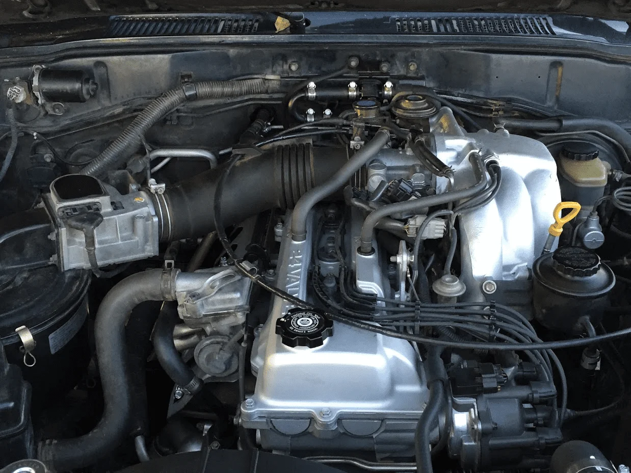

When I went to look at I could see it had a new radiator. I was new to the 80 world and did not know about infamous head gasket issue, But have bought many used car and usually shy away from anything with a new radiator.
The seller assured me it had not overheated and that he was a honest Family man.
Will we all know what happened, I did not make it 50 miles before I knew something was up, YEP blown head gasket.
Friends and family said I was wasting my time but I contacted the seller anyway, Honest he was He give $ 750.00 back towards a head gasket repair. I thourgh that was more then fair.
So off to Shoppy it went for the repair. Nice job Shoppy Thanks

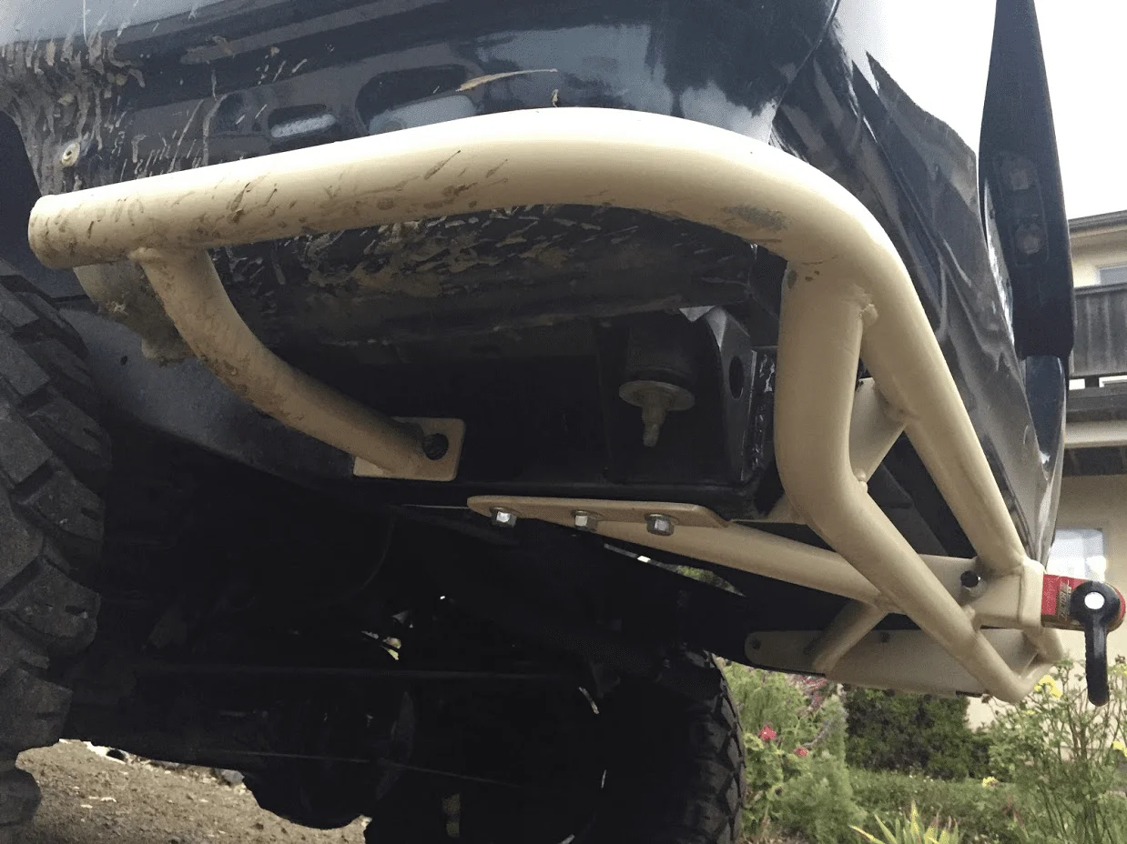

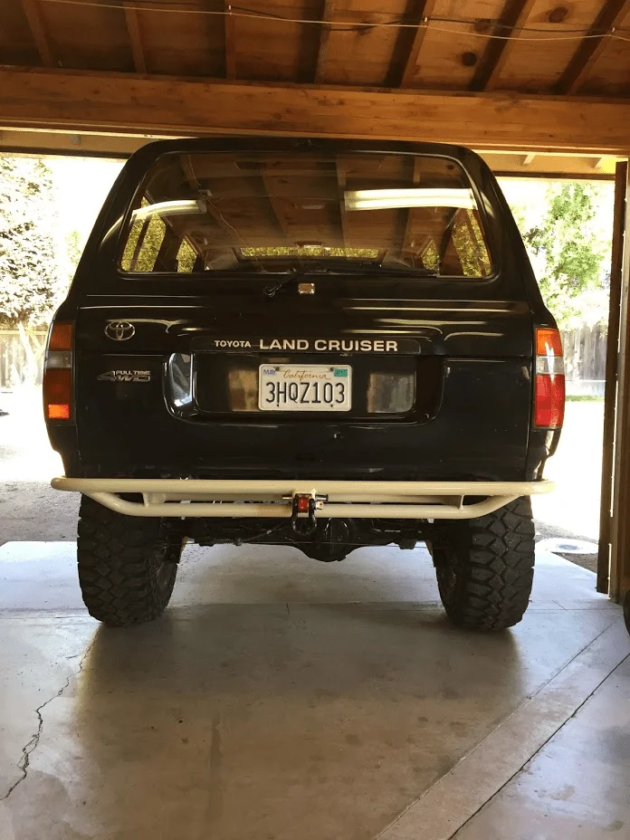

Started to Fab up a rear Bumper, cut out the rear cross member removed the spare tire mount & used the factory mounting points.
Was very happy with the way it turn out

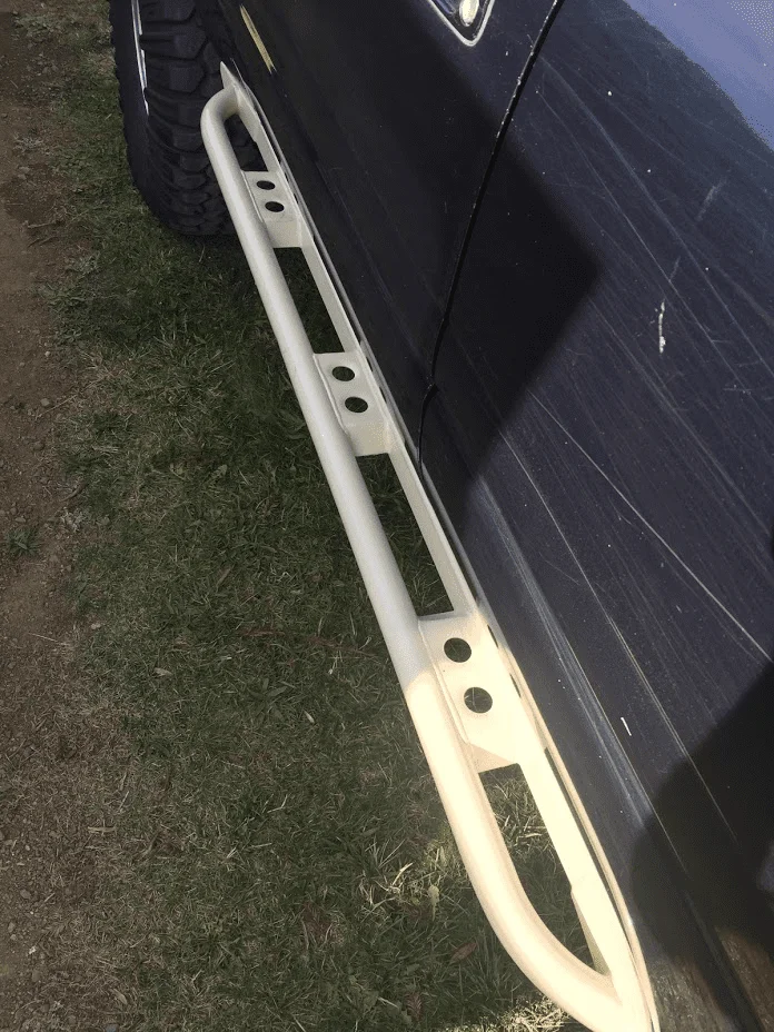

Up next were Rock sliders
These are one off molded in not attached to the frame. Again very happy with the way they came out.

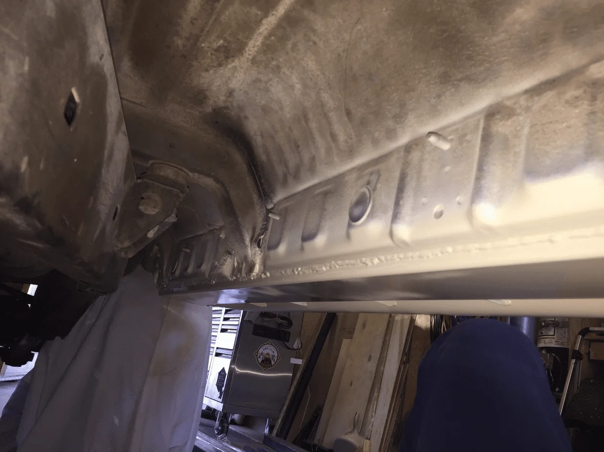

They are welded to the rockers only and have held up well
Pictures of how they are welded to the rockers underneath

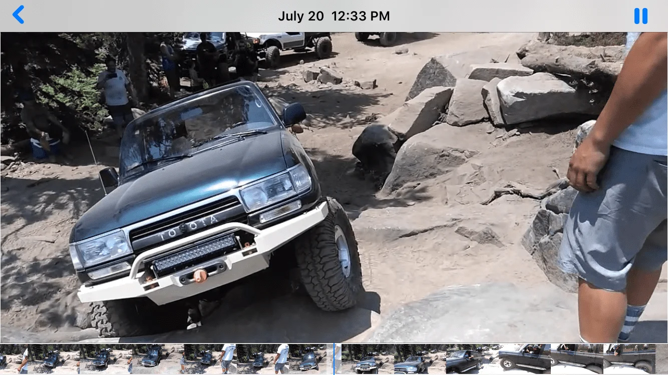

Around the same time came the Costa fab's front Bumper with a Zero Dark lite bar & a 10k Warn winch.
Again this is the only picture I could find. I was wheelin the Rubicon and walked right up the Soup bowl.

Always liked your rear bumper. One of the only good-looking rear tube bumpers out there.
