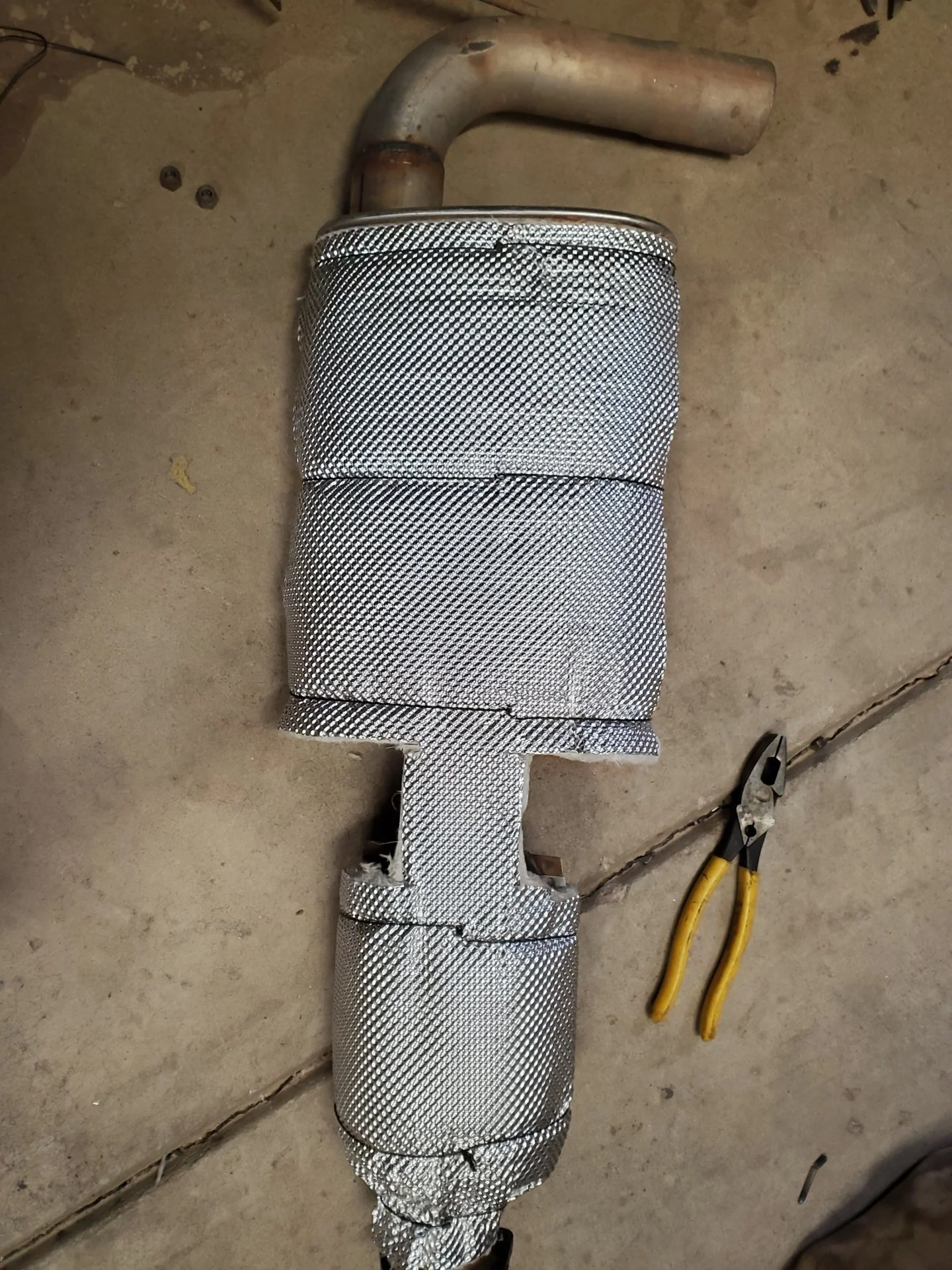

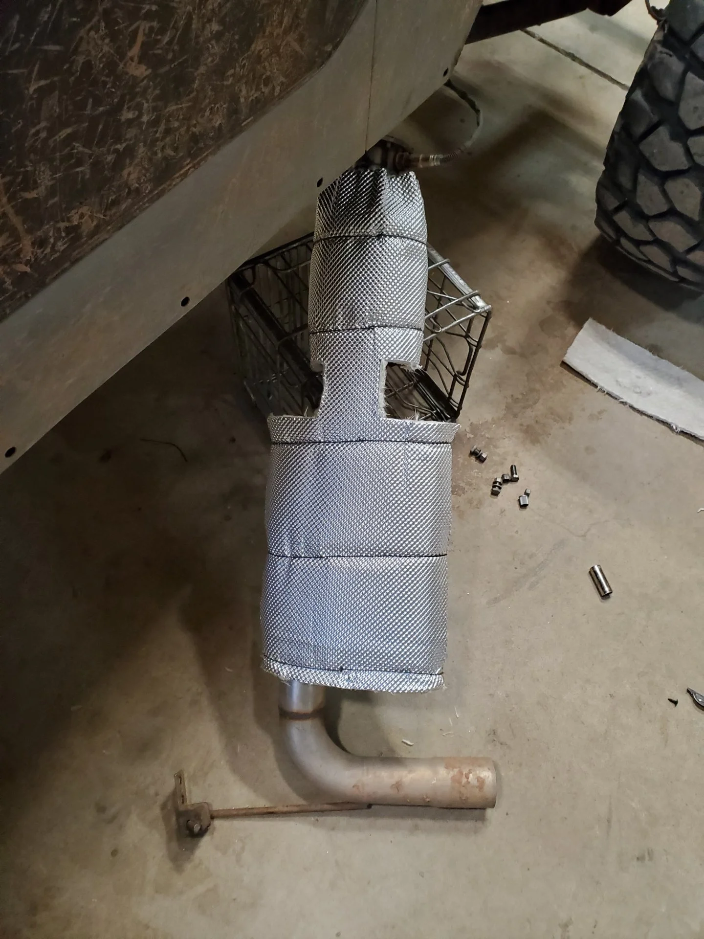

So, I've been having major problems with my fuel getting heat soaked, making my fuel pump really loud. It got bad enough that my fuel began to boil driving up from Colorado Springs to Woodland Park. I'm sure the higher EGTs from pulling uphill combined with the change in altitude did not help either. I'm going to also try to run a lower octane fuel for a bit to see if the lower ethanol content helps as well.

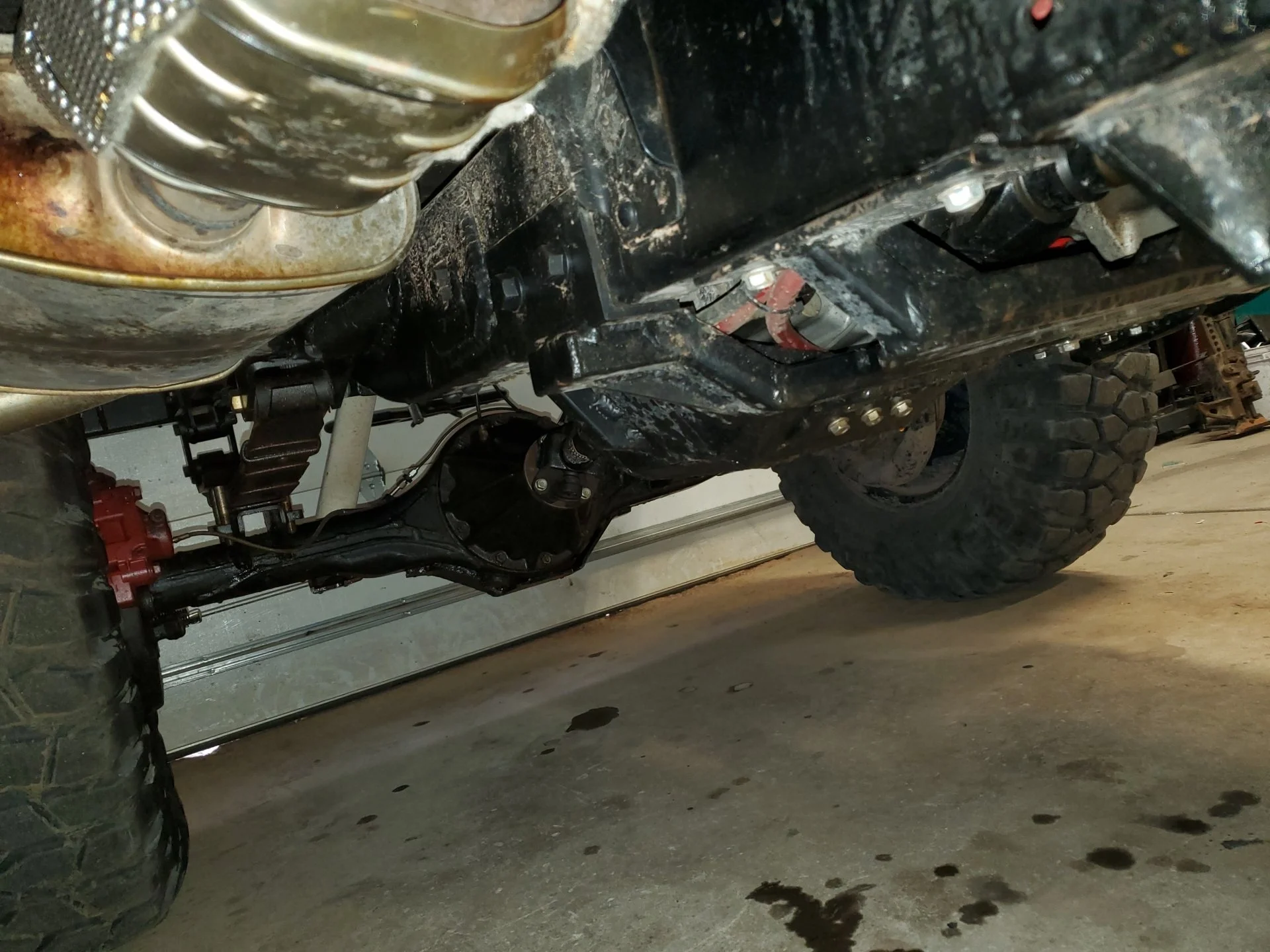

I wrapped my exhaust under the floor boards to see if I can keep the tank cooler.
If this doesn't solve it, I will be building some aluminum air-gap heat shields for under the floor as well. That should solve this problem completely. I don't have a ton of time right now with finals and other projects, but that is on the list. I'm really glad my exhaust is super easy to pull and replace.

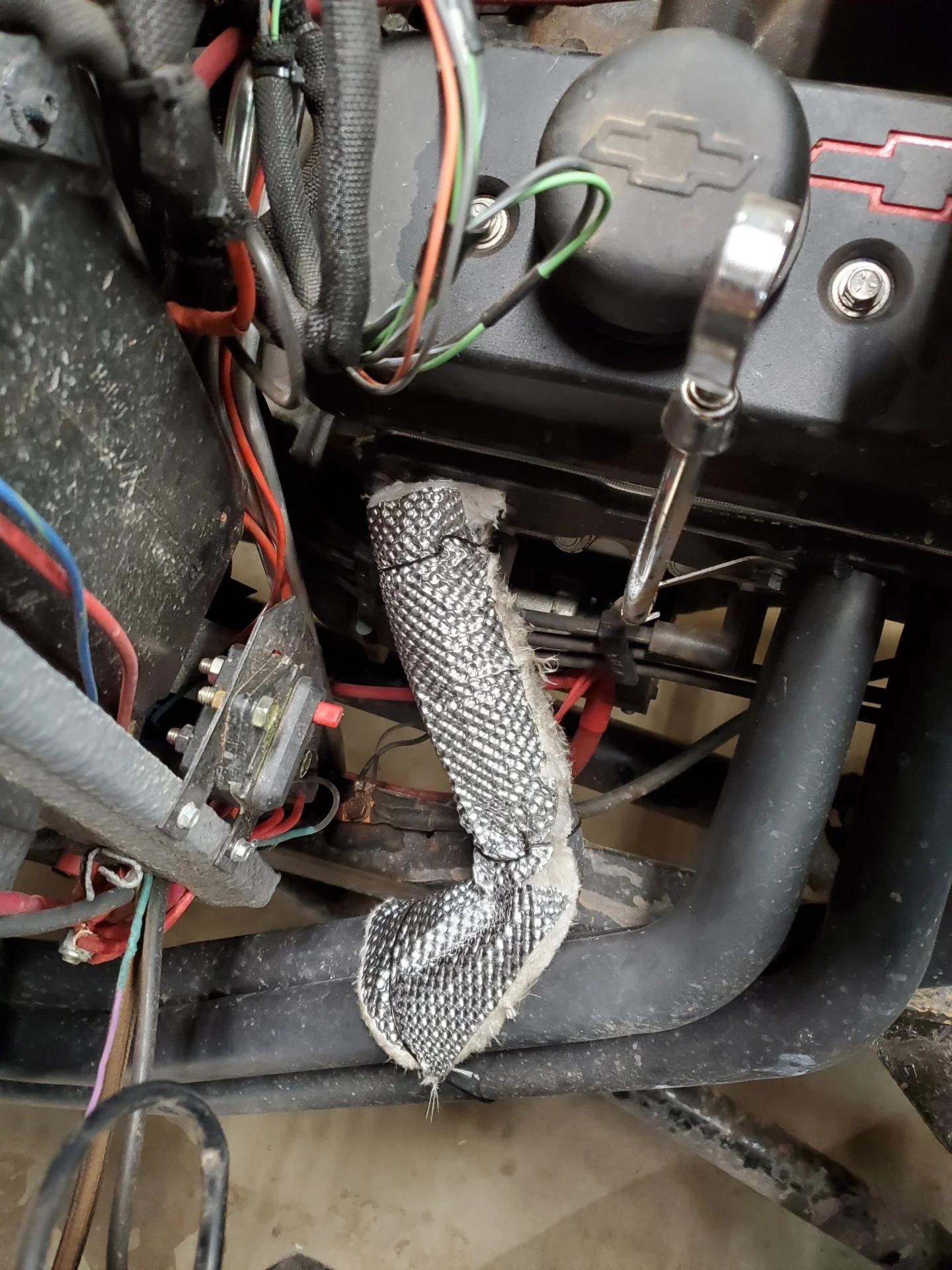

I also wrapped the header a bit where it comes close to my fuel line. I have some wrap that is susposed to go over the lines coming as well. I'm sure there is some heat transfer through the injectors, and I need to replace my gasket for the sniper because I have some pretty bad IAC whistle in 4th and 5th gear when I start to load up the engine, so I will probably add a spacer in there to try and keep the sniper cooler as well.

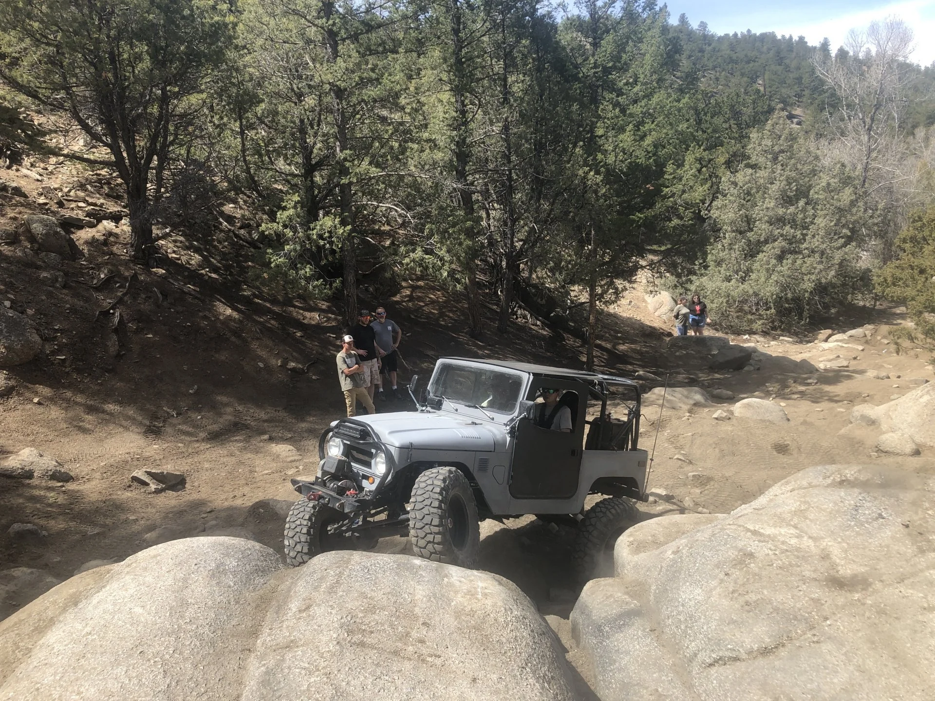

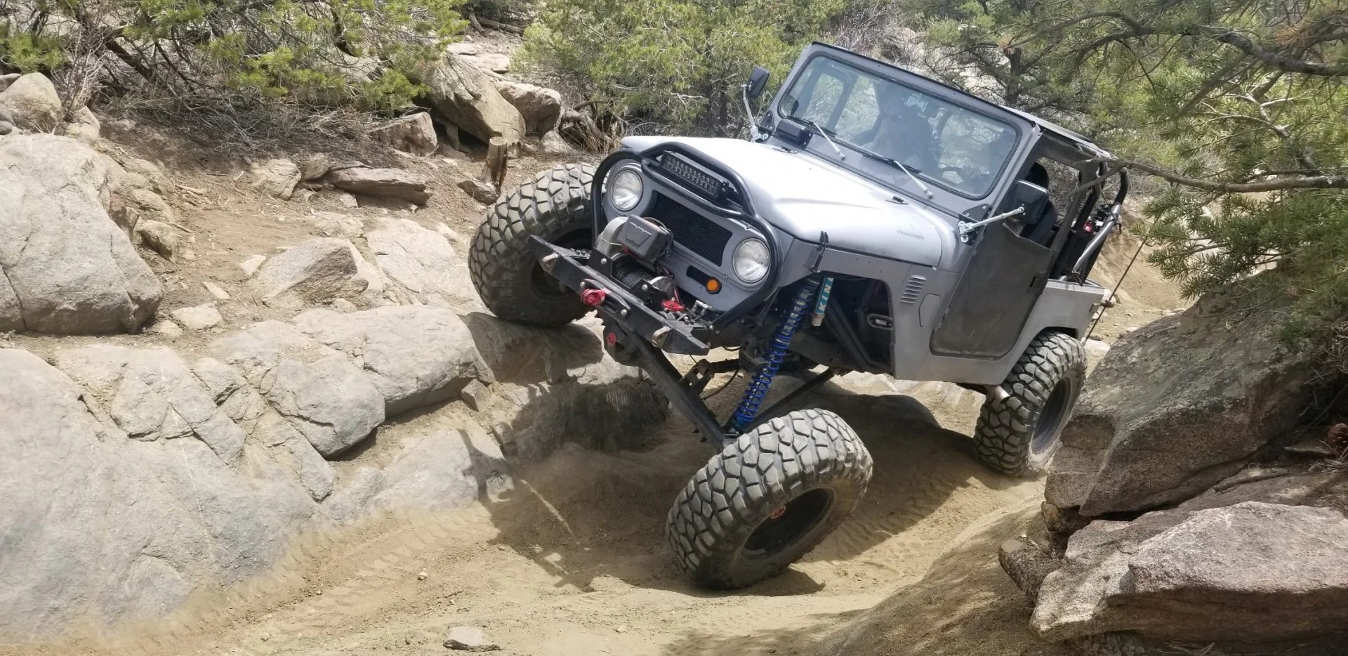

Do you have a pic where it’s fully flexed out? I bet it’s like 90 degrees or something haha
I don't. That rock was probably about 4' tall though.

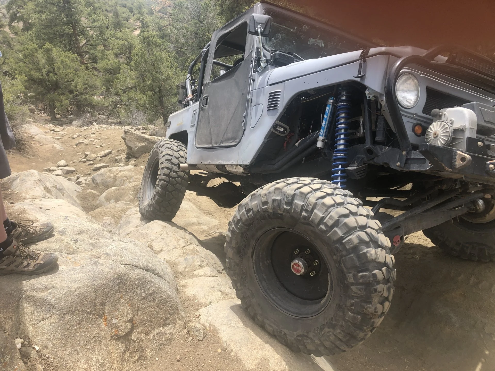

I need to know EVERYTHING about that front link setup!!!!!😍
I'm running 16" King 2.0 Coil Overs with Compression Adjusters from Filthy Motorsports. Universal Johnny Joint 3-Link kit with some extra brackets from TMR Customs.
Currently about 2.5' of travel.

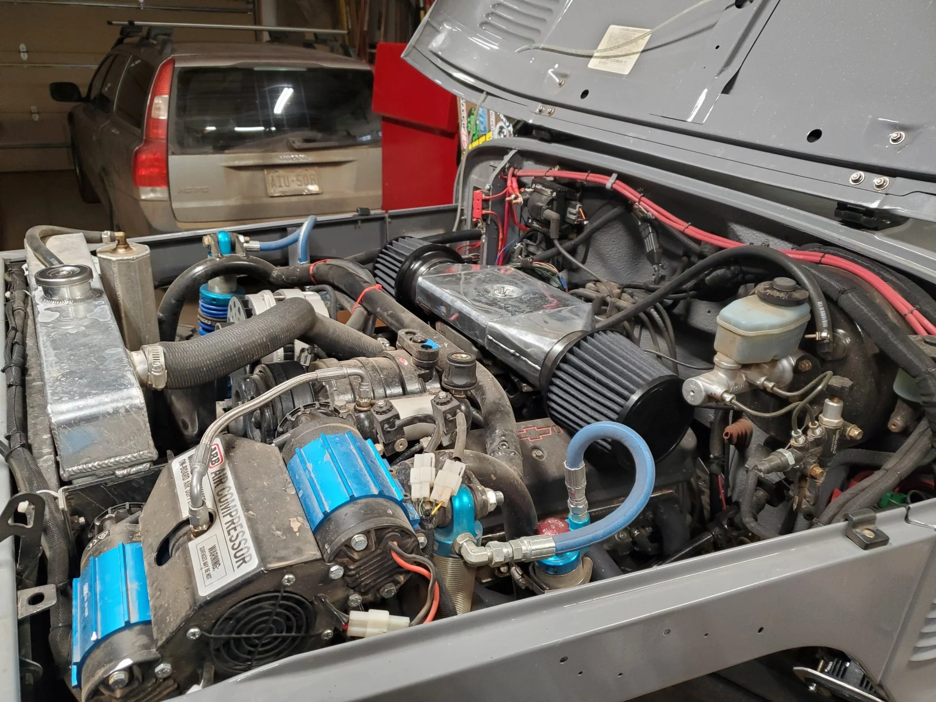

I also replaced my air filters with something a bit stubbier, so they clear the master cylinder. Some more updates to the engine will be happening soon.
Currently about 4' of travel.

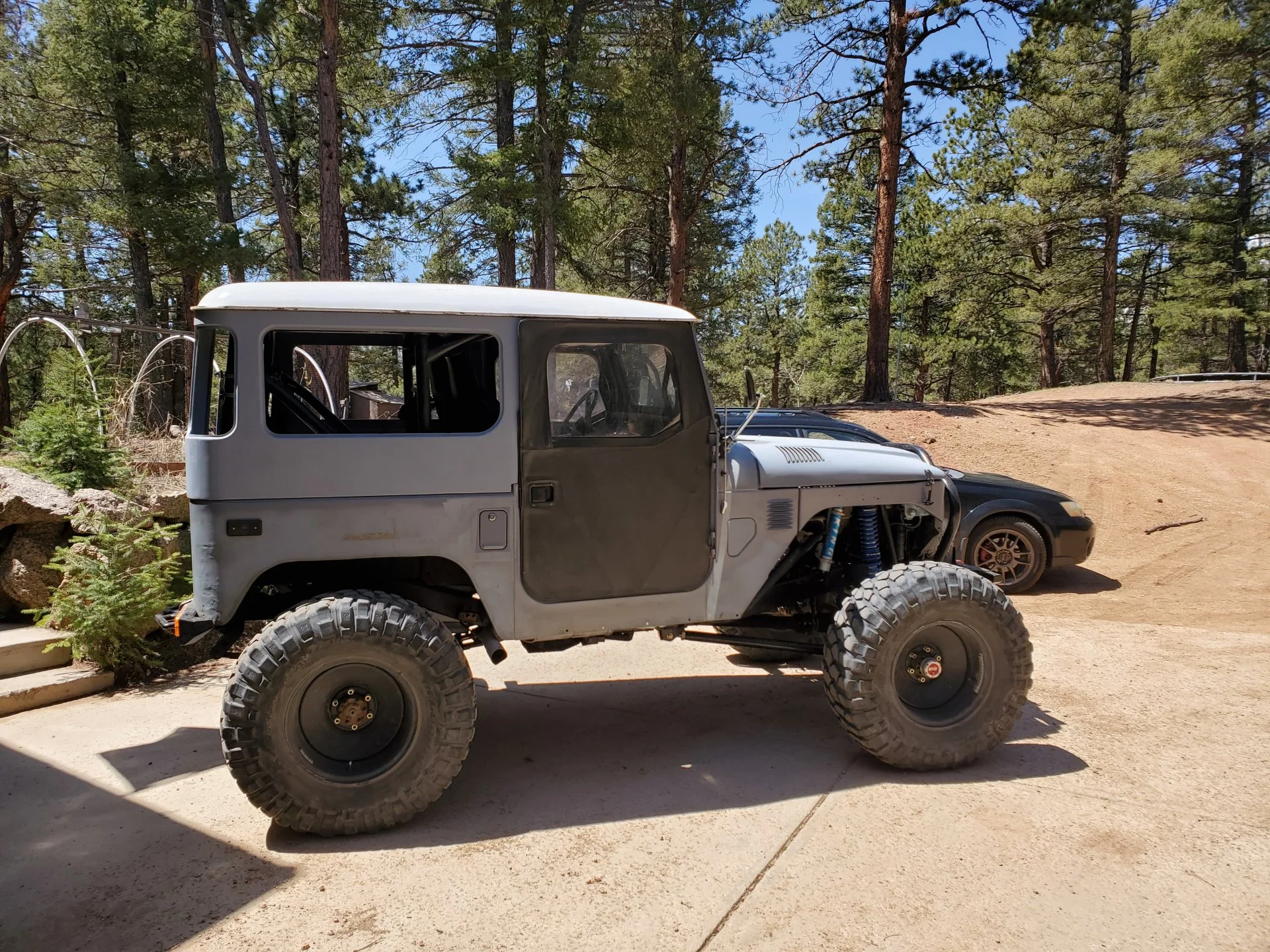

Got the hard top on today for transport.
I'm really happy with the look. I think it will look even better with the hard doors, sliders, tube fenders, roof rack, rear tire carrier, and paint.
:rofl:
Still a lot to do, and some fixes to be had. I'm thinking I am going to move my wheel wells up before final paint.
