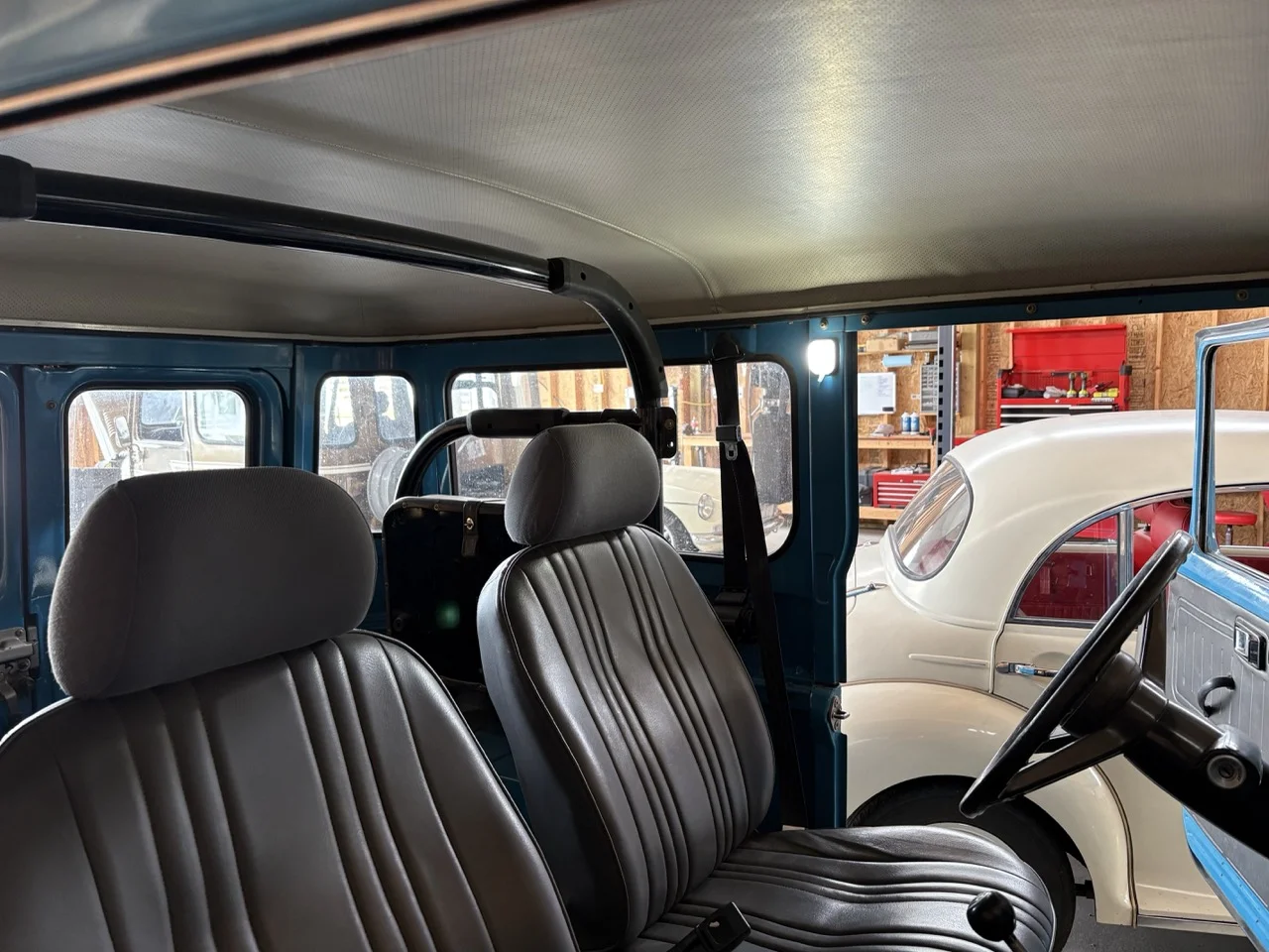

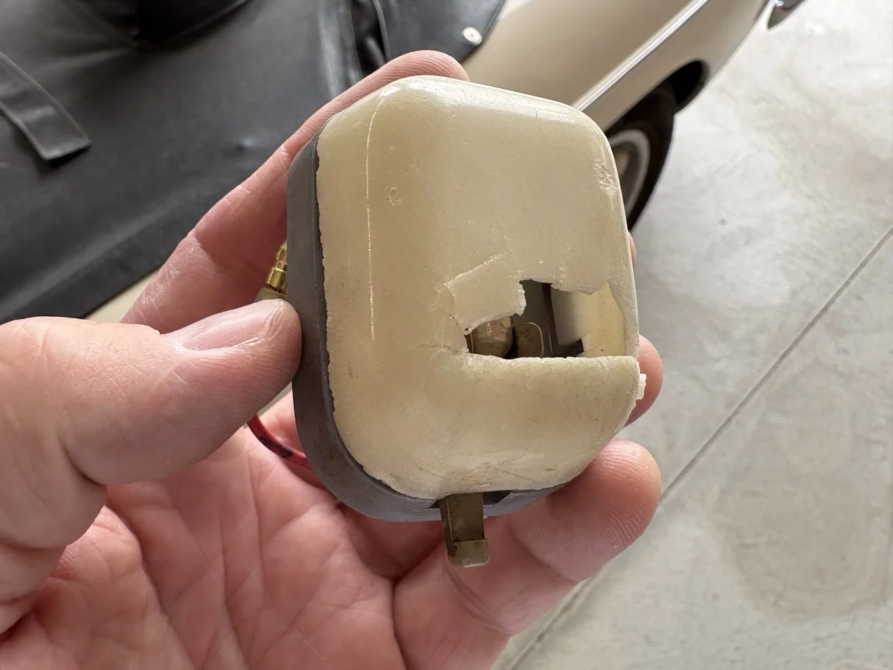

Finally had some time to knock a few small projects off of the Otis list. While I was waiting for some help to get the clutch slave installed and bled, I tackled a few small issues. First up was the dome light — the old one barely worked if you wiggled the switch just right, and the lens was cracked. A new LED one from City Racer and one item checked off the list.
From this:
To this:

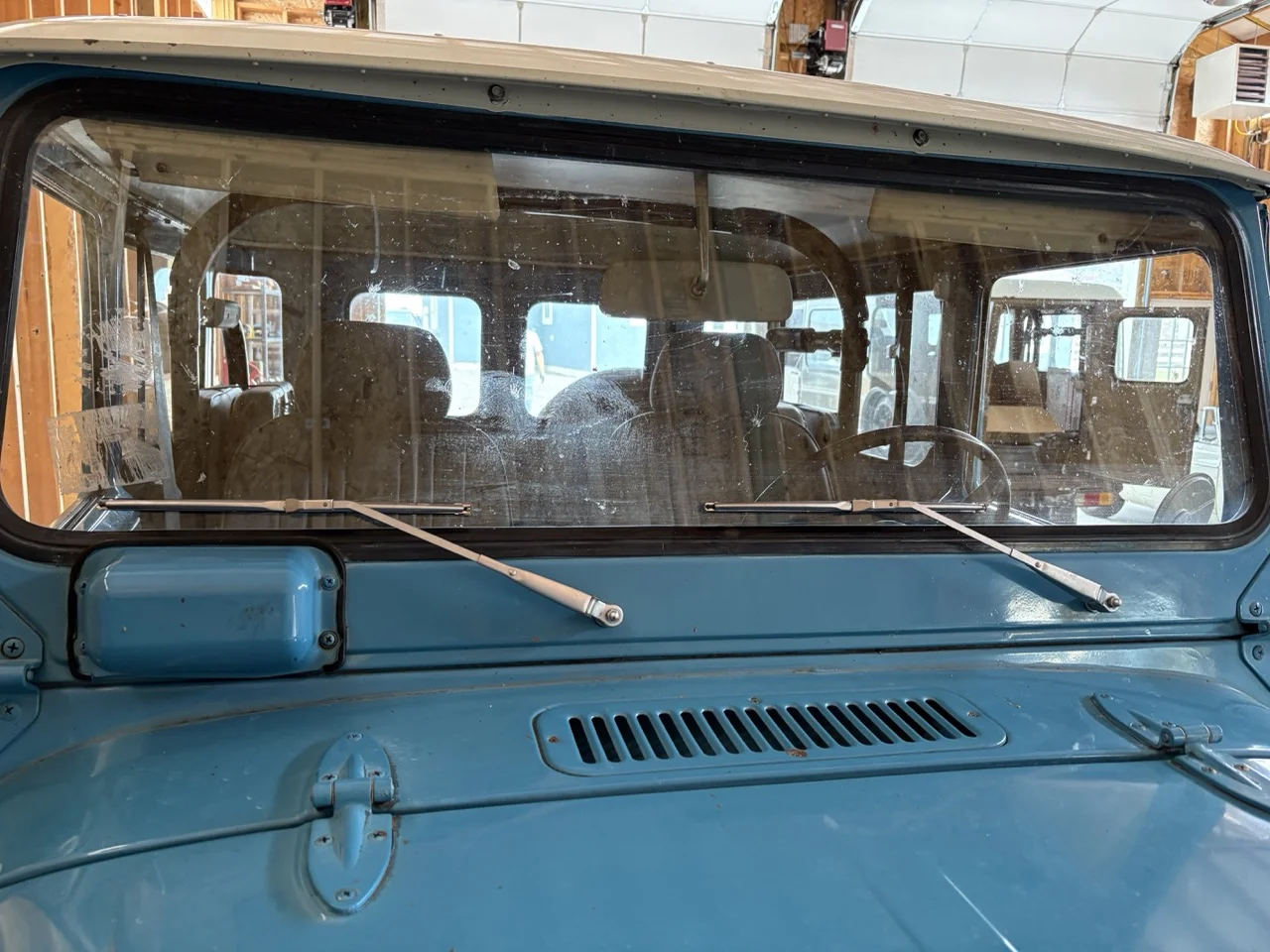

I also got the wiper blades replaced with correct ones. Small victories are sometimes what we get.
