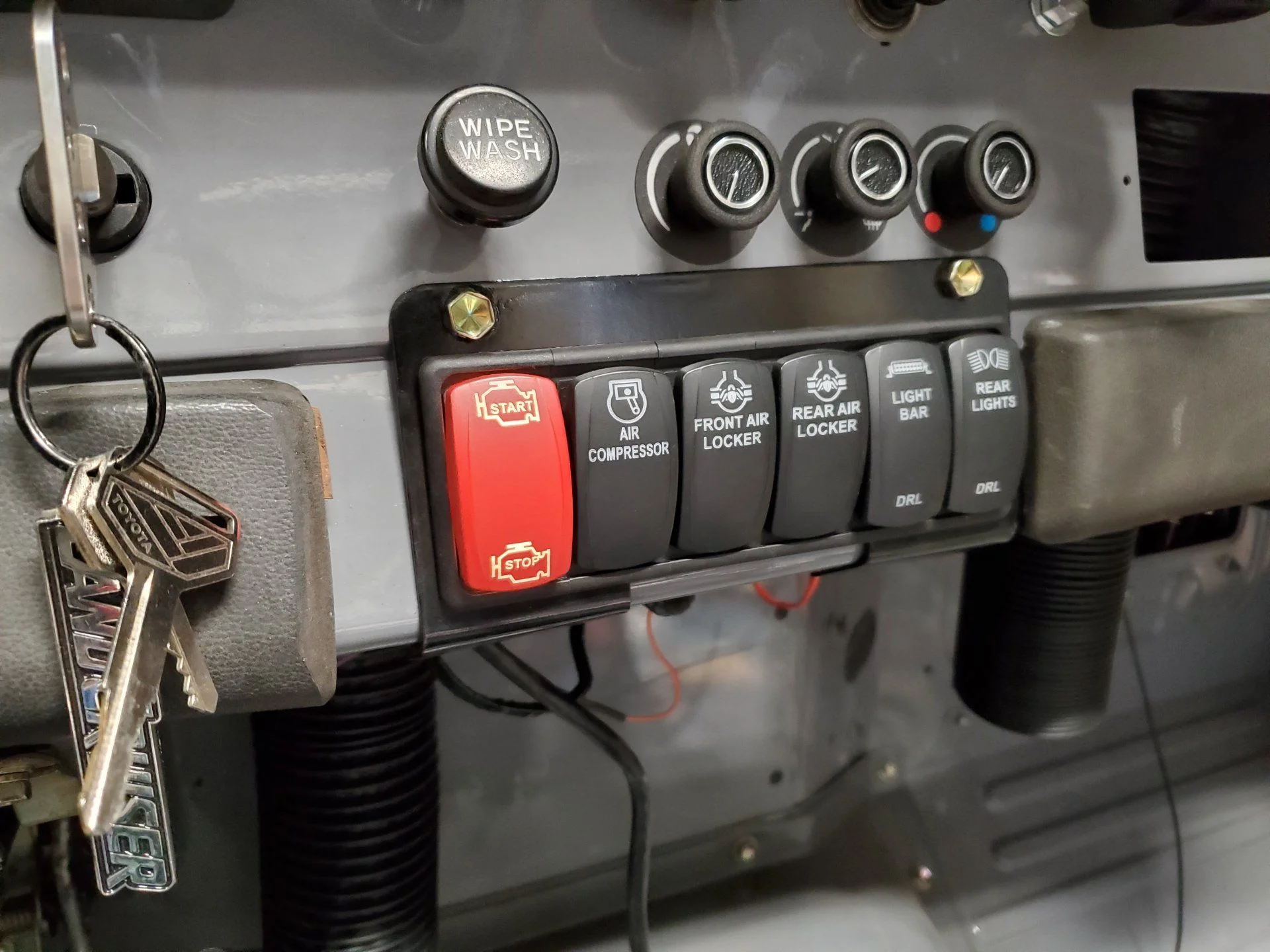

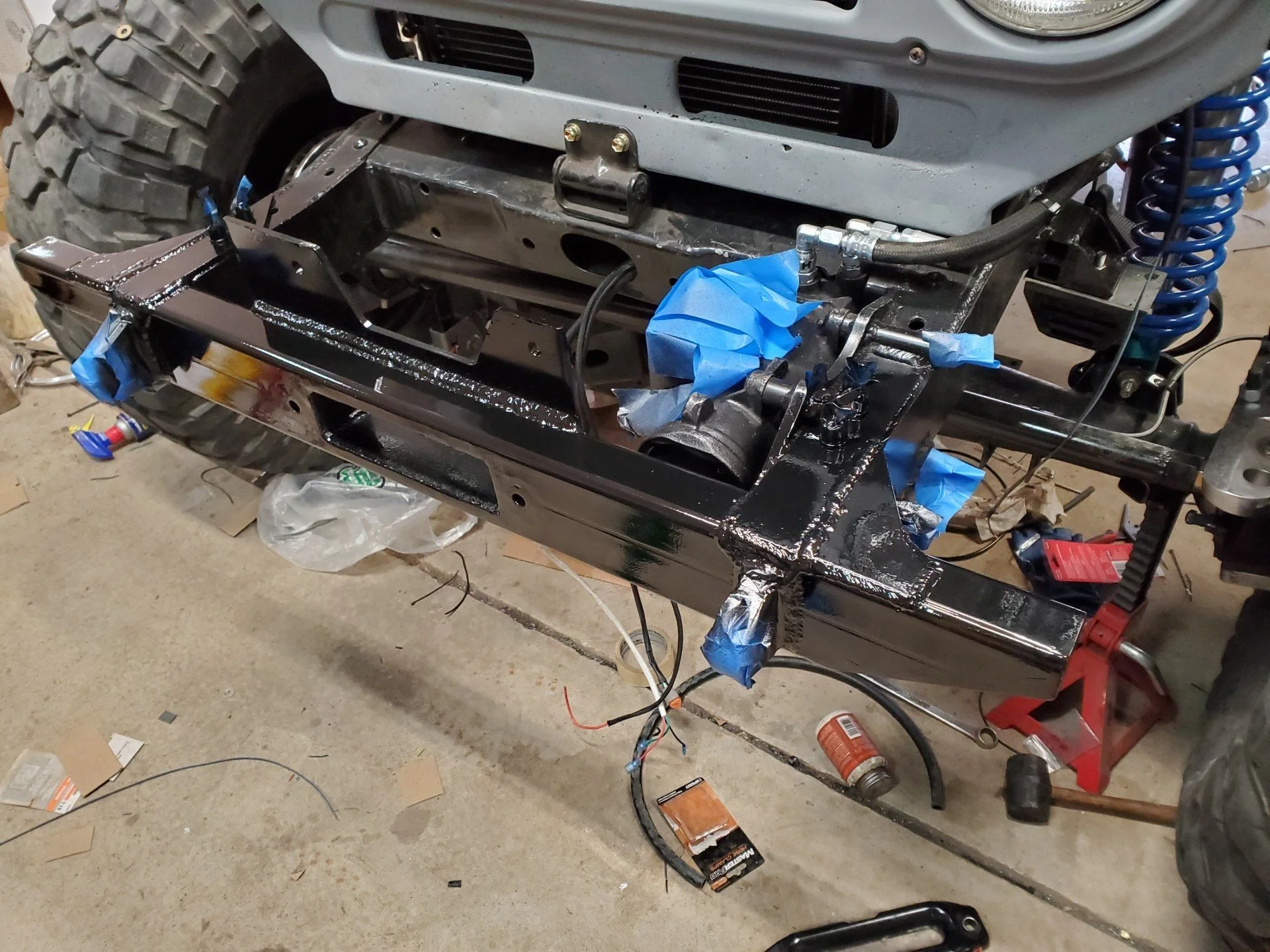

Switch bracket made up. I really like the look of the bracket and switches.

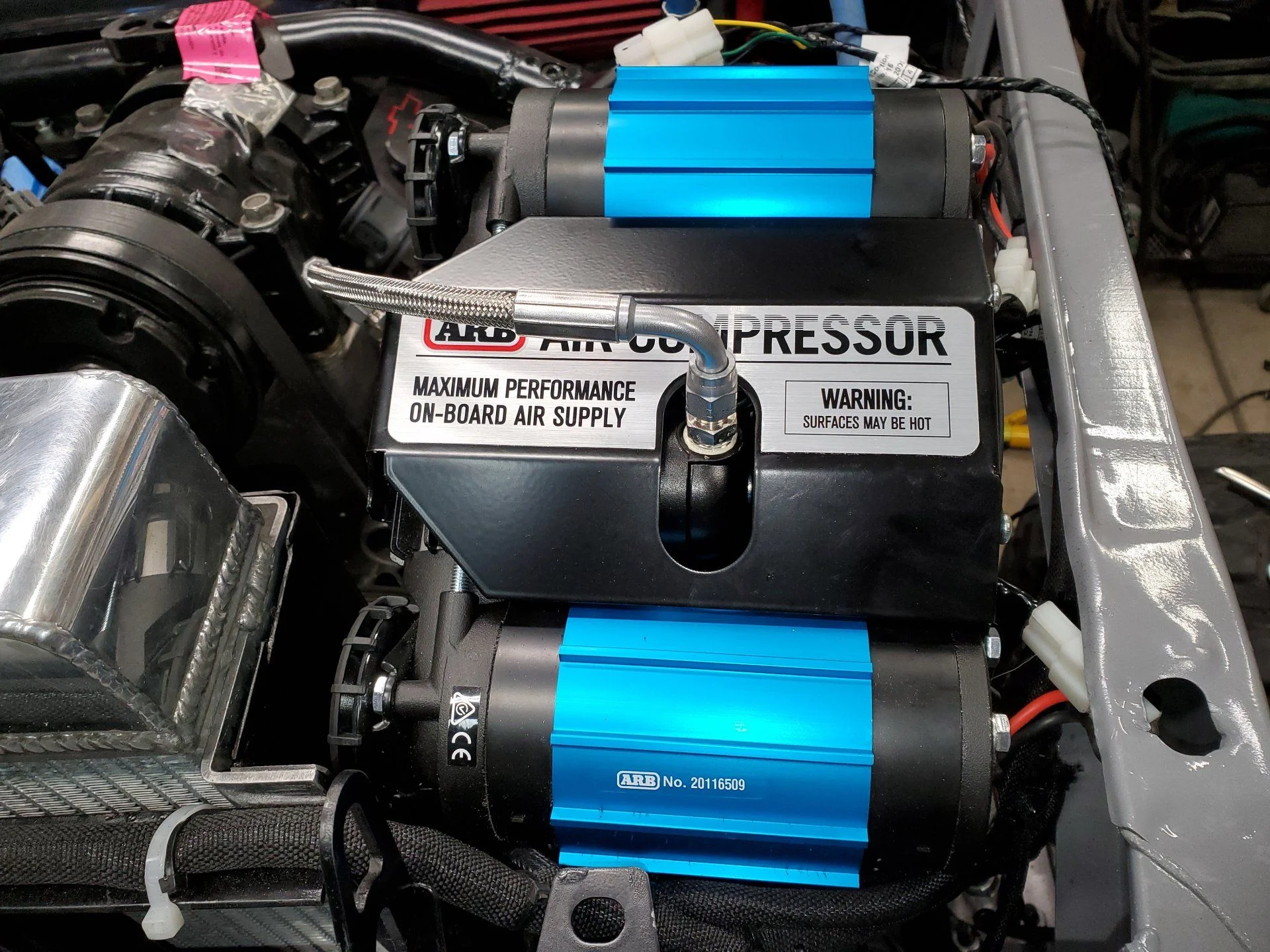

ARB compressor installed.

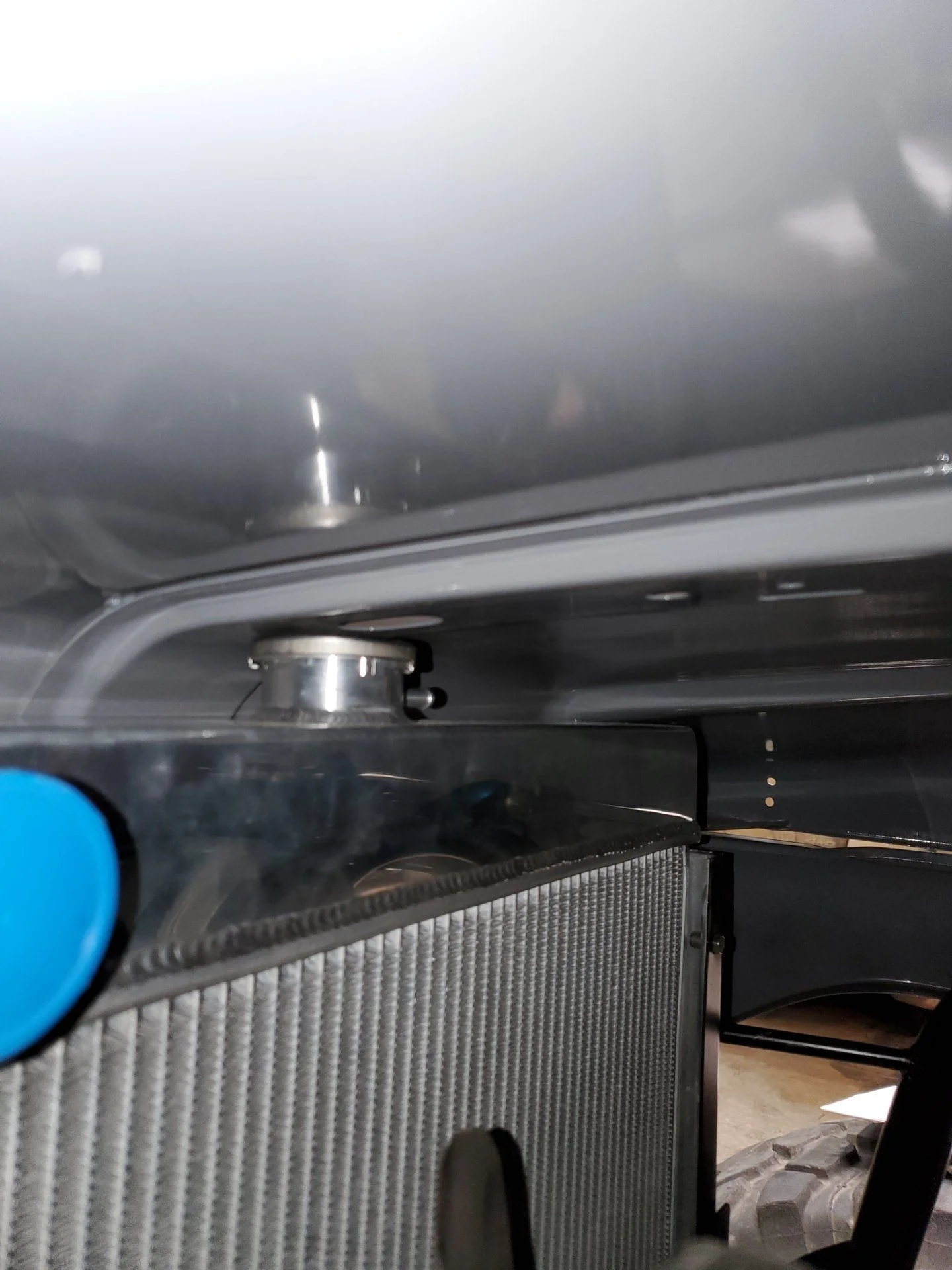

Hood on to check for clearances.
Air line.

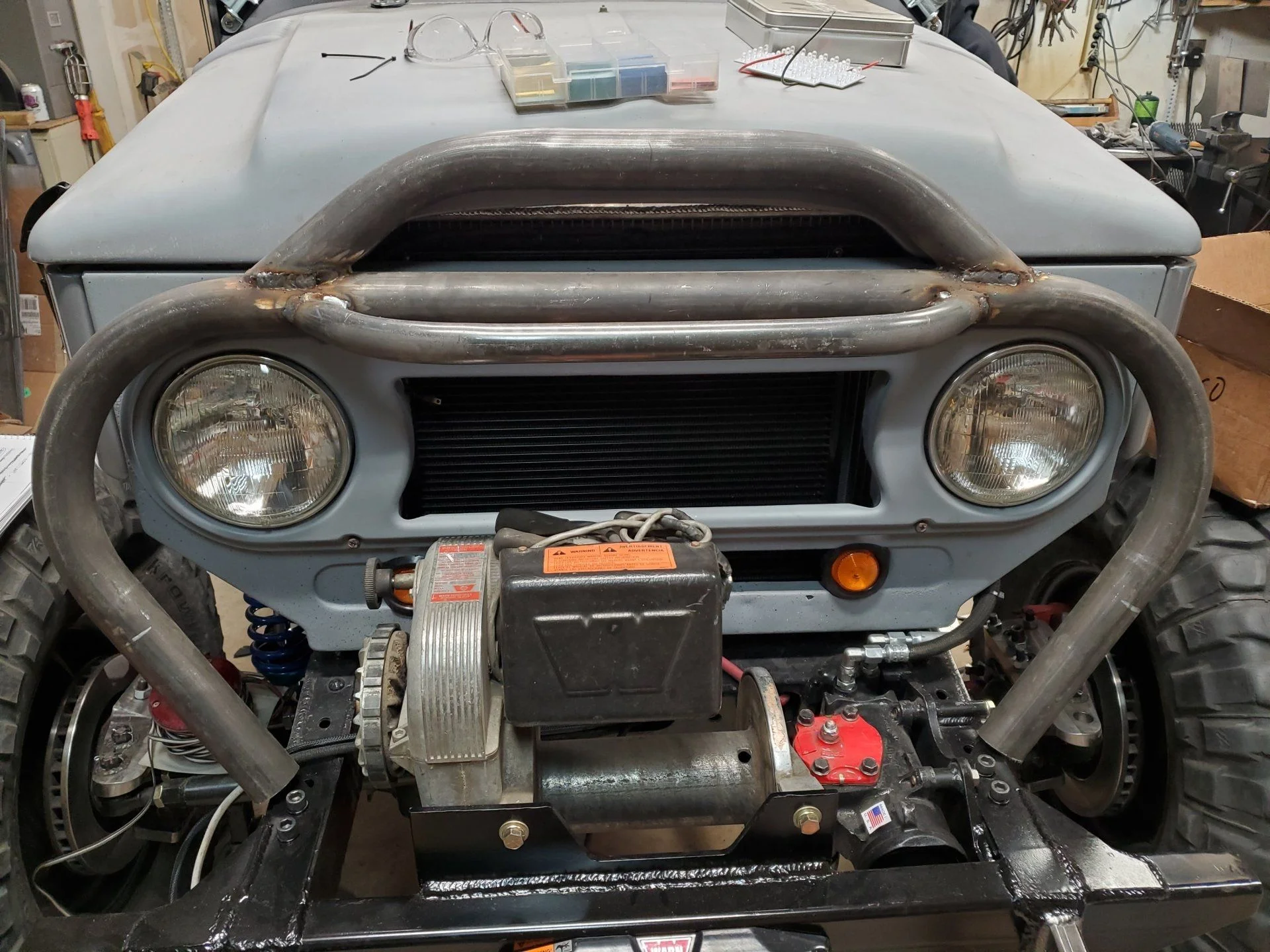

Radiator. It barely fits, but it does.

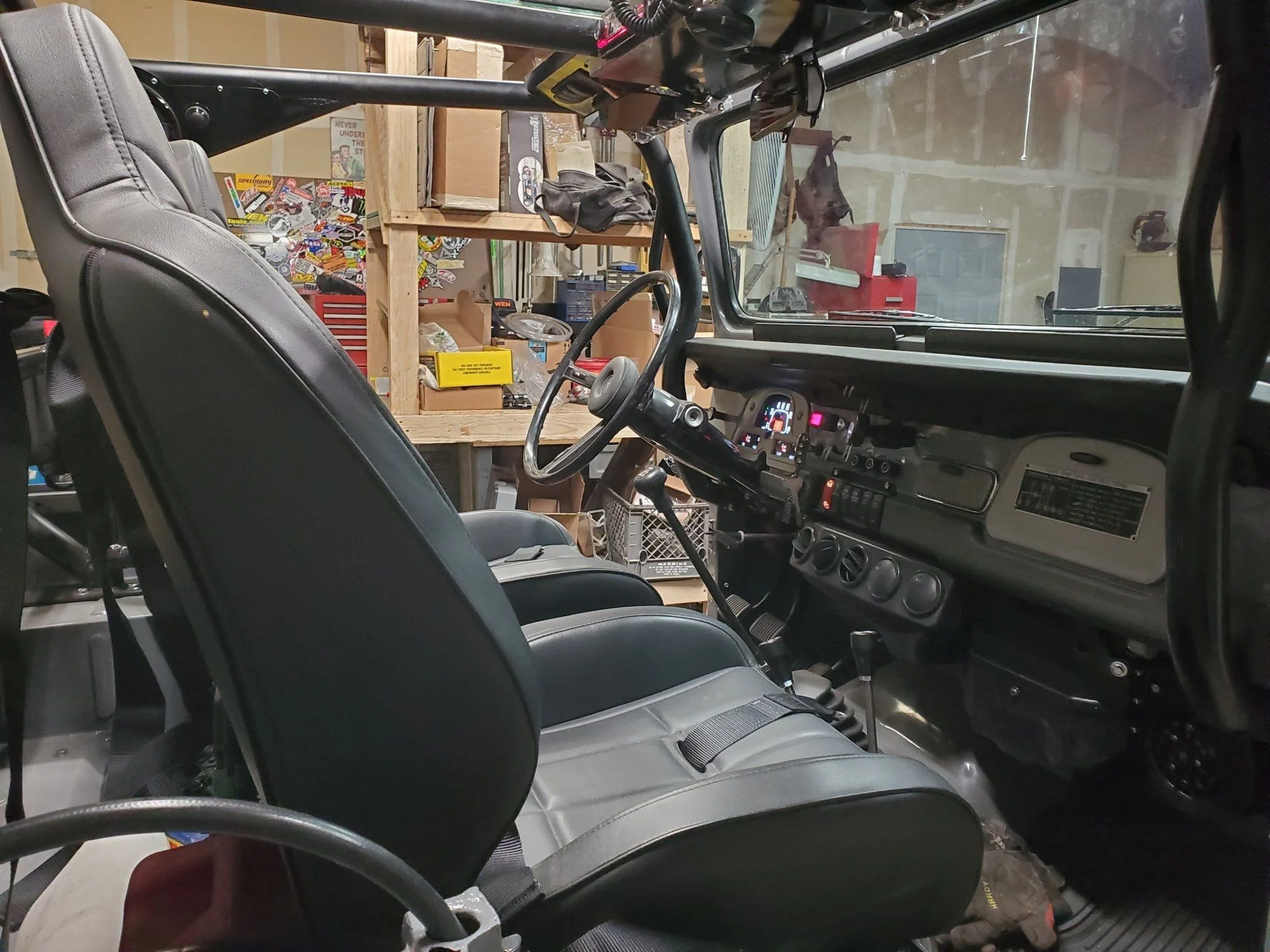

Holley sniper displays panel works. It can be seen through the sun visor and I think it looks really nice.

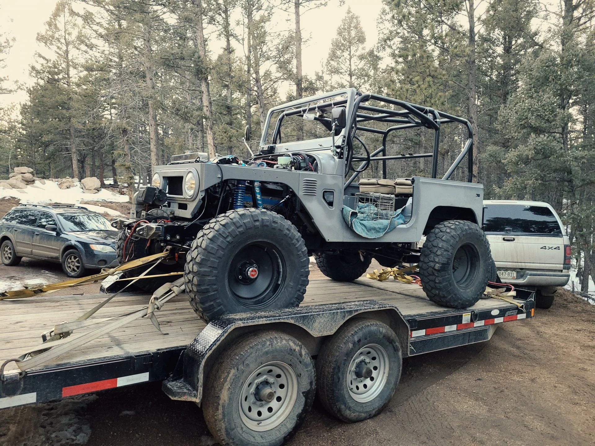

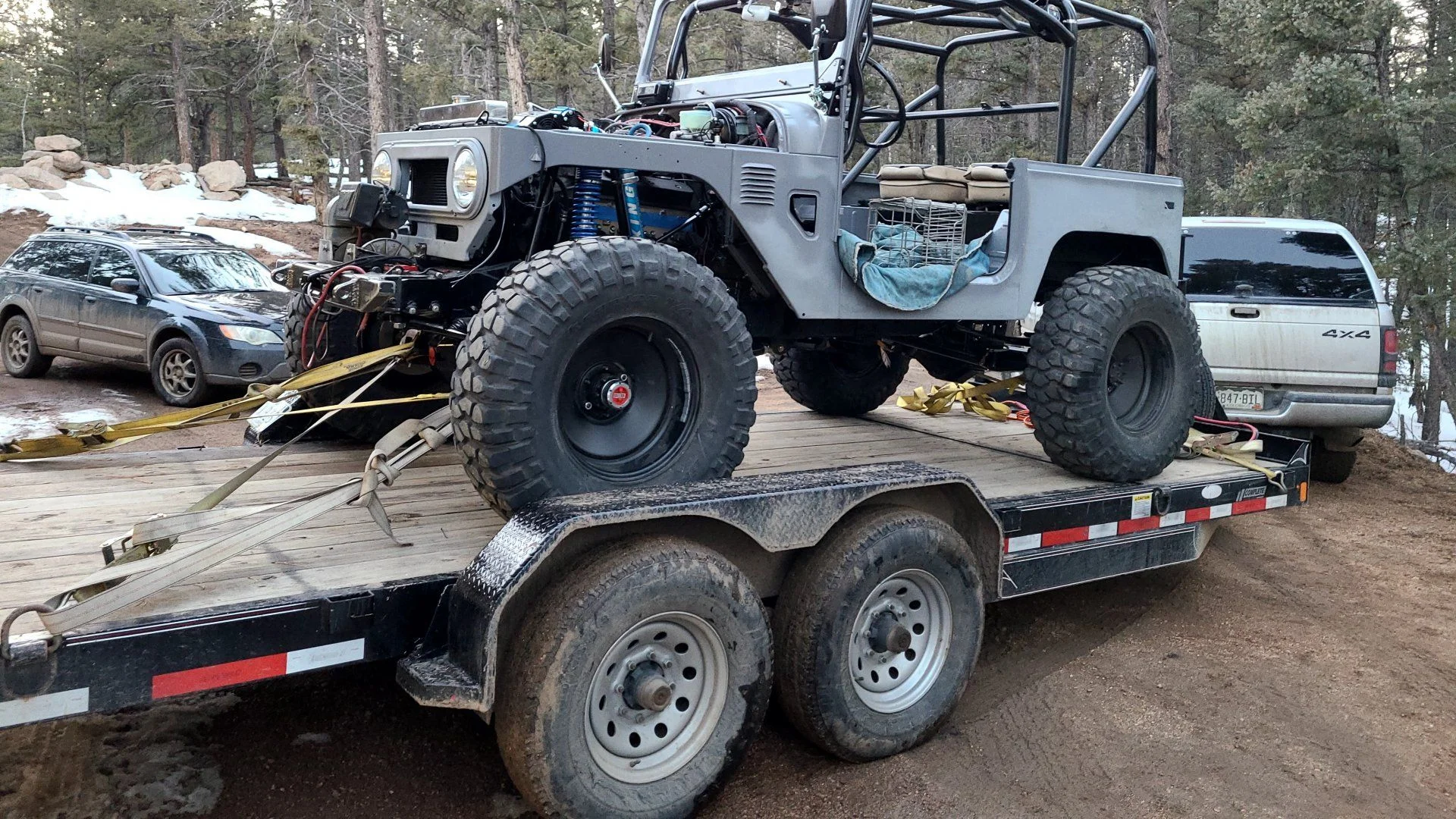

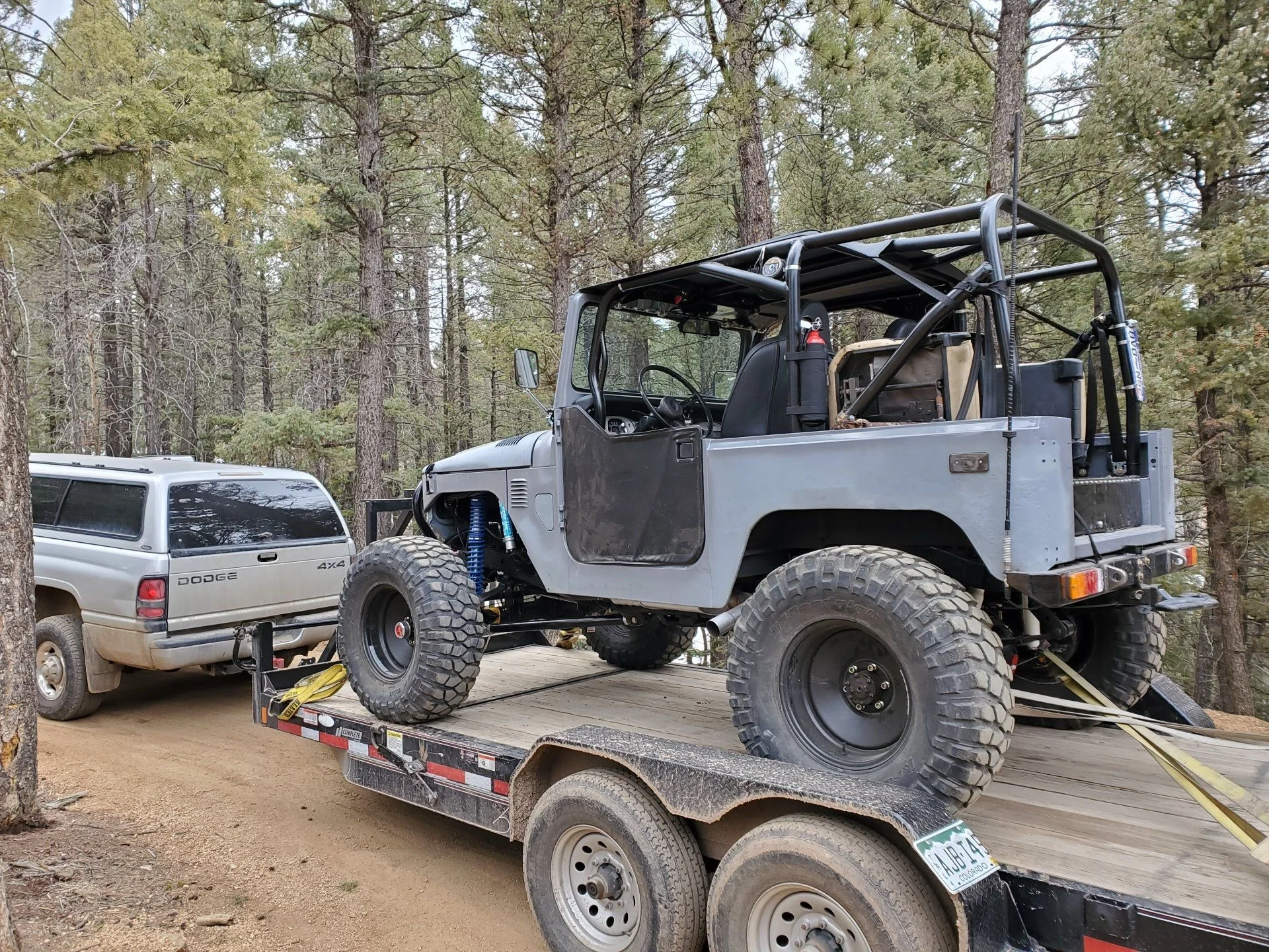

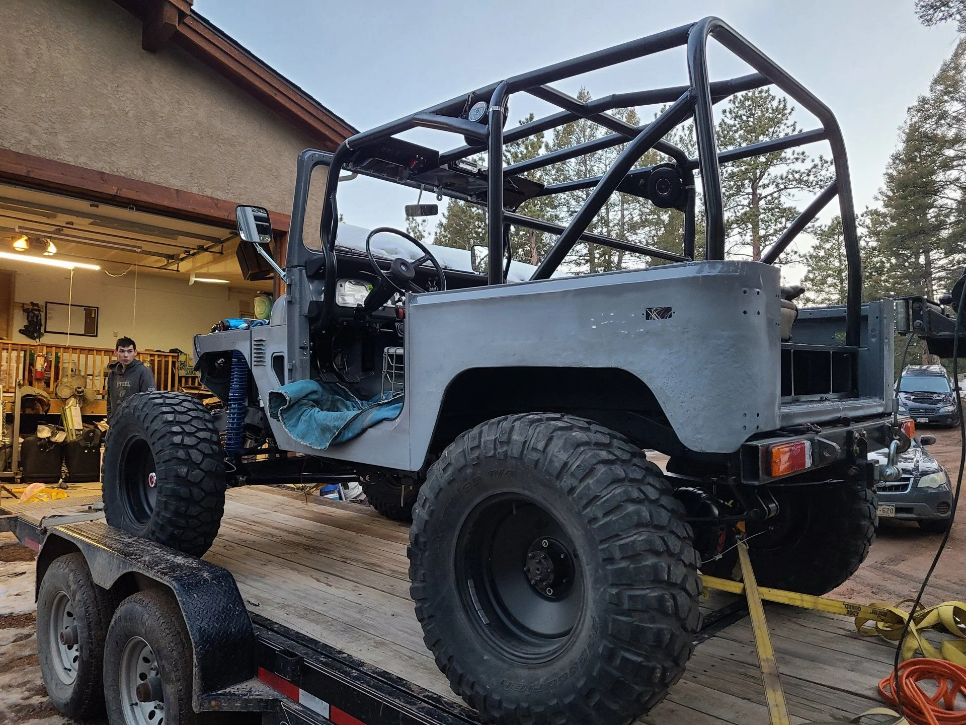

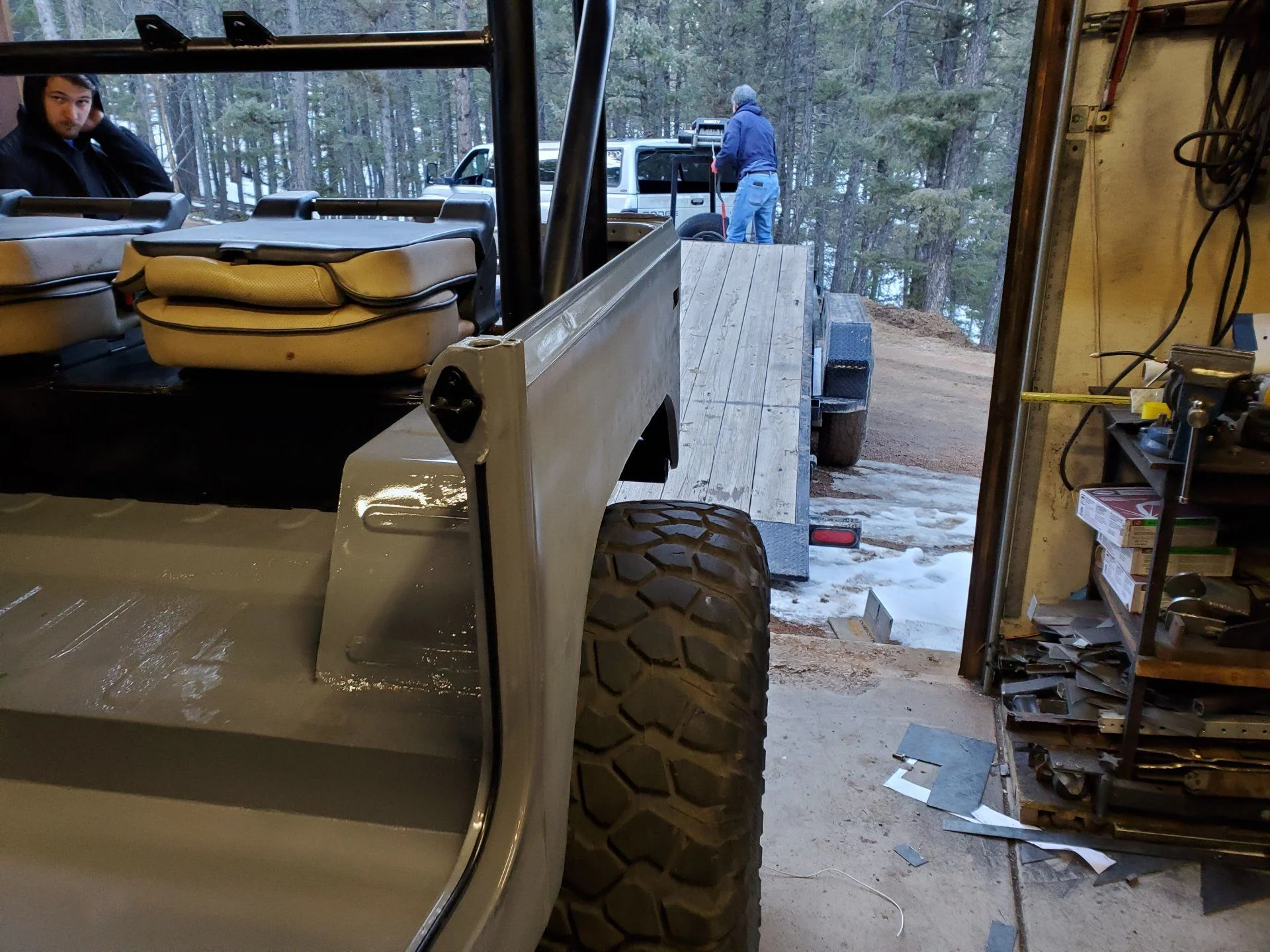

Loading up for the first trip since arriving here last January.

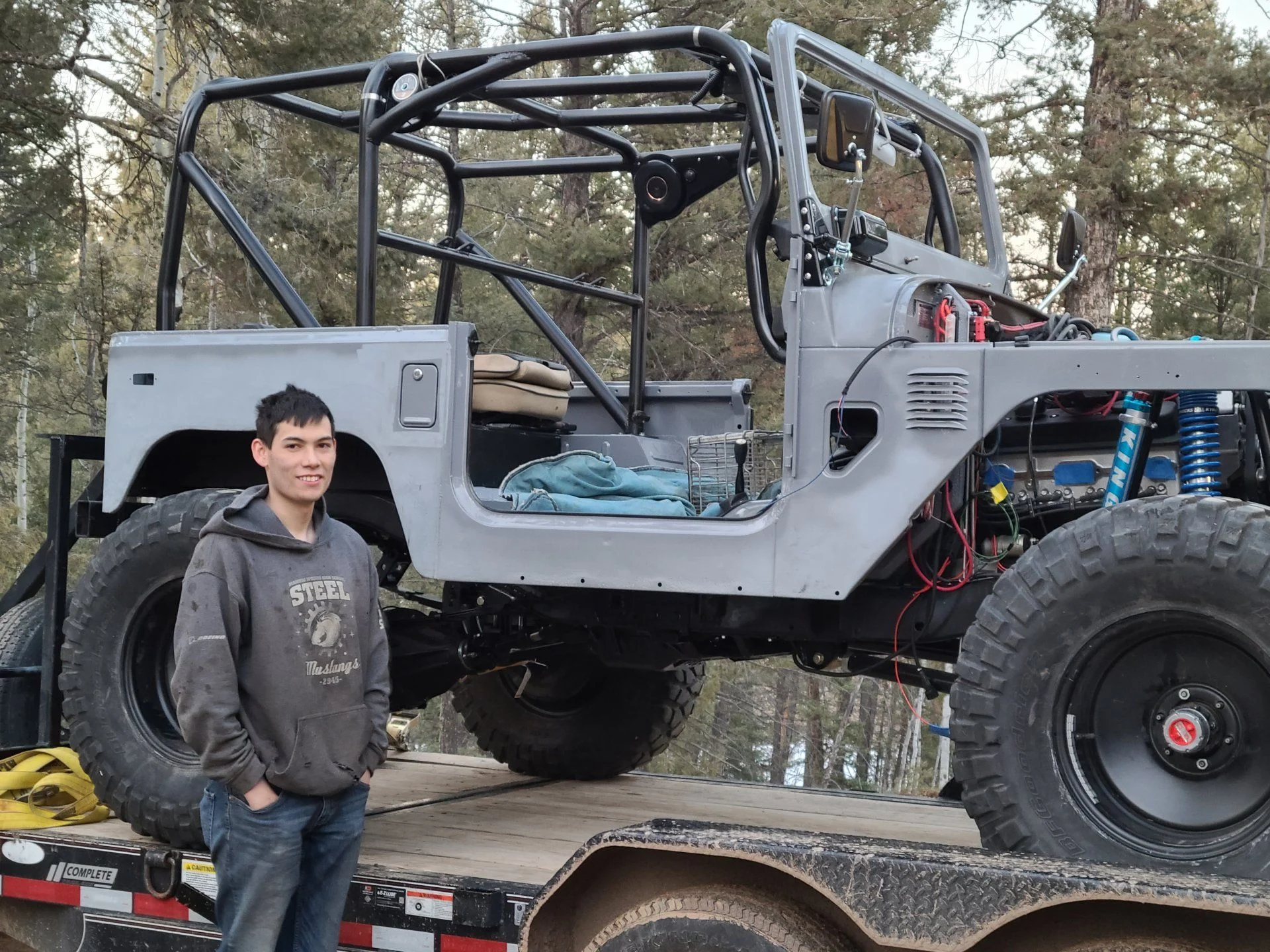

Loaded up. I'm absolutely loving the stance now that it can be fully seen from a distance.
Me, next to the last year and a half of my life. :doh:

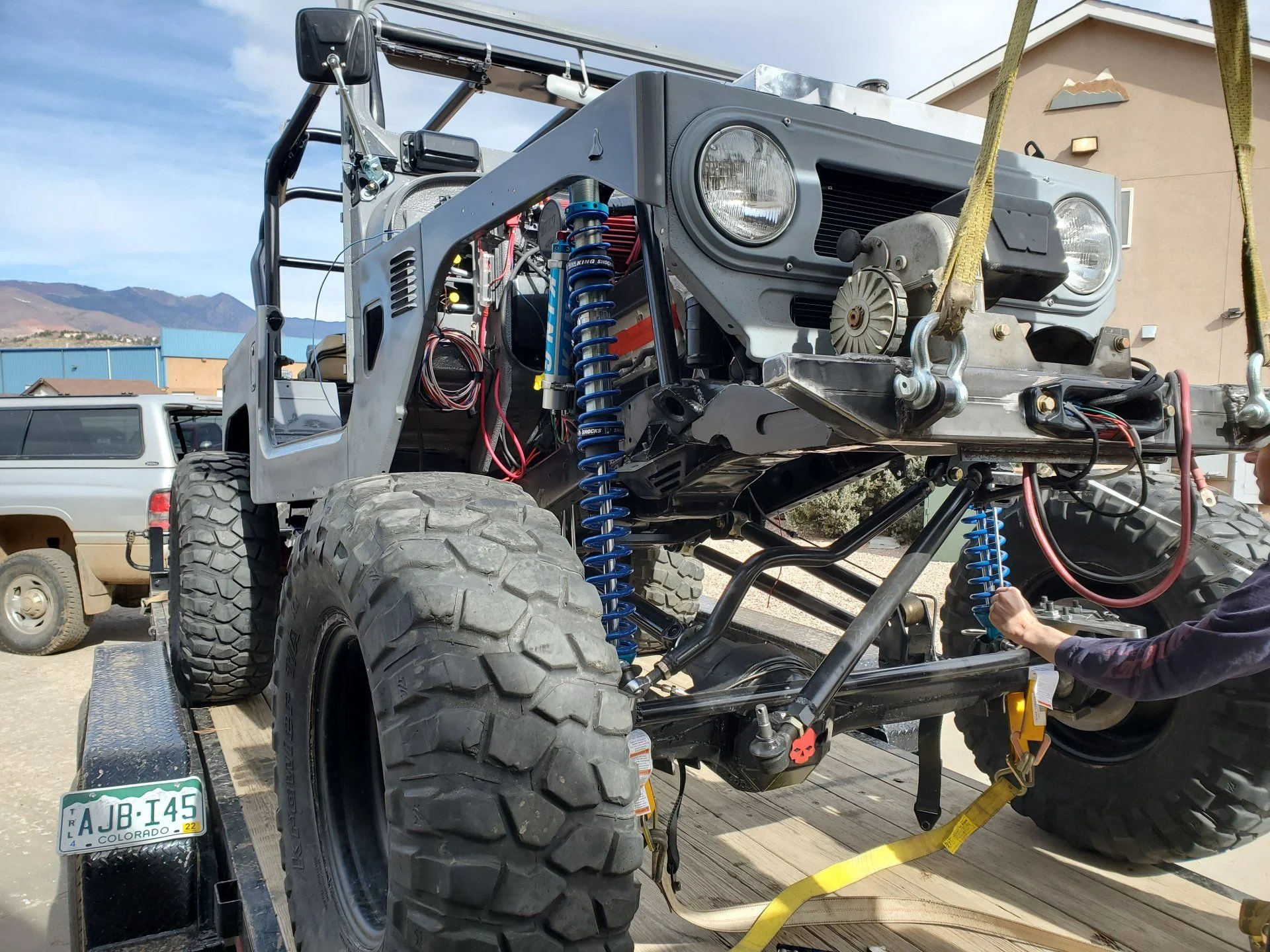

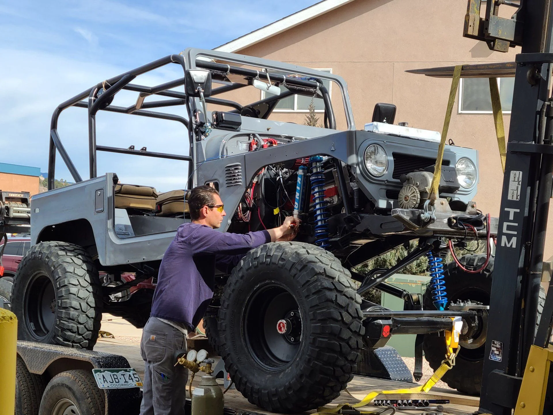

Charging the coilovers with Jed @ Armorology.

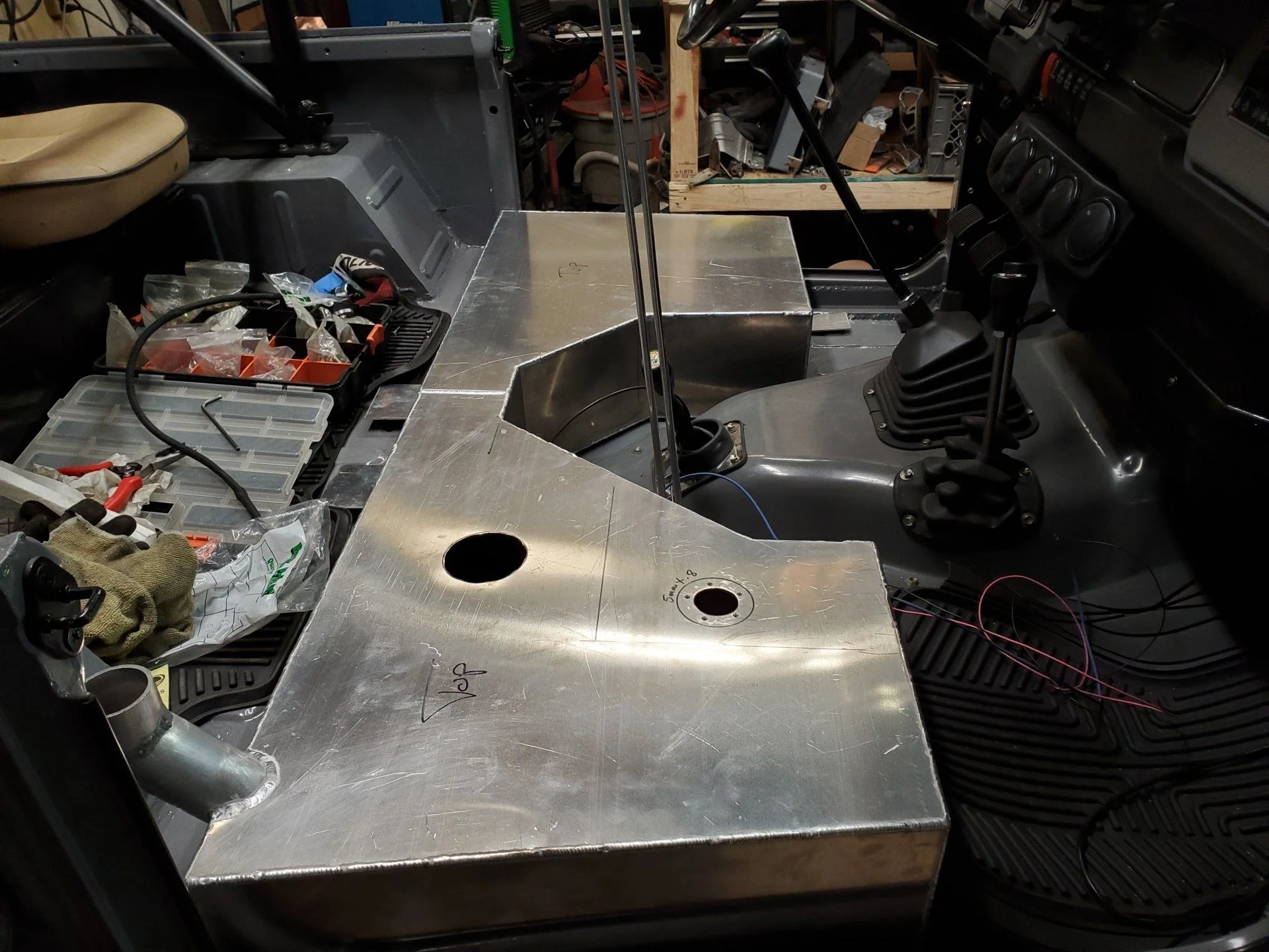

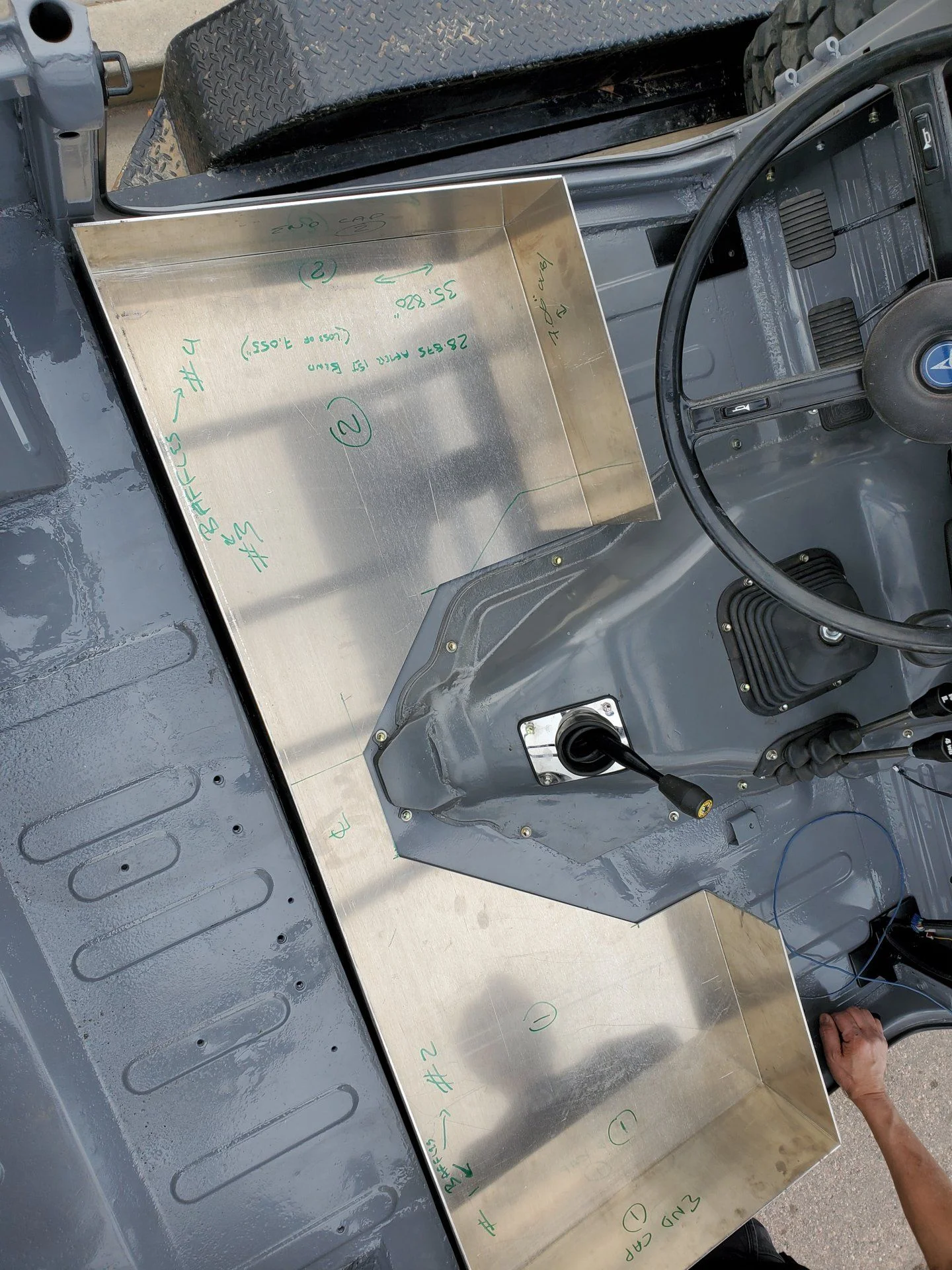

A quick test fit of the fuel tank, now being welded up.

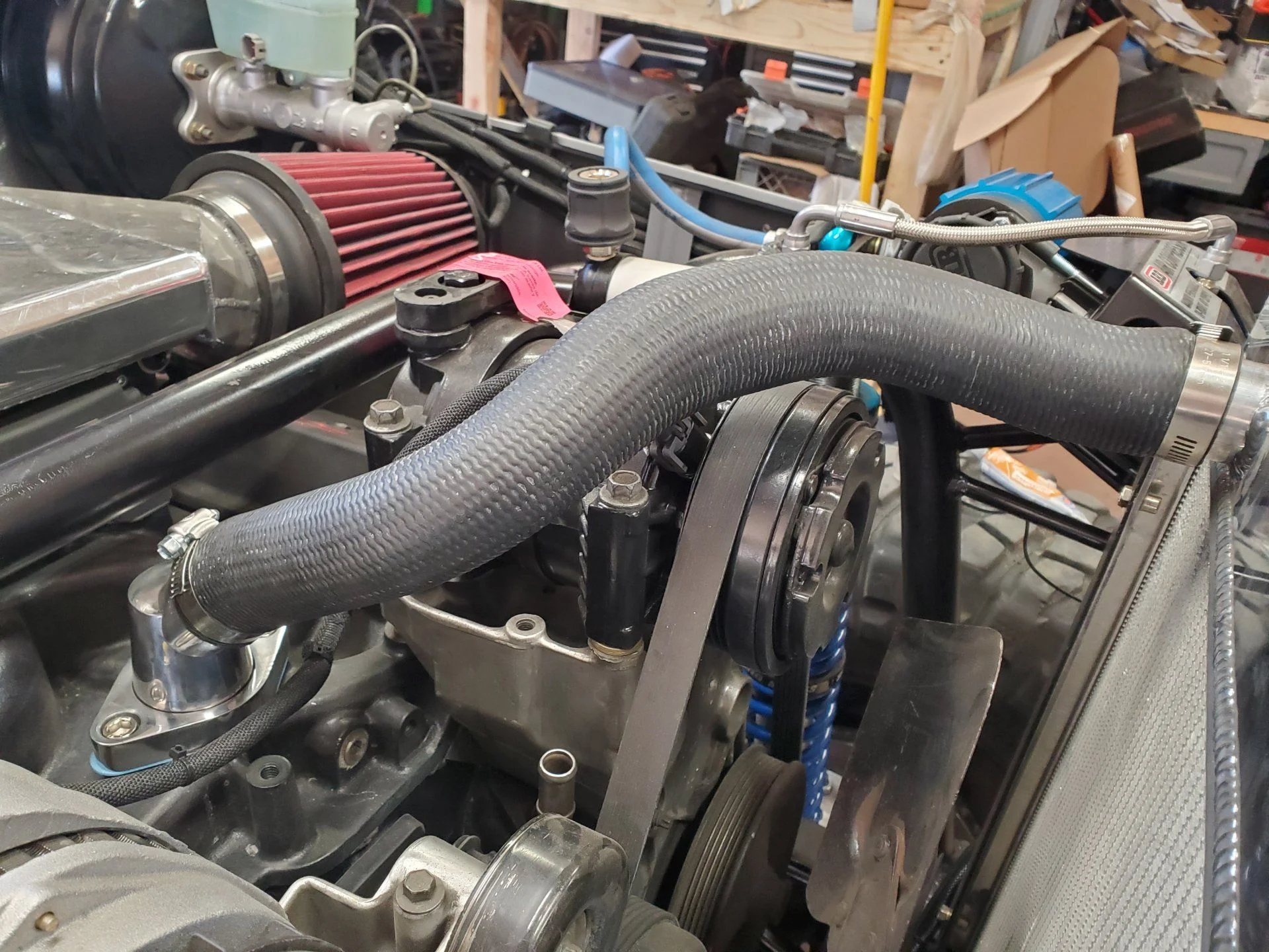

Upper radiator hose was a biatch to find. This is a lower radiator hose off a 2003 Bonneville. Part number 22329 @ O'Reilly's for my refernence.

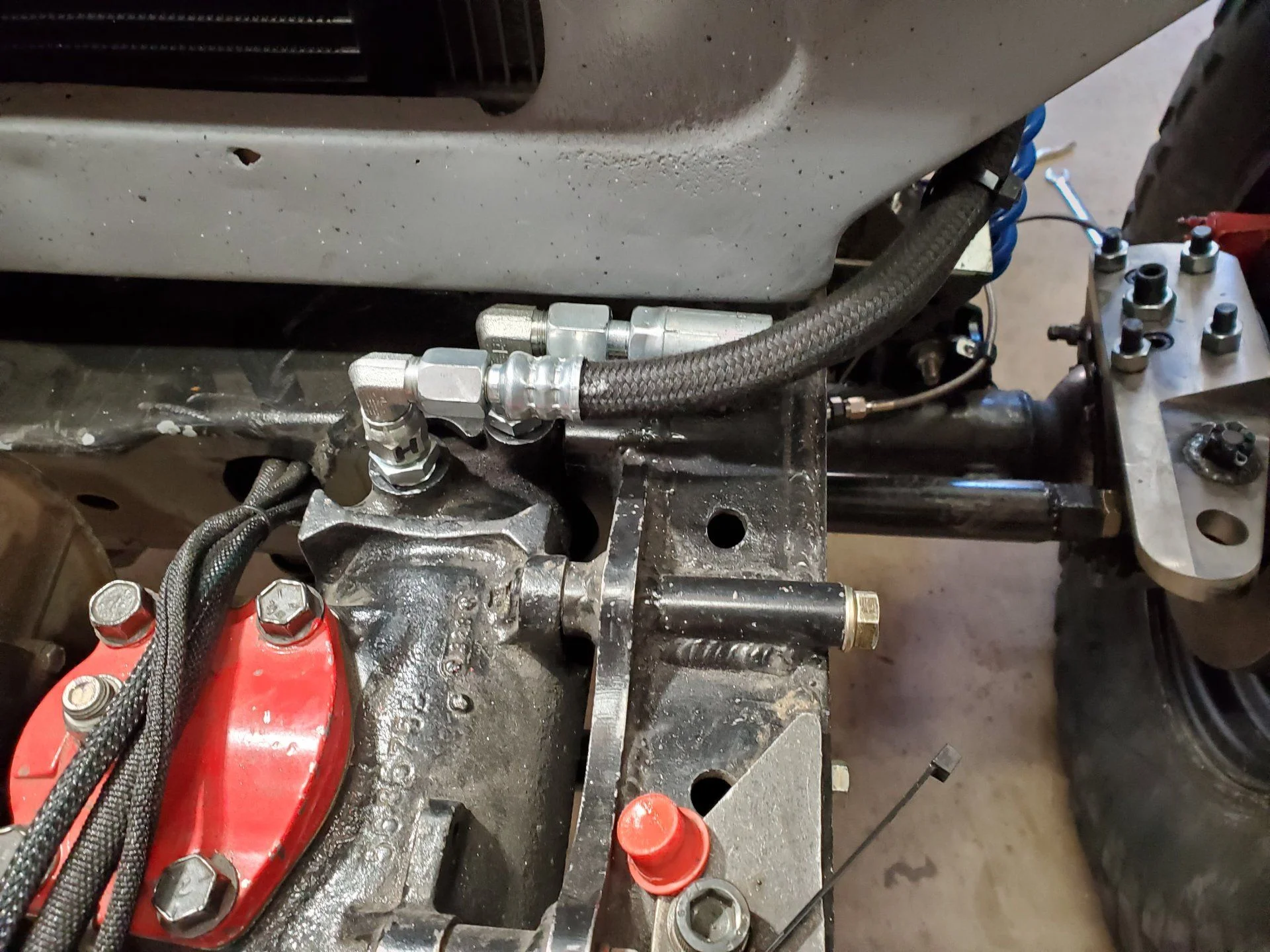

Power steering lines run. I like the heaver looking AN fittings and hydraulic hose, so that's what I had made.

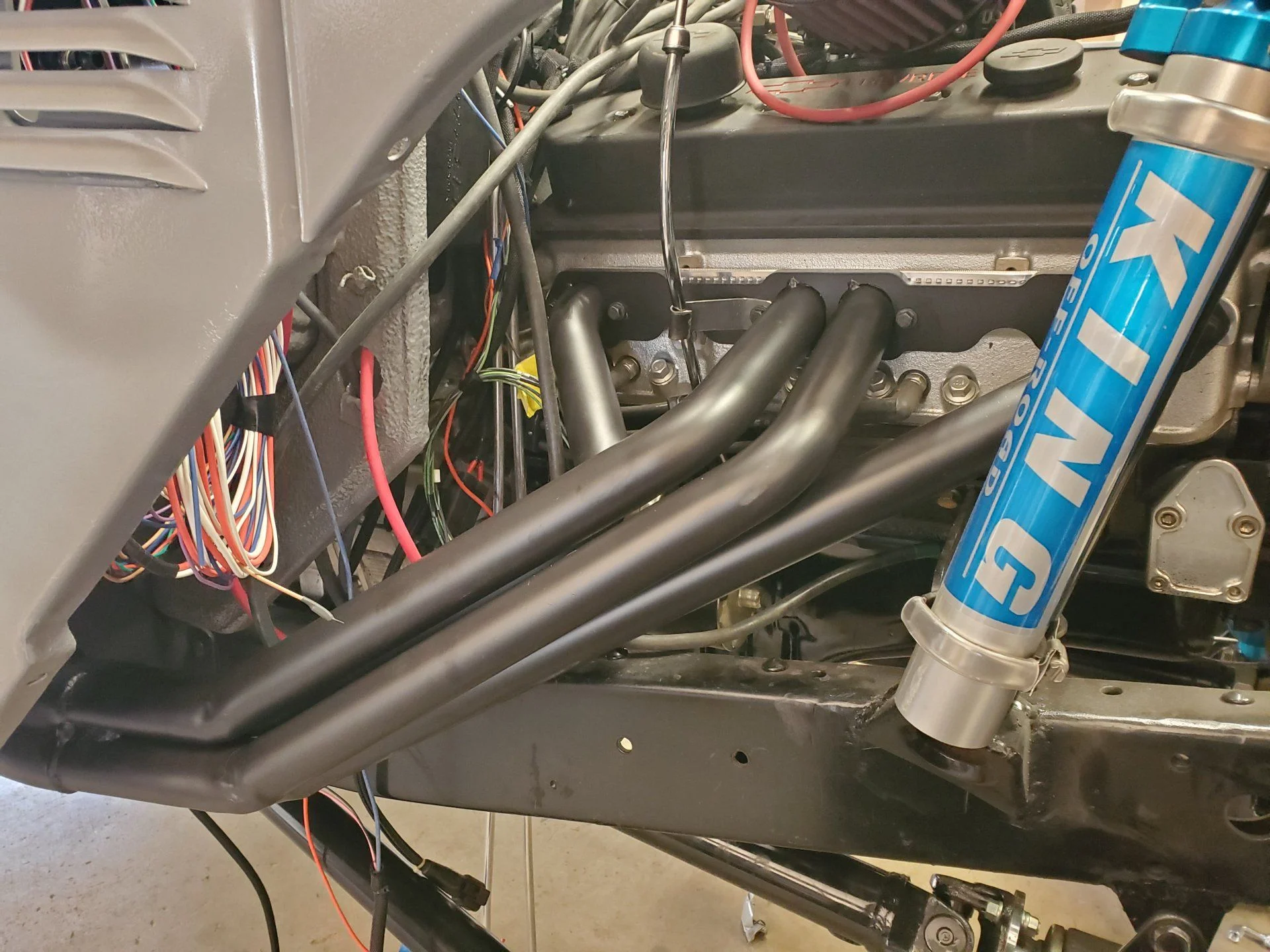

Headers back from coating, heat shields still need to be made.

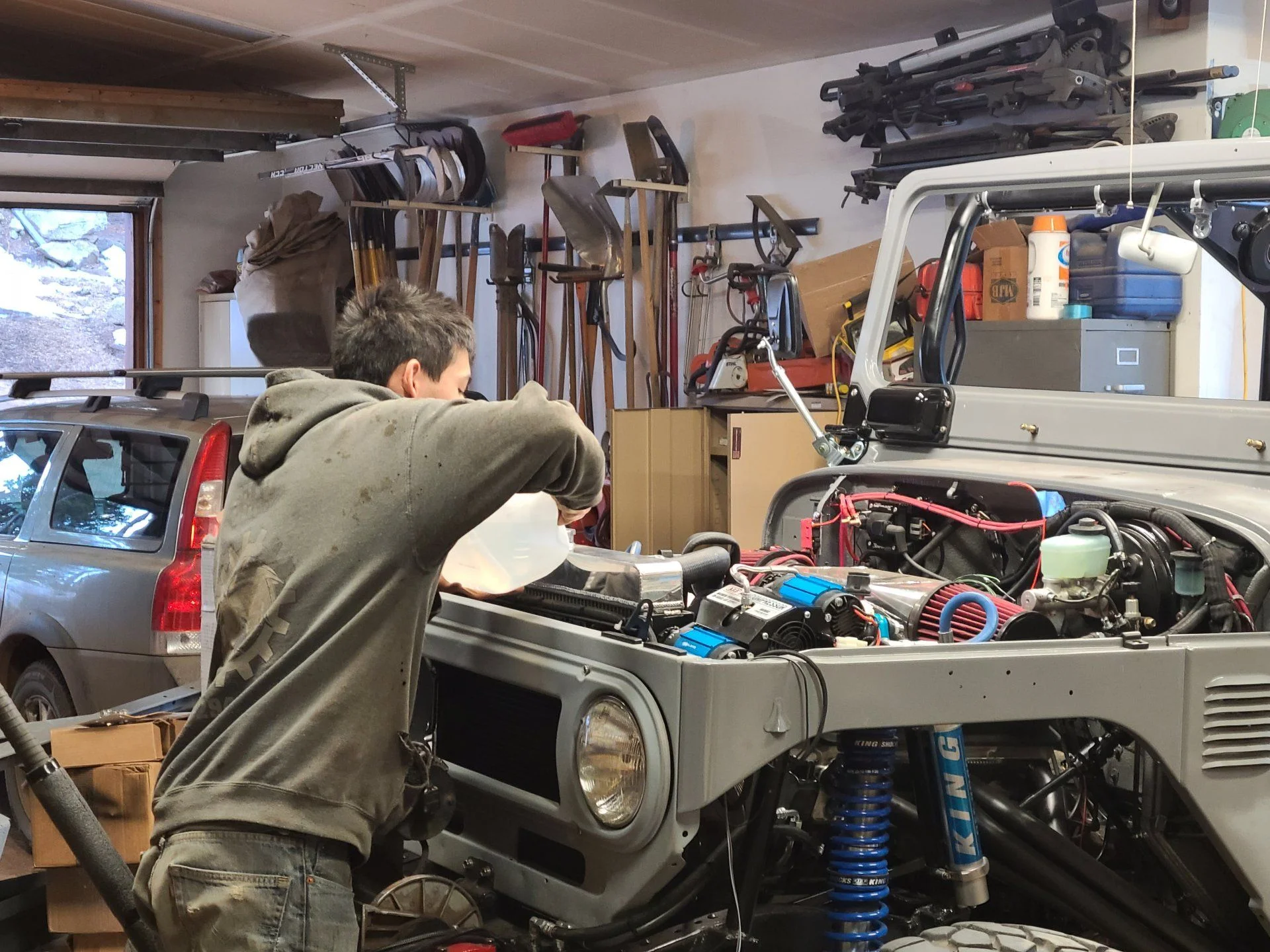

That's right, filling the radiator. 2 gallons of antifreeze and 2 gallons of distilled water later, and it's almost full.

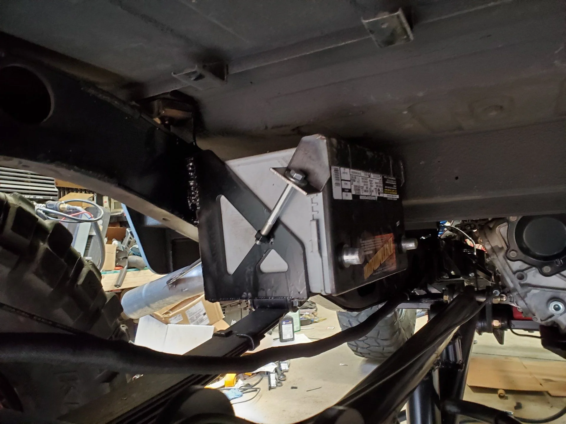

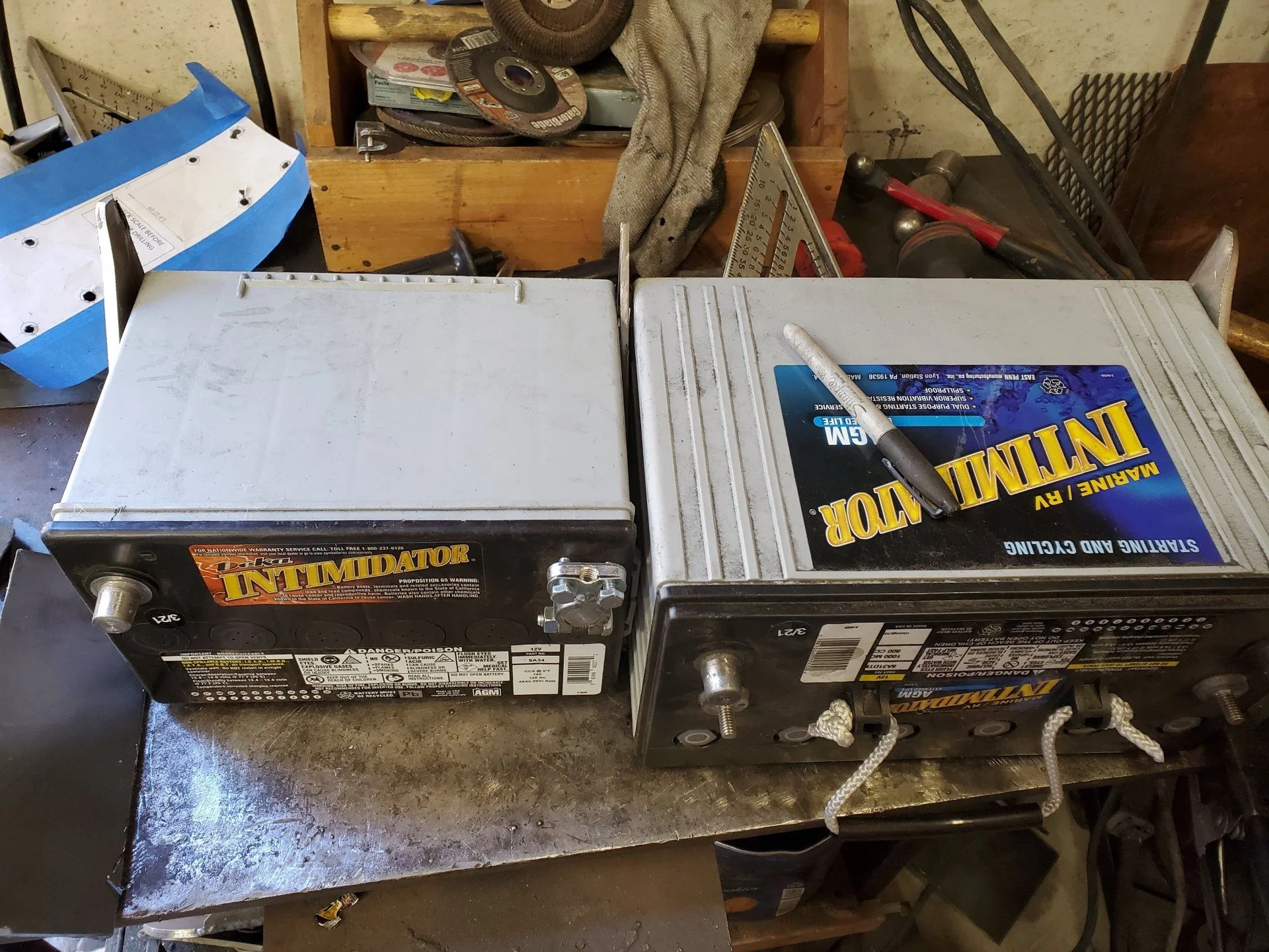

Dual batteries. One starting and a large deep cycle, both AGM.
I made some battery trays, and hung them up underneath.

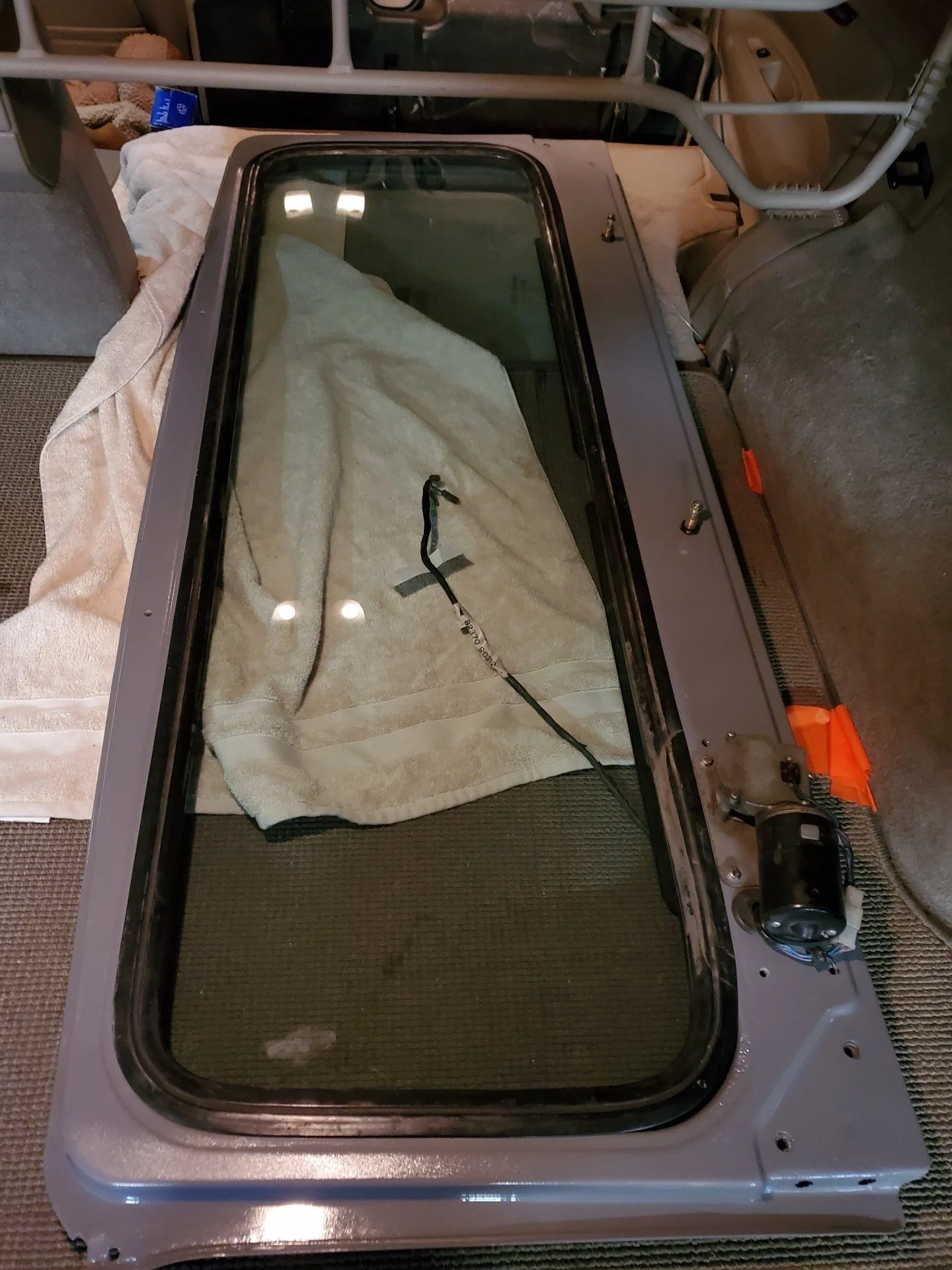

I got windshield glass cut and installed.
Slapped some rattle can on the front bumper.

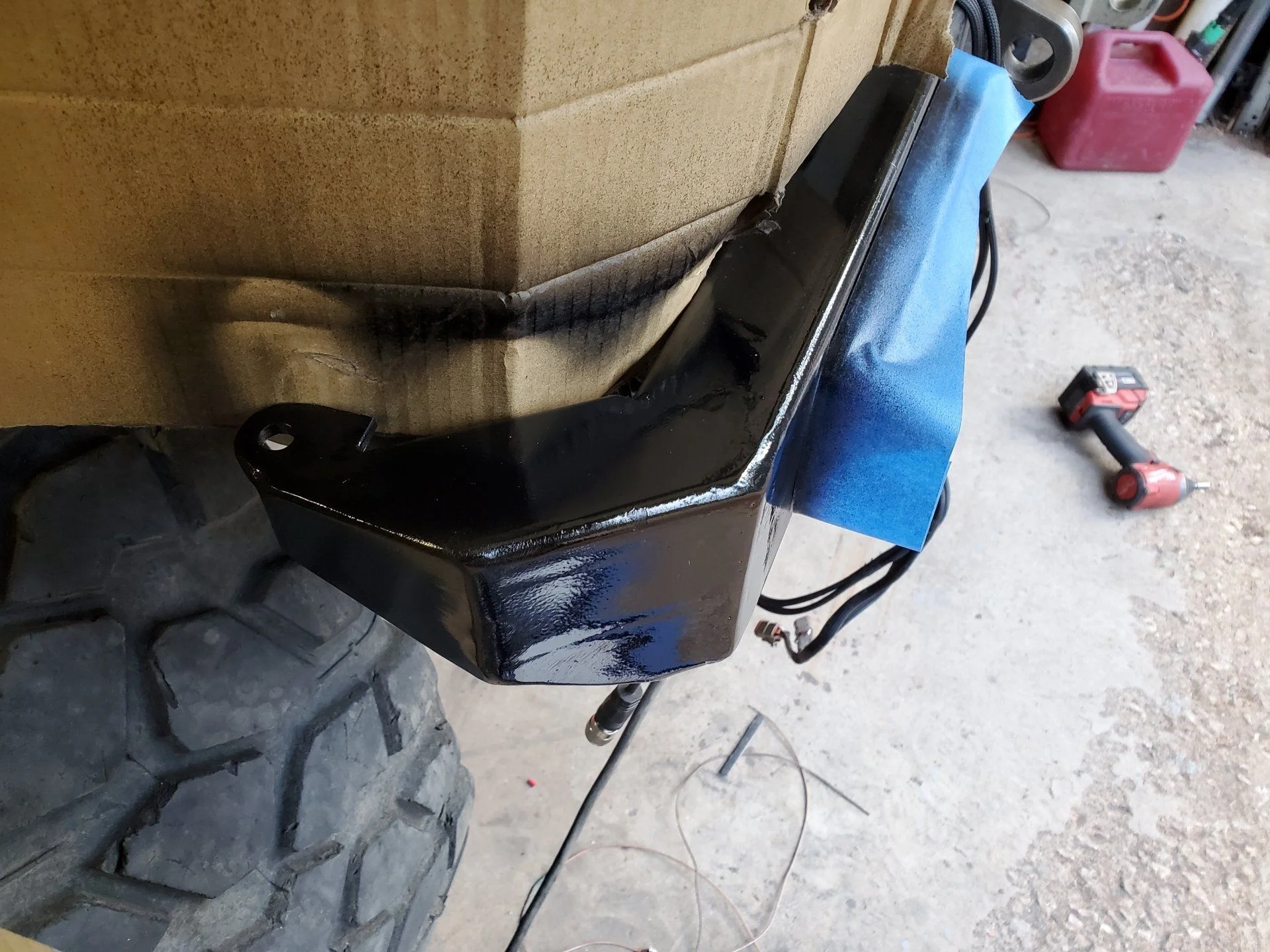

And finished up the sides for my rear bumper.

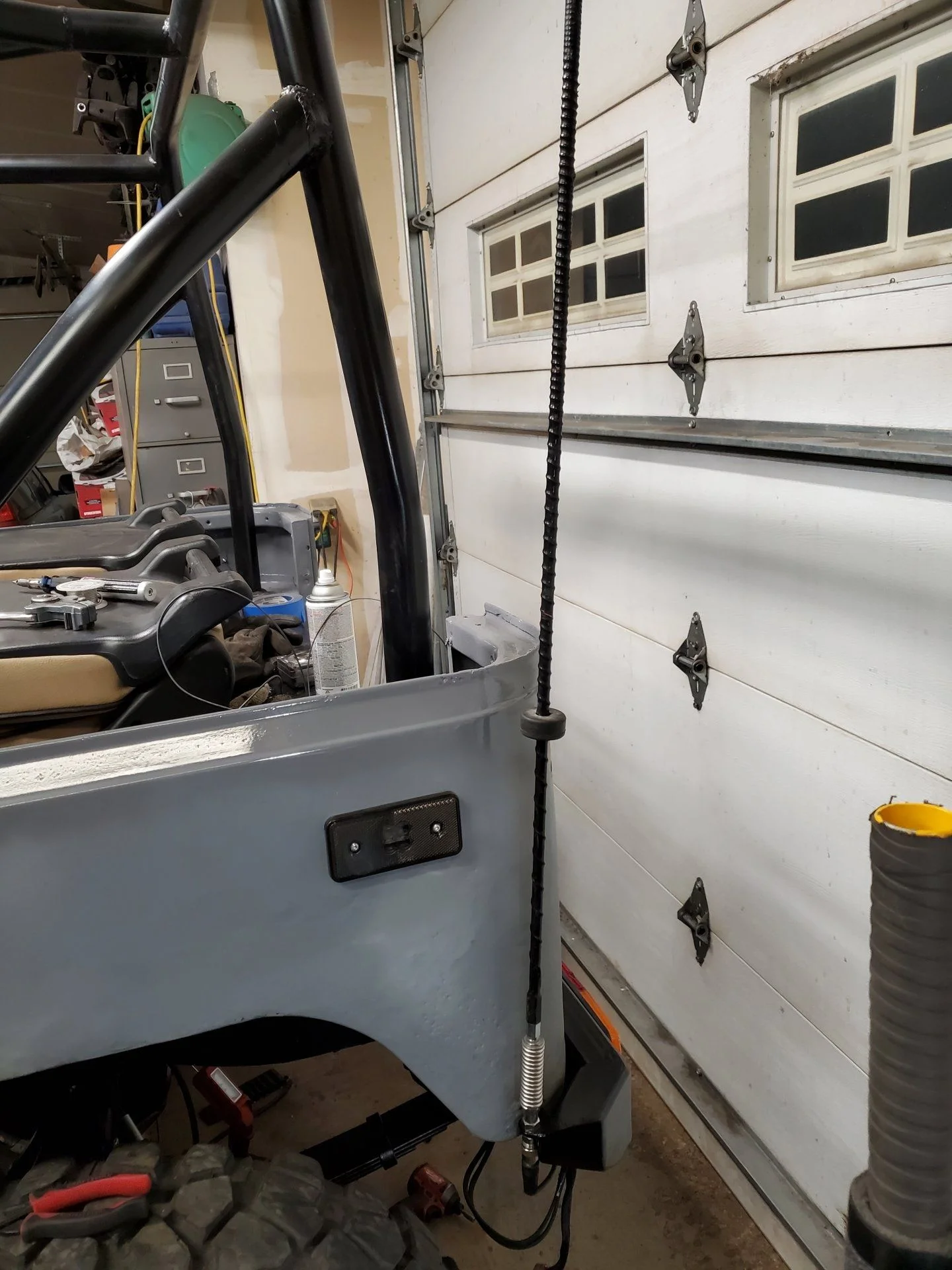

CB antenna installed.

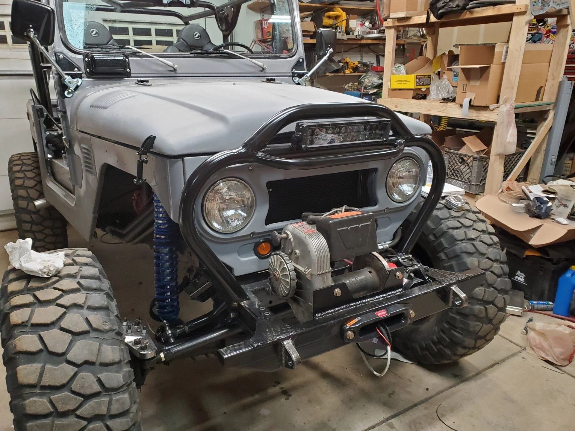

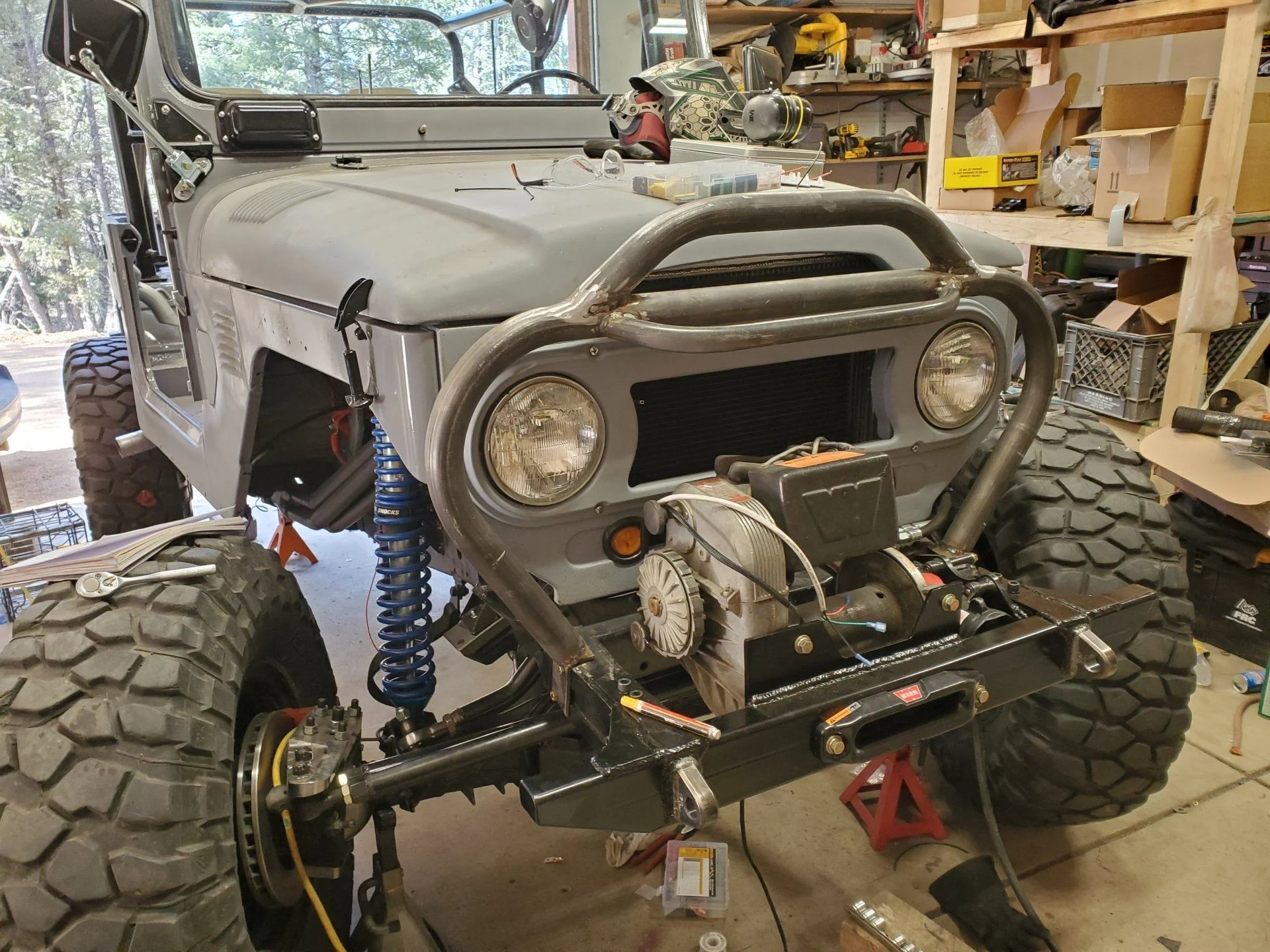

Front radiator ROPS and light bar mount.
Light bar and paint.
Starting fuel tank install.
Pump wired, lines completed, sender wired.
Seats back in.

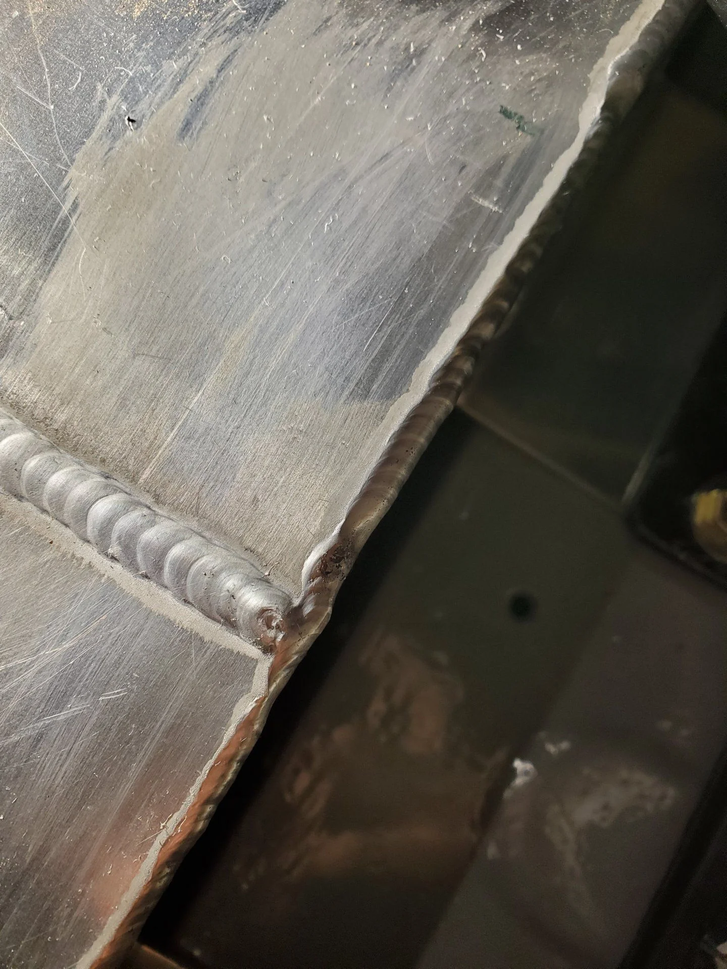

28 gallons later, and a few pinholes pop up. Not enough time to drain, clean and reweld, so I just slapped some sealer on them for now, to be fixed asap.

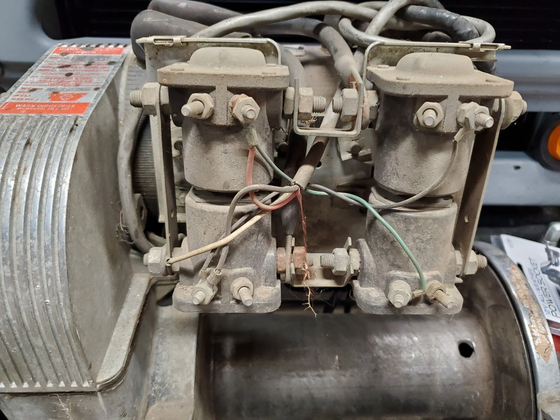

New power pulled to the winch, and all solenoids seem to be working, so I got my in-cab winch controls wired and working.

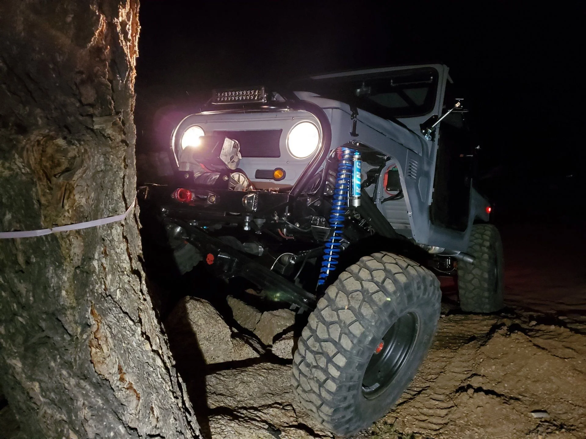

Finally, I got to drive it around. Everything is functioning very smoothly, but there are a few teething issues. Heater lines are not in the correct locations, and I believe that the water pump is only supplying water, no suction, so the heater is not blowing warm. Me, in all my smooth brain glory, wired up my speedo wrong, so no speedo on the first test drive. That is now fixed.
Here is the cruiser walking itself.
The 383 and sniper combo is absolutley amazing. It is super diesel-like, and practically impossible to kill.
There is no bump steer out of the front links, and limited body roll, so I am pretty happy.

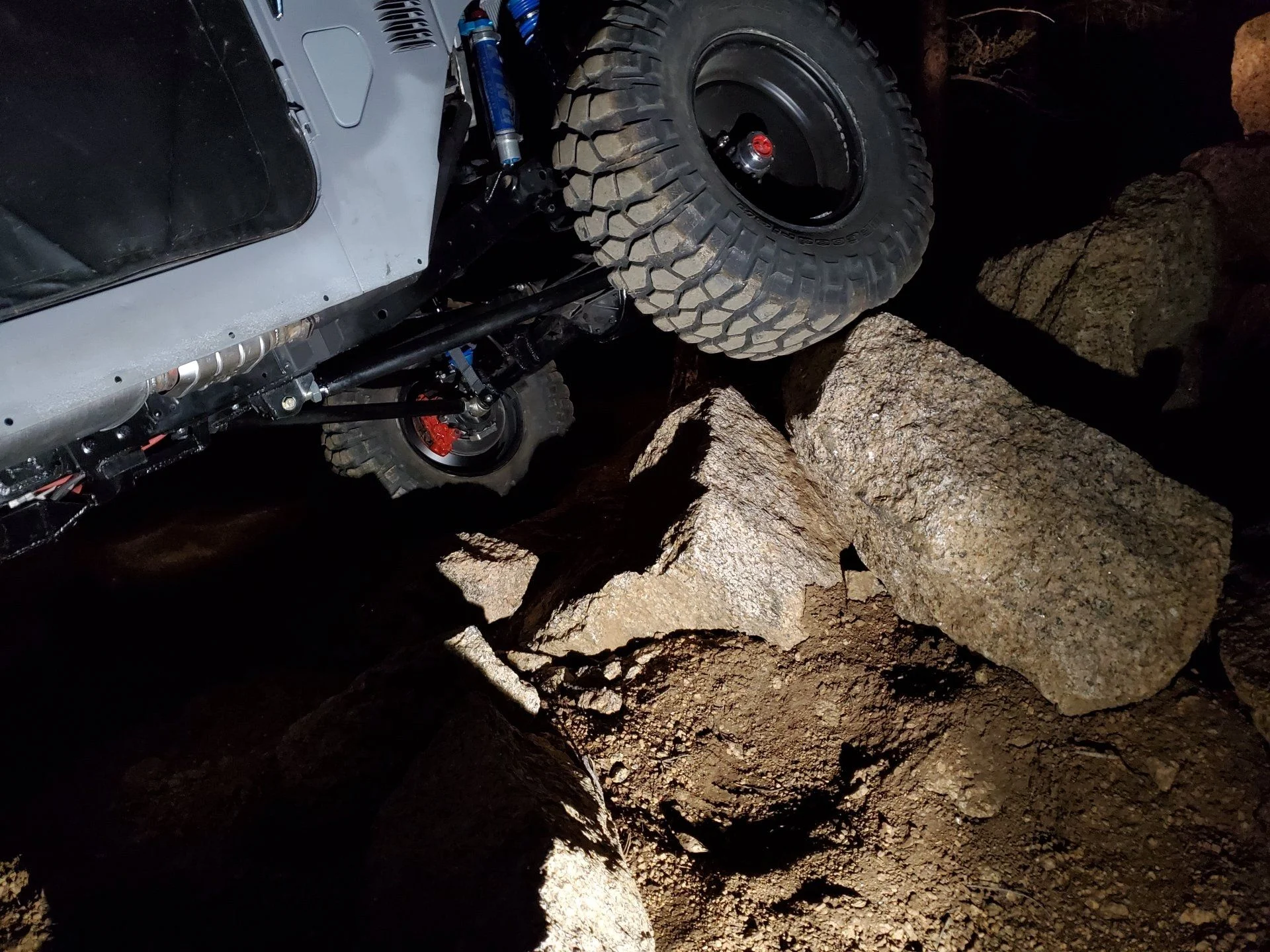

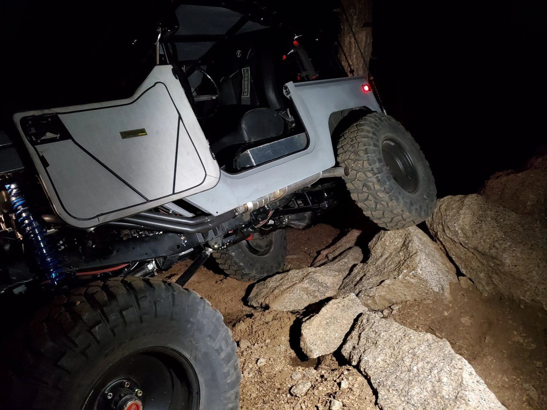

I got to flexing out the suspension for some s***s and giggles last night before installing shocks.
It flexes really nicely.
