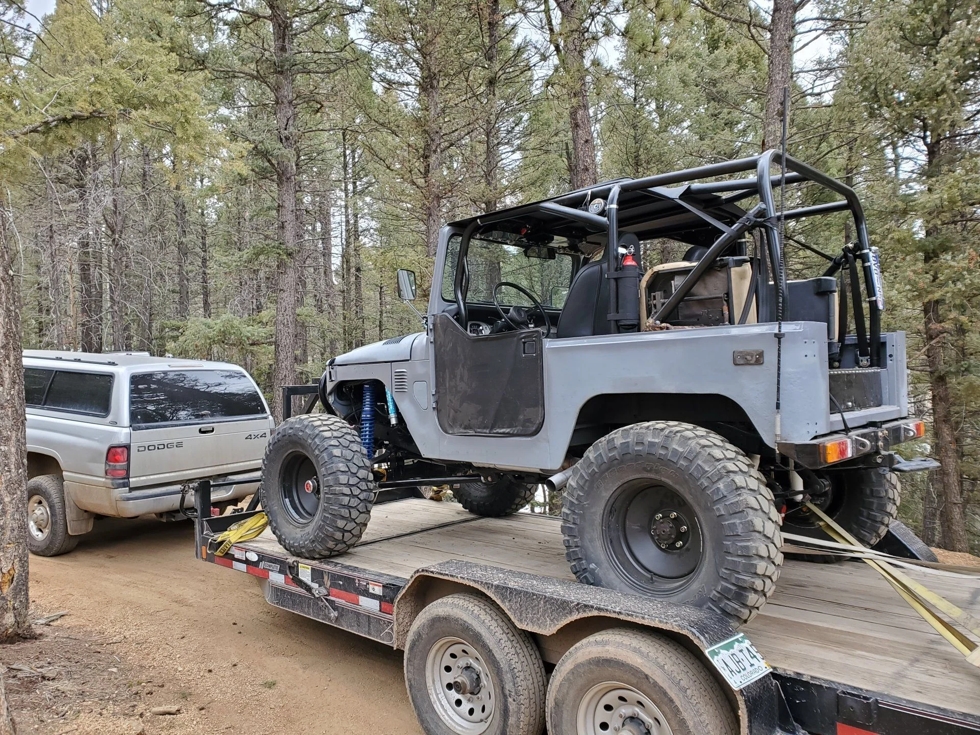

So, as a little backstory, I was throwing rear shocks on this thing at 2 AM Monday night, and we left on Tuesday. The problem is, I have very limited space for rear shocks, and needed about 10" of travel for them. 4 Wheel Parts had some that looked like they would work, so I was able to get them late Monday. The good news is that everything cycles really well, despite not having rear bumps. I got some el-cheapo rear pro comp shocks that are really really stiff, so ride quality suffered. Still, the rear SOA rode really nicely, but the shocks need less rebound and compression. I'm looking at some custom-tuned Bilstein 7100 Short Bodies in the near future.

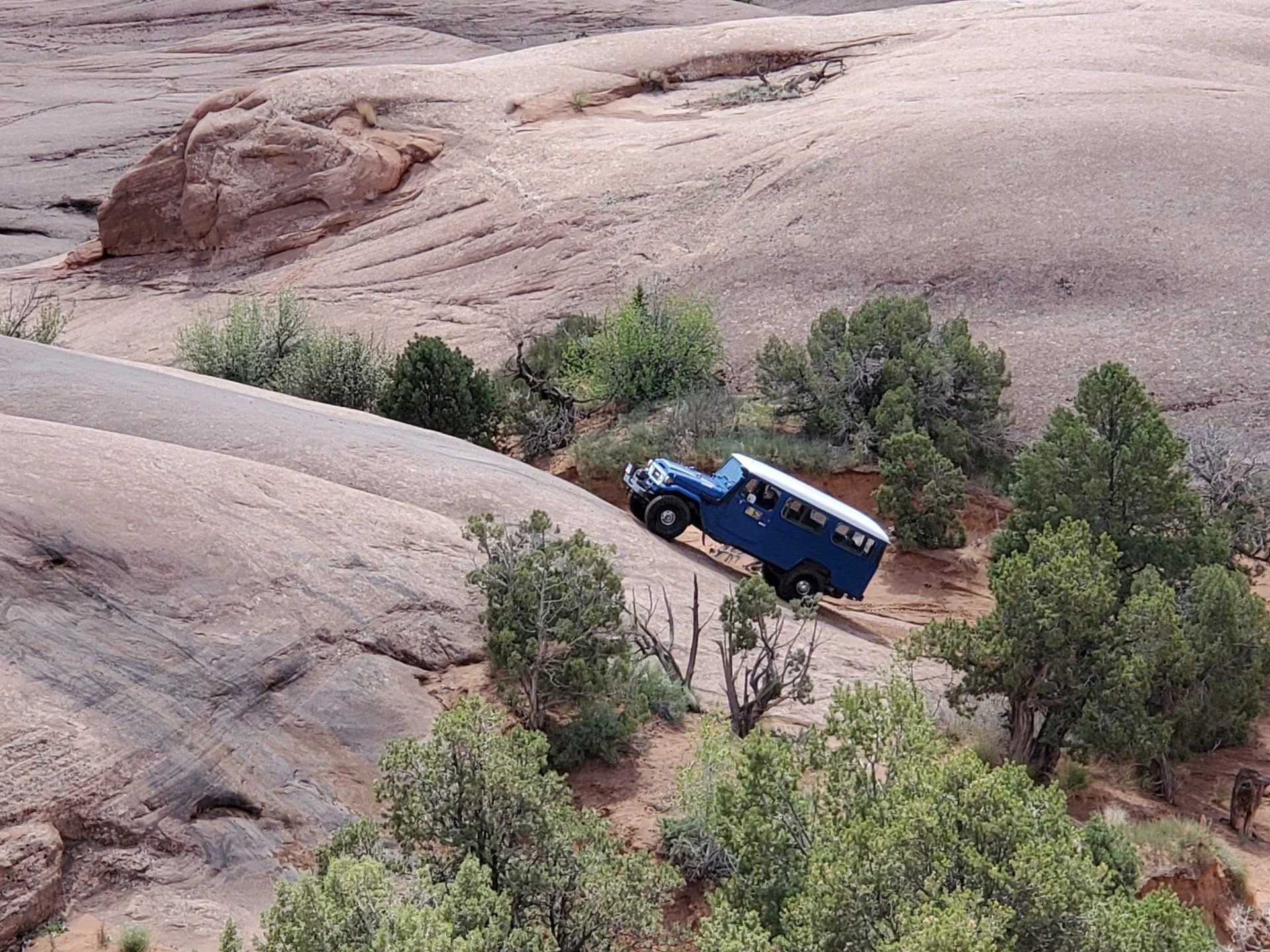

Wednesday morning, I checked in to Cruise Moab, got unloaded, and headed out with some friends to prerun Flat Iron Mesa since they were Leading / Gunning it the next day.

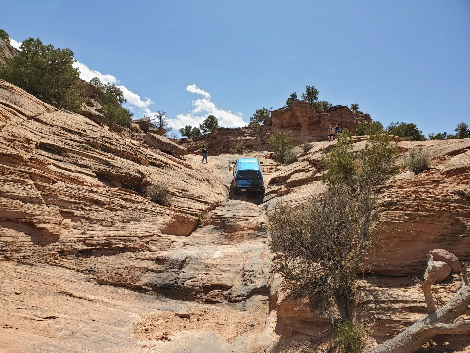

"The Chute"
The Cruiser walked it with no lockers very easily. I was still running about 20 PSI in the tires as well.
@Domofthedead in his Taco up The Chute.
We ran the first part of the trail and decided to bail out to have some time to chill in camp before the Hell's Revenge Night Run.

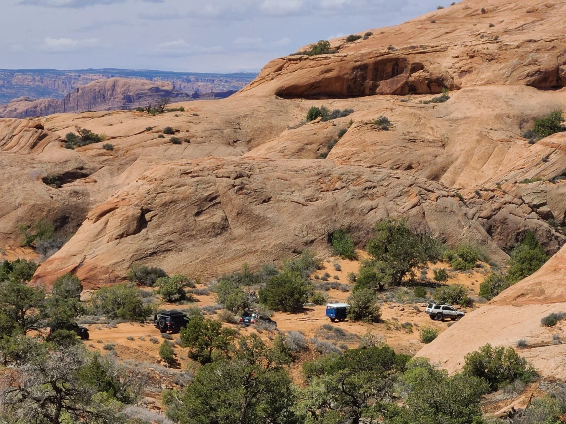

I got my rock lights wired up then, and I'm really glad I did. The Night Run was a blast. We had a pretty experienced group running it, as there was very little traffic since it was getting dark.
Somewhere near the beginning.
Green River Overlook from Hells.

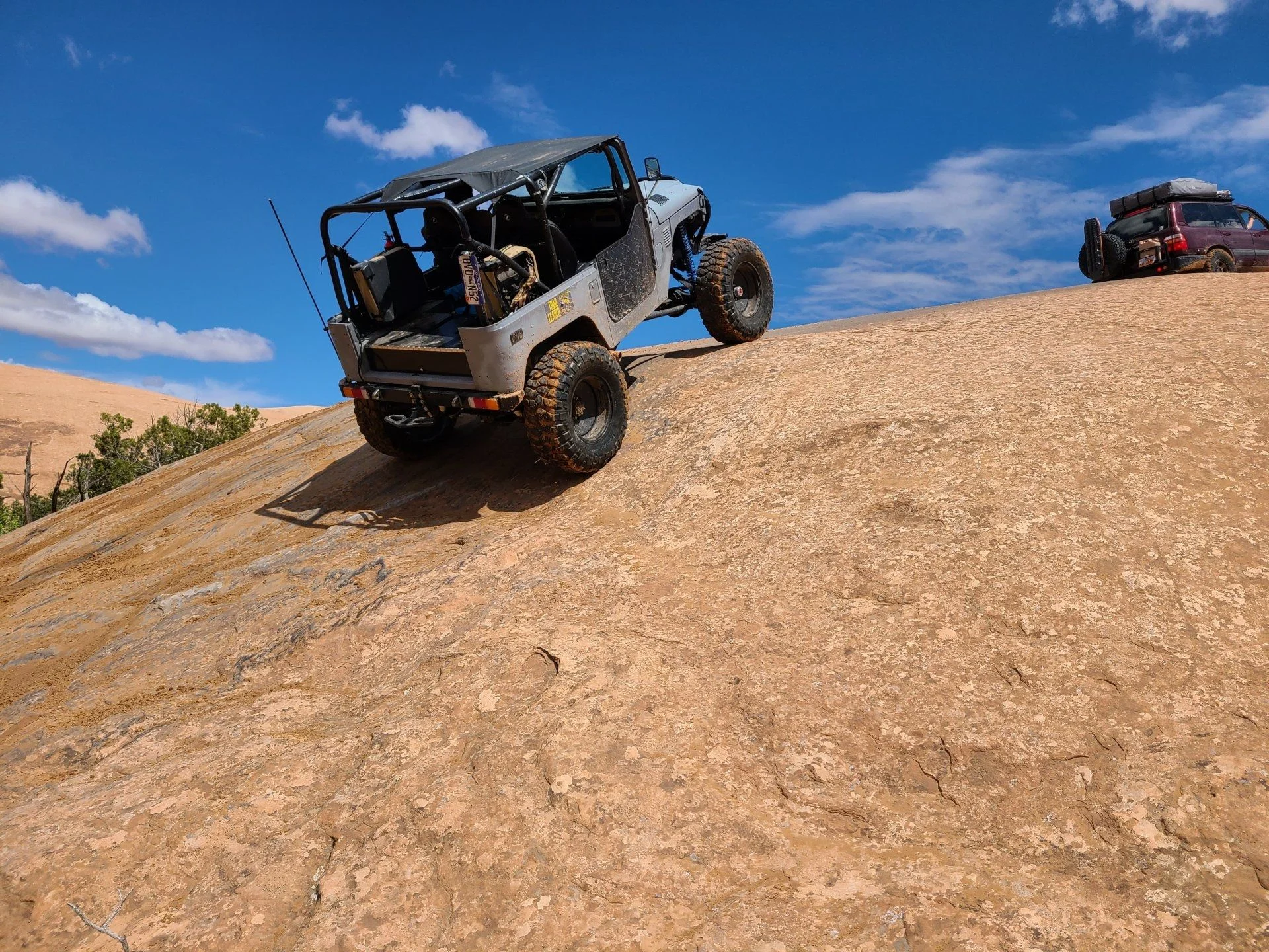

Jackson Philby getting tippy on Hell's Gate.
Me, screwing around on Hell's Gate.

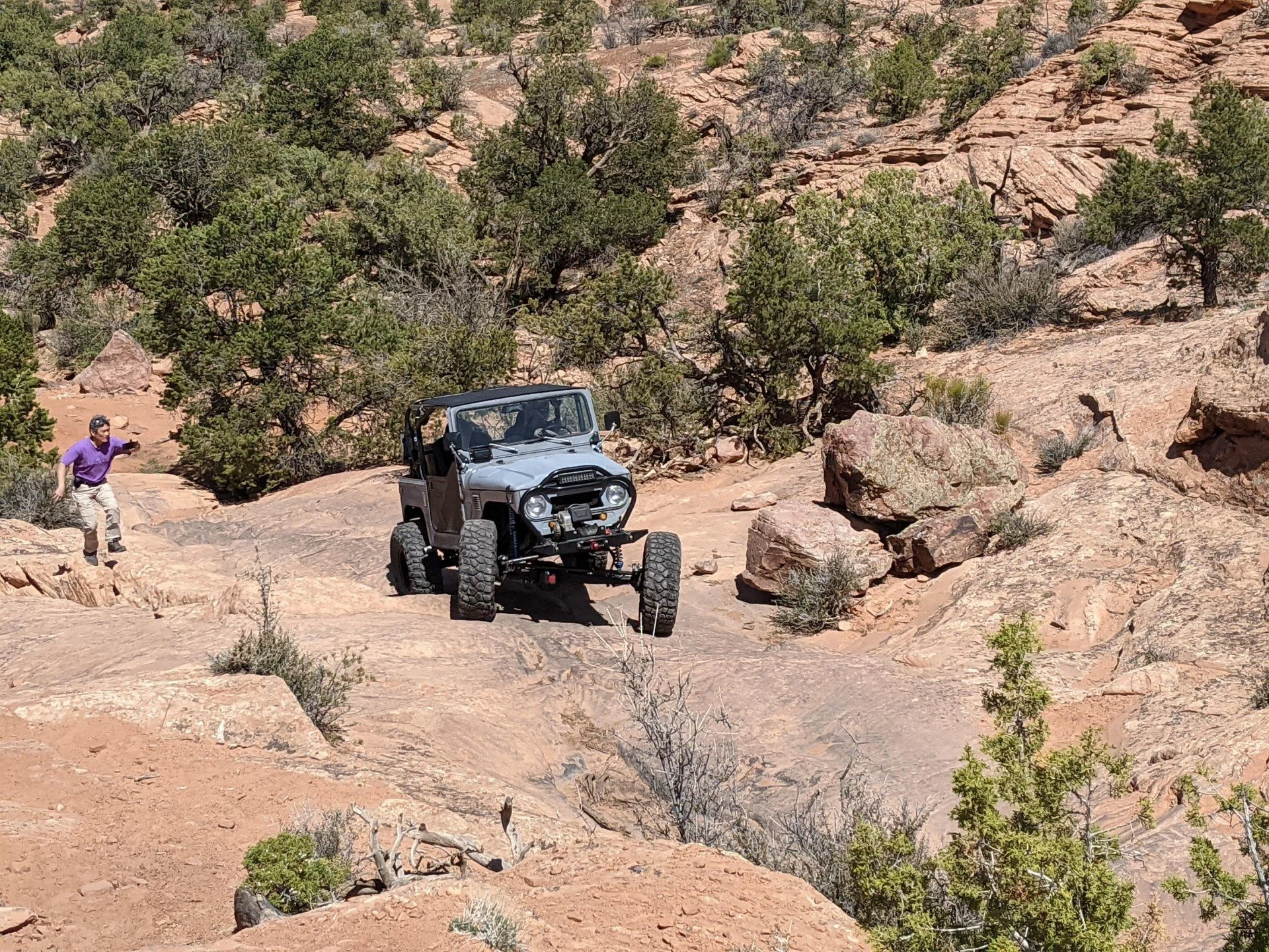

Saturday, I gunned Kane Creek. It was a ton of fun, and Hamburger Hill was a good challenge for most of the rigs.
The entry obstacle.
The Squeeze
Playing in Kane Creek.

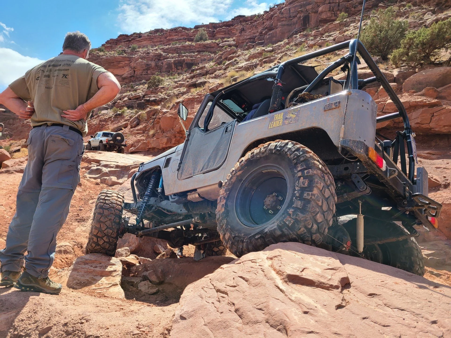

A few pictures from Hamburger Hill. I probably could have made the ledge, but I only tried once to save some time getting the rest of the group up as well. I almost made it, though.
