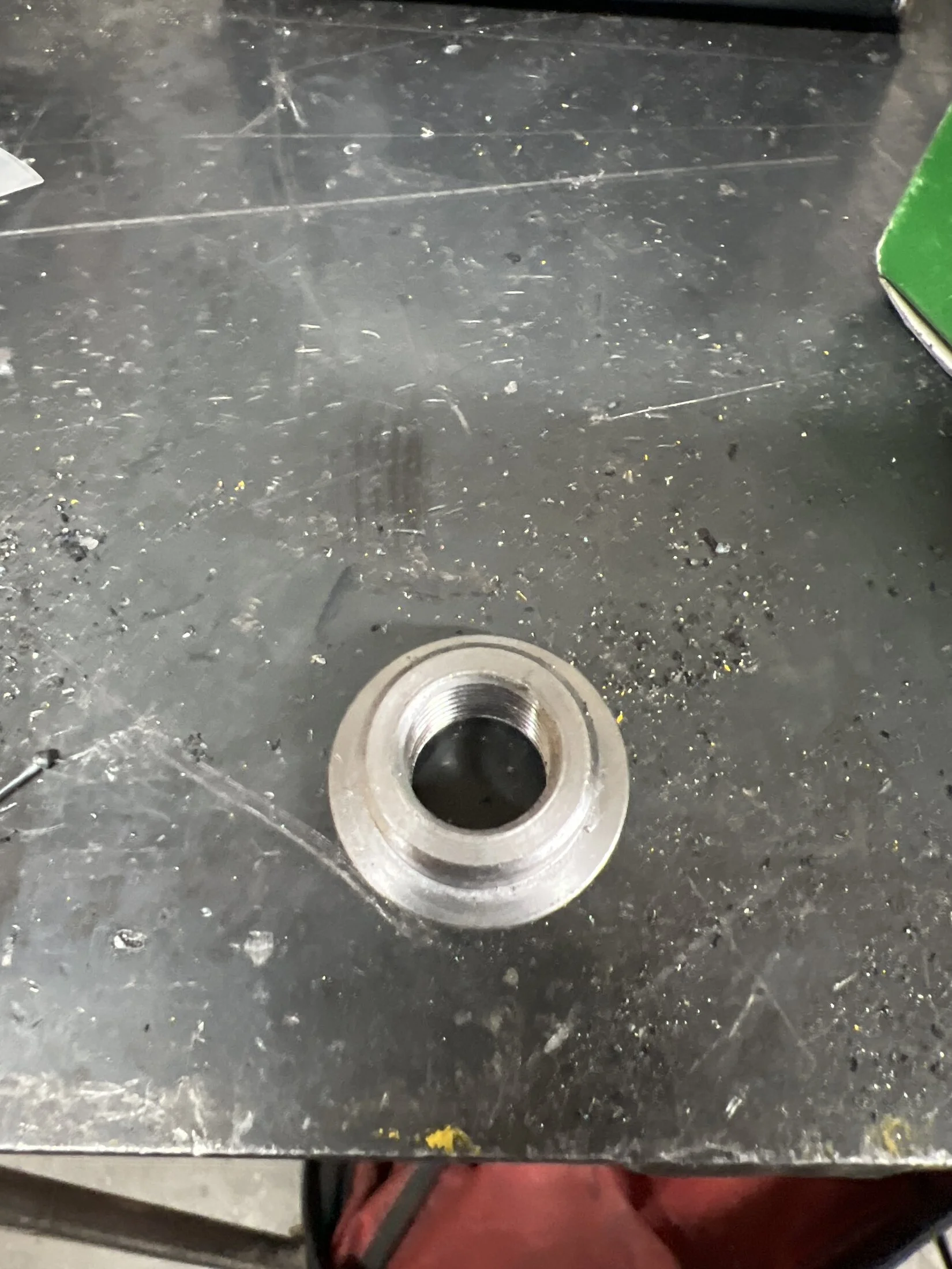

I need some help locating better 1/2-20 grade 8 weld nuts. The ones from Ruffstuff are way too soft and I stripped two more threads. What are you all using?

Did you try fastenal? Or even Ace hardware? Maybe grade 10 instead of grade 8? You could get regular ones and grind them down to weld in?

Fastenal didn’t have this thread pitch. I initially found some at McMaster, but I went with Ruffstuff as I needed some other pieces.
Here are the other ones that I found. I’d rather go with something that others know are good quality.

I use McMaster Carr a lot and find them to have quality stuff and they ship super fast !!

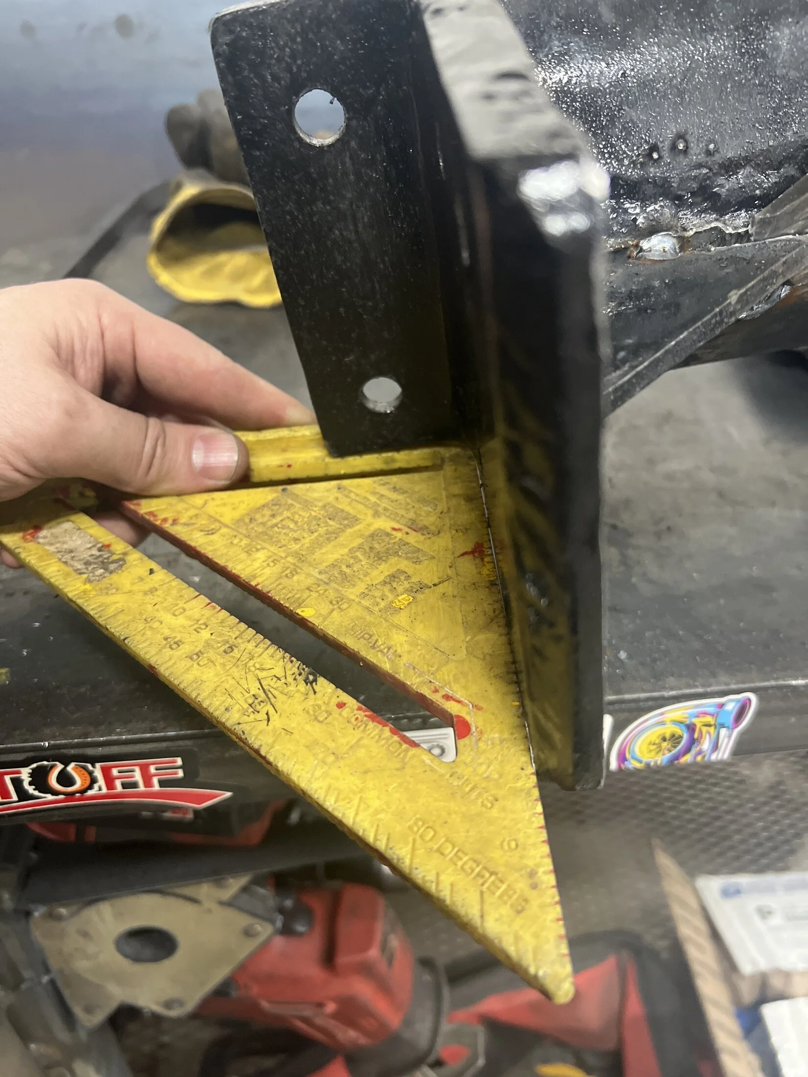

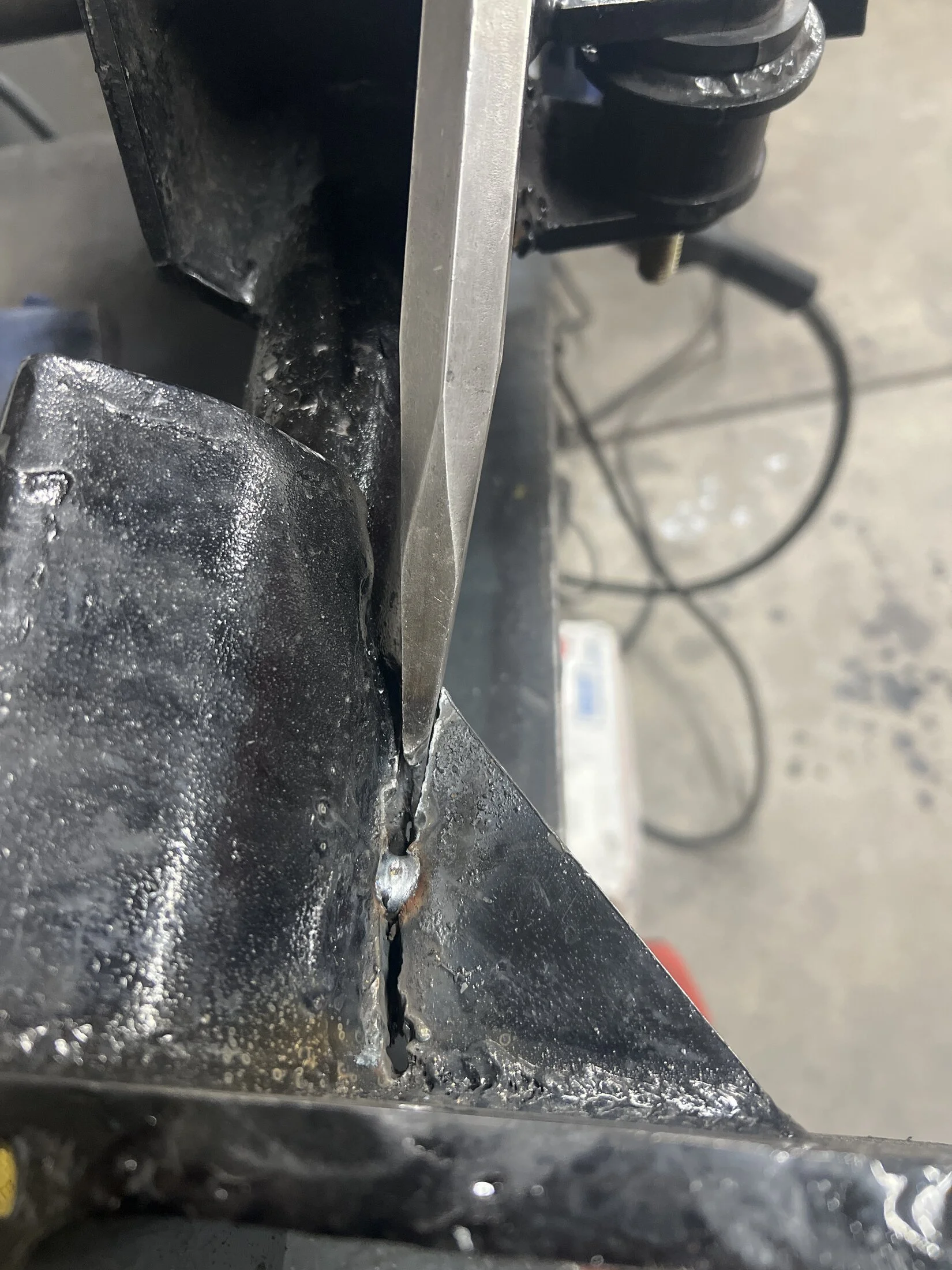

Update on the crossmember challenge. I took some time last night to investigate why I was stripping threads and I noticed that my frame has pulled apart a bit when my crossmember was removed. I braced the frame initially before I removed the crossmember to insure that the frame and suspension mounts stayed in place while I removed the welded tubes and replaced them with flanges. With the crossmember in place but unbolted, there is about 1/8” of a gap on either side between the brace and the frame. The force needed to pull the frame back together is clearly exceeding the capacity of the weld nuts.
Unless others have better ideas, I plan to sleeve and plate the frame from the outside so that I can fasten a bolt all the way through the frame and the crossmember bracket. This should be a simple and solid fix.

1) The nuts or bolt may still strip
2) drilling more holes in the frame could potentially weaken it
3) The frame & crossmember will be under constant pressure/ tension.
I would think adding a 1/8" plate to each side of the frame would be a better solution, adding strength to the frame and mounting point.

If I'm understanding the situation correctly, the part that is "too short" is the rear lower link mount?
I don't think you want that tension on that part, in that direction. That part is built to definitely take some tension and forces, whatever the links dish out, and if you are trying to pull that part away from the frame with constant tension, you are severely risking some very bad stuff happening if some threads strip.
It needs to be a tight mount. It's amazing what a few half inch bolts can hold, until you ask them to not shear where there is a gap. They bend pretty easily.
If this is what I think it is, I think you might consider lengthening the part and/or allow the part to flex with the frame and/or solidify your frame.

I am upgrading to (8) 5/8 bolts and I will weld sleeves through the frame, then add a 3/16 plate over the outside.

Definitely best to put it back in, tighten it down, then weld in place. Will have way less deflection.
I can’t weld the crossmember back in because I won’t be able to get the transfer case out without removing the crossmember, removing the engine, or removing the body. I also can’t reach the front side of the crossmember to get a proper weld as the transfer case is in the way. Believe me, I really considered welding it back in but that would make for a very interesting fix on the trail if I ever needed to remove the transfer case.
I have considered welding in a secondary cross member further back, but it would need to go above all of the links and I’m just not sure that there is room for that. Either way, I will need to get the four link cross member back up in place before I can assess what needs to be done after, if anything. I’m pretty confident that eight 5/8 bolts will hold this thing together. I’ll go up to 1 inch if I need to.

I think he meant welding it while it’s in place.
Not welding it into place
