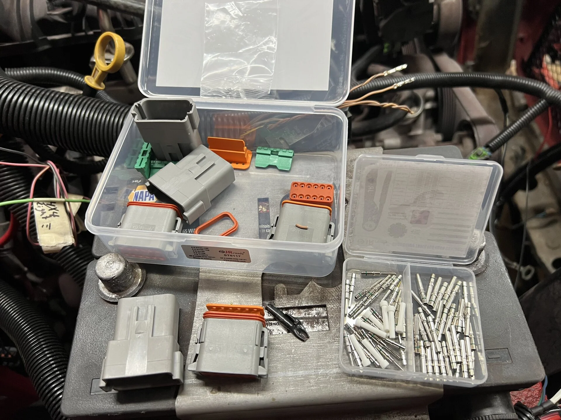

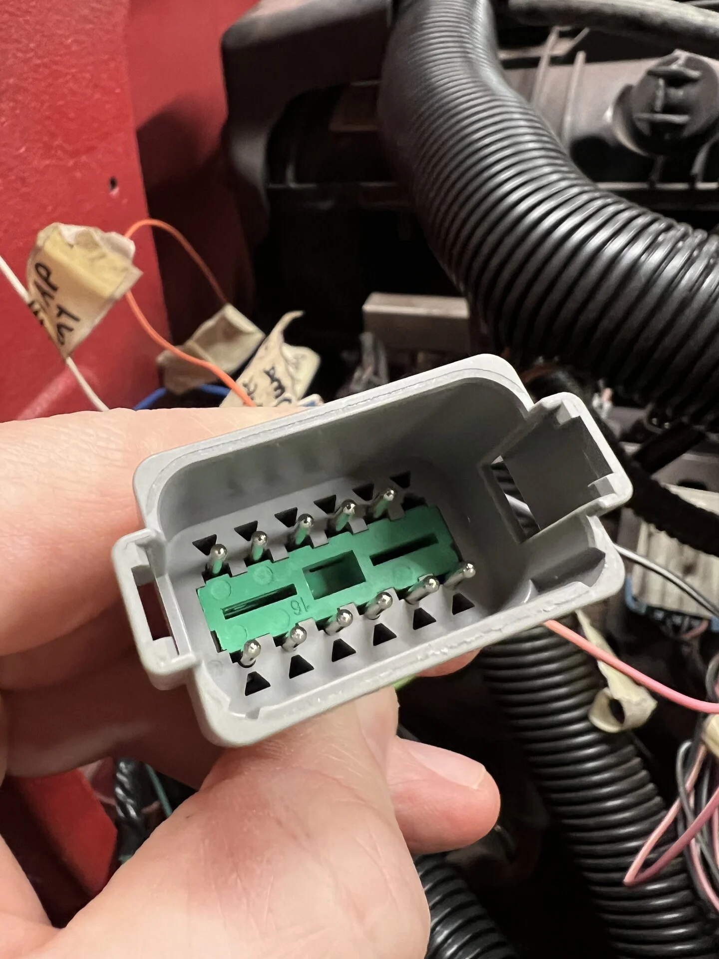

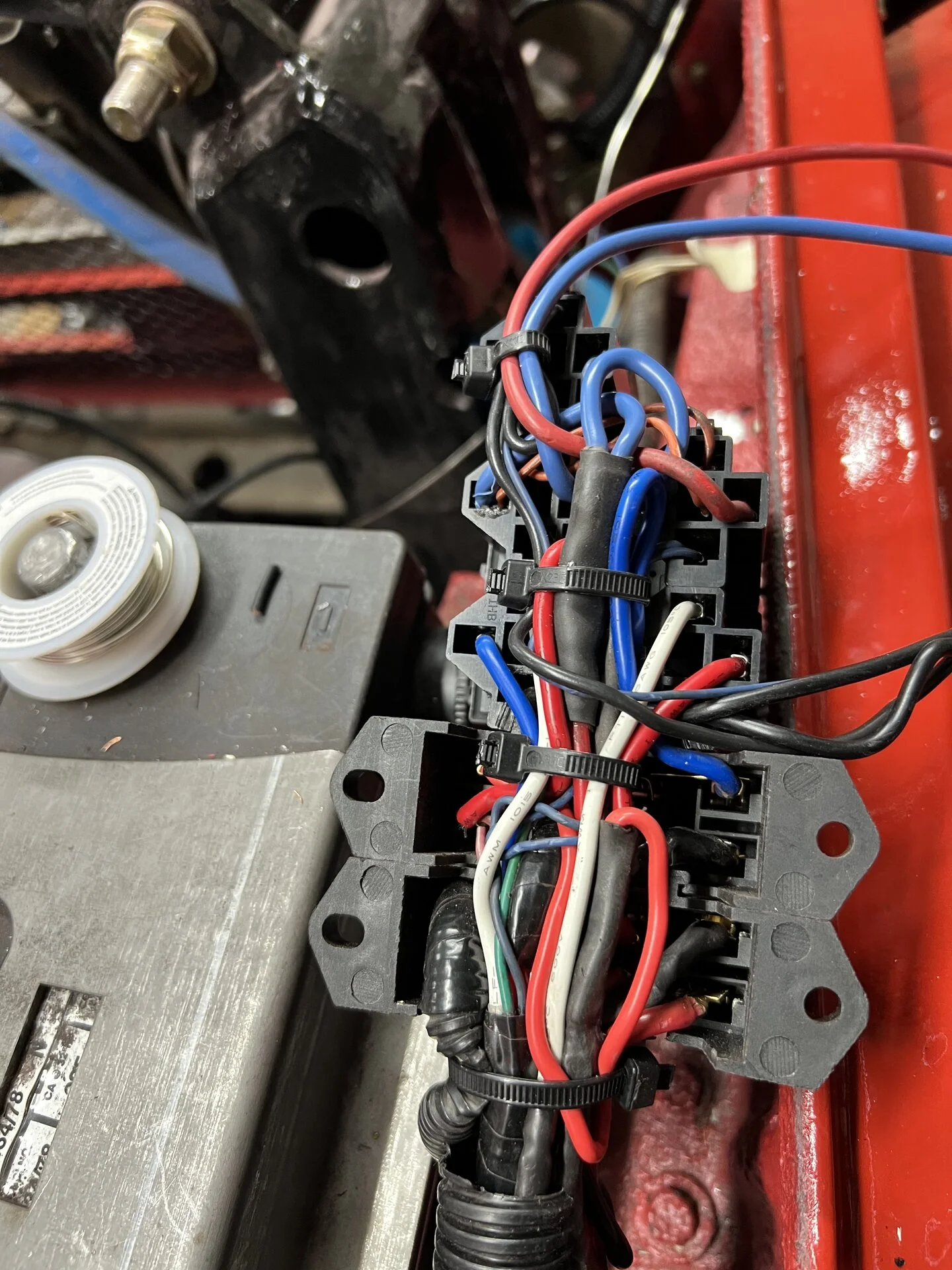

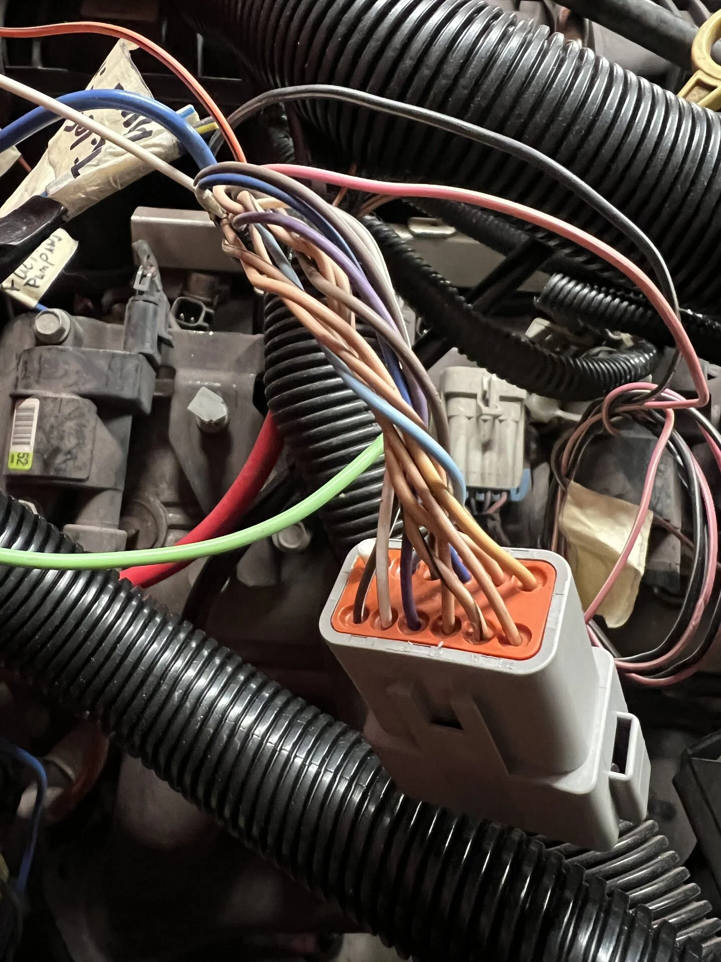

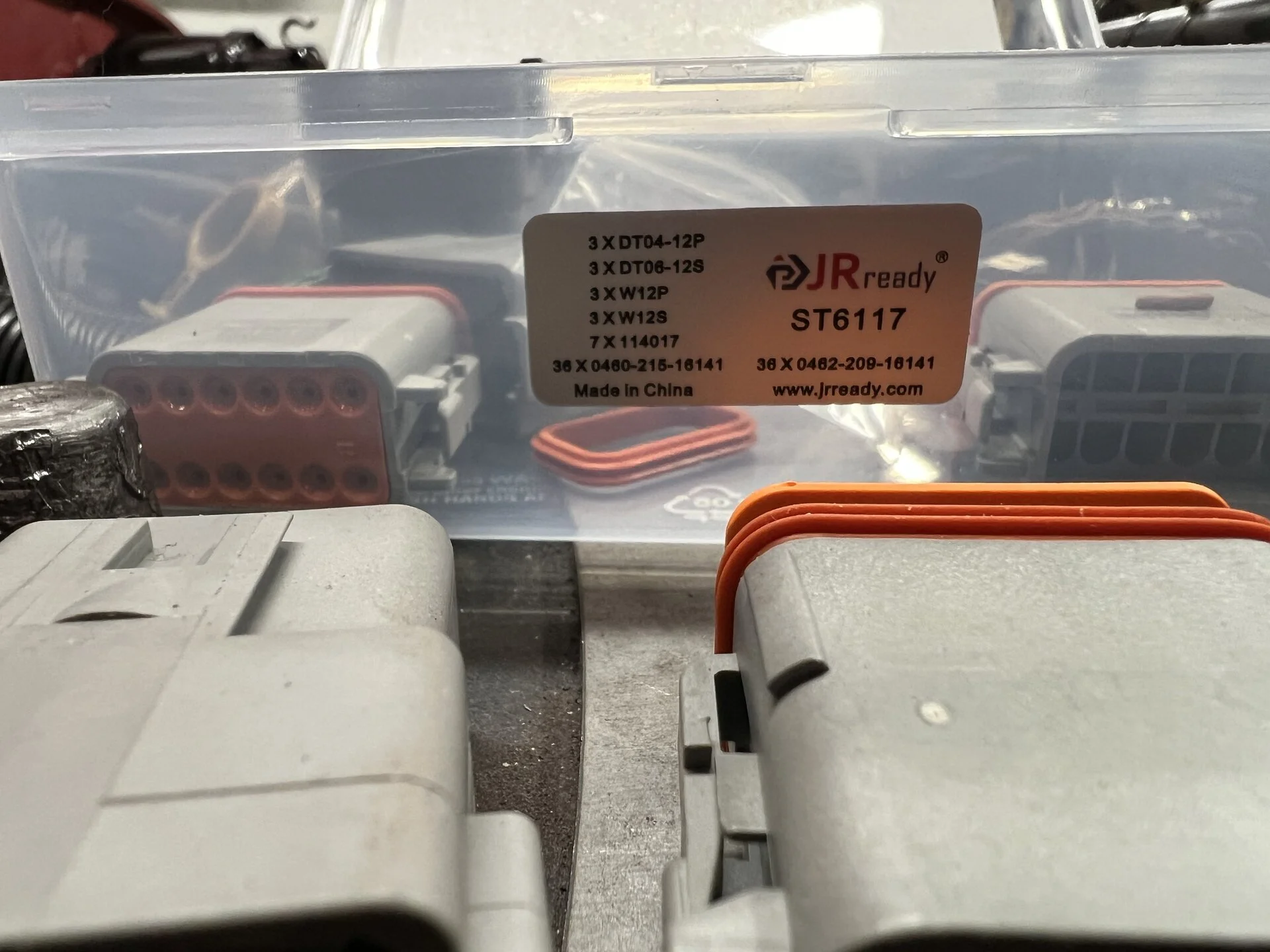

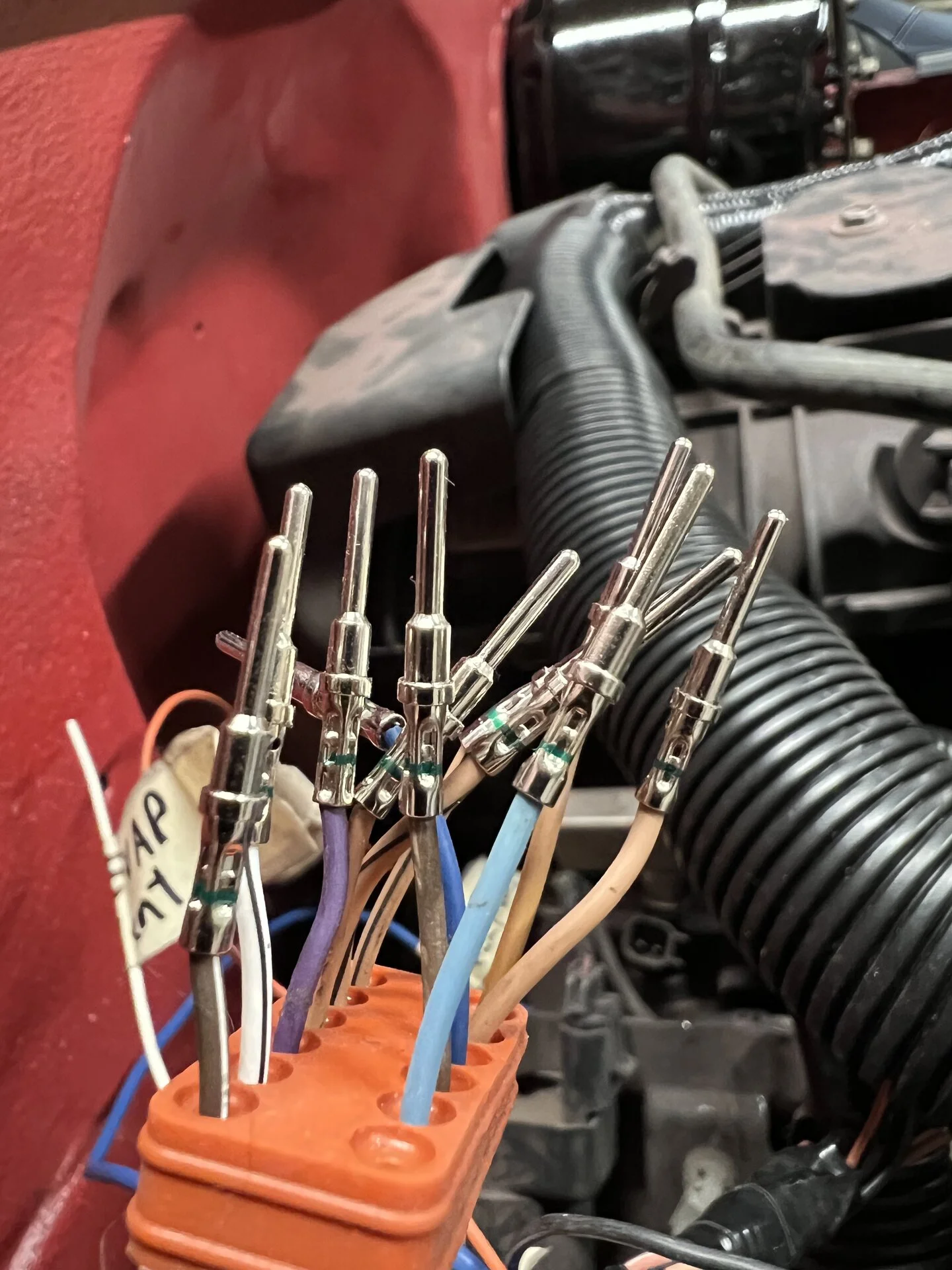

The fuse box and engine harness are about 95% complete. That’s all for this weekend. The highlight of the weekend was watching the check engine light come to life. Sorry, I didn’t get a picture of that before I unplugged the battery. I did snap a few pictures of these JD Ready plugs. They are excellent quality and i highly recommend.
Engine Fuse Block
Here are links to the items used above if anyone wants to use the same setup. The fuse block is okay, though it is definitely less quality than a Painless block. It was a fraction of the cost so I’m willing to give it a go, plus it is expandable on both sides. You can also put relays on both sides if needed.
One relay turns on three fuses for switchable power. The other three relays are for the fuel pump and fans.
JRready ST6117 DT Series... Amazon.com - https://www.amazon.com/dp/B07VK35Q2D?ref=ppx_pop_mob_ap_share
Dorman 85668 Black Fuse Block... Amazon.com - https://www.amazon.com/dp/B000CO7I04?ref=ppx_pop_mob_ap_share
Gebildet JD1912 Car Relay Harness (for fuse block and fuel pump relays) Amazon.com - https://www.amazon.com/dp/B078T8CMF6?ref=ppx_pop_mob_ap_share

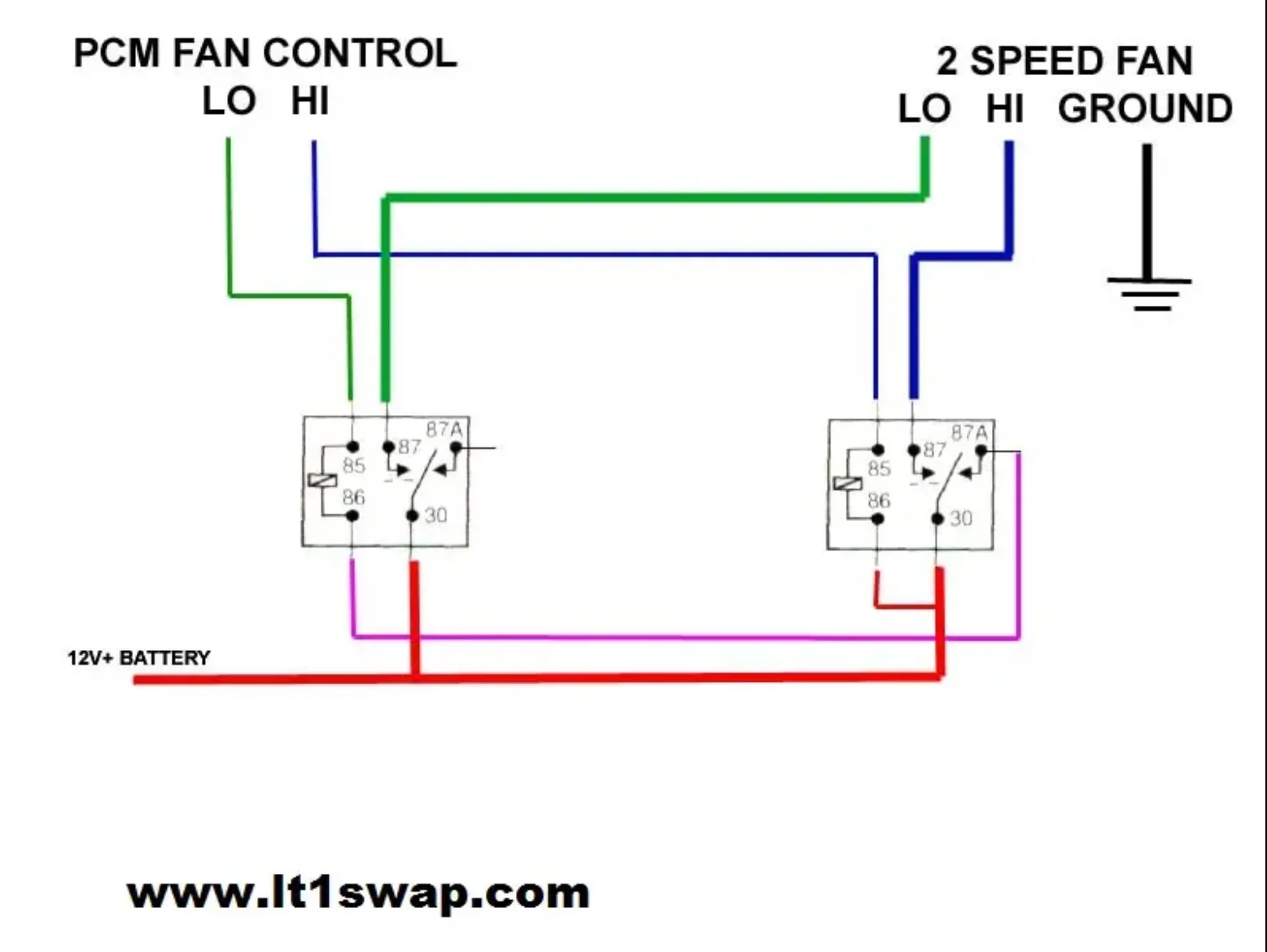

Hi, @mtweller. I’m digging up this post from last year to ask a question about your fan wiring. I have the E38 computer with 20 awg wires for my low and high fans. I realize that you have one fan. How are you controlling fan speed with the computer?
I have my 20 awg wires hooked to a relay and 14 awg wires going to where my fans will be. Did I wire this correctly?
This diagram might explain things. I wired in 4-prong relays and this calls for 5-prong. Oops. I guess my setup would just apply full power and the 5-prong must regulate the power somehow? In any event, I am back to the drawing board. More rework. Ha.

Thanks for the reply. Mine isn’t variable from what I can tell but that is a neat feature on your setup. I’m glad that I read through these comments before I got any further. I ordered the right relays and I should have them in on Friday.
UPDATE: this is not the final setup as it will most likely go through another iteration. I’ve decided that I won’t run a dual speed fan and the Spal fan that I am looking at comes with a relay on the motor. Oops. Those relays should come in handy later on for something else. More details to come in later posts when I am back to the cooling system.

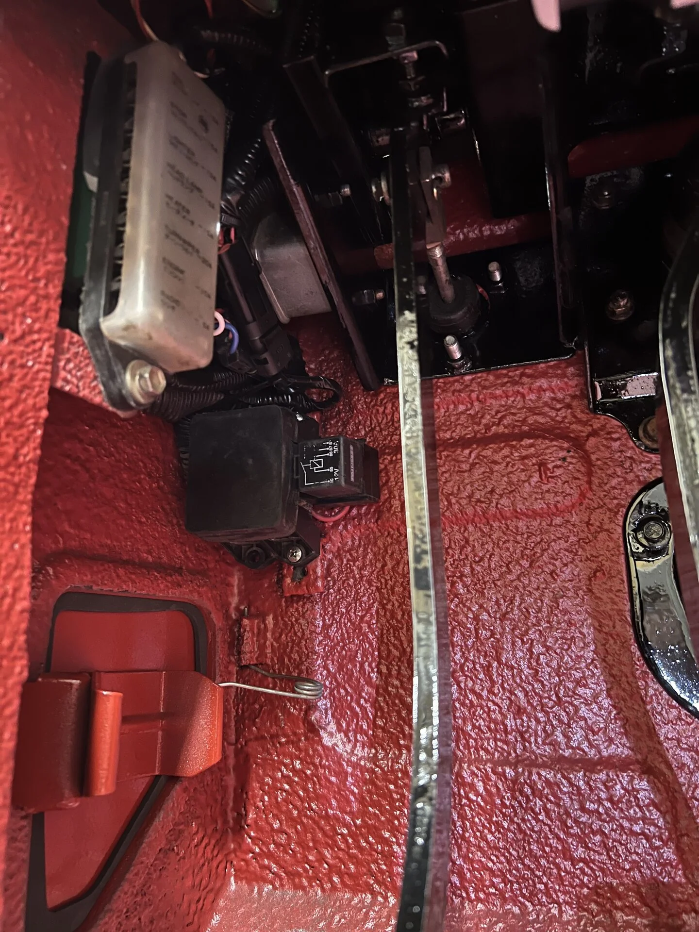

I finally got the engine fuse block installed. I only need 1 5-pin relay and the rest are 4-pin. The 5-pin is needed to switch power from the low to high speed fan. I also added another relay to supply a ground signal to the high speed fan when the ac compressor is engaged.
