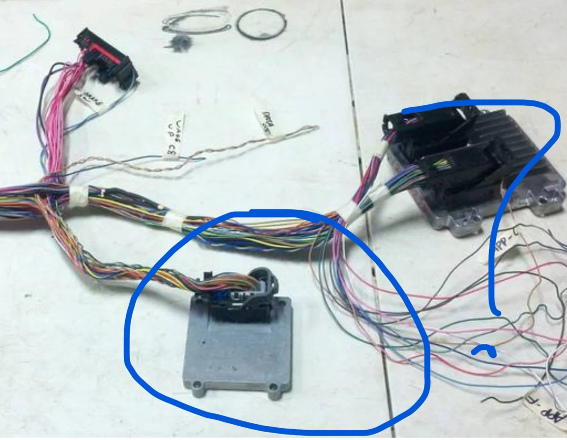

Anyone have any idea what this circled box does from the picture below that I found on ls1swap.com? I didn’t have the box with mine, but I did have a similar plug in this area, though my plug clamps in a different place and may not have connected to this box. I thought that the plug was for under dash wiring and I deleted everything except for the pedal controls. The rest of the wiring went to the fuse panel or deleted PCM pins from what I remember. I’m not too concerned, just curious.
I’ve ditched the VSS, well, sort of. I still need it for my gauges. I’m bumping this back to the top (or is it the bottom of the thread?). What is this box?
