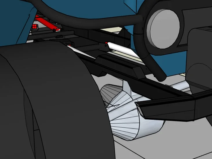

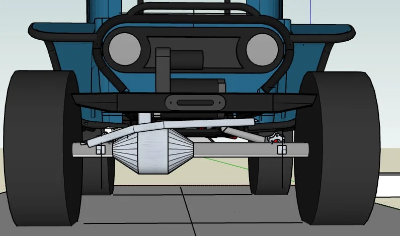

I am leaning away from the whole tube hybrid frame idea, as I am finding I will have adequate frame clearance just stacking rectangular tubing. Which will make building the frame MUCH easier and faster. Just need to make a notch for pumpkin and panhard. This will also do away with my little stinger front idea, but that's ok as it was way more clearance than needed and this way will allow me to run an 8274. It was also a bit questionable of it would have even been legal as I believe I need 10" extending past frame rails each side.

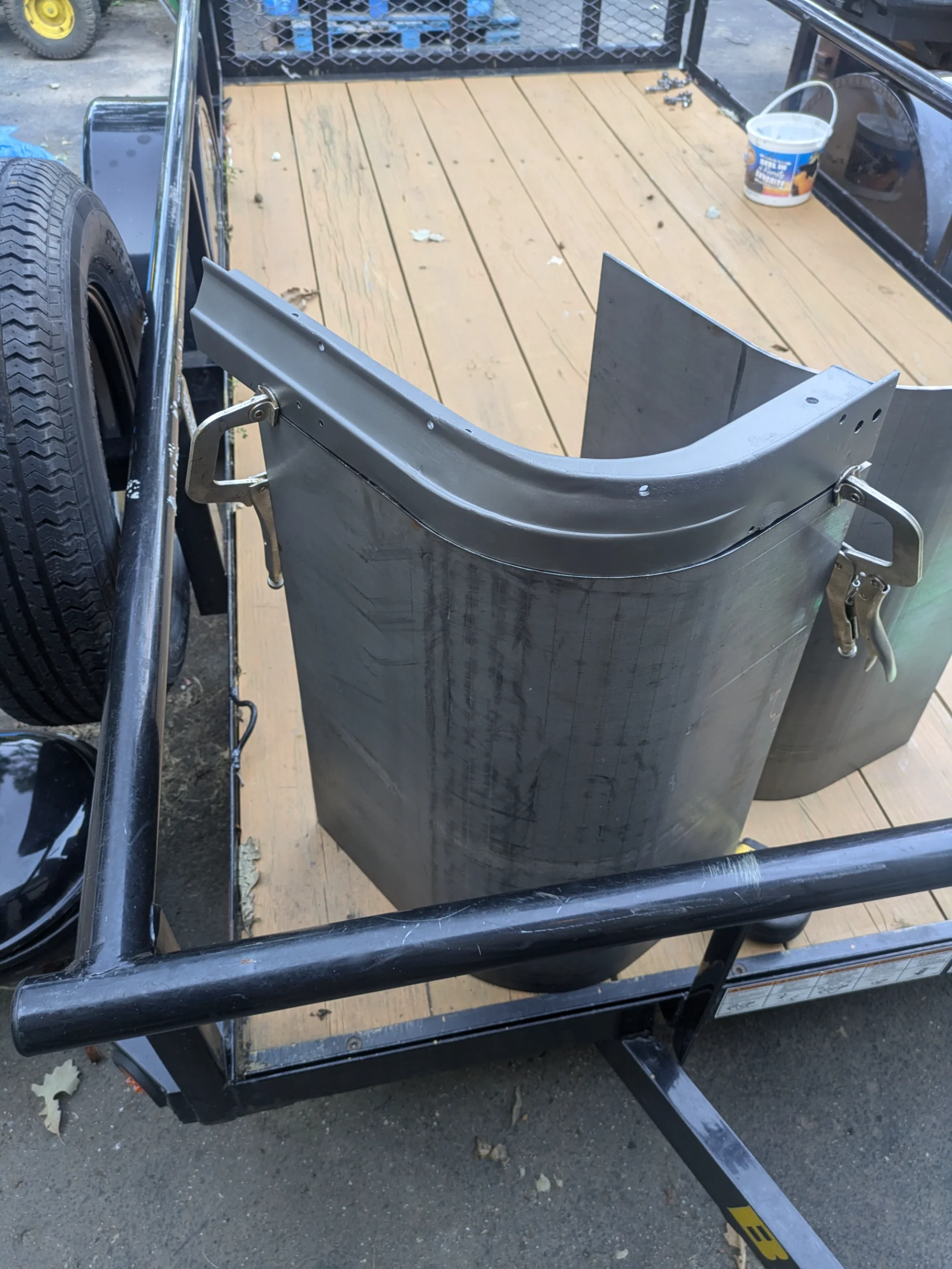

Trying to get ahold of awl_teq on here to see about getting a 45 tailgate from him, otherwise may go the chinesium route. But I've got a loose plan for a beefy 45-ish styleside bed using tubing and sheet that I really like. Needs work still.
Hoping to get cab shell together by fall, probably starting on frame first thing spring. Anyways, back to the mountains where there is no service!

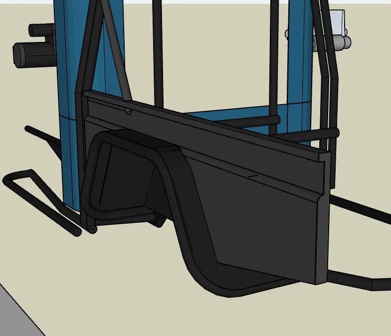

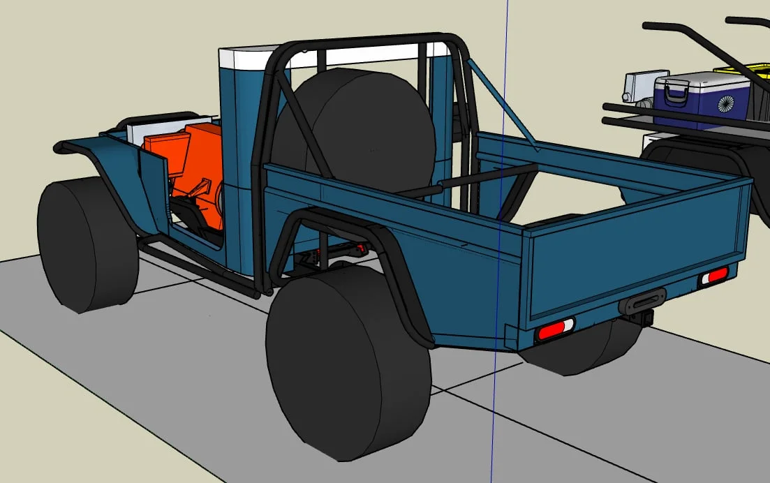

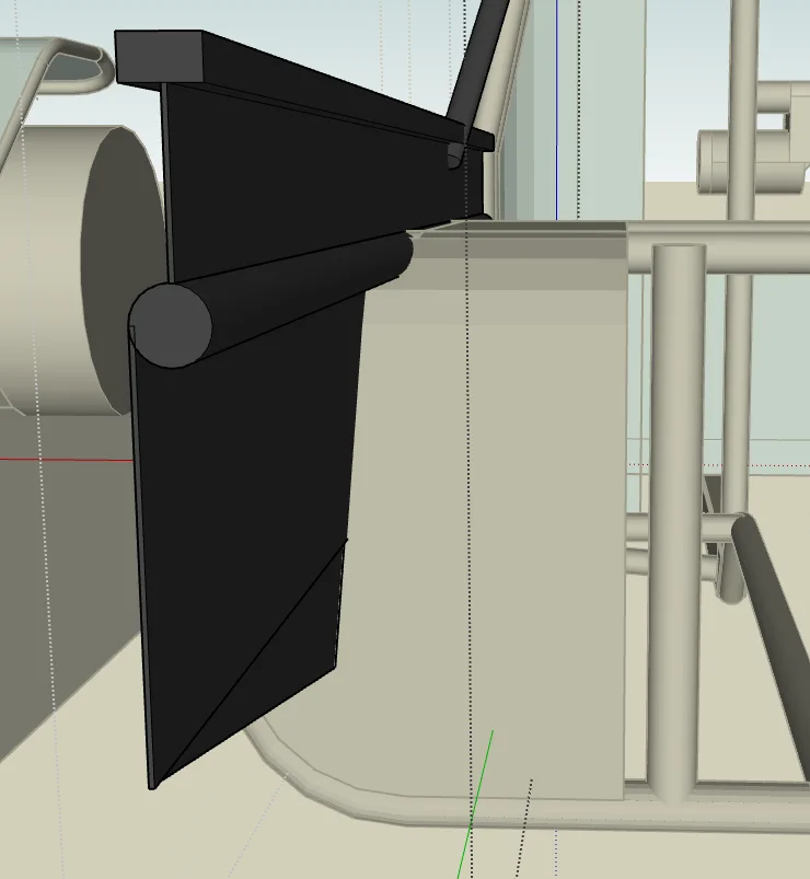

Those 3D renderings are insanely awesome.
Thanks, I'm sure they look horrible to someone actually experienced with CAD, but it has been awesome for visualizing and laying stuff out.
A complete fj45 bed popped up on fb a few days ago. One of those Land Cruiser fb pages.
I bought a complete used 45 bed from a gentleman whose truck was at IPOR. I cut it down to about the same dimensions as a tundra crew cab bed.
You will be pleased if you go that route.
Been watching stuff but would prefer not to molest a real 45 bed, plus the tube in the DIY version I am planning would allow me to tie in tube fenders. Really just trying to get my hands on a tailgate at this point, need to bug the contact for awl_teq again, still no response.
