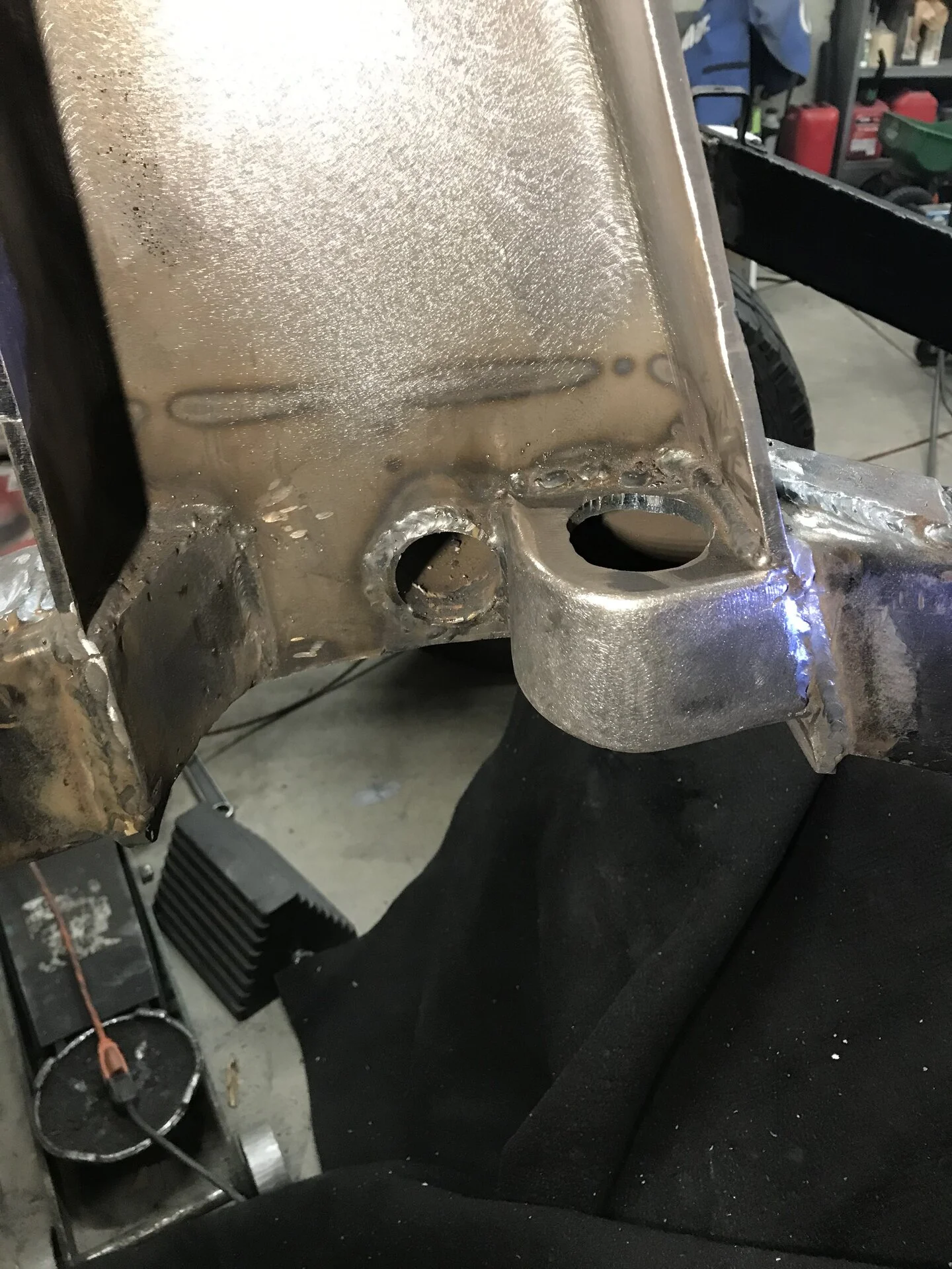

Air Bump Bracket (Rear)

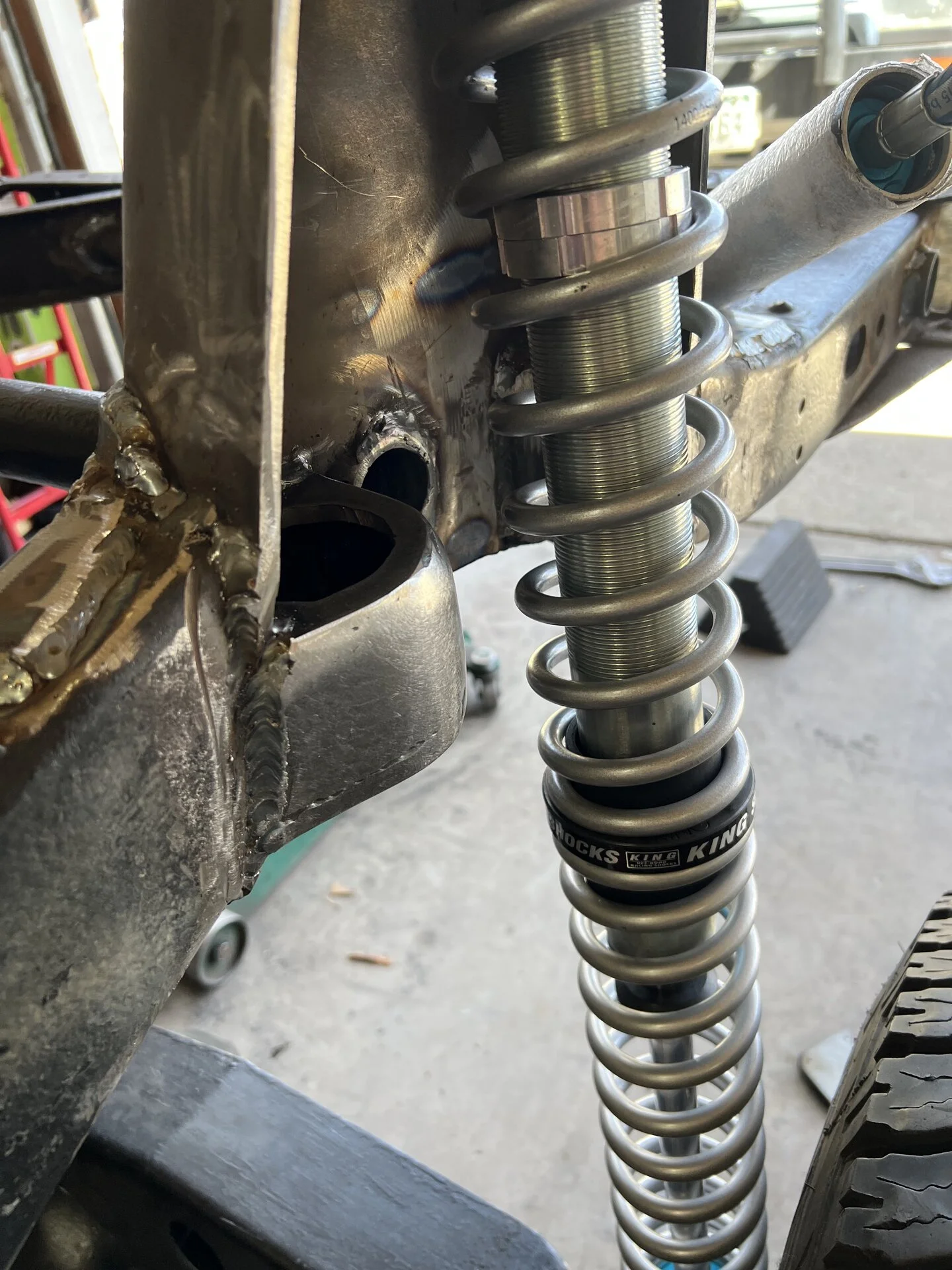

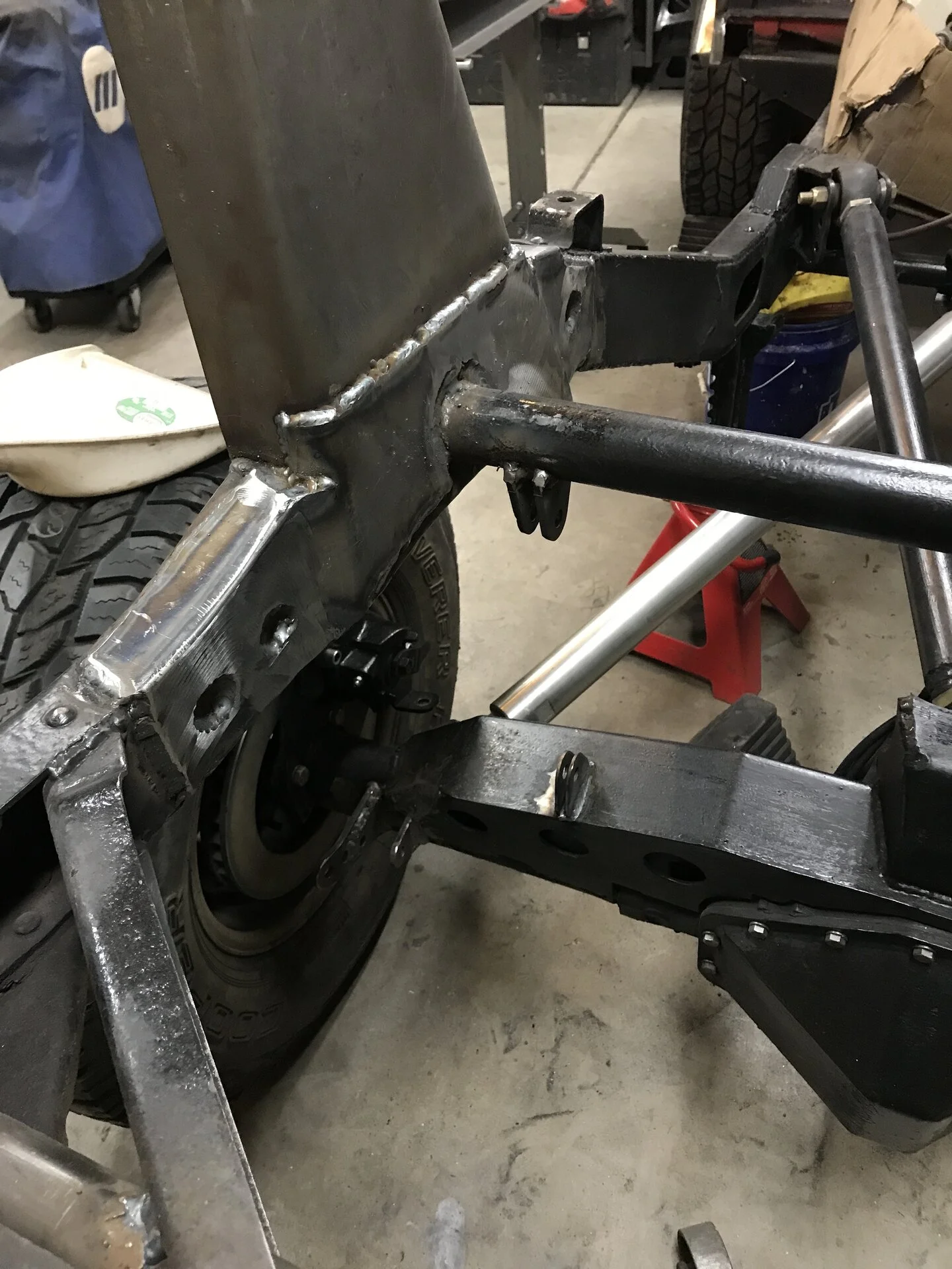

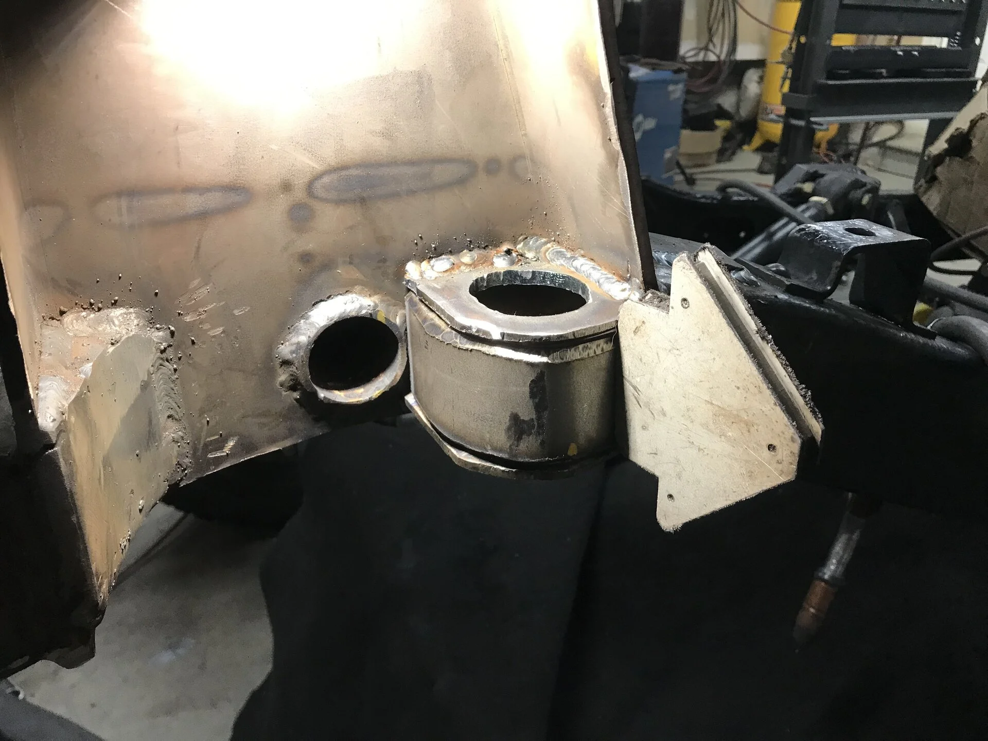

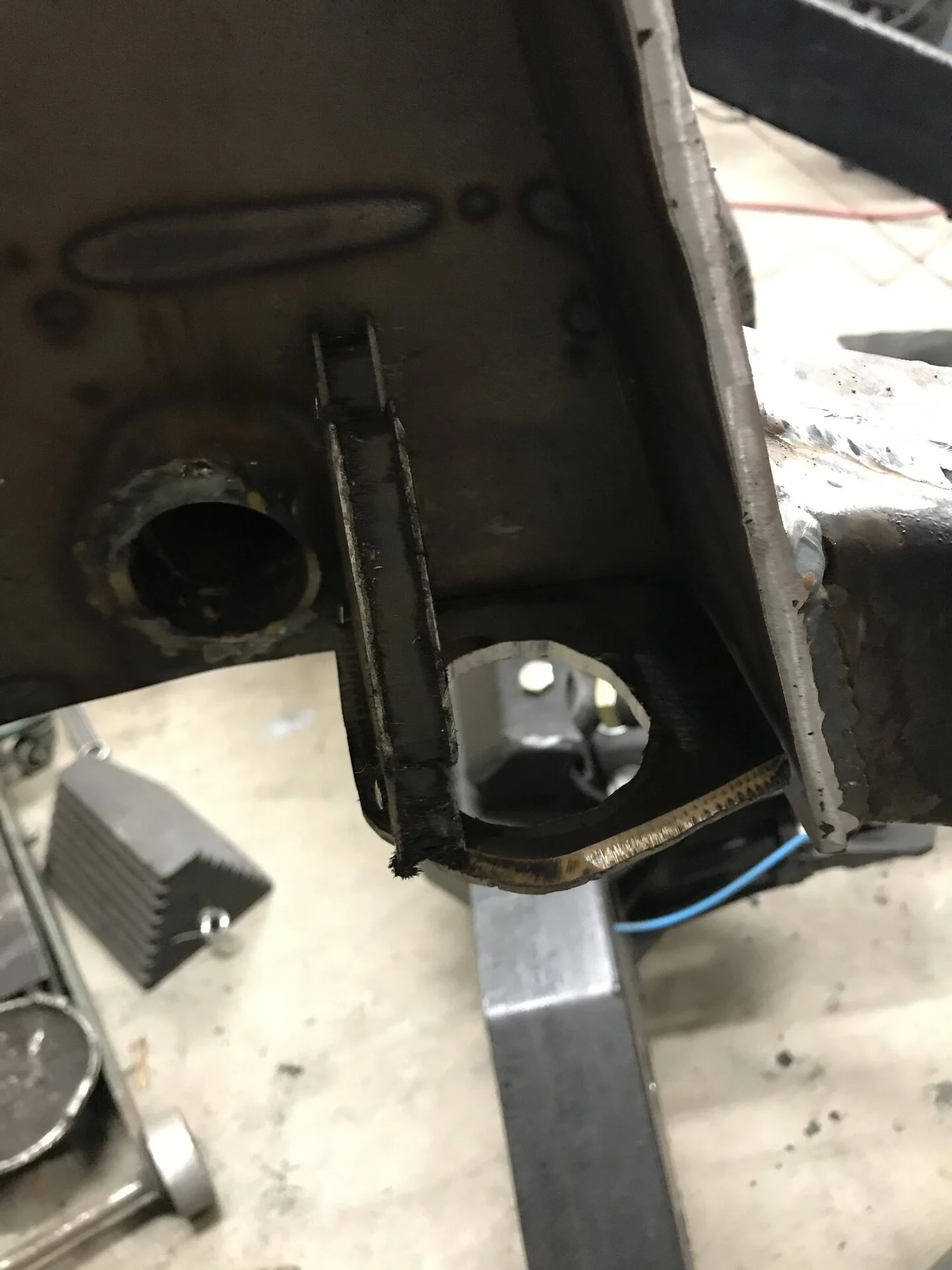

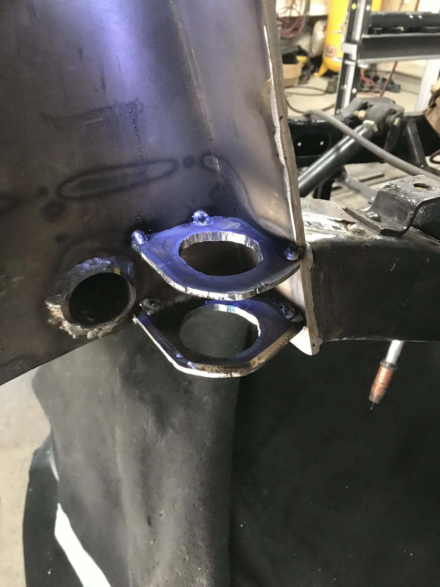

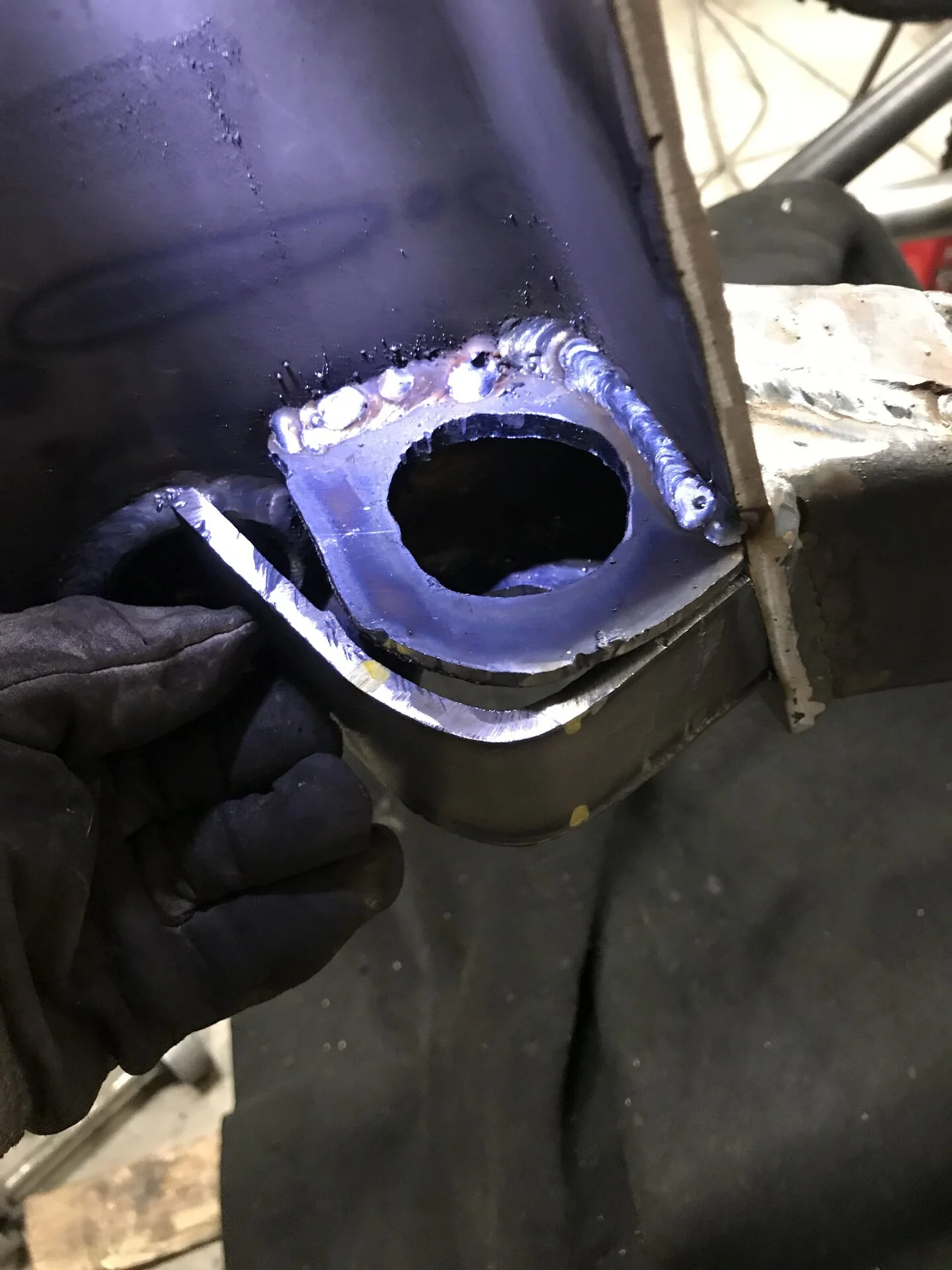

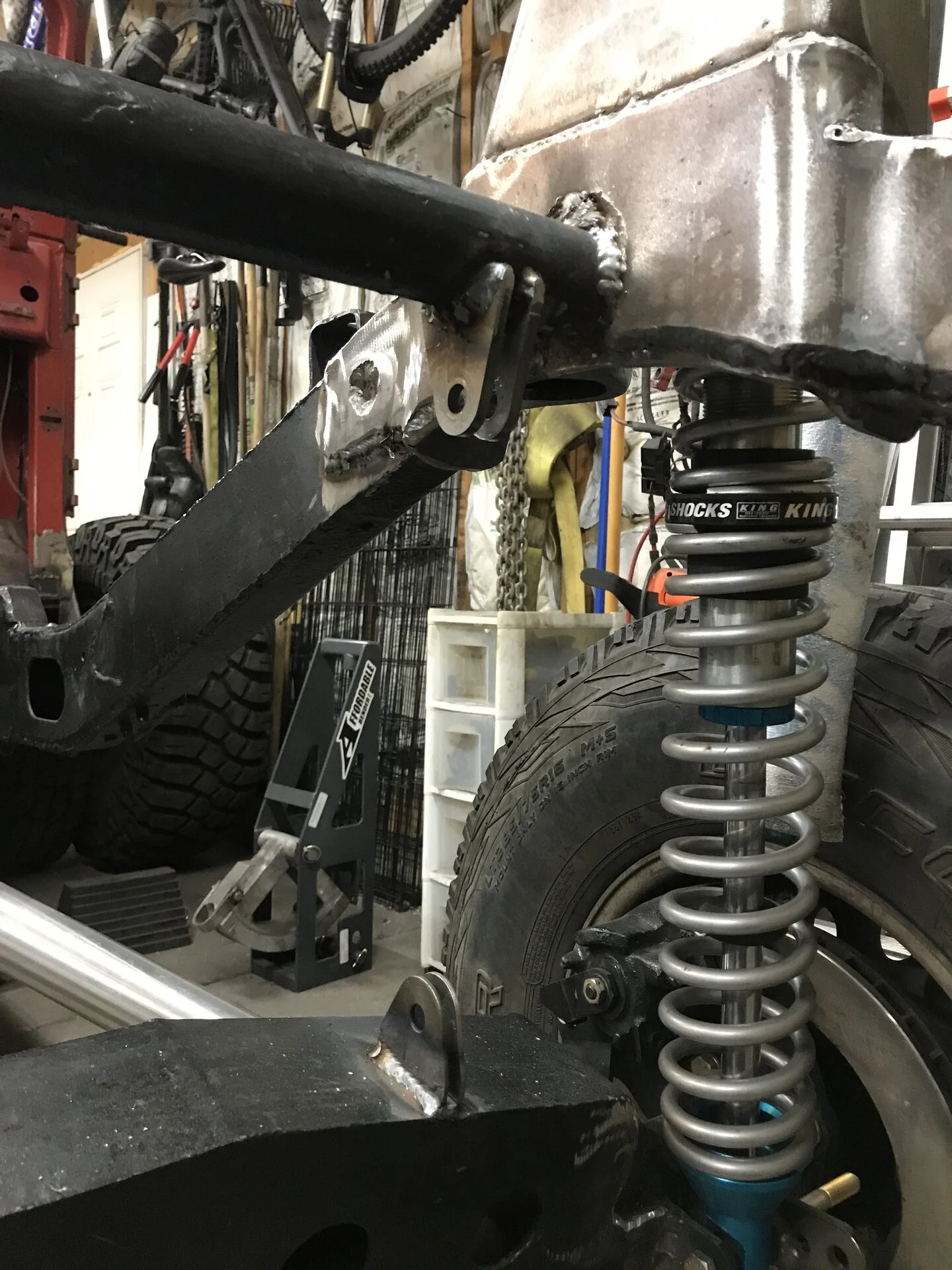

One rear air bump bracket is done and ready for paint. I’ll weld the can on later.
Nice, and it adds gusset to the tower, any plane to brace top of towers ?
The top of the tower is tied in with 1/4 shock tabs and cap. I don’t plan to add any more to these towers.
I’m glad that I snapped a picture of that. I never finished welding the tabs!

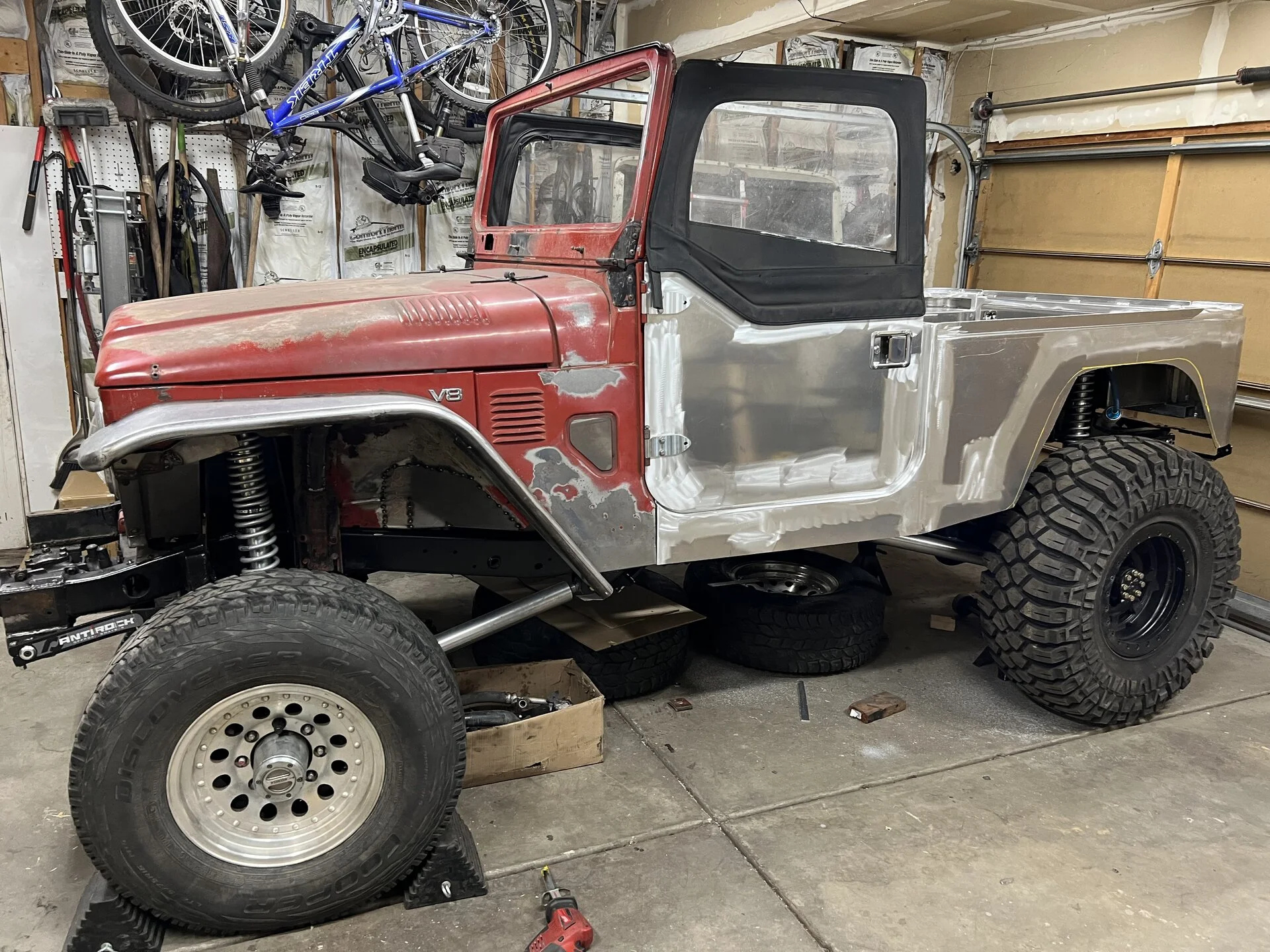

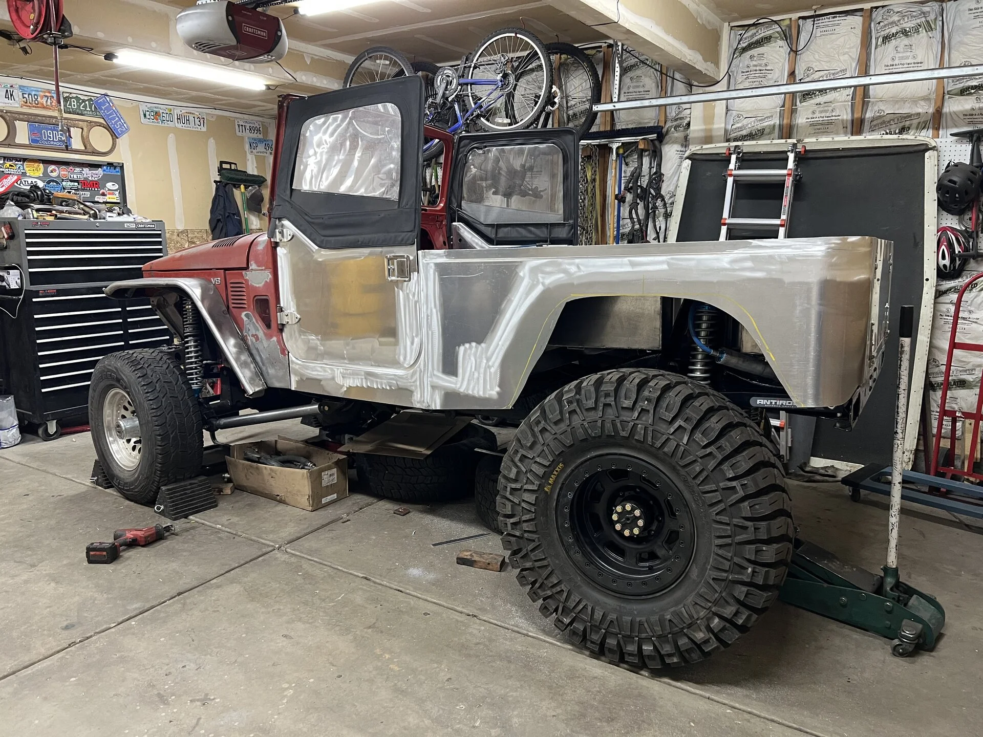

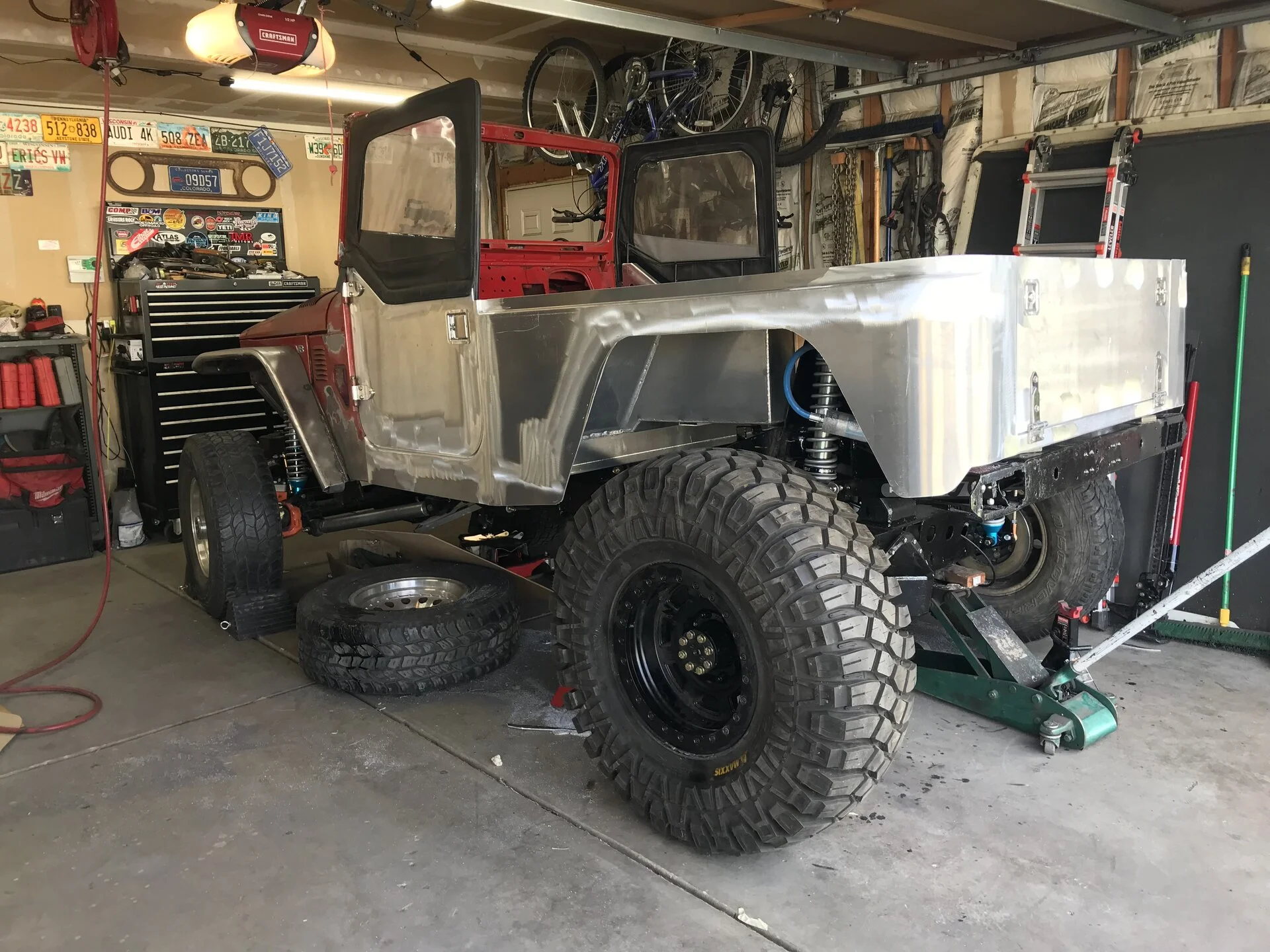

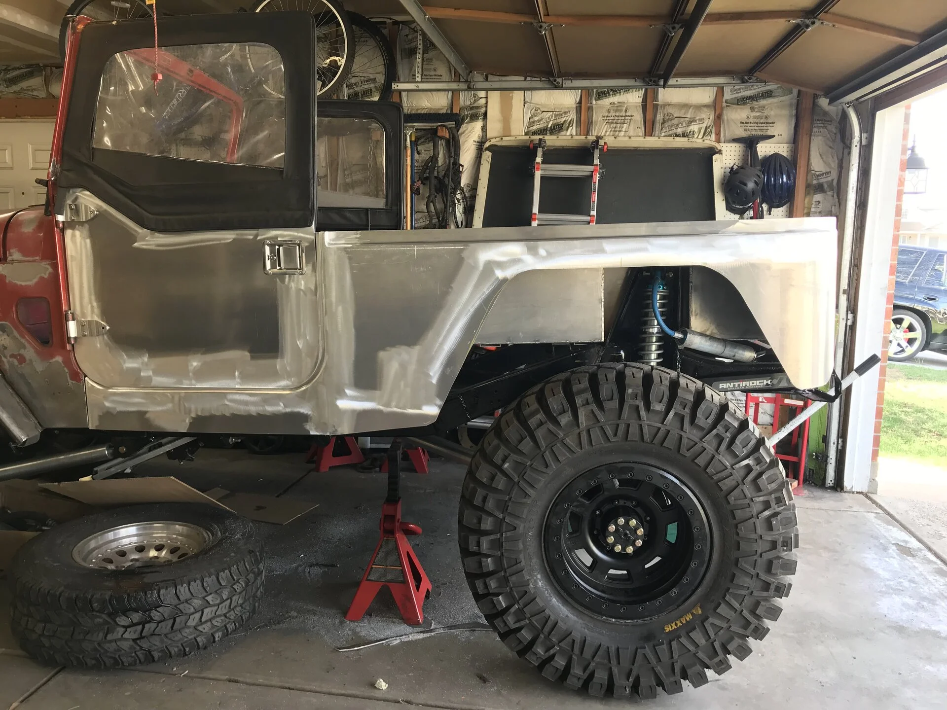

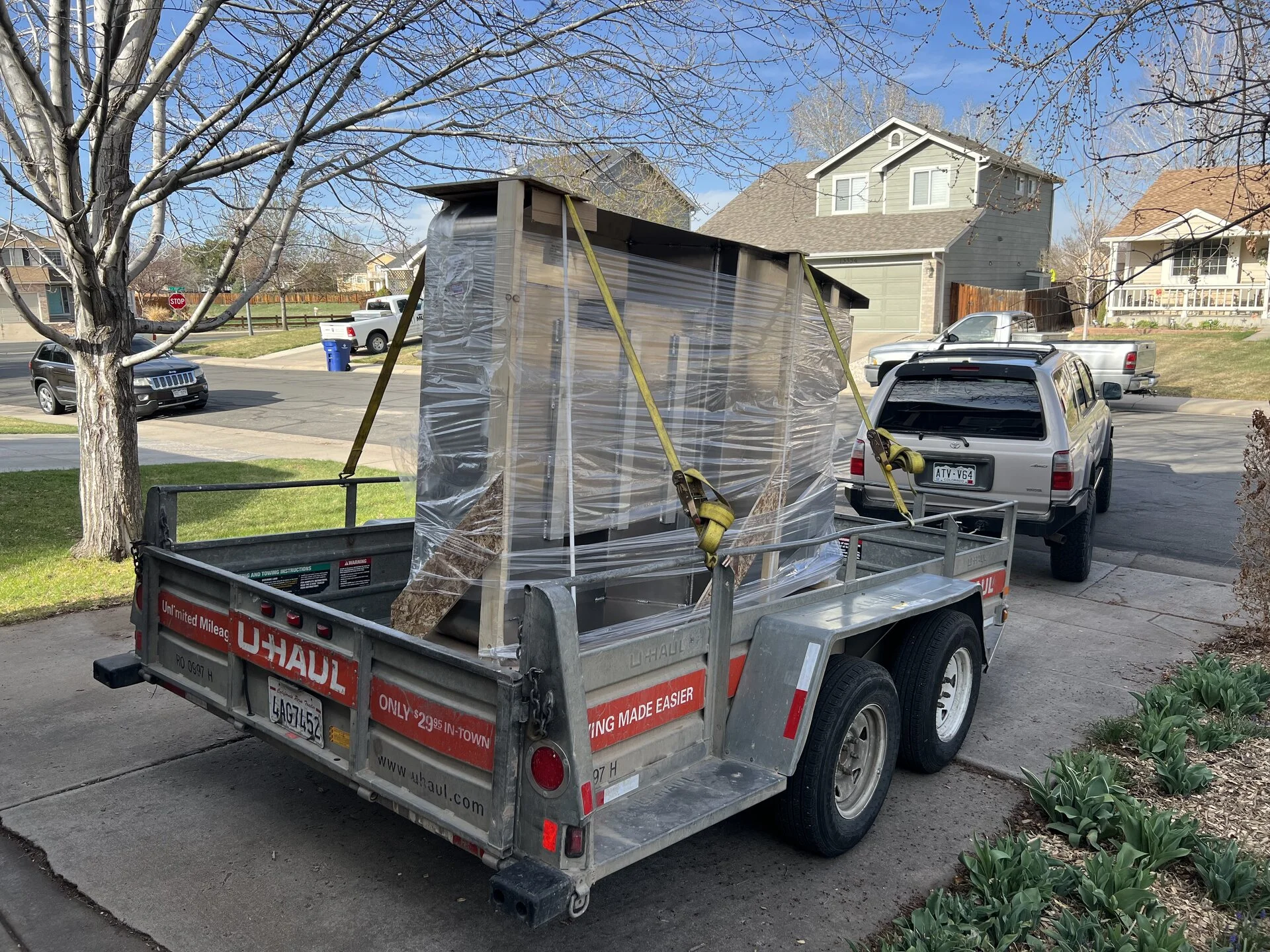

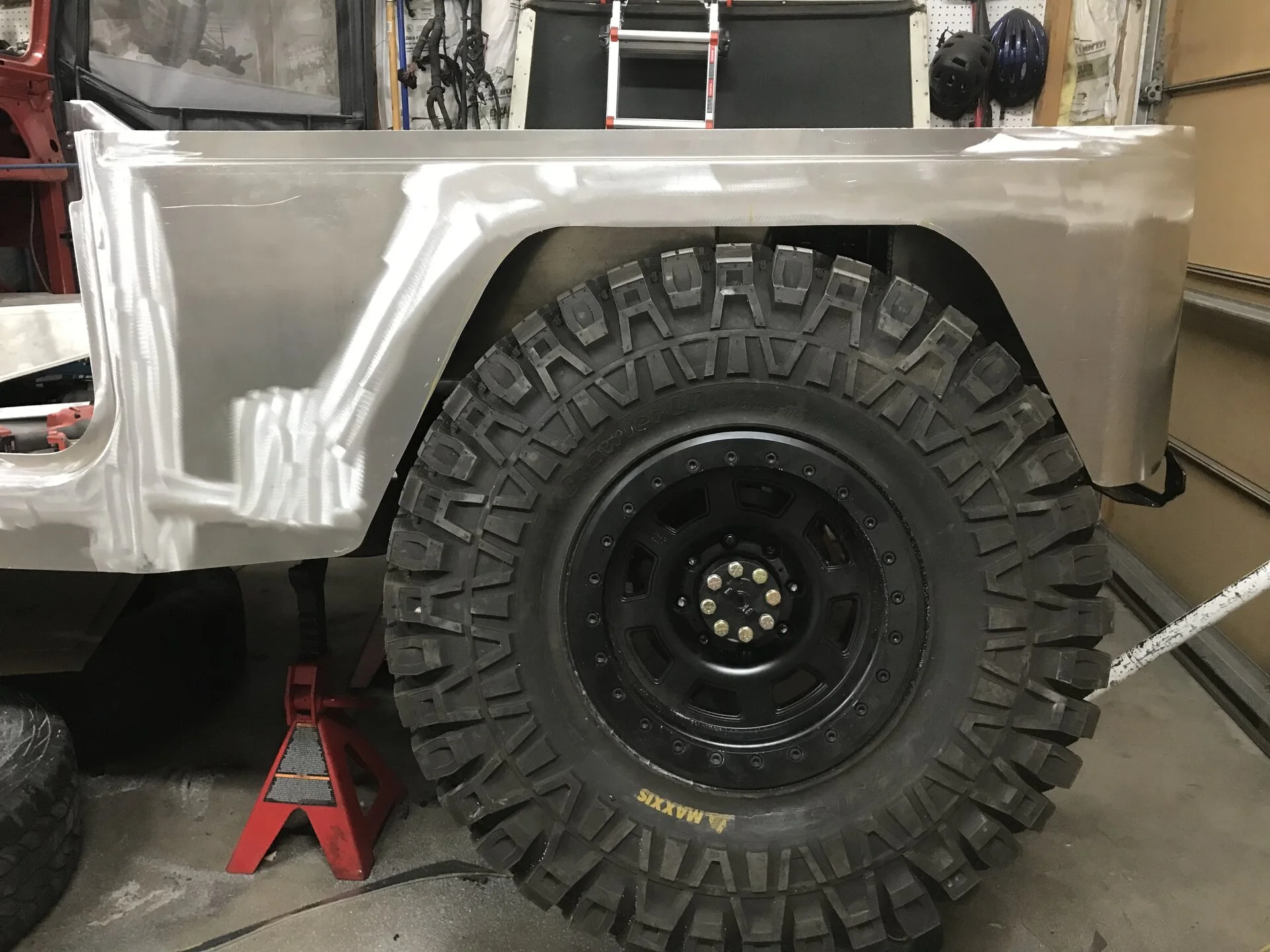

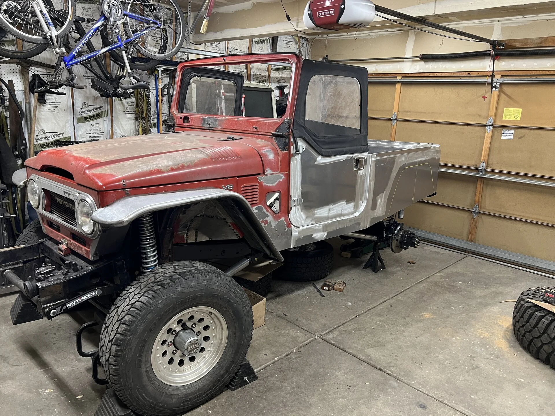

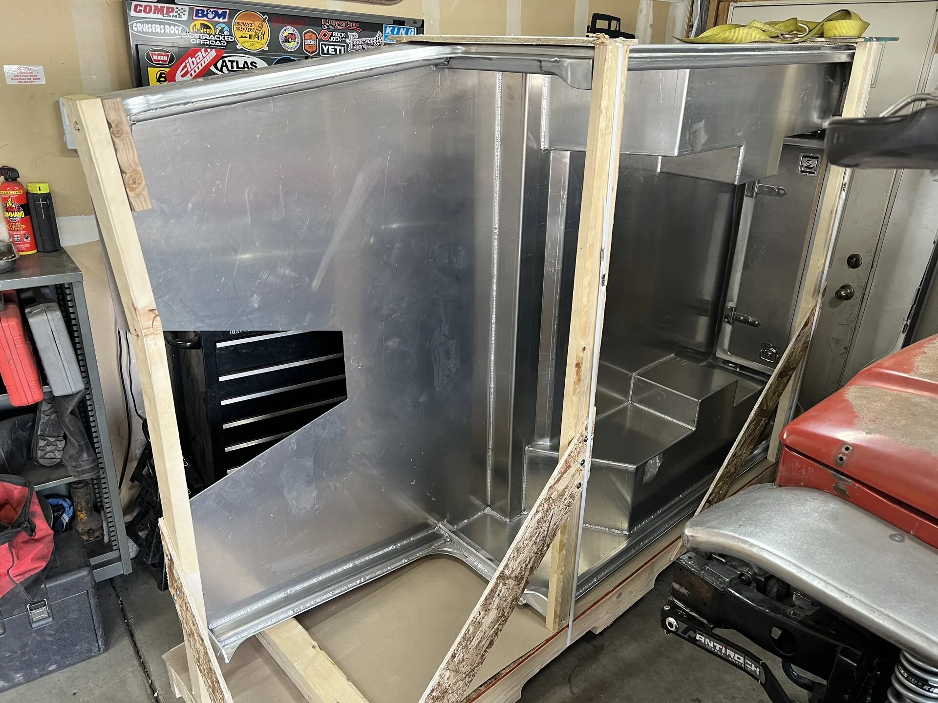

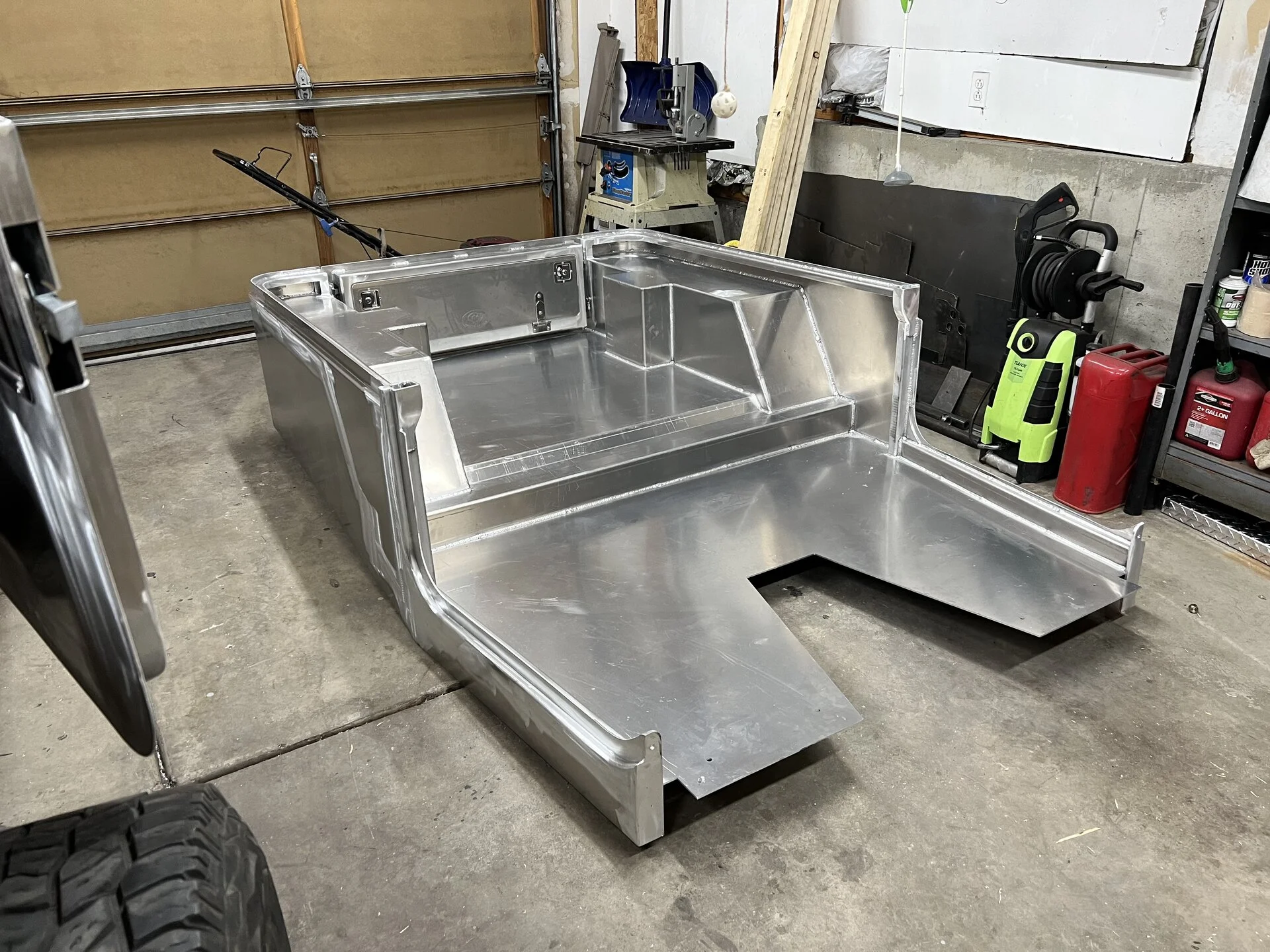

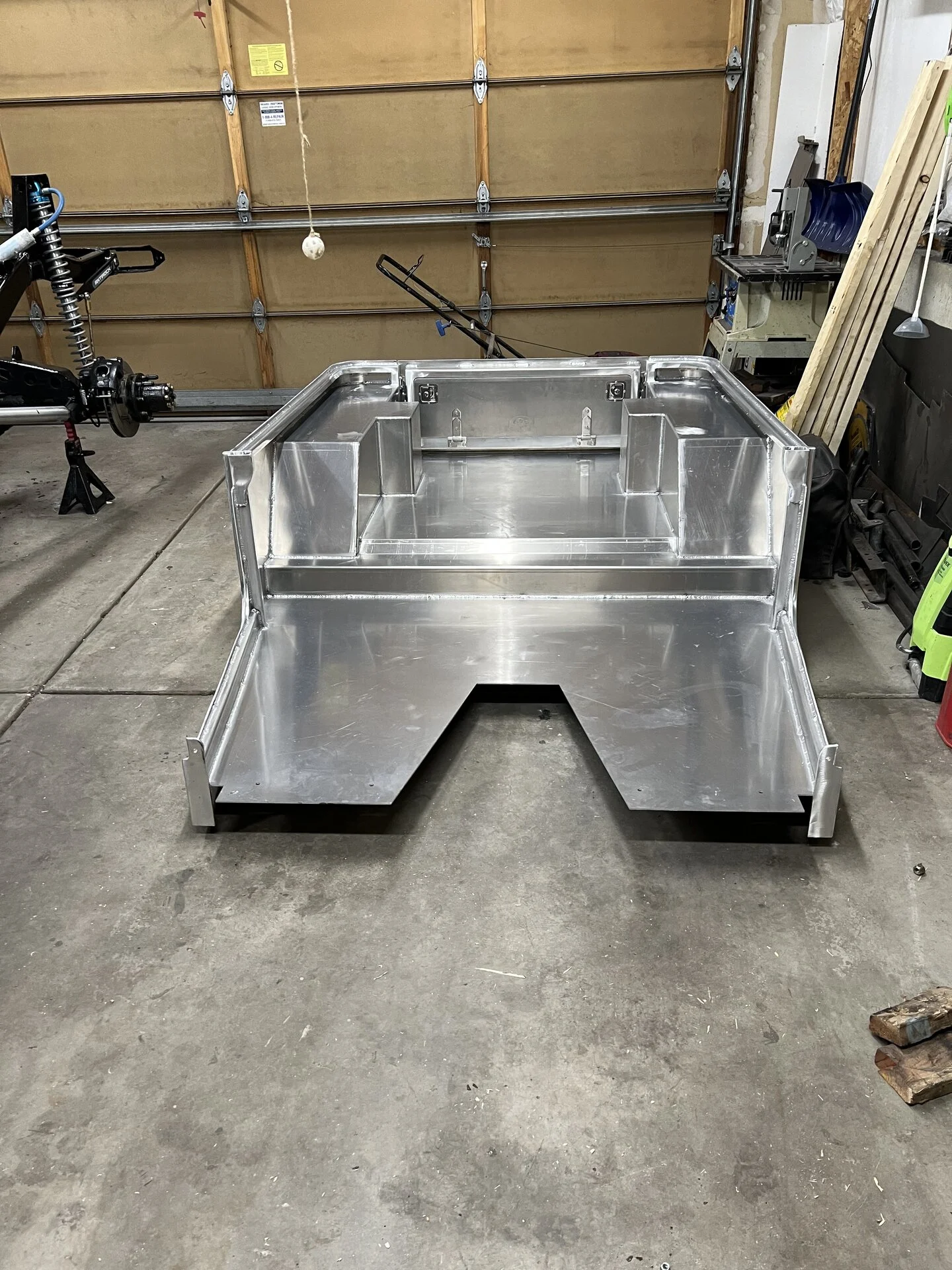

Jelly, thats such a better way to get it done if you got the coin, nice. Do you know the weight ?
I’ve been saving for almost 30 years. It weighed 438lbs on the pallet, which includes the half doors, tailgate, transmission tunnel and hardware. The tub weighs around 230 lbs.
