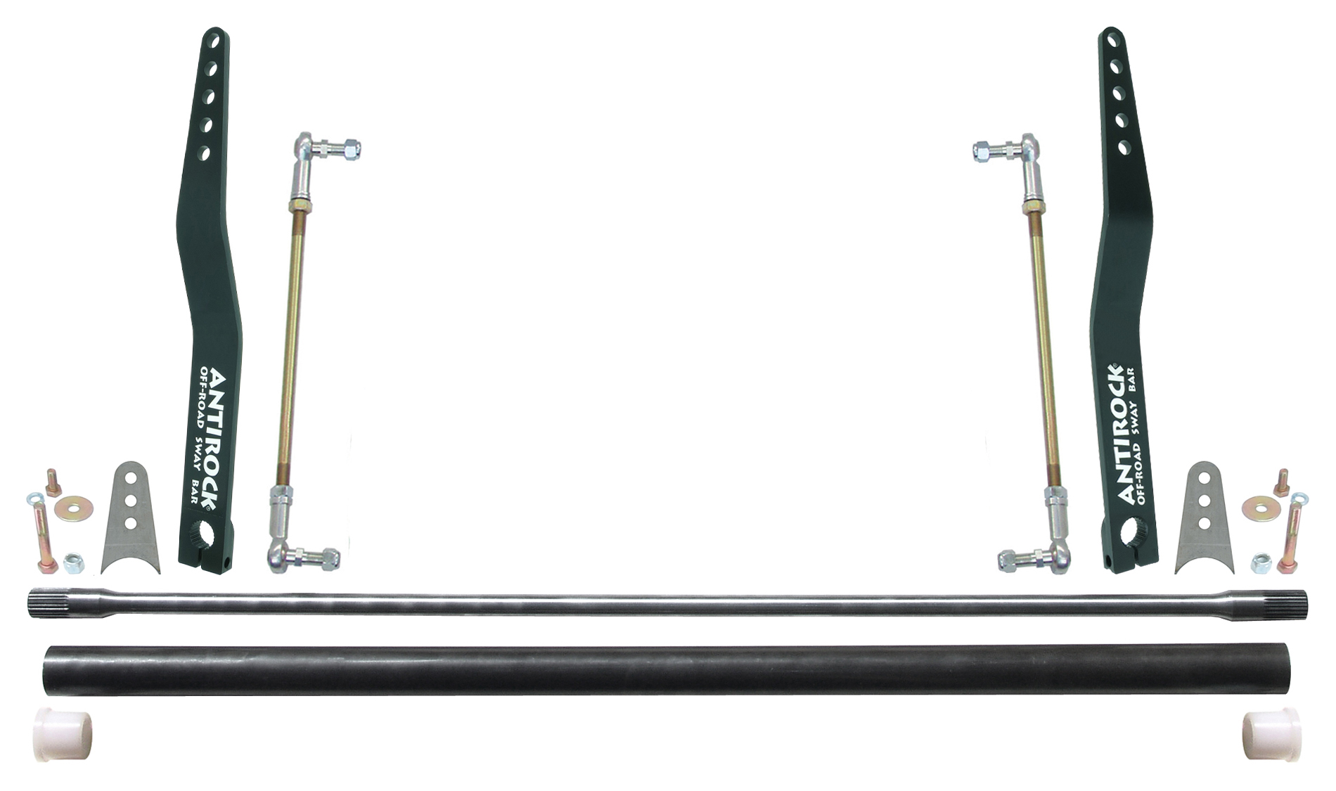

This is 50 inches wide
I spoke to Max at Rockjock and he said that the 40” setup has a 1” torsion bar and it is intended for increased tension that you might want with a heavier vehicle. This bar could break if flexed beyond 12”.
It sounded as if all other kit sizes have a .7-.8” torsion bar and they can be flexed beyond 16”. His setup flexes 22” and his sway bars have handled just fine.
Wont you disconnect the sway bar off road?
Not the anti rock. they actually help more off road than on .
Not sure i can visualize the physics here. Can you explain?
The way i understand it is the anti rock sway bars have less torsional rigidity than an OEM system and help transfer forces between the two tires off road.
I think you meant to say they are a compromise from a more rigid bar that would better control body roll on the road?
@EWheeler The Antirock is designed to keep the vehicle as level as possible through an obstacle. If the left-front compresses, the Antirock will push the right-rear down.
If the vehicle had sway bars to begin with, the Antirock setup could introduce more body roll than the stock setup. I don’t know what it will do to the Cruiser on-road.
Here is a great clip from John Currie. He does a better job explaining and I am still learning:
Here is some literature from their website:
Antirock Sway Bars are designed to balance the vehicle’s front and rear suspension when off roading, resulting in better, more consistent traction. Additionally, off road sway bars never require disconnecting!
Antirock sway bar equipped vehicles will exhibit more body roll than vehicles equipped with the factory sway bars. Antirock sway bars may be used on the street, however, they do not provide the same handling characteristics as the factory sway bars.
