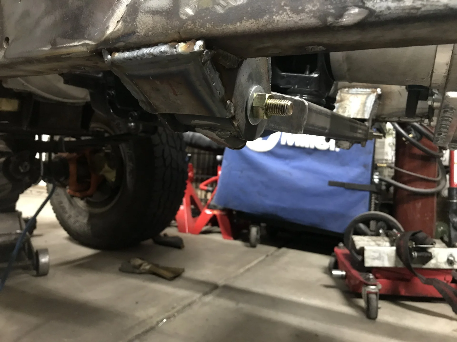

Transmission mount is done. Next up are the scab plates for the frame extension.
Thanks for the tip, @matzell. I had planned on putting a t-case mount as well though I am reconsidering it based on guidance from AA. They told me that they have had a few Atlases come back with broken tail housings around the area where a rear mounted brace was mounted and they no longer warranty that piece if a mount is installed there. What are your thoughts about that? I may still put a mount back there despite their guidance. What does your mount look like?
Something like this: Atlas Support Ring - https://www.wideopendesign.com/wide-open-design-atlas-support-ring
or this
I have a 205 and use the tmr mount
I'm using a 205 rear output mount from nwf. X2 what Matt said, you really need something.

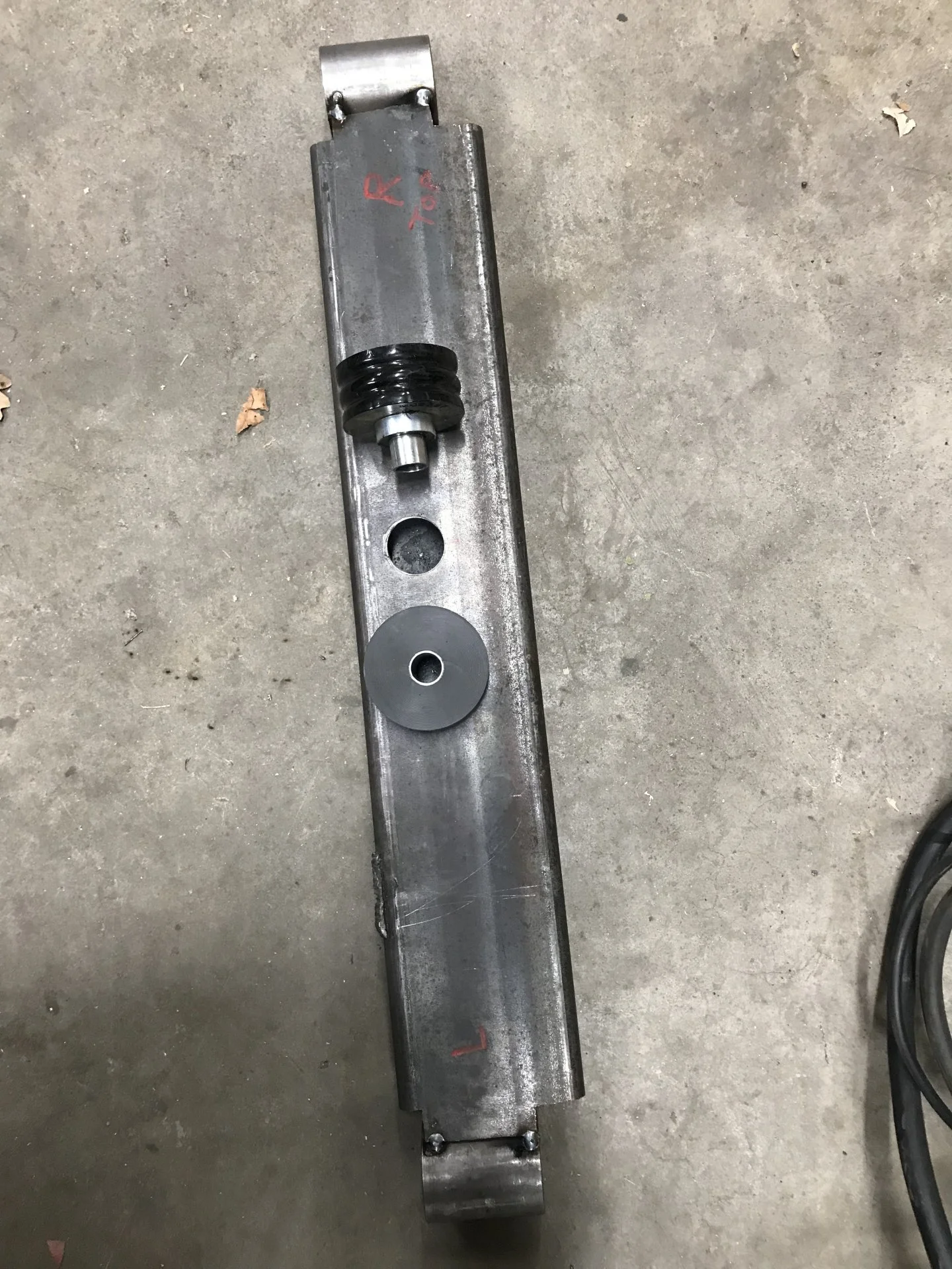

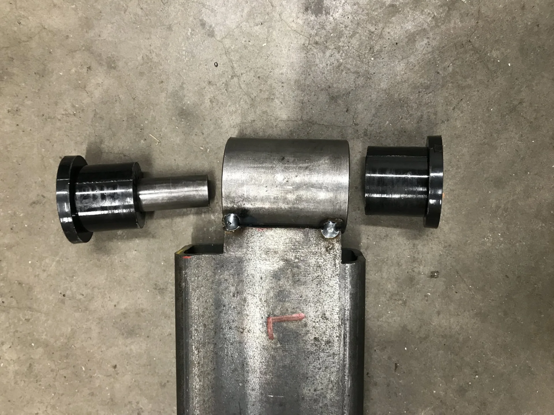

Question, are we talking about bolt size, or shank size? For bolt size, 3/4 seems way overkill to me, If you aren't hauling ass through the rocks or desert, 5/8 is more than enough. The shear strength of a grade 8 9/16 bolt is more than enough (~27K lbs). A 3/4 has 50K shear strength. Shank size is a different thing, I went with 1 1/4 Johnny Joints.
3/4 it is. I had stainless steel misalignment spacers on my old steering, which was installed for 20 years. It looks like the Ruffstuff kits only have the option for zinc spacers. What is the drawback with using zinc spacers?
Thanks for the tip!
The zink is more likely to seize on the bolt. Anti-seize helps but I have had to cut bolts out to get things apart.
look into aluminum links, Branik makes nice ones, or Wide Open Design. The steel ones, even 2" .250 wall can easily bend even when trail riding. For the cost of bungs and tube it is not that much more. The uppers are fine for DOM
We are talking bolt size. I am using 5/8 currently and I may stick with that instead of 3/4. I’ll make a decision this weekend.
You are helping the economy! I hadn’t even considered aluminum links until now. They must be solid aluminum? What size would you run? 2”?
I've used the 2" links from WOD. They work great. Way stronger, easier to use, and they look really good as well. I used 9/16 on my uppers, and 5/8 on my lowers IIRC.
