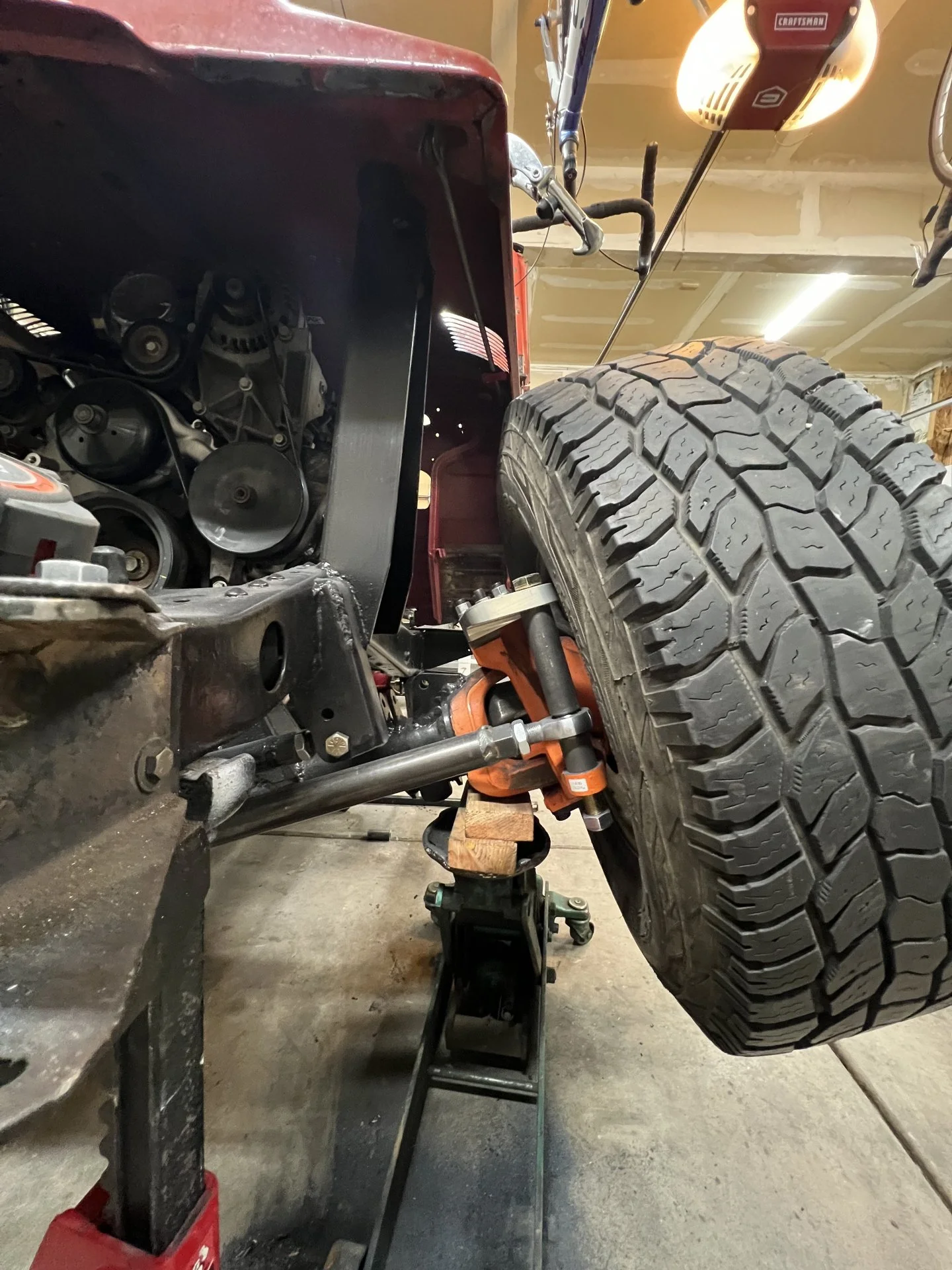

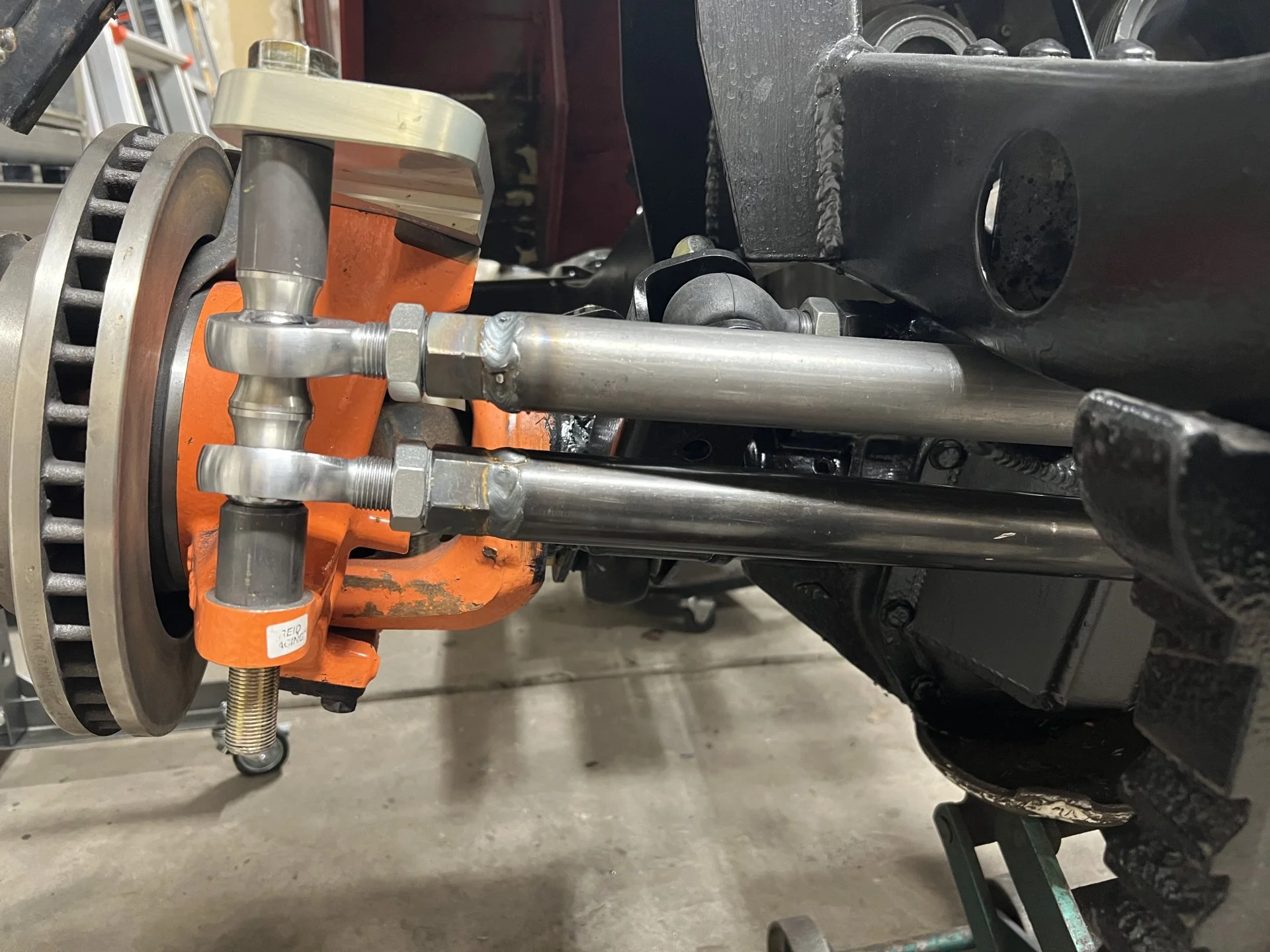

I would put a misalignment spacer on top and bottom of each heim. Probably not necessary for the tie rod as it really doesn't require any rotation of the heim, but I would still do it just because it just looks right with one on top and one on
Thanks, Evan. I’m really happy with the progress. The tube sleeve is machined to be used without a misalignment spacer.

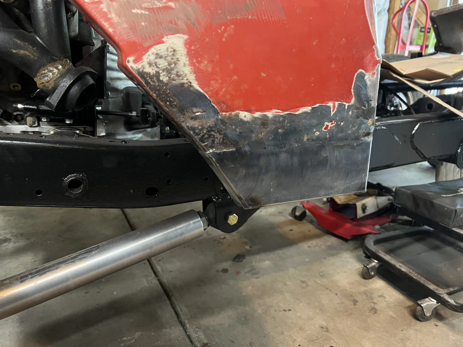

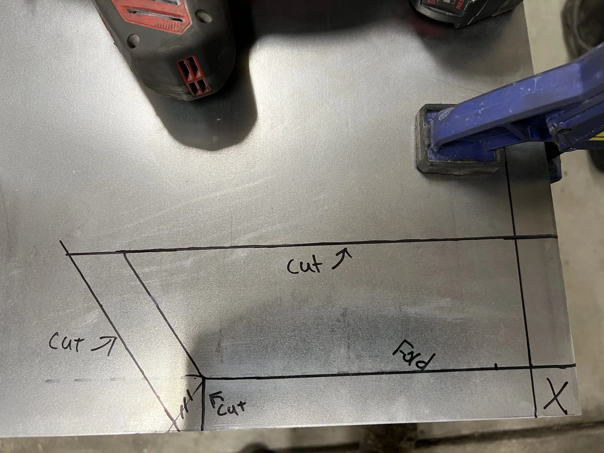

I’ll start welding in sheetmetal to the cowl next weekend!

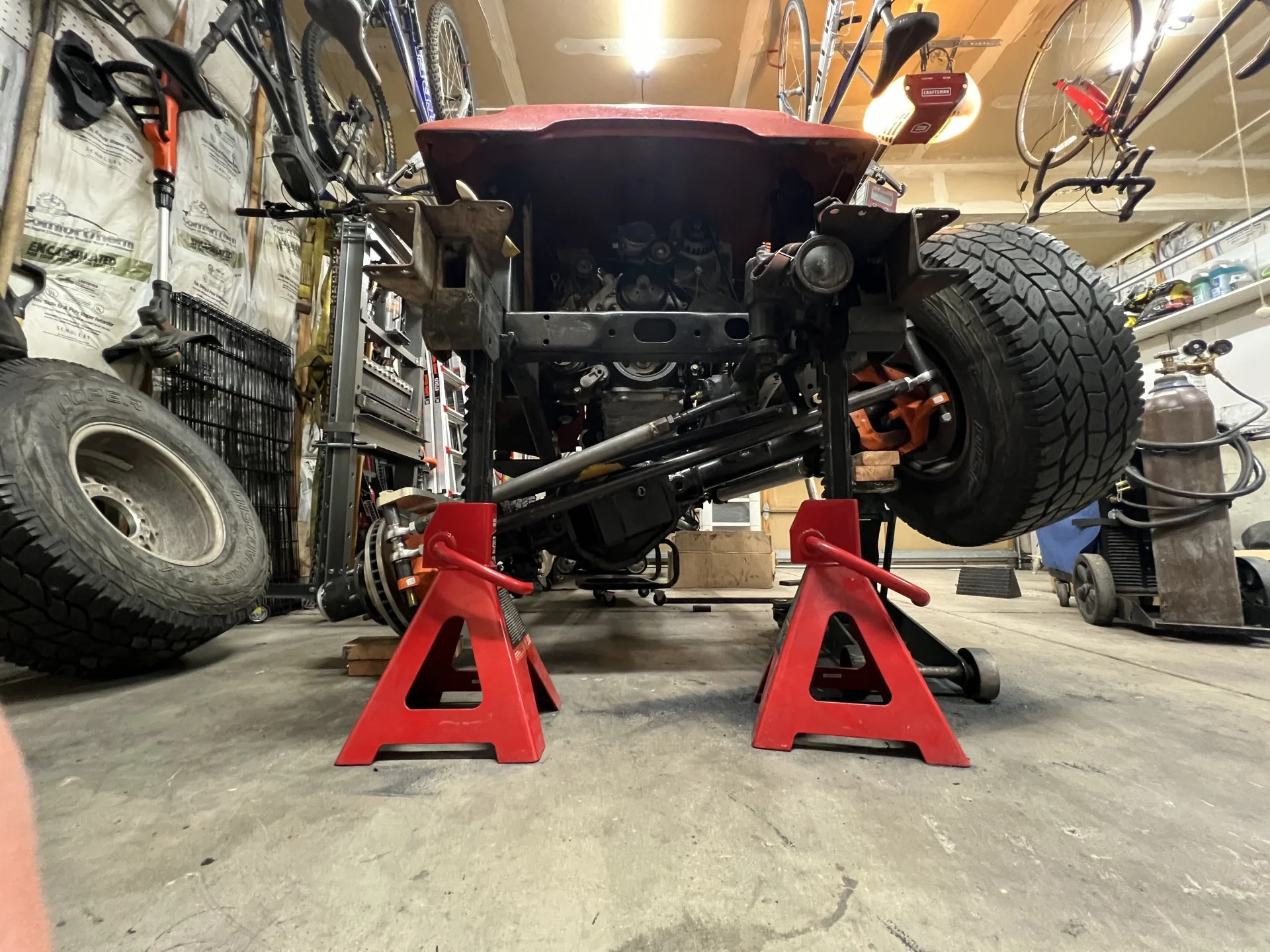

Final 3-link travel

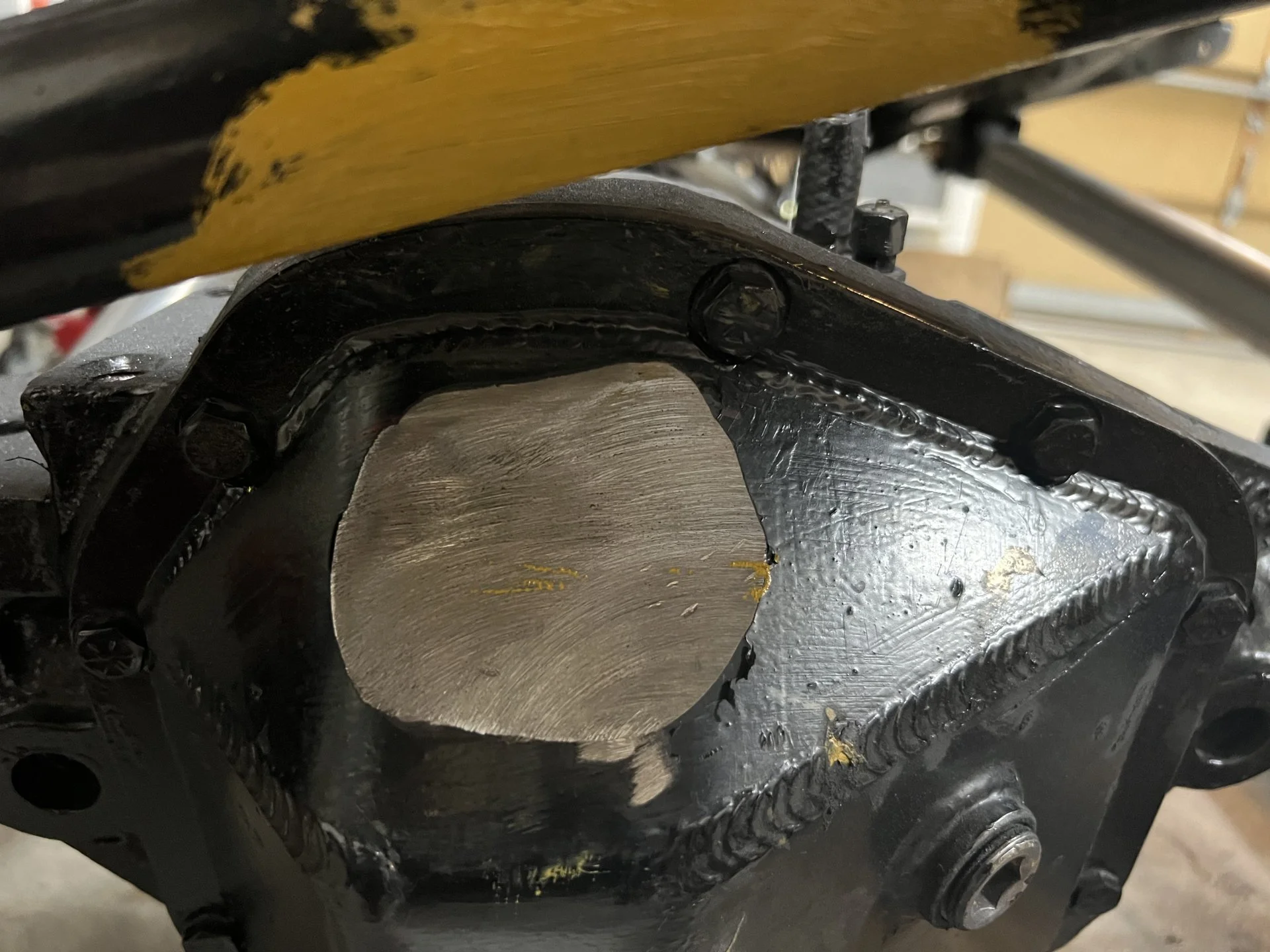

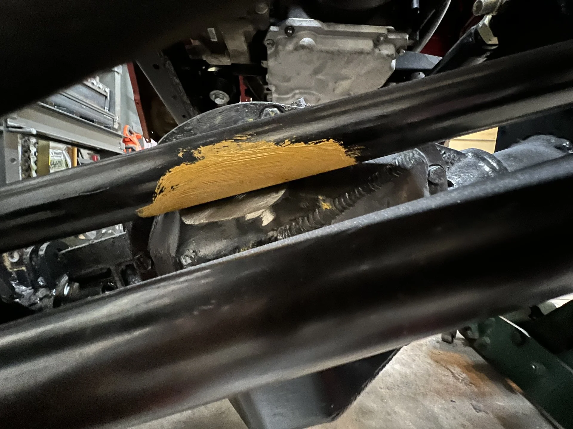

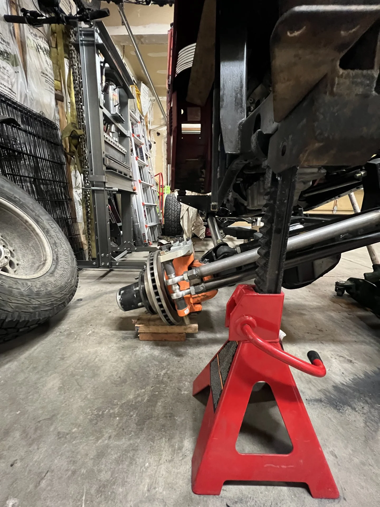

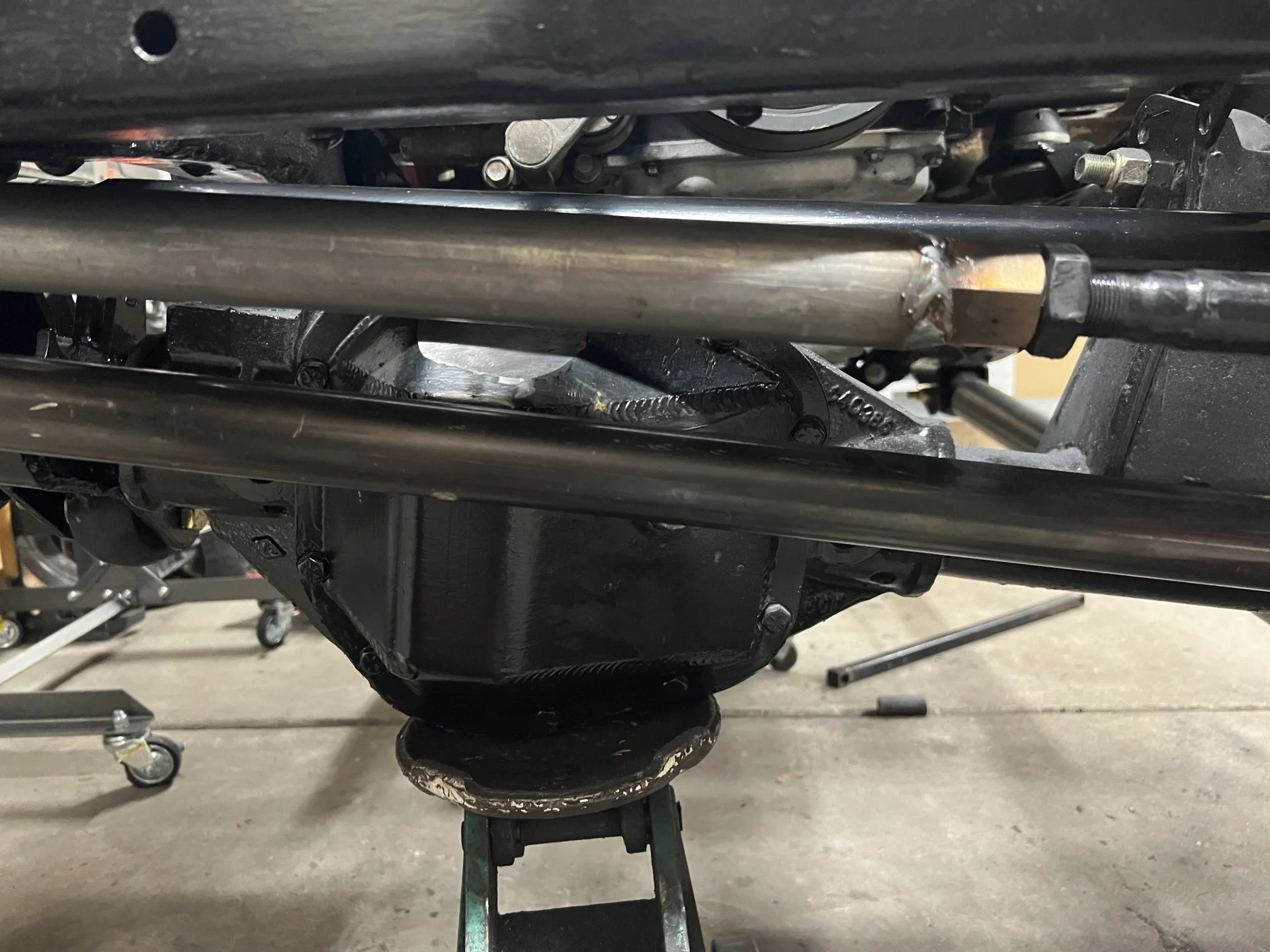

Gear marking paint is good for many uses 😉. The steering and front suspension arms are done. I had to grind the differential cover a bit to clear the panhard bar. It still rubs slightly on full compression but I think that it will be fine. I achieved 4.25” up-travel and approximately 9” of downward travel. ✅

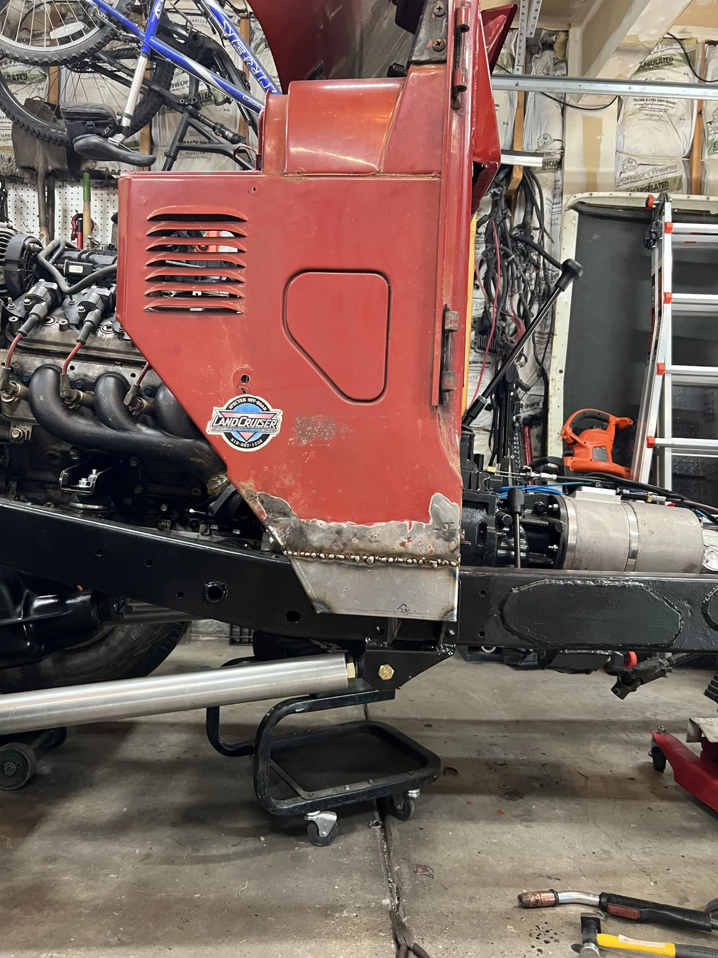

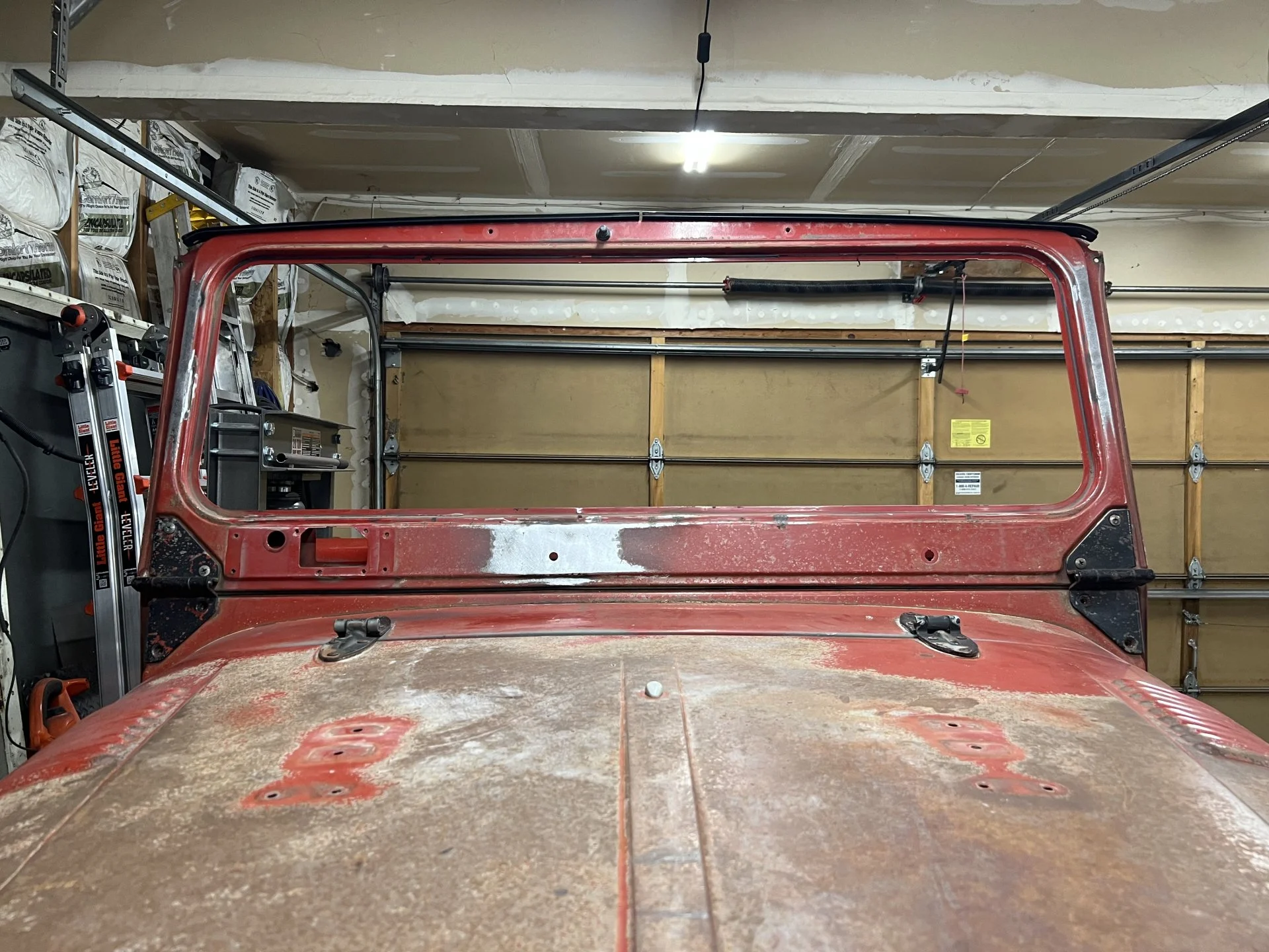

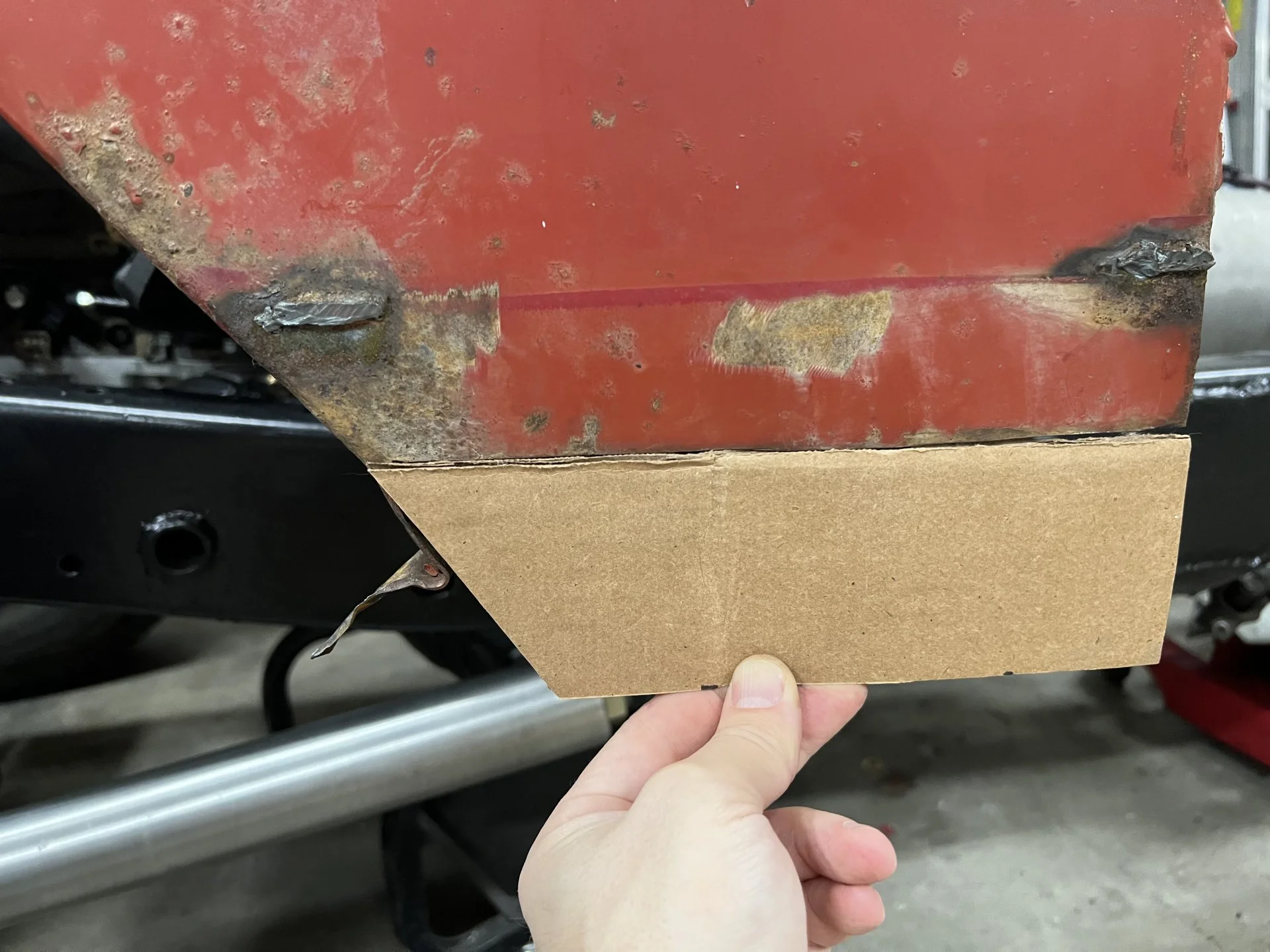

Don’t do that. It is starting to look good. It was in need of some TLC. Mine was pretty worn, too. I noticed today that my windshield is cracked all around the hinges, which is the only piece that I haven’t taken off to inspect. That will be a future task to address. Next is to repair my rocker panels and the floor on the cowl.

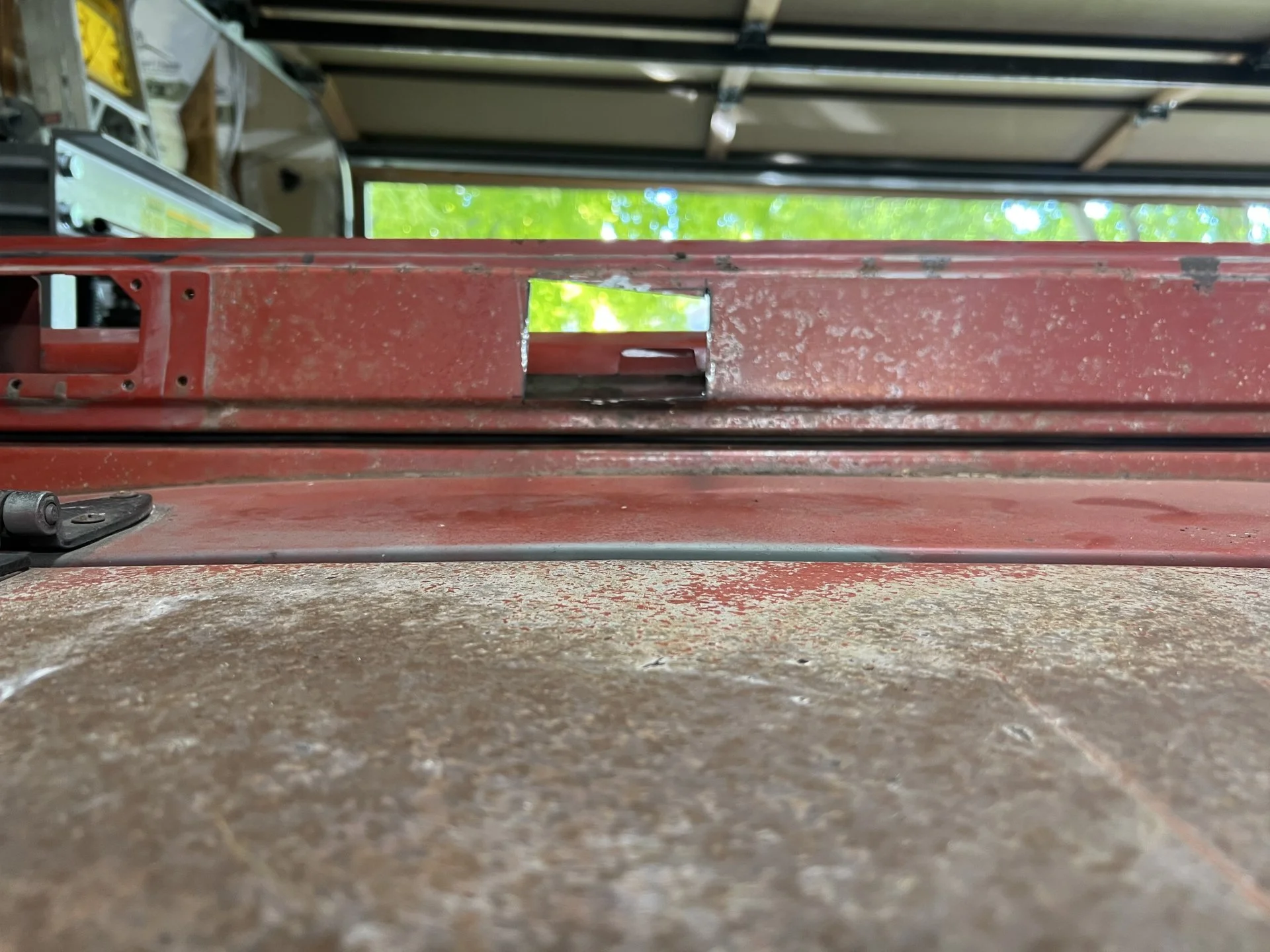

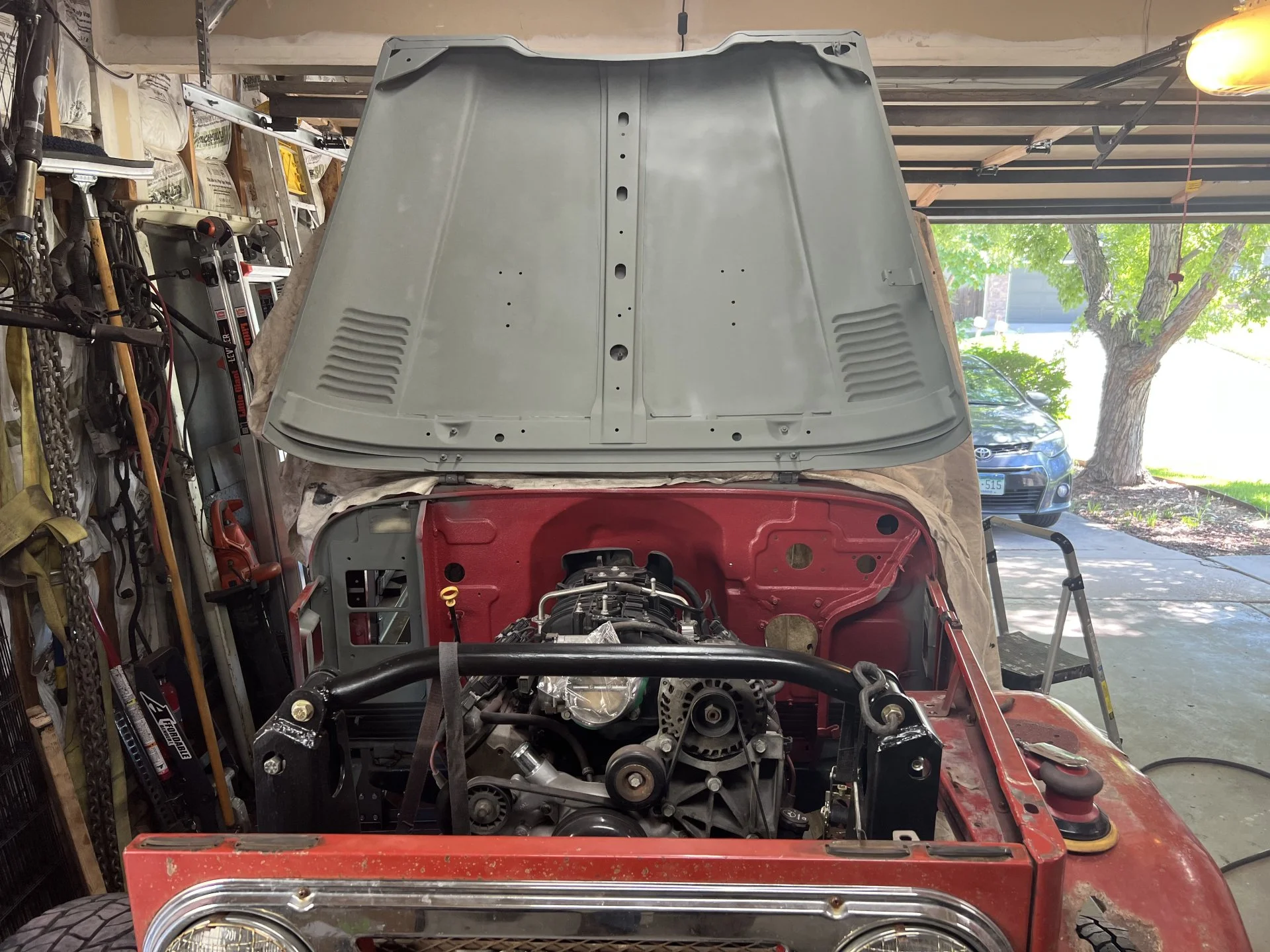

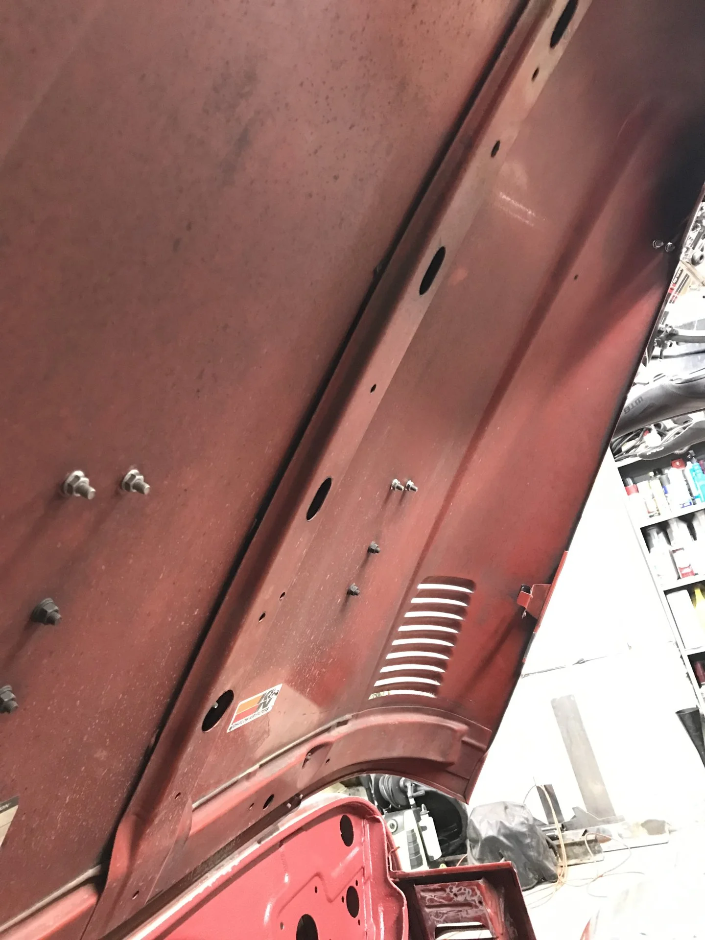

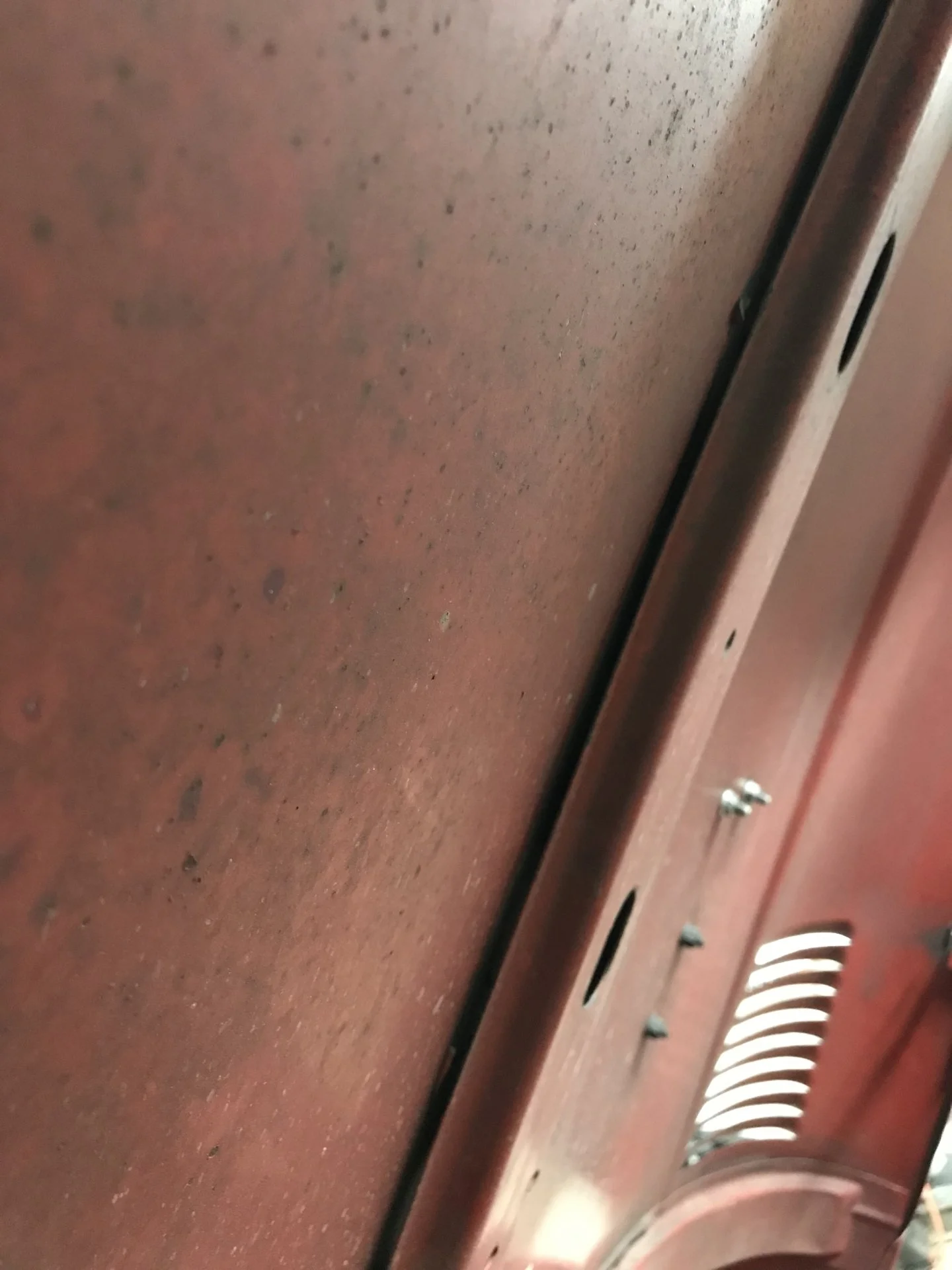

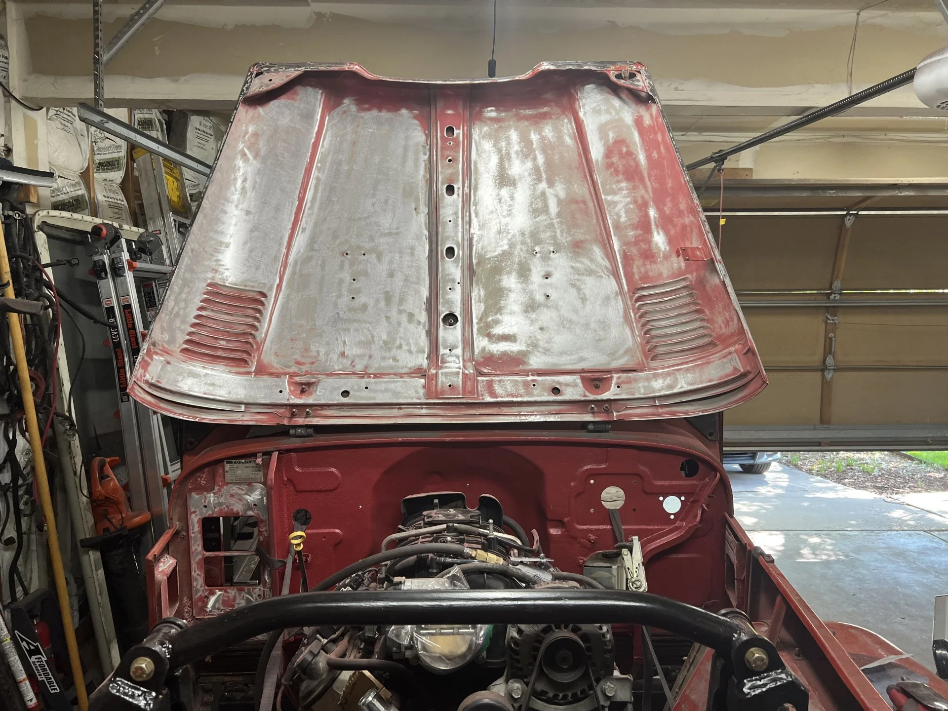

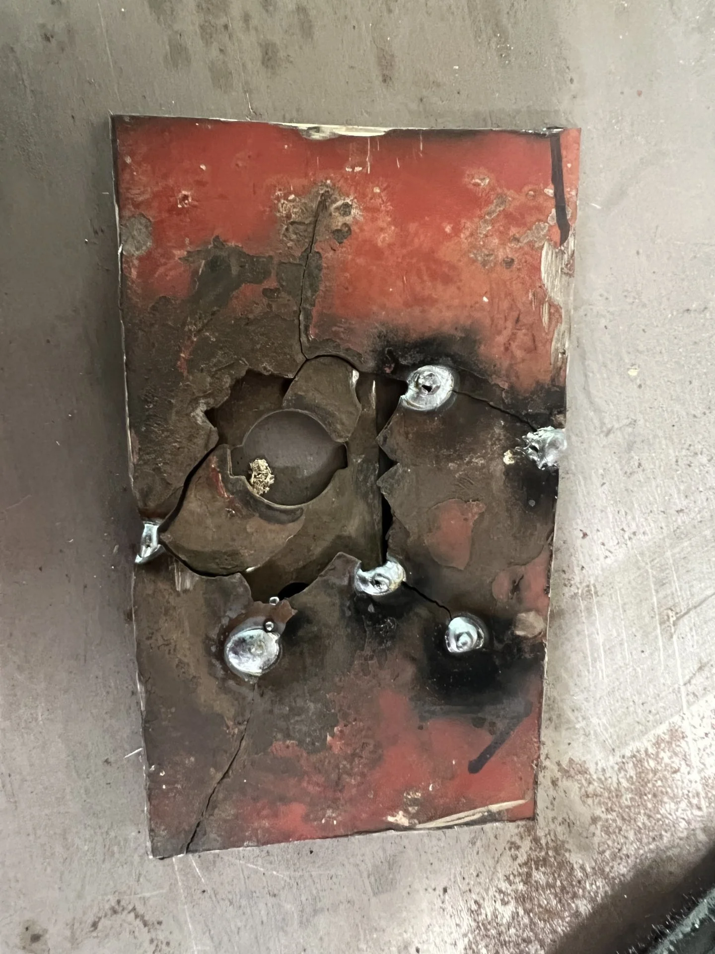

Warpage. Best to bond them imo.
Thanks. I have body seam sealer. Will that work?
You're going to want something with some good adhesion and tensile strength once cured and bonded to both parts. I don't think seam sealer is the right product. I don't have a good recommendation based on experience, but I'm thinking JB weld should work? You'd want to remove the hood and flip it upside down, and then figure out how to clean everything and get them bonded back together.
Thanks for the replies. I’m glad that I didn’t weld the hood. I’ll need to get some panel bonding adhesive, which has a strong and flexible bond. Apparently it also has spacers in the adhesive to keep the proper distance between the body panels.
Thanks for the Silkaflex recommendation, @Firemedic831.

Panel bonding adhesive. Tons of varieties out there. Sikaflex, seam sealer, those would work for a period of time, but not permanently.
Then again, nothing is permanent.
