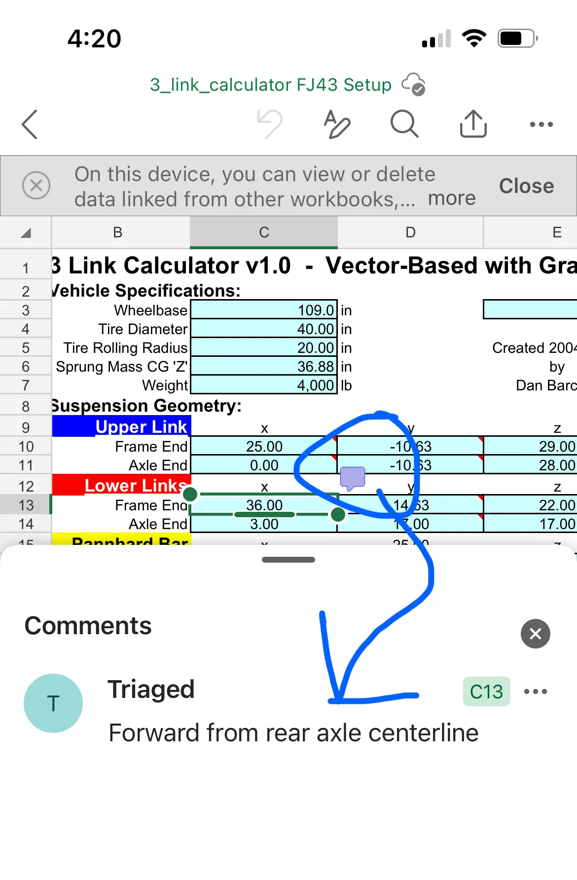

Sweet, with rough mock up I figure almost exact same numbers although my lowers will have WAY less triangulation due to packaging constraints.
IIRC 46* combined between the two of them is considered minimum on a 4 link, not really hard to hit that, most are way over that just because we can.
Not sure if you’re aware of the “how’s my numbers thread” on irate? Very informative and helpful.
Well technically the link length is the x frame end minus the x axle end…so your rear, upper link is 35.13 minus 1.38 long and the lower rear is 39.25 minus 4.13, to clarify for @peesalot .
It’s how you fill it out in the form, and when your filling it out on the later versions it’s much more visual and makes more sense than seeing a chart IMO.
It’s too late to panic but it looks like I may have entered the wrong numbers into the calculator. I’ll need to crawl under the Cruiser to get actual upper link measurements but the rear lower measures 40” from center to center of the bolts, and the front lower link is approximately 36”.
Shenanigans…

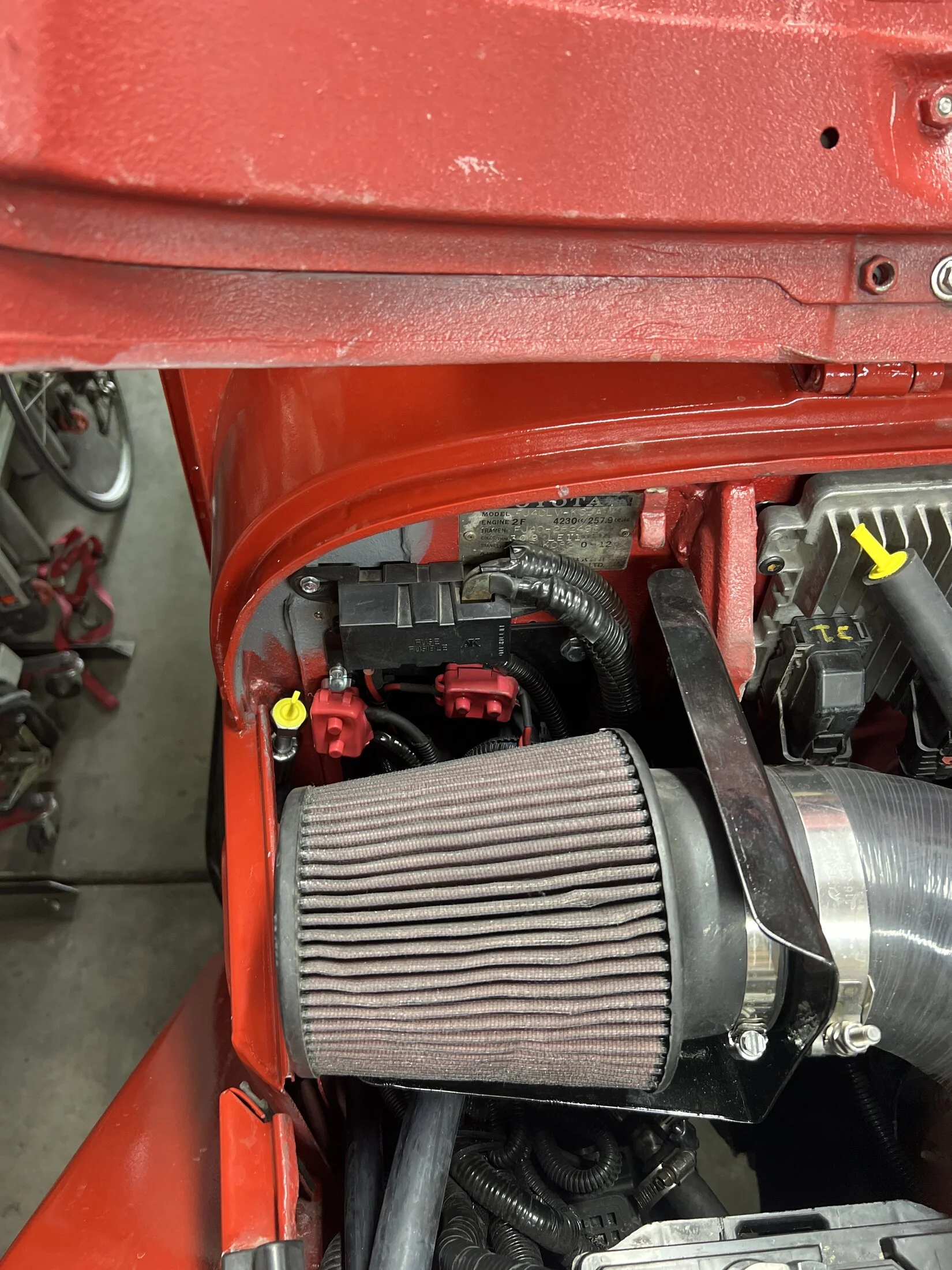

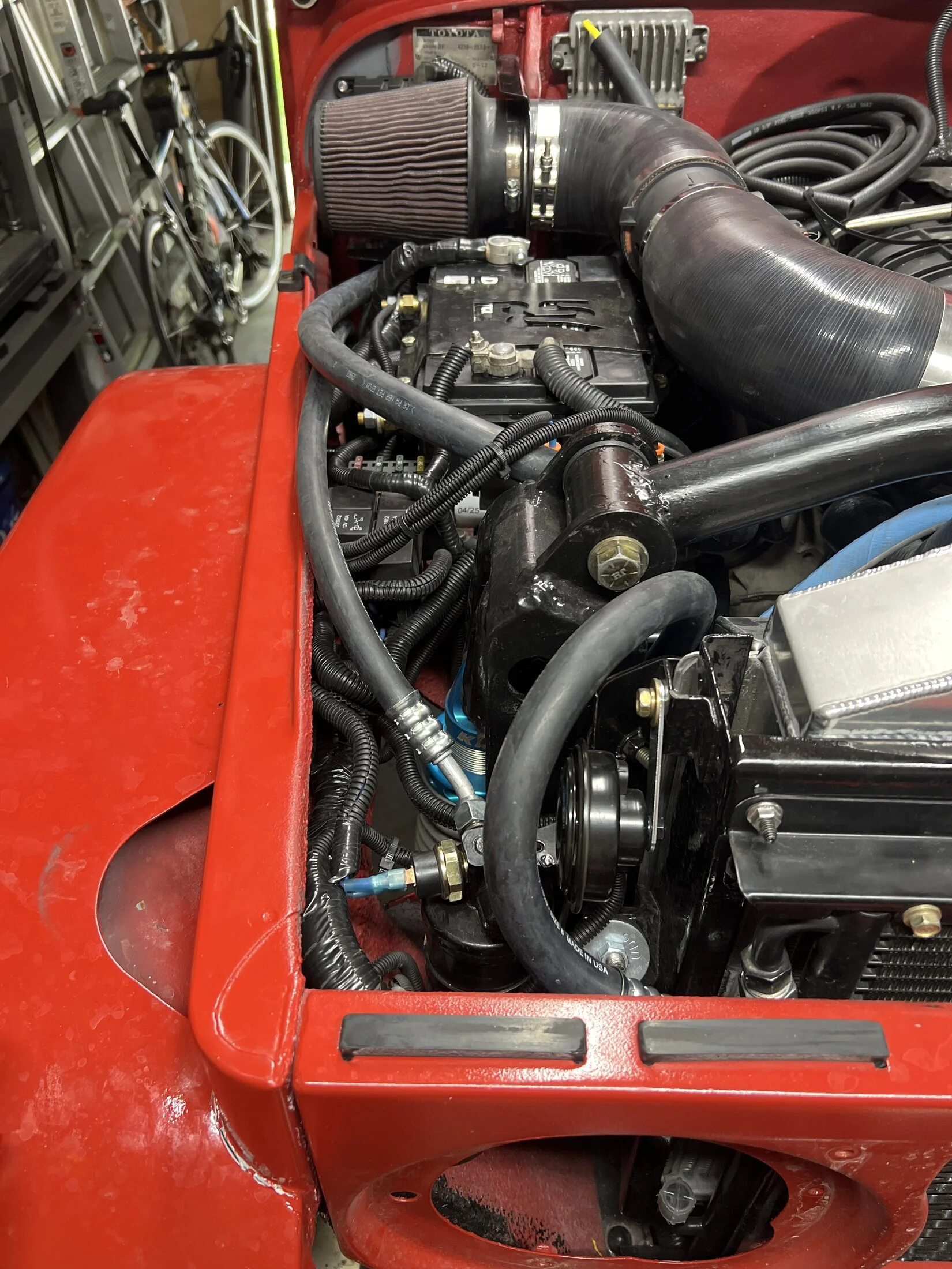

Are you planning to run a baffle or something above the air intake so you don’t suck in rain/water through the hood lovers? I thought about running my intake to the same location, but stuck with it in the middle of the engine bay for now.
I would measure the amp draw if I had a meter large enough but mine is only rated for 10 amps. I can’t imagine that I am pullin
I hadn’t thought about doing that. I’ve driven through some pretty mean rain storms and so far I’ve been okay. I’m not too concerned about river crossings as those louvres are too high for any river crossing that I would attempt. I’ll have to ponder that idea.
What is your air intake temperature running during normal operating temperature? Mine runs about 110 to 130°F when it’s around 80 to 95° outside.
I believe I’m running about 20 degrees warmer than the ambient air temp.
