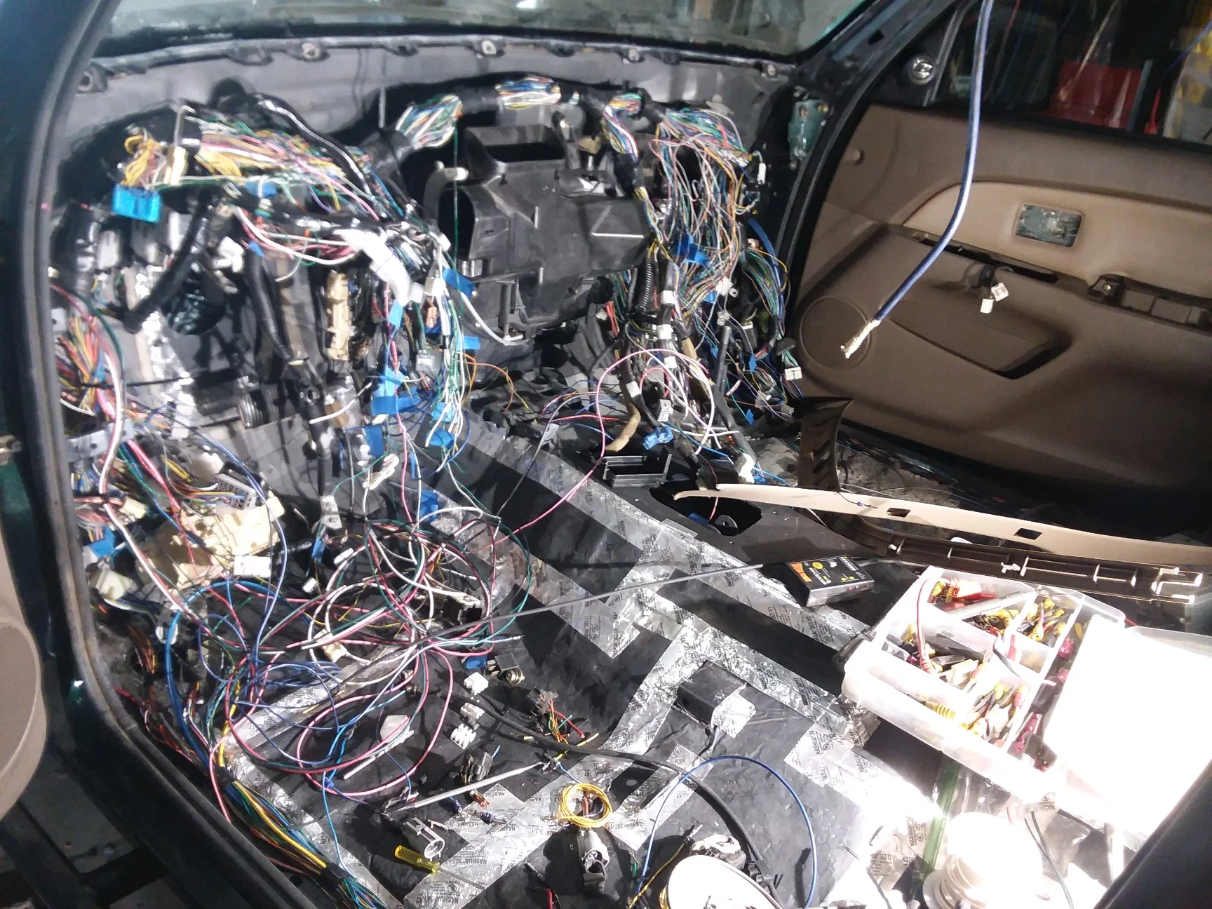

I won’t say it was a quick time pairing down the ls harness, but I glad I did it. When we were on a wheeling trip and I was having issues I knew exactly where to look and wasn’t scared to dive in. Honestly, if I hadn’t paired it down, I might’ve thrown my hands in the air and ordered a new harness. I’ve been loving that motor ever since.

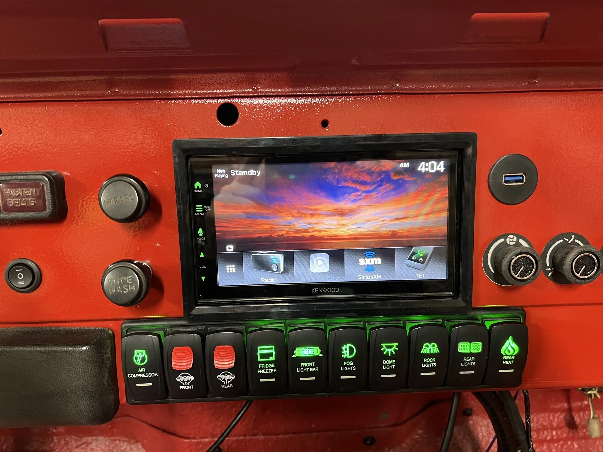

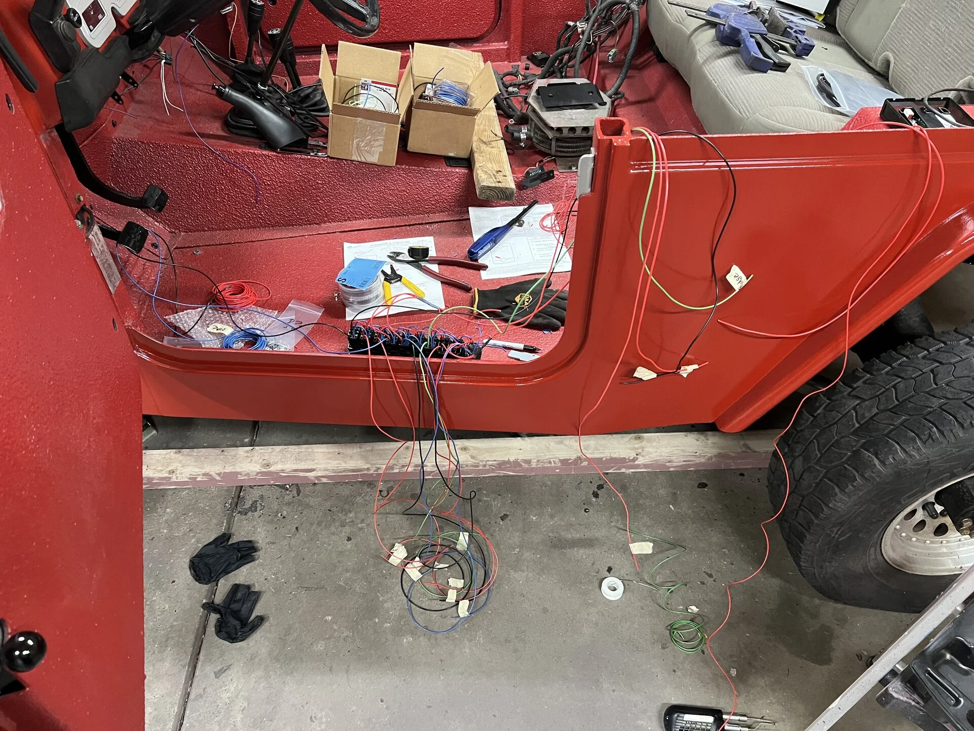

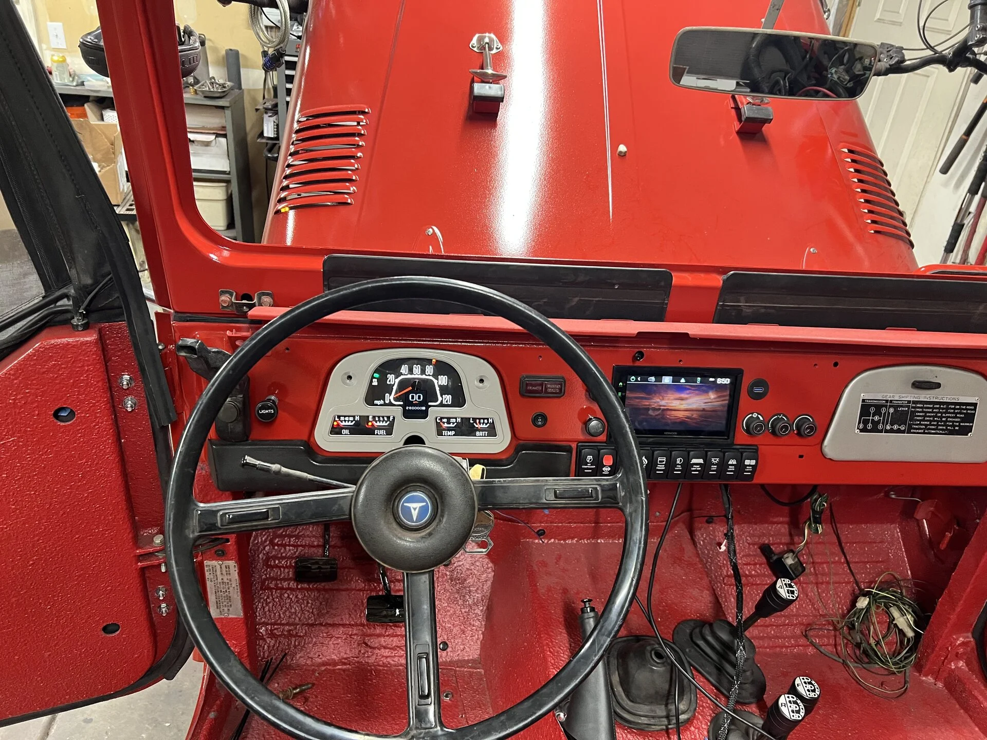

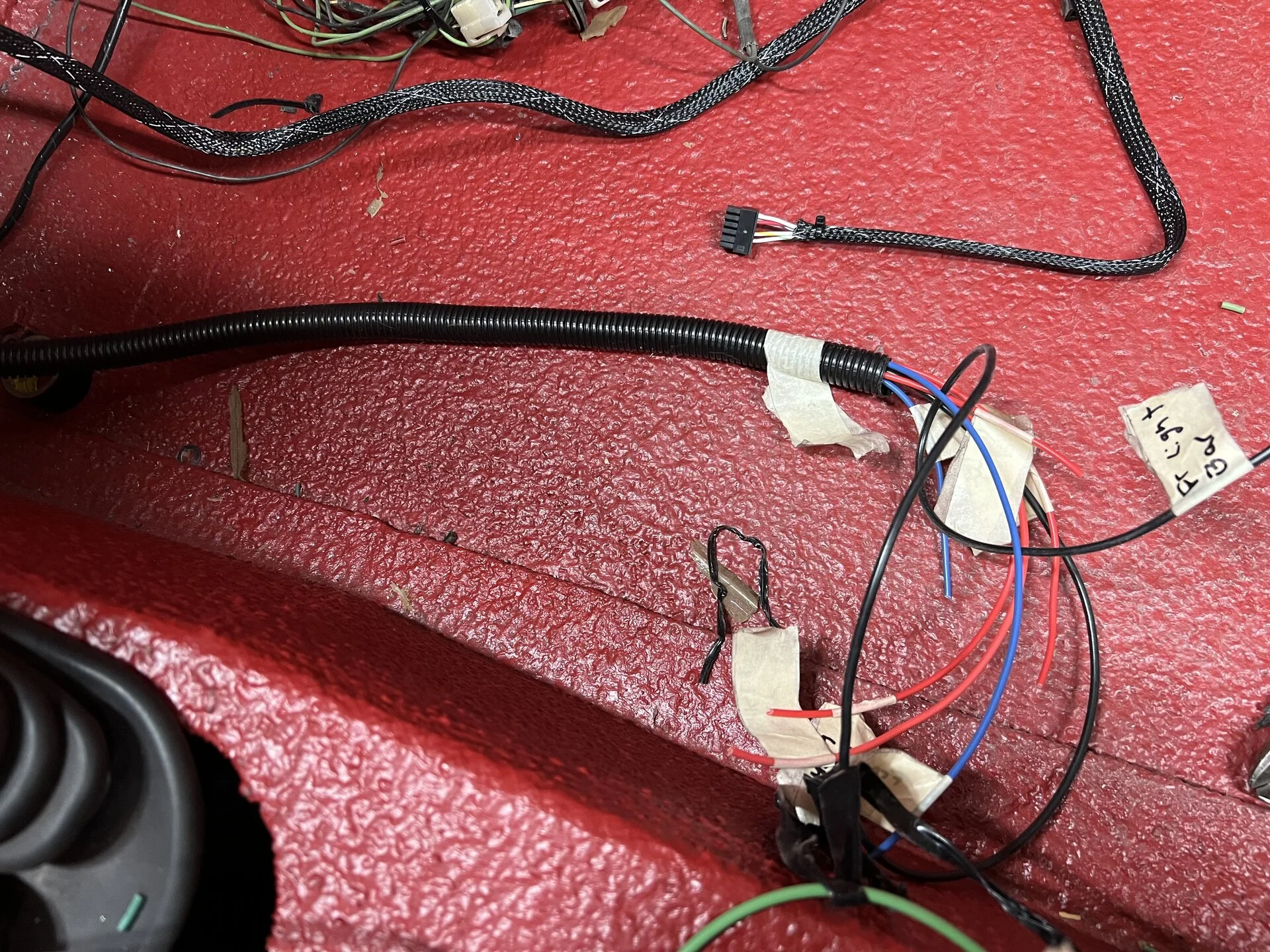

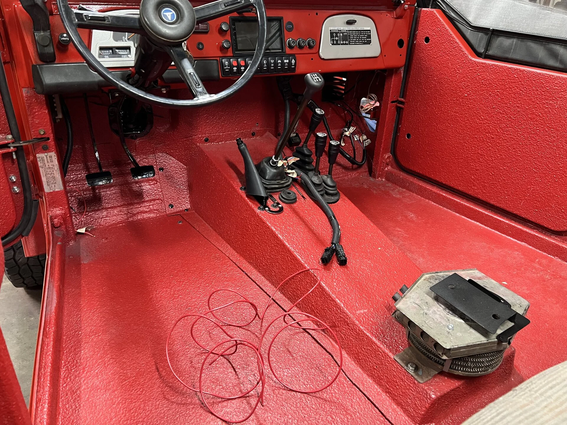

The switch panel is wired! I can’t believe that I spent 5 hours on this.
What are you doing! Now I feel better. Thanks for the shock. That looks like a lot of work!

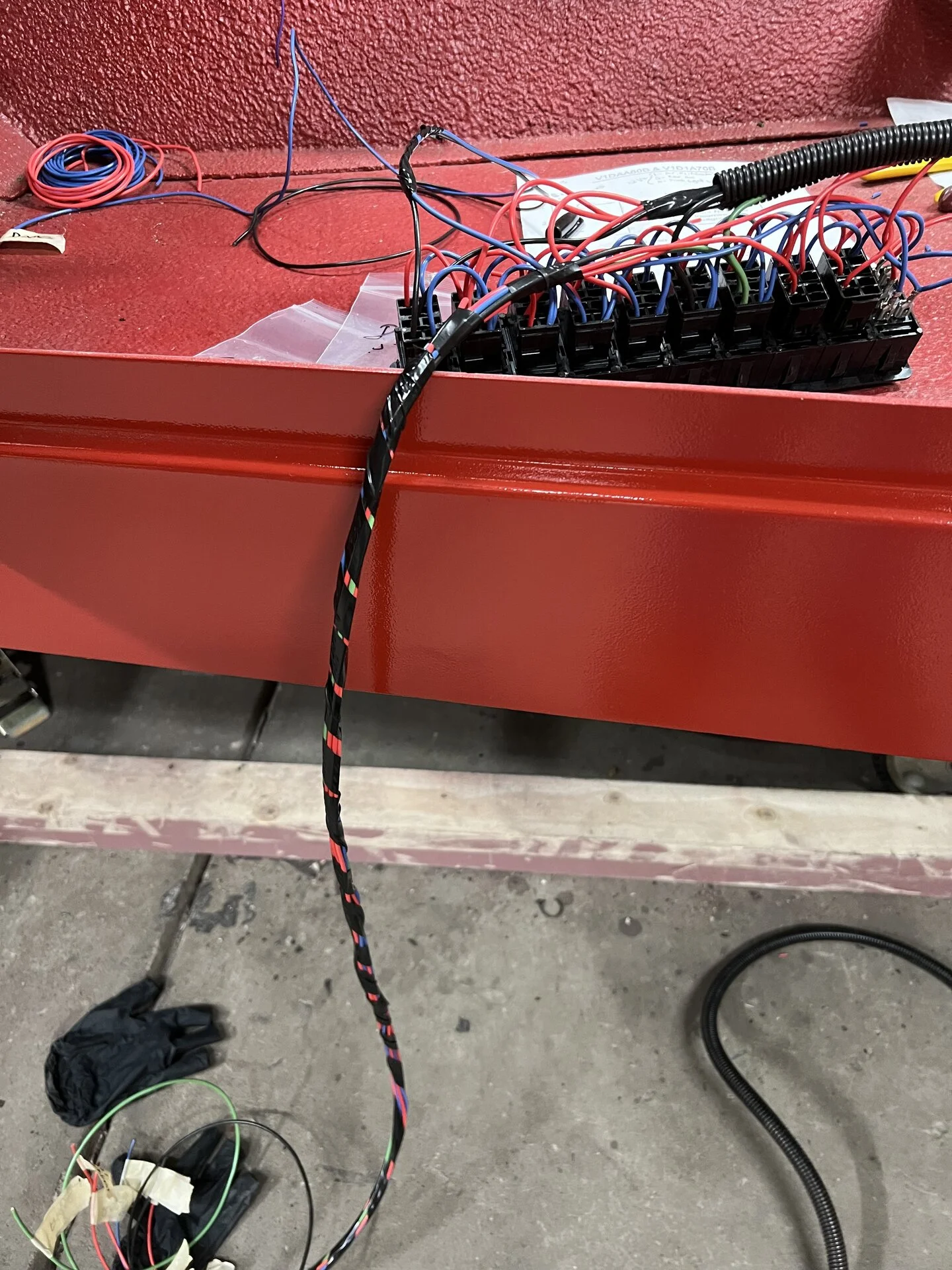

running a diff engine, trans, tcase, fuel tanks and pumps (wired said up to switch on the fly between tanks), electric cooling fan, light bar, ARB locker F and R, and a host of other things that require custom wiring to integrate (wired said so they are on/off in key on/off to not accidentally drain the batteries. What you see in the pic is only a piece of the wiring, trying to keep things looking OEM as possible, rewired the engine bay fuse/relay box for my needs and amperage requirements, using Toyota switches to control the ARBs, heated seat, and integrated the dash indicator lights to show when the ARBs or on/off, the Atlas is in rear/front positions, the air compressor is powered and other stuff.
I’m glad that you mentioned your 4x4 lights. I almost forgot to run a wire to my transfer case.

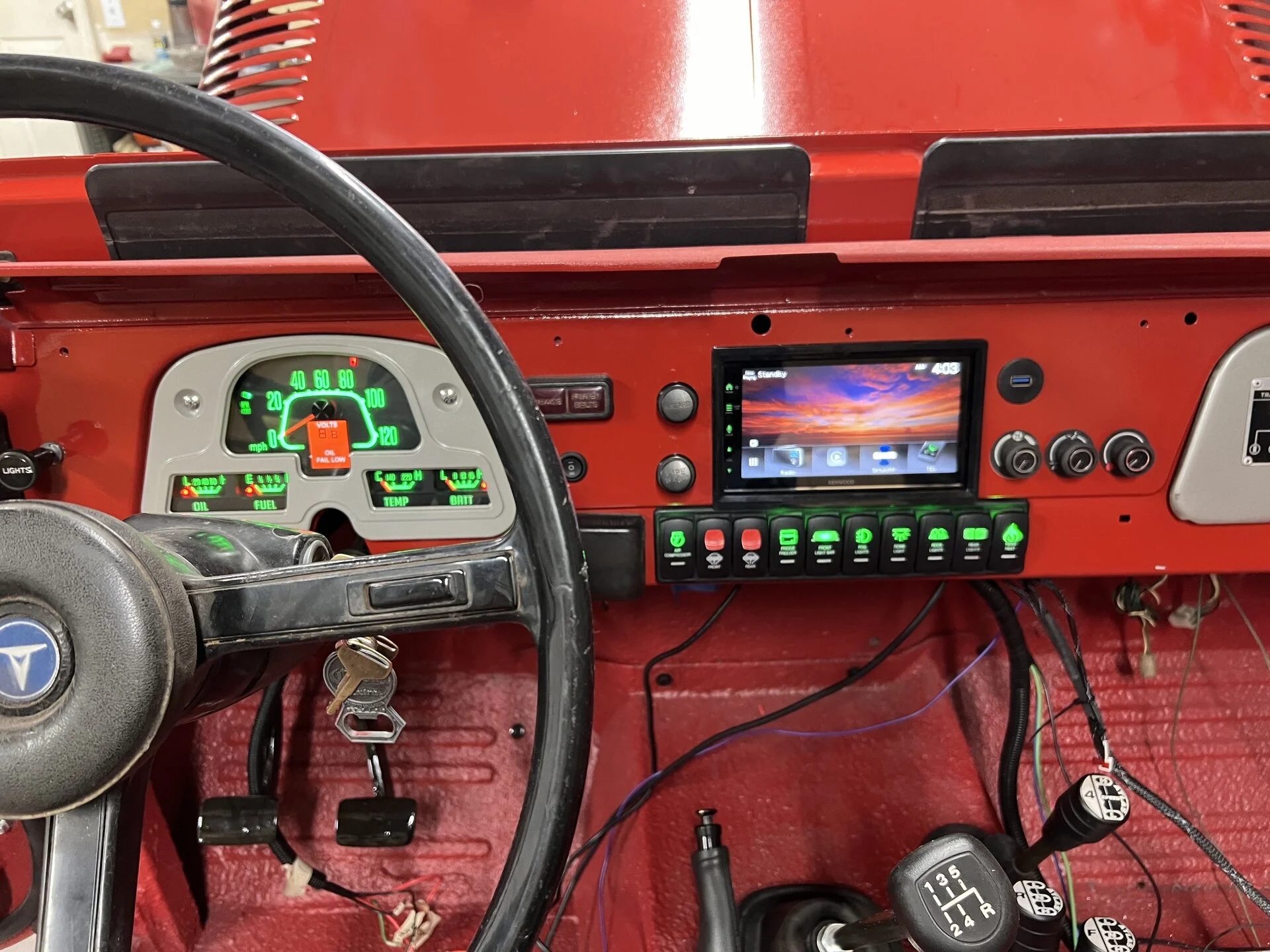

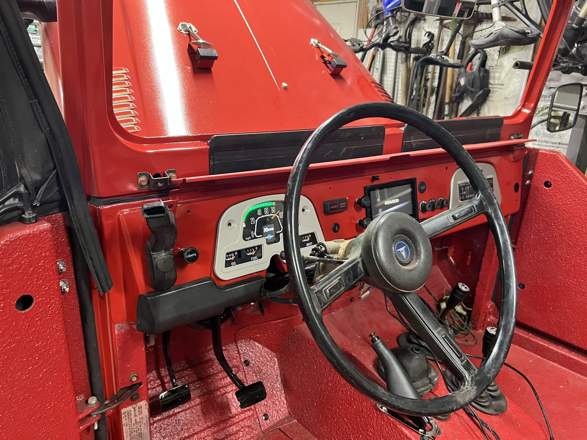

That’s enough for now. I still need to add a few more wires for the trailer brakes and radio antenna, etc., but I think that I can sneak them in later. Tomorrow I will pull the trans cover and tighten up a few things, then install for the final time, then I’ll button up the A/C and start working under the hood!

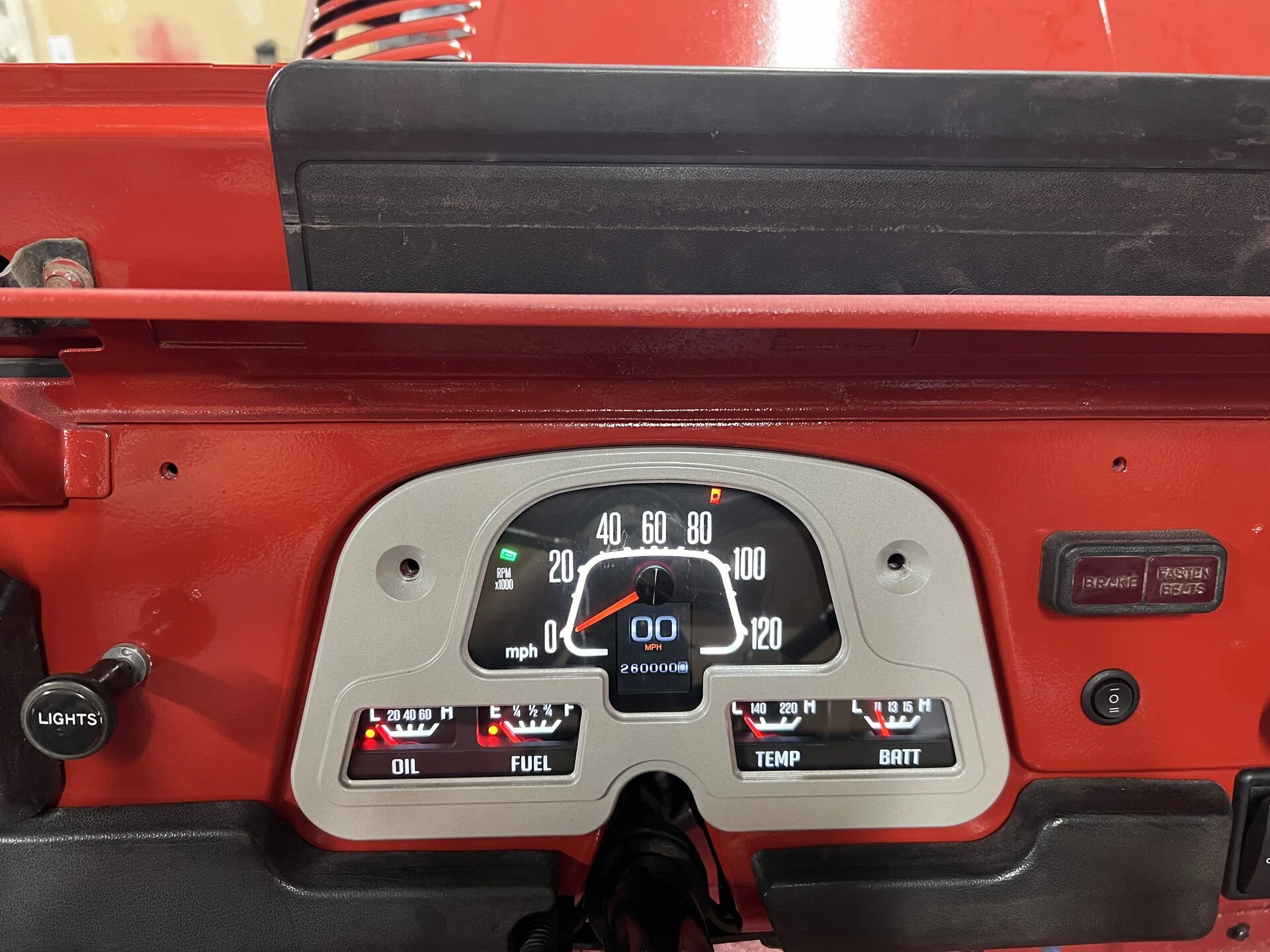

Small wins this weekend. I did not get to the HVAC, but the cluster is about 80% wired. I had some trouble with the brake warning lights and that set me back a few hours before I decided to stop. I’m not sure why that light doesn’t work but the wires have no ground/power. That’s a problem for another day.

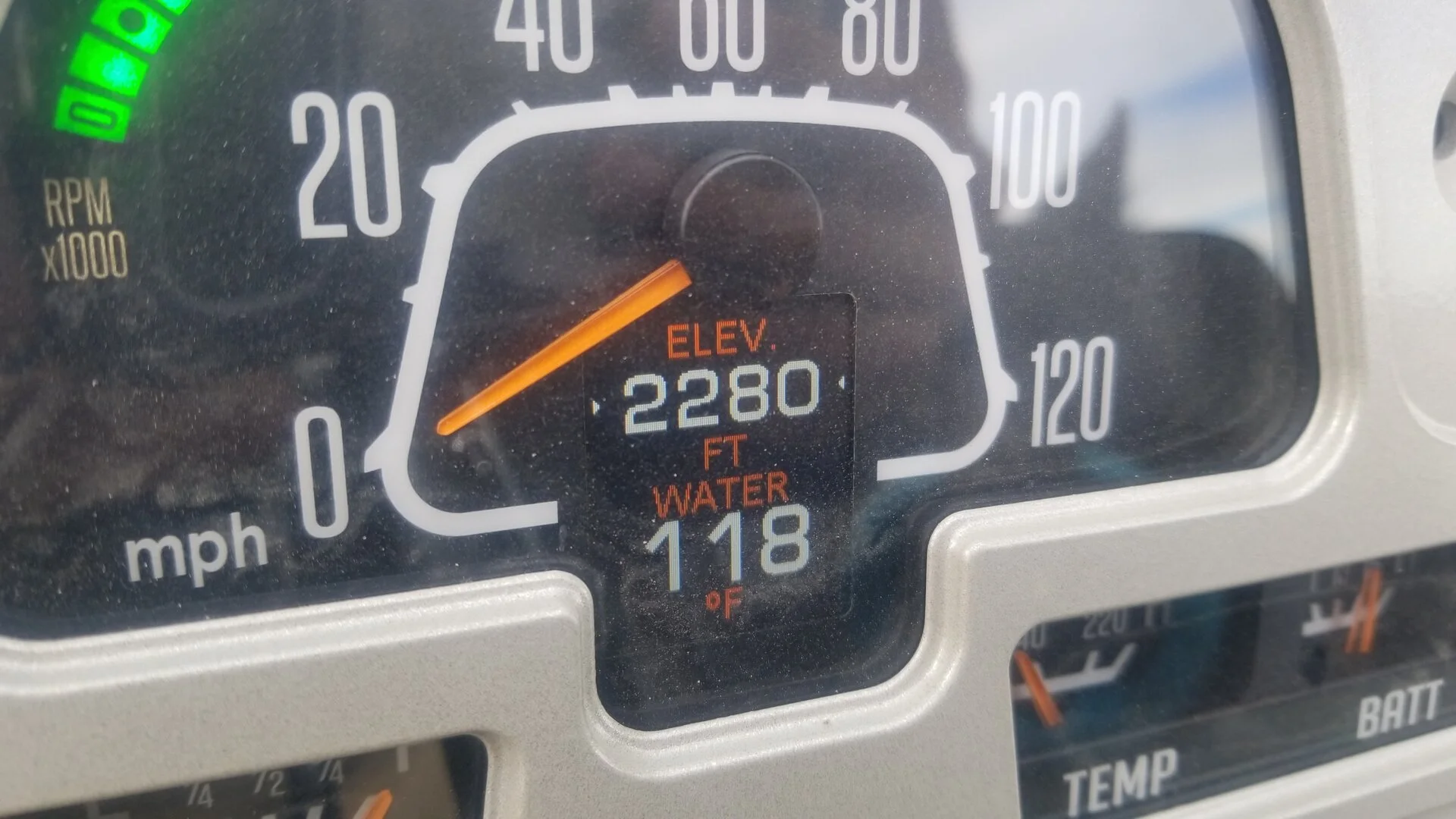

My favorite feature of the DD gauges is when you use the GPS module for speed, you can display elevation in real time since its using satellites for the speed. It will also display outside air temp with a small included wire thermometer.
Nice! It seems like Dakota Digital doesn’t advertise all of the capabilities as I don’t remember seeing elevation as a feature. I’m already hooked up for an electronic speedometer and my radio came with a GPS antenna so I need to figure out whether the radio can display elevation. I did get the outside temperature module.

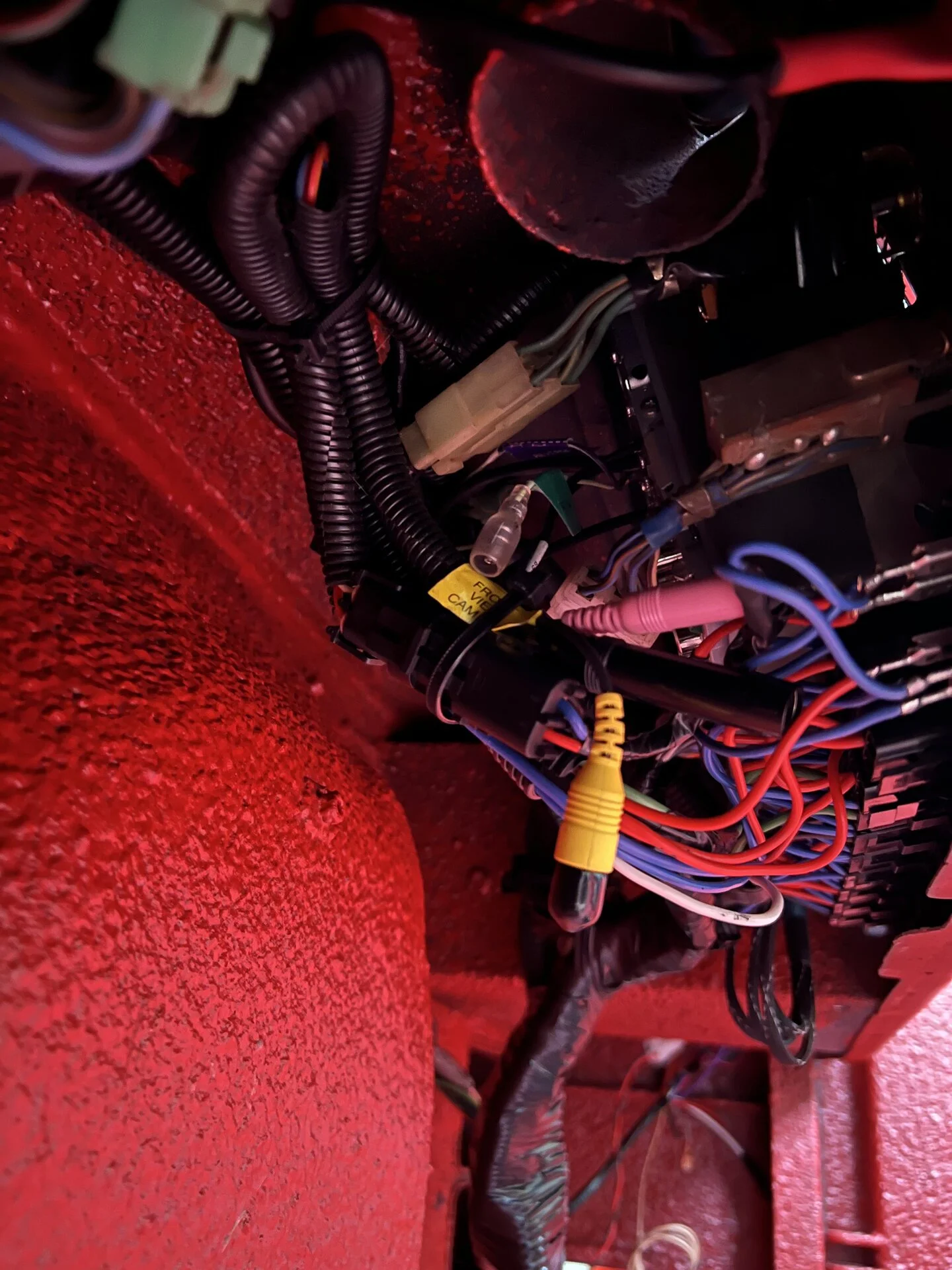

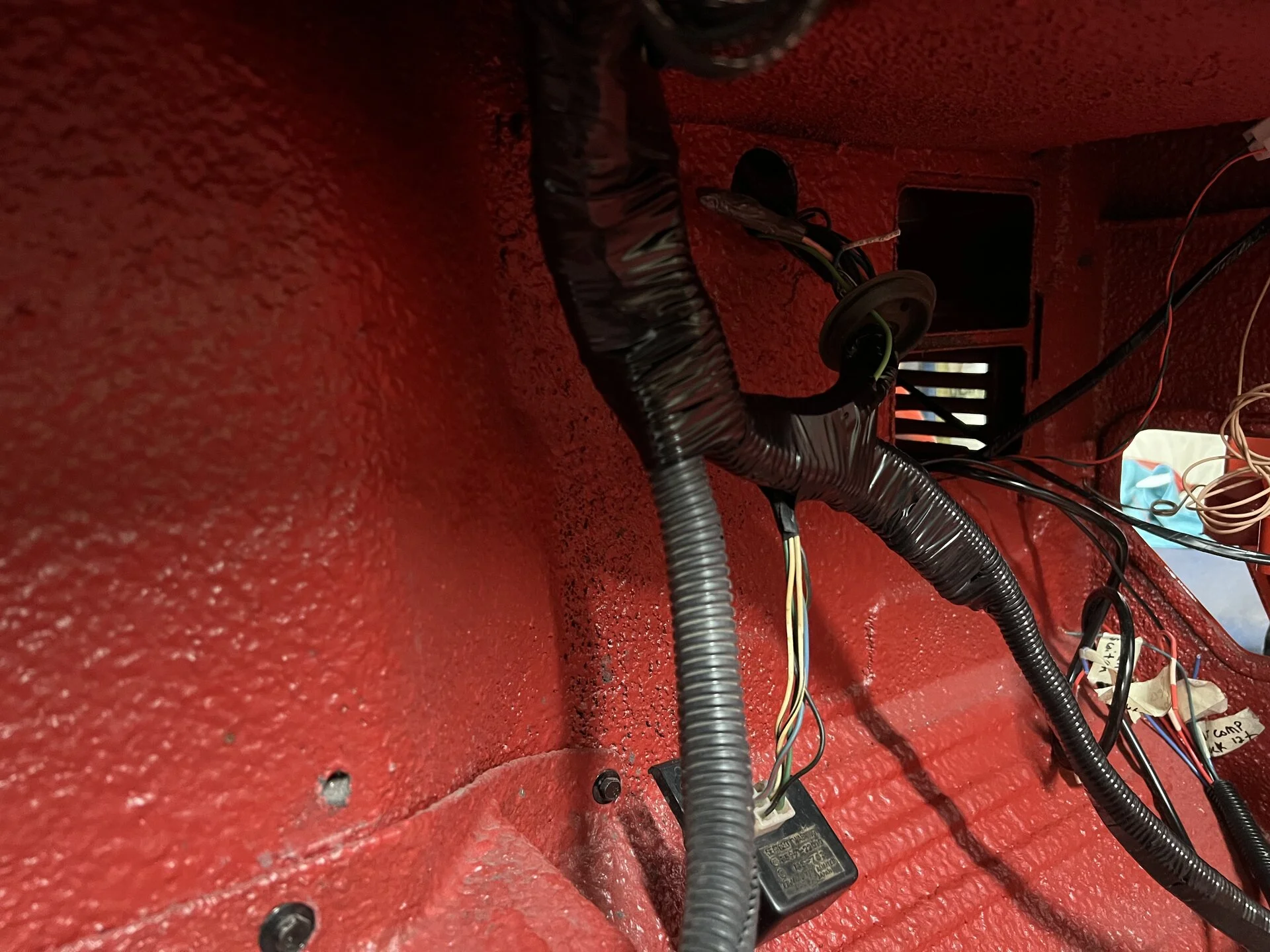

Thanks! I didn’t post anything yesterday as my wire trunk that I built for the right side under the dash was too thick and wouldn’t allow enough room for the heater to bolt in. I’ve cut into it for the third or fourth time to relocate the wires…but to where? Ha! I got up early this morning to assess.

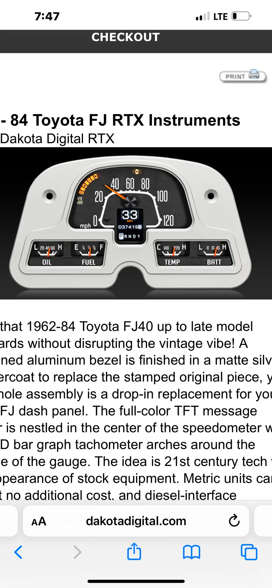

Why 🤦🏻‍♂️Why do I look at other builds 😃. And then think I can not live another day without certain parts. Oh why oh why

I see that you are showing us the checkout window, and your battery is almost dead so you must have been pondering this for awhile. Ha. Some advice if you are really interested in this cluster (I don’t see why you wouldn’t be. Ha!), these are on a two month back order from Dakota Digital. Summit and Jegs both had them in stock and they are $50 cheaper. Summit had 6 left when I got mine. Just saying.
