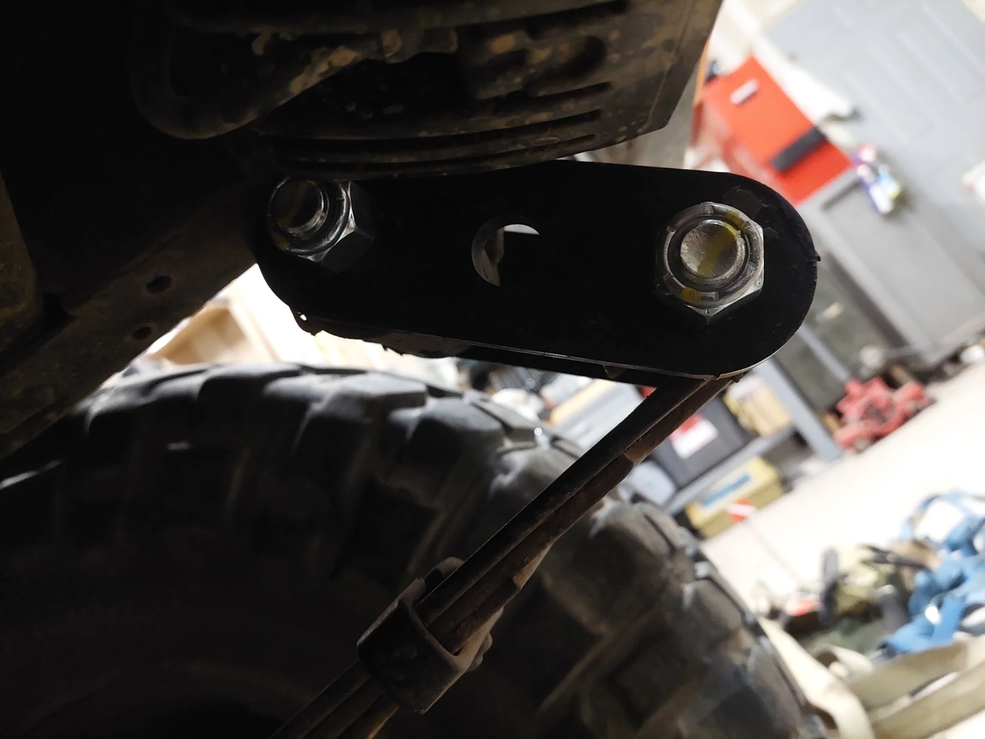

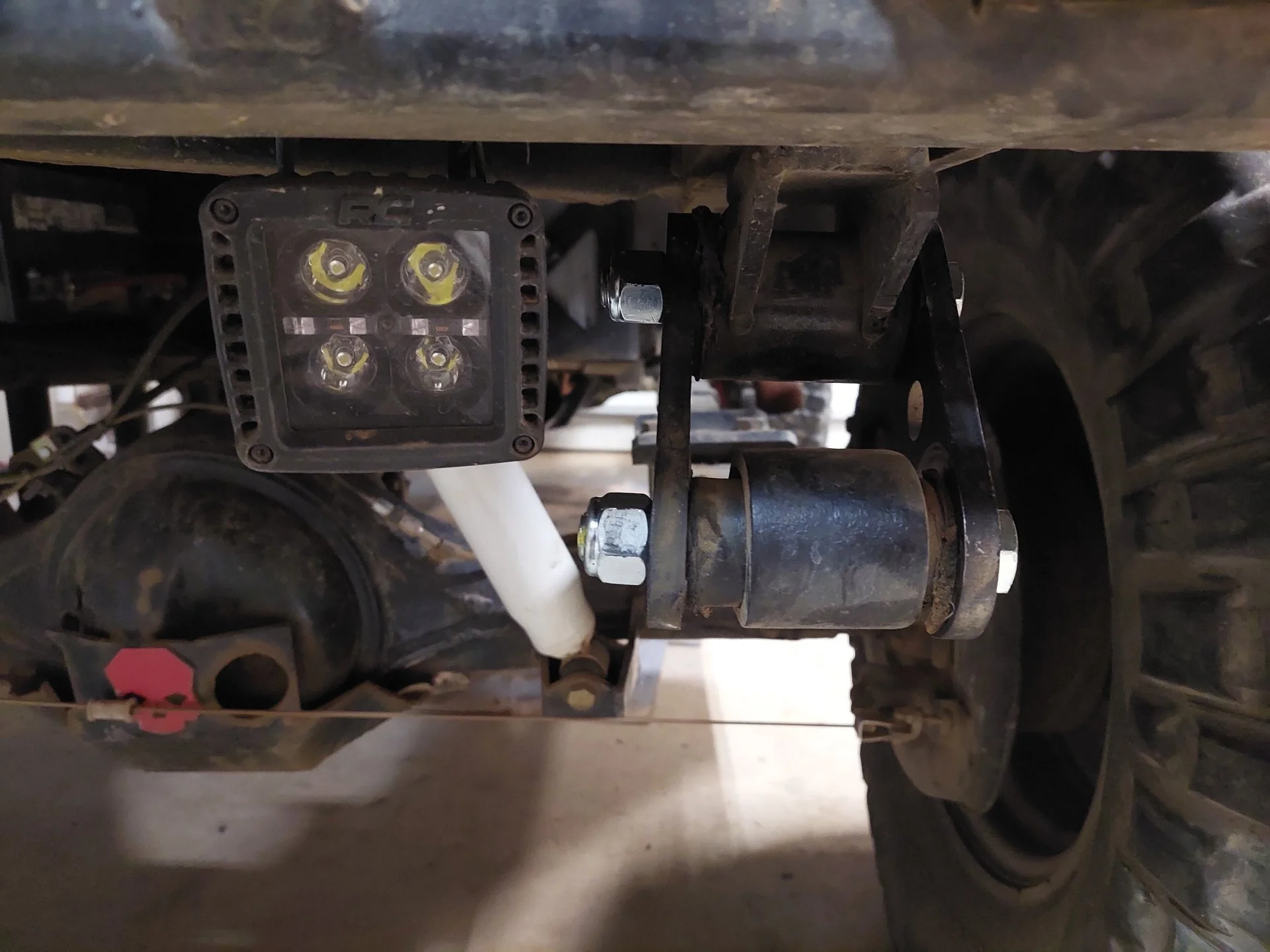

Well, I finally got around to changing out my shackle and leaf bolts and moving my links around a bit.
New 4 1/2" x 5/8 bolts for the shackles. My previous ones were about a quarter inch short, and I had one nut back off (Thanks for the magic bag of hardware that saved me, @Godfather90) at SAS this year, so I just cranked them down till I got around to changing them out.

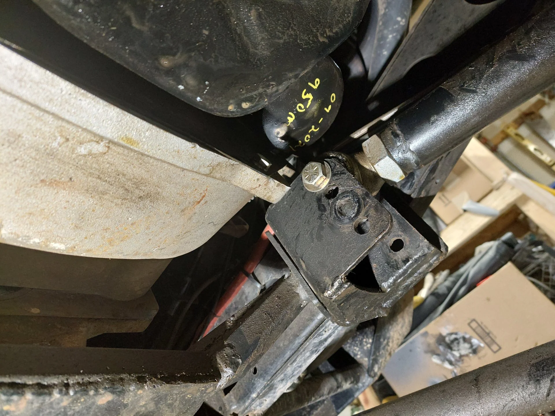

I got my upper link moved up higher. Hopefully, I can limit the unloading on big climbs, now. I'm probably going to turn my 8274 into a suckdown since I have in-cab controls for it anyways.

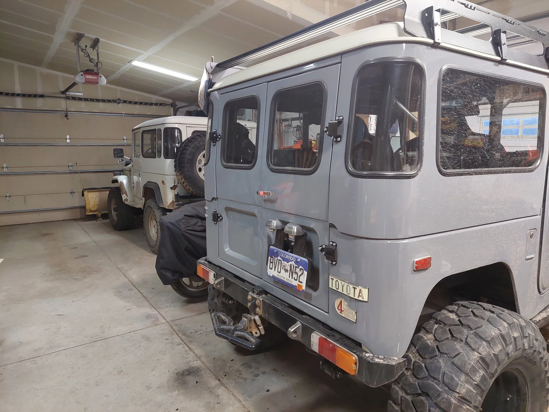

And a picture of the herd hiding in the garage.

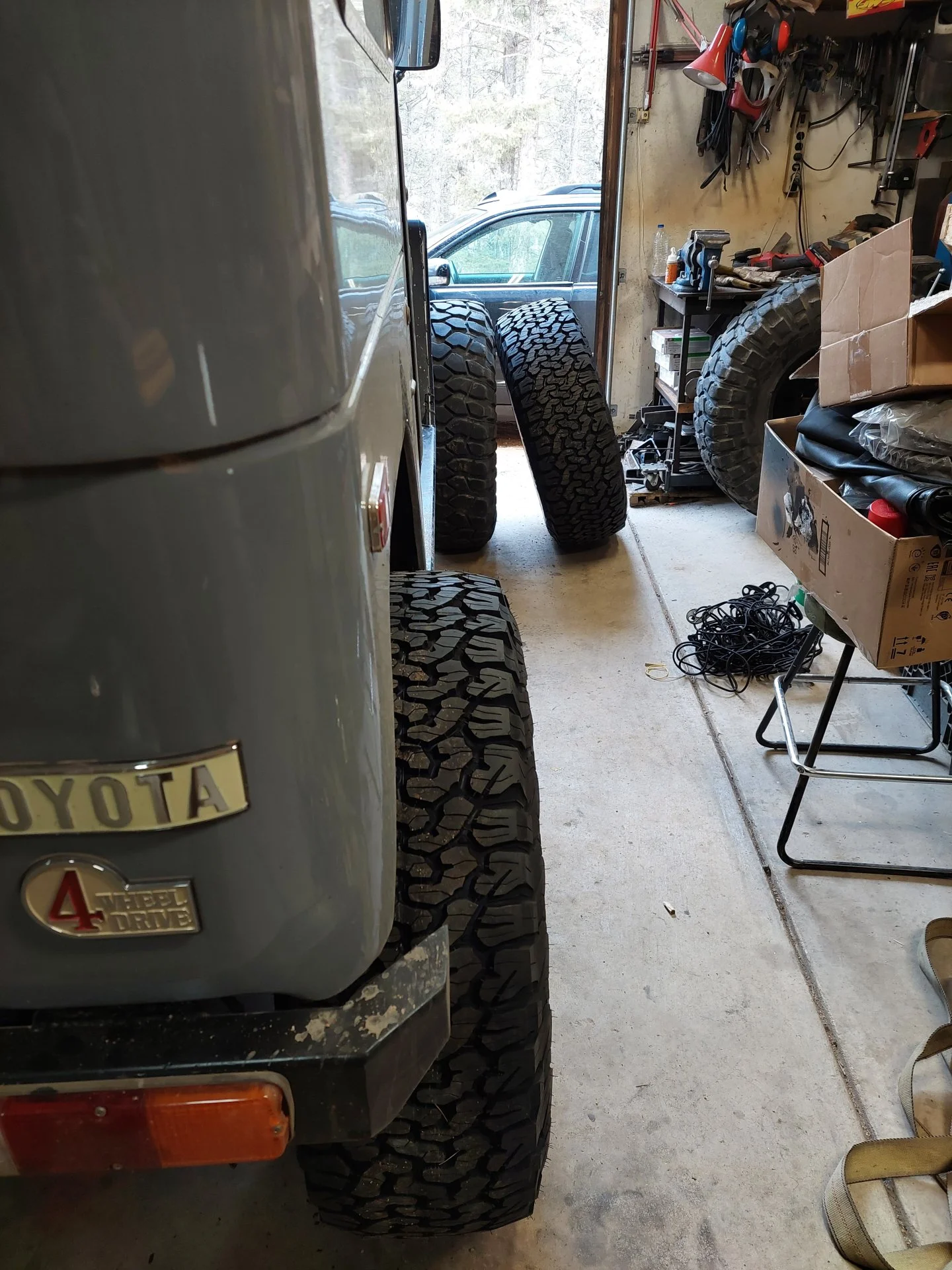

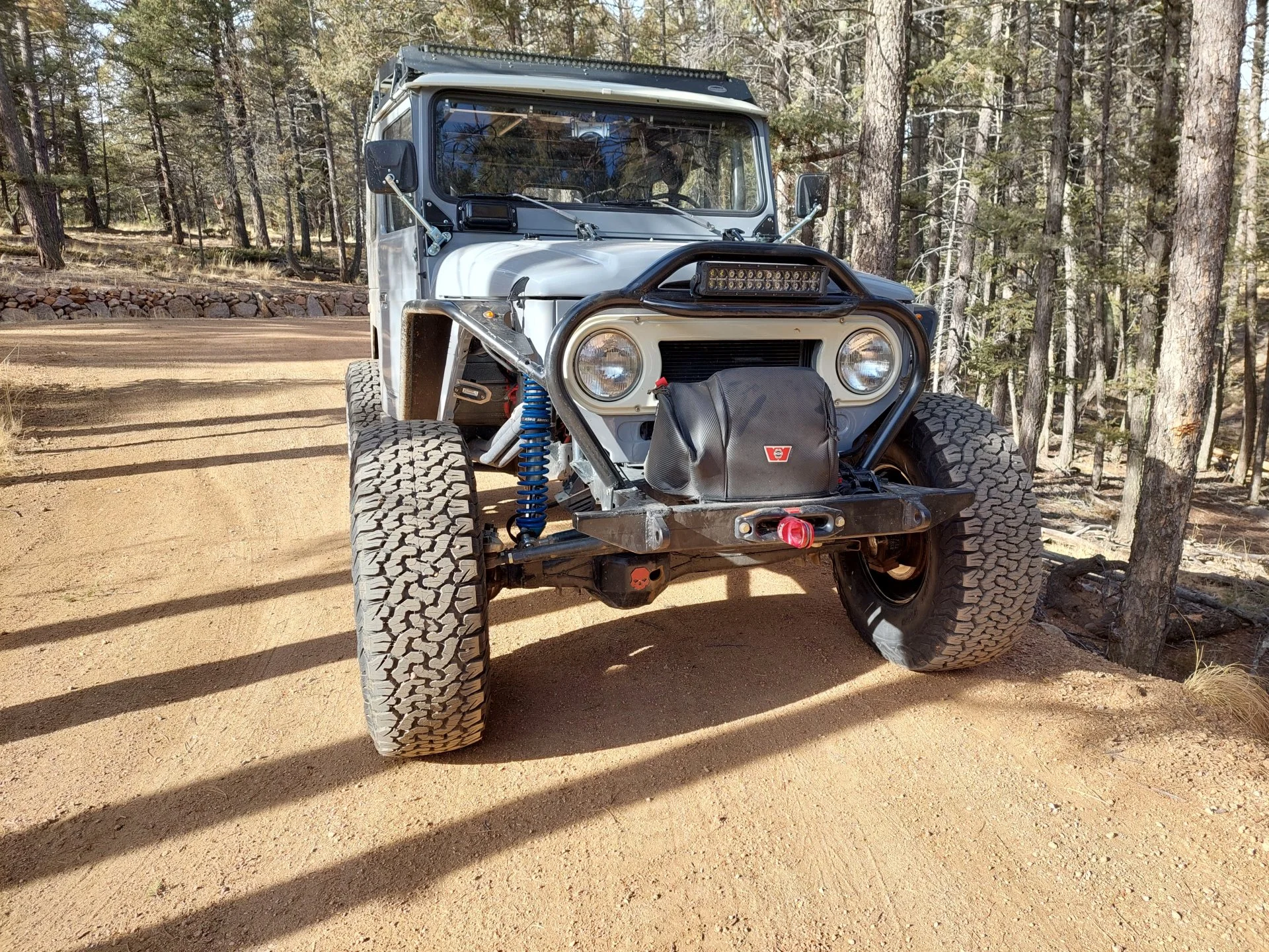

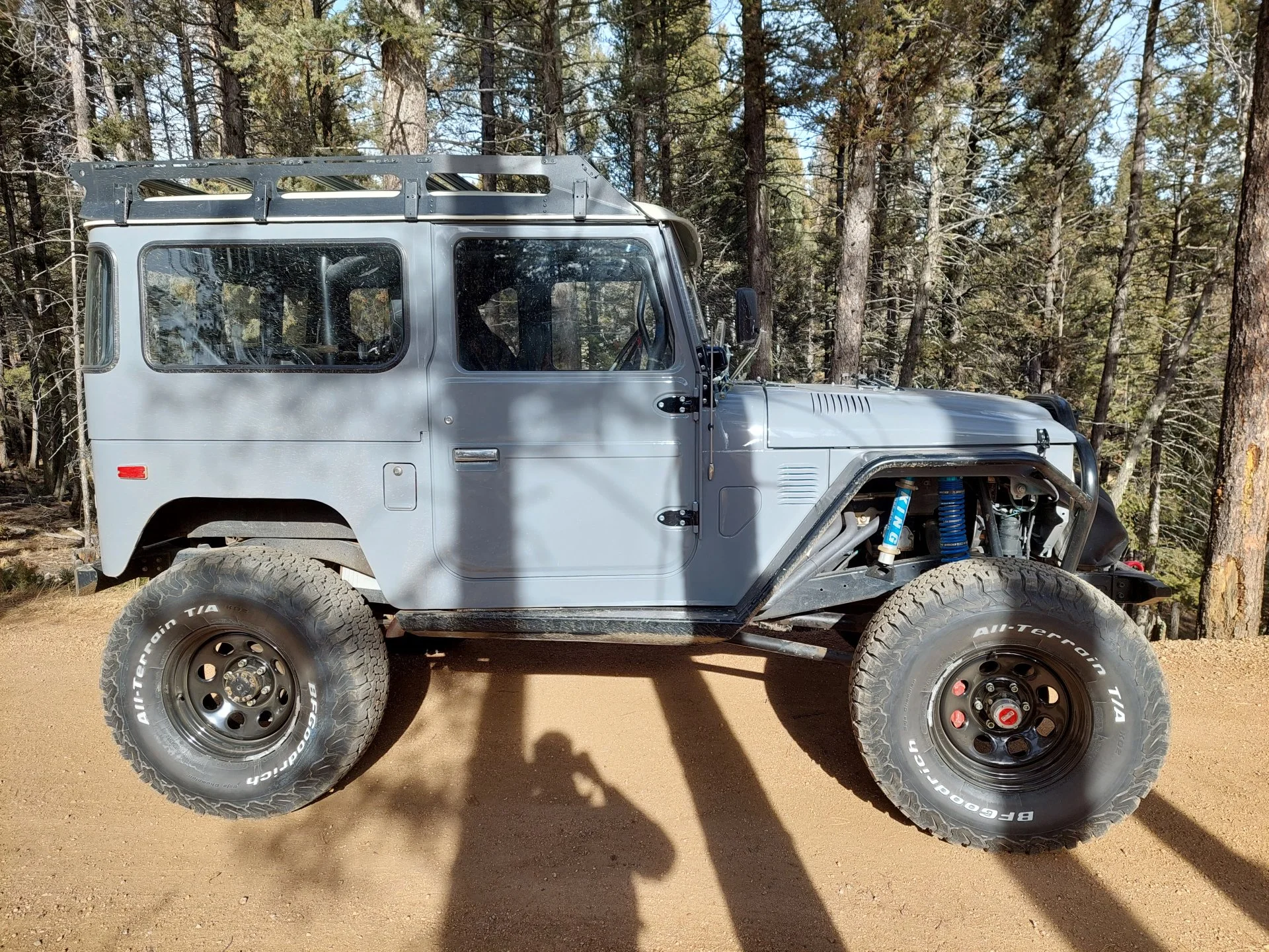

Well, I finally got around to getting new wheels and tires so I can go snow wheeling (if there was snow)
Anyways, I made a mall crawler.
New 37 × 12.5 × 17 KO2s
I'm not super in love with the look, but the on-road performance and snow traction is well worth it to me.
I went with Pro Comp steel crawler wheels, since they were on sale at 4WP, and I like the looks. They are also lower offset which is nice for a road wheel.
