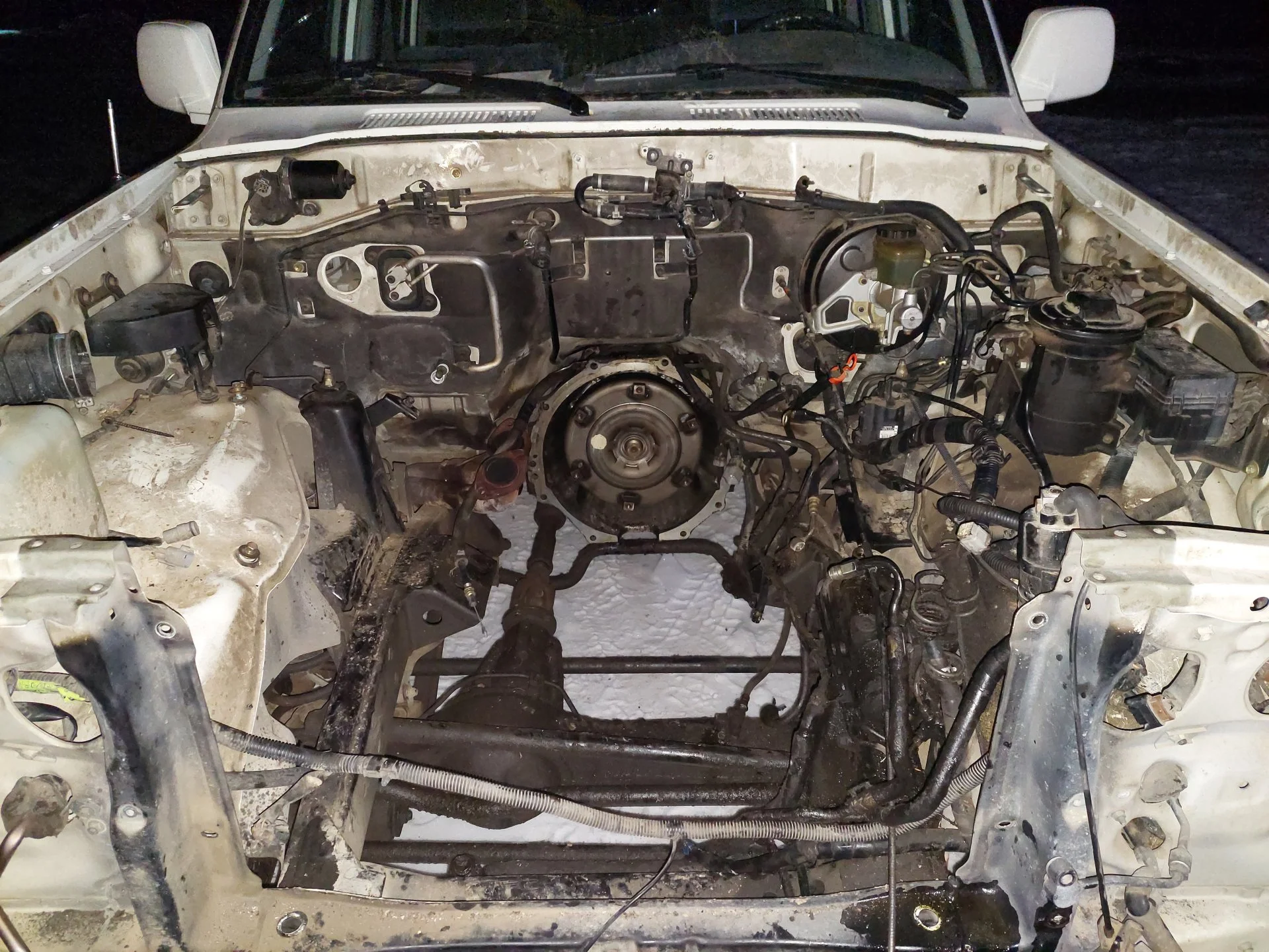

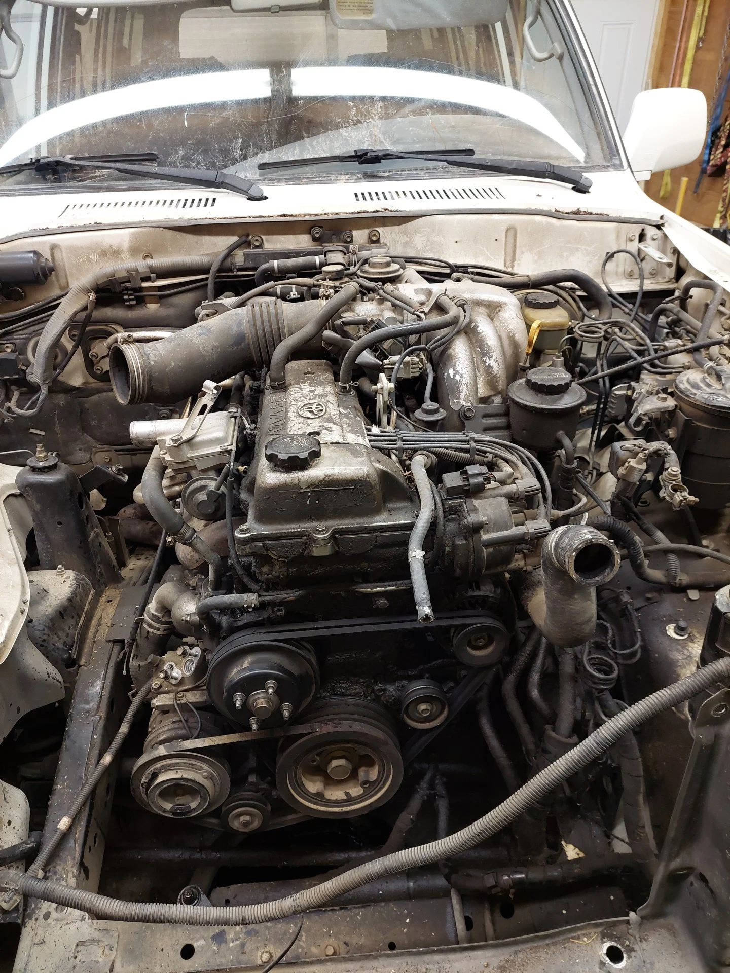

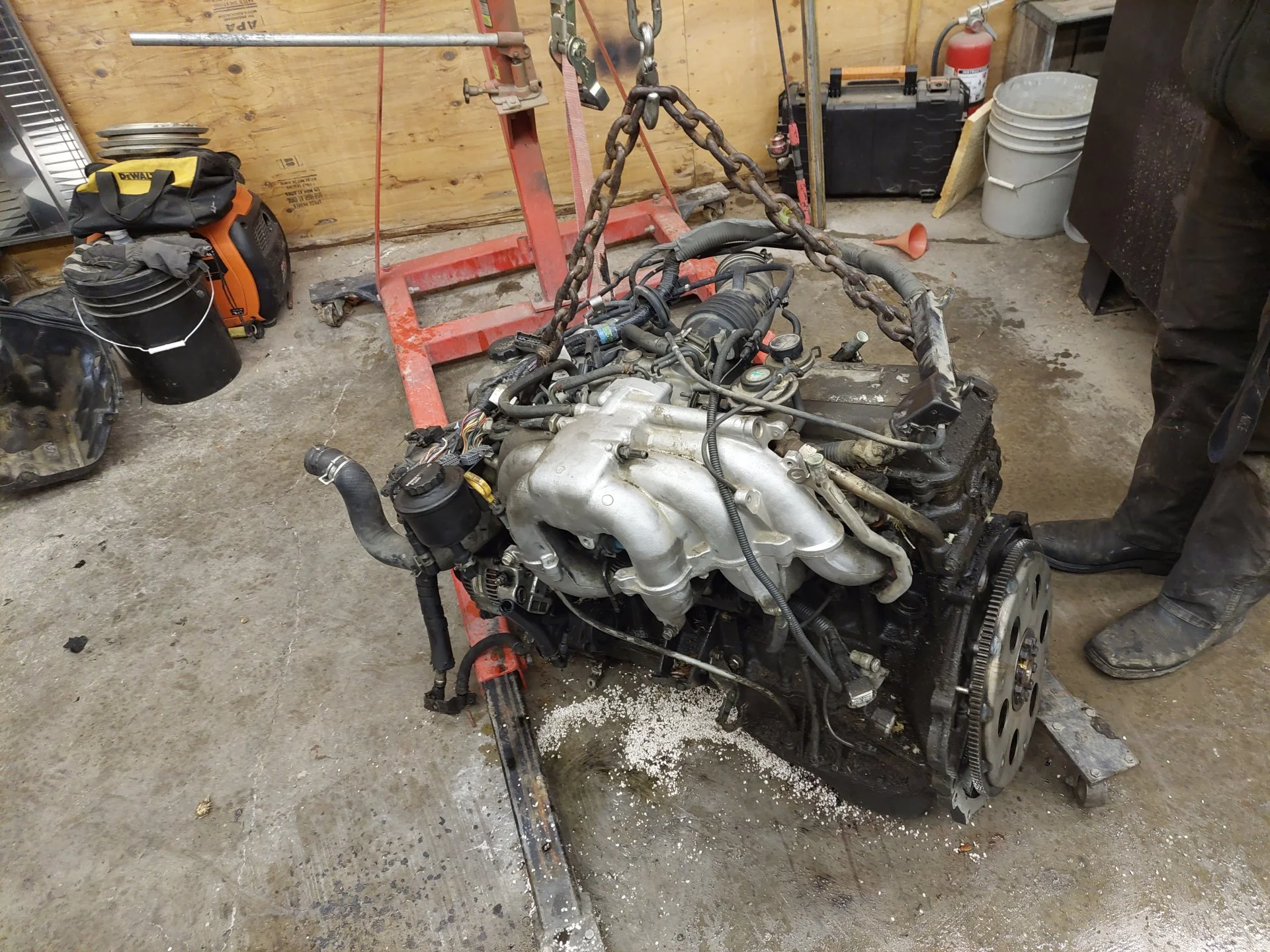

Not my rig, but one from work. Pulled this slightly holey 1FZ FE. We are pretty sure the guy ran it low on coolant (there was less than half a gallon in the block and rad combined), overheated it, and freed rod #1. It took a little less than 8 hours. Those upper bellhousing bolts were a PITA, as usual. It was also about 5* outside, but about 35* inside, so nice and warm.
Planning on shoving the new one in next weekend.
