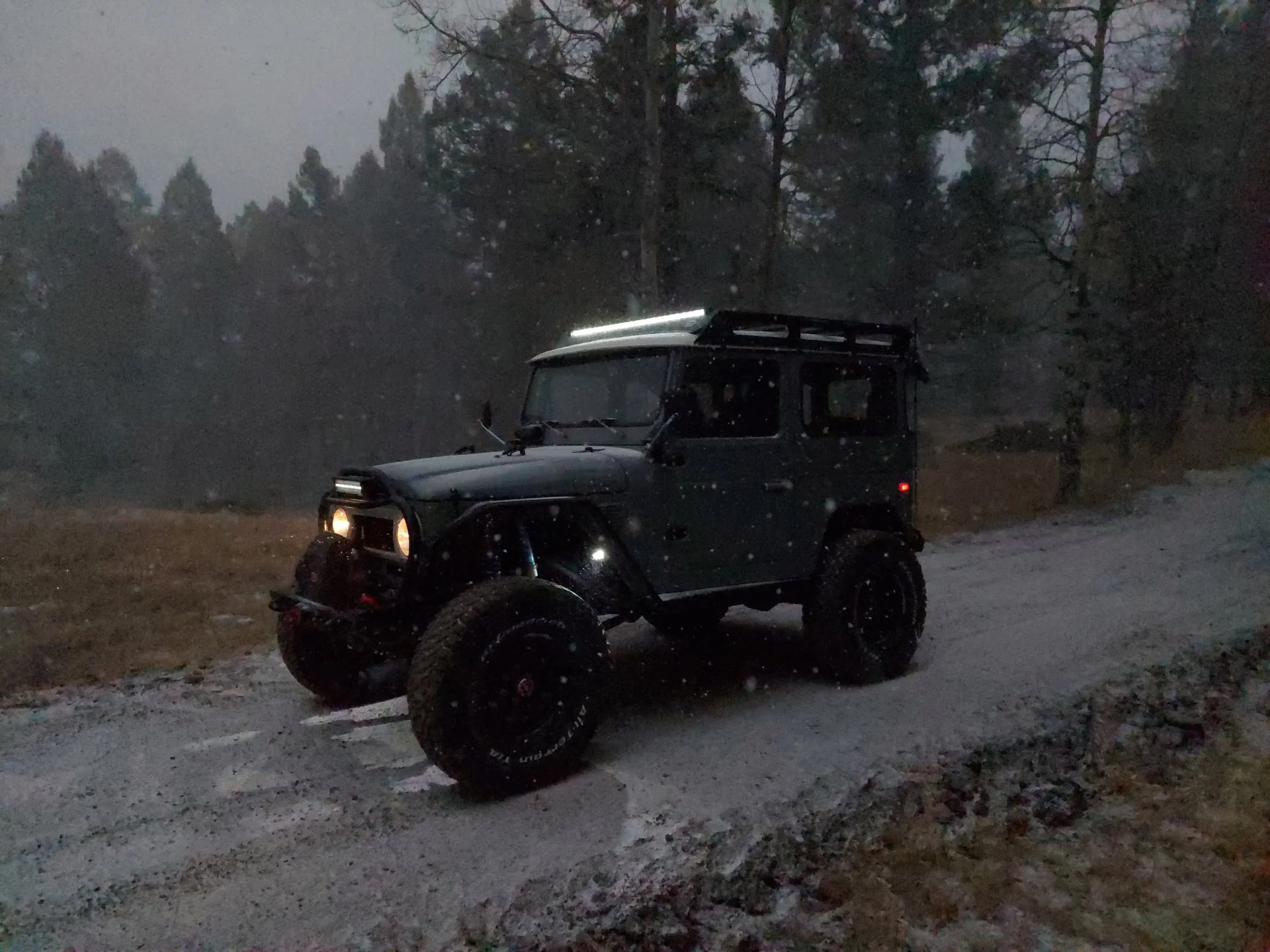

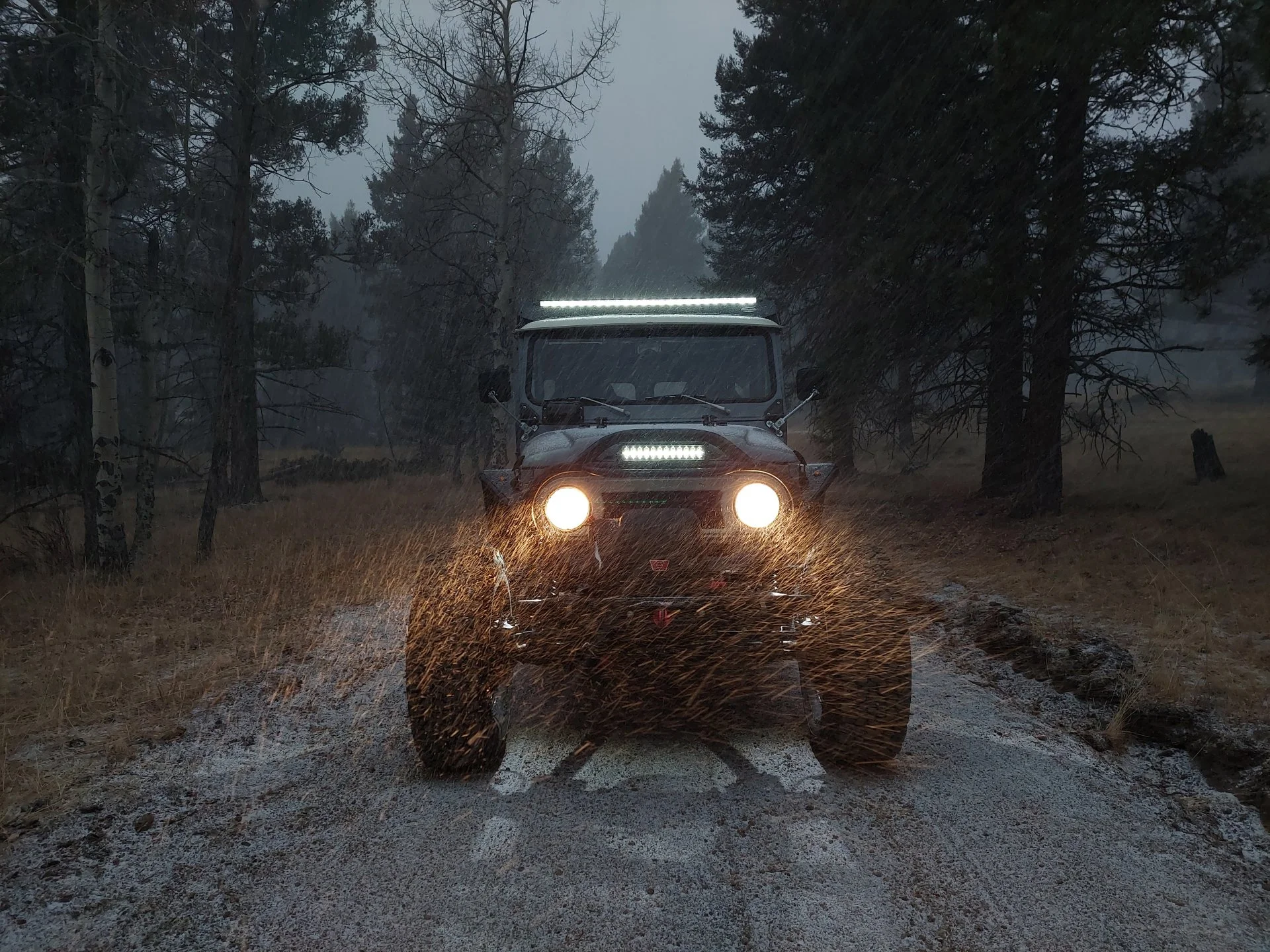

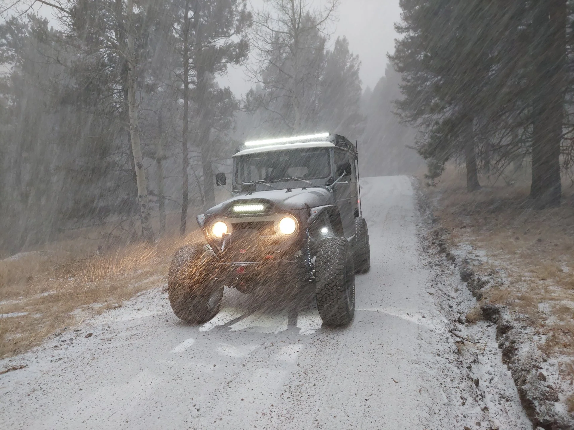

Took a few more pictures in the snow.
Yassss! I love the white walls!
You better send me some snow wheeling pictures!
Mike
If we had snow, I totally would. It is way to dry this year.
