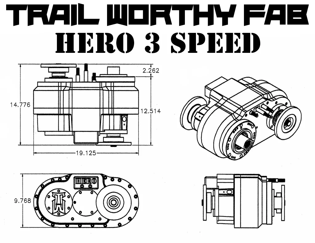

Well, @Godfather90 sent me this... He's really good at convincing me to spend money.
TWF Hero 3 Speed case. 6" shorter than my current setup, and doubled. Expensive option, but I can sell the toybox / split case and get some of it back, and keep the same crawl.
That's not a doubler transfer case. That's a three speed transfer case. High, medium, low, no "doubling" at all.
