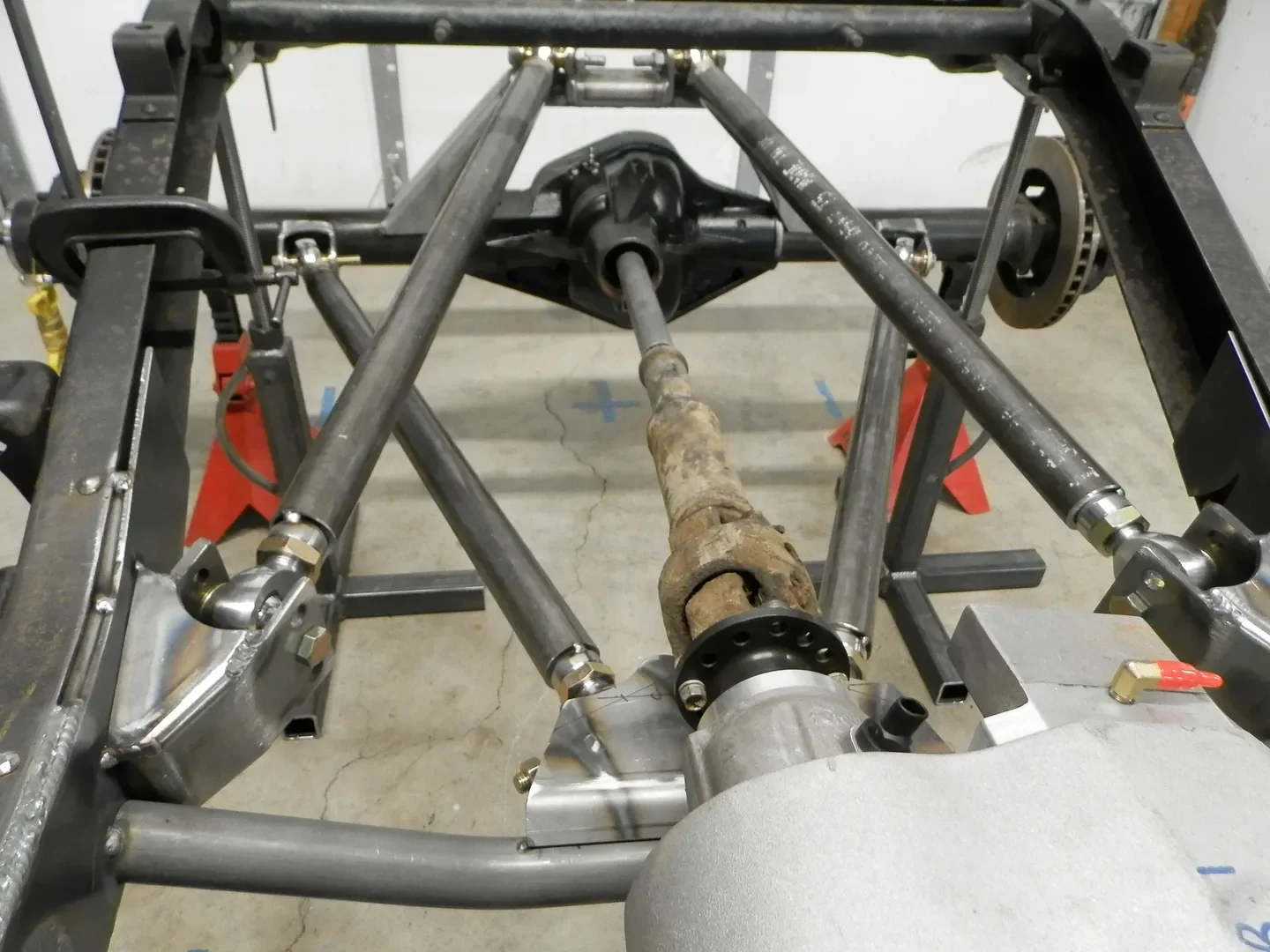

You had me there for a sec. I'm currently trying to sell my drivetrain to stick in an auto and something shorter, just so I can fit an effective link system for my rear. I'm glad I can save someone else from making the same mistakes I made.
If I remember correctly from reading your build thread, aren't you running an NV4500 like me? What transfer case are you running? I am hoping that my frame extension provides enough space in the rear for my drivetrain and suspension. We will find out soon!
383, NV4500, Toybox, Splitcase. I'd love to have your frame dimensions since it would fit perfectly. Another 14" would be more than enough to fit my current driveline.
The frame extension is one of my favorite parts. I am hoping that I won't need to reposition my original crossmember to work with the Atlas. Wouldn't most automatics be longer than the NV4500? Maybe not with the addition of the adapter?
They should be about the same length. The doubler and split case makes my drivetrain long.
