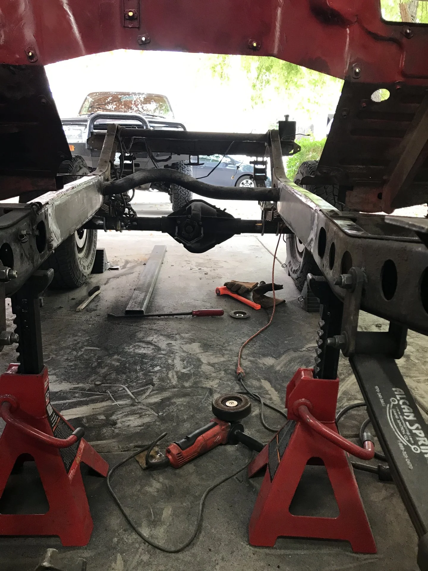

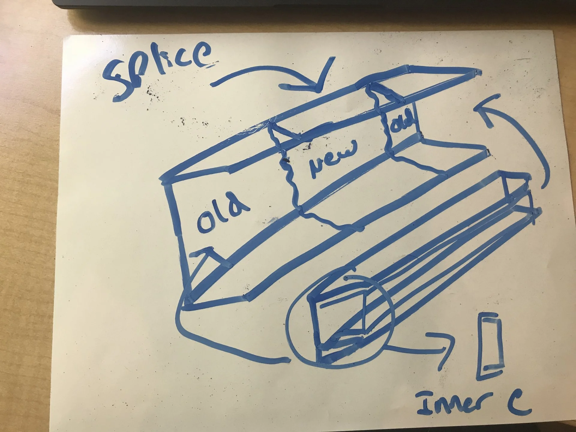

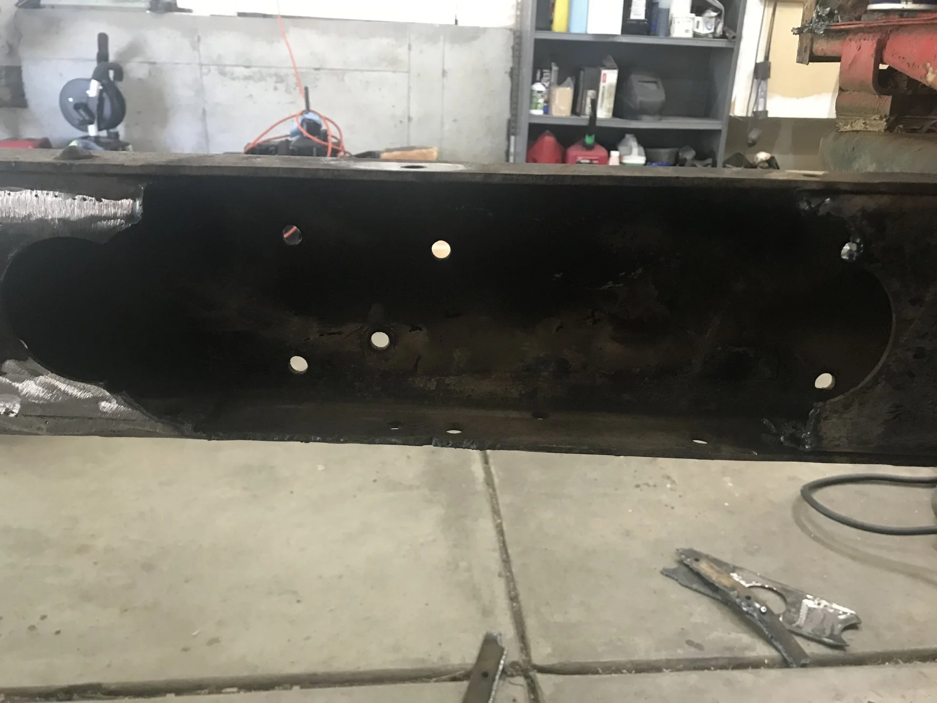

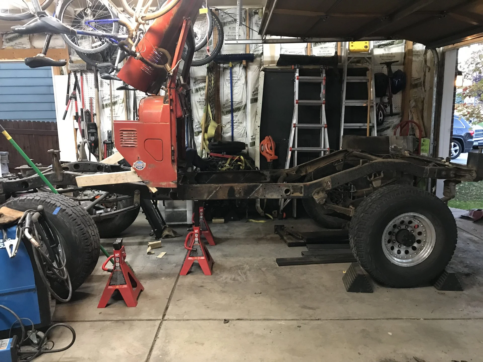

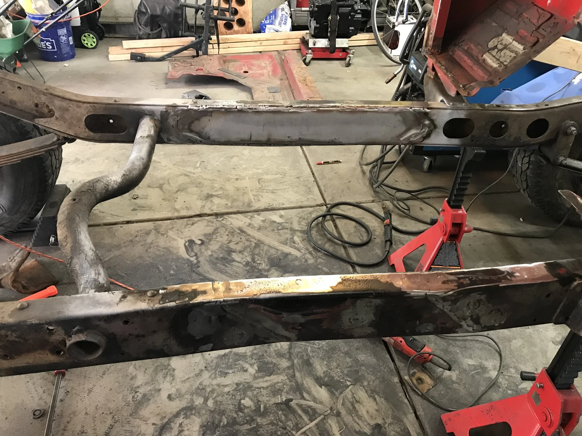

My frame extension should be ready for pick up on Friday and I plan to extend the frame towards mid-October. I will be cutting my frame at a diagonal. My drawing skills are limited so I drew the cut marks as straight lines.

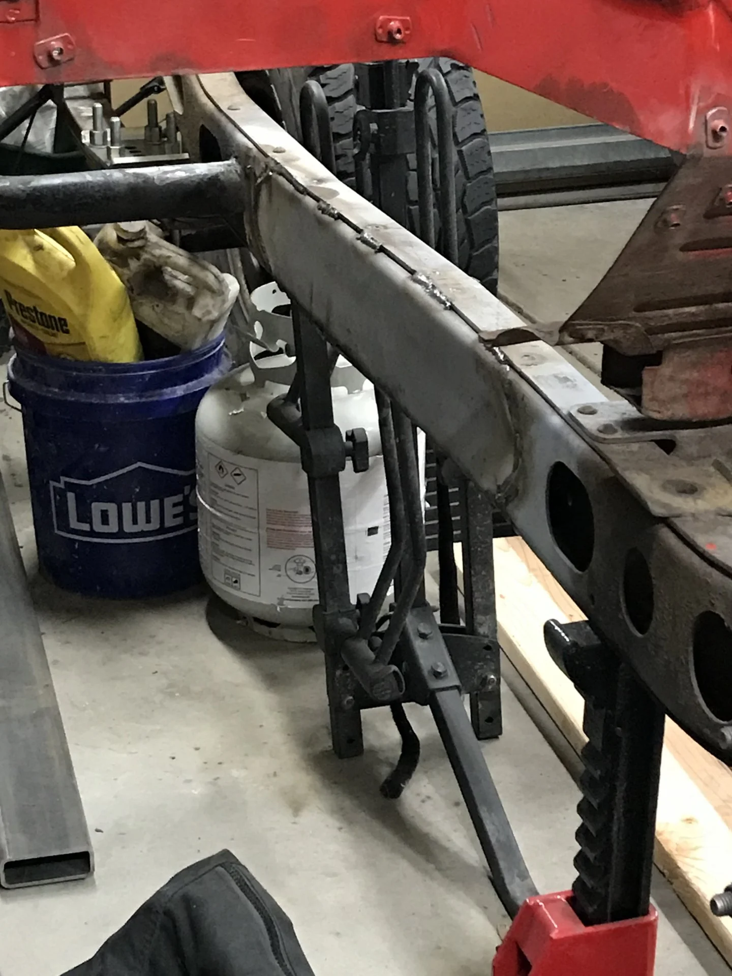

Thanks again to @Tank5 for the donor frame. I will use that to splice the outside, then place the new pieces on the inside. A sample from the donor frame is below.
I've usually heard that it is recomended to split the frame at a 45° on the length of the frame, but I'm sure someone with more experience can give some advice. @Godfather90 may know.

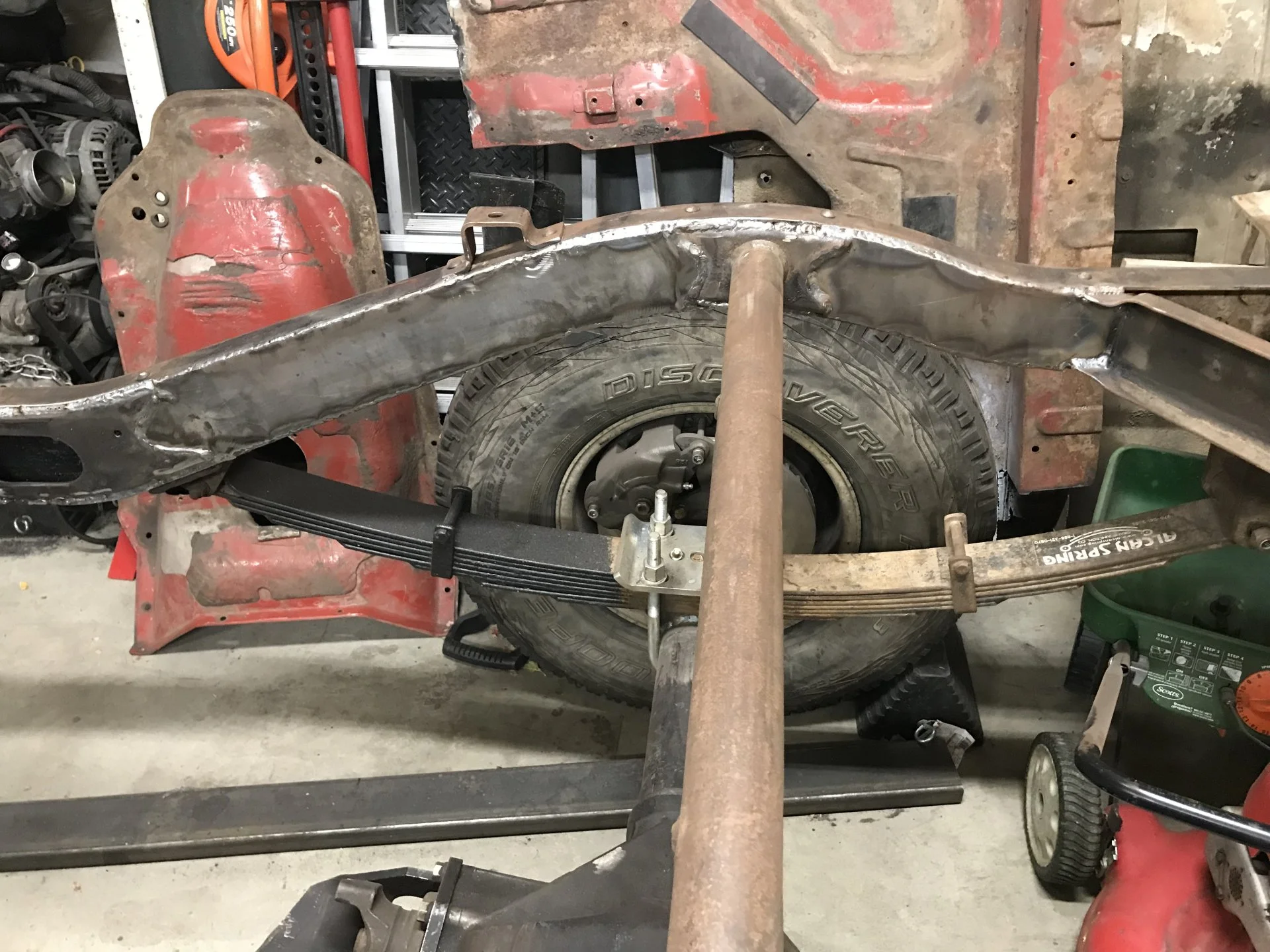

Hi there and thank you! Yes, I set my Cs at 3-4 degrees positive caster.

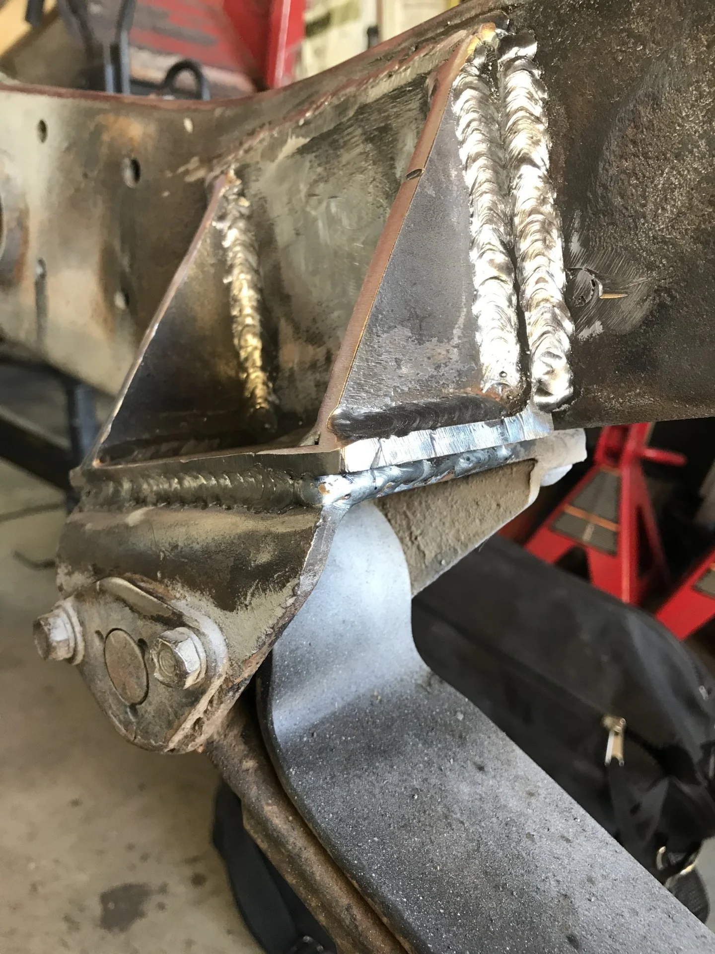

@Broski , I should also mention that I set my front differential, and the rear for that matter, at around 12 degrees upwards from center. I achieved this temporary in the front with shims on the cast leaf spring mount and by relocating the left mount. I will do a 4-link eventually and my Cs are relocated to accommodate the extra angle.
You'll want to box those perches in.
Thanks for the tip. Just to confirm, did you see that I have a piece of 1/4” angle under the gussets, which is on top of the factory mount? I thought what I did was already overkill :)
Do you still think that I need to box it in? Perhaps there is something else that I’ve missed.
FWIW I think they well hold up just fine.
Yes, I'd still box them in. Mainly to have a clean surface that doesn't trap mud and dirt, but reinforcing the open triangle is something you won't regret.
