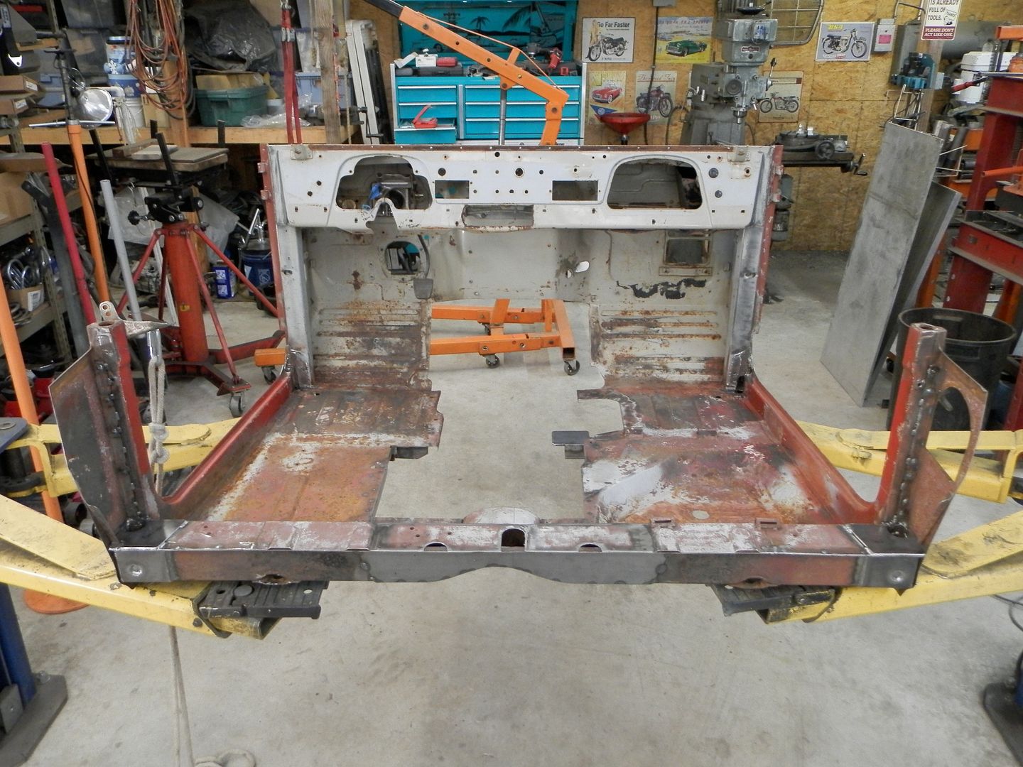

Here's the body and frame we started with.

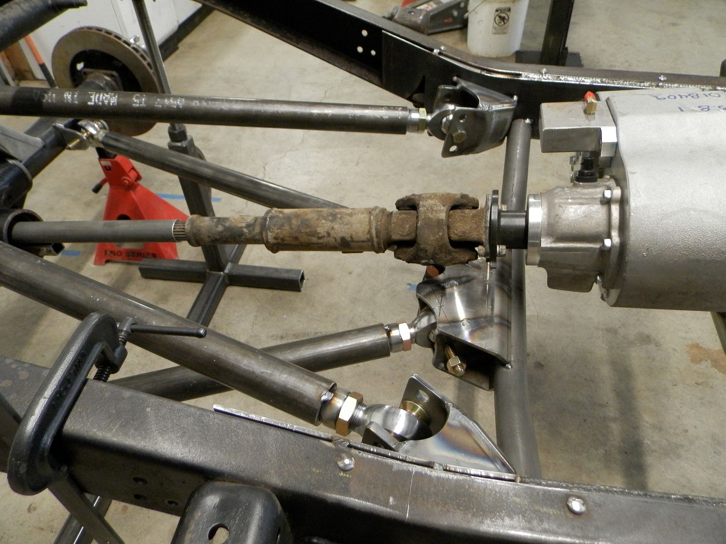

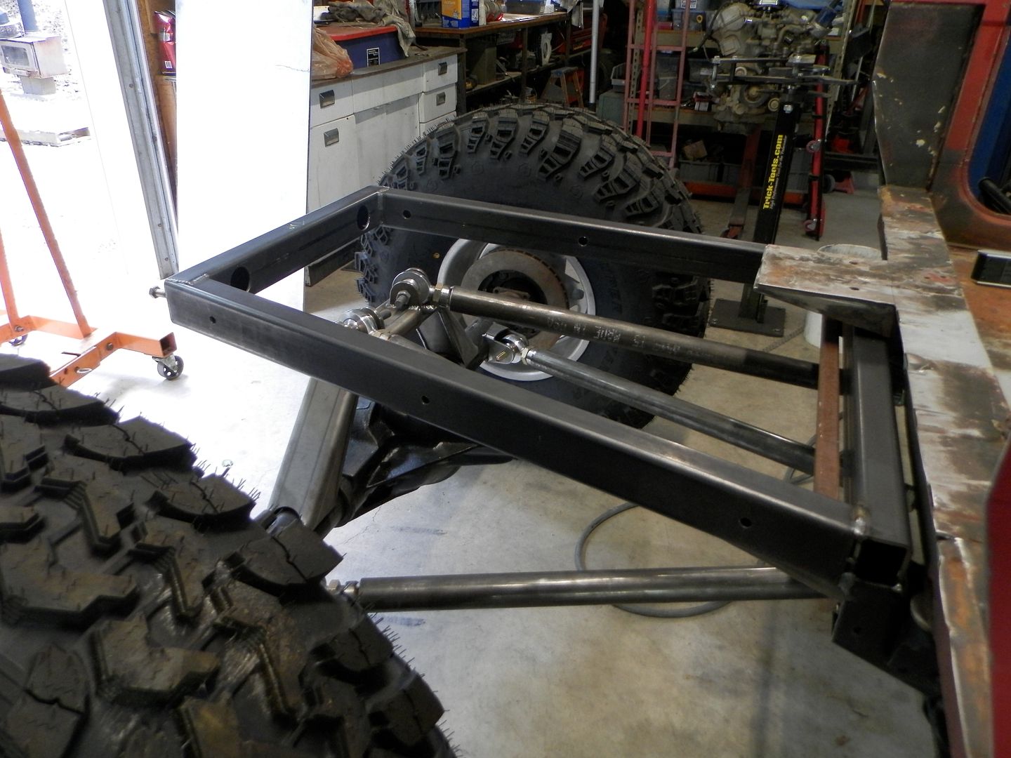

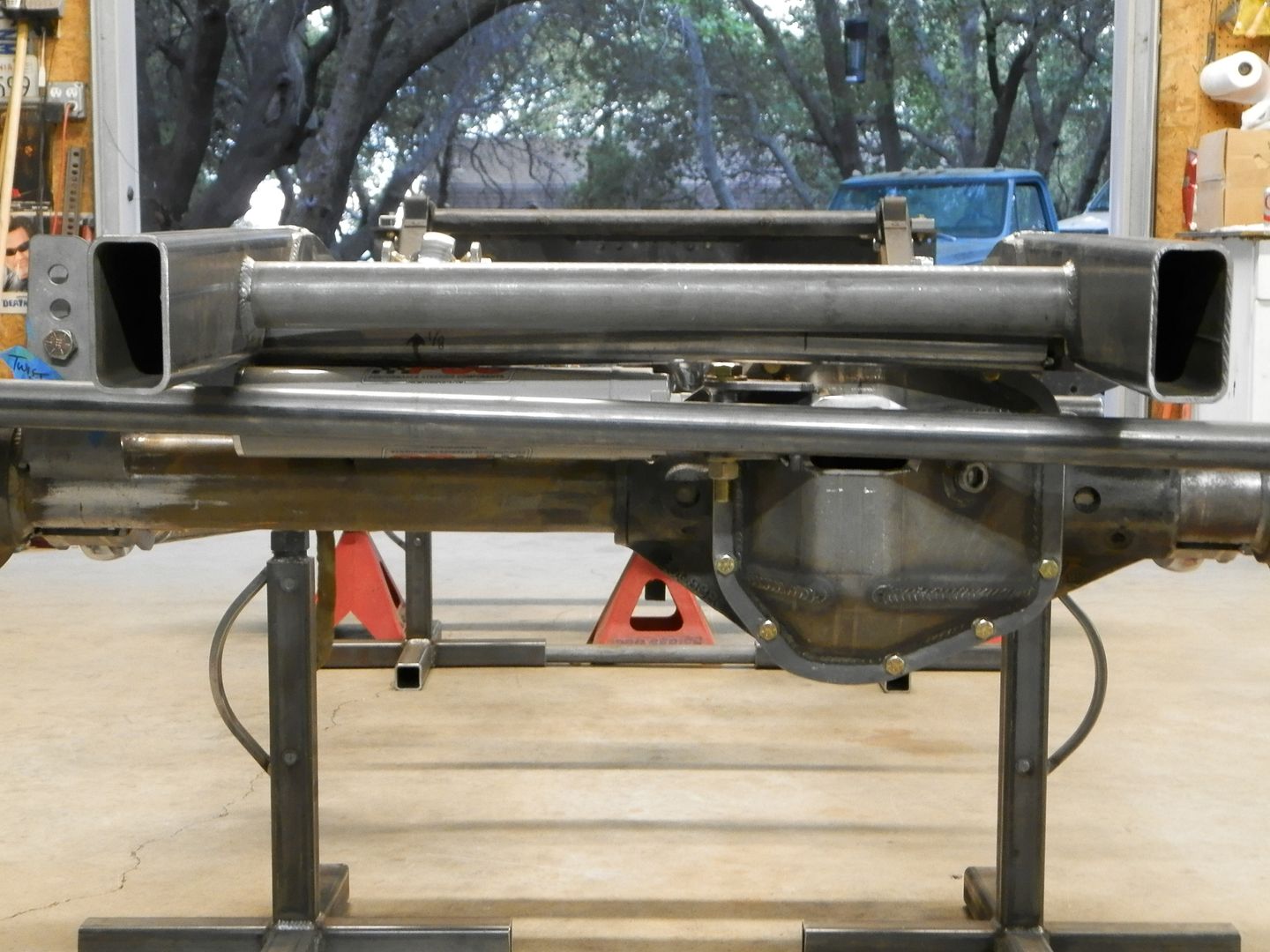

After mounting the motor, trans and t-case, and plating the frame, I quickly got to work designing the rear suspension. I set it up with a bit less roll steer than a KOH car and there is a bit of adjustability built in. The wheelbase was stretched to 115" wheelbase.

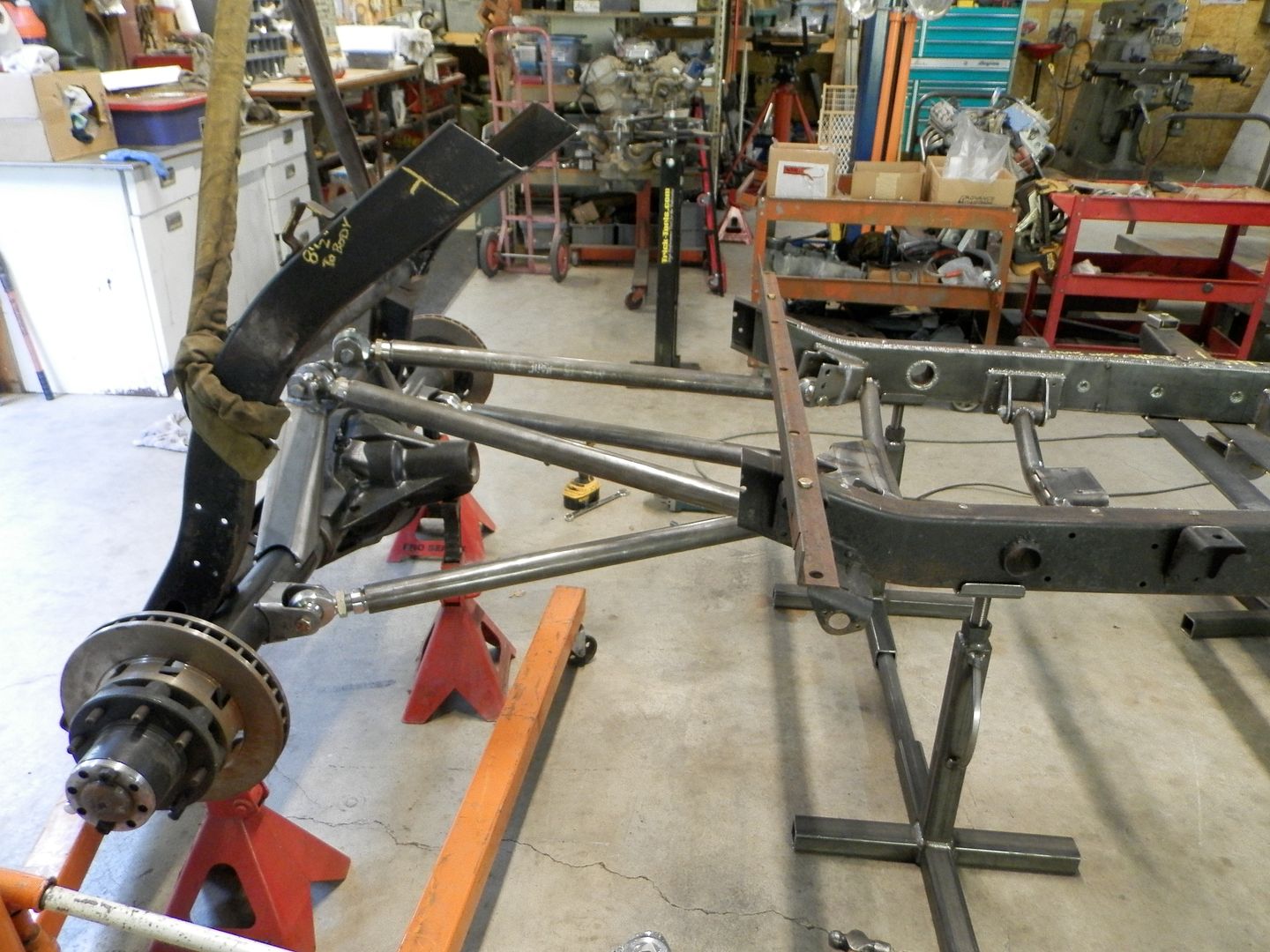

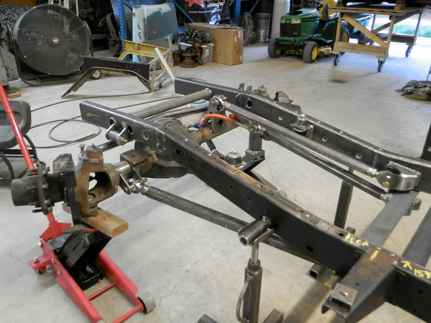

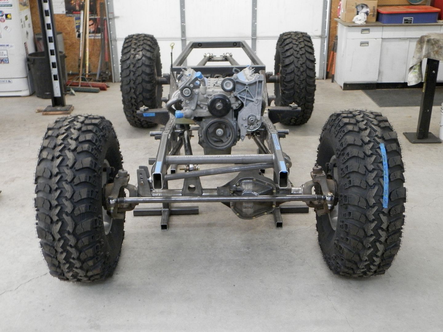

Next up, hang the front axle.

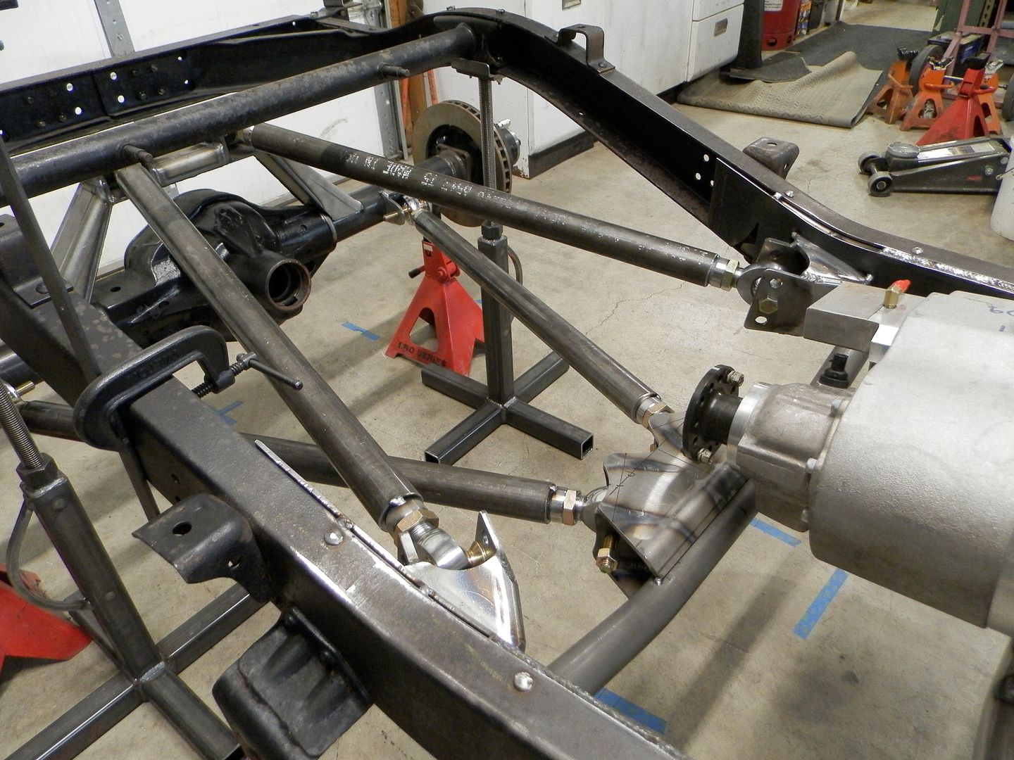

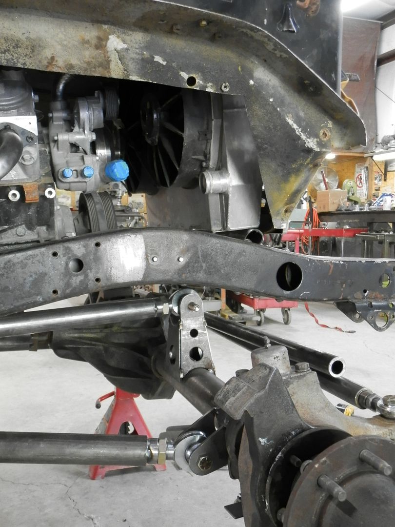

A 3 link with a panhard was the only way to go while working inside the confines of a stock-ish frame and also trying to maintain a low ride height. So far, the bottom of the frame is 23.5" above ground so the truck is pretty low. We may raise it an inch or two if we need to.
There was simply no room to use a fully triangulated 4 link. Even using a traditional steering box was out of the question. We ordered a single ended ram system from PSC and I was able to fit it behind the tie rod and low enought to clear the panhard bar and frame.
The initial mock up was with really long lower control arms and a single piece front driveshaft. After proving that scenario to be sub-par, we ordered up a short intermediate shaft from Jesse at High Angle Driveline and shortened up the lower control arms. The upper control arm is almost the same length as the lowers to try to control the pinion angle throughout the suspension travel, the same approach as we took with the rear. One benefit to using a 2 piece front driveshaft was that I could design it so that one-length-driveshaft is used front and rear, so one trail spare will fit either end.

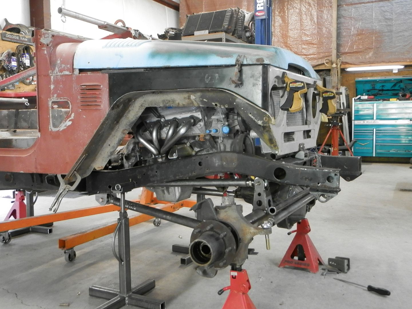

Mock up.
Building the front suspension at full bump is always a good idea, but here things were very tight so that's where I started. The stock frame horns would cause a lot of fitment issues, so the frame was clipped out front to make room.

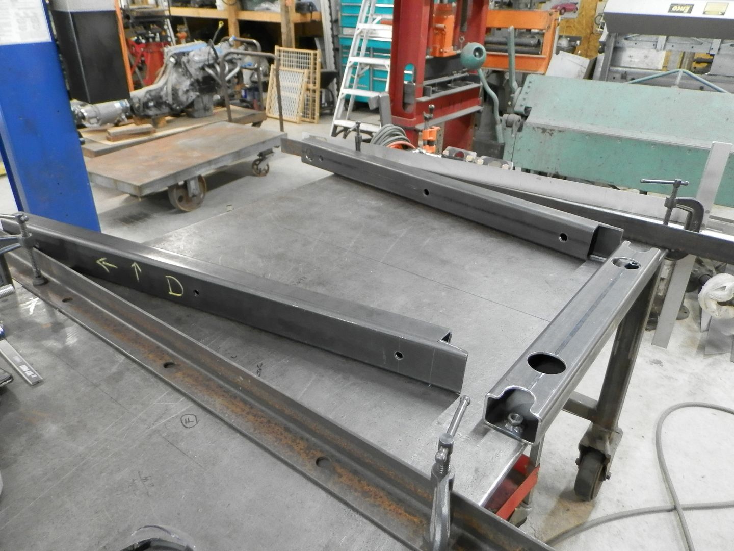

Build lower clip section. Has to clear the links.
Mock it up and start the welding.

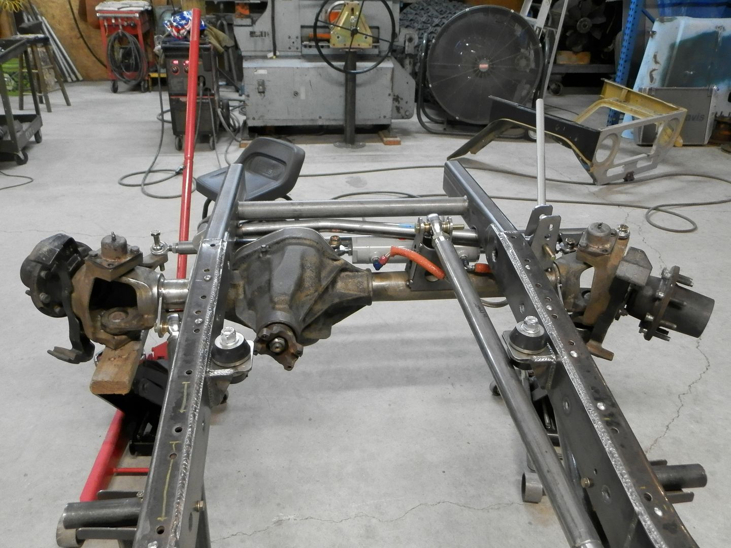

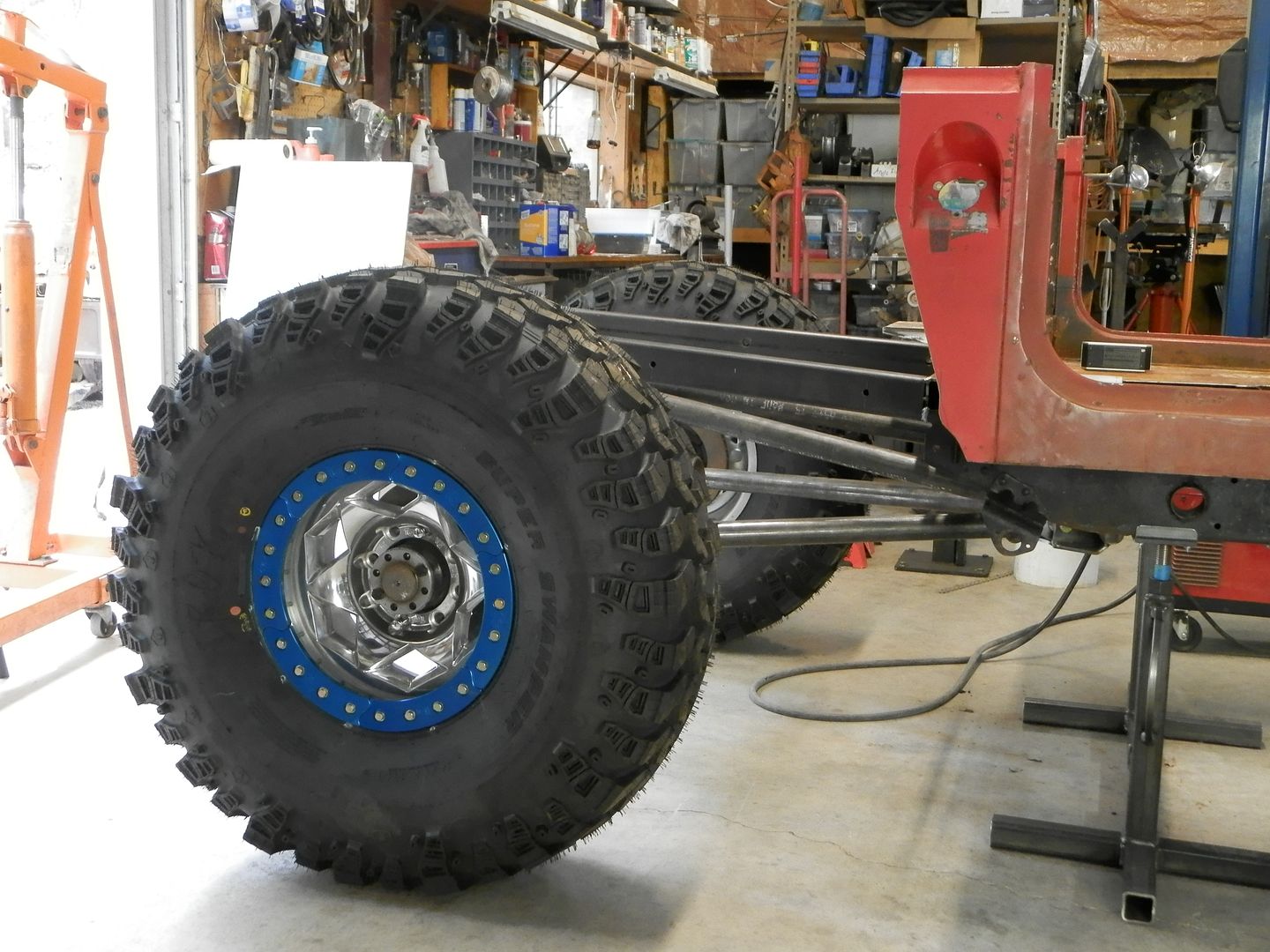

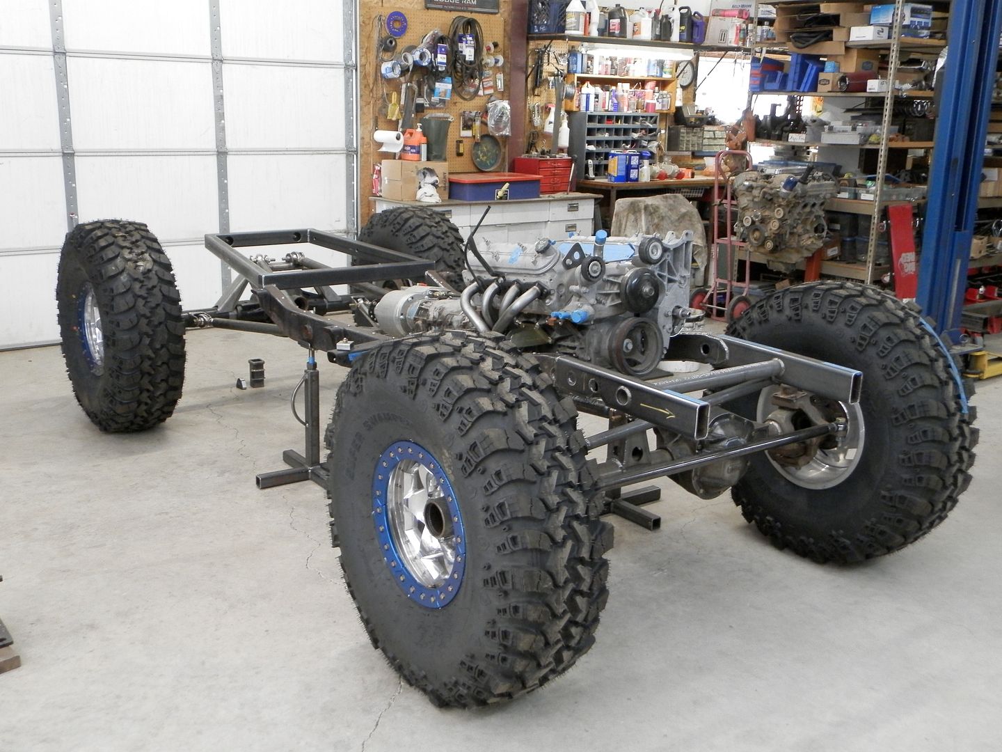

This is how she sits right now.
Chassis almost a roller, just need shock mounting, bumpstops and limiting straps.

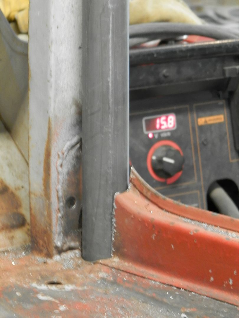

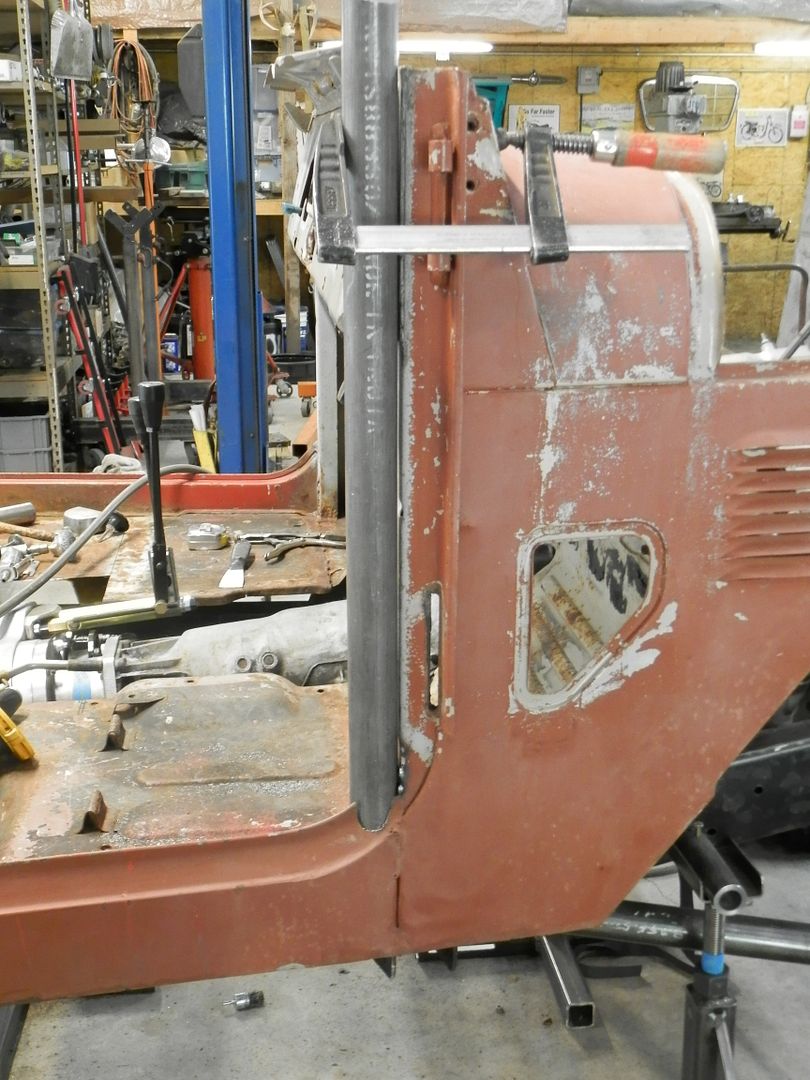

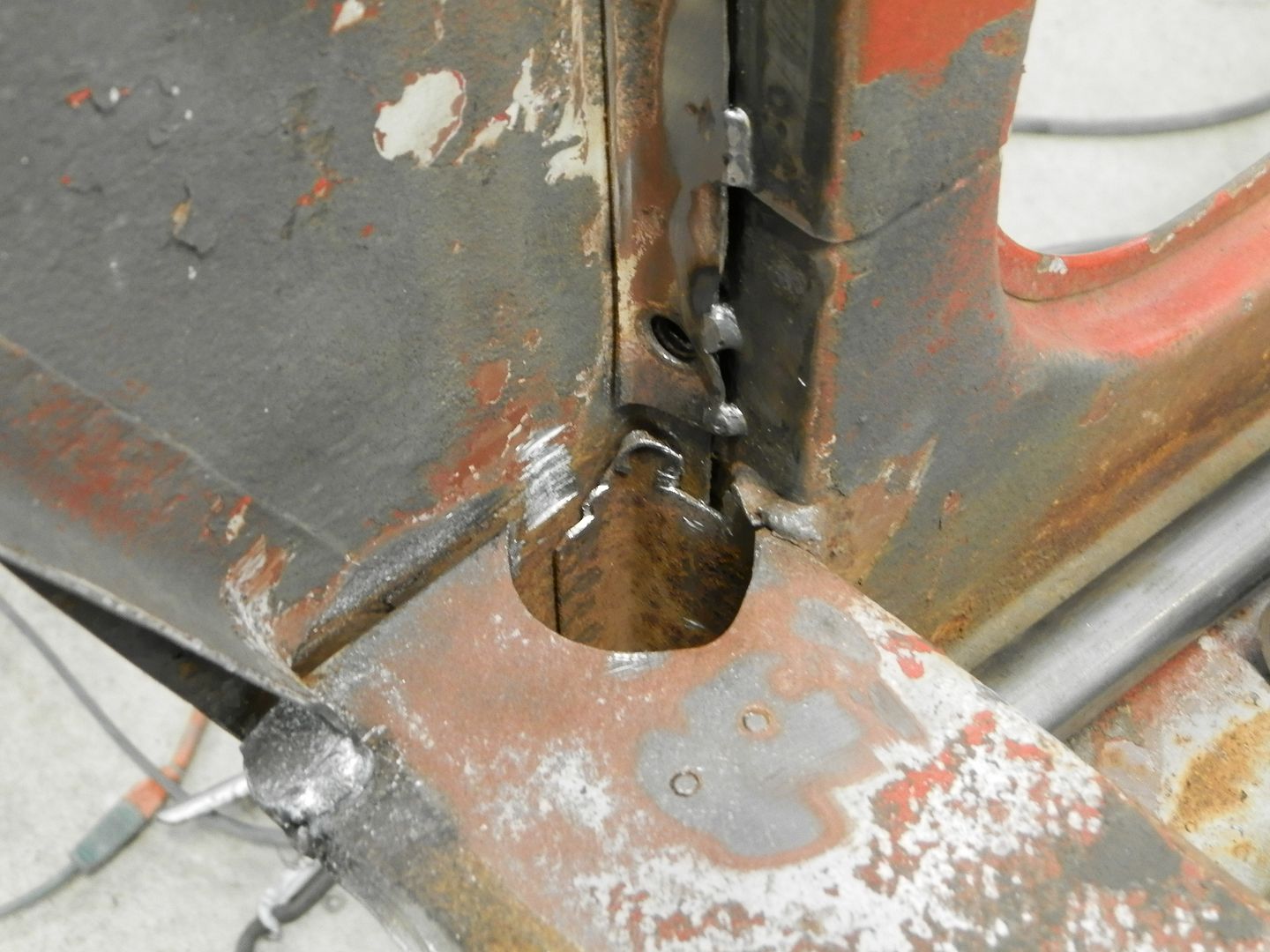

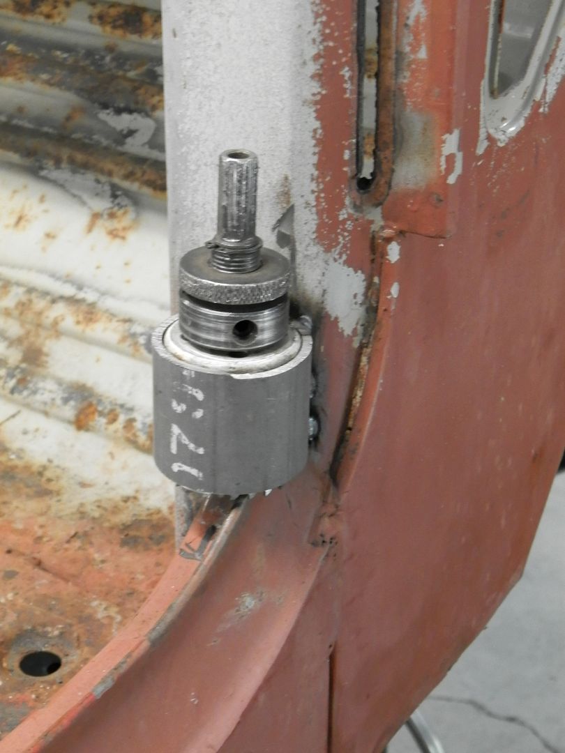

Had to shift gears a bit to get ready for the rollcage. The body is going to be removable from the chassis, and the cage is going to be integral with the body, so strong mounting points are key. The rear of the cage section will support the weight of the truck via upper shock mounts tied into the cage, so the rear section has to be triangulated and stiff.
Finding a nice out of the way place to stick some tubing.
Getting crafty with a hole saw.

Ride height and packaging is one of those inverse relationships that make life miserable for someone like me when trying to build a front suspension. I really wanted to keep the ride height down to a minimum. The narrow frame rails of the FJ combined with the mass of the D60 diff did not leave me much room to play with anyway. Even without a steering box and drag link, getting everything to fit at full bump took a lot of time. One thing to point out is that since there is not going to be a drag link, I was pretty much able to have the panhard bar set at any static angle I liked without the worry of bumpsteer. Would I have liked it flatter, sure, but I'll take what I got.

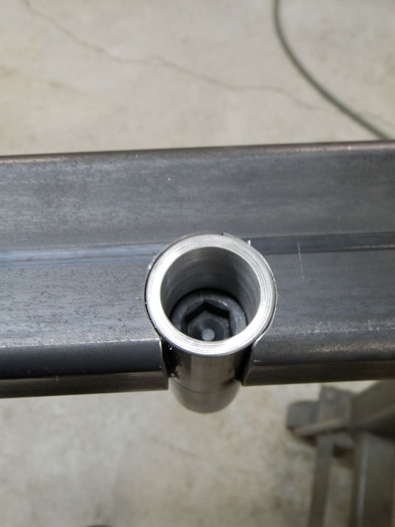

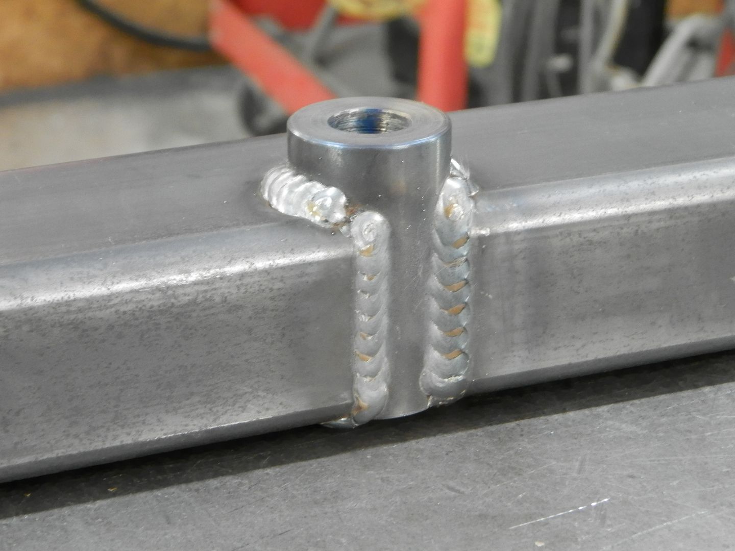

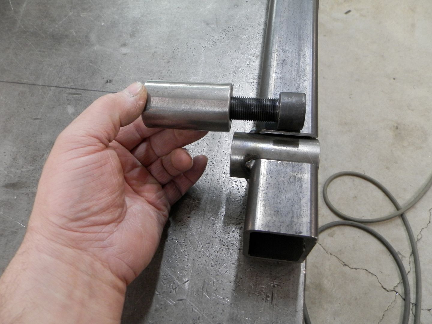

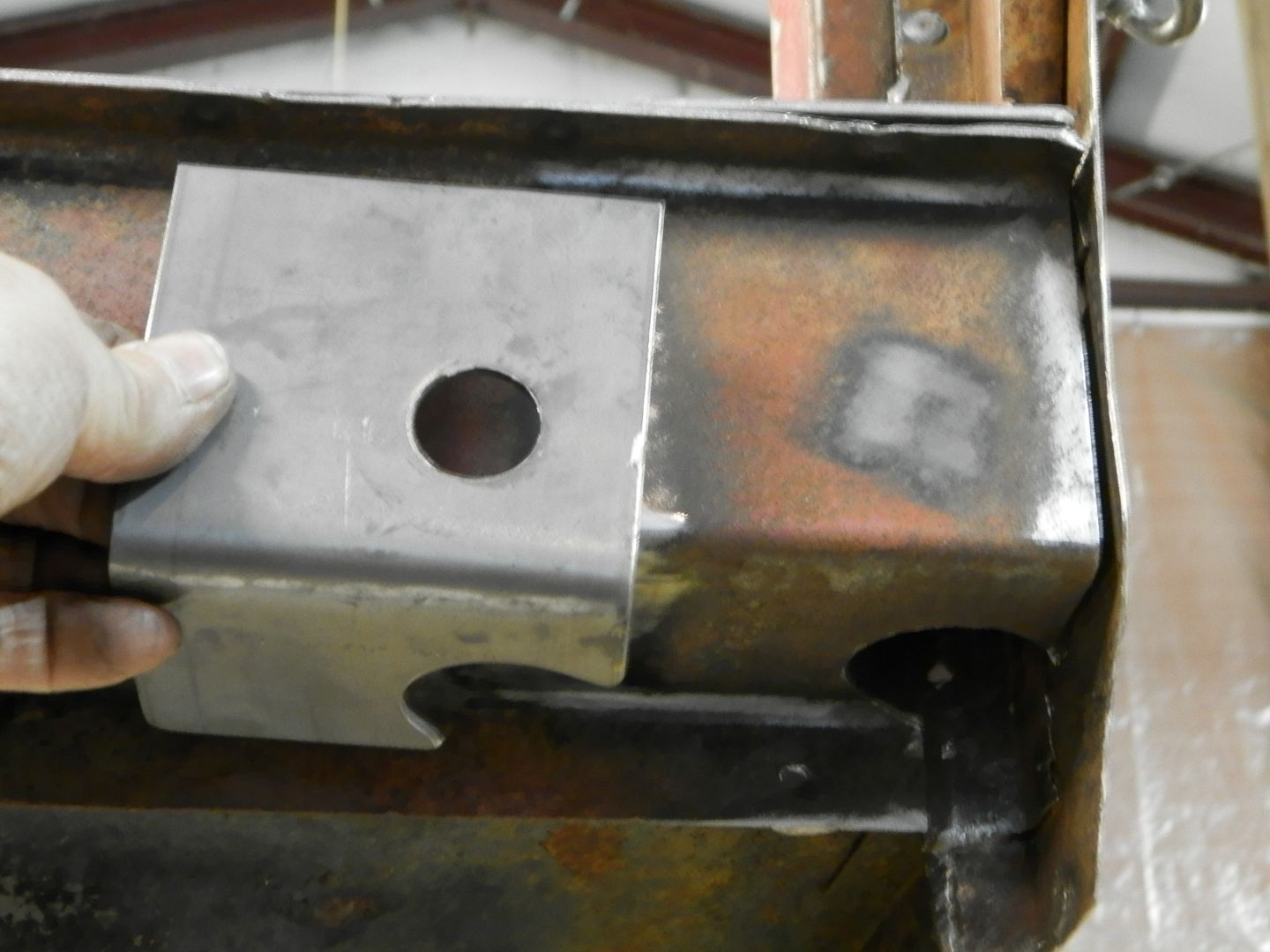

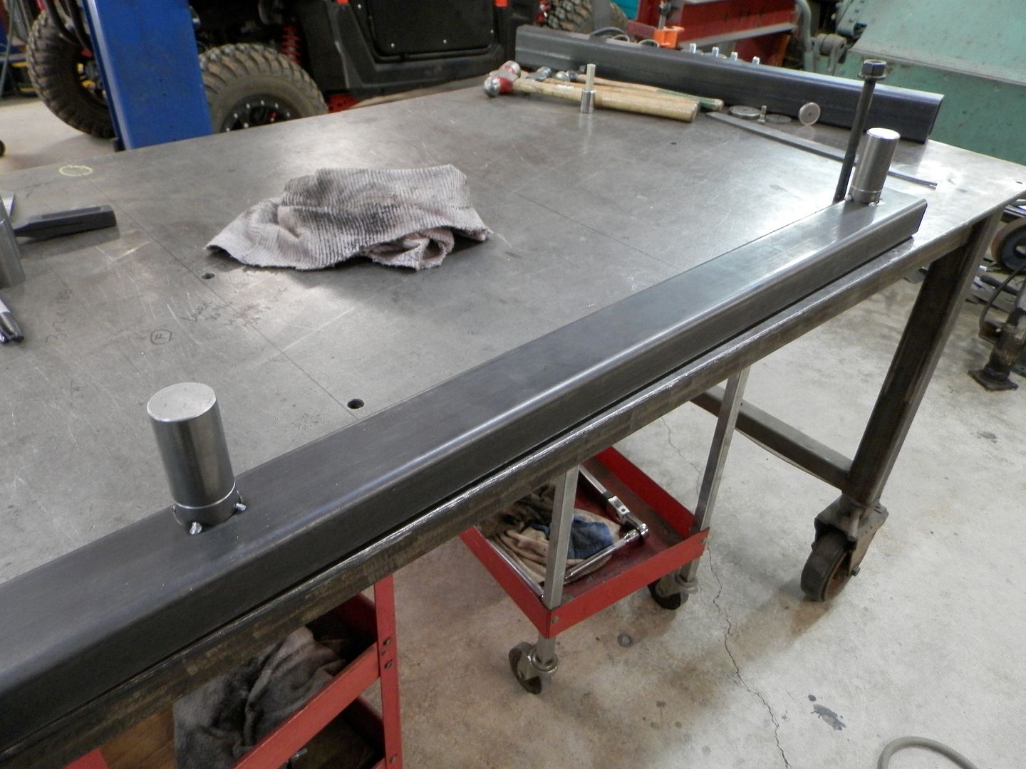

As compared to the Savvy/Currie Jeep, this body and roll cage are going to be removable from the chassis, which presents it's own set of problems. One problem is since the rear shocks are to be cage mounted, the triangulation at the rear of the cage and where it meets the frame has to be very rigid, both for performance and durability reasons. The second hurdle was to make it easy to remove the body from the frame. I had Jim Christiansen, formerly of Inchworm gear, machine up some tube inserted bungs that will make bolting the cage to the frame a piece of cake (pics below).
One feature of this FJ that was very important to the owner was that it be a 4 seater and that getting in and out of the rig be easy for the rear passengers so cage triangulation is now important not only for the suspension, but for the safety of the passengers. That means I can't have a bunch of roll cage tubes in the rear where I need them the most. We will be building the cage here shortly so expect an update on that front soon.
Here are some pics.
Bungs for the cage mounts welded into the very rigid slider assembly.

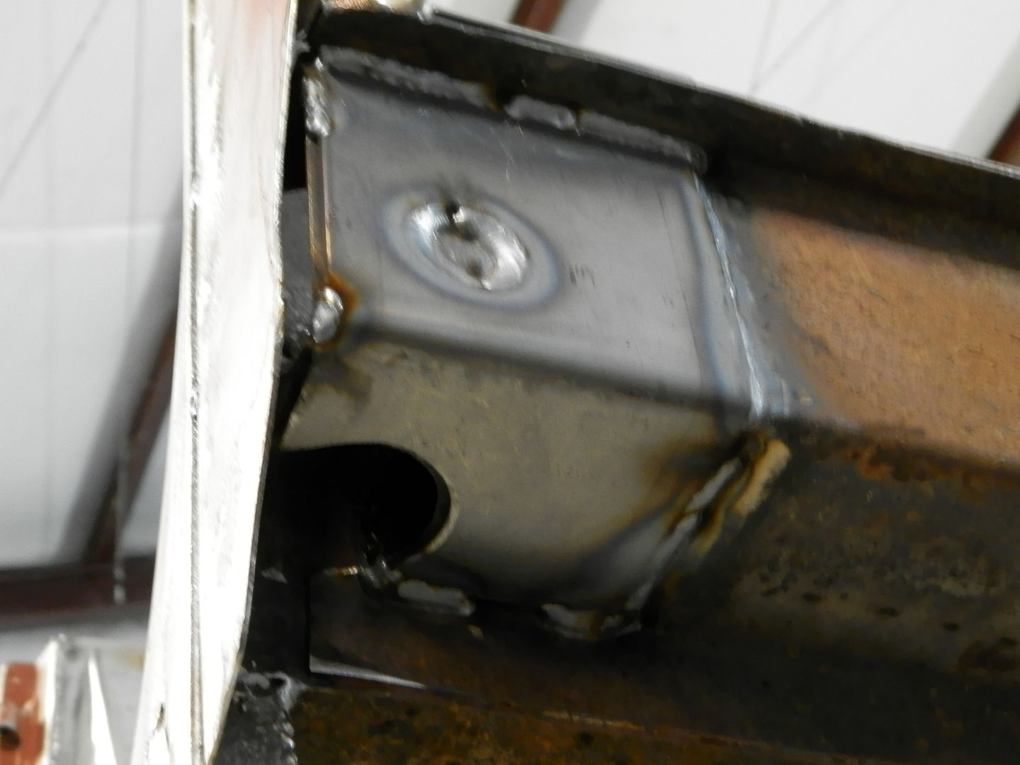

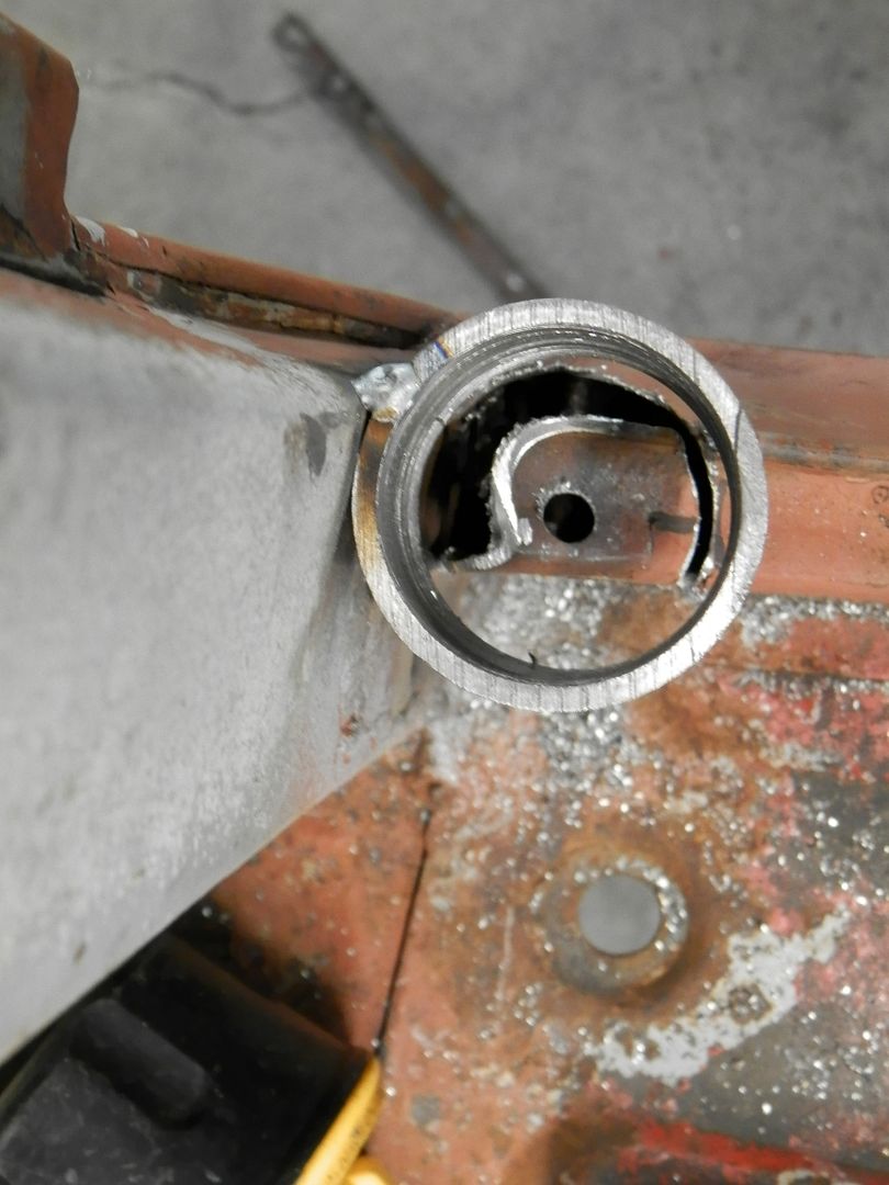

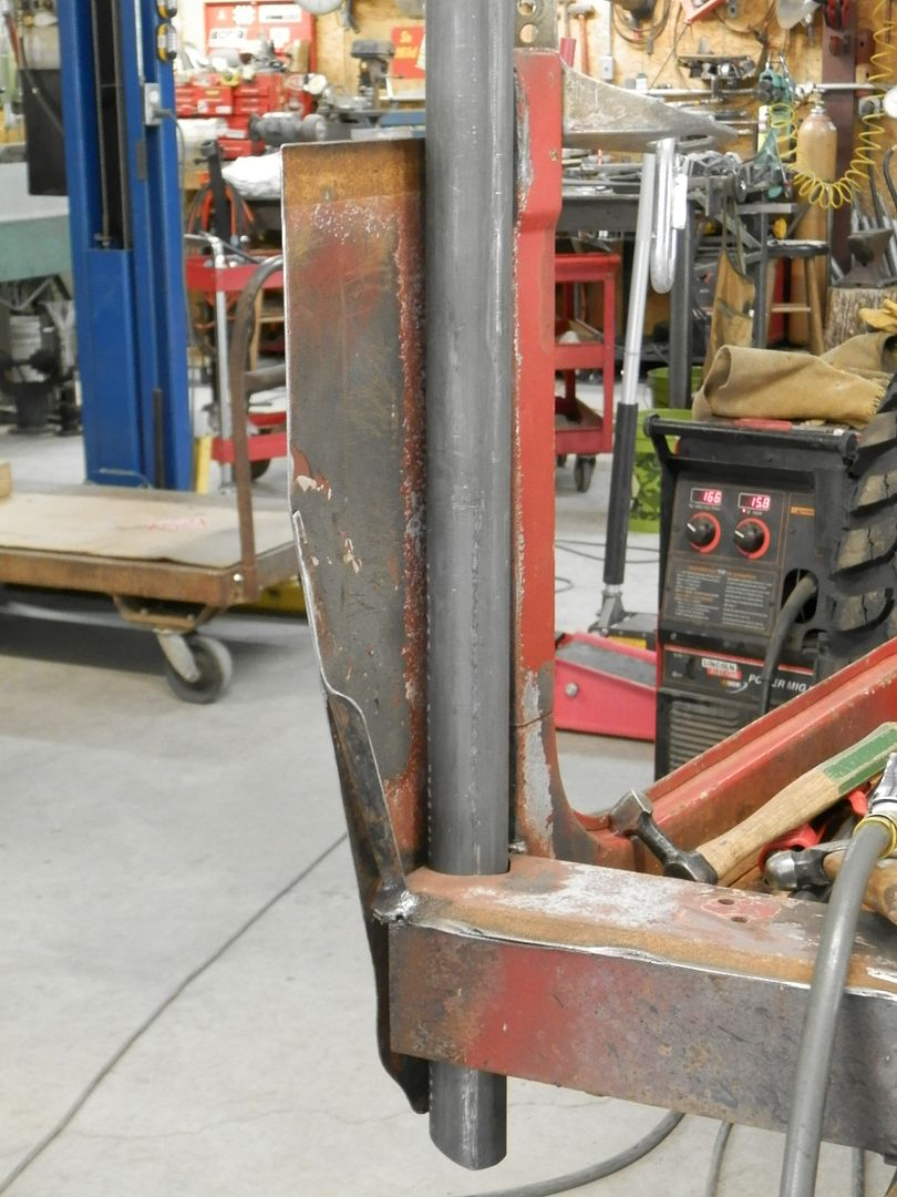

Reinforcing the body tub where the cage tubing will pass through. The tubes will be fully welded through these areas.

Great fab work!
@Stoffregen M-Sports Do you want this moved to the hardcore section?
Your welds are fantastic, wish I had those skills.
