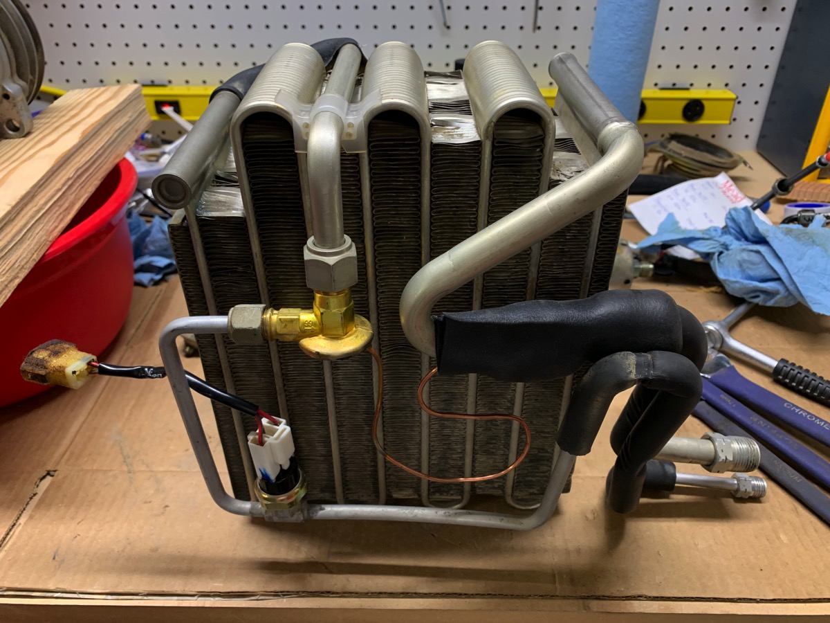

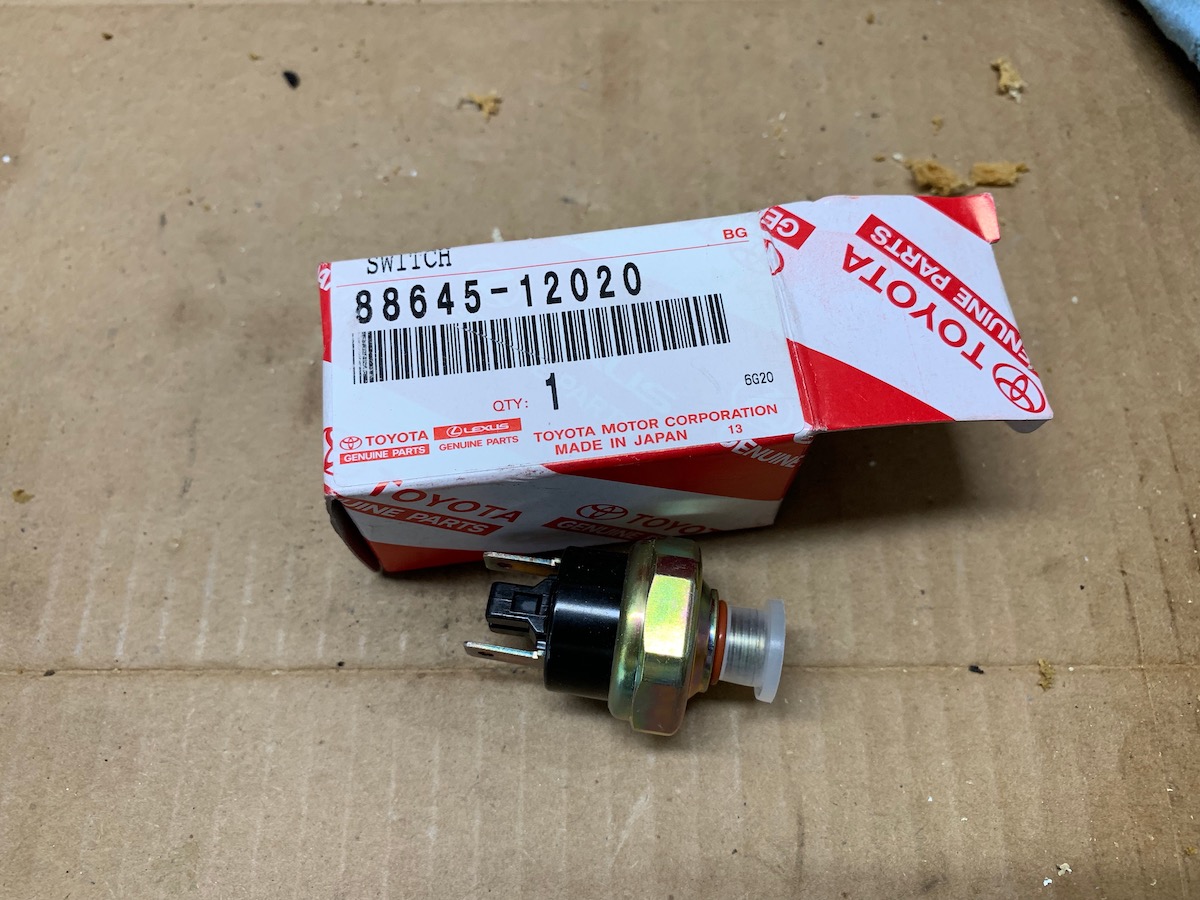

While I had the evaporator assembly all torn down it seemed prudent to replace the pressure switch as well, especially given it was only a $10 part, OEM.
Then re-assembled the evaporator components...
The popped it back in the housing...

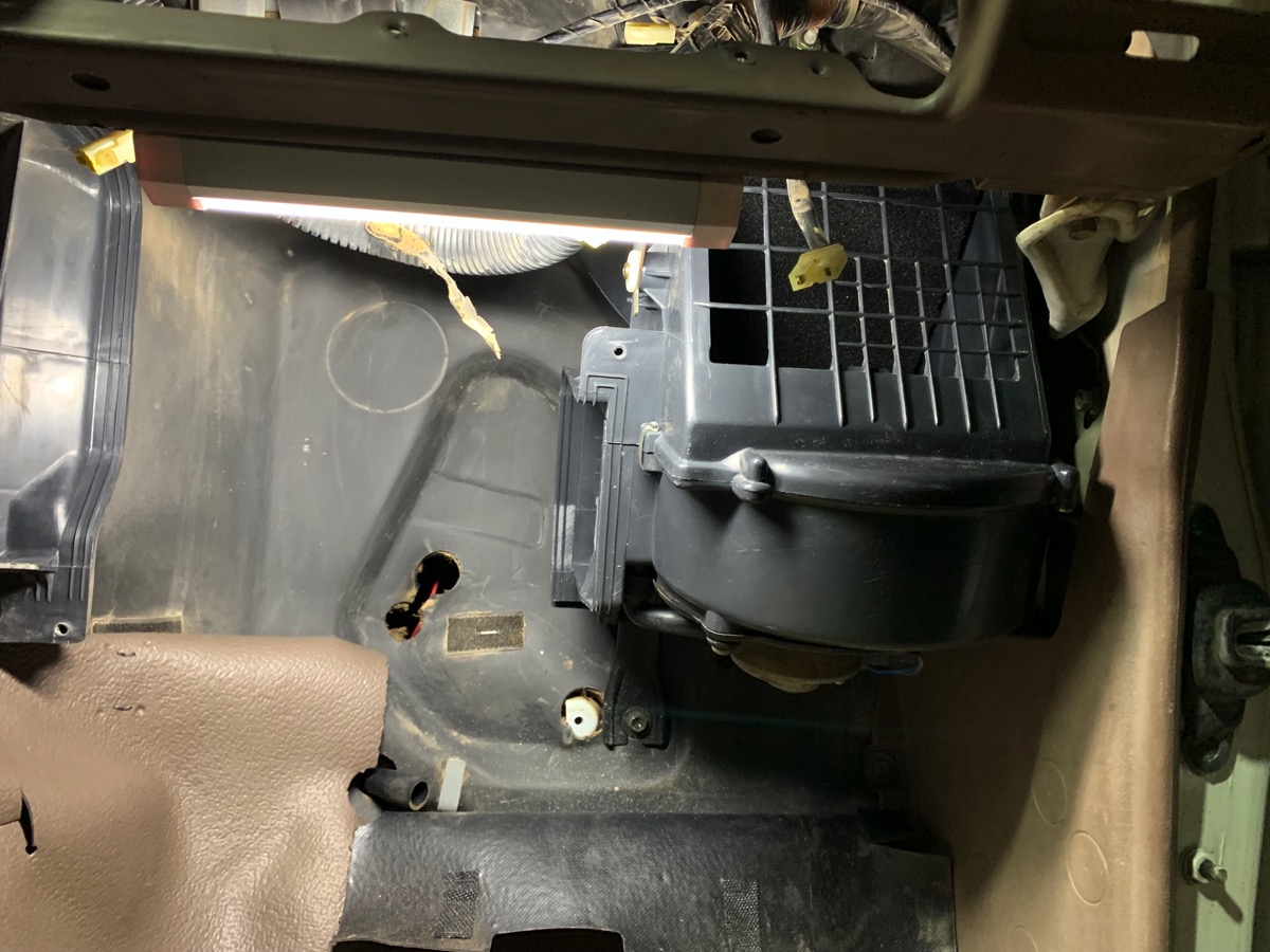

The blower was also re-assembled with new foam and new "gasket" material where it presses/mates to the fresh air intake.

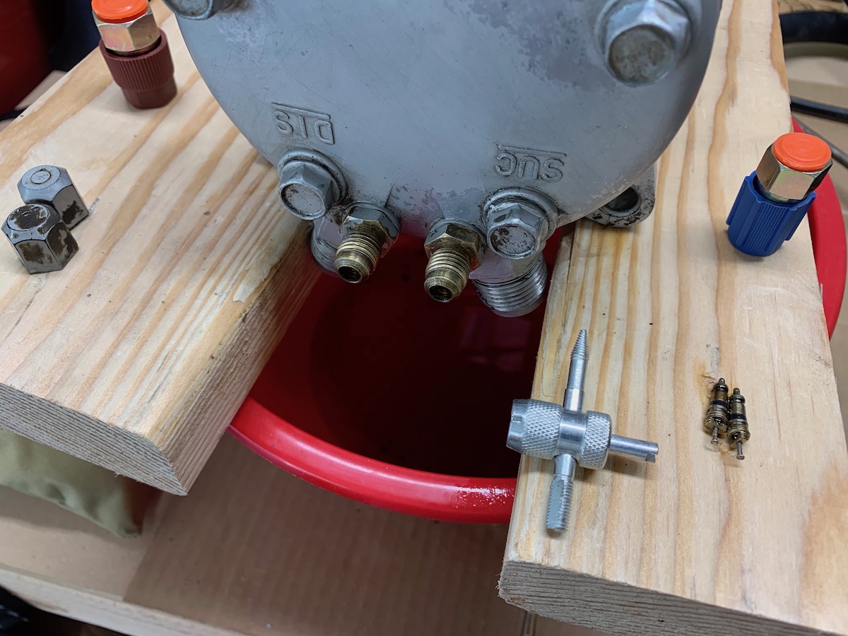

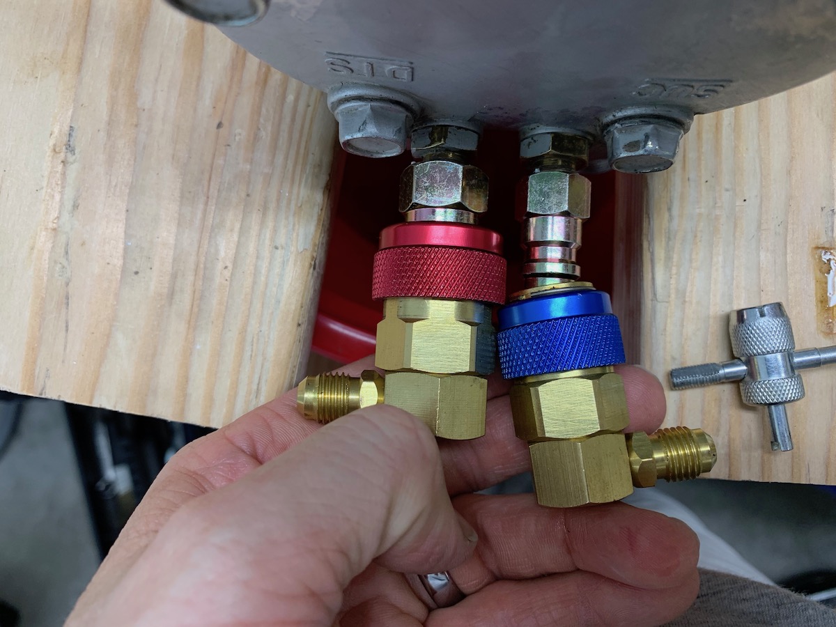

The compressor has also been converted to R134a service ports...
I've got an obvious problem with the new ports being too close together to accept both the high and low pressure adapters. I've got a right-angle service port to solve that issue.
Blower went in...

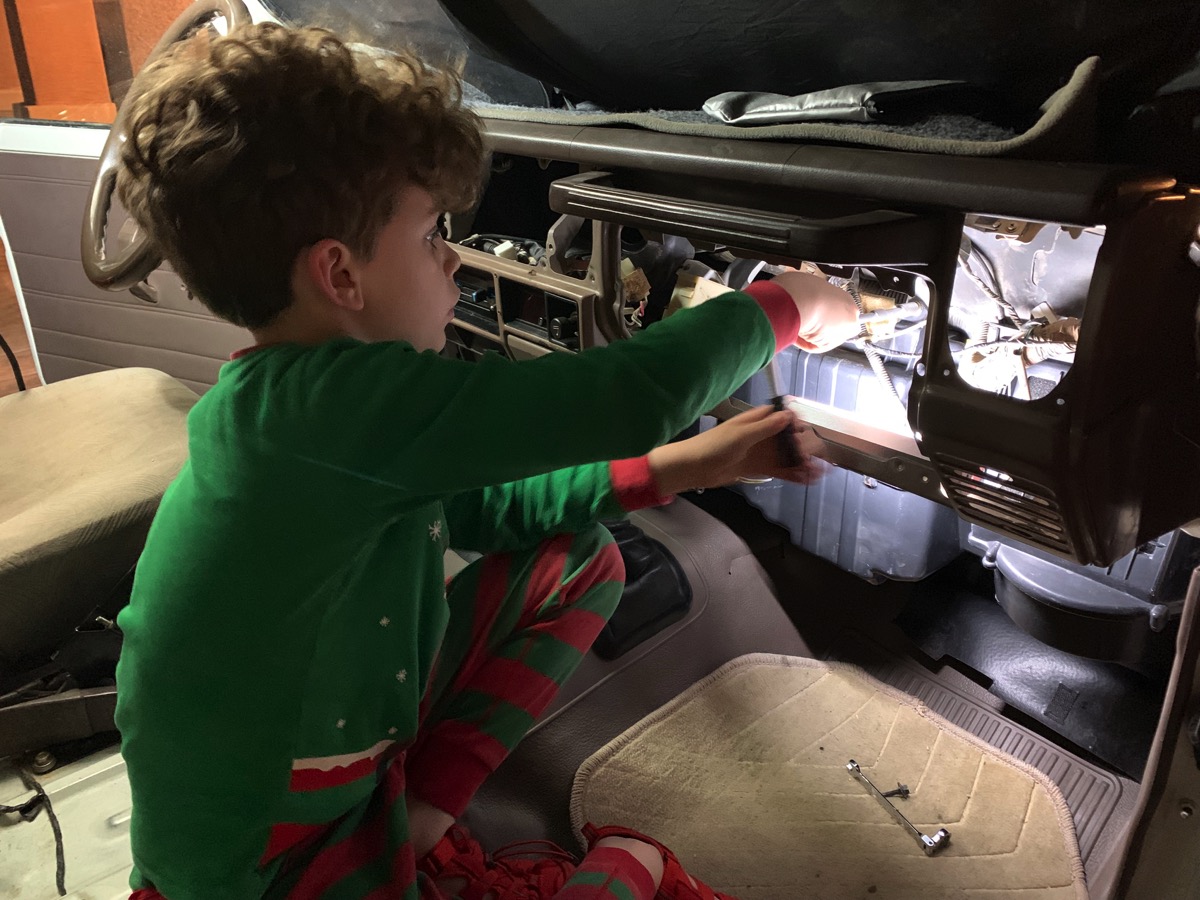

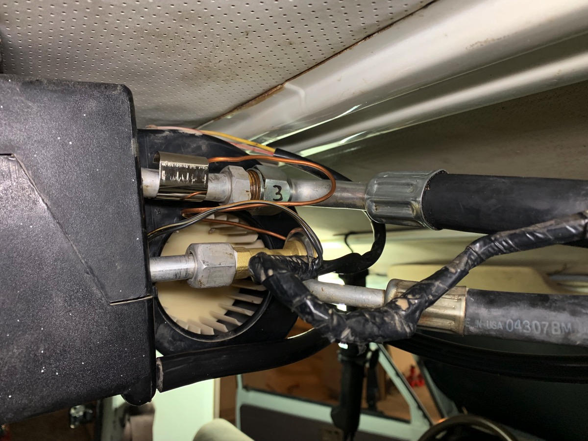

Then the evaporator housing... (those Christmas PJ's must be his favorite)
New expansion valve plumbed in on the rear AC... I'll insulate later if condensation becomes an issue.

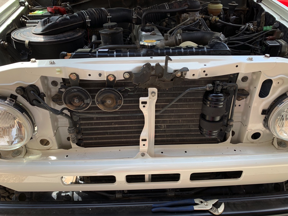

New drier went in last. Driers are sold vacuum sealed to prevent moisture from contaminating the desiccant. Uncap, fill with any oil as required, and then plumb into place when ready for vacuuming out the system.

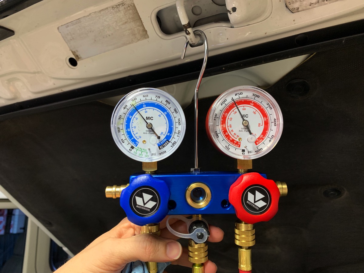

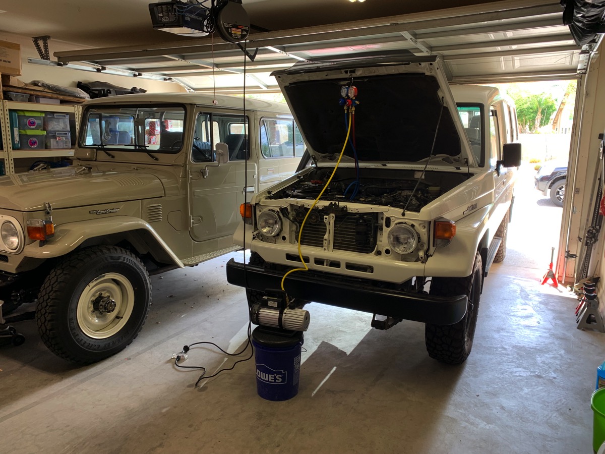

Then I vacuumed the system. I pulled vacuum for an hour... and then let it sit for an hour.
And it didn't hold vacuum... :bang:

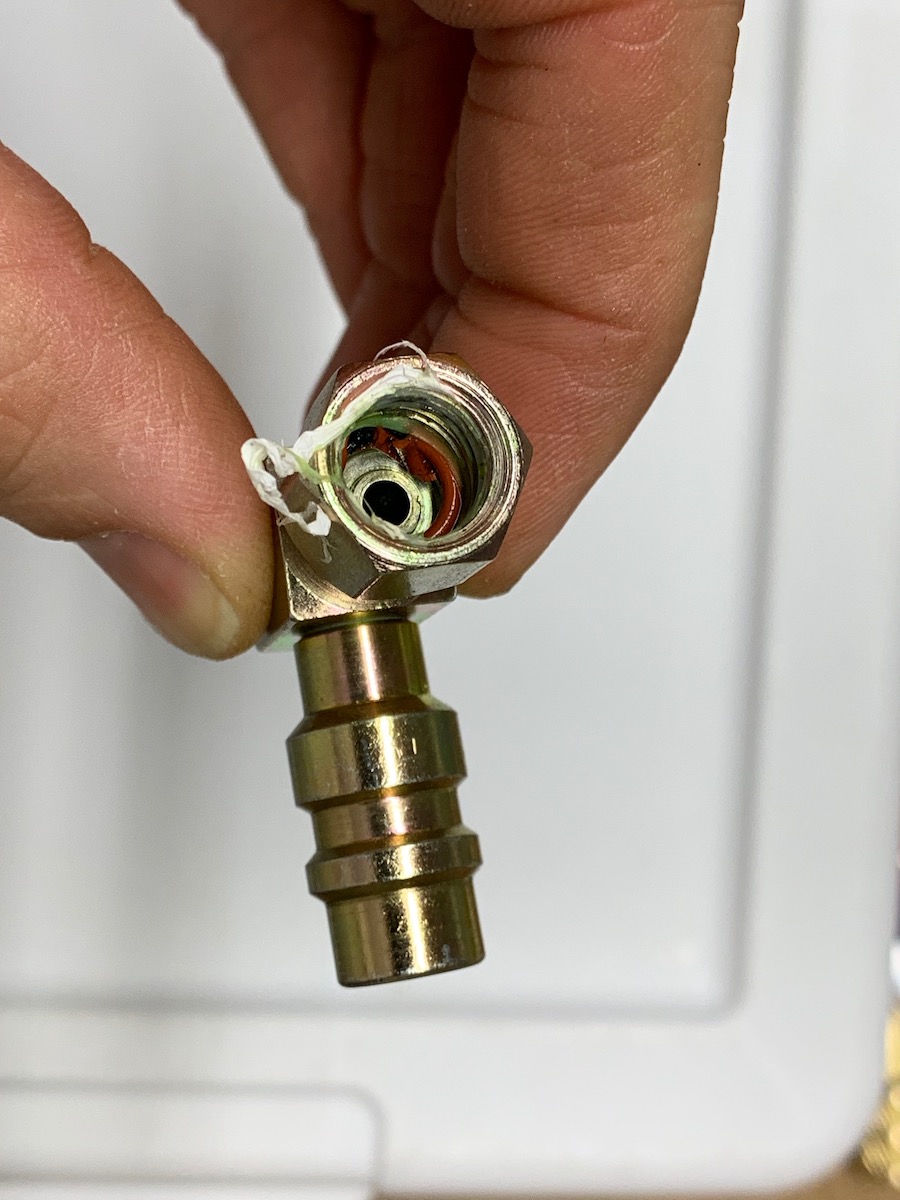

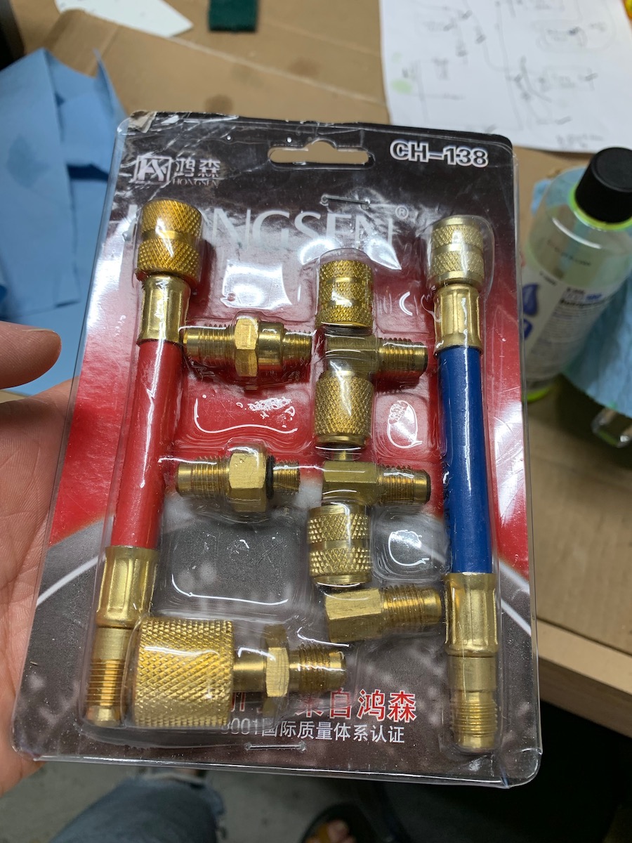

But I had a suspected culprit... the chincy Chicom right-angle adapter I'd put on the compressor. Upon pulling it I found this...
So I ordered a more promising bit of hardware. Only to discover that it was also chincy Chicom stuff.
But these actually had nice, sturdy-looking rubber in them. Also seemed much better constructed. So I fit one of the right-angle adapters from this set and pull vacuum again. Then I waited again. And it held!
So I charged it. I drew in 10.5 ounces of oil (6 for the compressor, 1 for each evaporator and condenser, and 0.5 for the drier bottle). Then I put in 3 cans of R134a. Mid-refill the AC clutch engaged and I had pressure.
And it was blowing plenty cold... sub 40-degrees F. And this was with both the front and rear AC running.
