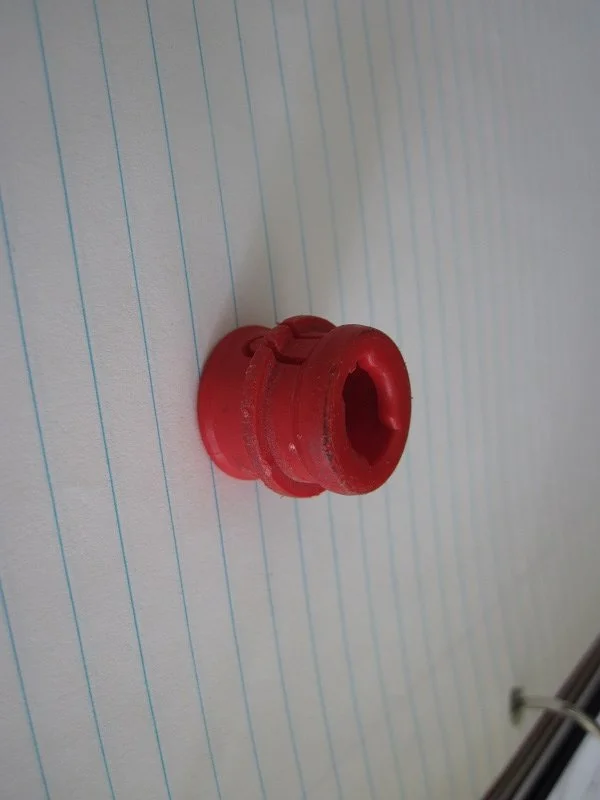

Here's the photo. It clearly doesn't have the black O ring. I have no idea what it is. I don't own a 70 series by the way but do have 2 80 series. I found it when unpacking after a camping trip. No clue what it came from but your photo of the engine bay triggered my memory of it and thought maybe you repurposed the same thing as a plug. The piece I have is open through the center and no electrical type connectors in it.

That does look amazingly similar... but looking at it I'm thinking it's a bushing of some sort from a tent, or foldable camping chairs, or some other camping equipment. But yeah... it does look like the end of the temp sensor.

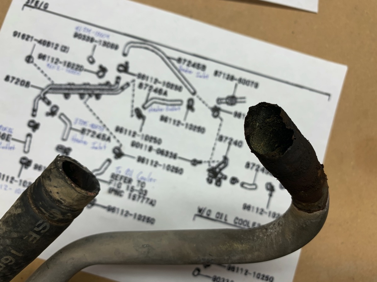

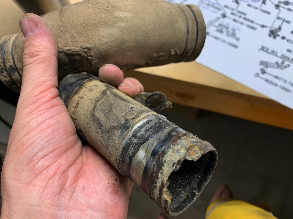

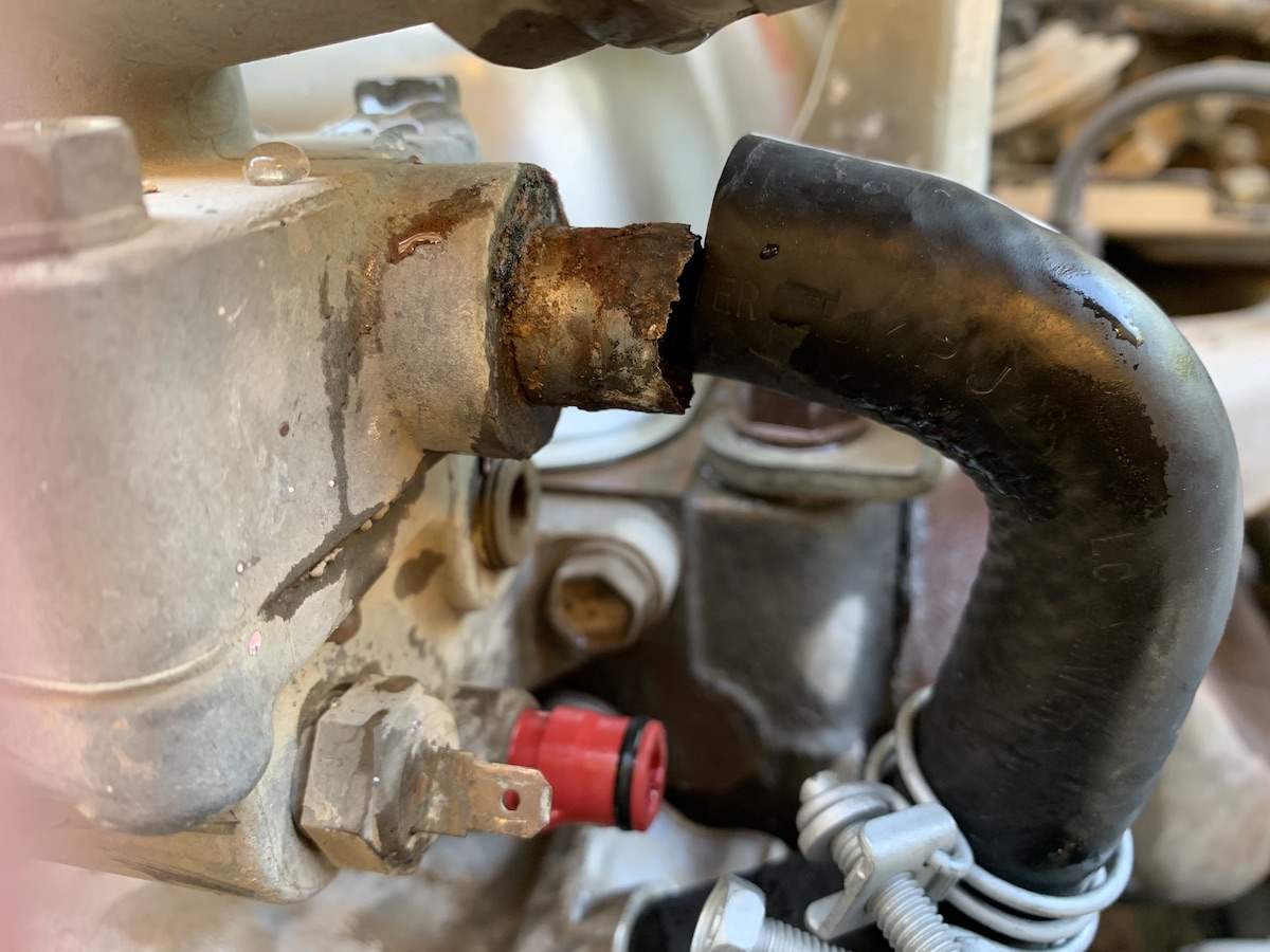

Well, I was right about a new weak point exposing itself. The union of the supply hose to the oil cooler pipe started to leak, getting to the point of spewing a nice mist of coolant all over my engine bay. Here's the culprit... with hose clamp removed the hose wasn't budging.

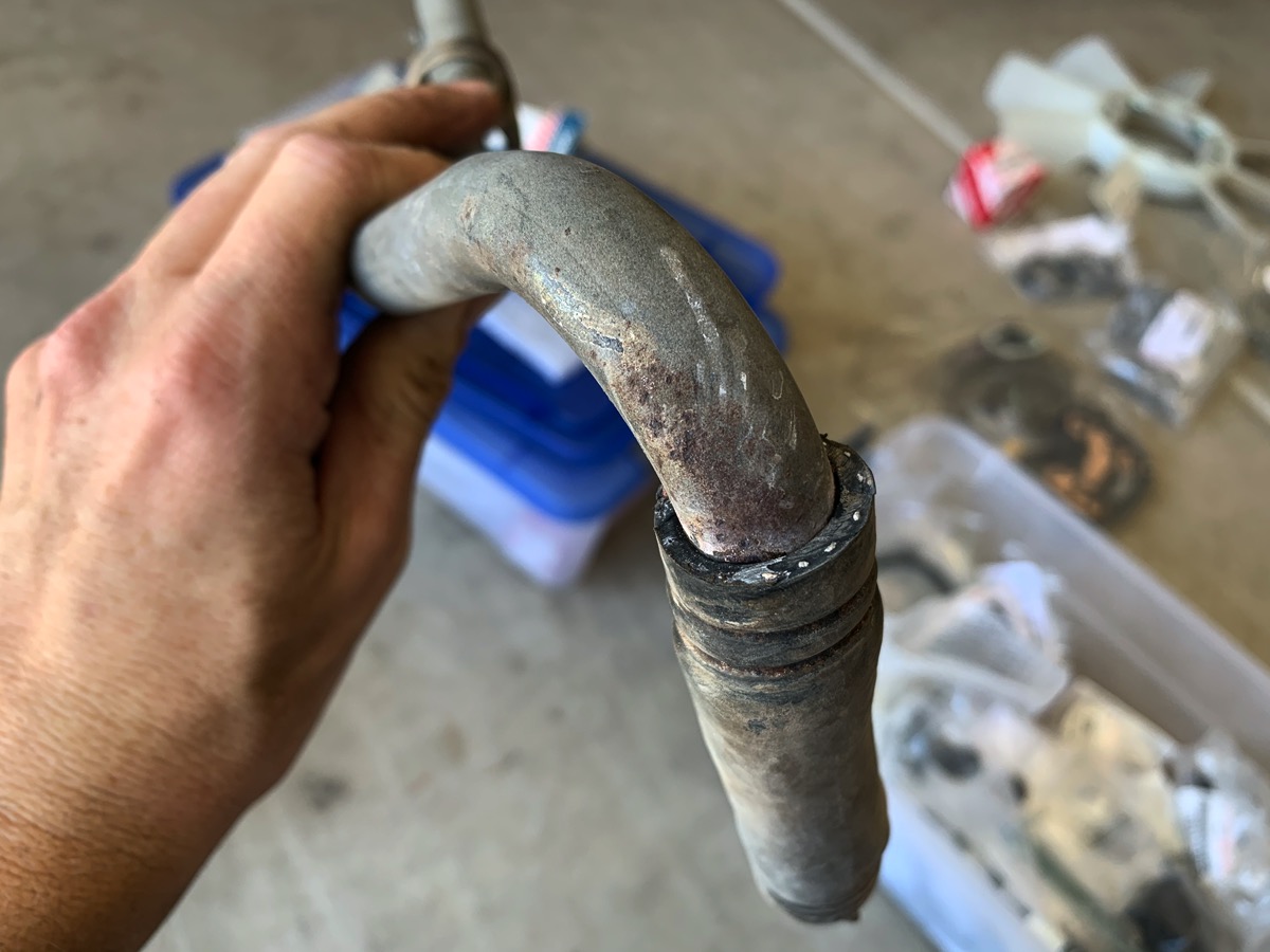

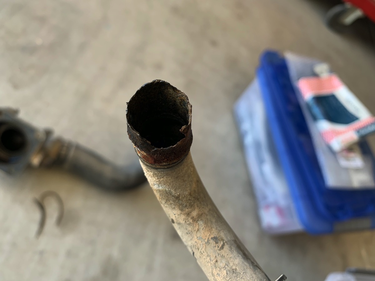

I had to really work to get the hose off the end of the pipe, and here's what I found:
The other end wasn't better.

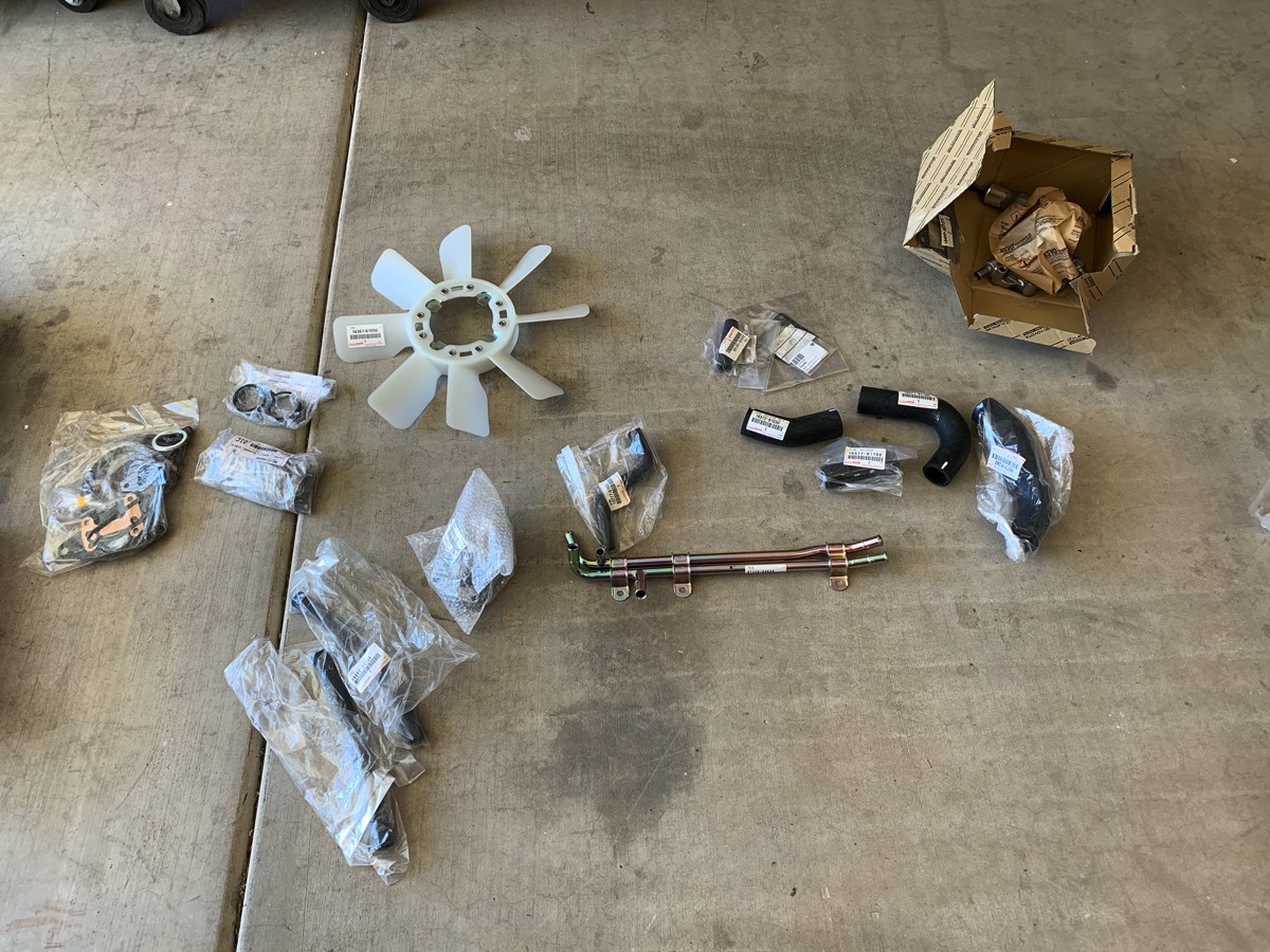

So I took stock of the parts I'd ordered while still overseas.

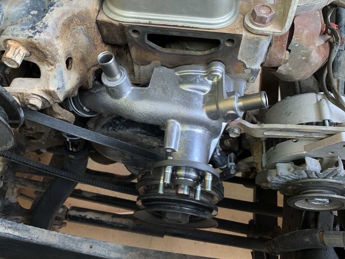

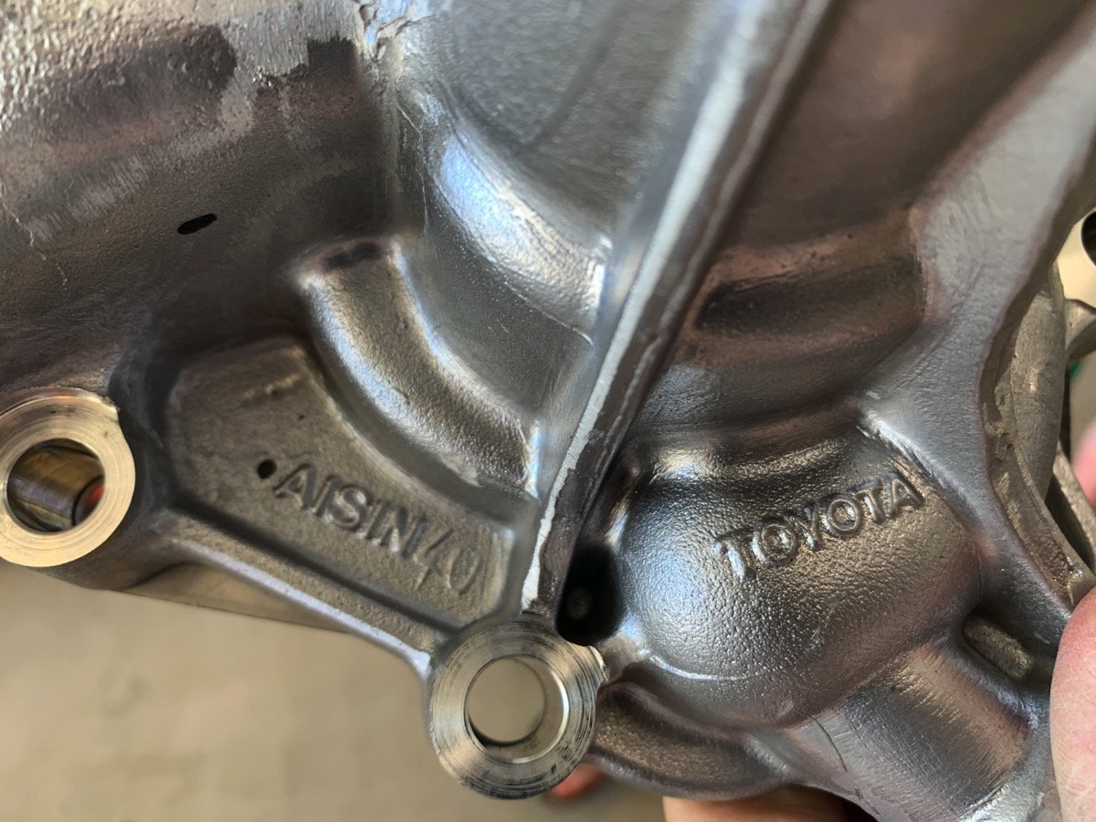

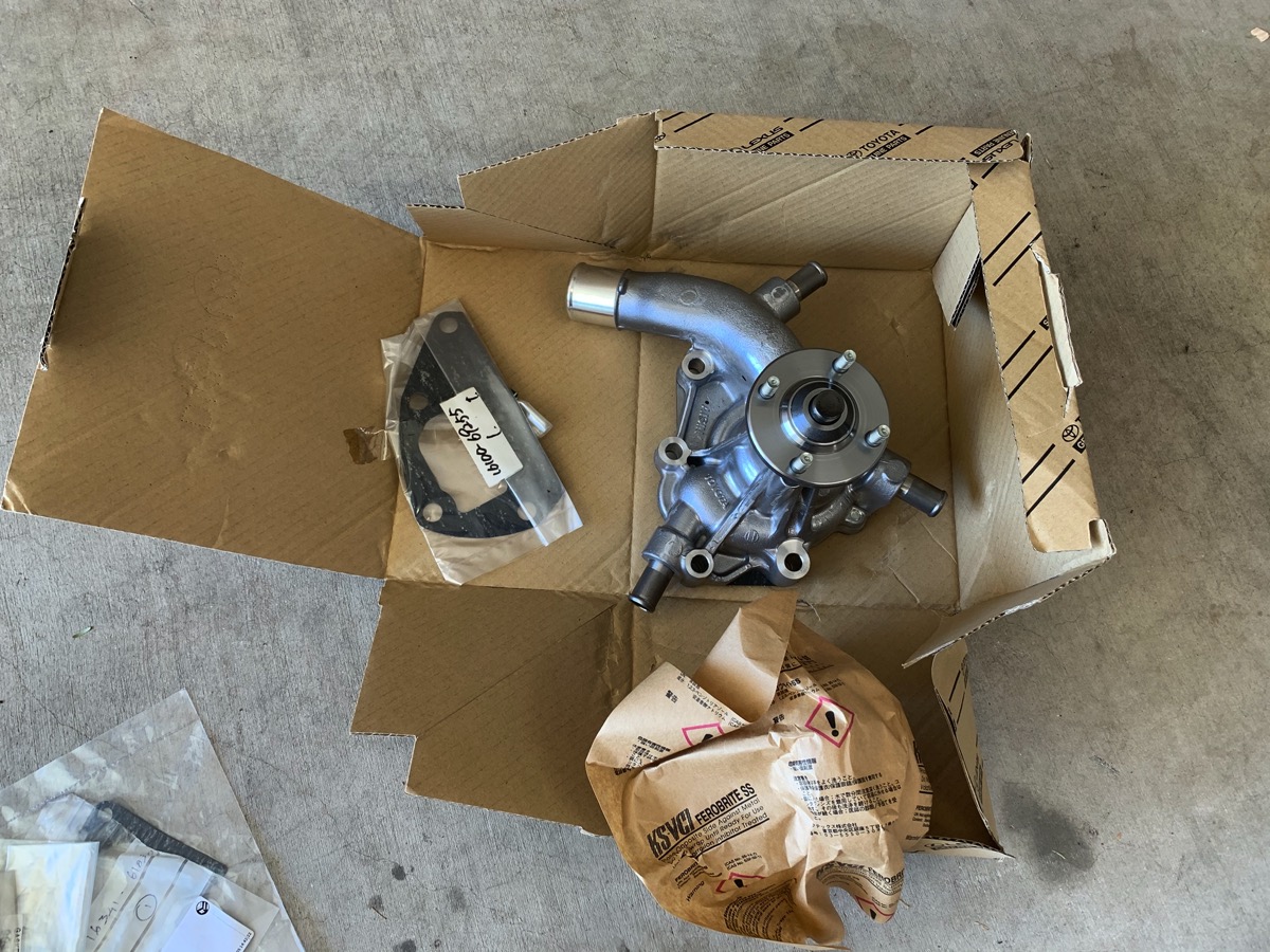

Man the new water pump is shiny! And it had a cool rust-inhibiting paper wrapped around the front flange where the fan clutch mounts.

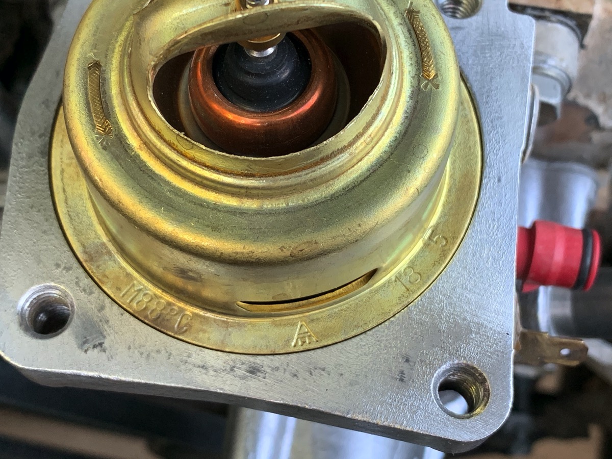

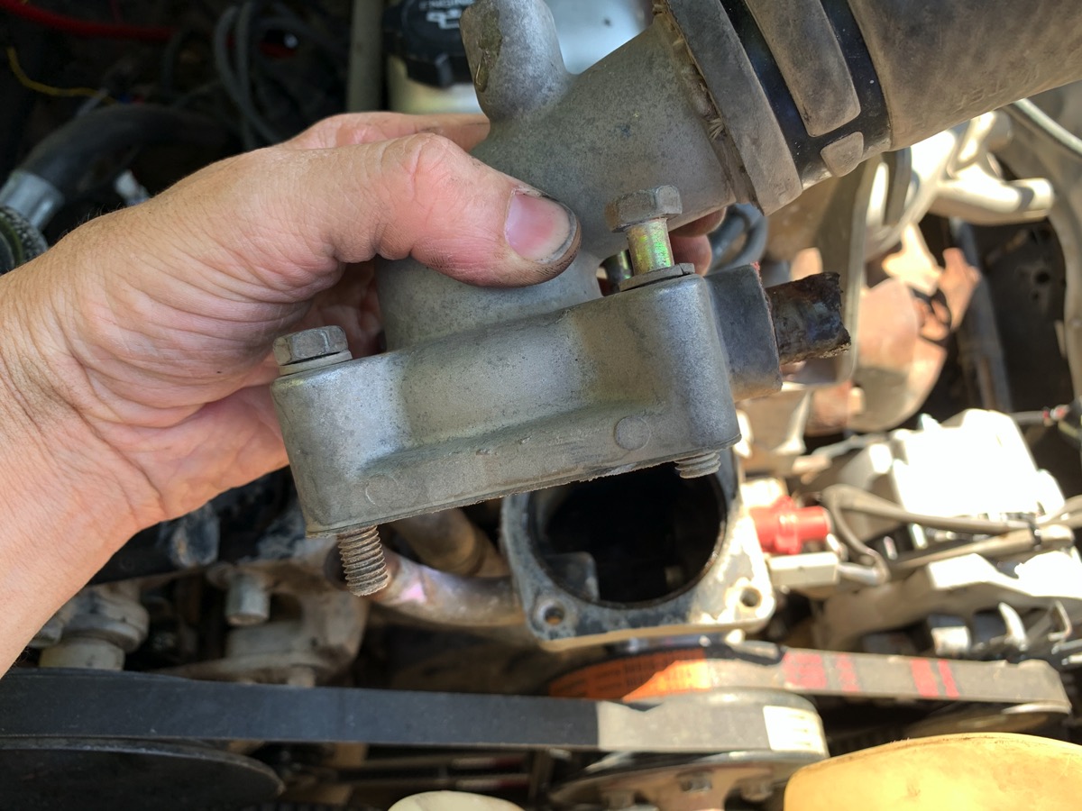

And for all the oxidized and eaten-away coolant pipes the mounting bolts for everything were easy to break loose and remarkable clean and devoid of rust. The thermostat housing, the water pump, etc. Upon opening the thermostat housing I was not totally surprised to find no thermostat. Almost every 40 you find over there just has it removed. This was no different.

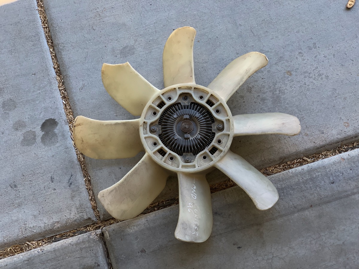

The fan was tired.

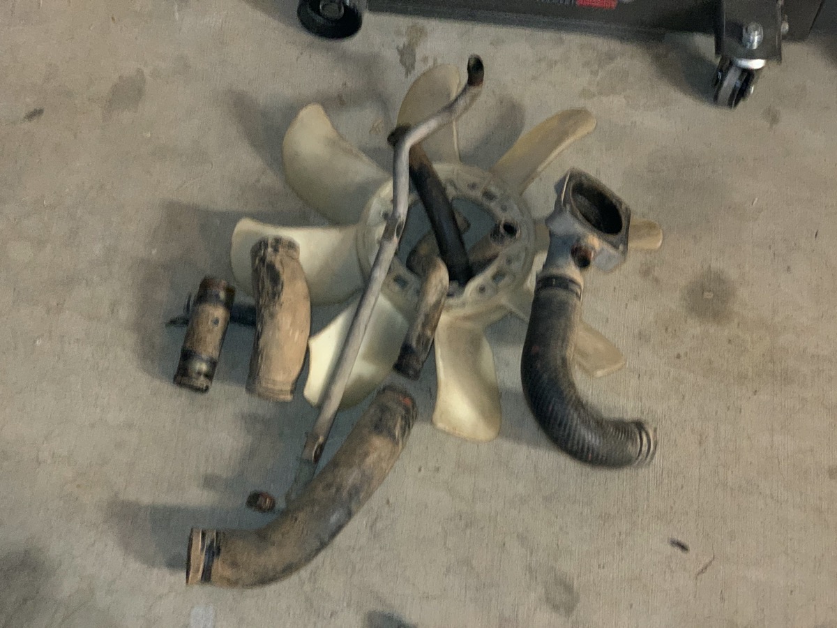

As was the pipe joining the radiator outlet hoses.
The trash pile.

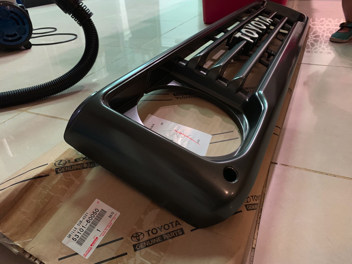

Where did you order this? On partsouq this part number is chrome/grey and I want the black.
Pretty sure the one in the photo is gray and not black.
I bought this while in the UAE. My parts guy sorted it for me. I actually ordered 53101-60030, which is the "no paint required" part and is the alternative to 53101-60040 which is the "plated" or chrome one. When I ordered 53101-60030 my guys got me this one... it was superseded they said. They knew I didn't want chrome. But you're right, on Partsouq the one they have pictured sure seems chrome, not like mine. Weird. It COULD just be the lighting... because the backside of the part is shown as black plastic and not chrome. Usually the chromed ones are chromed on all aides (see 53101-60160). If you look at 53101-60150 on Partsouq it has a very similar look... but it also has a close-up that clearly shows the dark grey with subtle metallic.
Indeed, mine is not pure black. It's a very dark grey with a very subtle metallic sparkled in it.
EDIT: I've now edited this note 3 times... upon further inspection the Partsouq one has just caught reflection and glared to look chrome. It isn't. 53101-60060 would be the true chrome version. The one on Partsouq is the same as mine. And man my parts guys were much better than Partsouq... on both price and making sure they knew what I wanted in superseded parts.
Hey @Bing173rd, this picture captures the subtle dark grey with some metallic pretty good... contrasted with my OEM black bumper.
Thanks, I really didn't want to get to stuck with a shiny grill. I try not to order from Partsouq but use them to verify as they have a lot of pictures of the parts. I'm in Japan so there are a couple places you can order and get free shipping, but the catch is no returns so you have to be correct on your part numbers.

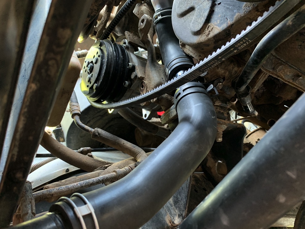

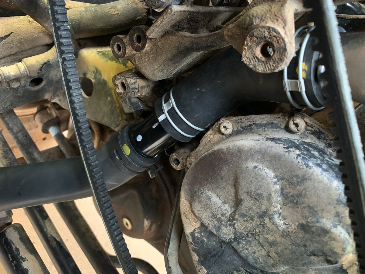

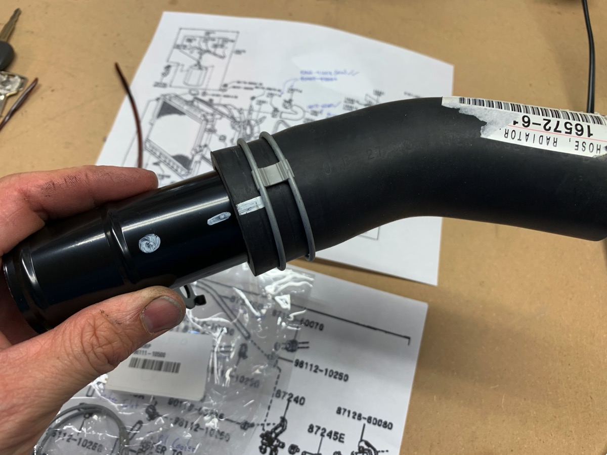

New hoses, new clamps... I just love the OEM dual-wire hose clamps. I think it was @Onur that advocated to me that I should stick with these way back when I first got my 40.
I also love the way some of the hoses/fittings have markings for proper alignment. Toyota's parts engineers man...
Radiator outlet hoses connected and routed in place. Kinda bummed that one hose clamp is no longer available in the wire type...

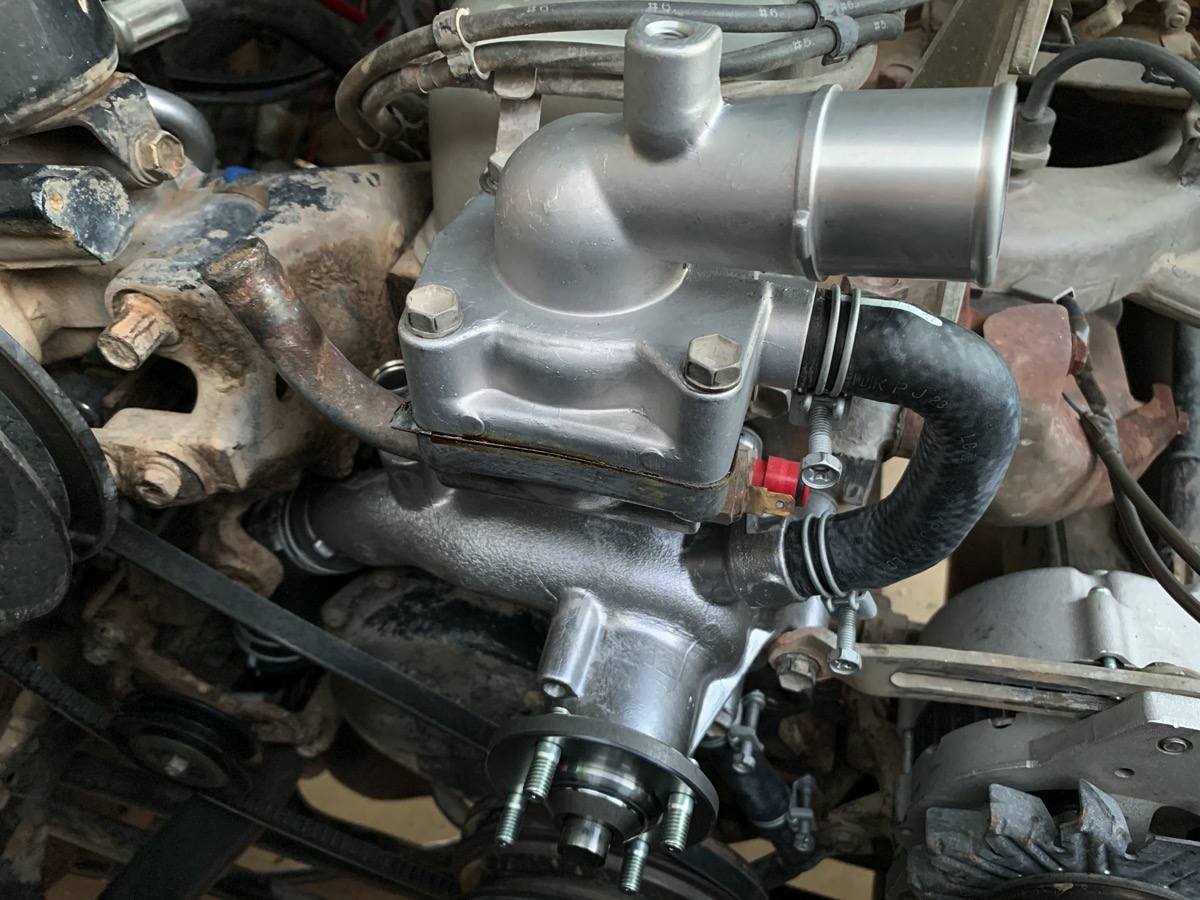

New pump on the block.

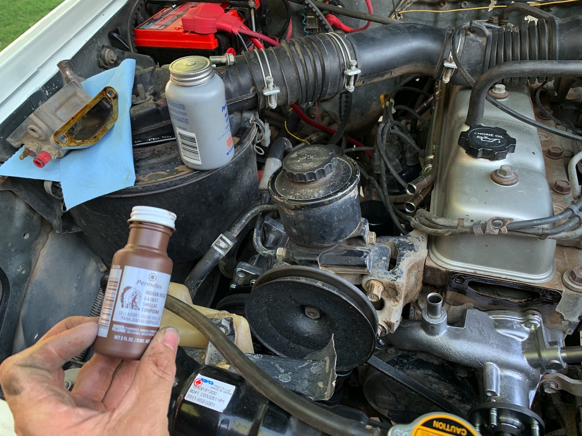

And using Indian Head (thanks to @wngrog for this pointer) to supplement my paper gaskets.
Bottom of the housing in place and mating surface cleaned.
And a new OEM thermostat!
And the housing buttoned up.

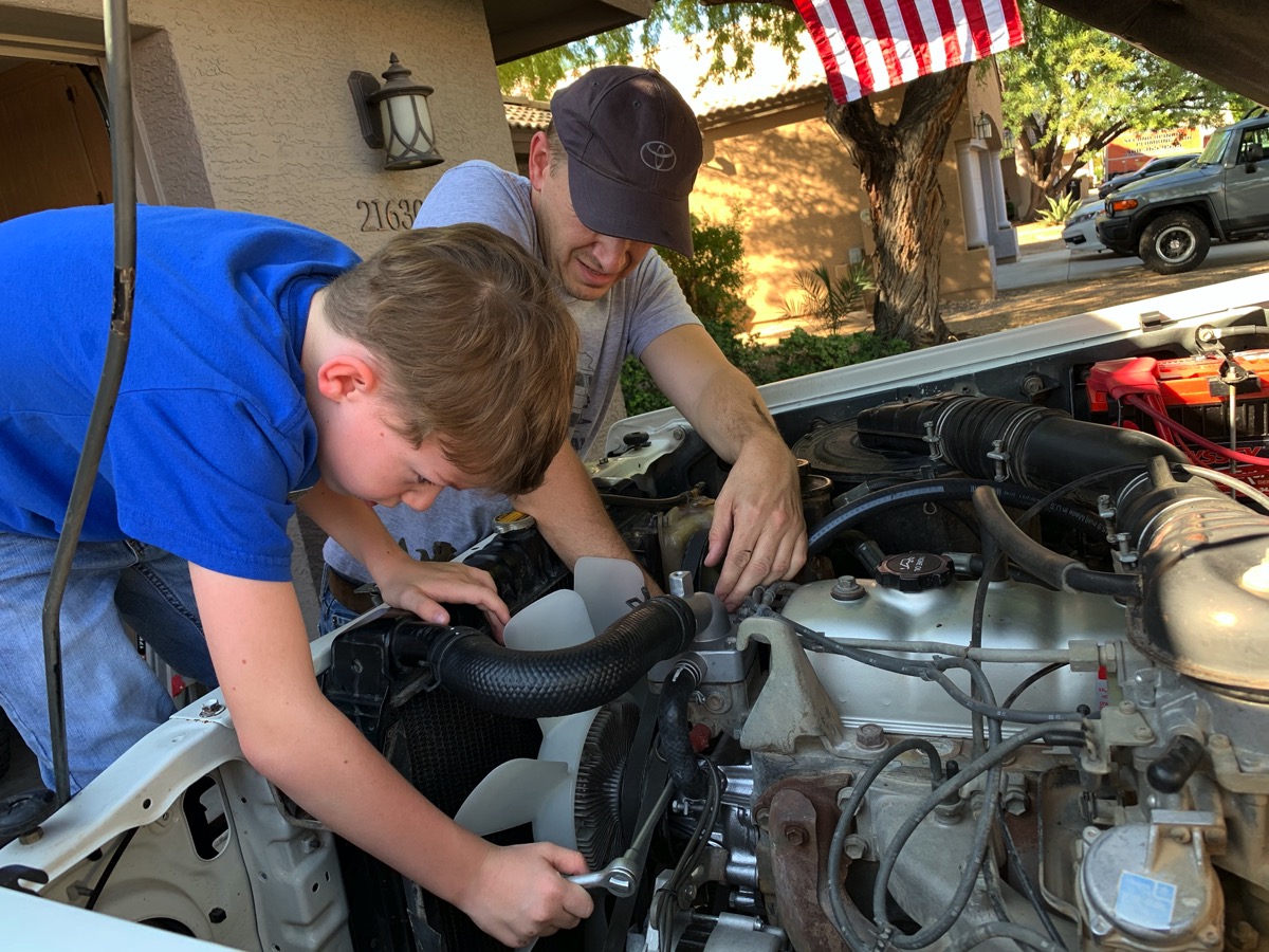

Had a bit of help on the re-assembly.
Great job! Love the flange prep. I use Gasgacinch. Is that similar to Indian Head?
I'm not sure how similar they are. Haven't used Gasgacinch. This is my first time using Indian Head actually. It's a "shellac" that is billed as most applicable to paper gaskets to augment them.
Not sure if the F series had 2 thermostats but I found out the hard way I needed the 82* not the 88* t stat on a recent desert crossing. Us southwest guys can't be too careful
The parts diagram doesn't list more than this thermostat... but that doesn't mean a lower temp one isn't available in other markets. I think I can use any 2F/3F/3FE thermostat in the housing. But I'd expect Toyota spec'd the right thermostat for a Gulf Spec truck...
The temp gauge shows a slightly higher average running temp than it used to. However, it gets up to temp much quicker and then stays pegged in one spot now pretty much no matter what I'm doing... windows open, AC on, stop-and-go, highway. Which is what I expect a Toyota to do. With AC in stop-and-go it used to get hotter than it reads on average now... and fluctuate much more.
Weather is cooling off here in Phoenix considerably now so I may have to wait til the thick of next summer to see if this thermostat is rated too high.
