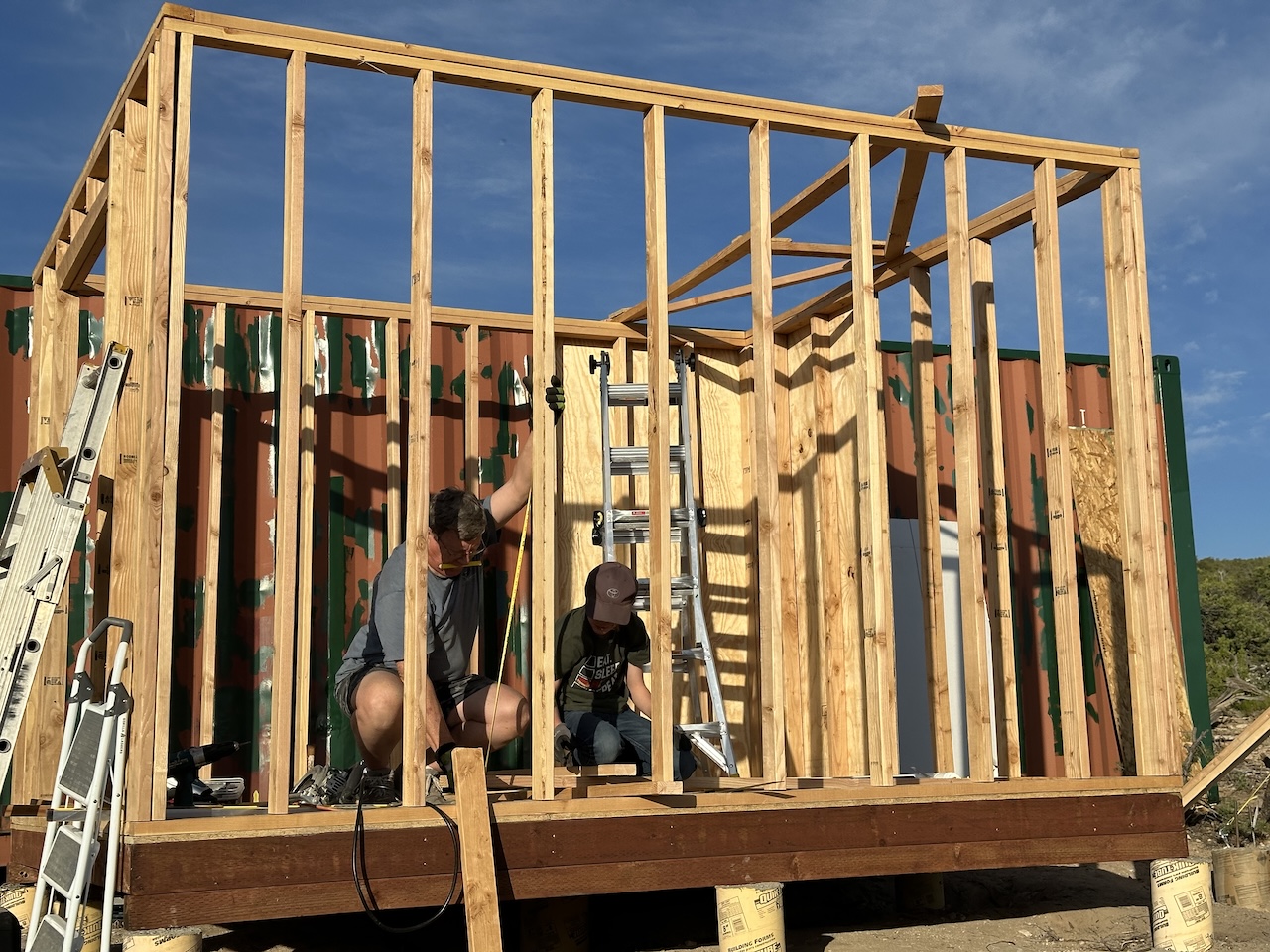

Last summer my father taught my younger boy how to do some basic framing. A buddy of mine has property up north and wanted a 10x12 "cabin" built... and he hired my son to do it. All materials furnished by my buddy and my dad and son framed it all up including trusses in our yard... and then we disassembled it into panels and flat-pack towed it up to the property.
Here's my dad and son erecting it on site...

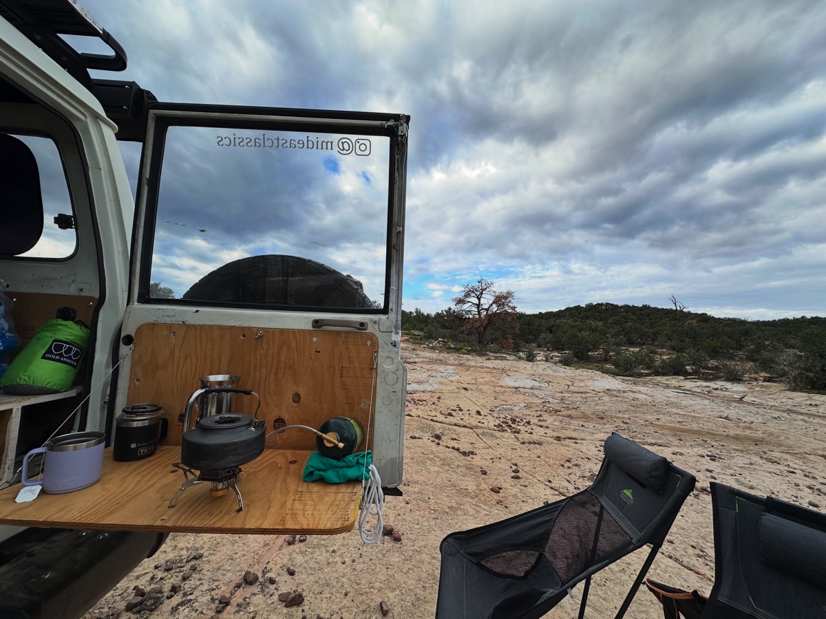

The fold-out table in the rear or the Troopy is great for early morning coffee...

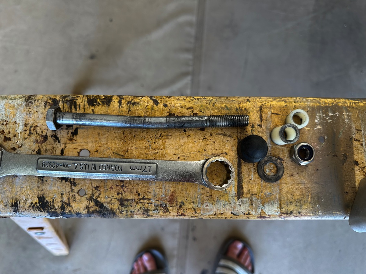

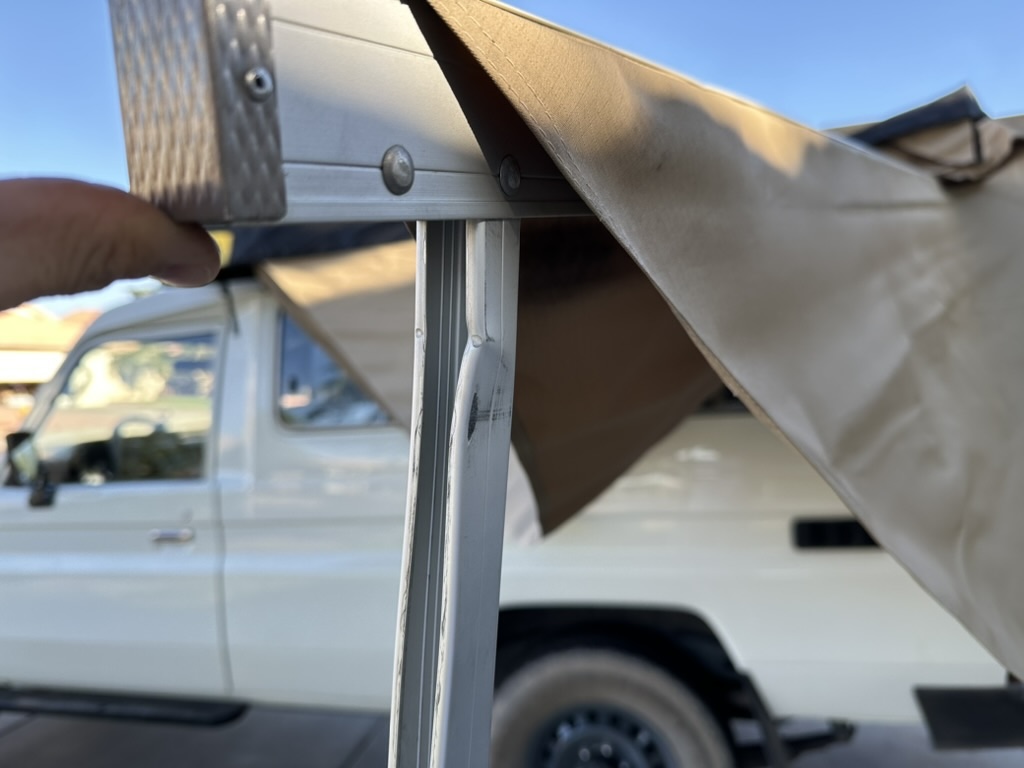

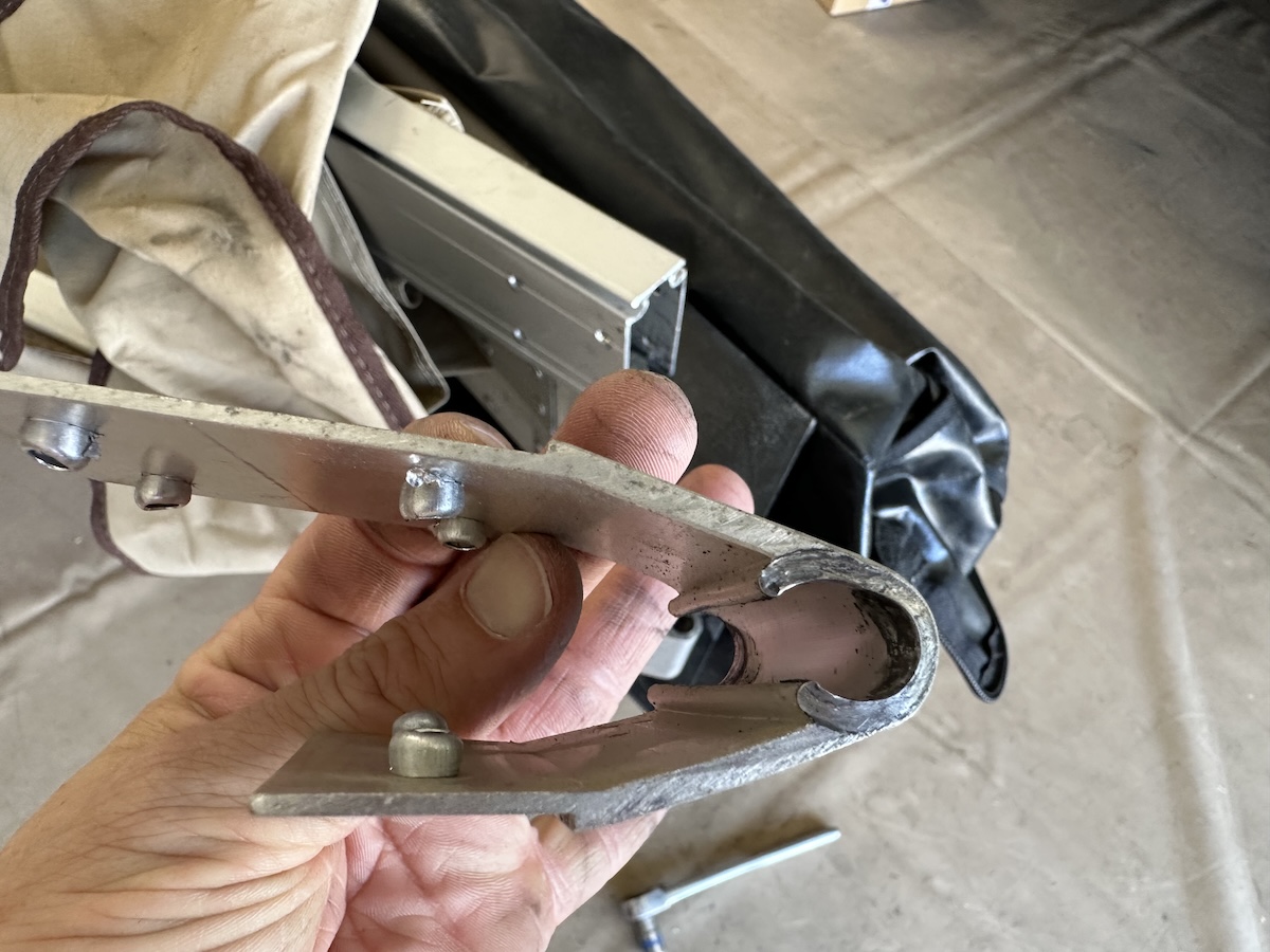

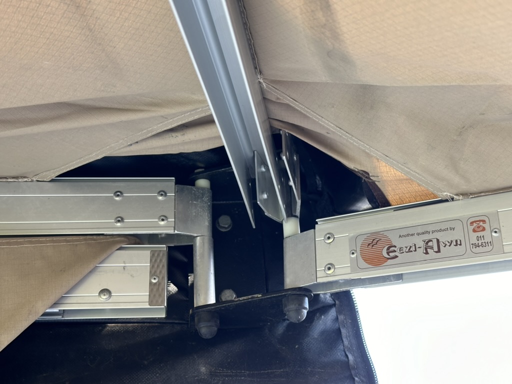

A bit of a bummer on one of my trips up to my buddy's property... the wind grabbed the shade awning and damaged one of the swing-out arms. The arm sheared off the swivel and one of the support legs was bent.

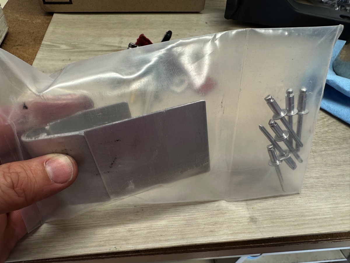

This is where the design of the K9 awning proves it's worth again. Just blown away by the intentional failure points that make for an easily fixable situation. The damage was constrained to the swivel piece as well as a bolt.
The hardware was easily fixed with a trip to my local ACE hardware (I have one nearby that fortunately has a great selection of metric). The swivel ended up being a quick phone call to @Equipt... who had a replacement swivel ready for self-repair as well as a replacement support leg.
With the abundance of rip-off design and manufacturing of cheap goods out there I am once again thoroughly pleased with this awning. Great kit.
So glad you were able to get a replacement of that rather unique extrusion.
