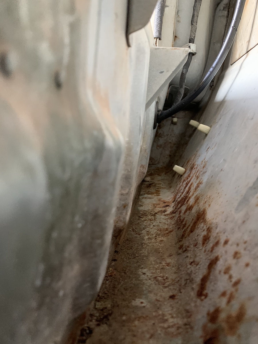

Pulled all of the rubber plug grommets out of the sills and ran the hose into the truck and blasted away... it started off way worse than it looks here. This photo was taken after several minutes.

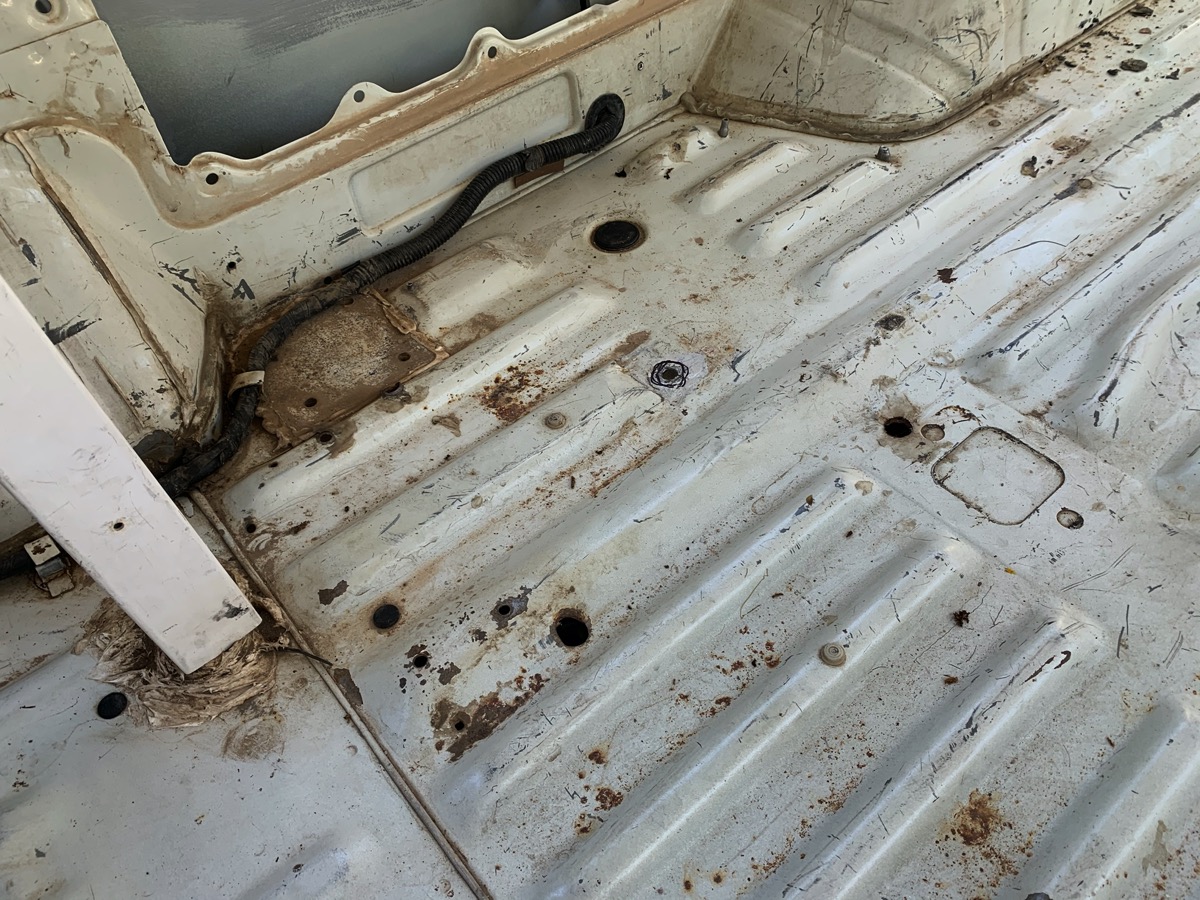

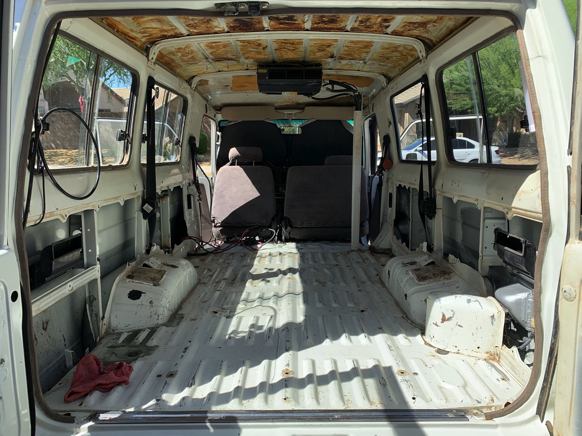

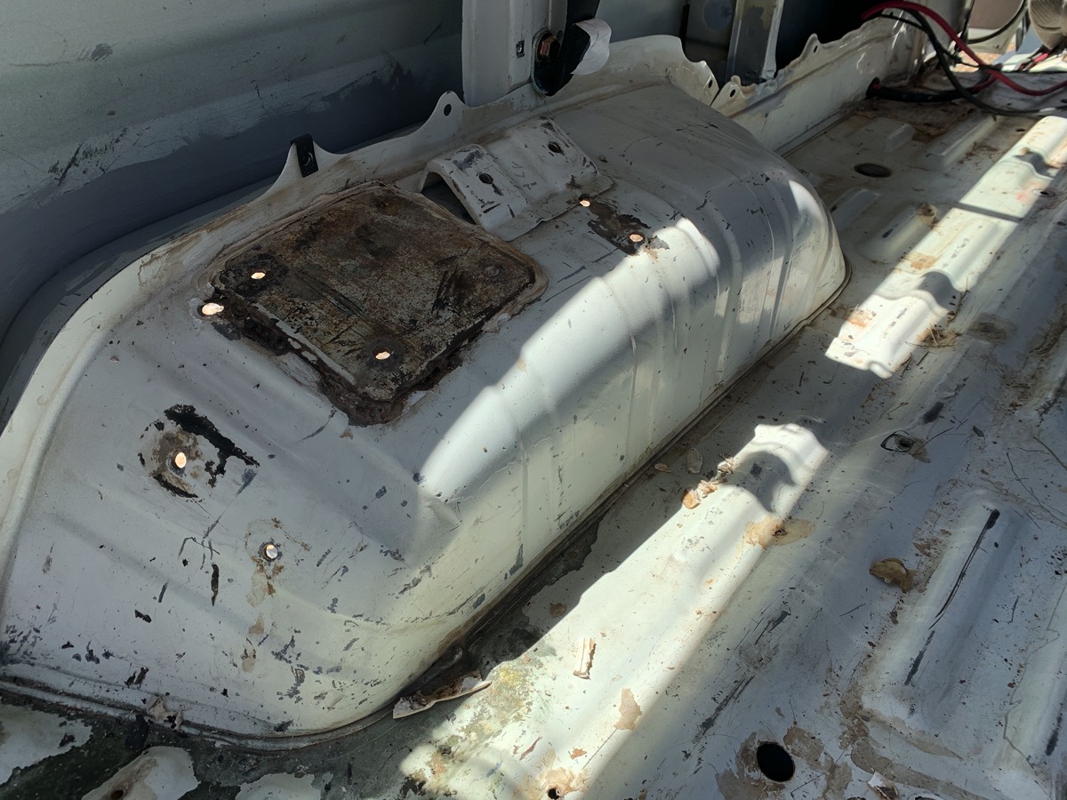

Then I stripped out everything in the back.

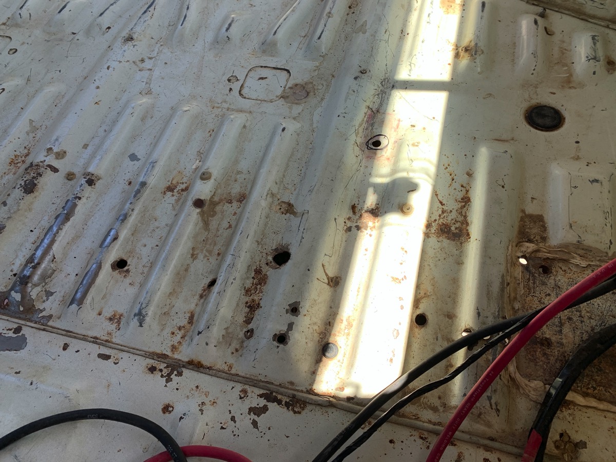

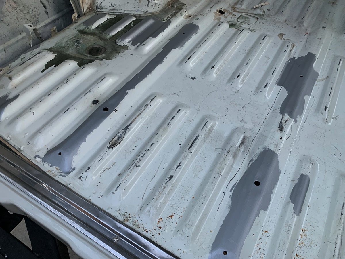

The floor in the back is Swiss-cheese... I counted 90-something individual holes and then stopped counting. They must have repurposed this truck several times. When I bought it I removed a large sheet of aluminum diamond plate that had been riveted into the floor and found a lot more holes than the rivets accounted for. And many of them "sealed" with caulking. There are four reinforcement plates welded in similar to @c2dfj45, for a roll cage at one point I suppose.
The worst of the rust that I could find.

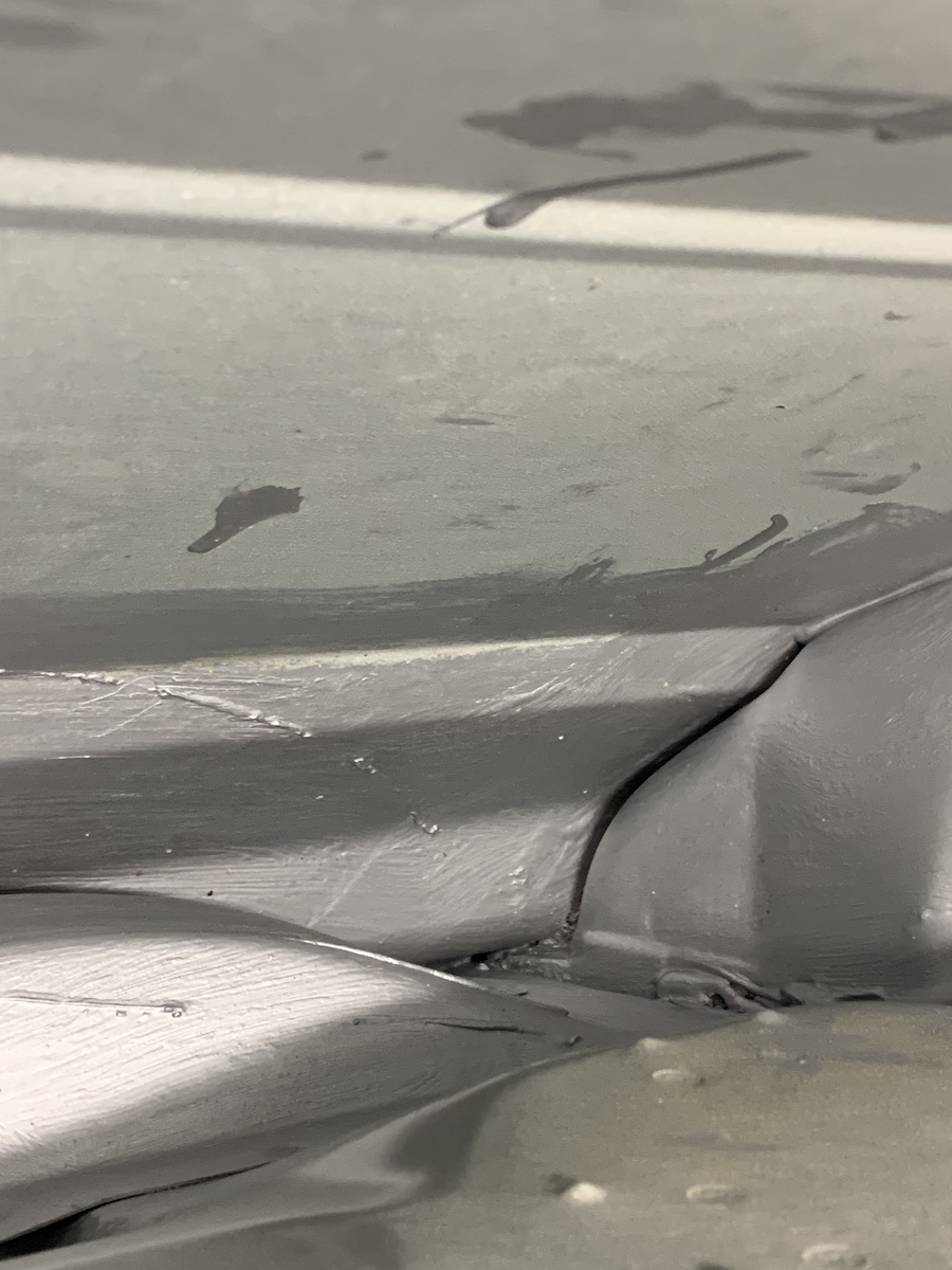

Laying down master series in the panel cavities and body seams.

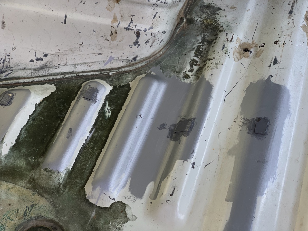

Also removed caulking, ground down jagged edges, and primed all the holes.

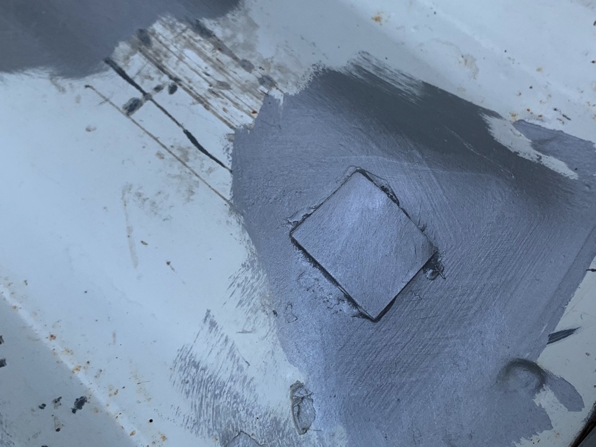

And I've been patching the holes with small pieces of 16 gauge steel. I'm bending them to fit over each hole and then gluing them down with Liquid Nails Fuze-It. Each metal patch is painted with Master Series before being glued down. My theory here is that eventually, once I have an appropriate workspace and a welder, I can knock these off easily enough with a grinder and then weld them properly closed. In the meantime, this reduces noise and dust intrusion and given my arid desert environment doesn't pose a rust risk. I'm torn on whether to Spectrum over these patches and then Raptor line... while I'm undecided I'm going to just put the workout mat material back down on top.
After the glue sets I smooth the patched area with the grinder again and then paint over with Master Series.

And an overview of more patches going down...
