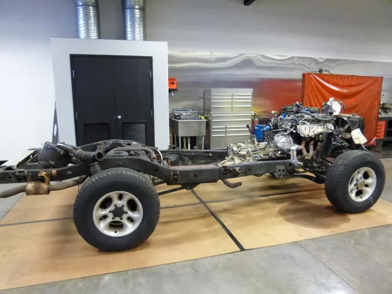

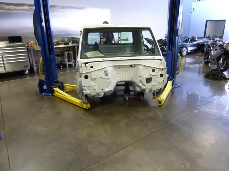

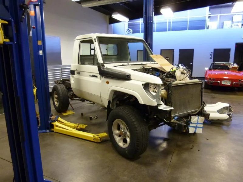

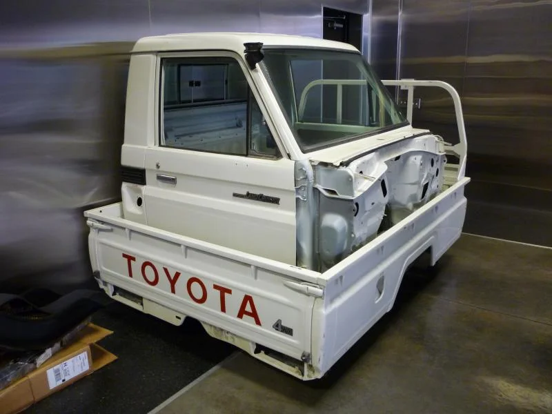

Thought I'd post up some pics of our 79 build. Pretty much the same as some of the other ones going on....1997 FZJ80 drivetrain and chassis that will be extended. My goal is to make this thing look as OEM as possible. I'm going to keep it forever so I'm doing the right way.....everything is Toyota and everything will be new. I've spent the last 1.5 years amassing my interior/exterior parts. My truck was damaged pretty badly in shipping so unfortunately, I'll have to repaint it(sticking with white). I opted to keep the interior good old Toyota oak as the door panels and mats were already that color. I'm digging the oak....very glad I went that route. Once we get the body squared up and mounted, we'll tear down the motor and do a rebuild. Strip the chassis for blasting/coating. I think I'll probably Linex the underside of the cab as well as the bed(going to do them in something close to oak). This won't be a 4 wheeler, probably just a daily driver with occasional off road use and or towing. Probably use it to run parts around for the shop too. Should be a fun build....should be more fun to drive it.

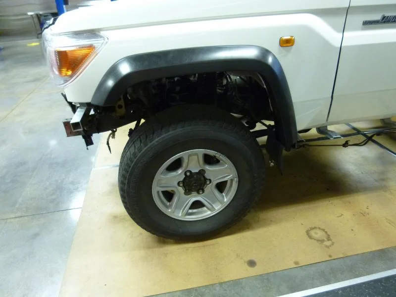

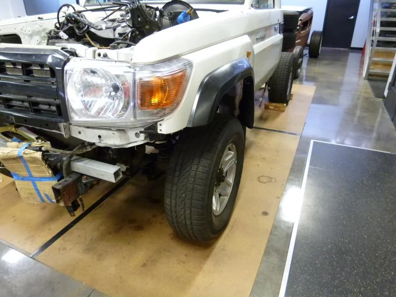

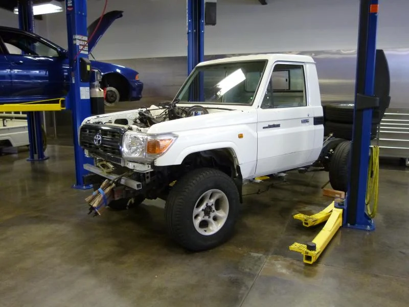

More pics....body going on the chassis for initial mock up. We should have the body mounted in position this week.....depending on the customer work in the shop. Since this is my project.....it gets worked on last. Fine by me.
Once the cab is on and mounted....we'll lay out the stretching of the frame.

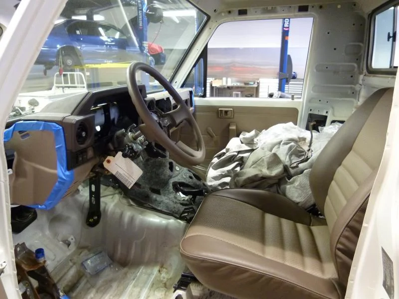

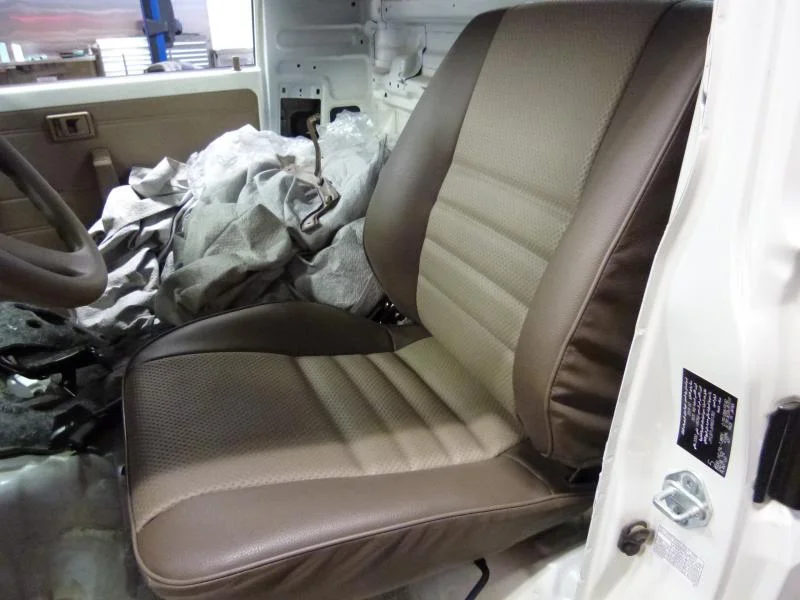

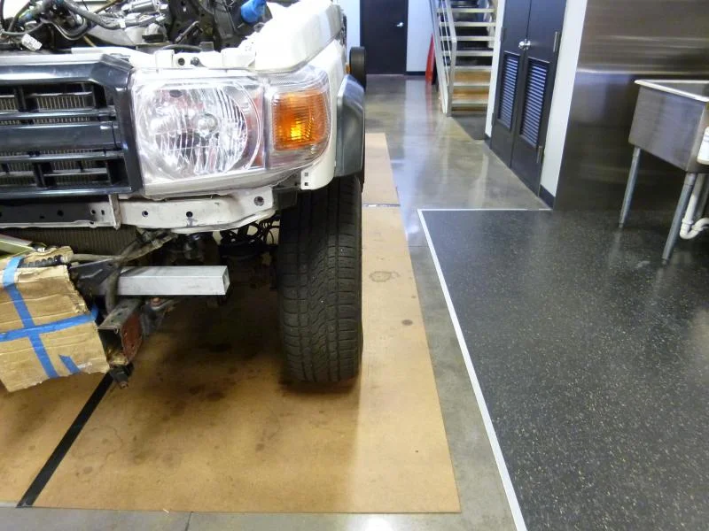

Last set of pics....rough mock up of the interior. I went ahead and ordered the OEM seats for the truck. Big bucks but for me, it's important for it to look legit. I have every piece of the dash, the heater and most importantly for me, AC. A must in FL. Column was a RHD unit that we will witch over to LHD....have all the pieces. New wheel, new horn pad, new cover for the column. Oak of course. I also bought a full matched key set.....doors, ignition, glove box. One key. Nice. I was very apprehensive about the width of the 80s axles and the narrowness of the 79 body so I went ahead and ordered OEM fender flares. They're pretty slick and fit on as you would expect...perfectly. They'll be color matched to the body when it gets paint. Working on doing the gauges(I have a used cluster that I'll 'blend' with the 80s gauges as I am keeping the 80s harness(I think). We'll cross that bridge when we get to the wiring phase.
Did a quick inspection of the steering column....I have a 14mmx36 spline female universal on the column(not sure what year the column is). 17mmx36 is the output of the 80 box.....14mm splined shaft isn't that easy to find....thinking if I could use that, I could do a 14mm/17mm universal into the steering box.

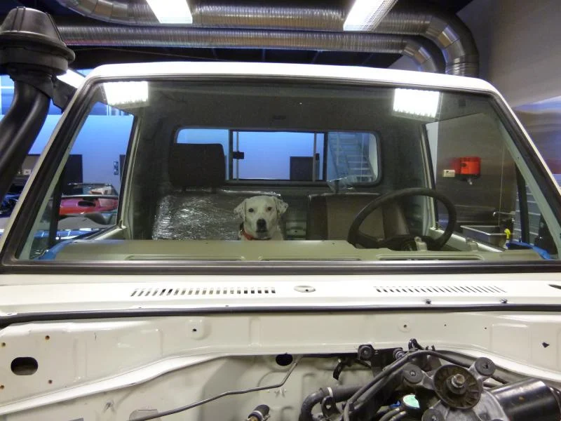

My dog likes her view from the passenger seat....
