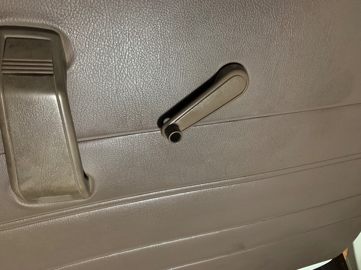

Simple little job done with my boy a month or so back...

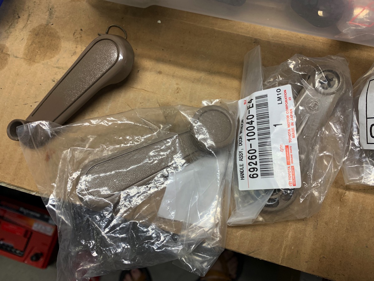

Both my window regulator cranks had no handle piece.
I thought it was cool to see "AISIN" and "TEQ" on the backside of the crank.
Of course the old brown (Sable) color interior stuff is largely NLA, so I went with the new Oak stuff.

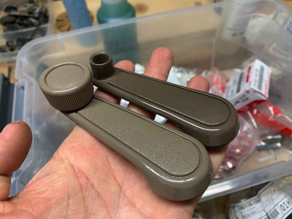

And installed.

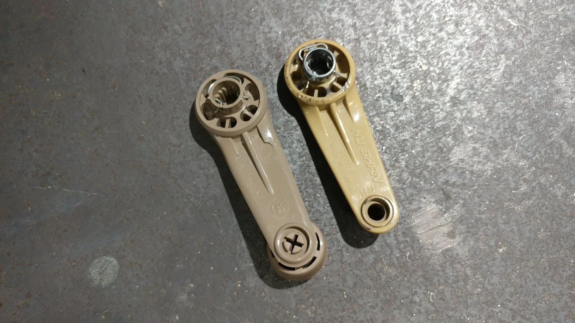

Kind of a boring update. But I thought it was handy to see a comparison of the old and new brown colors, Sable and Oak.

I often wonder what causes automakers to spend so much time, effort, and money on interior colors of vehicles such as this. Just make a 'brown' or 'tan' interior, keep it that way, and everything would be cheaper and easier.....for Toyota and for the consumer. No one buys a 70 series because the interior is 'Sable' instead of 'Oak'. All auto makers suffer from this.
They weren’t available as options to each other... Sable preceded Oak. I think the move from Sable to Oak was a simplification thing for them... Oak is available in a lot of their trucks. It’s kind of a standard color now across the Land Cruisers.
My troopy had the ever popular Hu Shan handles. Weird color too. I'm sure they weren't concerned about color match when they went on.

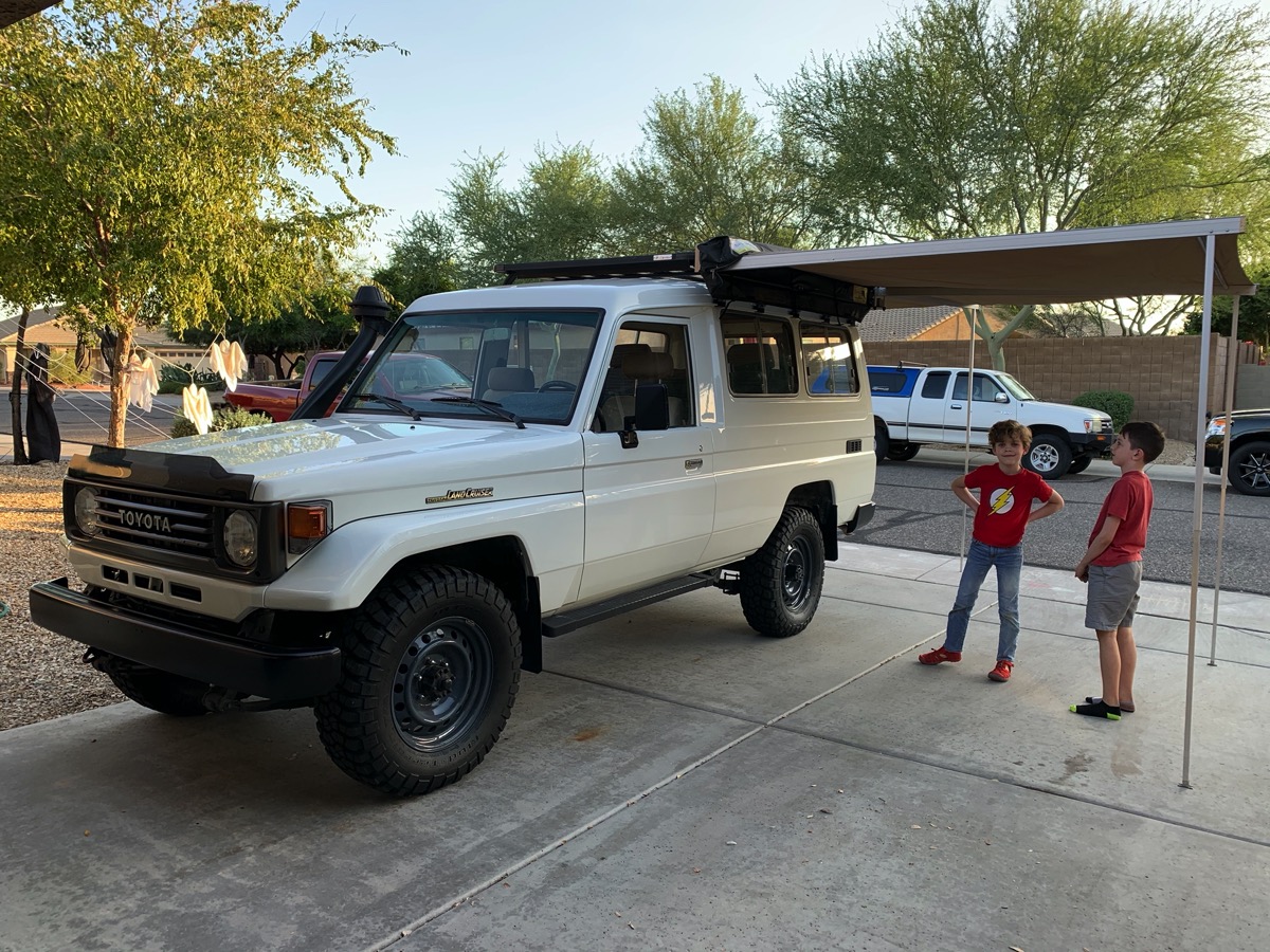

I owe many thanks to @AndrewHadji... I picked up his old Eezi-Awn roof rack and Manta awning after he did the can-opener job on his Troopy roof and installed the Alucab.
We managed to sort out shipping through uShip. Interesting model they've got set up and it worked out alright. Everything was delivered in good condition. Andrew really hung with me while I sorted out how/when I was going to get it picked up and shipped. Thanks again man!
I gave the roof of the Troopy a good waxing with Griot's products and the random orbital before installing the gear. Won't have much access to the roof for awhile now.
Some shots of it installed:

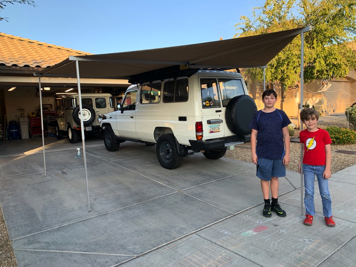

My oldest boy and his cousin helped me install the awning and we folded it out to try it out...
We used a simple square awning on our 80-series in the UAE... and we used it a lot. It was very handy to have and we knew an awning was in the plans for the Troopy. This 270-degree is going to work out really well for us.
On top of the roof rack I'll be mounting a few basics... Maxtrax, shovel, axe, and a solar panel. I want to keep it relatively unloaded and low profile height wise. But it sure is spacious up there. I'm sure I'll find other things to throw up there. =)
Super pumped. Thanks again Andrew!
I just cant express how beautiful it is to see your lovely kids work with you on your 75.
it is a pleasure to see how you have brought this baby back to life. keep up the great work.
Your 75 looks awesome.
Thanks a bunch! And yeah, the kids are big part of my cruiser fun. I don't want to do it alone.
Looks killer. Very jealous of the weather. 8 degrees here this morning.
That pic was from awhile back. We are all wearing jackets around here now. Ha!

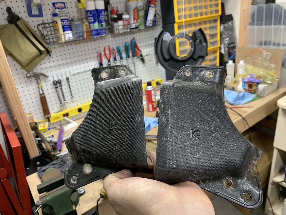

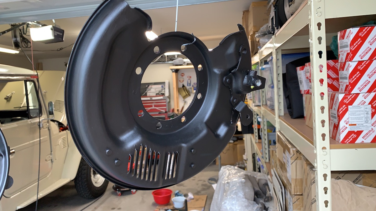

I've been rebuilding front and rear axles... brakes, bearings, seals, gaskets, etc. As part of that work I've been cleaning up various parts and repainting them. The front backing plates had air scopes for the discs. As I was cleaning all the embedded and concrete-ized fesh-fesh, one of them literally fell off. The other was very loose, so I pulled it off. Hiding behind them were huge accumulations of the fesh-fesh concrete gunk.
I cleaned up the backing plates and repainted them. How vital are these air scoops? Do I need to figure out a way to remount them? There's lot of similarities between this axle and a 40 or 60 with disks... but the scoops are new for me.
