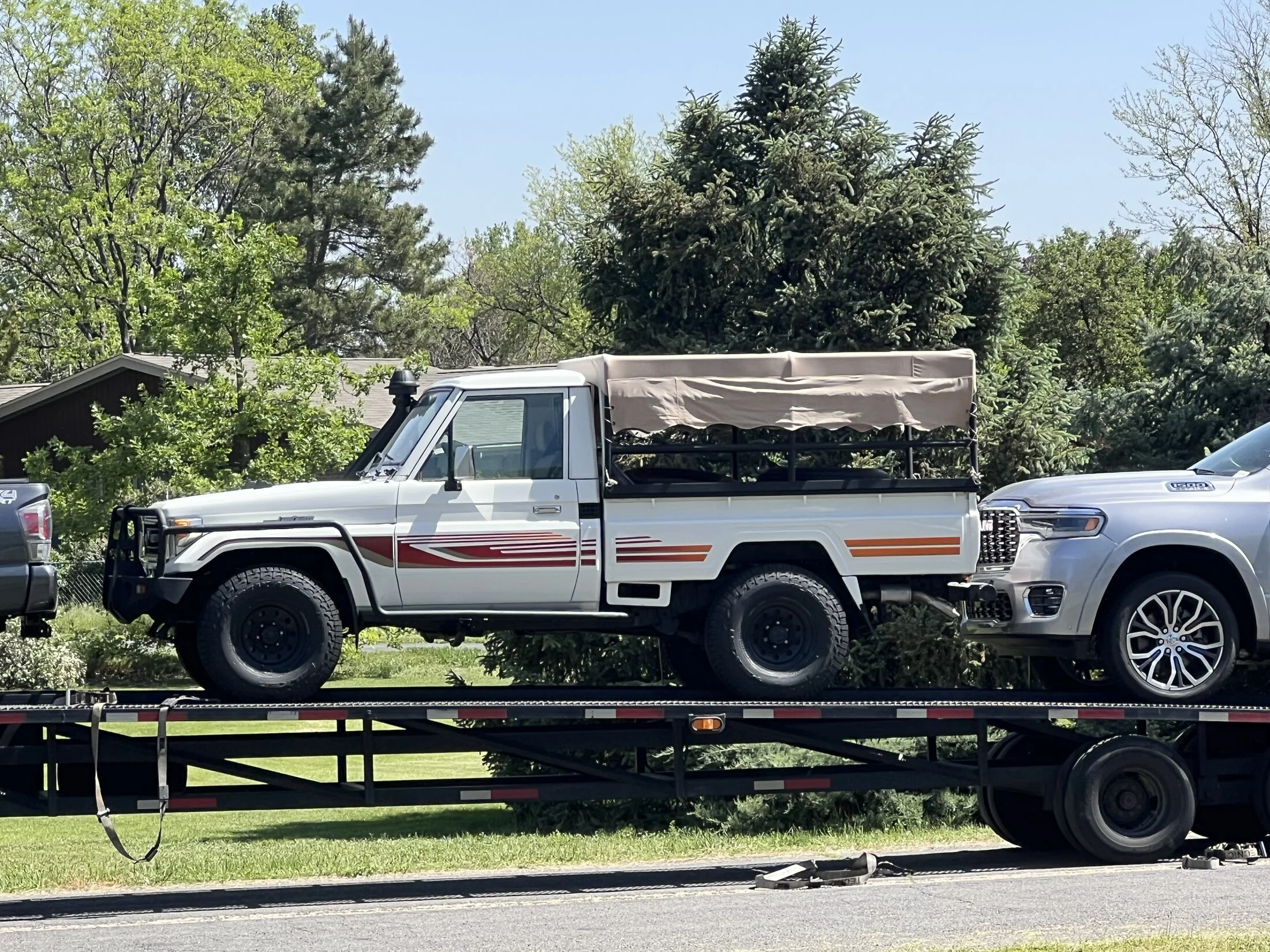

Just like the title says, what is the largest size/tallest tires that I can fit on one piece (non split) rim 16" factory steel wheels without having any rubbing? I searched both here and online and the range I am seeing is pretty significant.

You can fit 33 in. x 10.5 in. tires with no rub. Anything taller or wider will rub; it may also wear your axle seals/bearings faster.
35 in. tires require a front axle modification.

I thought there were a couple of 75 series pickups in the MUD classifieds with 35x10.50r17 wheels on them.
This would prove the 35" tires work
From there, your choices are:
Squeeze a 315/75r16 on a 6" rim - will work but you (and I) will be hated
OR jump to a wider aftermarket wheel with your choice of 16" wheels (0 offset) from these suppliers below
Things will be VERY tight, but I think I am correct. Please research, it is your money not mine

@saltycoconuts just sold his 75 series with 35x11.50 tires. Looked great.
Actually 35x10.50’s!
Such a great fit for 75’s
Although whenever I get my next 70, I think I’ll stick with a 255/85/16. A lot more availability in a pinch.
