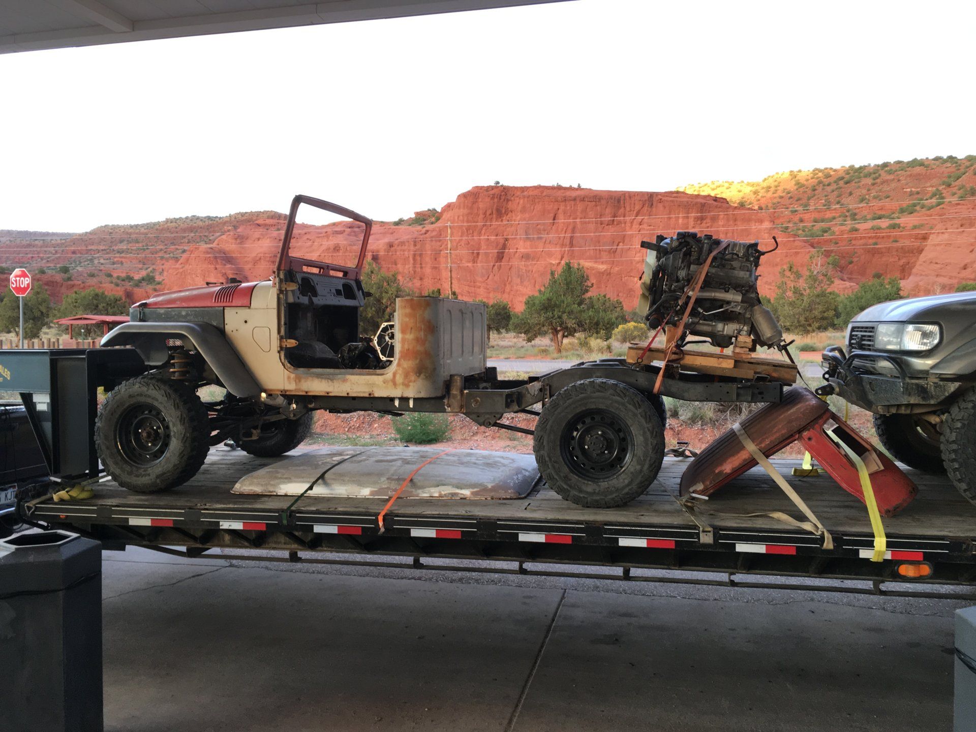

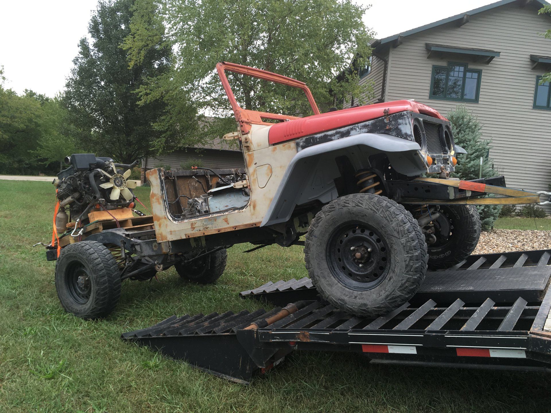

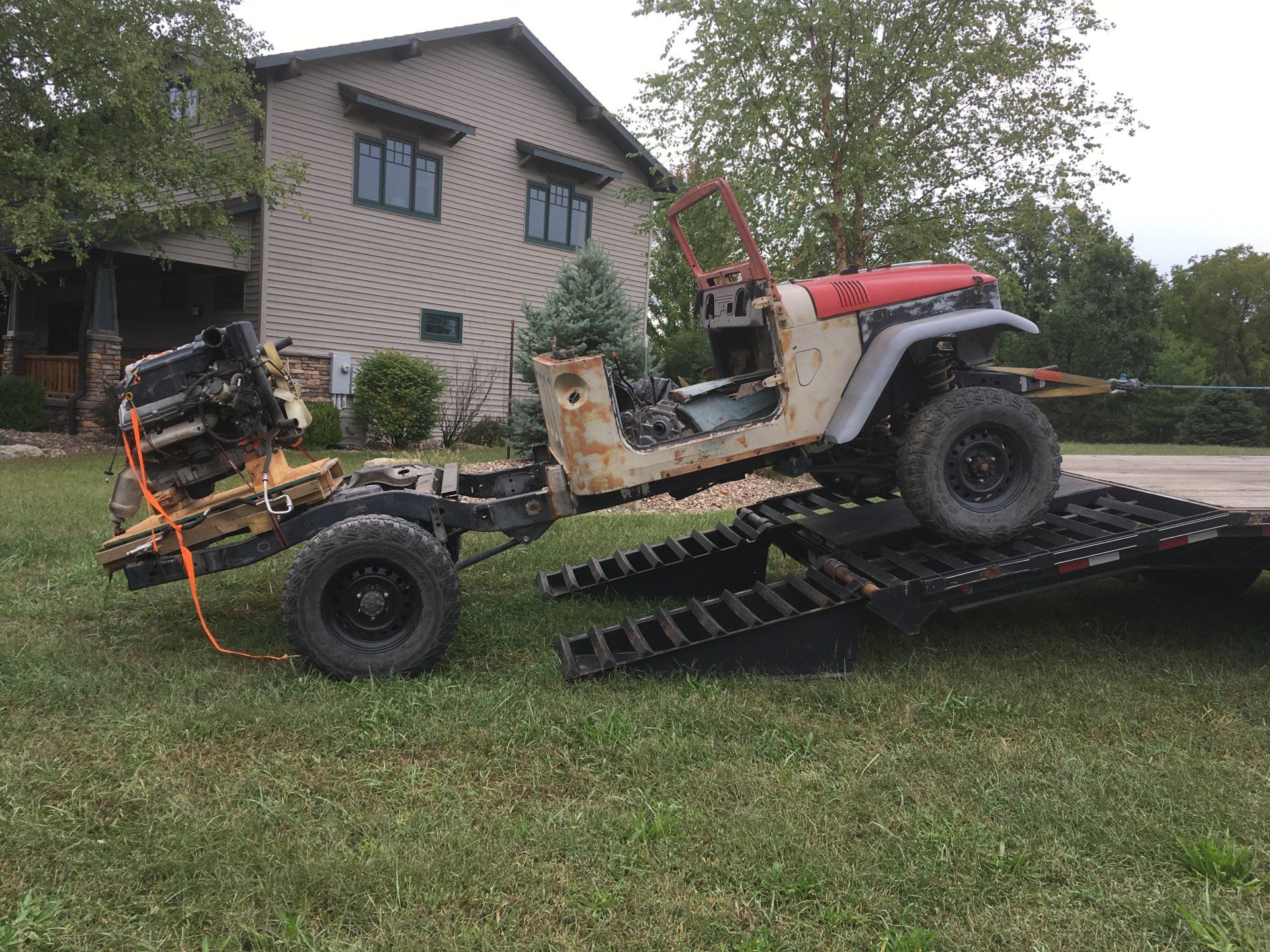

Assumptions were made, and you know what that does.... given all of that tank5 projects and posts in the past, I assumed he had a loader, He assumed I had a smaller trailer. Translation is that getting the engine off the ground and into the vehicle was quite a puzzle. We finally decided to strap it to the pallet and put it on the back of the 45 frame. Loaded up and started the long trip back to Kansas City..
Drove straight through the night, and made it back to Kansas City to offload and back in the garage.

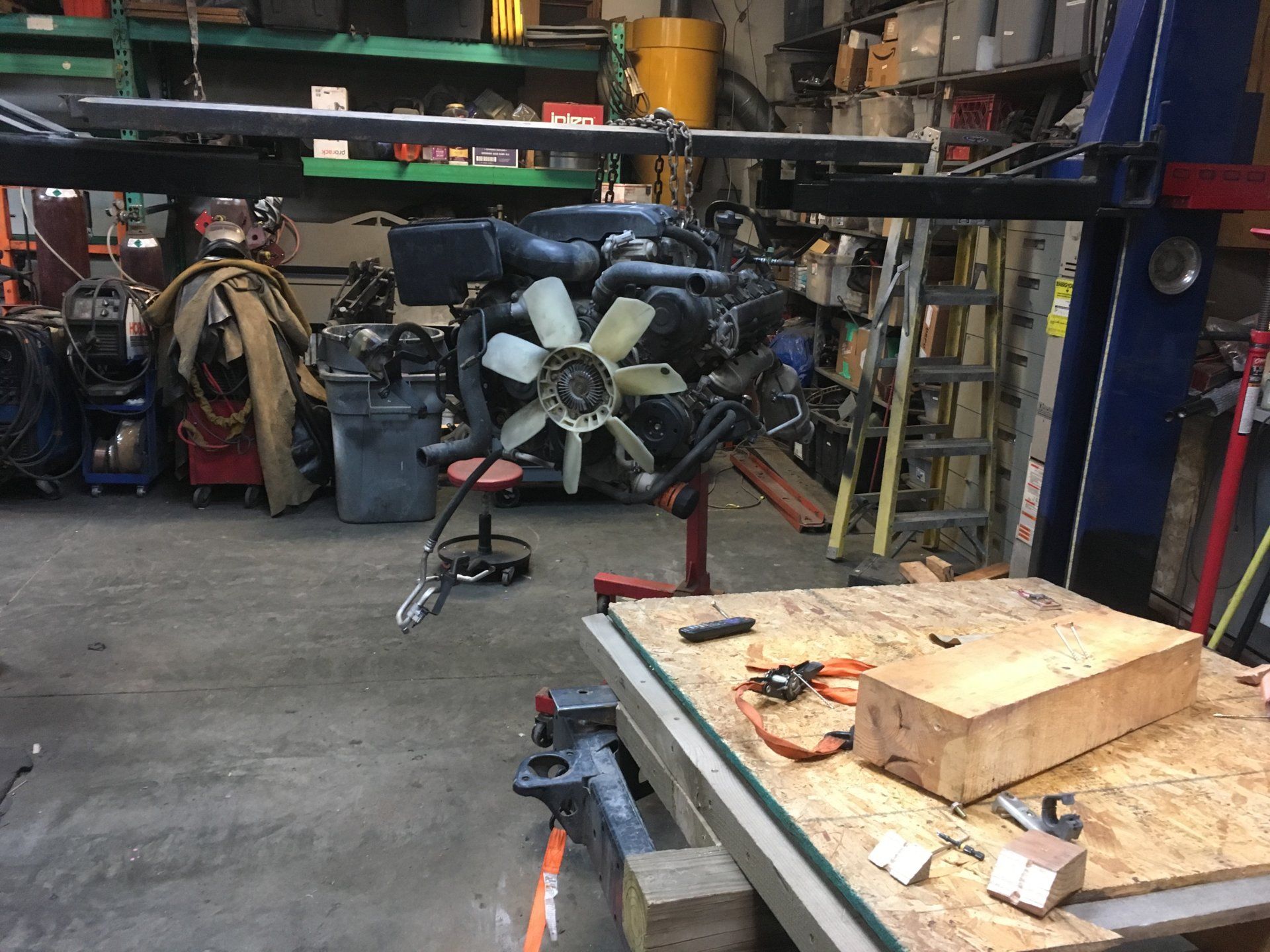

Somewhere along the way I decided it was time to pull the engine off and start working on this. Recall my original intention was to put a GM engine in, so still at this time I’m undecided about this 2uz. I plan to put it in, hook it up make sure electronics will let it run, then decide
That catches you up to this week. First on my list was to get the engine mounts fabrication started. I pulled off the OEM mounts, and fabricated these plates. Next step is to pull the oil pan and filter and replace it with a different sample pattern, that works better for the 80 suspension parts. I bought some DOM sleeved bushings on eBay, so plan to get the engine setting in place, then fabricate the rest of the parts.

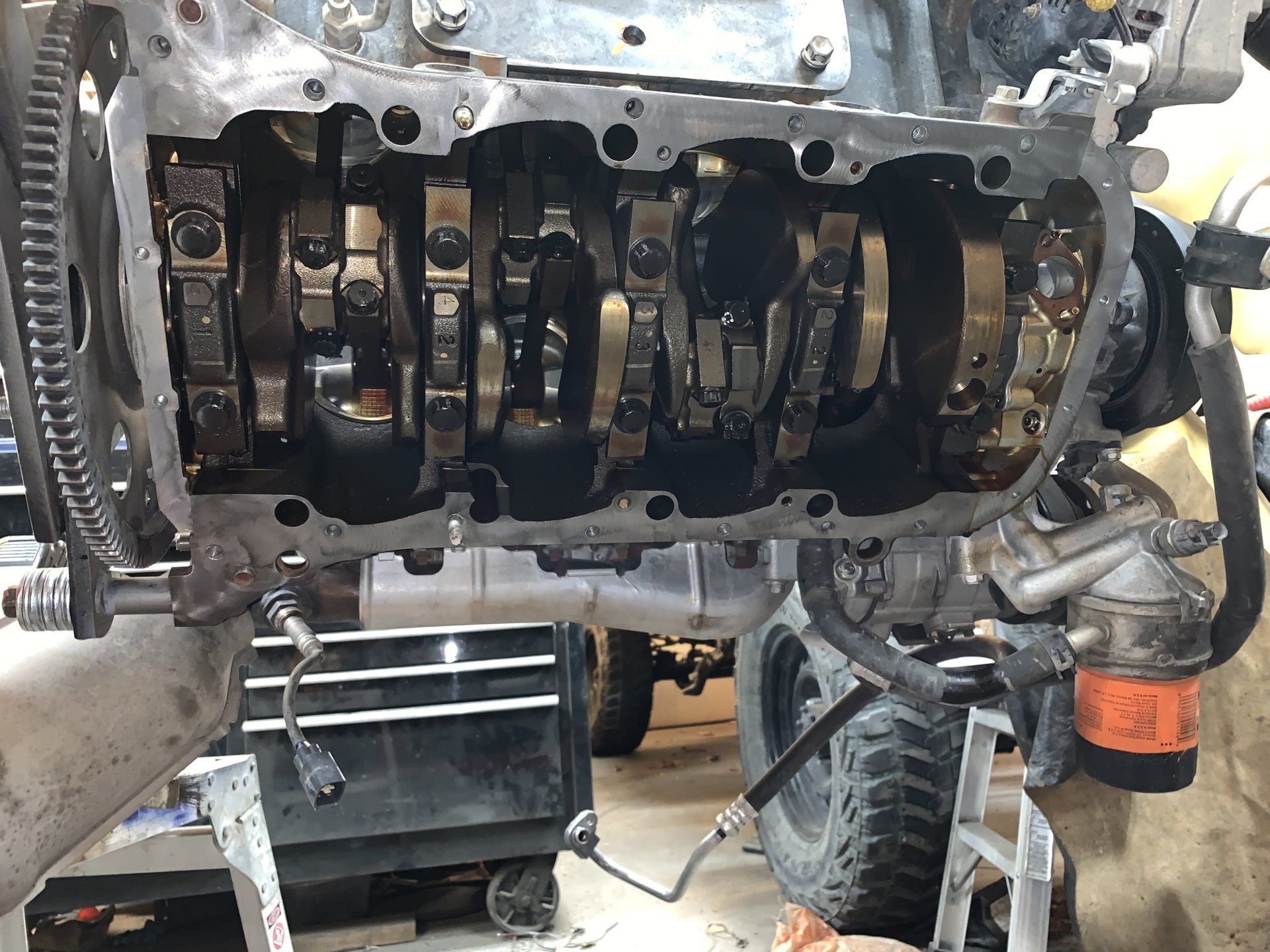

@StucknKS helped Pull the oil pan, so we could swap to the different sump pan.

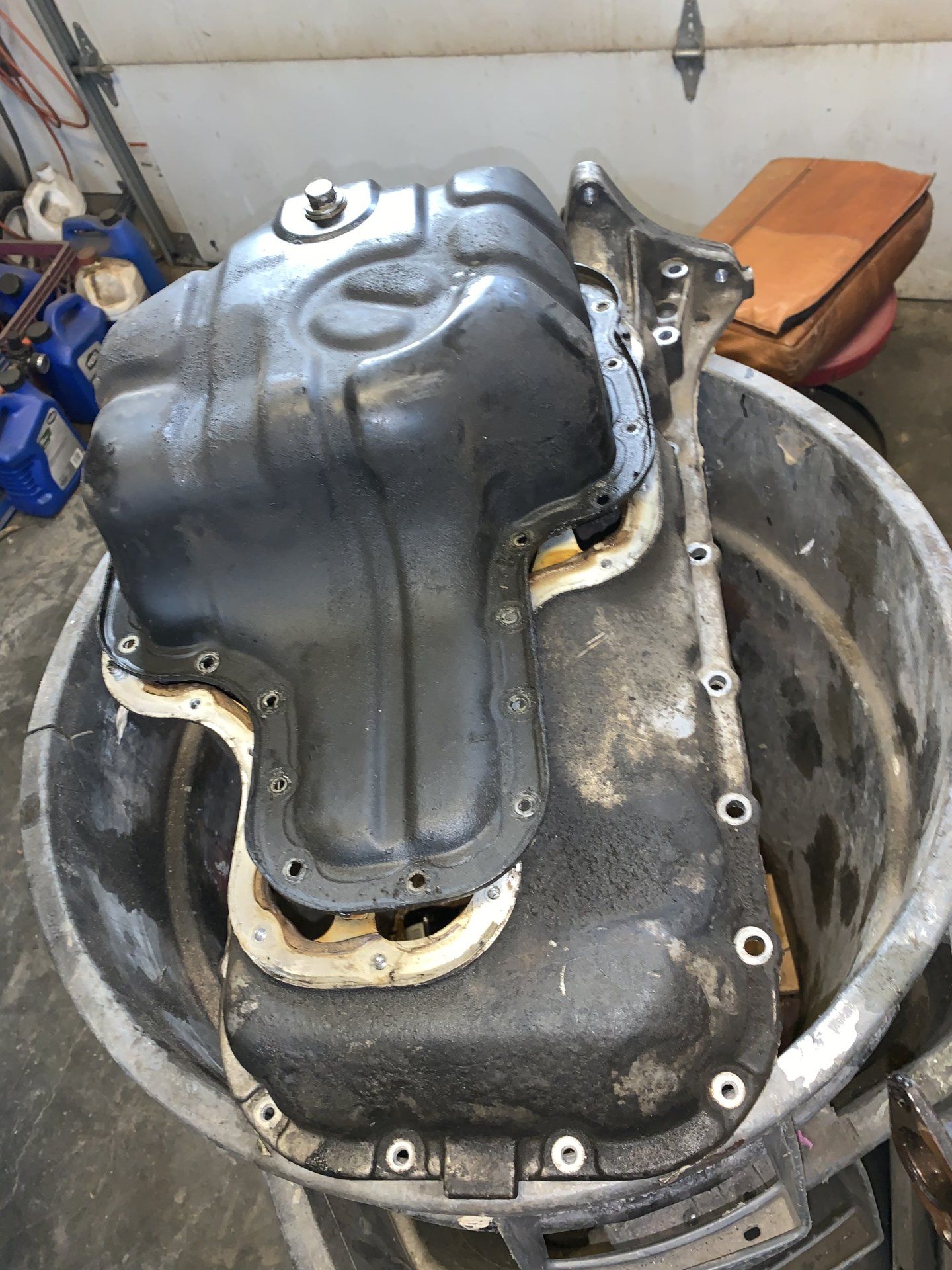

Here’s the 100 series oil pan that @Tank5 supplied. I could not find the dipstick in the parts he provided. I had to wait a day to have it warm enough to pressure wash outside
Here’s the 100 series oil pan that @Tank5 supplied. I could not find the dipstick in the parts he provided. I had to wait a day to have it warm enough to pressure wash outside .
I am glad you are making progress. I did not get the dipstick from the 100 series the oil pan came from. I was hoping I could reuse the dipstick that was on that engine.
Keep up the work.

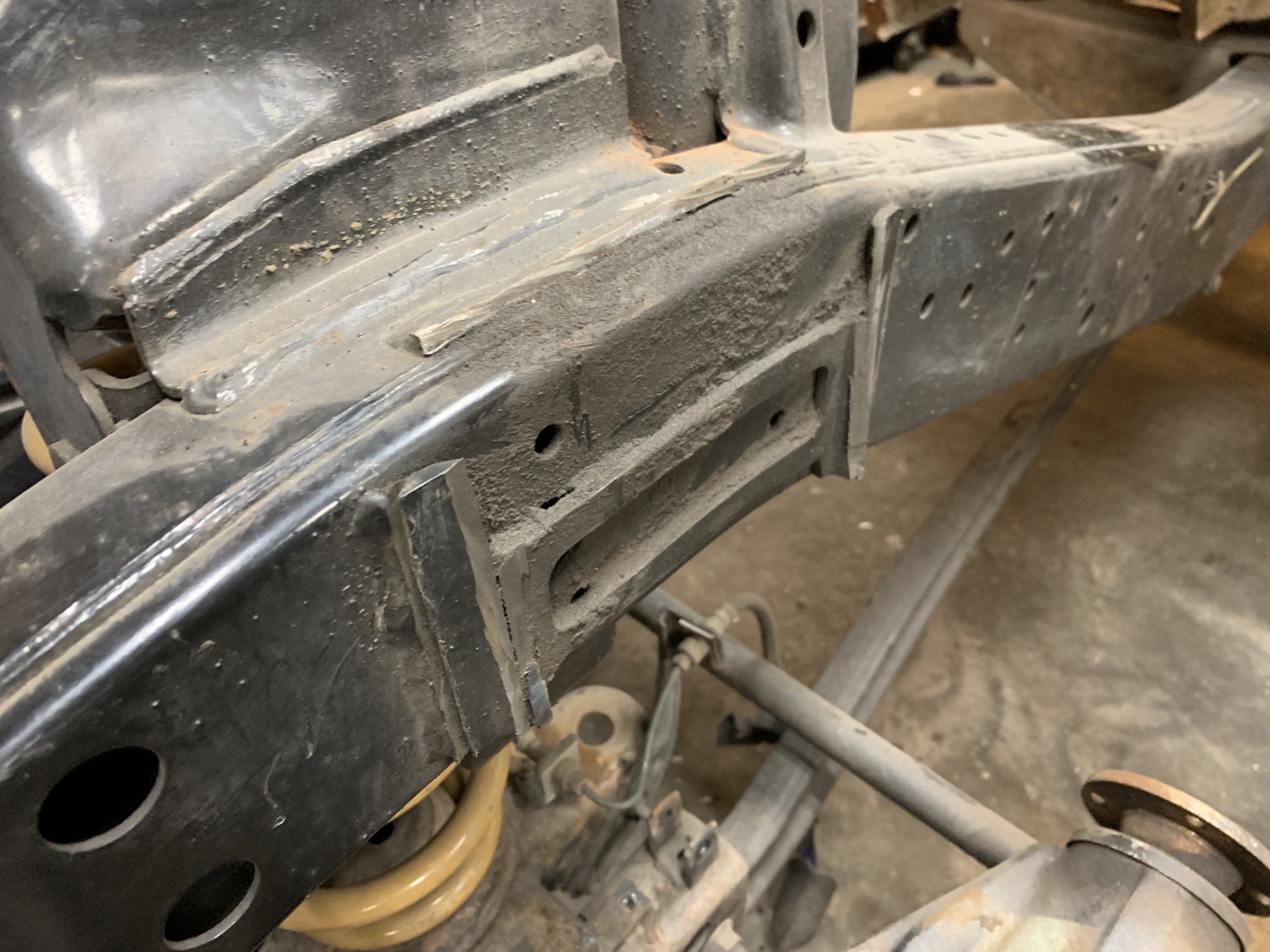

I needed a gasket for the oil pickup tube, so I started working on cleaning up the frame for the motor mounts. Once again @Tank5 had already started on this process and made it really easy with cuts better than I could do — not a single mark on the frame
