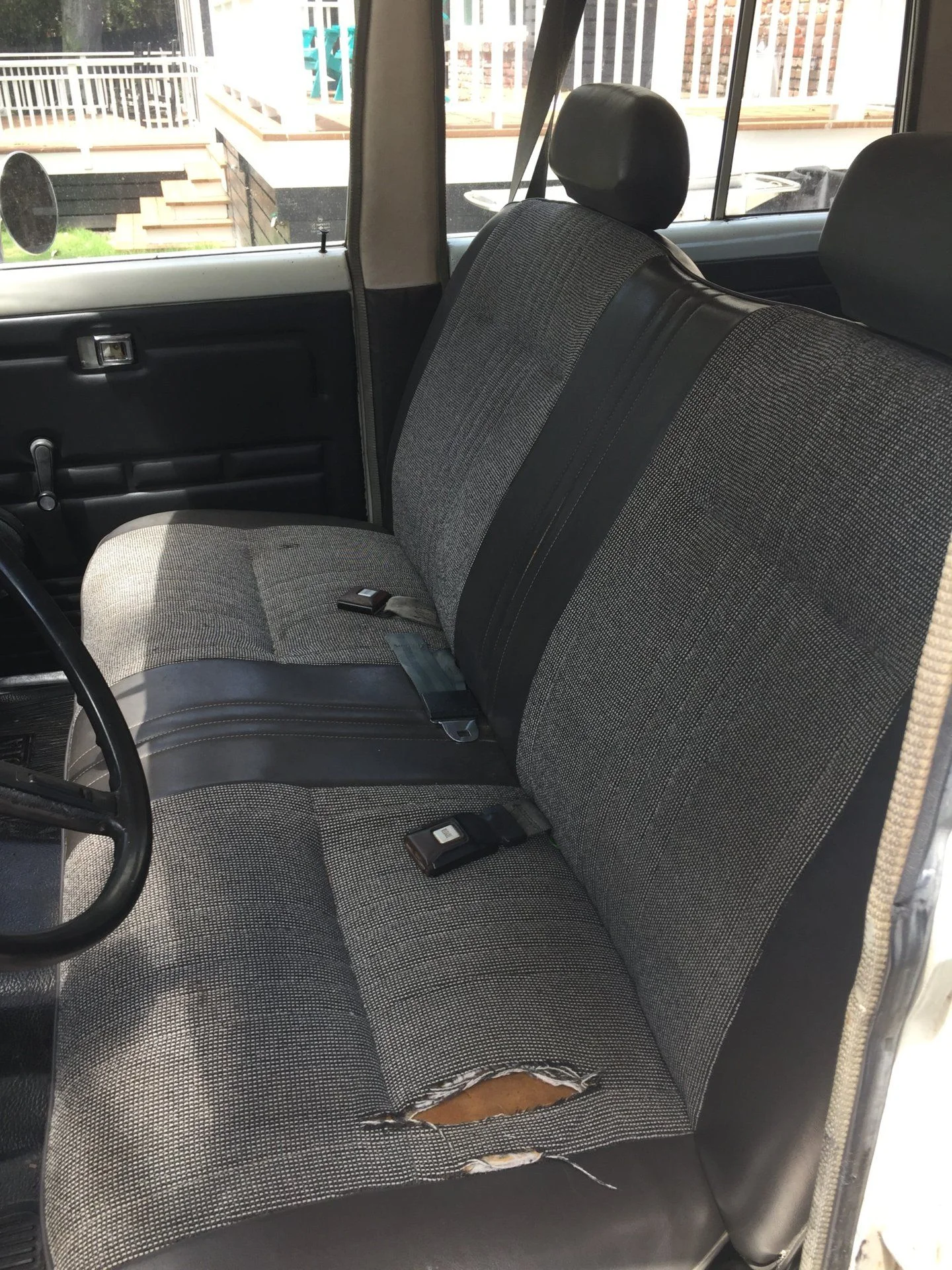

It has a new head unit and speakers. Apparently owner bought those door panels as the originals were pristine and he didn't want to cut them. Also put factory A/C in the interior (with new components under hood). Comes with a back end full of parts!

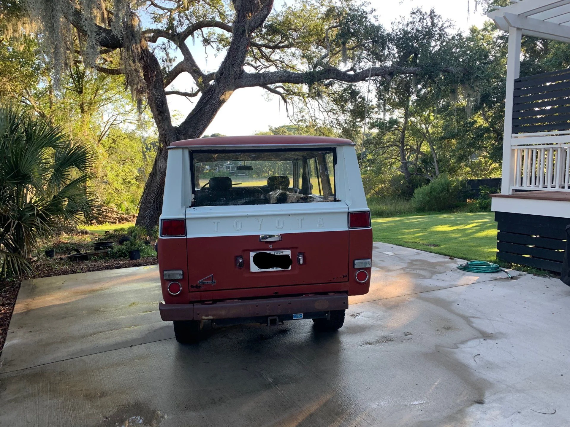

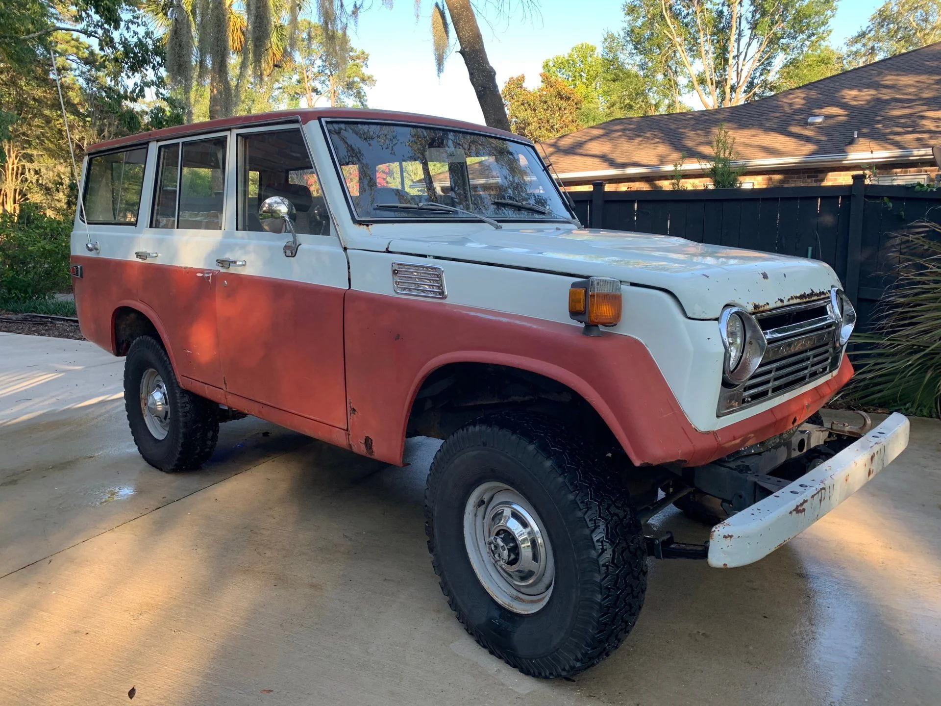

It seems to be sorted somewhat mechanically. My plan will be a frame-off in a few years when I retire. In the meantime, maybe some rust converter to slow things down on the body. Frame looks great so it's really just the body that I'm worried about.
Nice, looks like @a1500rams door panels. And it aint GREEN off to a great start.
I think it came with two of your floor pans and rockers...
Now, what would you advise for that hood and driver's A-pillar? Those have me a bit worried.
Thanks Bob. I'll get some better photos when I can take them myself. In the meantime I'm leaning toward Eastwood or Black Star or similar rust converter followed by some Cruiser Corps, rattle-can Freeborn Red and Cygnus White. Really just anything to slow things down to a crawl on the body for the next 3 or 4 years.

Congrats on the buy. Looks like a fine swine. The A-pillar can be a nightmare - check out Arnold in my sig for how my local shop had to deal with it.....
Thats a good one.
The hood is easy to fix....nice and flat and easy to work with. That A pillar is going to be fun. Windshield has to come out, and once you start poking around, it'll open right up. Don't start poking at it until you are ready to dive 100% in.

Thanks. No plans to go further than rust converter and some rattle can Cygnus White for now. It will be frame-off, glass out, etc when I get around to the full restoration.
Now you’re scaring me. I hope mine isn’t that bad. Fingers crossed.
You still have the '85 4Runner?
Thanks everyone for the positive comments. Now that I have seen the rust up close via FaceTime and close-up photos the body work will certainly be more involved than I had anticipated. I guess many of you guys have already been through that process though and came out the other side. I'm going to use a wire brush, gallon of Corroseal, and some rattle can paint on it for now. It will go into a 10 x 20 storage unit when we are gone. Hopefully that will slow things down a bit.
