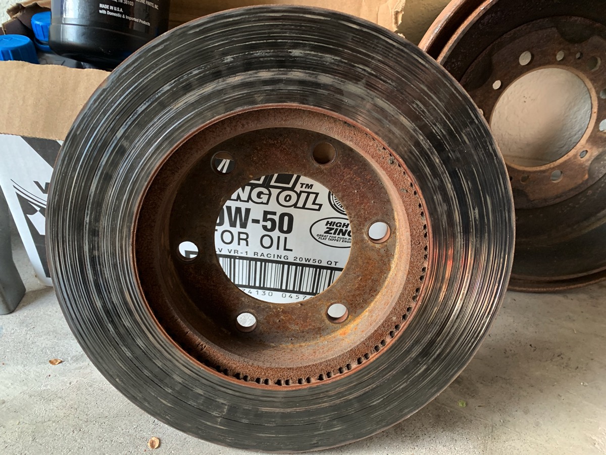

I knew it had brake issues though. The rears would occasionally bind up when reversing and I remember seeing the fronts while the wheels were off once in the UAE and it wasn't a good picture...

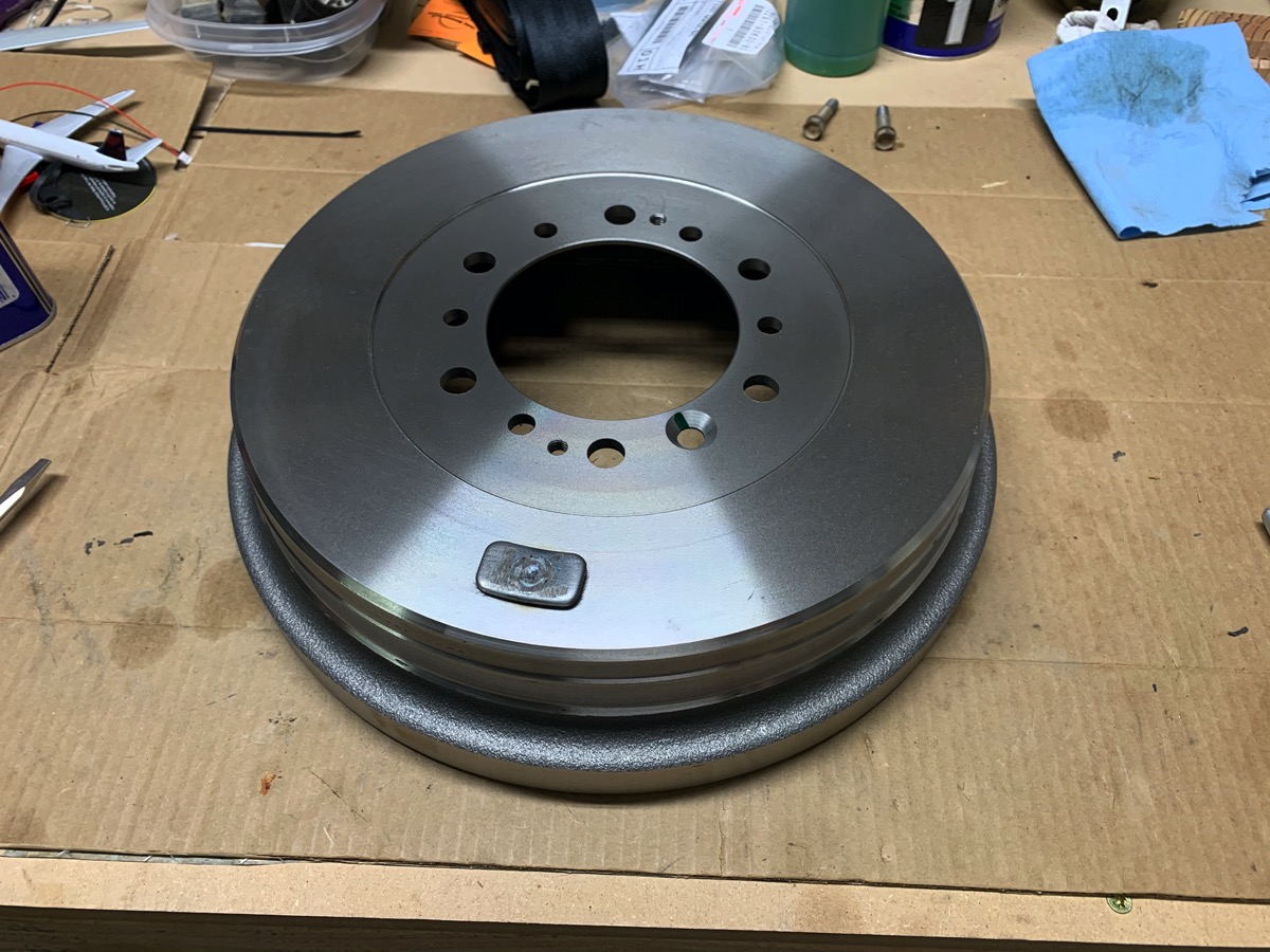

With one rotor in that condition I figured the other brakes weren't going to be fairing much better. So I snagged new rotors and drums while still overseas and shipped the parts back.

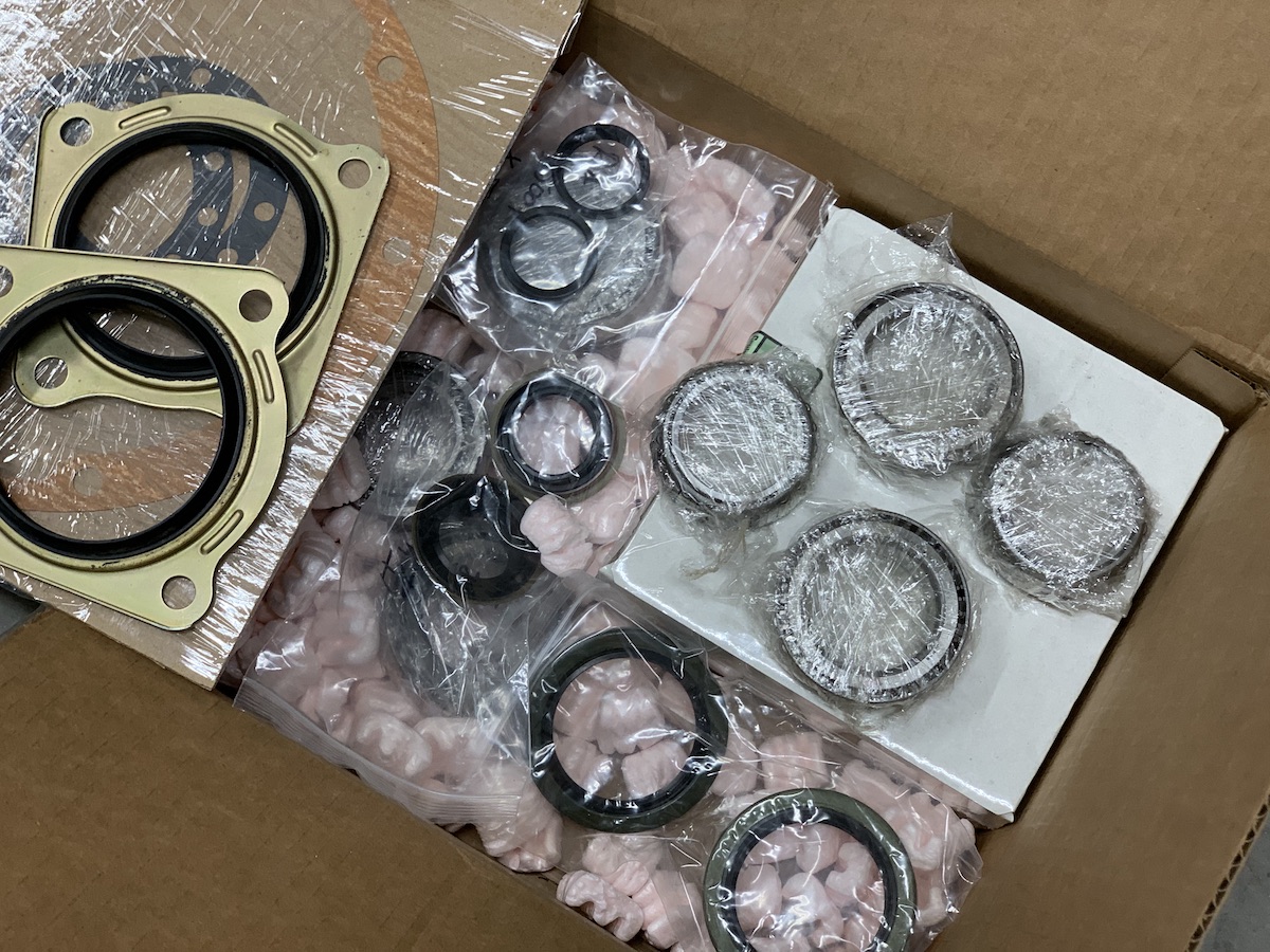

And then I bought axle rebuild kits from @cruiseroutfit. Even with great OEM parts pricing over there, Curt's kits can't be beat!

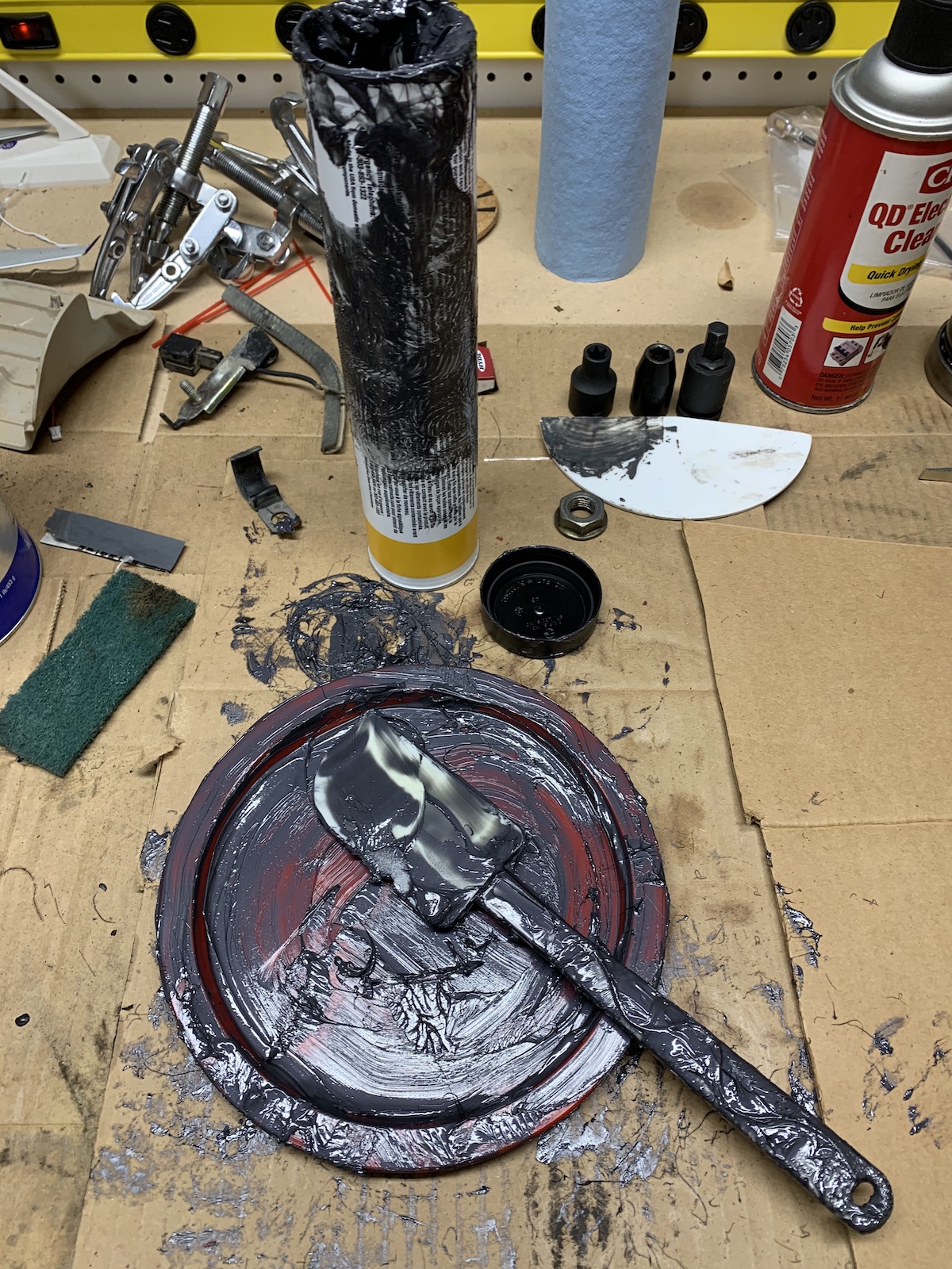

Got some moly grease for the front birfields.

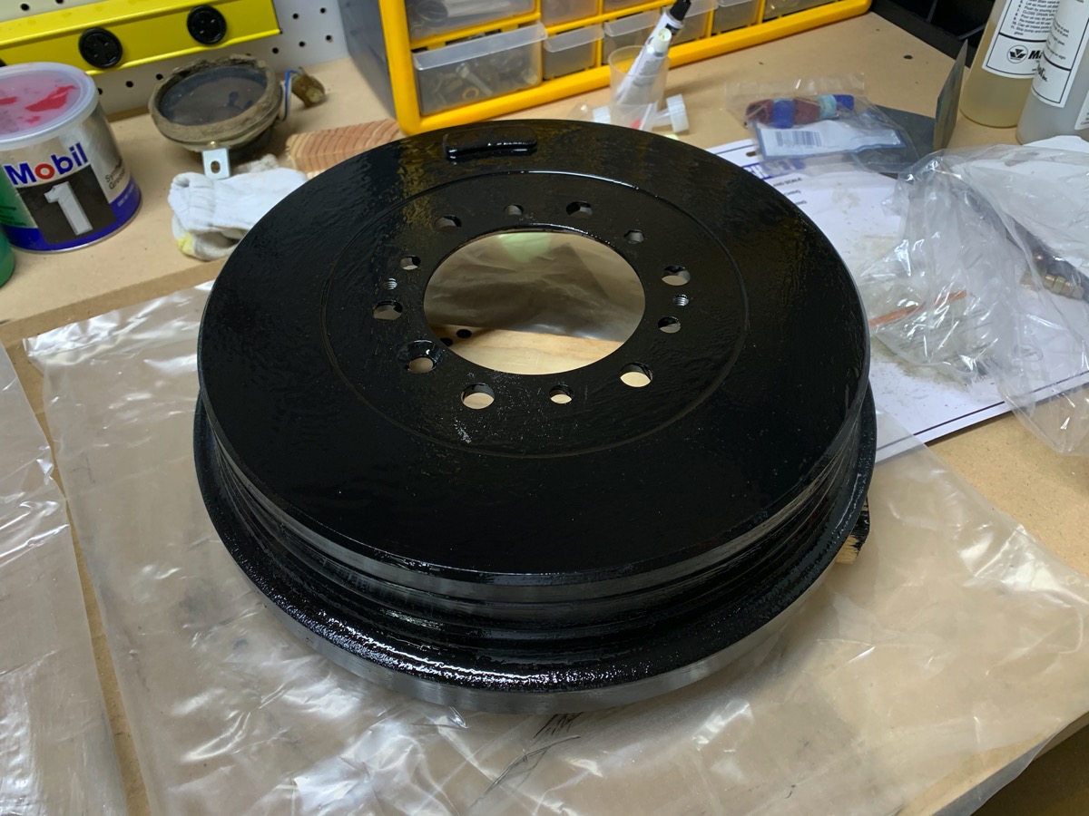

And painted my drums. Ended up not painting the calipers as the remans from Rockauto had a nice paint on them already.

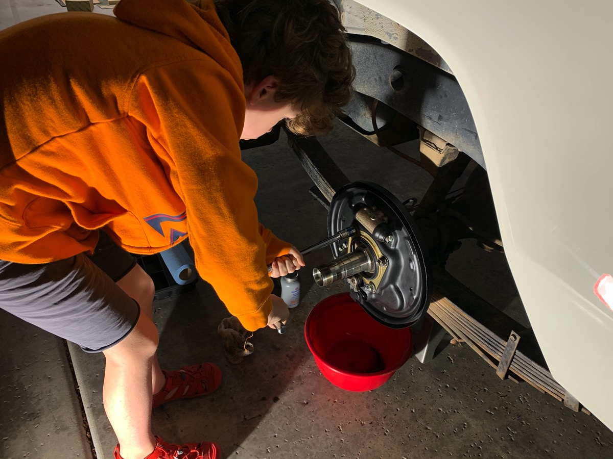

So late one evening my oldest and I got to work. Once I showed him how to use a breaker bar he refused to let me help. Ha!

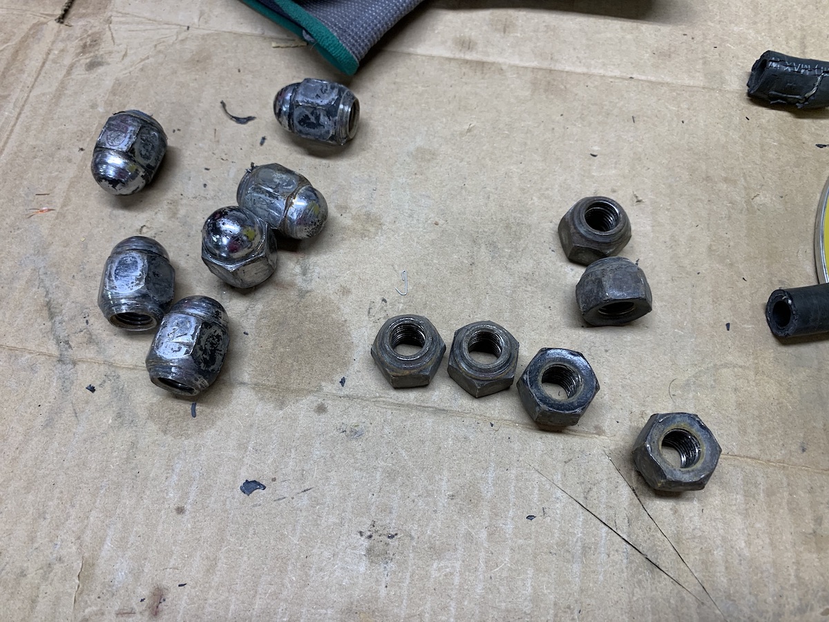

The lug nuts were a mix-and-match affair and all were well-rounded with abuse from the years. I actually used all new lug nuts once we wrapped things up.

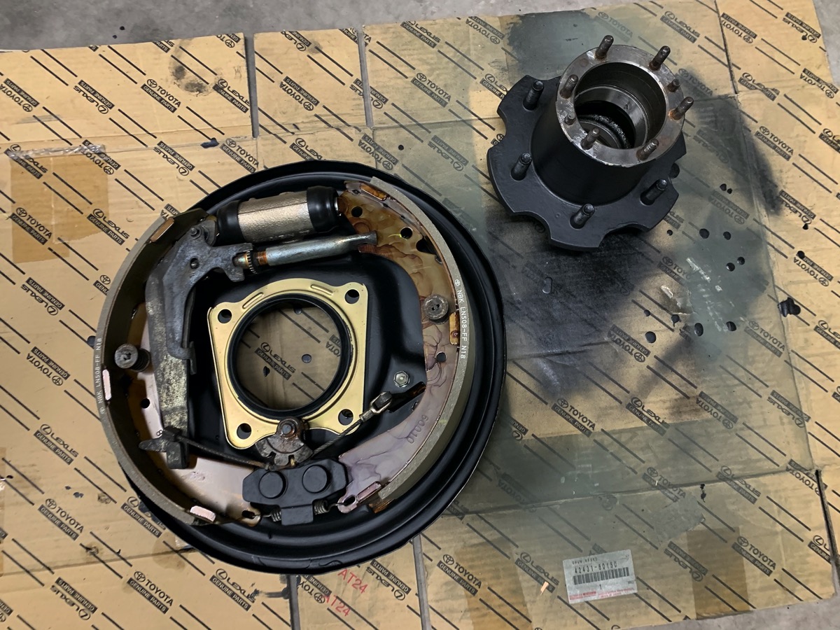

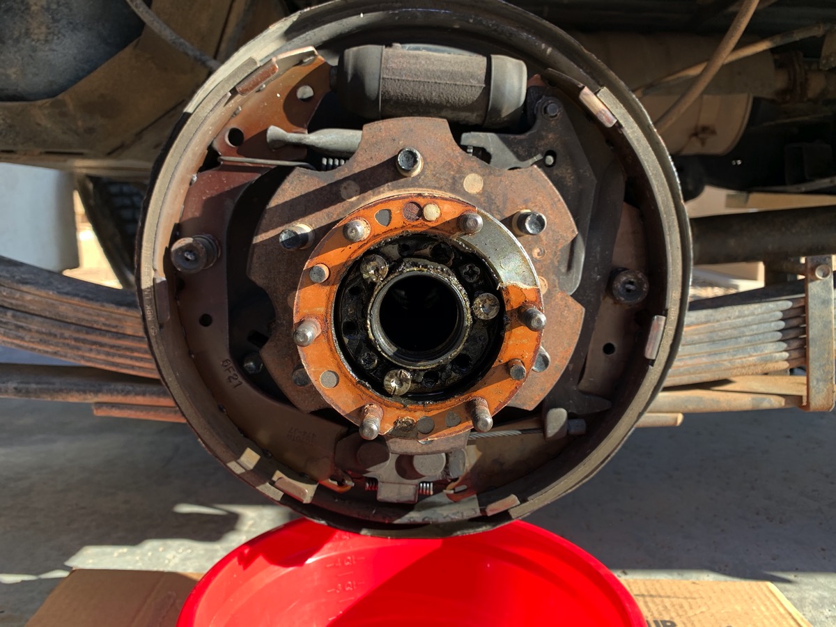

The rear passenger side looked remarkably good once the drum was off. I could still read the writing on the sides of the shoes. They'd obviously been replaced very shortly before I bought the truck.
But the driver's side was where my problems were.

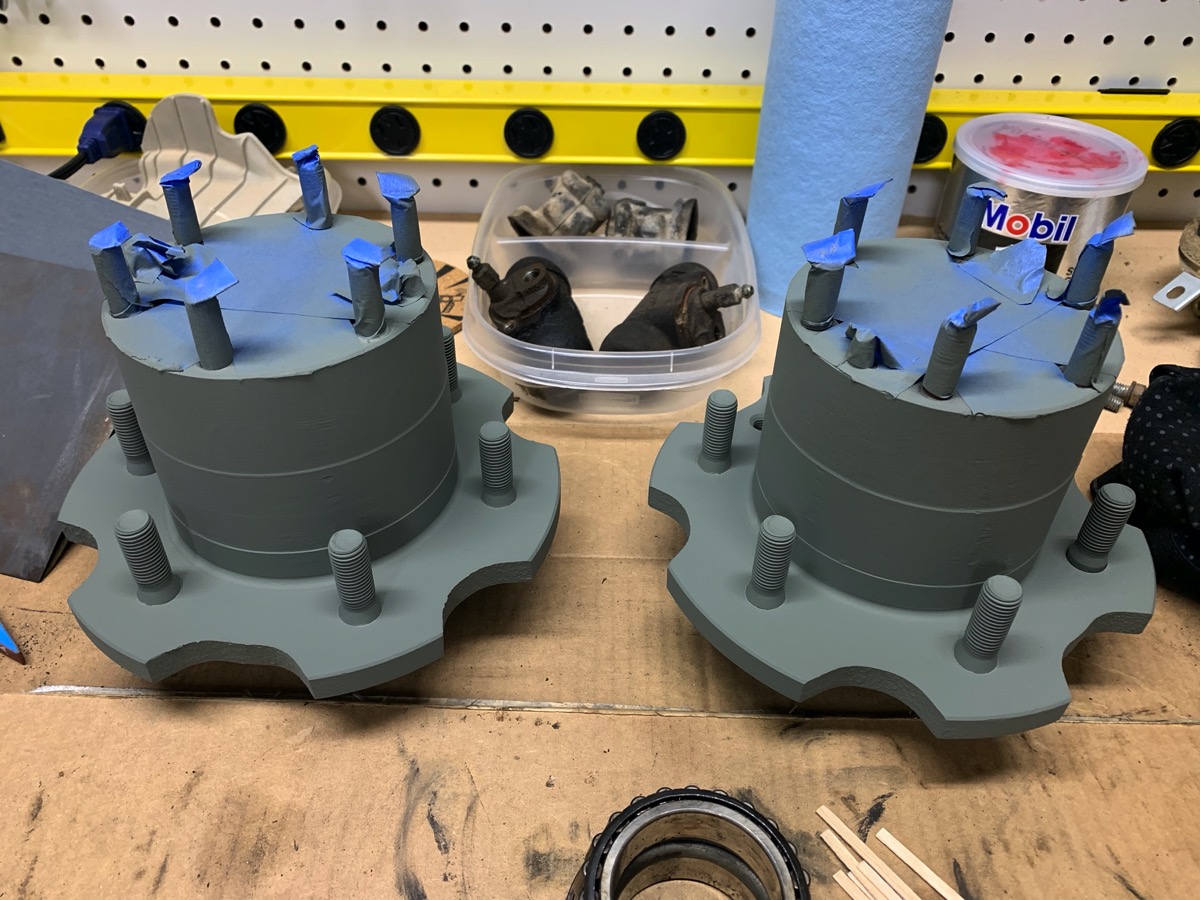

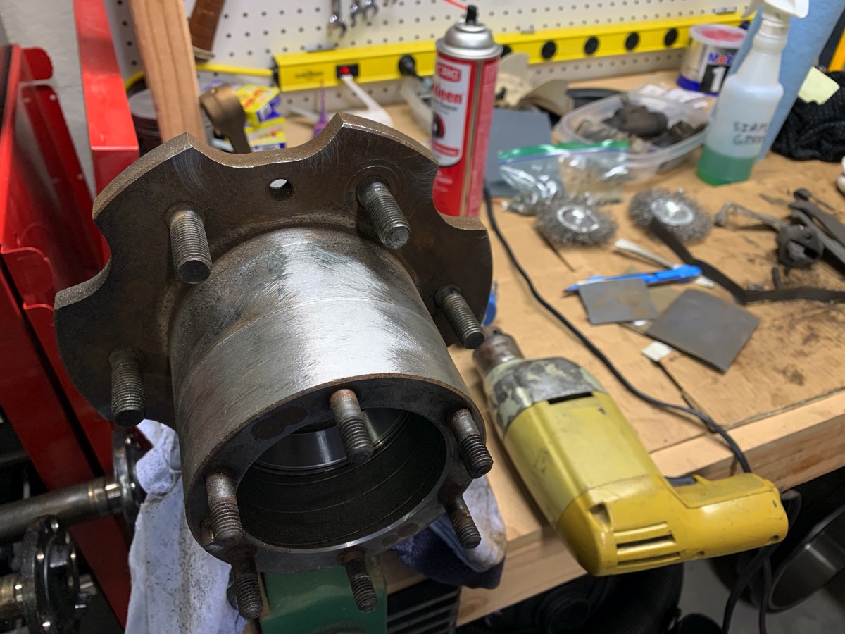

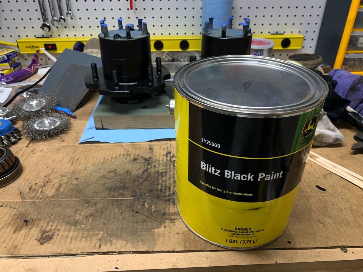

Wire brushed the hubs...
And primed...
And painted.

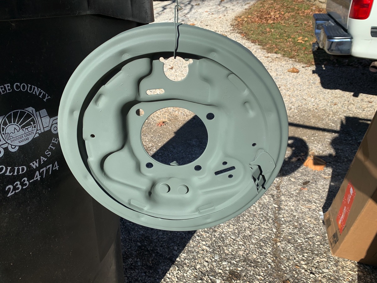

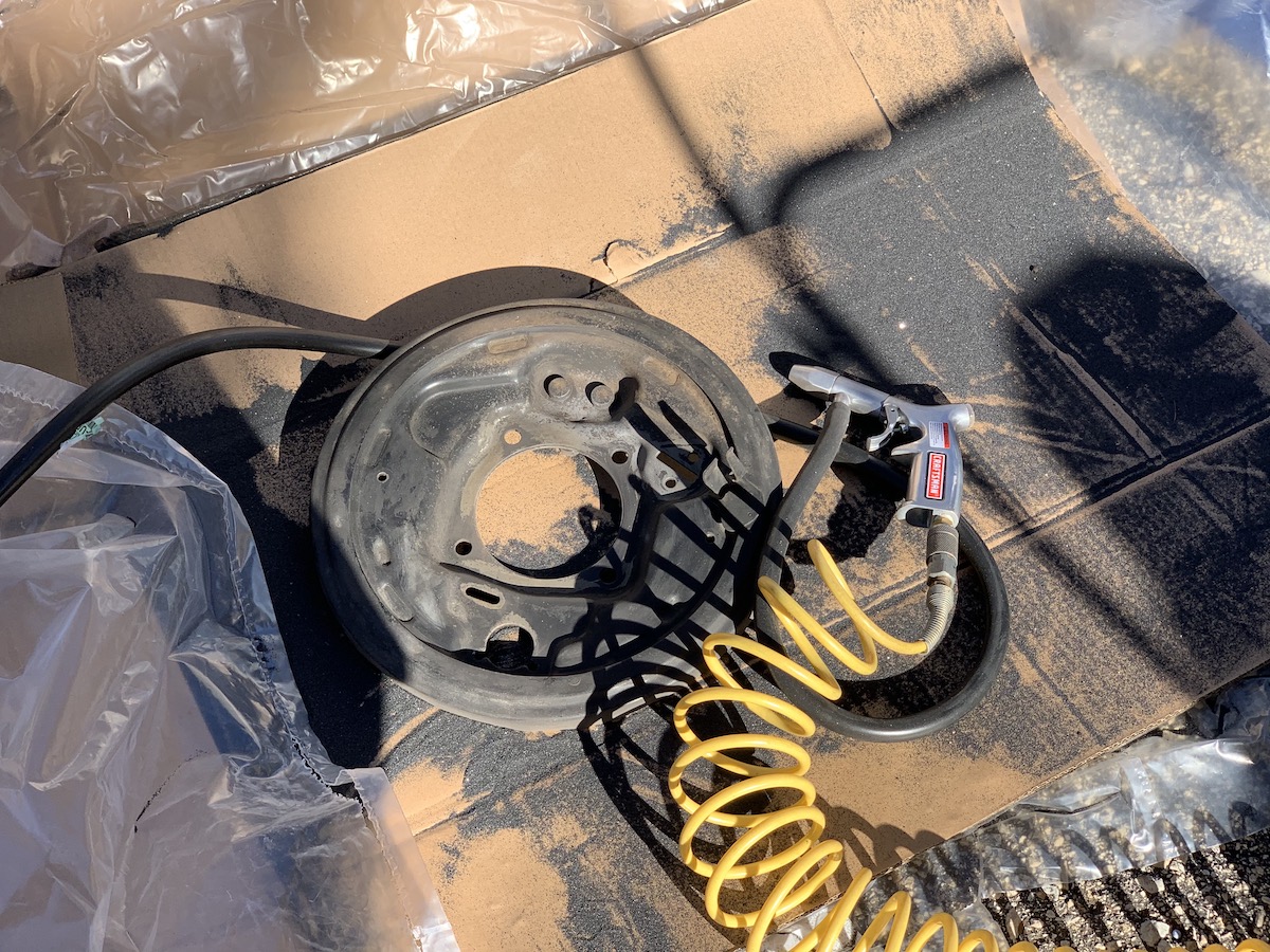

And while visiting KS for Thanksgiving my dad had an excuse to test his new sandblaster...
And primed.

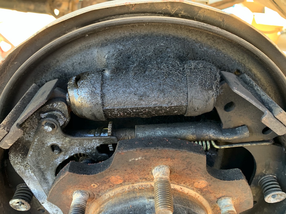

Once we got back from KS it was time to reassemble. The passenger side I re-assembled on the axle. New cylinders included.
But I remembered something @SNLC said about re-assembling them on the backing plate while off the axle and did that for the driver's side.
That was MUCH better.

What surprised me was the new brake shoes on each rear wheel. They must have done that to get it to pass export inspection. Ha! I'm sure the driver's slave cylinder was already leaking at that point. But that would have been more money than they wanted to spend to sell it to me.

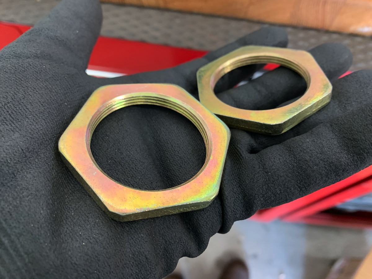

The large nuts for the hubs were unmolested... leading me to think this truck was still on it's original bearings in the rear. There'd have been screwdriver and chisel marks all over the nuts if they'd ever been serviced.

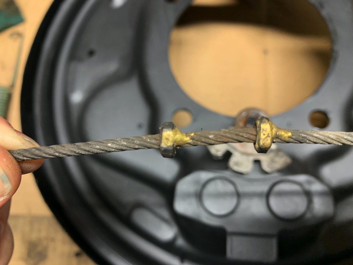

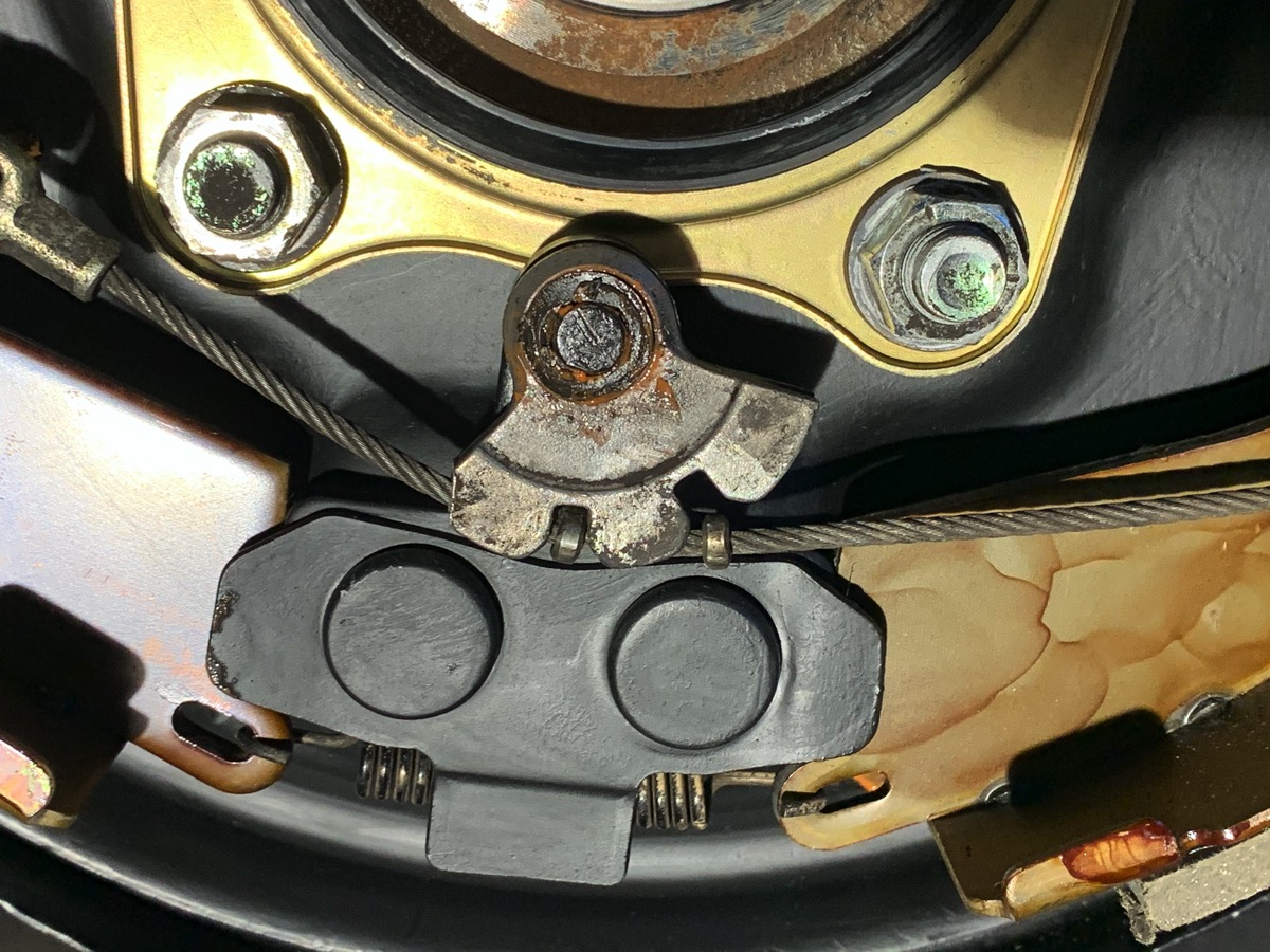

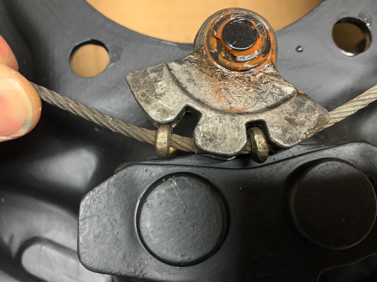

BUT, they obviously made a dodgy repair to the parking brake linkage at one point... and this may have been why they sometimes bound up on me in reverse.
They'd rewelded the "teeth" on the internal brake cable.
Which didn't work right with the internal cam.
I'd swapped the cams, but upon further inspection I could see they'd modified one of them to work with the dodgy cable.
I put it together as best I could to get it back on the road... and then I ordered a new cable. I gotta go back in and make it right...
BUT, they obviously made a dodgy repair to the parking brake linkage at one point... and this may have been while they sometimes bound up on me in reverse.

I've not used their chassis paint, so can't comment on how the thickness varies. It went on to the drums plenty thick, I only did one coat. My oldest actually did the painting and I just went back and touched up right after him.

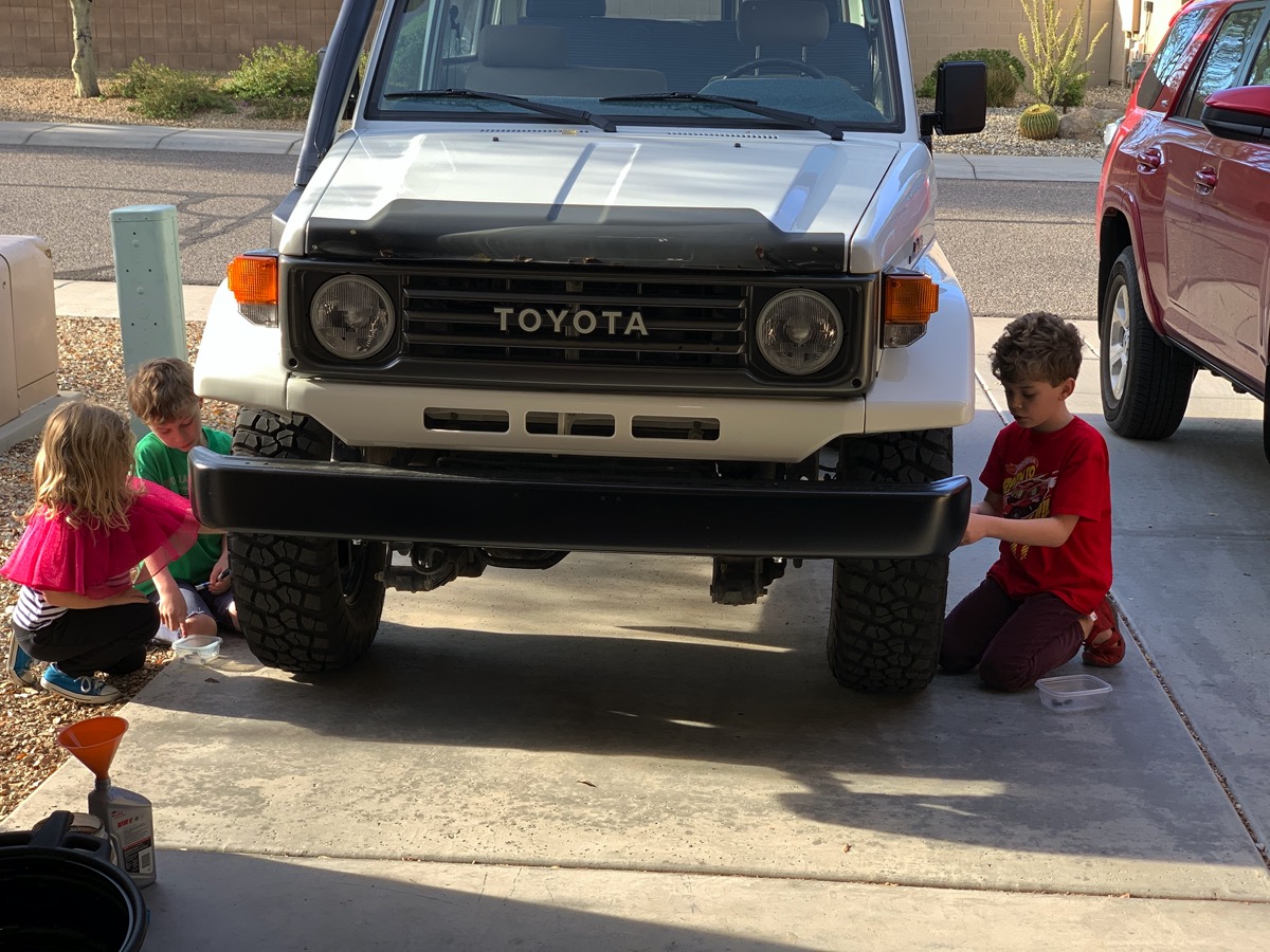

This time little brother and little sister didn't want to miss out on the fun. My daughter loves doing anything us boys are doing... but she's resolutely all-girl in the meantime. Taking axle screws off with a pink tutu on... around her neck to "keep warm" she said. Love it!

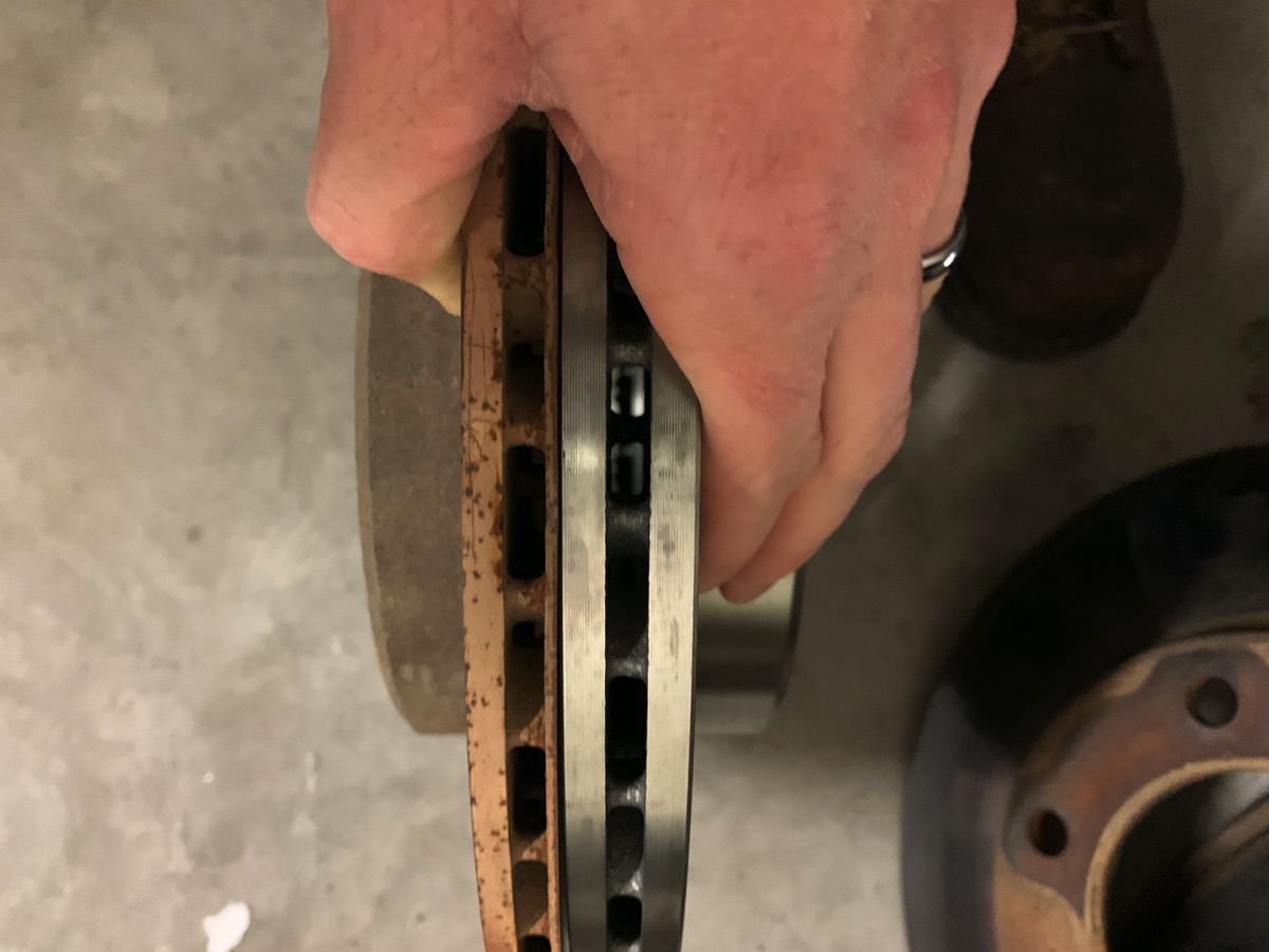

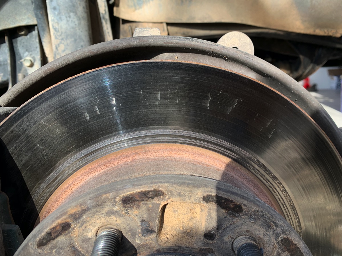

The front rotors were indeed in very bad shape.

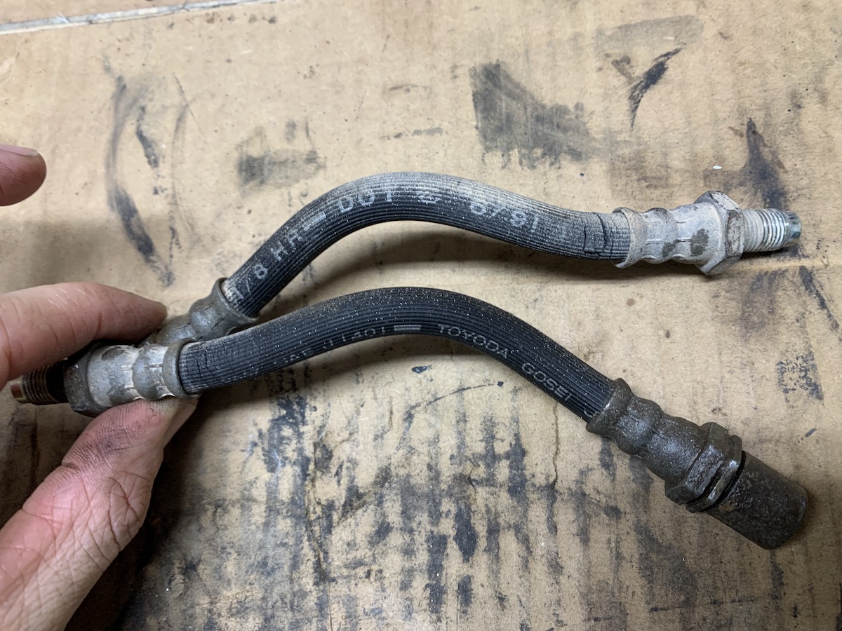

And the soft lines, dated 6/91 (original to the truck), clearly needed replacement.

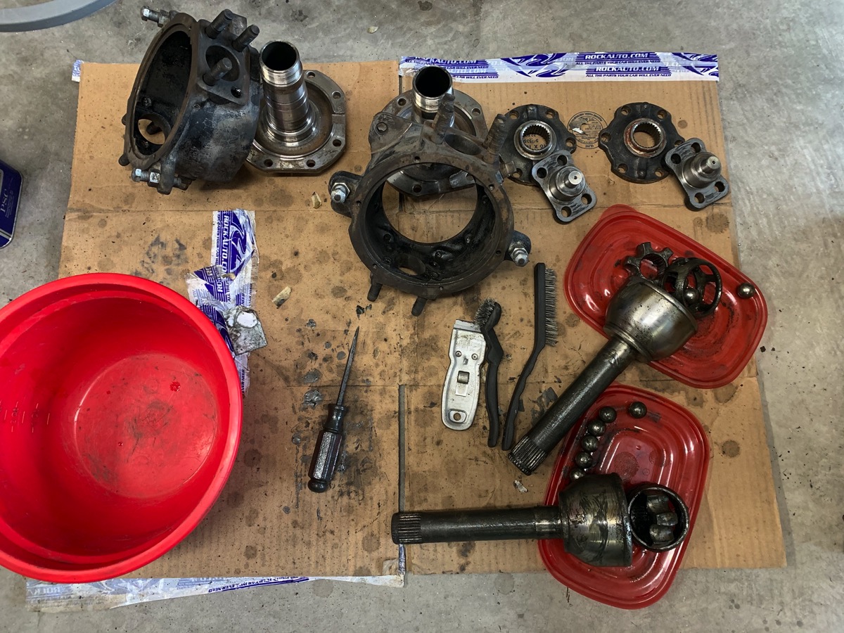

So lots of cleaning... scrubby tools and lacquer thinner. The kids don't help with this part.

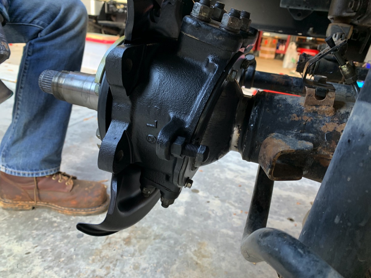

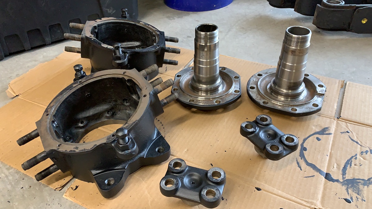

And painted.

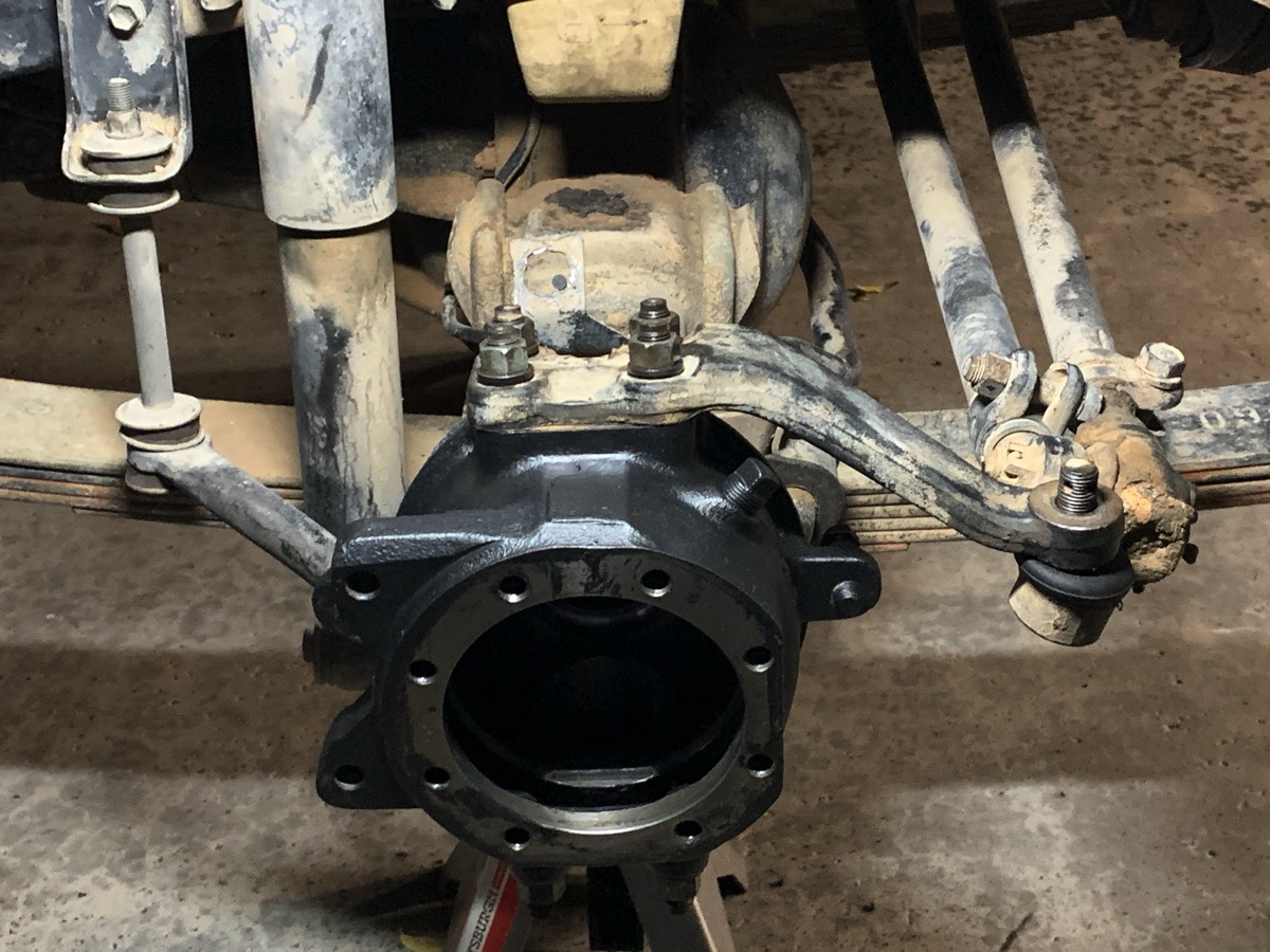

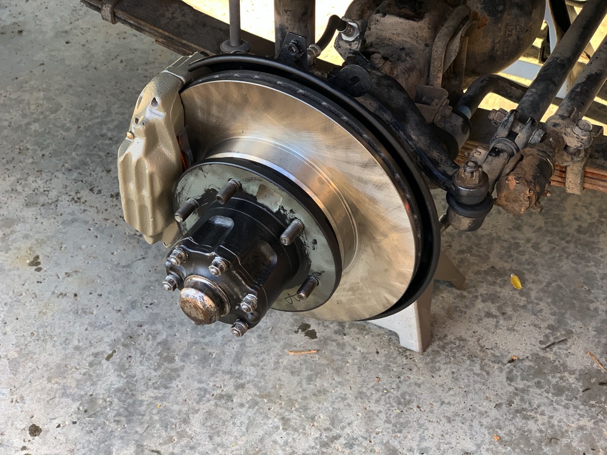

And knuckles on. Shame I can't redo the whole axle housing and steering linkage right now. TRE's and relay rod ends are next on my list though.
And more assembly.

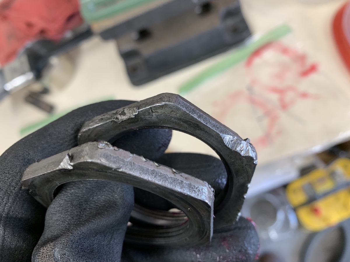

There were signs of servicing the front axle at some point. Maybe the bearings, maybe the rotors (although maybe not the rotors!). Typical chiseled up nuts from the spindle.
I had some re-plated ones laying around from a bundle of parts I had done while restoring 40's over in the UAE.
Buttoned up!
This was a serious undertaking. Took me way more time than I anticipated. Nothing terribly hard, just loads of work. The whole cleaning and stripping down parts for paint, and then painting, didn't help I suppose. I just wanted to get things right and know exactly the status of everything in there.
Anyway, I can drive it with confidence in the bearings, seals, and brakes now.

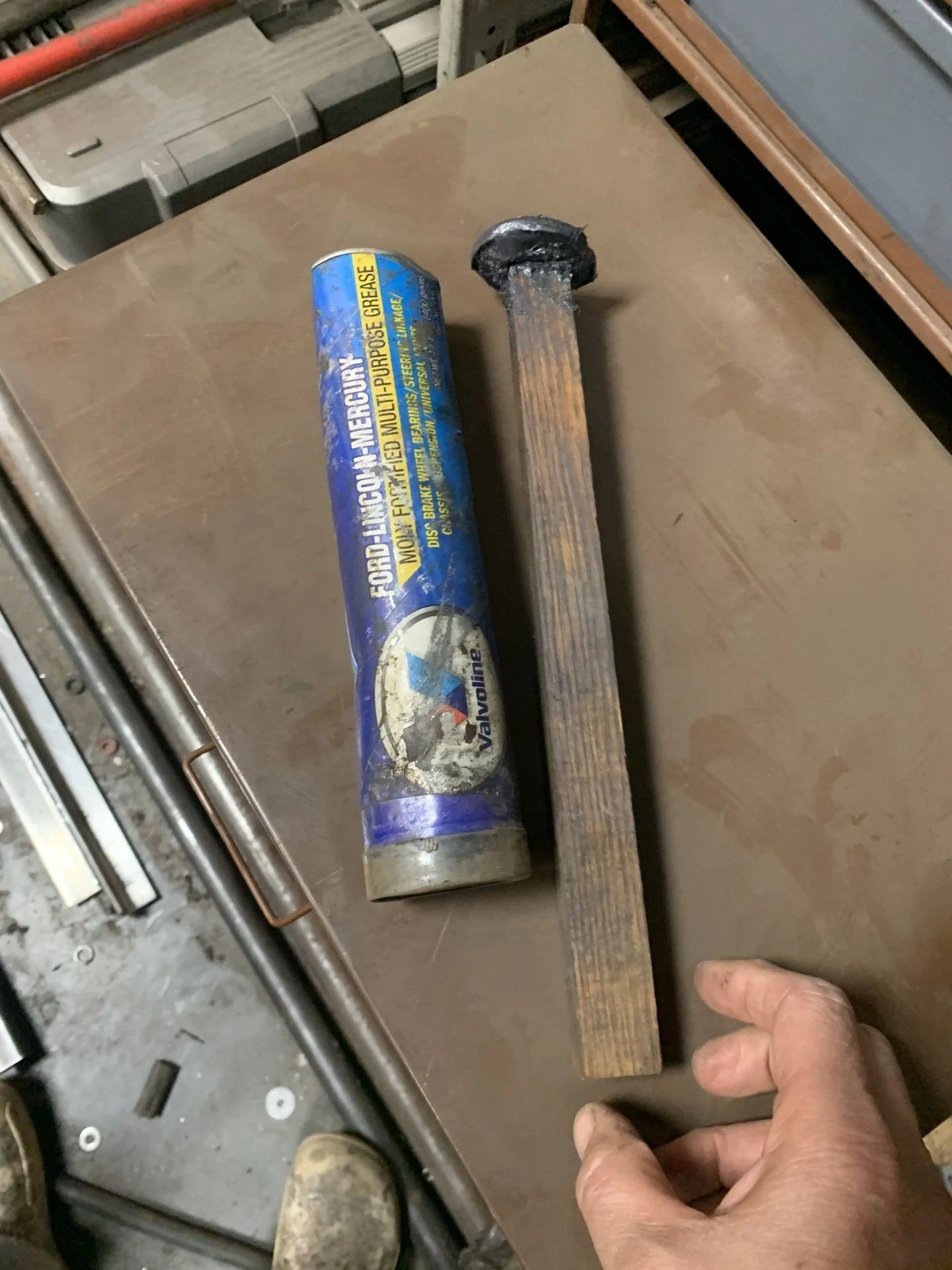

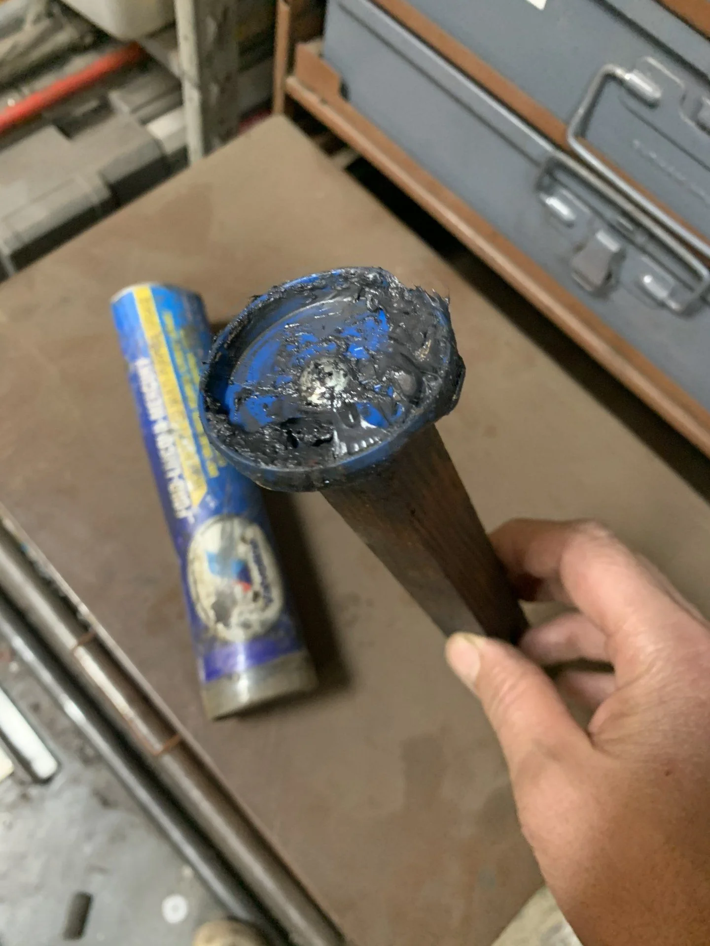

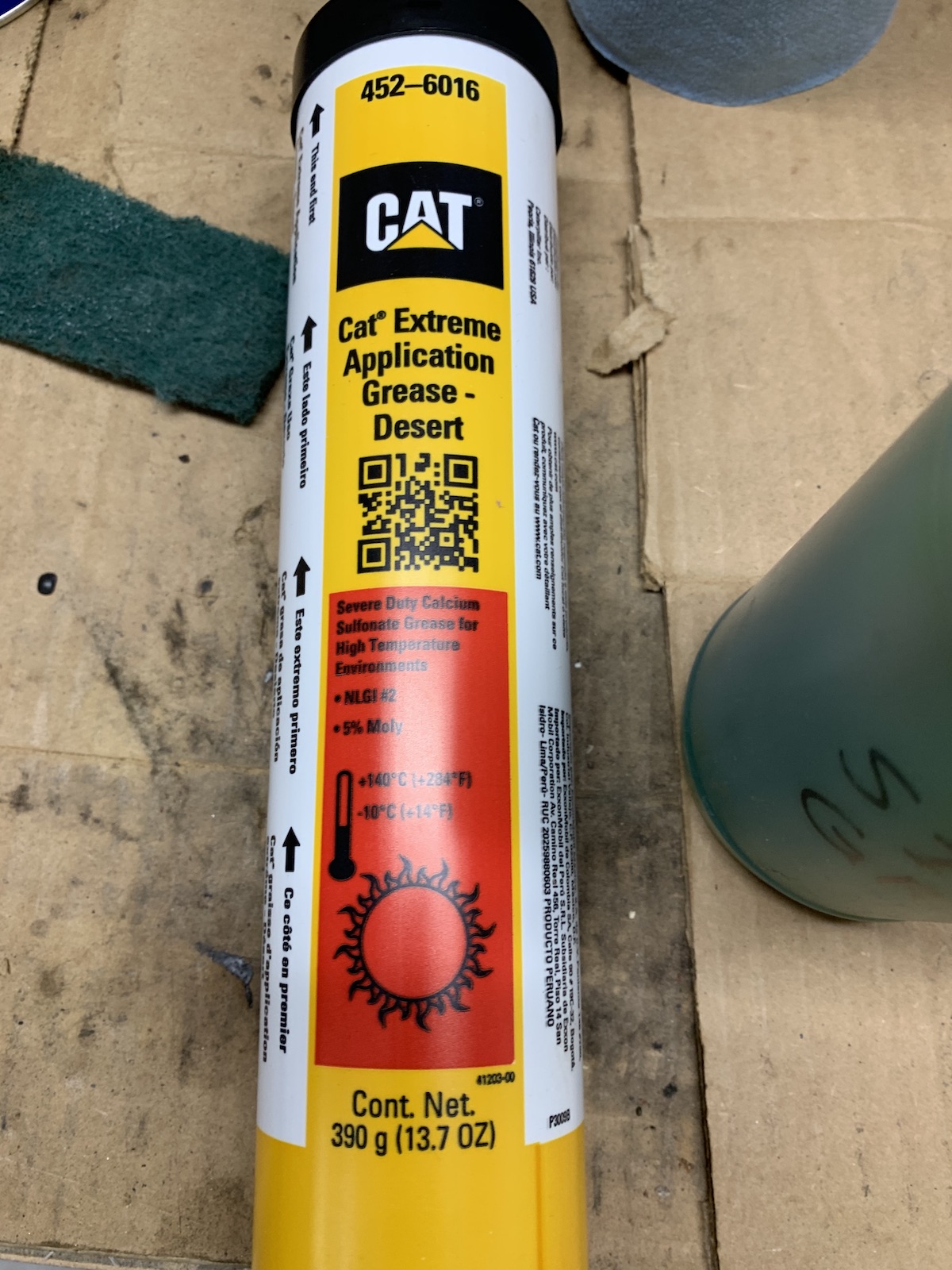

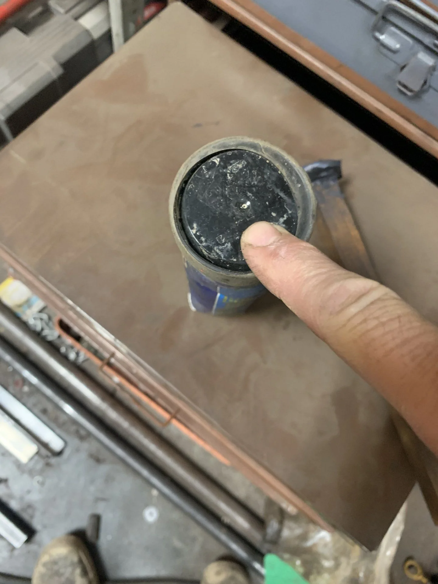

One suggestion...... on the tubes of moly, I took a little piece of wood... like a big stir stick and screwed a plunger on it and use it to push the moly into the hub area. Makes it really clean and easy..... I will try to take a picture of one.

Actually it’s something you already have and free.... so when you open up a new tube of Grease the side you open up like an old pop top can the grease comes out of —-the opposite side has a plunger or a cap. Just pull one of those out, screw it to the board and voilà!!

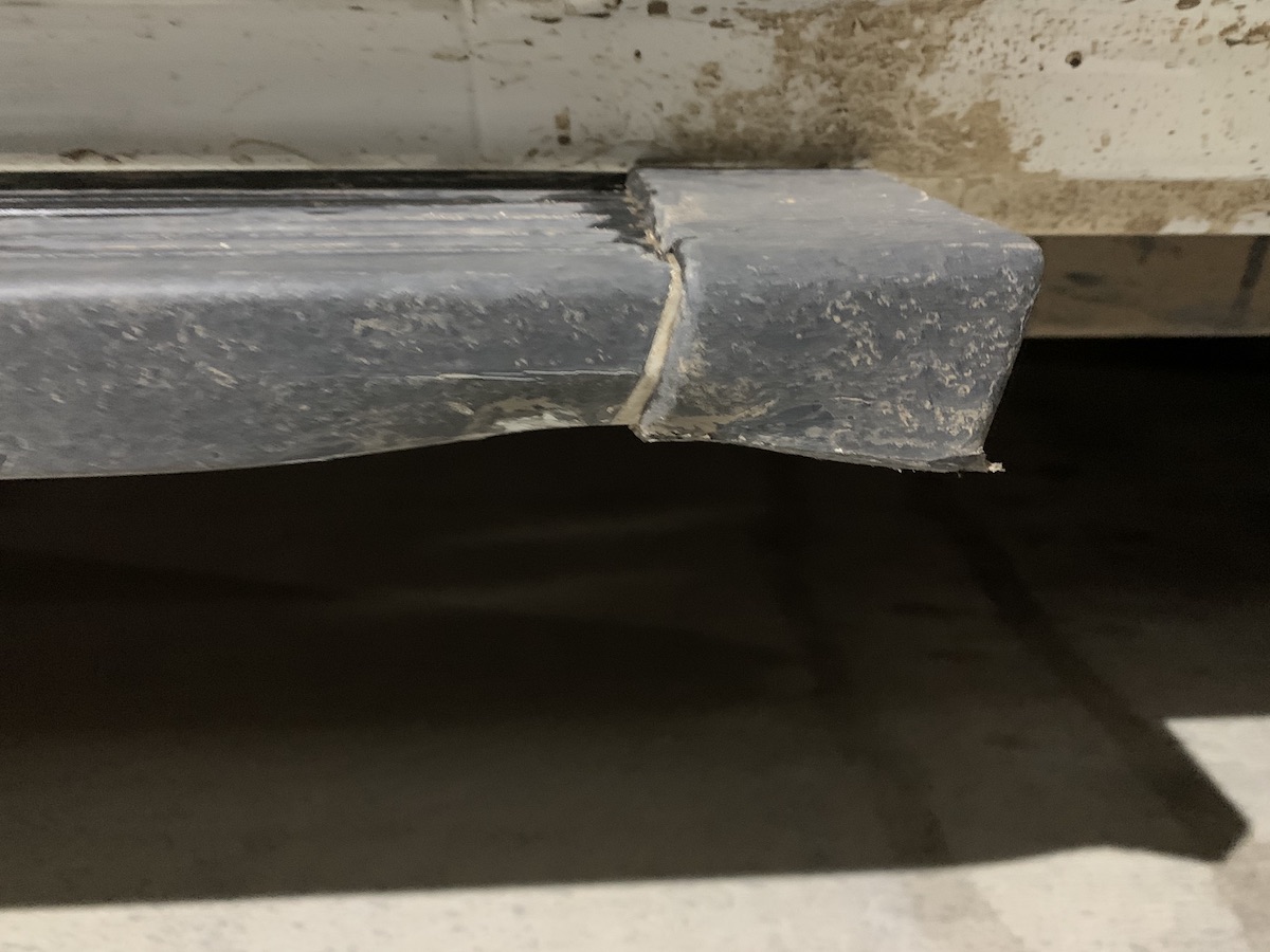

We did have a little carnage... my driver's-side step got munched on a rock through one of the more challenging areas. Had a spotter and everything but I'm quite new at trails with rocks.

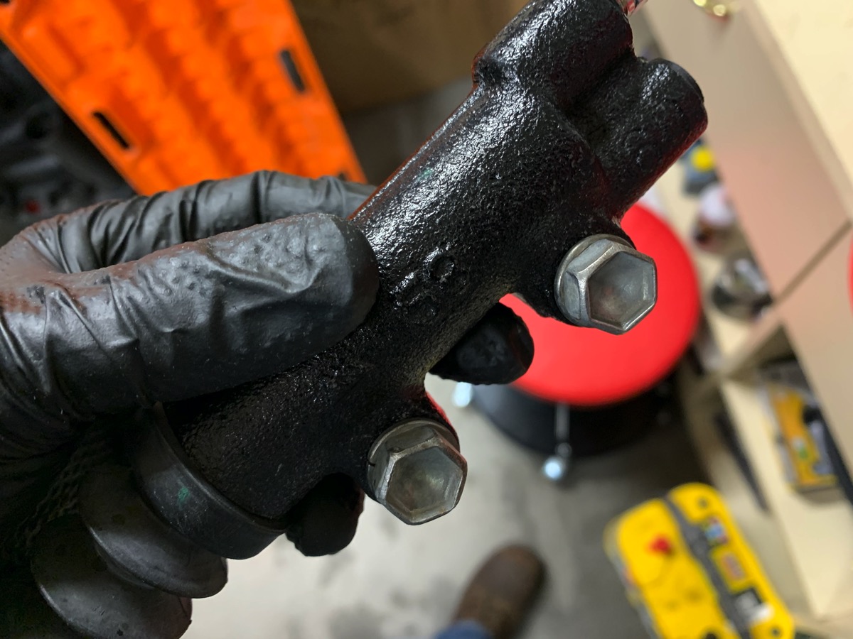

Clutch Slave Cylinder
I could tell my clutch slave cylinder was going bad... could feel the bleeding and it looked pretty worst for wear.
The slave cylinder was bought new while still overseas... part of my stash I brought back with me. I love how well the original hardware cleaned up. The lack of rust on these Mideast trucks is fantastic.
Once the slave was replaced it was amazing how much better the clutch worked... for about a day.
Now the master needs replaced, bad. Part ordered...
