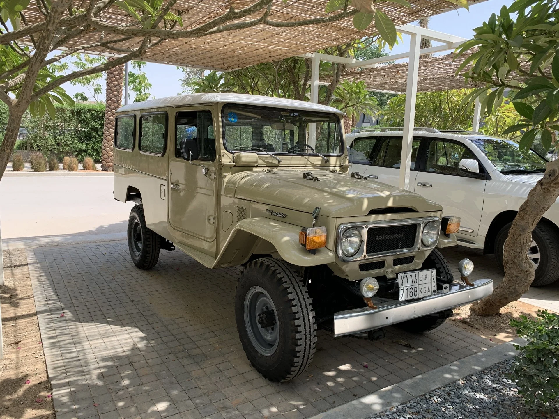

I have kept my eyes open for a late model ('79+) Troopy the entire 3 years I have been living in Saudi Arabia. Not long after I got here I found one on the side of the road but in hindsight am glad that I could never get in contact with the owner. I did manage to occupy my time however with a 1994 FZJ75 for the last 2 years but have more or less ran out of things to tinker with on it so onto the next project.
I had help finding this one as Khamis Mushait is several hours drive from Riyadh but with WhatsApp and FaceTime we managed to get the deal done. Troopy was delivered to Riyadh 3 days later via car carrier (really cheap btw) and here we are. I haven't done much other than drive it home from the depot (about 30 km) but have started ordering parts. It drove reasonably well although I didn't take it over 100 km/hr given the traffic. It does seem to oversteer just a tad but otherwise tracks and brakes very well. Power steering works really well at low speed.

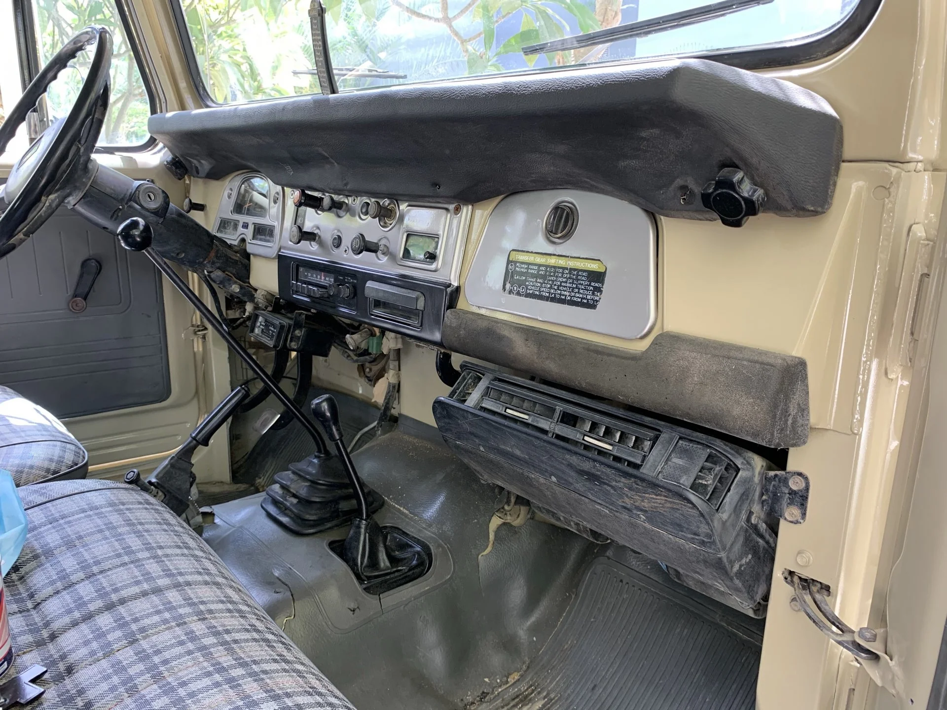

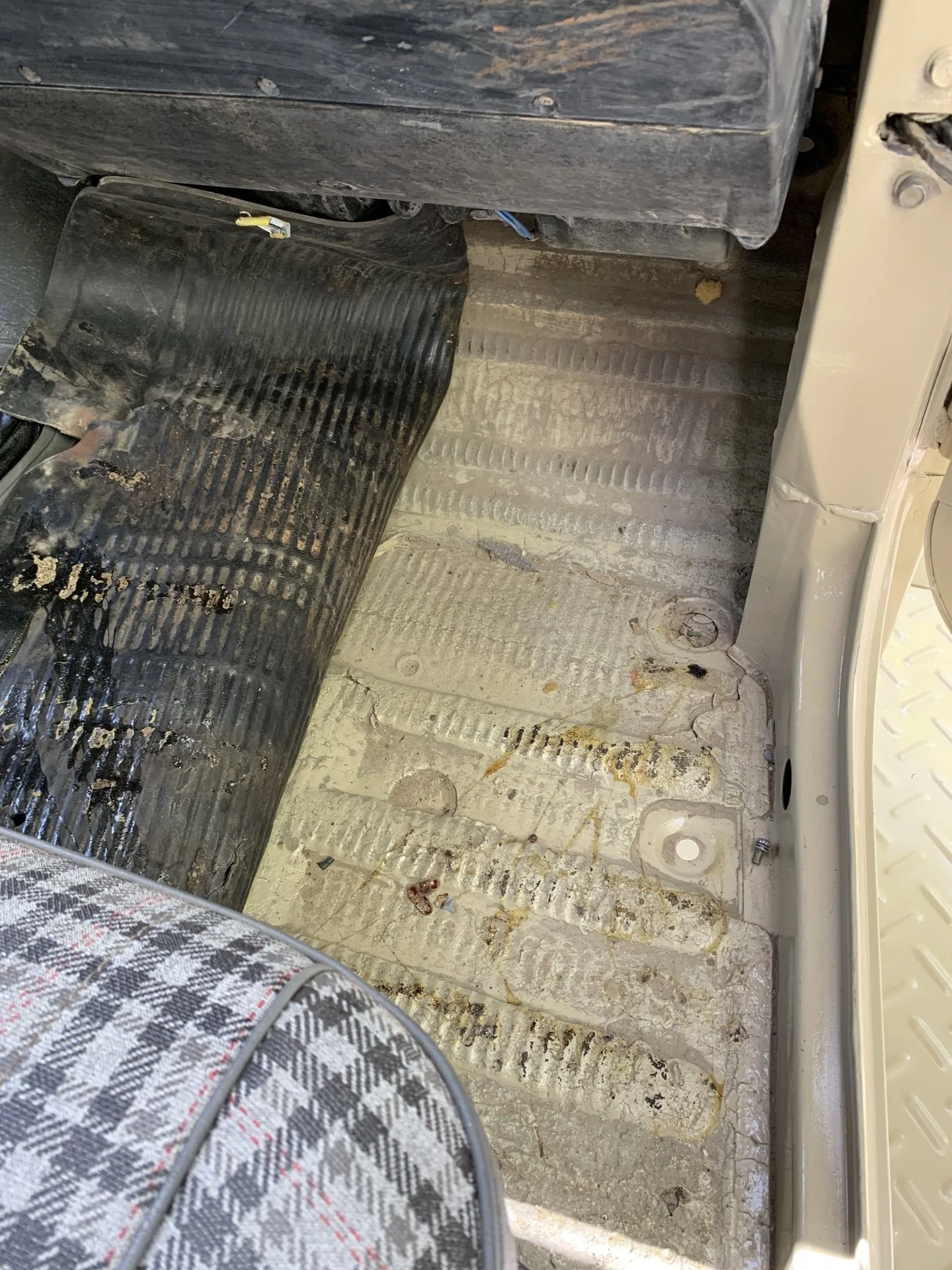

So it's a 1983 (12/82 build date) with 126,400 kilometers on the odo. It has factory A/C, power steering, and no heat. Original interior but exterior was repainted a few months ago. I have checked the outside with a magnet and looked extensively under all the sheet metal I can access. Very pleased so far and haven't found any area that has excessive bondo. Khamis Mushait is very high in the desert mountain in Southwest KSA and as such I didn't expect any rust; and so far I haven't found any. The floor pans, rear seal, etc. are all in excellent shape.

Dang that’s great looking. I’m ignorant wrt ME driving are left hand drives common?
Beautiful, I love the troopy's but like most rigs they are mobile sun rooms. Even here in Colorado it can be tough to drive unless early in morning and late in the evening. I would be hard pressed to ever sell our 84 BJ45.
They are all left hand drive in the middle east. So is all of Africa except for South Africa for that matter.

New dash pad. One of several boxes that showed up today.
WOW - she is a beuaty!
Thanks. Needs some TLC but don’t they all?

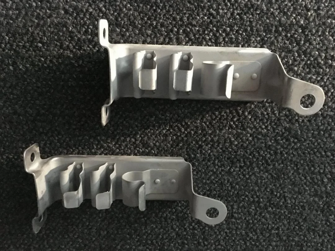

Any chance you (or anyone else) have 100% intact starting and jack tool holders that you could take a photo of? Mine are obviously missing a clip or two. Would be great to find a photo of the tools in place.

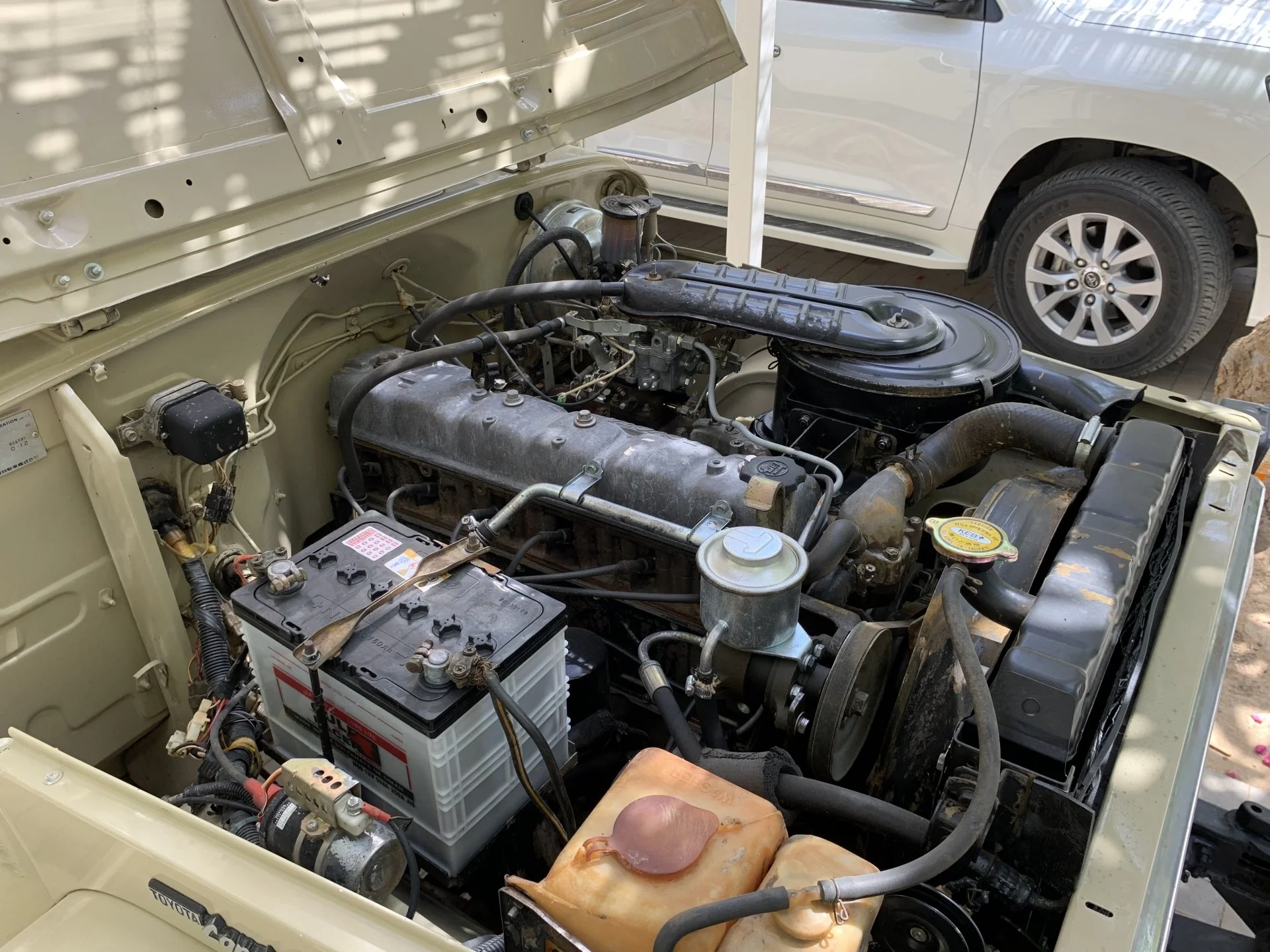

Do you come across many of the air cleaner assemblies for the 80+ 2F over there?
Truck looks great, taking many notes of what I see.
I assume you mean the Gulf (or General) spec assembly and not the US type? To be honest, I have yet to find an early Land Cruiser graveyard. I think there is one about 3 hours north of Riyadh but I haven't confirmed that. The giant wrecker yard south of Riyadh has a few older 40s and 45 pickups but there's not much left on them.
