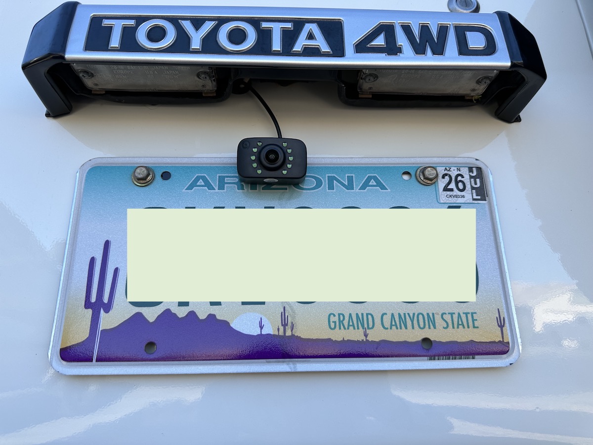

Ha! It doesn't bother me as much in my Troopy. I'd never do it in my 40... but this truck is a tool and the rearview camera and bluetooth stereo are natural additions.
Where did you mount the camera? 😊
I mounted it right above the license plate. It was the easiest solution to run the wire/cable. I figured worst case I could relocate it if I wasn't happy. I'm not doing precision rearward parking operations based solely off this camera, but it's generally resulted in quite a good view. I removed one set of the guide lines (both the head unit and the camera have their own). The biggest thing is that when I'm loaded to the gills for all 5 of us to camp I can't see through the rearview mirror. I'm tempted to add a switch for the rearview so I can have it on demand.

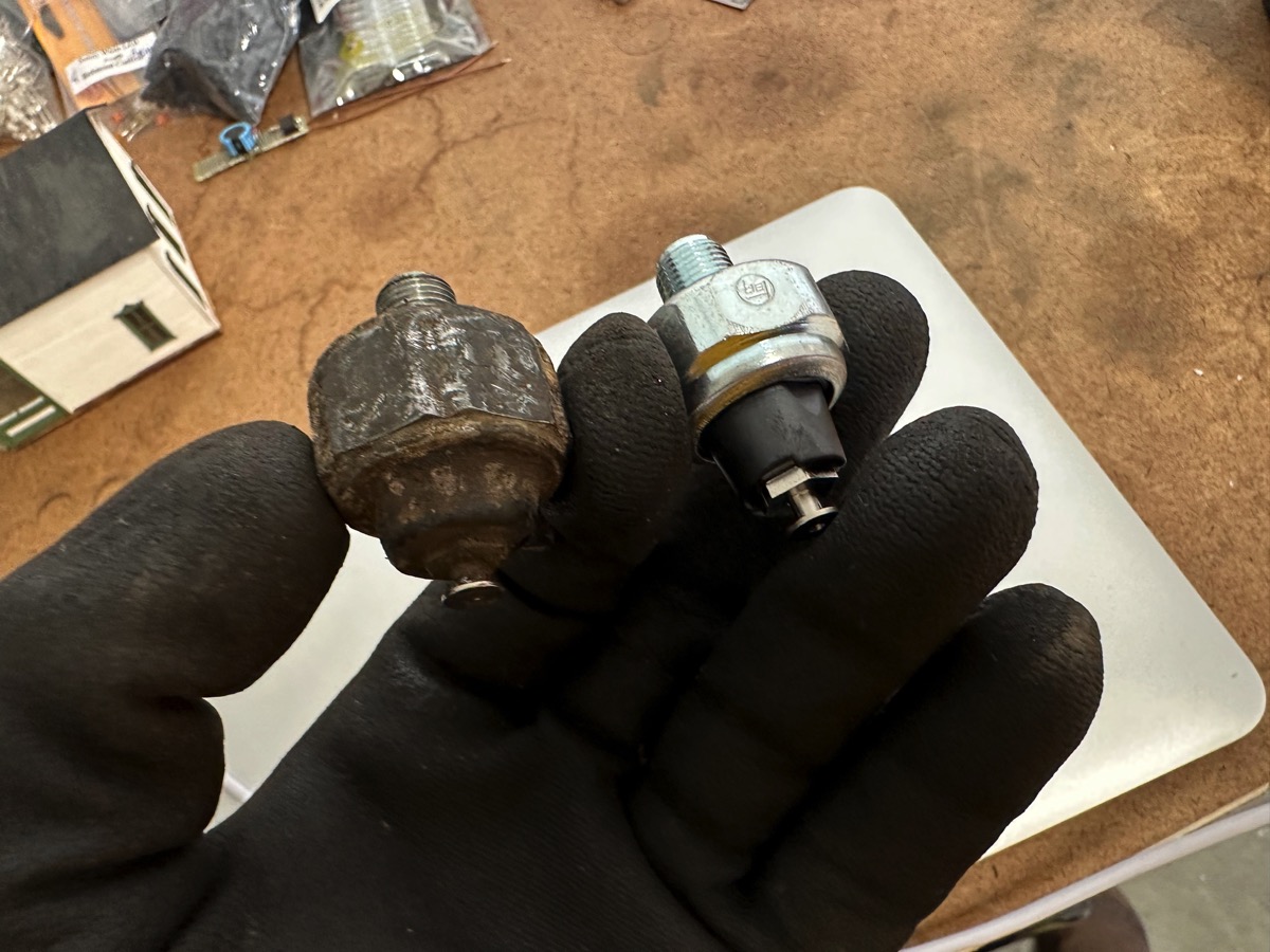

On the last oil change I went ahead and replaced the oil pressure sender. While driving in the snow back in January on a steep uphill the oil pressure light was dimly flickering on me... hasn't happened since. I stopped the engine immediately when it happened.... visually inspected under the hood... and then started up and kept going. Haven't been able to reproduce or observe the problem again. But figured that it made sense to just replace the sender.

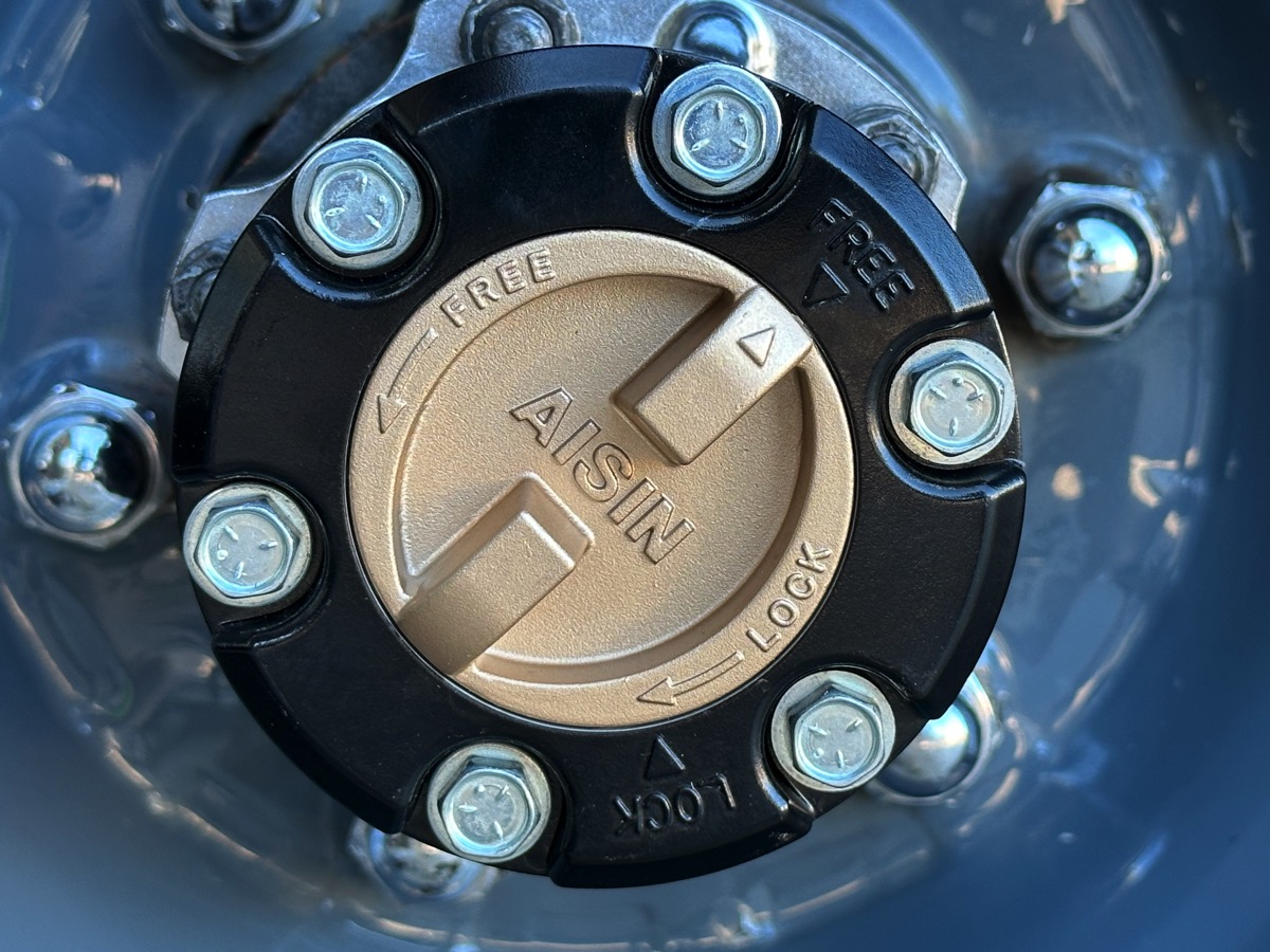

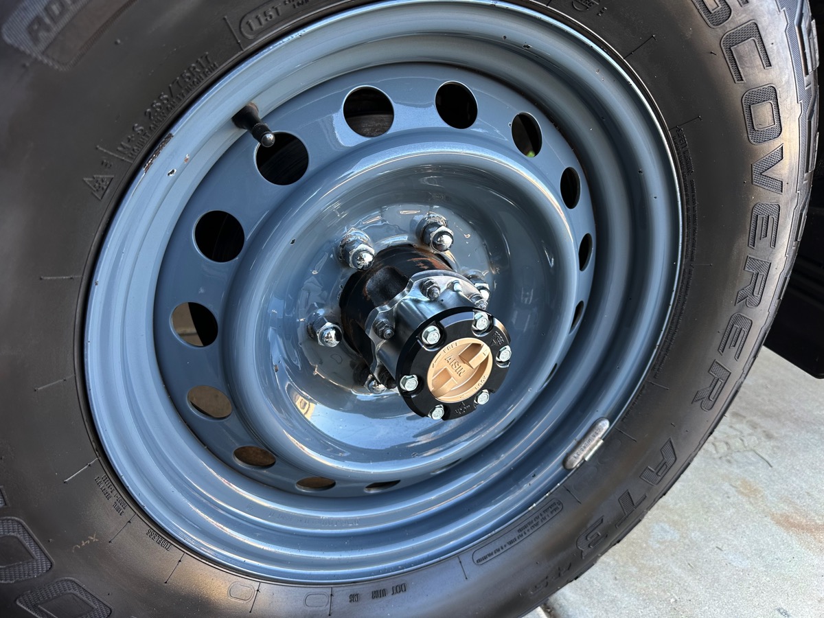

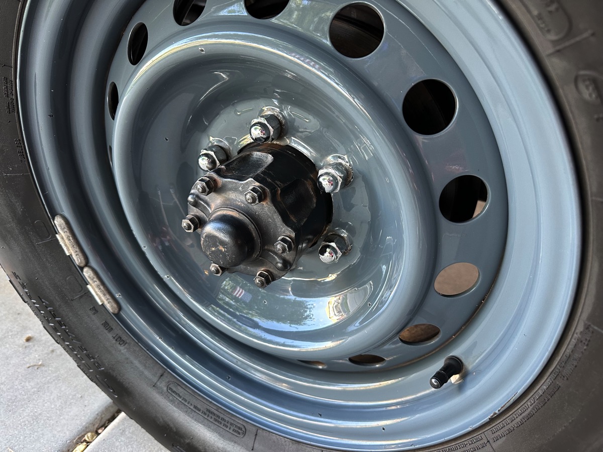

Also, I finally installed manual hubs on the front axle. This has been on my wishlist for awhile and I finally had the funds available to make it happen. It made sense before the upcoming long roadtrip to Solid Axle Summit.
They are so pretty brand new! I've only ever had used ones I rebuild. Shiny!

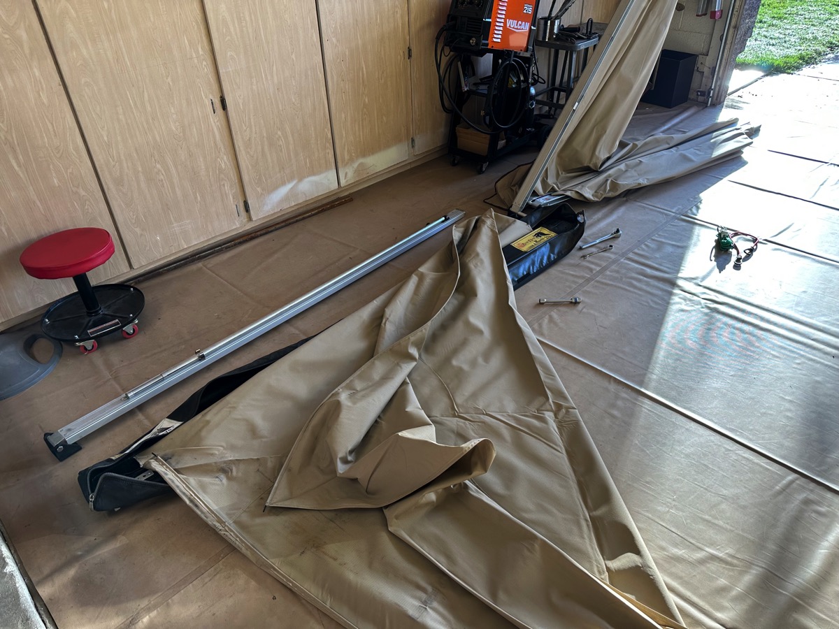

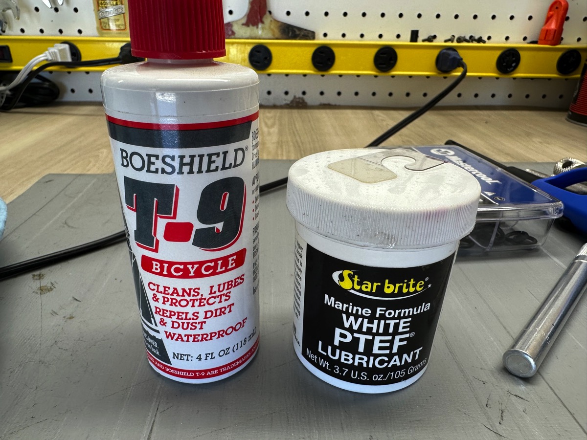

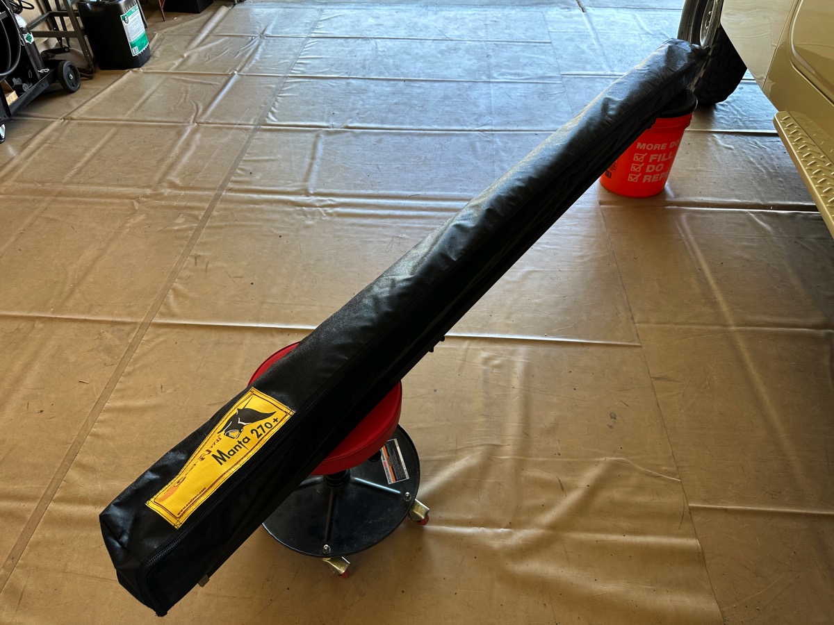

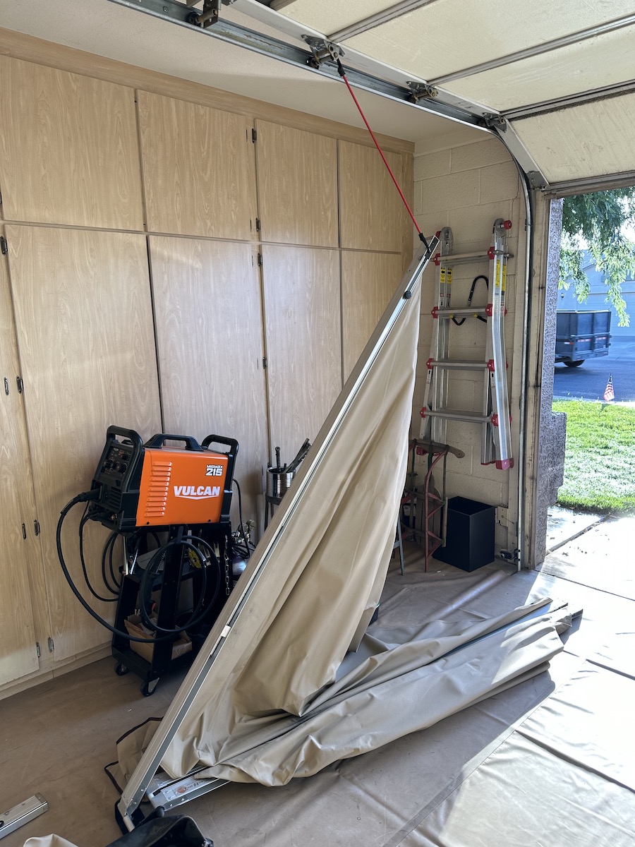

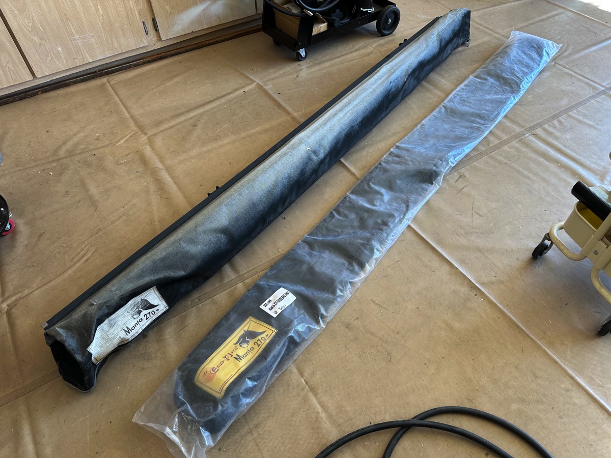

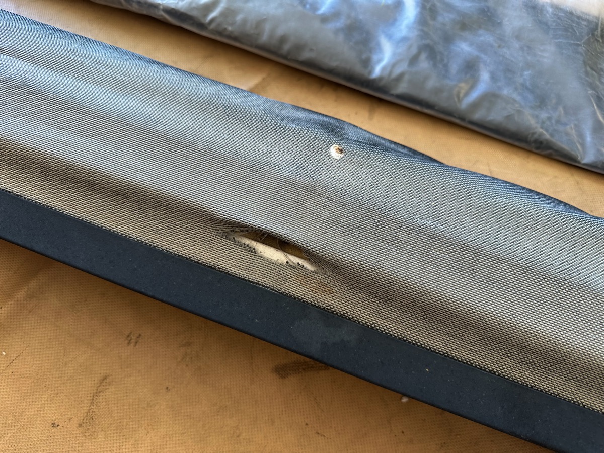

My awning is the Eezi-awn Manta 270. It's been a great awning. We bought it used from @AndrewHadji. The Arizona heat/sun was destroying the cover. So I called up @Equipt and they had a replacement cover, with integral main shade panel, in stock for my unit. It was a fantastic price for a bit of kit that will let me keep this awning maintained... I love kit that is meant to be maintained and not just replaced.
That was last summer... and it needed done then. It only got worse recently.
So I went about disassembling it... there were no instructions and I was winging it, although it seemed straightforward. I had to disconnect all the main arm brackets from the main back channel.
I needed a third hand.
All swing point were lubed with Boeshield T-9; the zipper was lubed with StarBrite White PTEF Lubricant. I learned about both of these items from folks here... though can't remember who. The T-9 dries up into a nice dry lube that doesn't absorb dirt. The StarBrite is great on stainless hardware to prevent galling... and also as a zipper lubricant. I used it on the old zipper when it got fussy and it worked a treat.
All wrapped up. Fresh coat of 303 on the outside cover for UV protection. Now I just need someone to help me remount it!

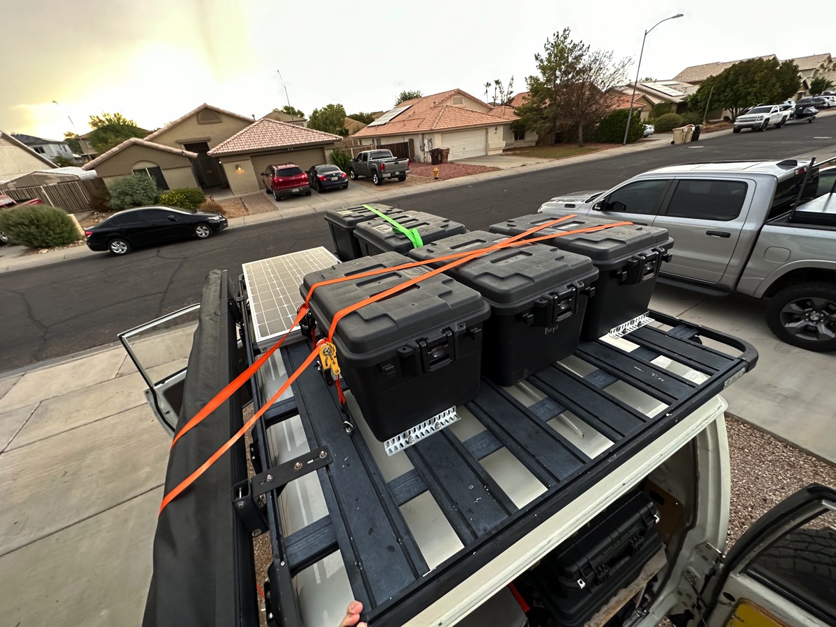

I do like my Sportmans Trunks. I'm using the 56 quart versions without wheels. You can stack them. You can sit/stand on them (rib-reinforced lid). They aren't boogie priced like some other "overland" storage. AND they are made in America.
I'm working on adapting some fittings for more quickly/efficiently strapping them down to the rack. For this trip we took 9 trunks... clothes, pillows, blankets, food stuffs, cooking supplies, dry food stores. That's by far the most we've ever taken. It worked out.

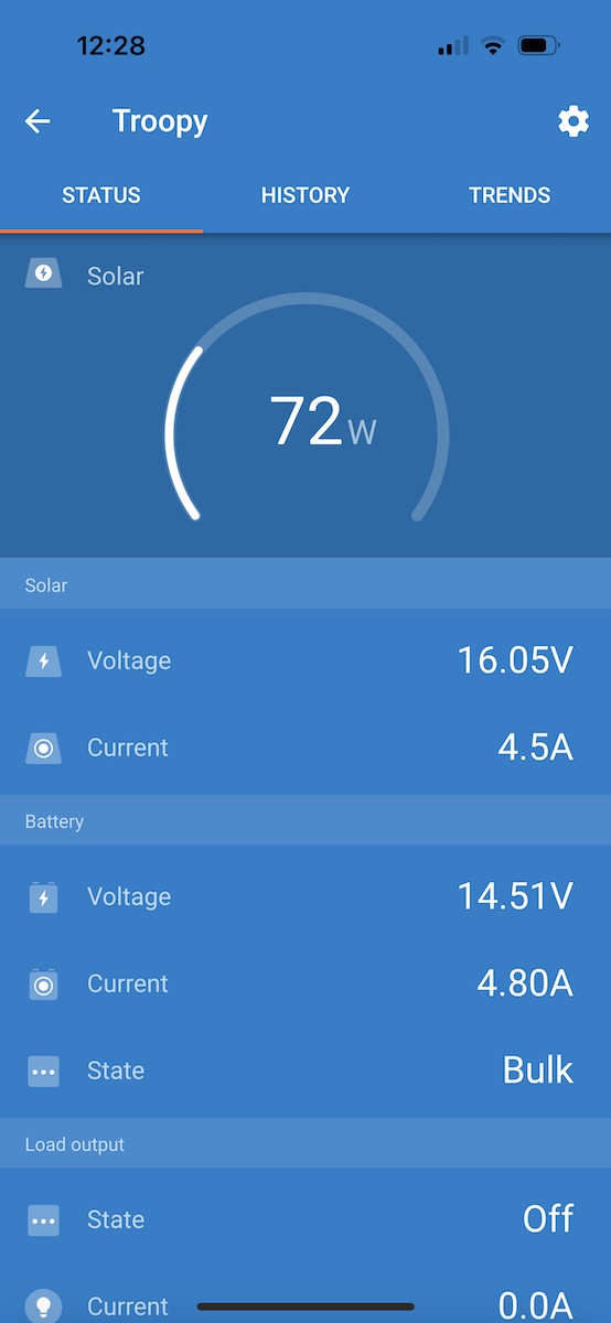

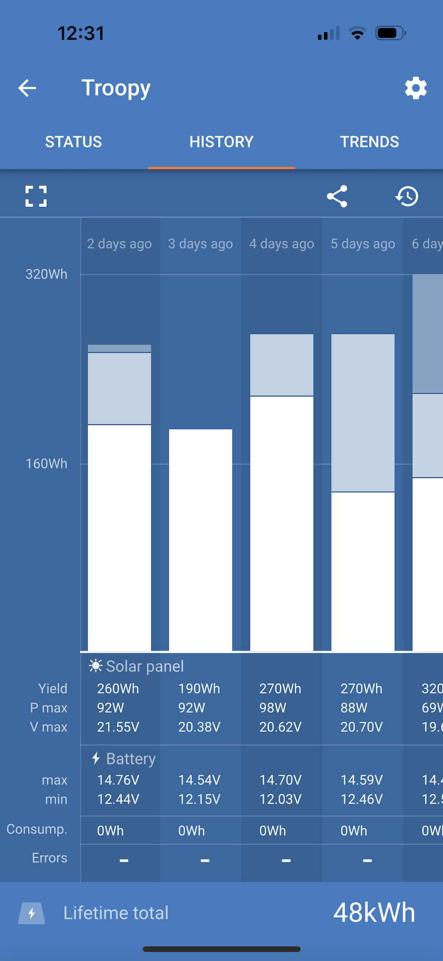

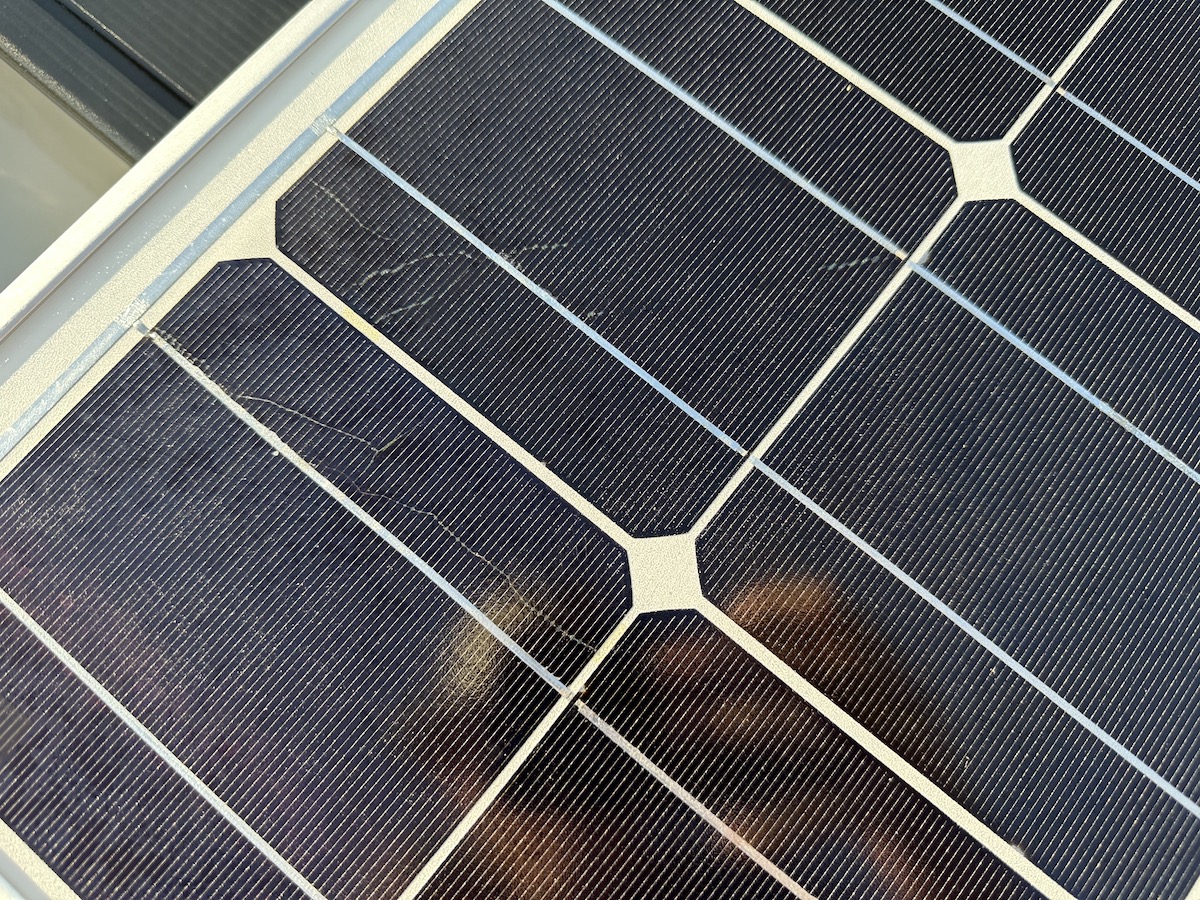

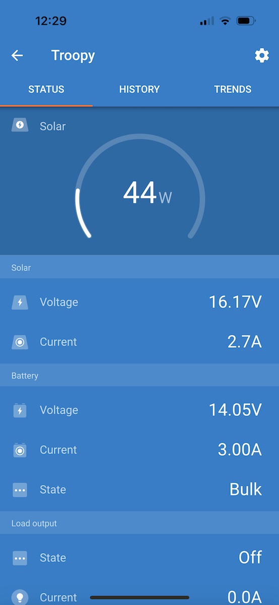

While washing the truck several weeks back I noticed some wear/tear on the solar panel. It's been over three years since I installed it up on top of the truck and it is in the sun nearly all the time. The "paper" inside the panel is yellowing... and there are some cracks appearing in the surface (I think they are in the glass, not the actual cells, though I'm uncertain). Anyone have insight on solar panel damage/wear?
I was a little concerned... however, on our trip to CO I was hitting the 90's for my Pmax (maximum wattage generated by the panel). One day even hit 98W... and it's a 100W panel. So still highly efficient and it had no problem keeping up with our refrigeration needs even with many days pretty overcast at times.
I bought a 1000W inverter (not pure-sine-wave) some time back to install in the Troopy. I've just never gotten around to it. It's more of a nice-to-half than a necessity. However, I picked up a 300W Jackery unit for my hunting trip last year and had only used it a few times. For this trip it got extensive use. And it has a pure-sine-wave inverter built into it. I have a handy 12V plug at the back of the Troopy it can plug in to and charge from the solar and/or car battery (solar charge controller handles that). It can charge devices and run the inverter while it's also pulling from the charge controller. And it's portable. I'm no longer going to install the 1000W inverter. The Jackery just provides a superior solution.

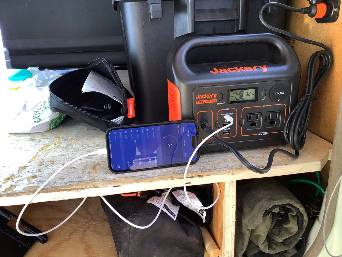

Also, fun thing about that last pic with the Jackery... my iPhone has the solar controller software pulled up to monitor the solar charge... which is charging the Jackery... which is charging the iPhone. Nerd alert... I know.

Unless the panel is defective in some way, you should see 25 years out of a decent panel, (and probably still running 80+% efficiency). From your tests though it is still efficient. And the glass on those is pretty tough, so I would be surprised if it was cracked.
That said, I have seen things break in the oddest ways when improper stresses were introduced. IE: were things piled on it (strapped down over it?)
The other thought is when placing these on a surface that may flex could also introduce stresses that are unusual. But from your pic it is hard to tell what those marks might be from.
Say, what monitoring program are you using on your cell phone? I have a charge controller, but it would be nice to get some more stats on everything when testing my multiple appliances.

The panel is mounted firmly at both ends… which made me a bit concerned about flex in the middle. Those cracks are actually at one end though, not in the middle where there’s any flex. I’ll keep an eye on them.
I’m using the VictronConnect App. My solar controller is Victron and has the Bluetooth dongle… it’s a seamless interface.

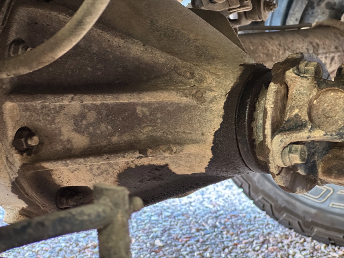

Found one of my next projects upon my return...
Wow, that looks awesome! Hope y’all had fun.
Leaky pinion seal? Gonna add a locker “while you’re in there”? :rofl:

While I'm in there... :hmm:

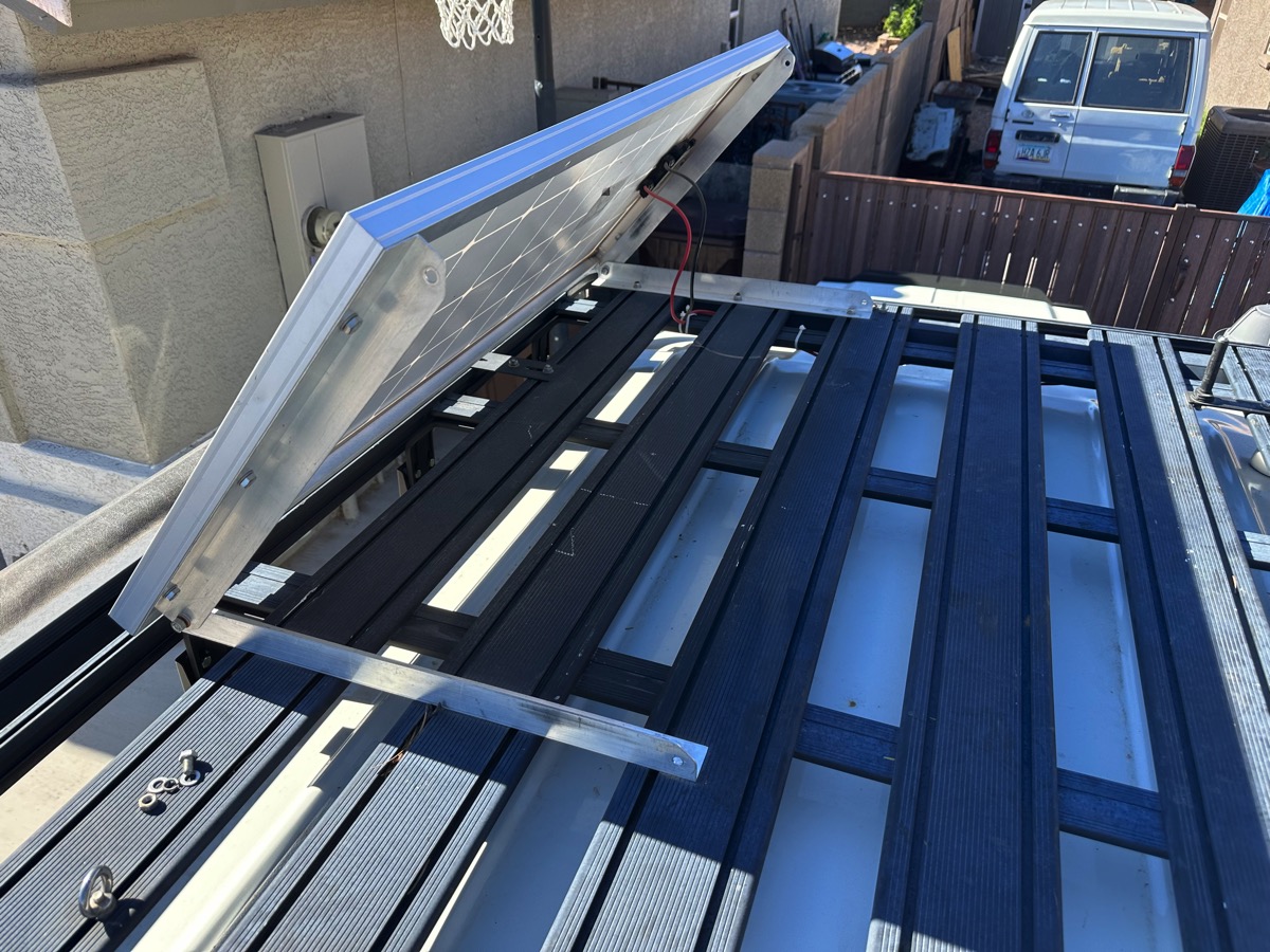

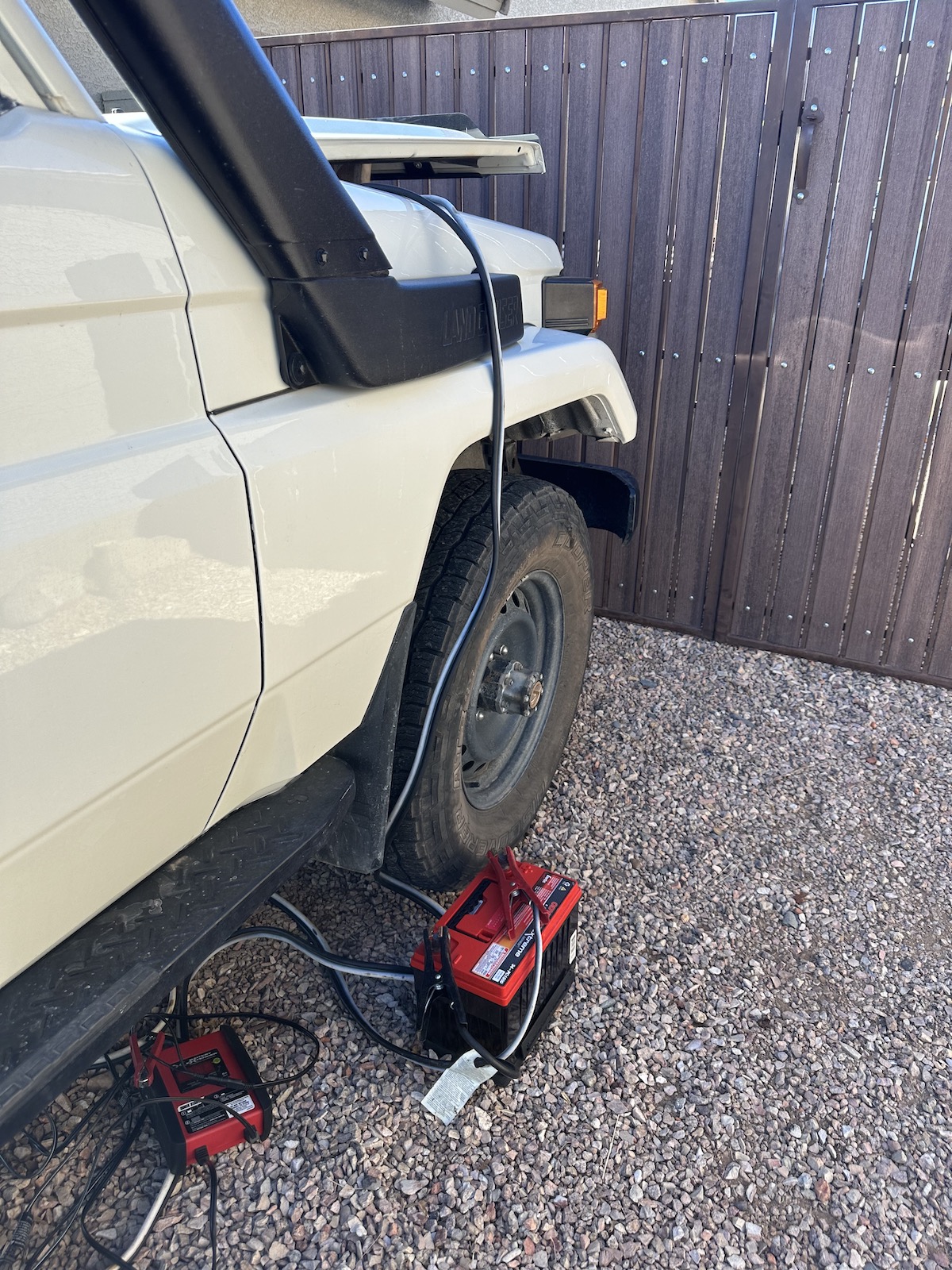

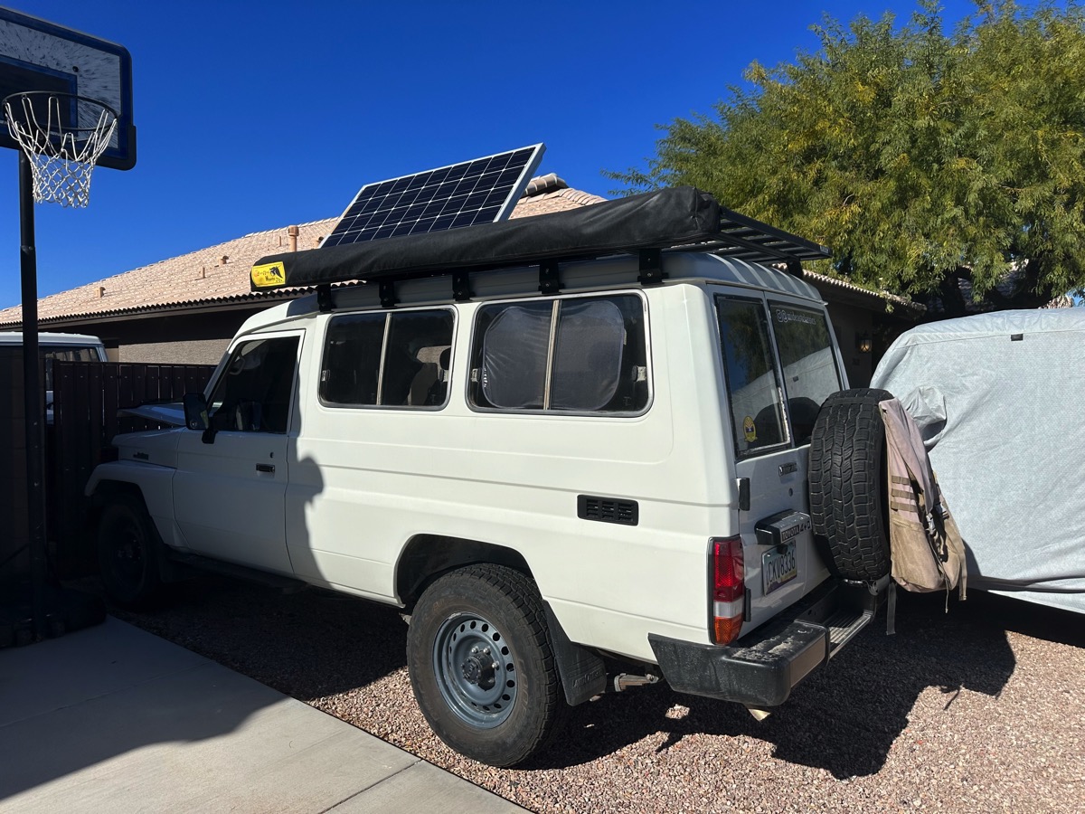

Left the headlights on in my 40 the other day... drained the battery down bad. It's an Odyssey so built for deep cycle but this was pretty bad. My battery charger wouldn't recognize it.
As it turns out I've found the Troopy's solar panel and charge controller to be a great battery charger... I just parallel the bad battery and my Troopy battery and it takes care of the rest. They are identical batteries so it works perfectly.
I noticed it wasn't grabbing as much charge as it normally does with the sun being so far in the southern sky. I built the mount for my panel to easily facilitate angling the panel. I've just never done it. So I figured I'd give it a shot.
Wattage before angling...
After angling... major increase.
Here it is angled upward. When I lowered it back down I reinstalled the hardware with wing nuts so I can more easily do this while remote in the future.
