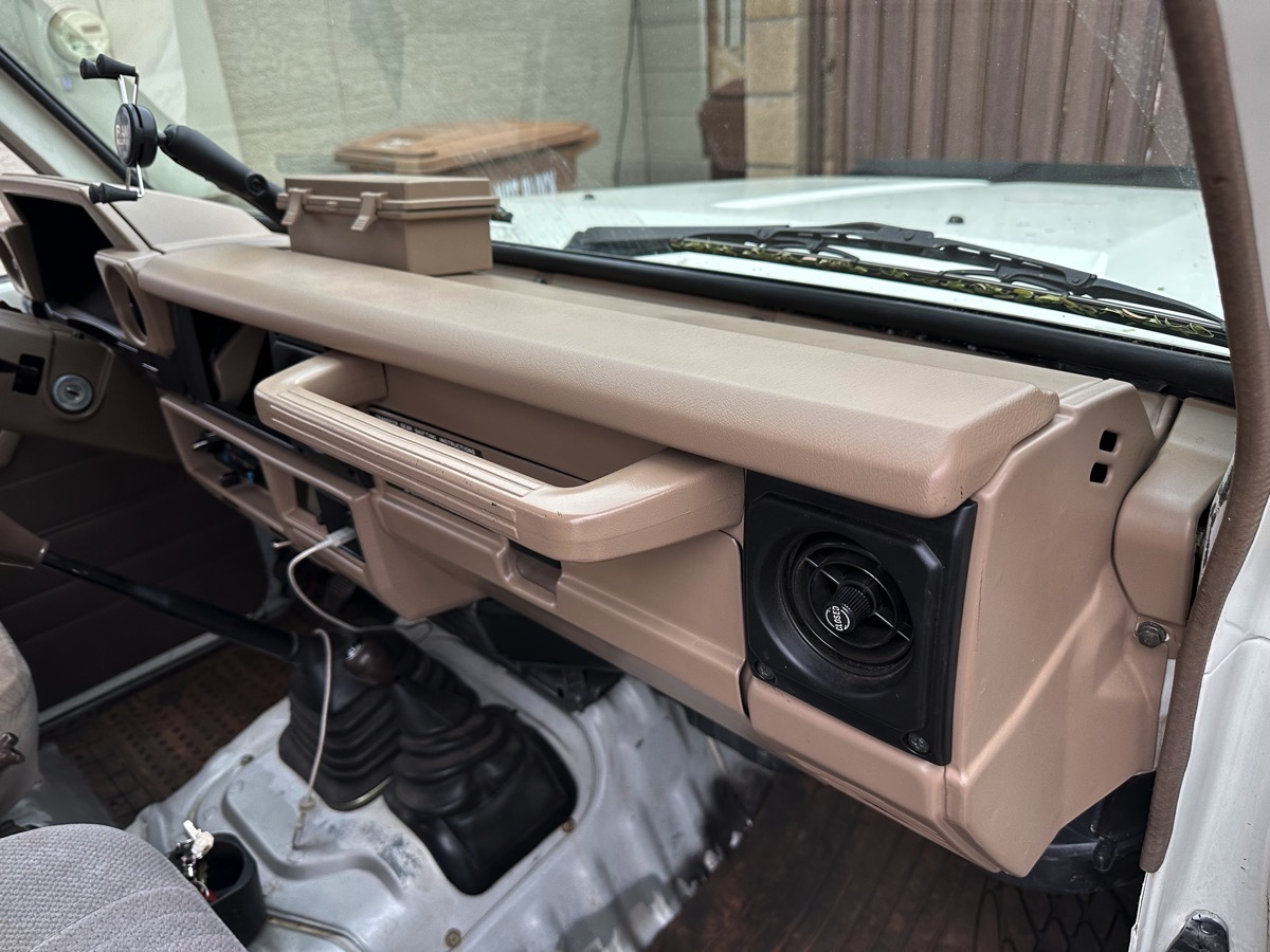

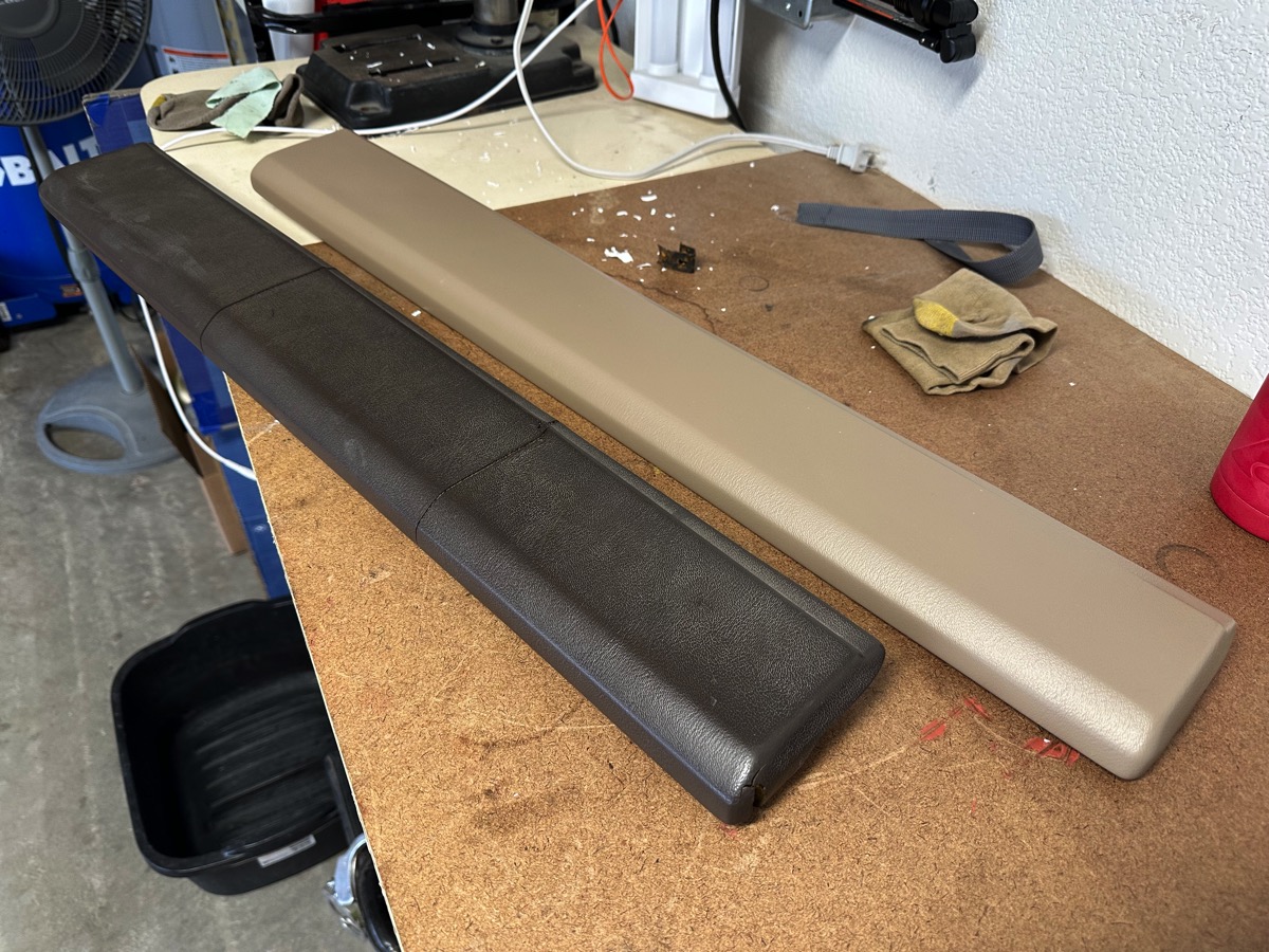

The restored FZJ75 Troopy that I have for sale right now had a few small blemishes in the original dash pad... barely noticeable but enough that I thought it was better to replace it. So I bought a new one and put it in that truck.
But the removed dash pad was in far better shape than my own... so a swap seemed a solid idea.
How my original one looked...
I painted up the better condition one with SEM paint... have been very happy with it's endurance on other items I've painted for the dash.
And installed. Huge improvement!
My super OCD son is now complaining about the steering column, steering wheel, and shift knob. Ha!

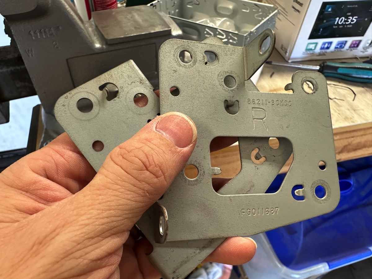

Work has been a bear... fair amount of travel and quite busy with project deliverables and proposals. Haven't really had time to tinker much. It literally took me 5 months to finish this little project... a stereo install! I really wanted this done before our upcoming roadtrip to Solid Axle Summit. We enjoy audio books as a family... and the kids will do iPad movies in the back as well.
Amazon had a lightning deal on this JVC head unit I'd been watching, so I snagged it.

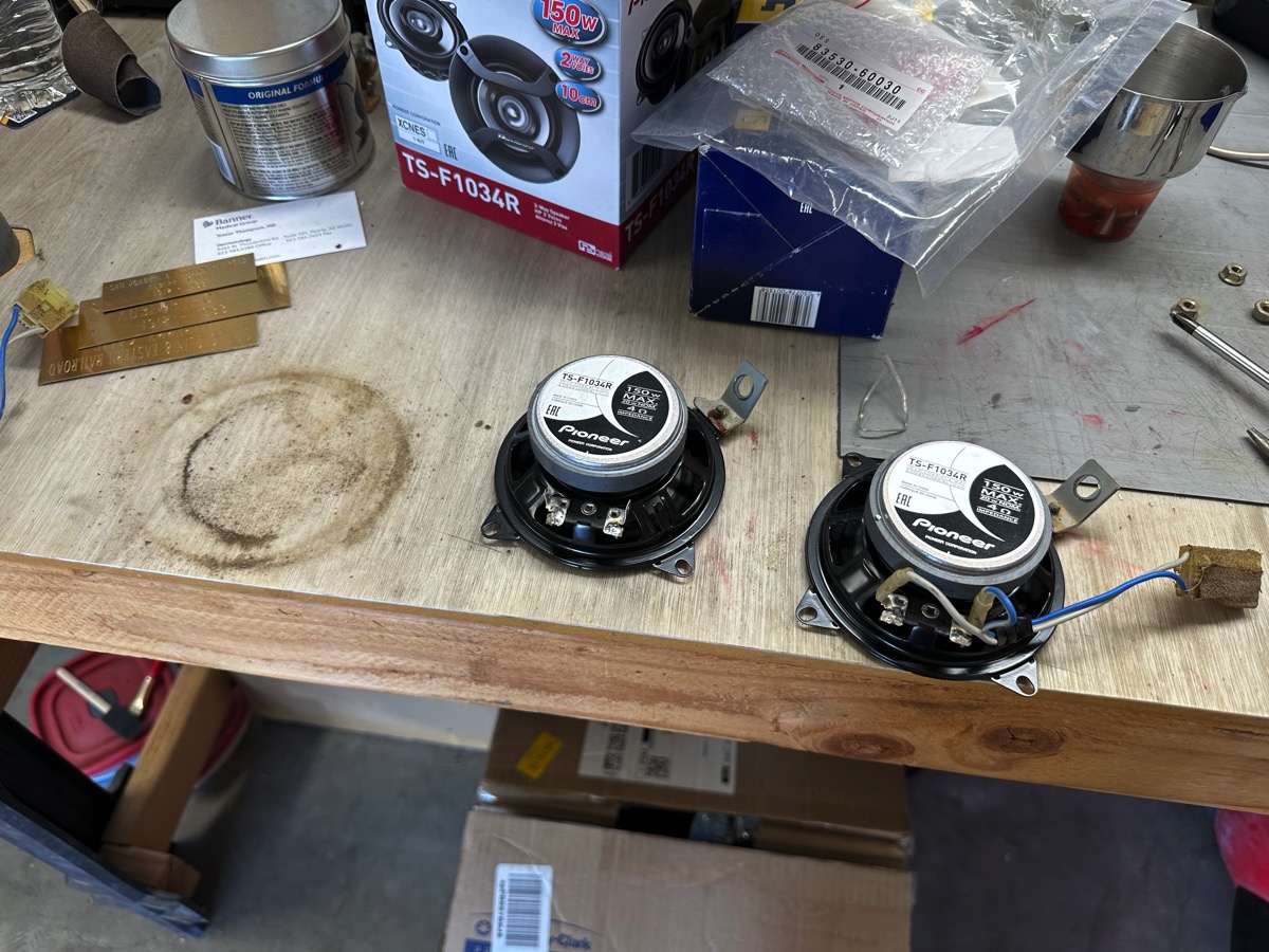

I had some 6.5" speakers that had been on the shelf for some time. So while I had the rear panels off months ago I went ahead and installed those.

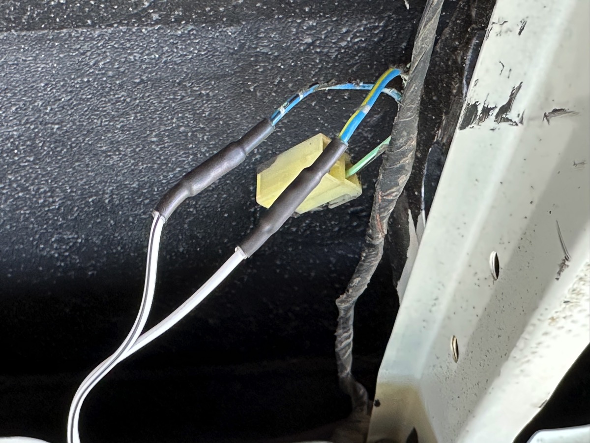

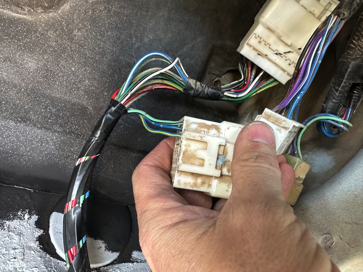

I actually pirated some existing wires in the harness that runs to the rear and has no function up front. That helped me run to the rear speakers which the truck had no wiring for.
Got some new fronts as well. That dusty circle on the left is where I had set down one of the old ones. Yuck!
I got a new female plug and wired that in to the rears. That gave me the wider existing plug already in place to serve the fronts and get power... and the new smaller rear plug to serve my new rears.
I had to dig through my parts bins to find these... so glad I saved them.

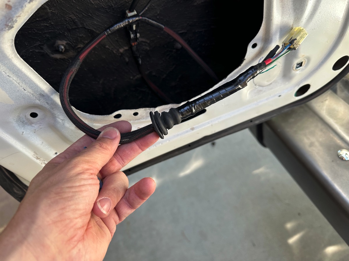

Also, for an exciting new feature I had to re-loom the rear ambulance door harness.
Head unit in, rear-view camera works great and is linked to shifting in to reverse. Works like a champ! The stereo sounds way better than I expected... it isn't going to win an award, but it passes for our purposes.

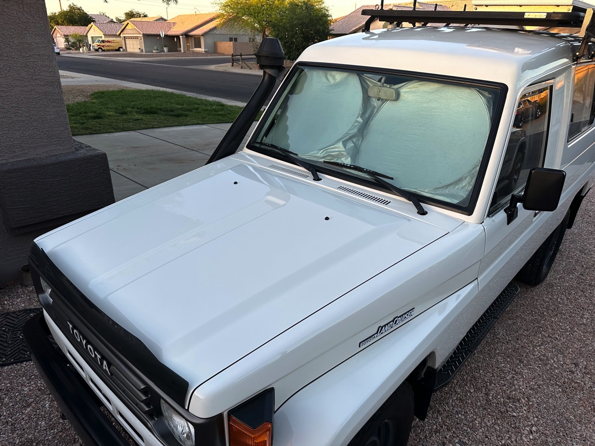

Way back in April I gave the truck a thorough cleaning inside and out. Pulled mats out, etc. It hadn't been washed since last September... and had been on multiple trips during that time. She still cleans up nice.
Gave the hood and front roof the Griots treatment.

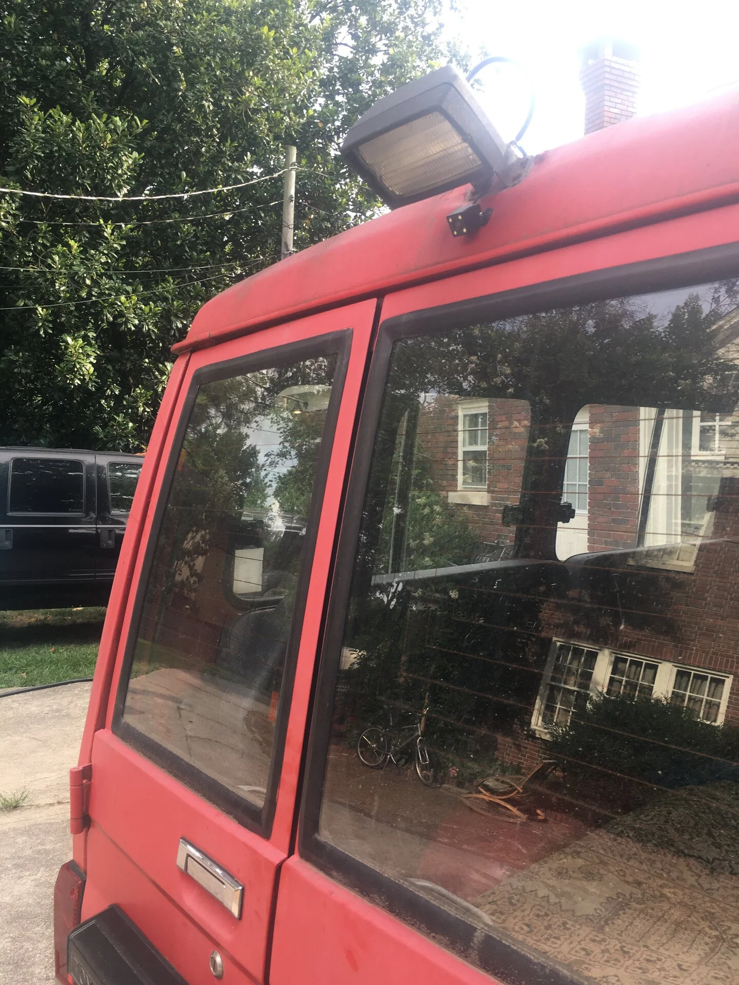

Where did you mount the camera? 😊
