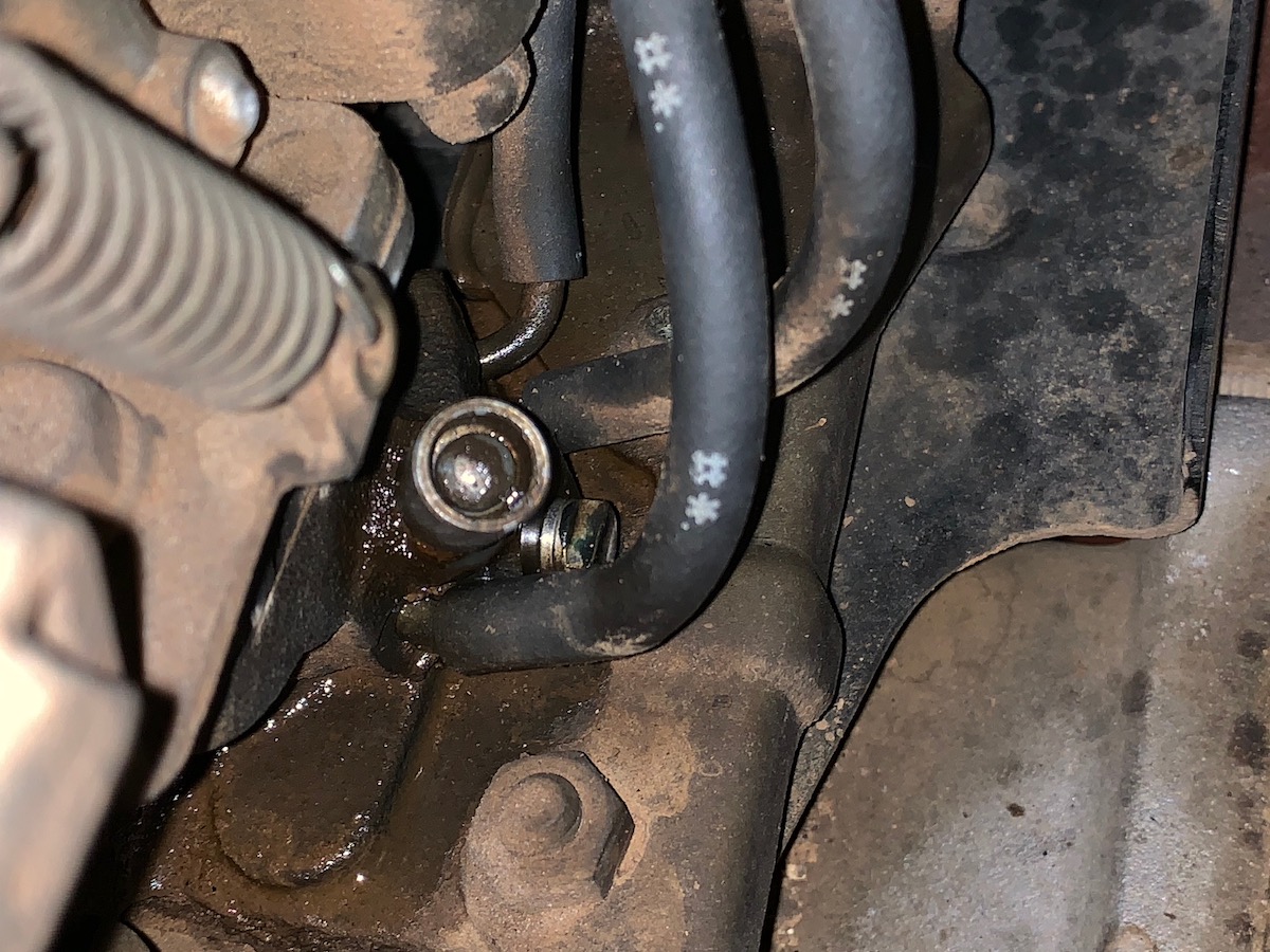

Did you follow the FSM to lean out the carb? How'd you adjust the idle mixture screw? Mine isn't a screw... do you have an SST?

My carb doesn't have the traditional screw... it has this thing that needs an SST.
I'm working on a solution to be able to adjust it.

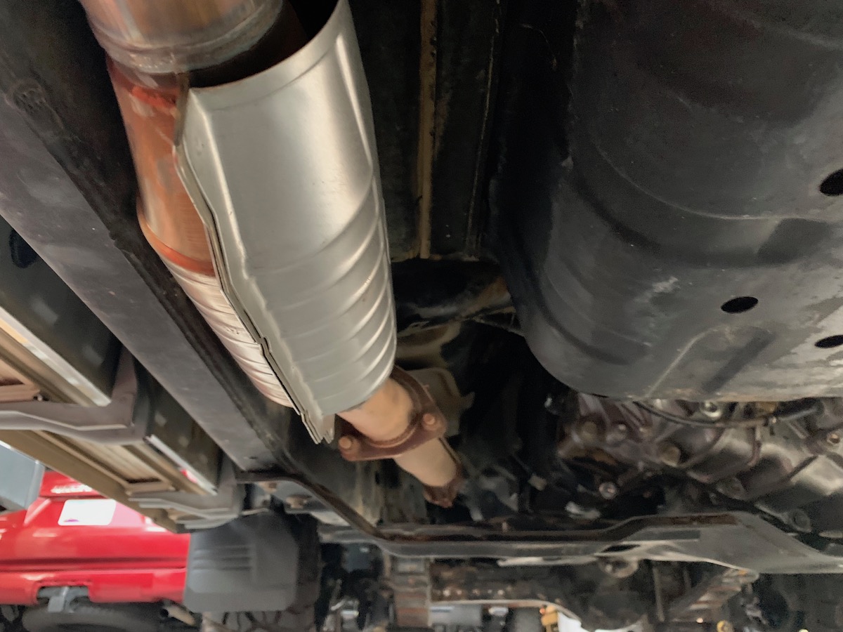

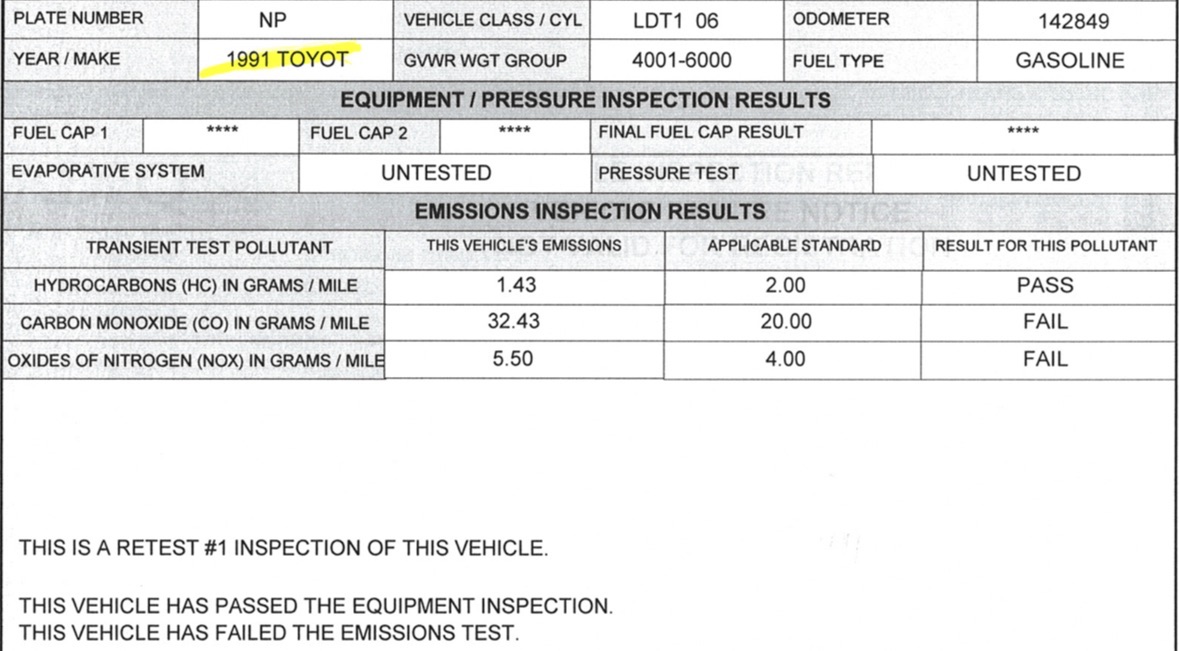

Also, got a catalytic converter added...
While it did help it didn't do enough...
Exercise caution installing a cat on a vehicle that didn't have one in the first place. It is quite likely that the cat will be dealing with a lot more unbundled fuel than it is meant to handle. This could result in excessive heat, enough to be potentially dangerous.
And I have been keeping an eye on this. I bought an IR temp reader. So far the catalytic converter hasn't been running any hotter than the exhaust pipe upstream of it... the muffler was hotter than the cat when I checked yesterday after a long drive.
Interesting. Maybe dremel a slot onto the Idle mixture screw ? Then just use a flat head screwdriver.
I seem to recall that some of the Ferraris I used to work on had an aluminum cap on their idle/mixture adjuster(anti-tampering). I had a real cool tiny slide hammer that I welded a self tapping screw to....drill a hole, screw it in, pop it out.
Hard to tell if that is a plug or something else....
Hello,
GCC spec Cruisers have that type of idle mixture screw. It requires a SST for adjustment. Part number is 09243-00020.
General market specification carburetors have a flat screw.
Juan
That tool is discontinued... though I did manage to track one down and it's in the mail to me now.
