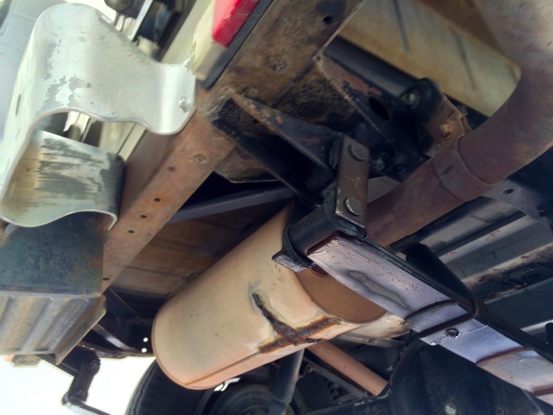

Snagged a very clean 1977 FJ40, GCC spec. Originally from Saudi, this was clearly from a drier portion of the country. Many of the typical rust spots are in perfect condition. It's got a little bit here and there, but no showstoppers. The chassis is in amazing shape. I'll let the photos do the talking… then I've got some questions.
Here's a typical shot of the wheel well condition...
Had to have a front axle seal repaired, all the suspension bushings replaced, and two chincy seat belts put in to get it to pass inspection. It runs great and I've already been scooting around Abu Dhabi in it.

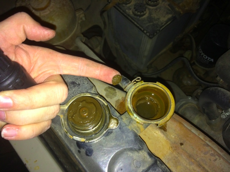

So here's what I found when I popped the radiator cap…
It doesn't smell or appear oily… just smells like rusty old radiator fluid. Lots of gunk on the rad cap. My thoughts are to flush the system and probably replace the water pump as a matter of course to baseline some of the mechanicals. Any other ideas or suggestions?

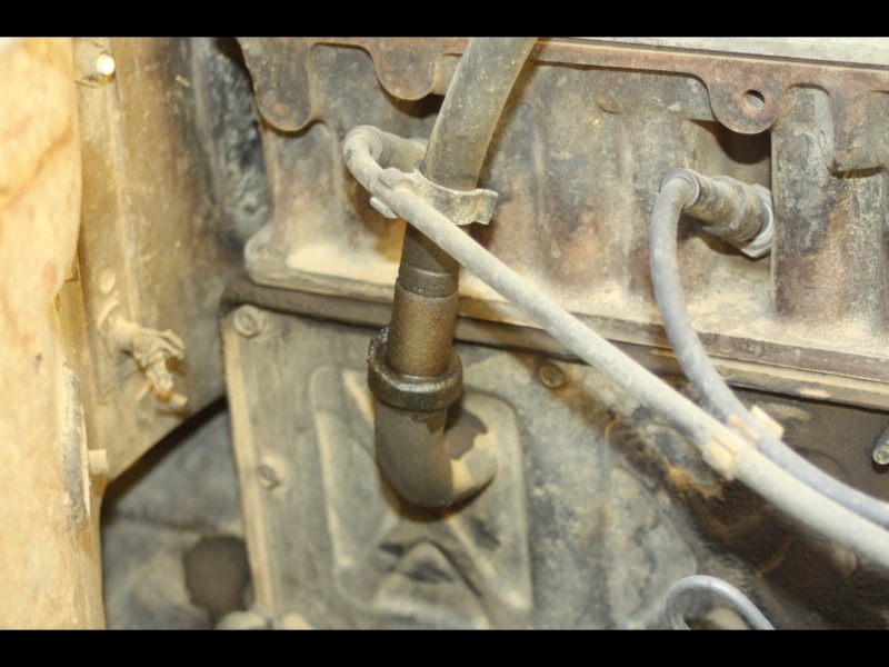

Can anyone tell me what this is and if I should be worried about the bit of oil oozing out? Tips or suggestions?

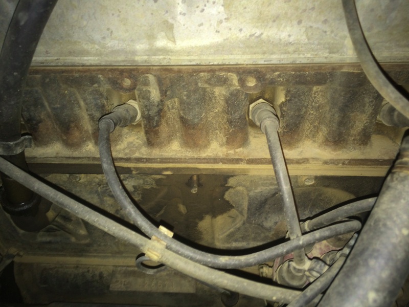

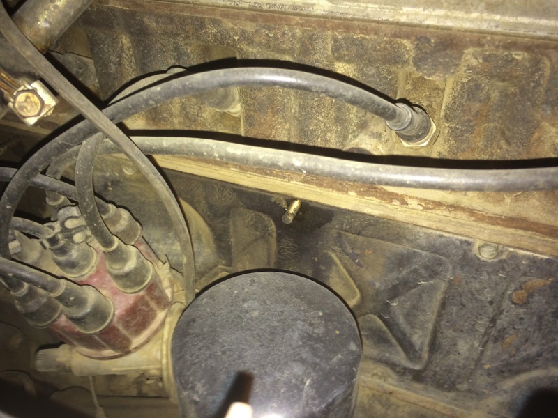

Lastly are these two studs sticking out through the lifter cover. Should these have nuts on them? Should they even be studs? Tips or suggestions?

Looks fairly typical for Middle Eastern trucks. Try a couple of clear water flushes before refilling with 50/50 coolant.
I guess you are asking about the PCV valve that exits the side cover and the two studs that usually hold a metal tube for either a heater or an oil cooler, depending on destination of the truck. Since KSA trucks came without heaters, someone likely removed the oil cooler and forgot to put back the ferrule and nut on each stud. PCV valve can be flushed with gasoline and reinstalled.

When you flush the coolant, don't forget to flush the block as well .. There's a drain between cylinder 5 and 6 on the left side of the block .. You can see it if you get down low in the wheel well and shine a light at the block. Could be tough to remove .. Use penetrating oil and patience .. Don't force it .. Patience!!
..and don't forget to burp the cooling system to get any air out.
When you clean the PCV be sure it rattles when you shake it.
Hmm thats pretty bad. Might be a good idea to have the radiator hot tanked at a radiator shop. Flush the system real good with water and as mentioned pull the block drain. Get a new radiator cap. Use distilled water or just buy premixed coolant when you refill the coolant. Also look into treating what little rust you have so it wont spread.

Your truck may have had factory heat originally and at some point had the system removed. Would explain the studs on the block where the heater tube would go as well as the plate over the firewall hole for the heater blower, although that delete plate looks pretty professional. I have seen a similarly aged truck in Saudi that did not come with factory heat and the firewall did not have the opening at all for the blower. Since you have the opening you could source the parts if you wanted to but it might be simpler to just go with an aftermarket A/C system and an aftermarket heater instead.

that valve cover is for a later 2F, here in the US those didn't show up til 79. perhaps you had an engine swap at some point. maybe to you have the later flat head pistons. maybe GCC spec got the later 2F's in 77. maybe someone just swapped the cover at some point.

I think you will find that most of the surviving 40 series trucks in the Arabian peninsula have had their engines swapped out at some point in their life--fairly typical.
Similarly, other parts are replaced with later versions--fuel pumps, master cylinders, valve covers, etc. Expect that these items have usually been replaced to keep the truck running and serviceable for the last 40 years. Note: good mechanics replace factory parts with correct factory parts, and do it skillfully; unskilled laborers will install anything that "sort of" fits, will do it terribly, and you should expect to remove and replace any butcher-jobs you may find. Many original Toyota Land Cruiser parts are available throughout the Middle East through small shops at decent prices--not the case today throughout most of the rest of the world.
Your engine has probably been swapped with a later version 2F. According to the code on your engine's head, your head is correct for General market, is closed-chamber, has no air injection ports bored into it, and uses flat-top pistons, not the hard-to-find domed pistons that would have been standard for your year truck in the US market.
You can check the date code on your engine head to determine its build date; the same goes for the date code cast into the left side of the block for its date of manufacture. If you post these numbers, along with the info on the firewall plate, some of us here can decipher what exactly you have there. All this has little to do with the value of your truck, unless you are looking to have a 100% totally original museum piece when you are done fixing it.

Sounds like there is consensus here that I don't have the original engine. That's okay with me... this isn't meant to be a 100% museum piece, it's meant to be my cruiser for driving, enjoying, and teaching my boys to tinker with cars. The later model 2F puts me in a better position for a power steering upgrade as the head already has the tapped holes.
I'll get the head number, block number, and builder's plate posted here for more information.
