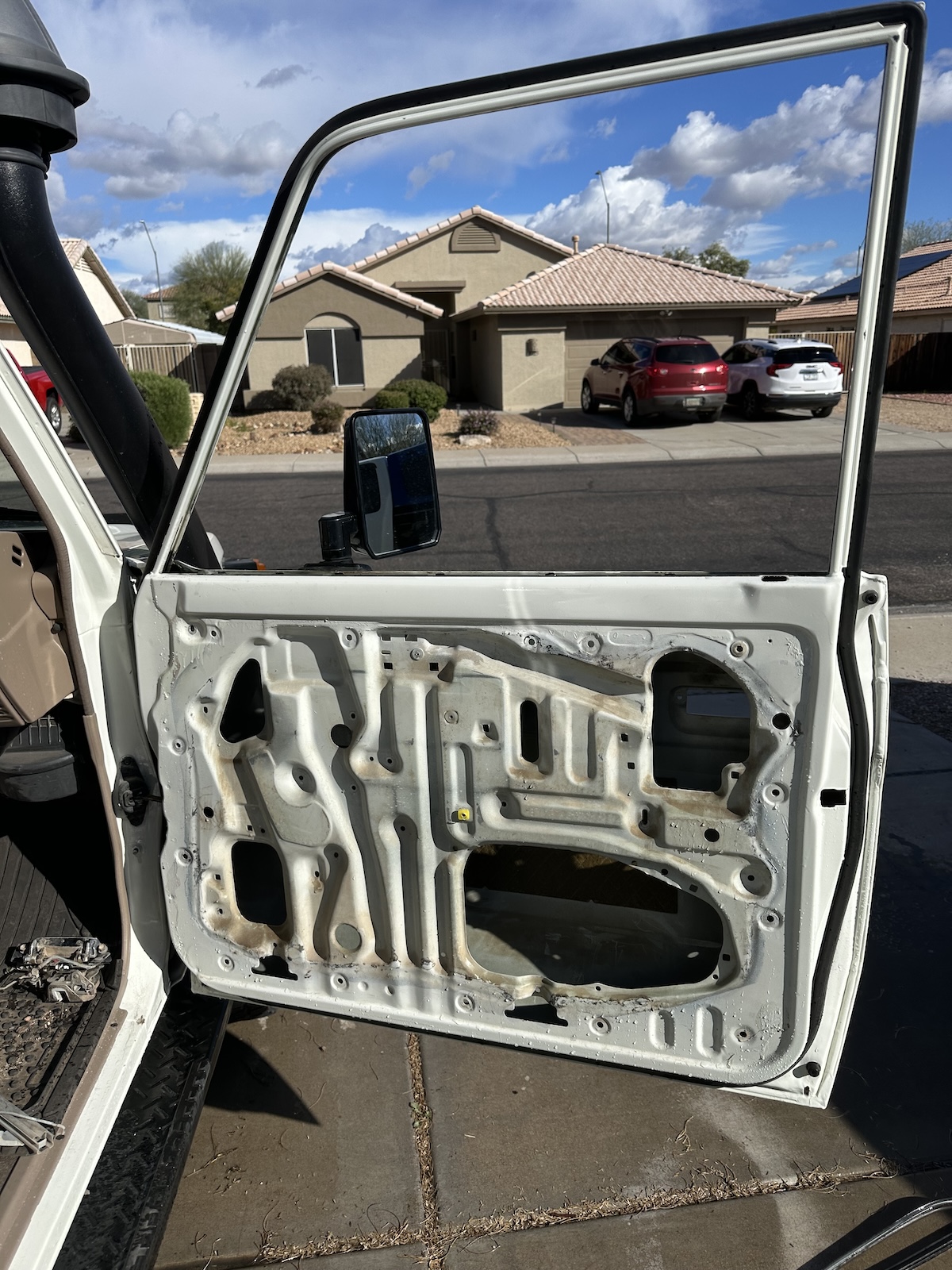

So the panels came off.

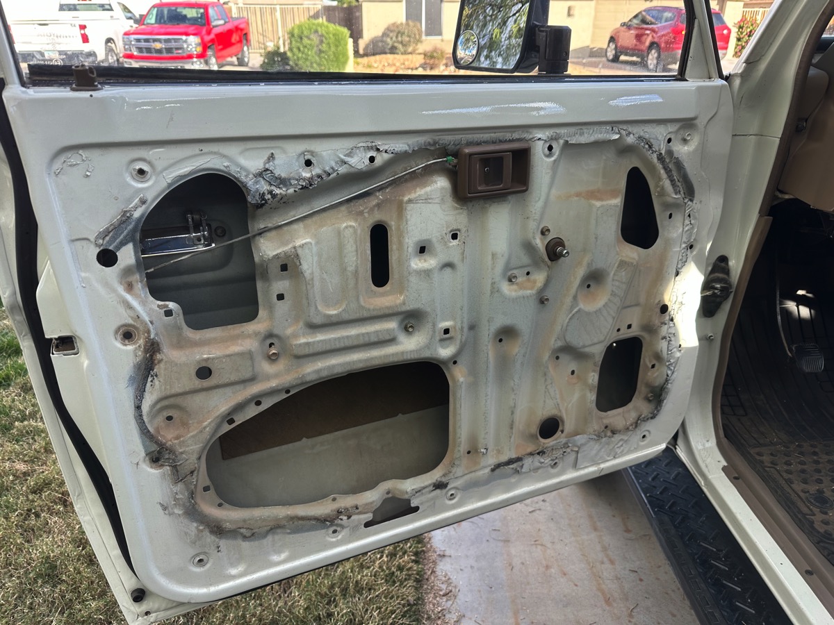

And I've got the passenger side completely stripped down. Thoroughly cleaning it inside and out...

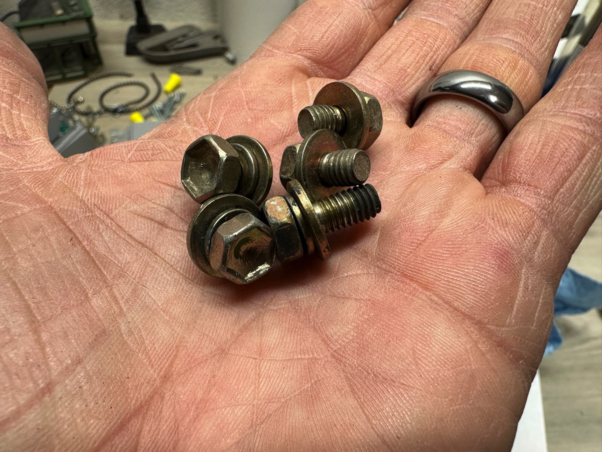

The condition of the hardware after all the fesh-fesh is cleaned off just amazes me.

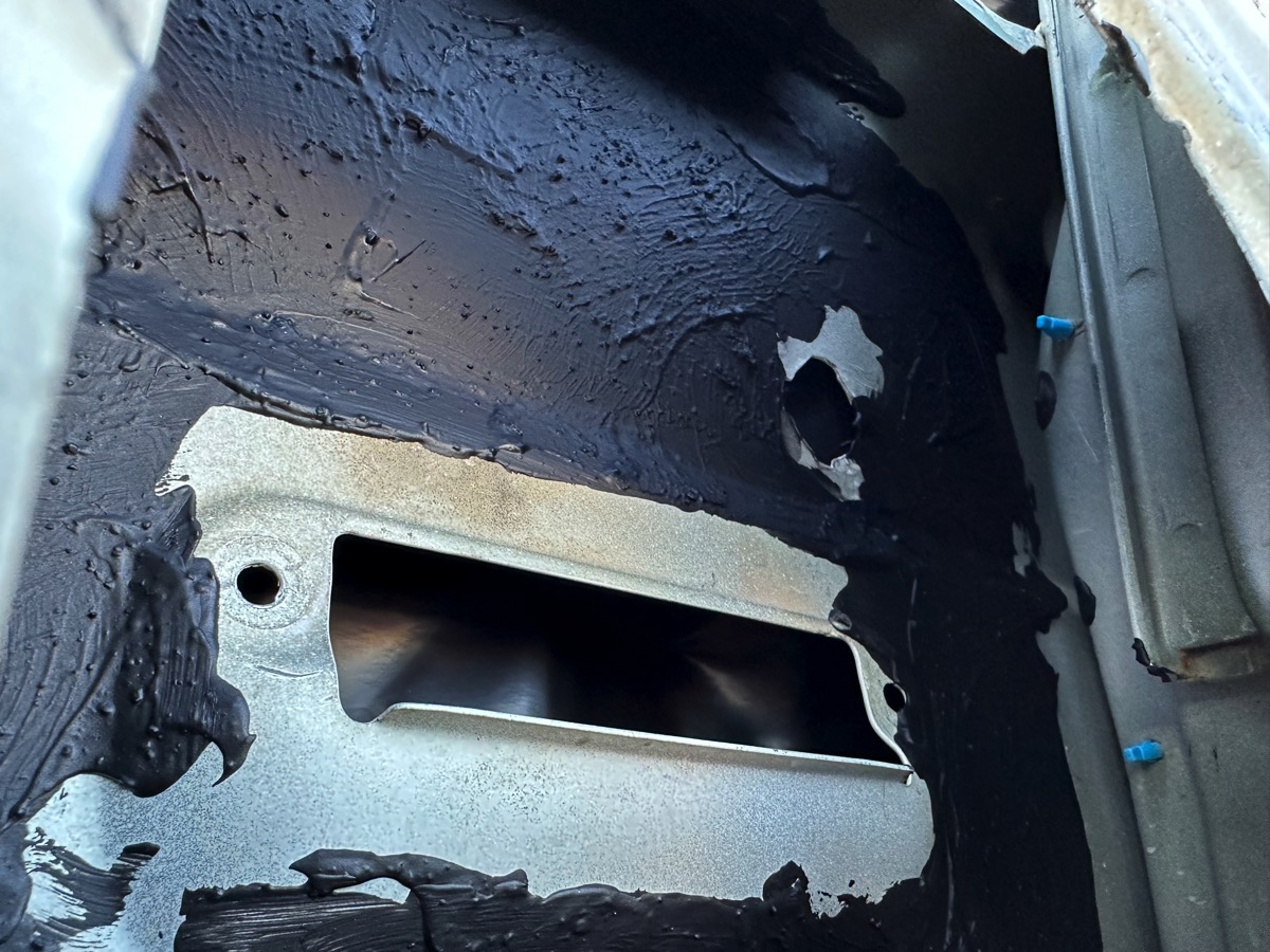

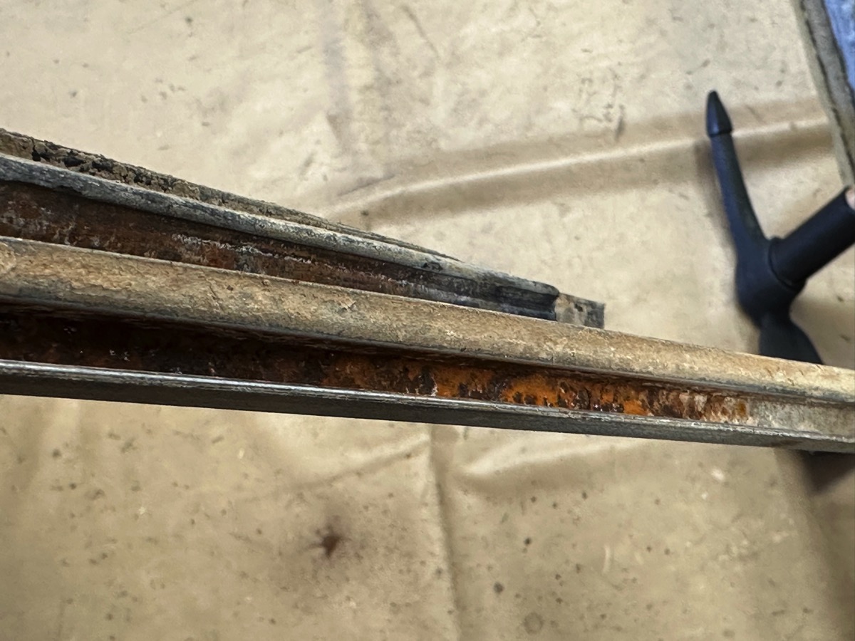

The window channel had a lot of rust down inside.

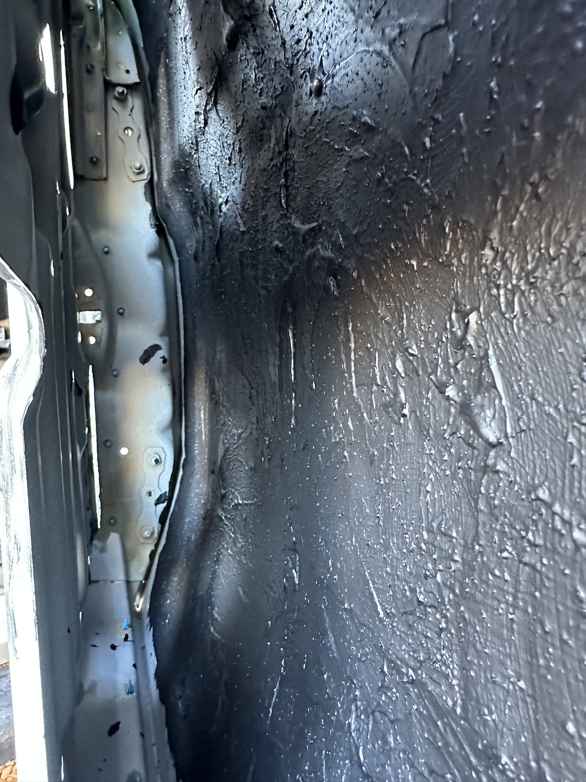

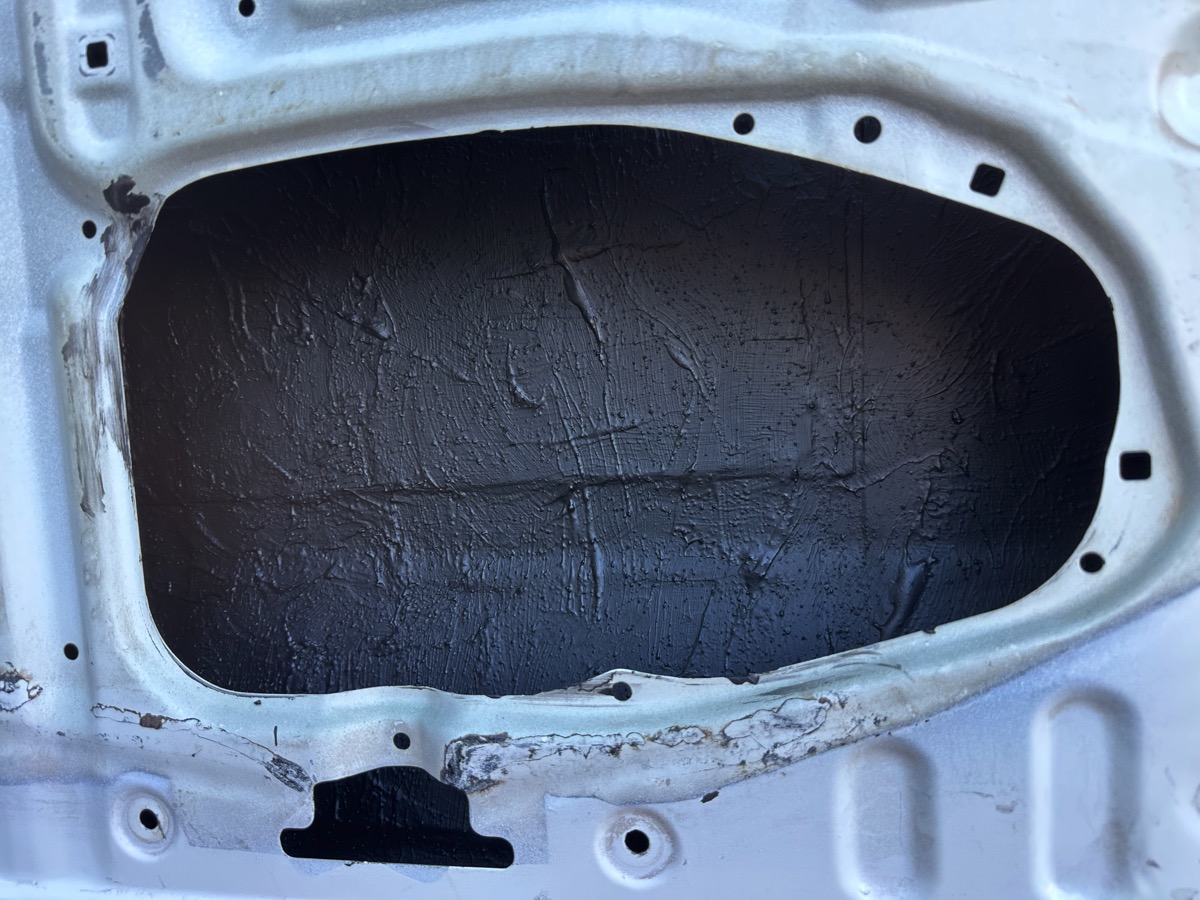

Spectrum was painted over Damplifier inside the door.

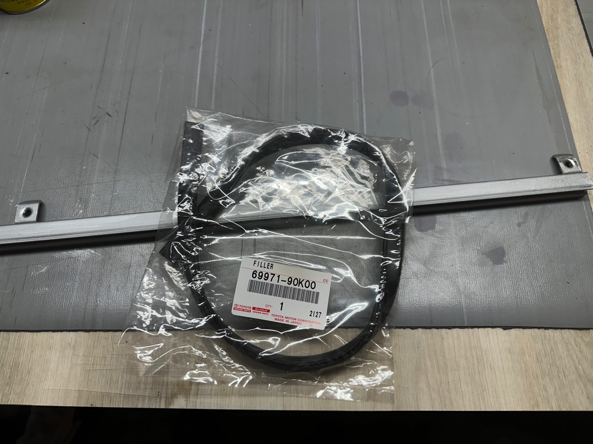

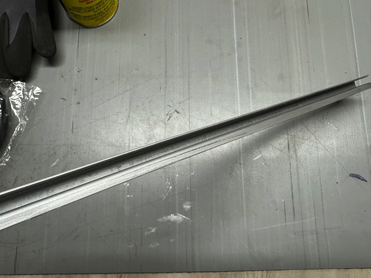

And the window channel has been painted up with Mastercoat. Struggling to get the window back into the channel with the new rubber filler.

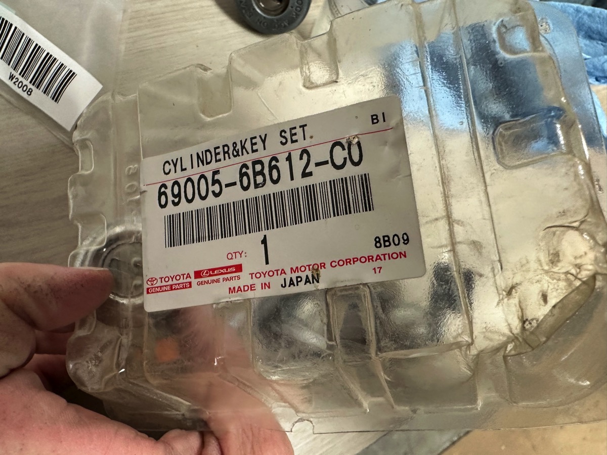

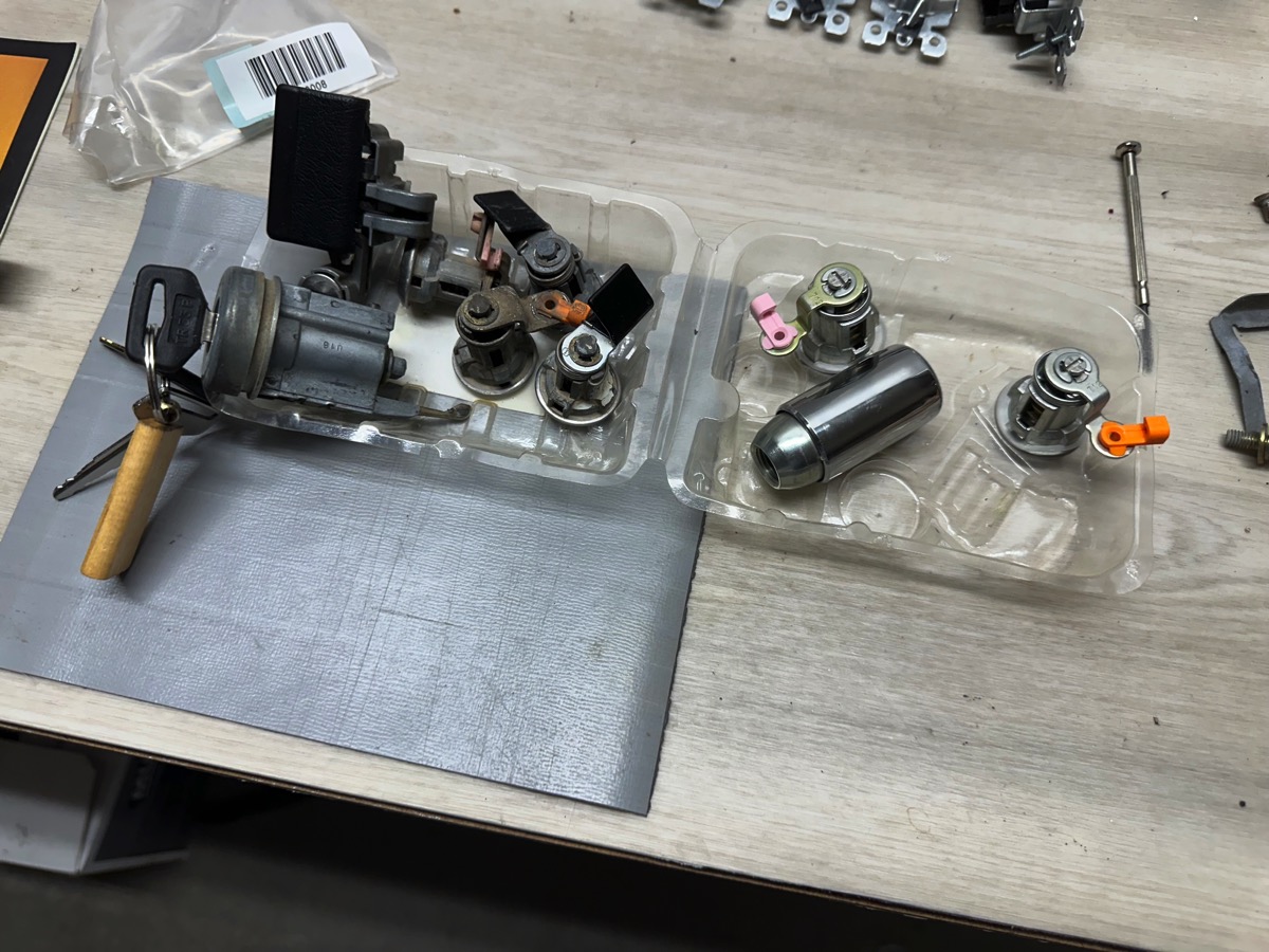

I'd snagged a complete new lockset while overseas and hoarded it for the appropriate time. This seemed like the best time to swap over.
Love the new keys.

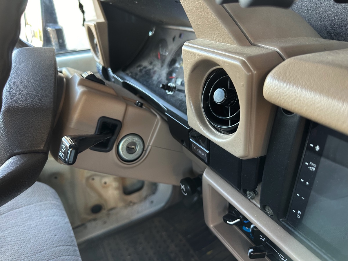

I swapped out the ignition and painted the clamshell to the match the rest of my dash.
The lockset came with everything... ignition, front doors, back door, two fuel doors, glovebox, and even a spare tire lug nut lock. Incidentally, I'll have a spare set if someone's interested. Still works but is old and dirty.

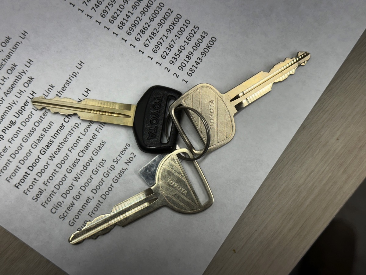

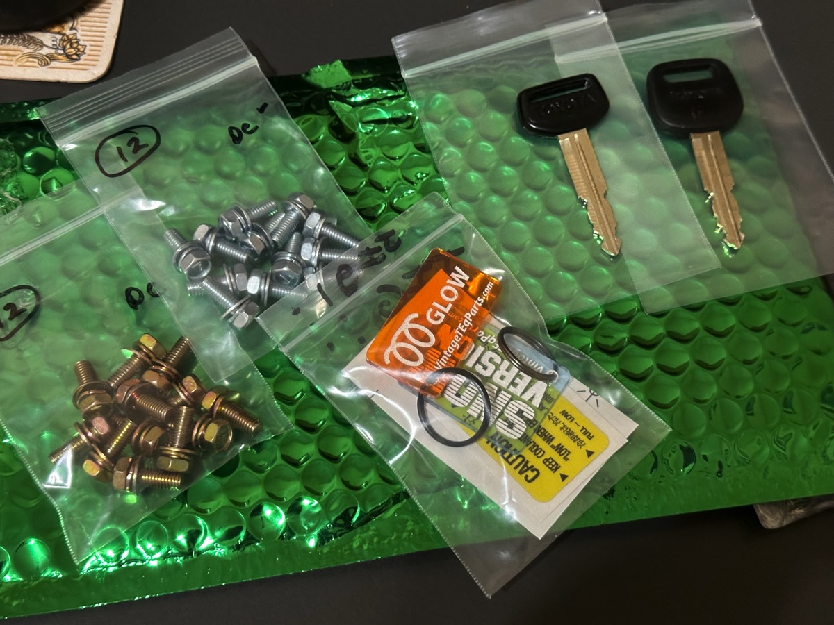

I like to have extra keys... so I reached out to @ToyotaMatt for some OEM cut keys. That guy does not disappoint and his goodie bags always include some extra treats! I just sent him a photo of the original keys and their 5-digit code... and he took care of the rest. Thanks a bunch sir!

No diesel in my future... the 3F is running just fine. The glow keychain was just a nice treat from Matt.

I've unified the dash quite a bit now... the steering wheel is in need of a color change now somehow.

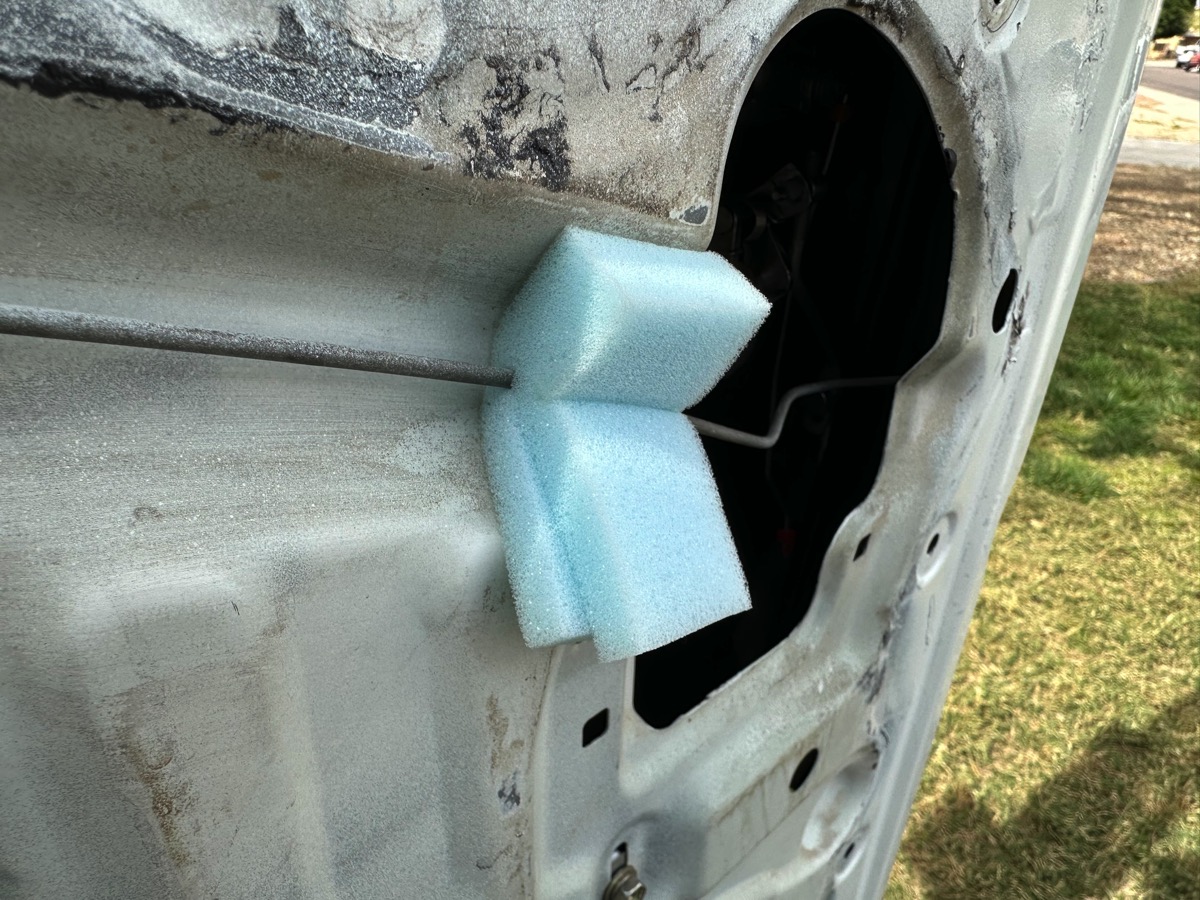

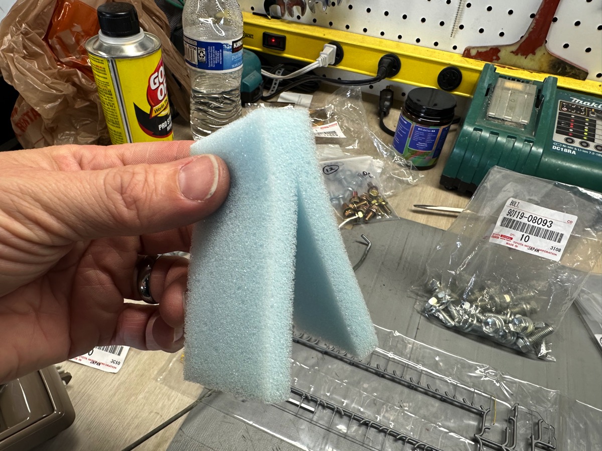

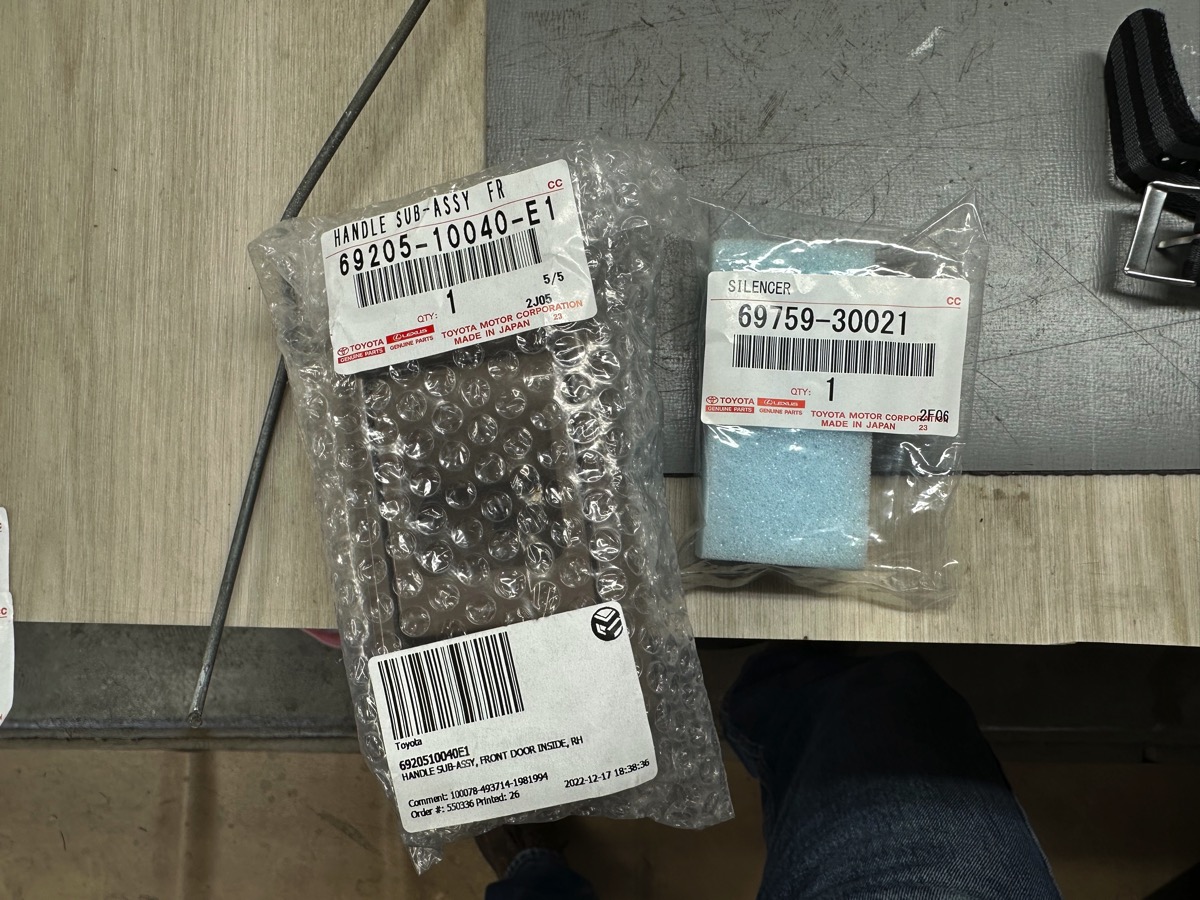

I've got the door mechanism linkage "silencer" as one of the parts for the door rebuild. I'm unsure how it is supposed to be installed. Any suggestions? @OGBeno or @SNLC or @c2dfj45 maybe... you guys get into the weeds on these types of parts too.
This is what I've come up with but I don't think it's right. It's getting pinched by the linkage which contacts the door housing.
It goes on the other end by the handle. Original location, more or less.
Edit: I think I did push those a little further to the right when I put the new ones in but before the first door card clip hole.
Thanks for this, much appreciated! So the rod does just pass inside the split portion of the foam.
Quick question... on your doors did you find the connecting rod there in contact with the door itself? See the circle below... my rod contacts the metal there and I was thinking I may need to shape/form the rod a bit to eliminate that.
Based on my photo Joel, I'm pretty sure it doesn't as there isn't any paint missing. I would honestly have to pull my door card to verify. Are those new rods? Can't remember if I replaced mine or not.
Now you have me second guessing my foam placement but on the other hand, if the rod is rubbing the door and you used the foam to prevent that, I'm pretty sure the foam wouldn't last very long. My theory on the foam is that it's to prevent the rod from rattling and not as a stand-off to prevent the rod from rubbing against the door.
Joel, when I pulled my door cards off my foam was right where @WarDamnEagle mentioned. I too have paint missing from where you've circled.
I ended up using very thin packing foam and some double sided tape and putting it in both locations. The foam should stop the rattling of the rod. So far so good, but obviously not OEM.

Sorry I'm a little late to the door party, had to dig out some photos to make sure. I have a set of pristine 2014 GR79 new take off doors that show the "silencer" in a different position. It's closer to where the connecting rod might rub, and seems to keep it from rubbing if it stays in place. It was in the same position on both doors.
That is a super-helpful image. Wow, thanks!
Out of curiosity, it's hard to tell in the photo, but where does the door handle rod pass through the plastic barrier? Is it immediately to the left of the silencer foam?
More or less in the middle of the large hole.
I thought it was immediately to the left of the silencer foam too, then saw the area @WarDamnEagle circled and now I'm unsure :hmm: I don't have a better photo showing it more clearly, but in the interest of uncovering this exciting door detail, I can dig one out and pop the panel off. Any other details you might be intersted in while I'm in there?
