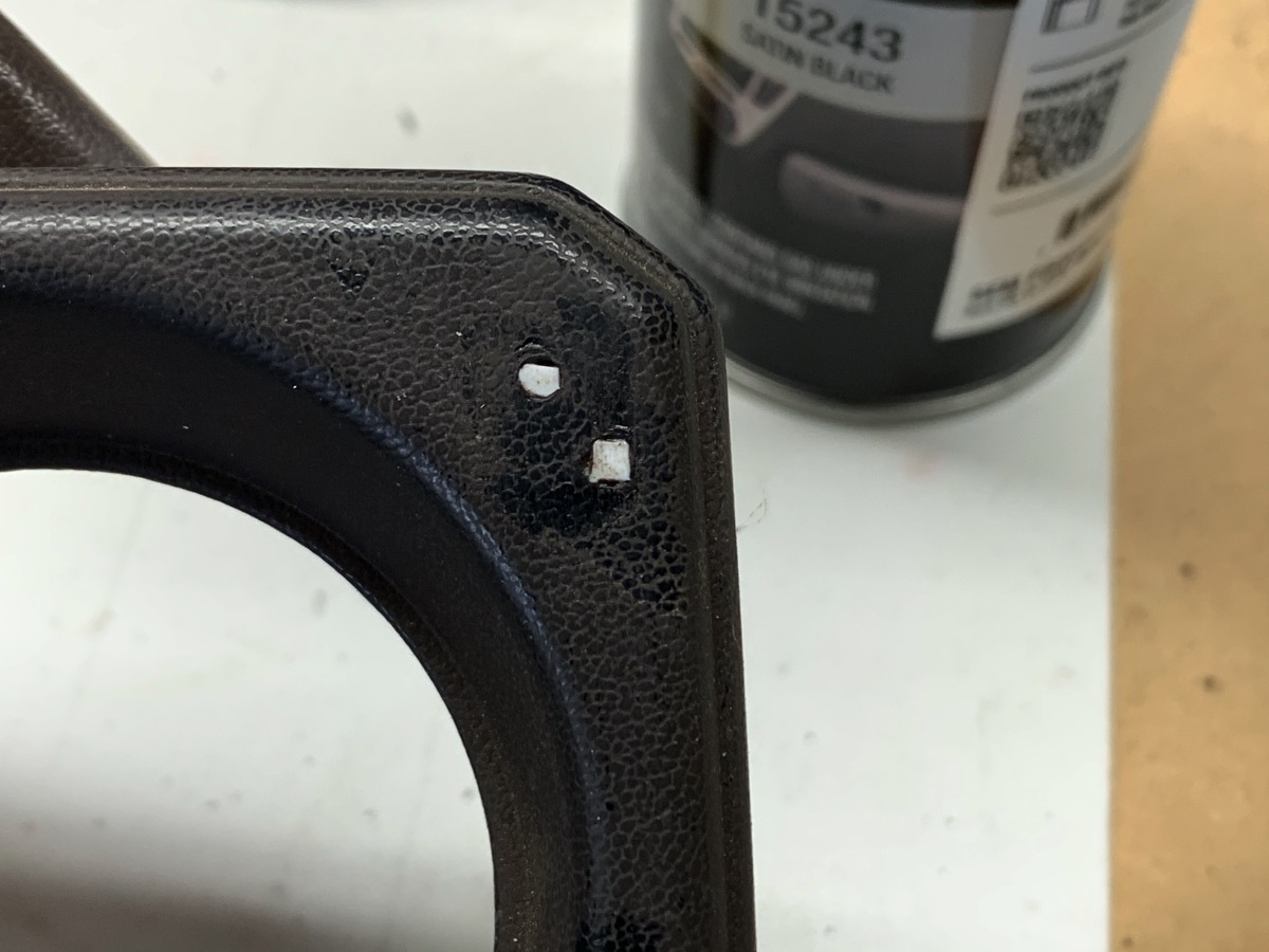

But first, there were some holes in the ABS pieces that I figured I'd patch up. Using my styrene/plastic fine scale modeling skills I didn't think I'd have too much or a problem.
Glue in some plugs of styrene stock.
Apply some Squadron putty.
Sand it smooth.
And painted (this was before a second coat of black to make this part two-tone). Sadly my repair shows through just a bit. But only from a certain angle. Otherwise it looks loads better.
