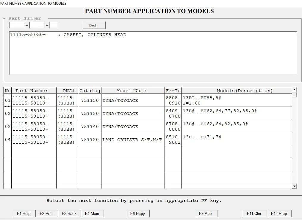

So I’m pretty sure the head gasket that’s in the kit I’m getting is composite. I would like to get an MLS one and in my research this is what I came up with.
11115-58080
Does that seem like the correct part number for oem MLS head gasket?
Hmm. I ordered 11115-58110 for my head gasket I hope I’m not wrong haha
For 13BT head gaskets are
11115-58050 - for BJ7x with 1.6 thickness
11115-58110 - for DYNA
Now the real question is what’s the difference between the two? And which may be superior to the other
Edit: it looks like 58050 turns into 58110. Don’t quote me though haha
Hmm. Now I feel like I got the wrong one
Yeah I think you got the correct one. 11115-58110 can substitute 11115-58050.
@cruiserdan does 11115-58110 seem like the correct headgasket for the 13BT?
The kit I have has a headgasket, but I don't believe it is an MLS style headgasket which is why I'd like to get an OEM one.
