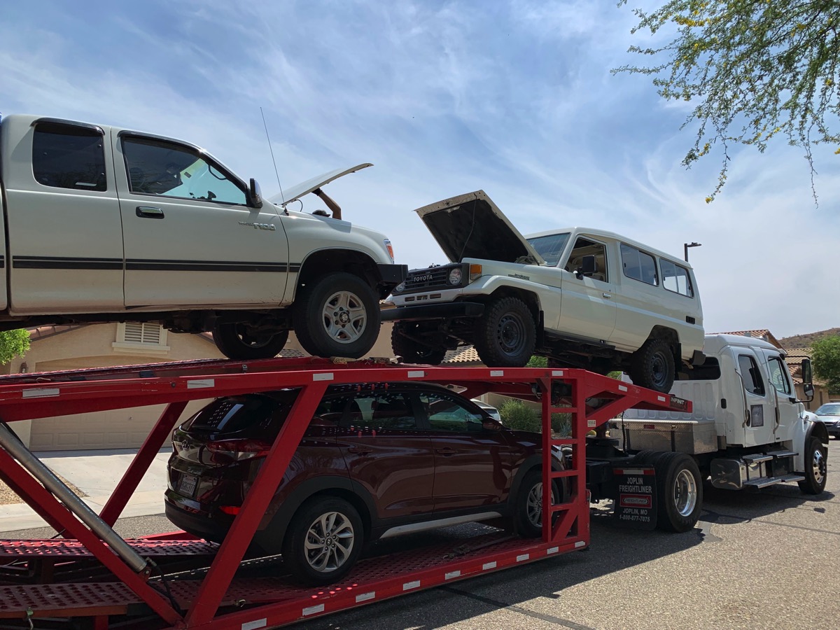

And show up they did!!!

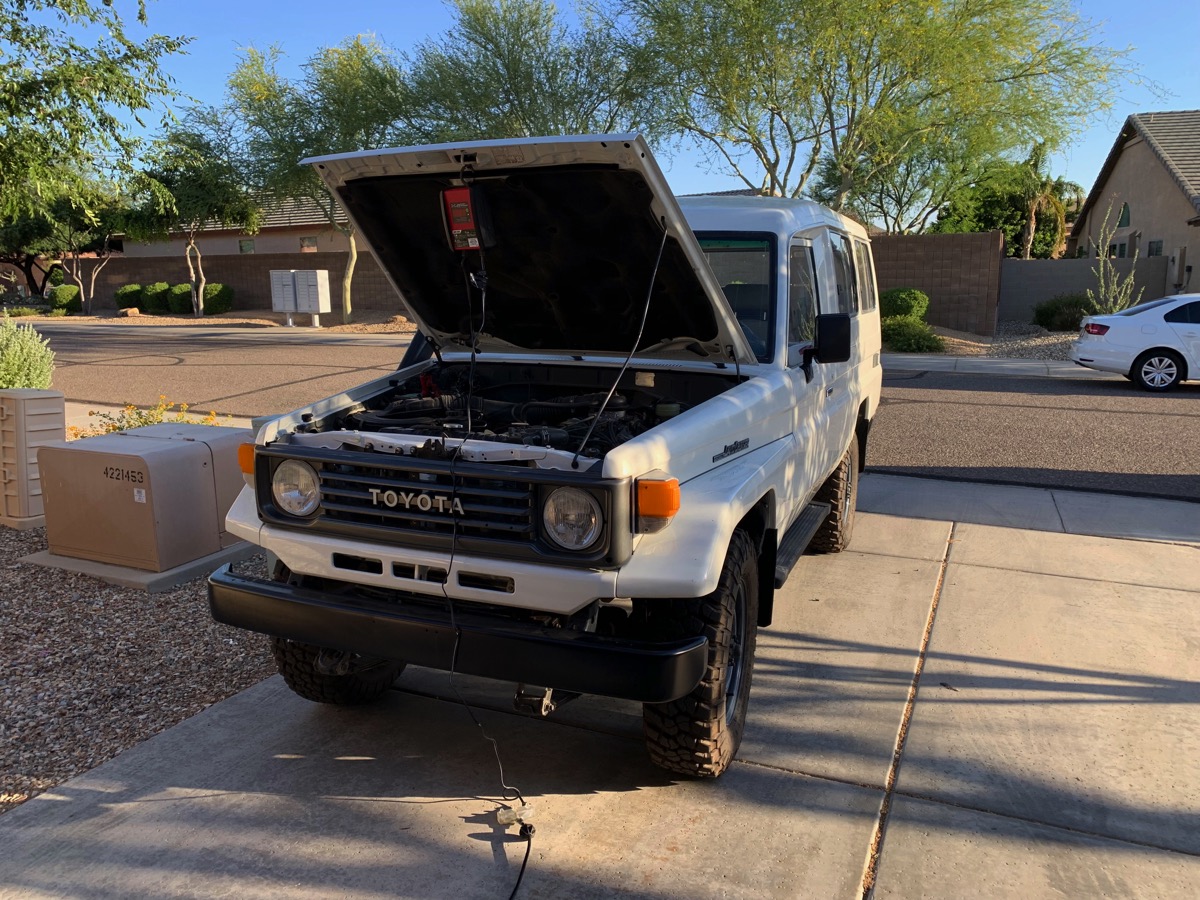

The Troopy had a dead battery and the driver ended up using my dad's T100 to do the jumpstart...
Got it on the charger.
The battery was DEAD. I also found that the ground terminal was pretty loose, so it probably wasn't getting good charge off the alternator anyway. With the battery charged and the ground fixed she fired right up. Still runs like a champ.

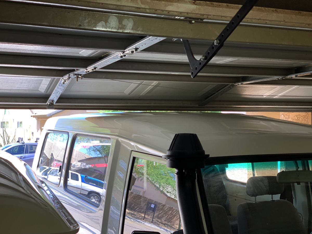

I pull the Troopy half way into the garage and determined that I can just barely get it pulled in...

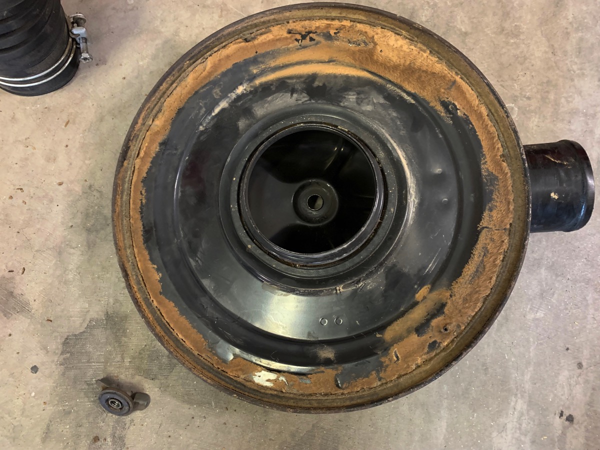

Found the inside of the air cleaner quite nasty...

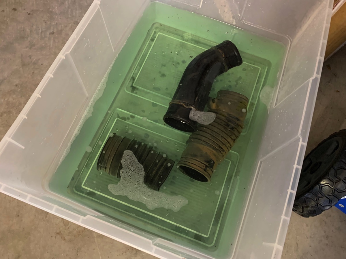

Cleaned up the intake hoses (and the lid to the air cleaner)...

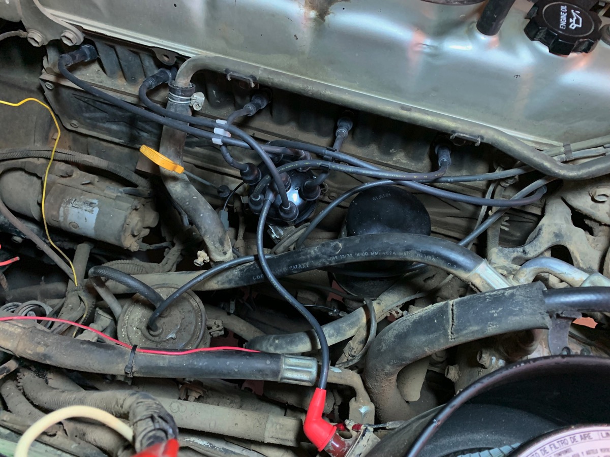

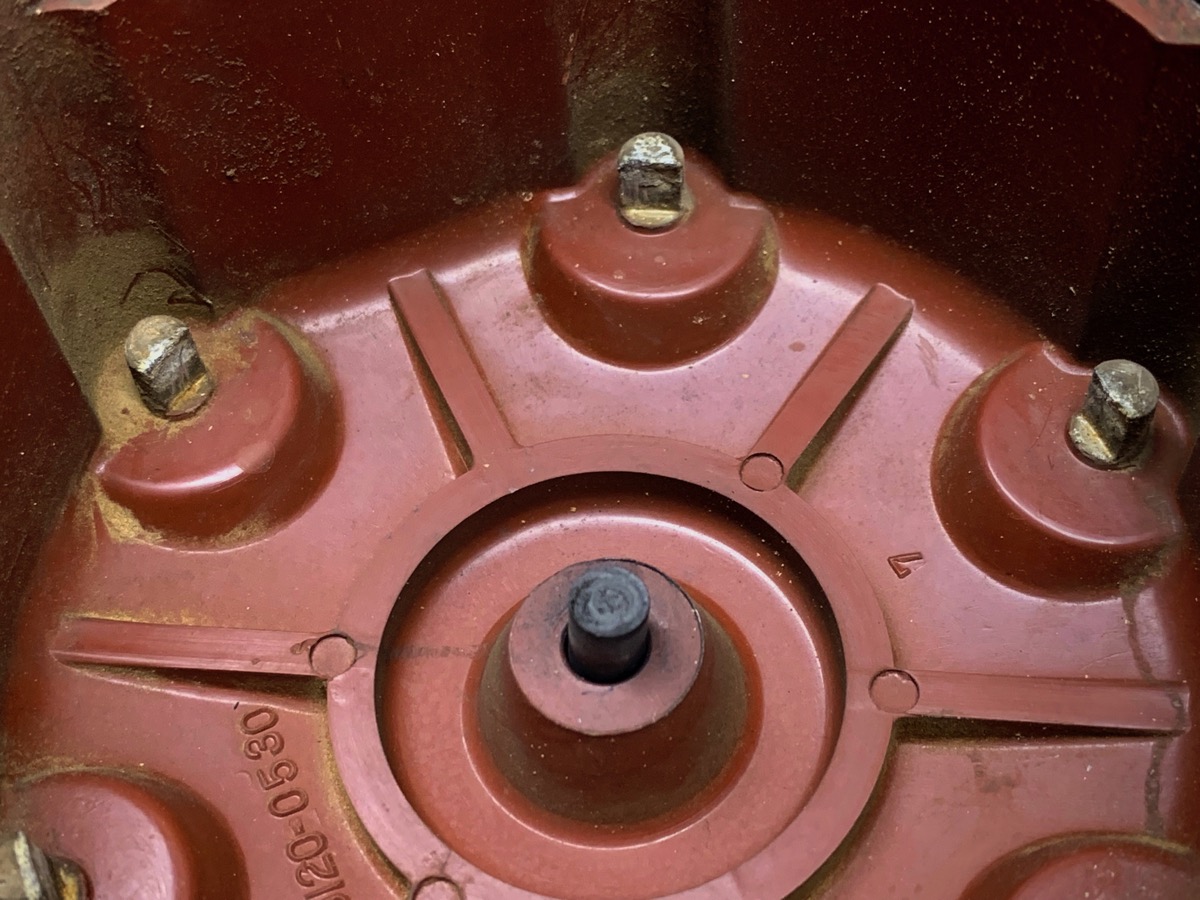

It was filthy mess down around the distributor... and I found some extraneous wires.
The old cap.

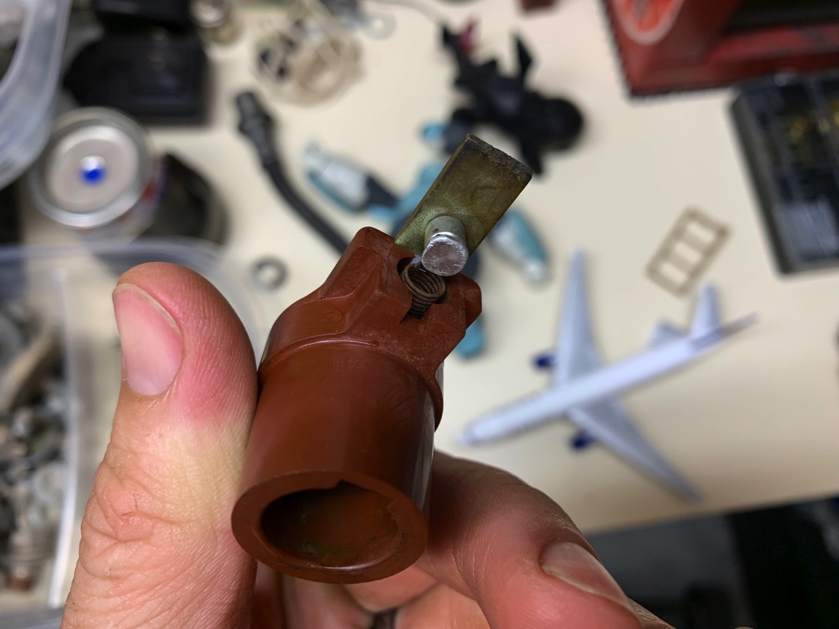

The old rotor... sadly these are no longer available. So I just cleaned it up and lightly polished the end to clean up the corrosion/pitting.

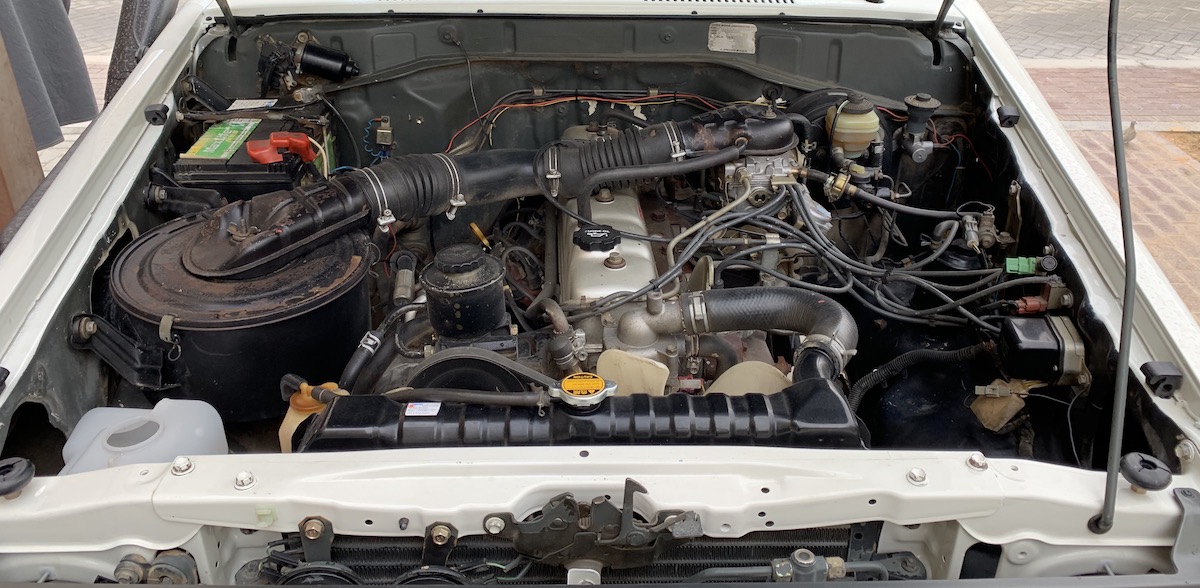

You are closer to a late 2F than a 3FE, Jim C (@FJ40Jim ) is a great resource on these carb/dizzy setups. Is all your spaghetti there ... or did it even have?
Tucker
Yeah, I do have some spaghetti... and good point on this being more like a late 2F. Hadn't thought of it that way, but this does look quite similar to a carb'd 2F from a 60-series.
I had a FJ73 with a carb'd 3F engine. Fortunately where I live, emissions testing was not required and still isn't. It would have failed badly if that was the case!! Had the same amount of "spaghetti" as you too.
