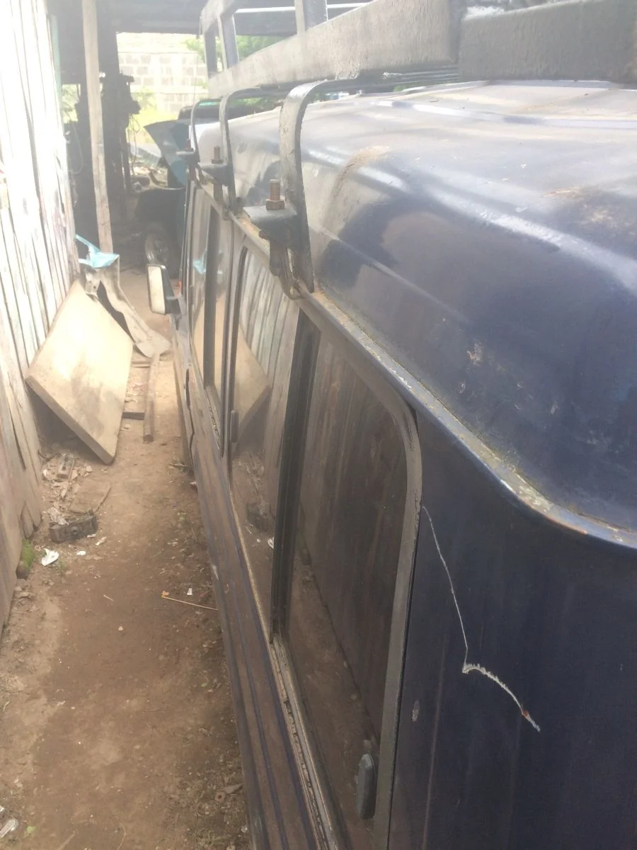

So it is really dirty like I say, sitting for three years. There is not many dents in it though, the roof has a few spots to knock out but what is most important on a Troopies roof is the gutter rails. On this truck, they look great with the factory seam sealer still looking alright. Seam sealer in other locations also looks good. Floor pans are pretty good as well. We might find a little of this or that when the body gets blasted but like I say, the biggest amount of work is in the rear floor cross-member. I am pushing to replace the entire rear cross member with a new OEM piece, if we can find it. The back doors are a bit rough as well but nothing that can't be fixed fairly easily. I couldn't find any rust in the firewall, rockers, bottom of doors, windshield frame and so forth.

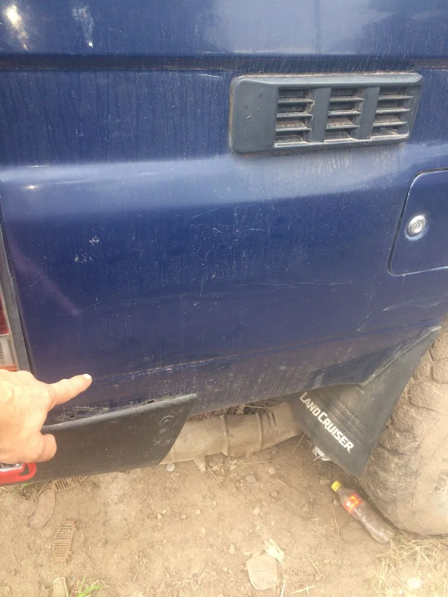

This is where I found the most bondo, very common spot for rust/rot on a 70-series. The other side doesn't have much if any bondo here so it is possible the bondo here is from a small fender bender. More like some of those young NGO workers backing into something. We will find out for sure when it gets blasted.

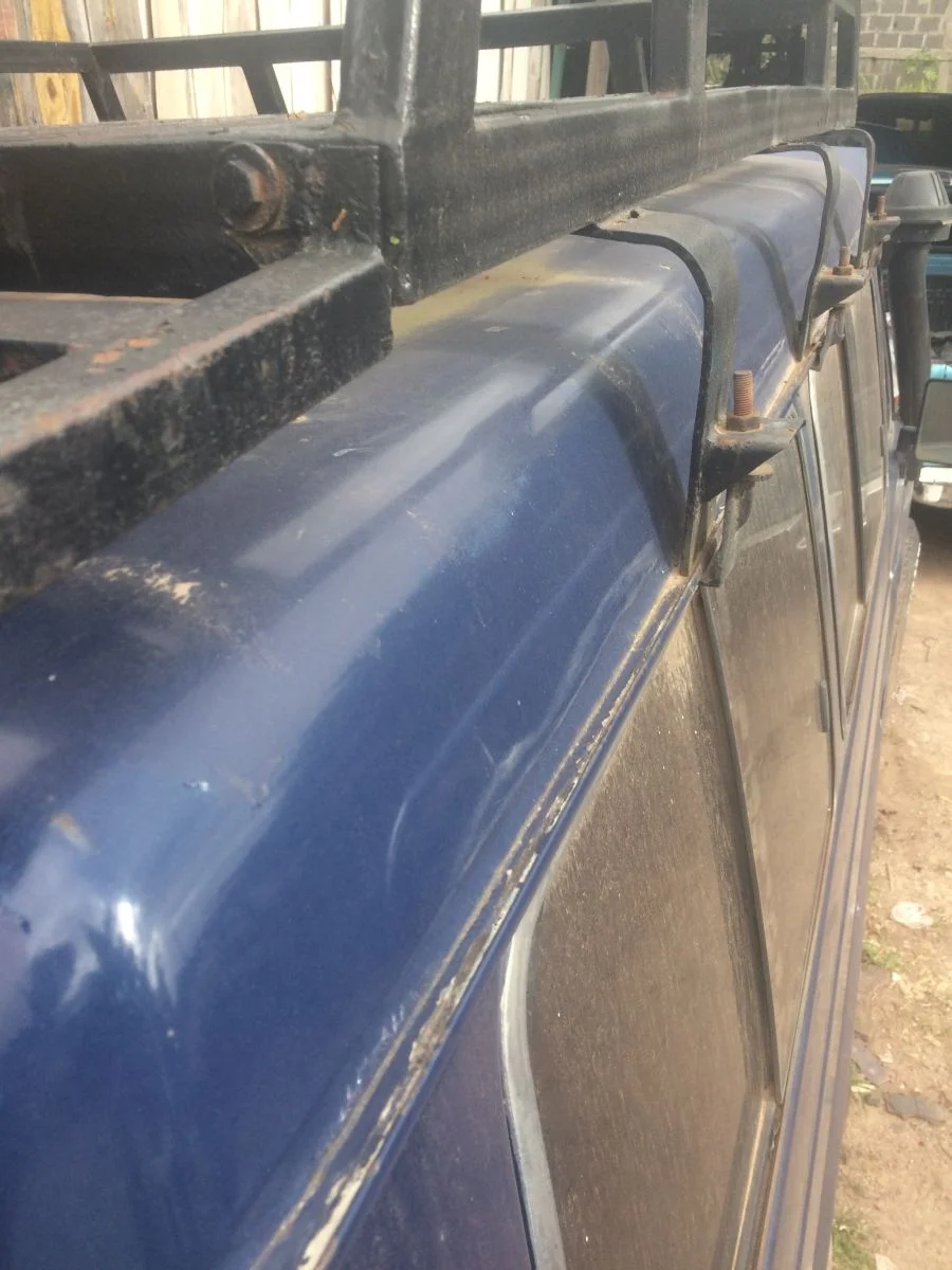

Overall, factory seam sealer is looking good on this truck.

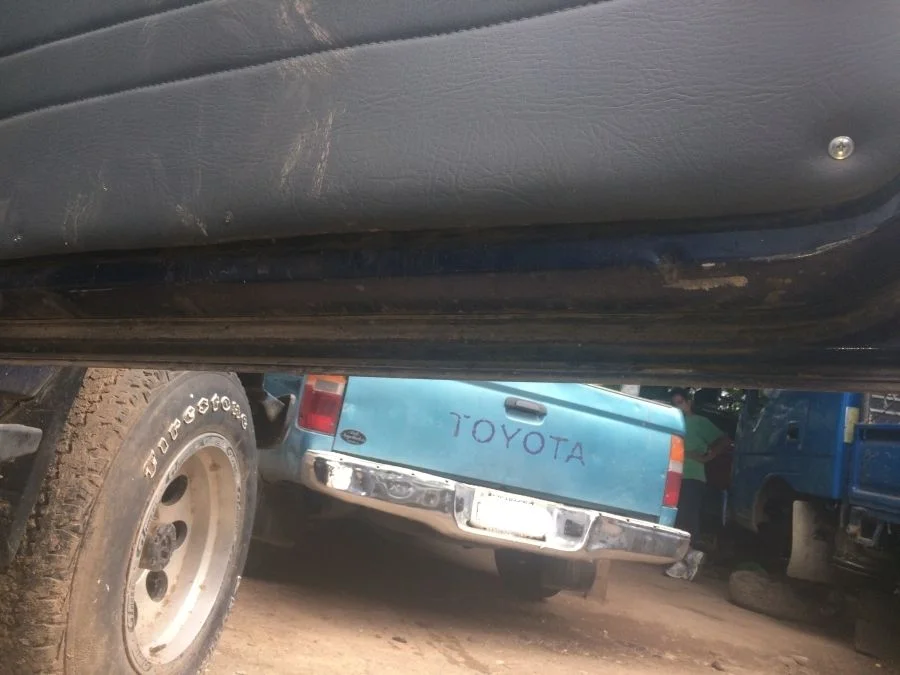

No rust/rot in the bottom of the front doors.

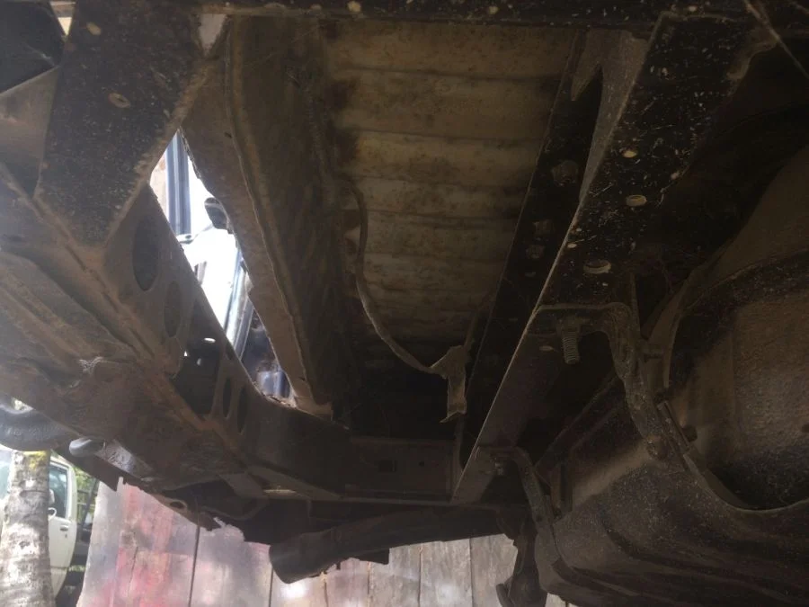

Here is the best picture of the rust creeping into the rear floor cross member. Like I say, I would like to see this body piece removed and replaced with an OEM piece. @beno

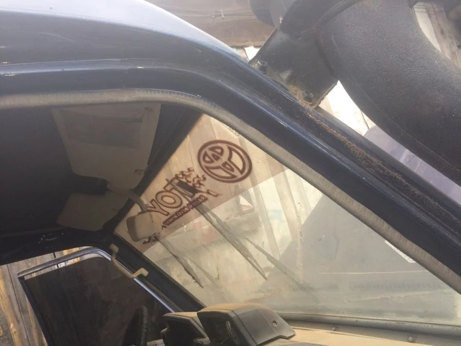

Here you can see the factory seam sealer in the roof gutter rails is looking good. Few more years of sitting though and it will start blowing out and that is when the roof goes to hell.

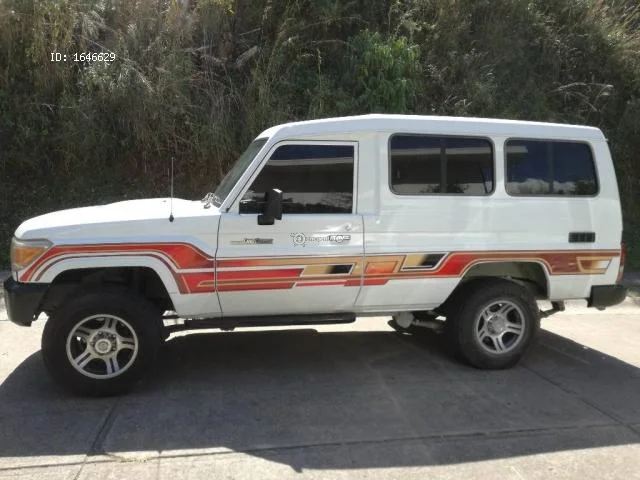

I dig it. I even like the OEM wacky 80s style stickers
Ya a lot of people dislike the side graphics. I dig them too, on all models. Personal preference.
The right bar work and sliders and tires with the right proportions for lift and it will look like a completely different truck in a very good way. My opinion of course!
