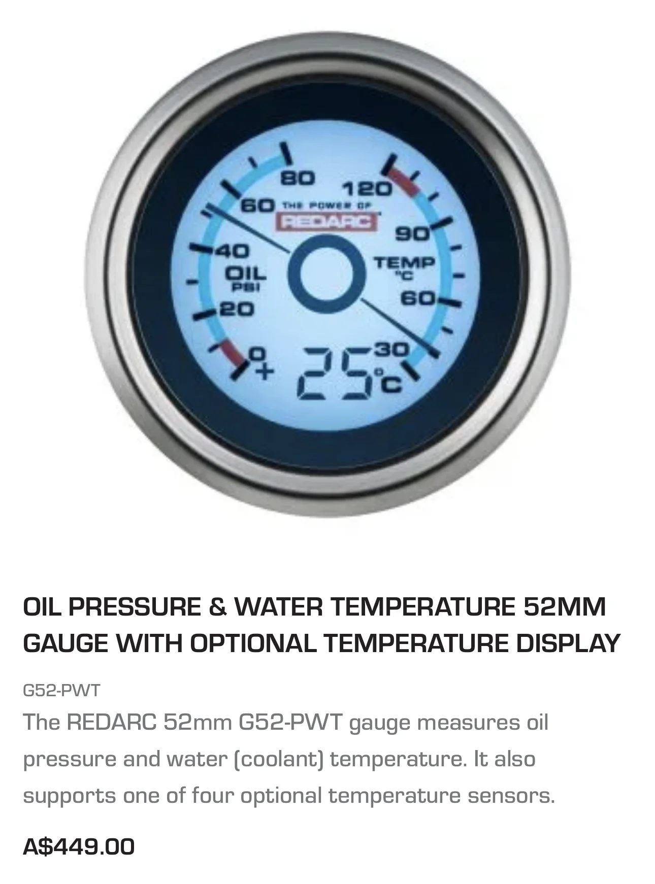

Hope you’re having a great weekend, I’m looking to get REDARC gauges for my 1991 lj78.
Just wondering which is best for this car, its fairly stock at the moment will eventually tune.
Only have room for 2 gauges, not sure if I should get the EGT that monitors beyond 800°C or just to get the one that stood at 800°C
Thanks guys

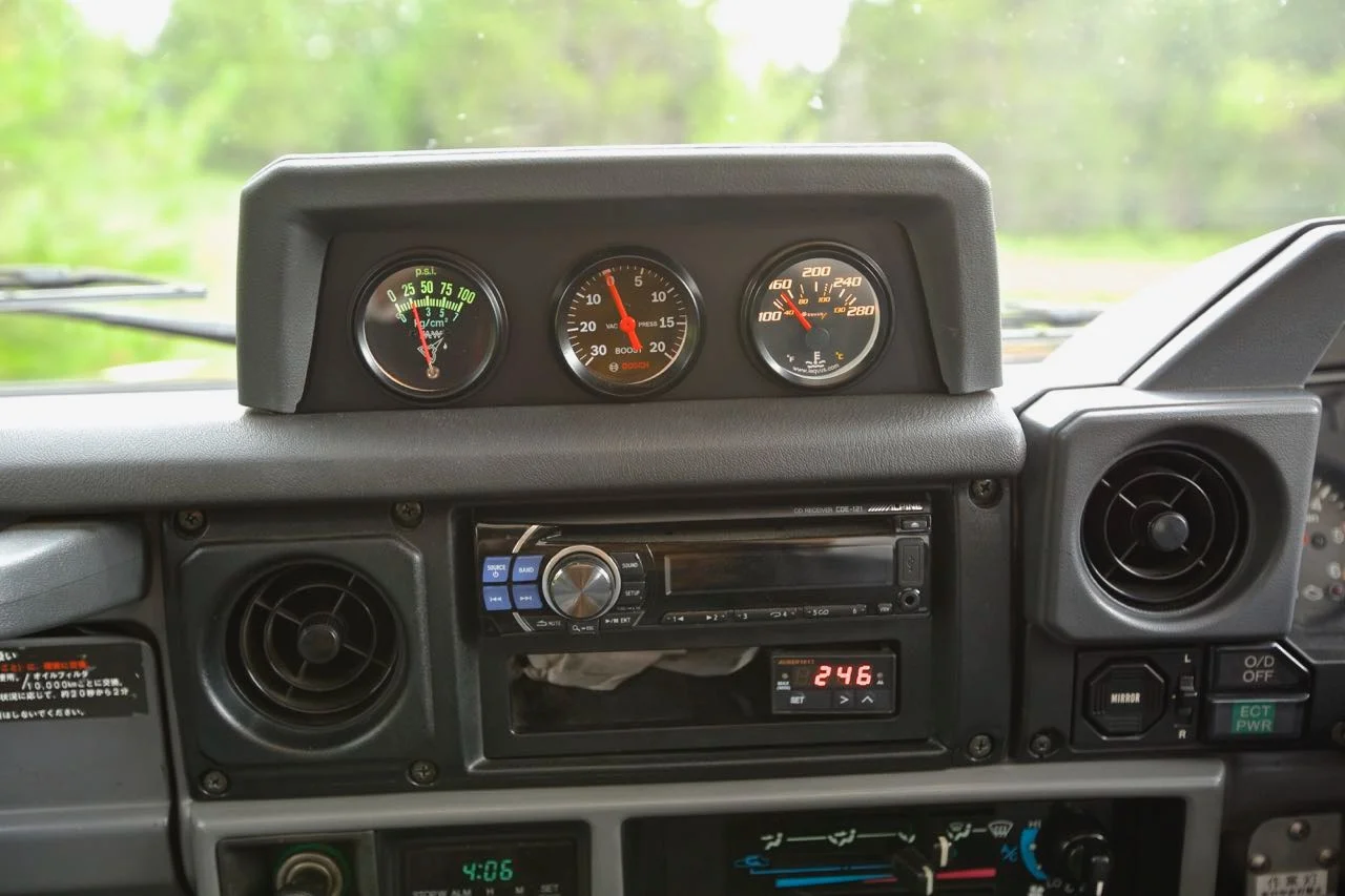

I run Red Arc boost / EGT’s & oil pressure /water temp combos. Very satisfied with them.

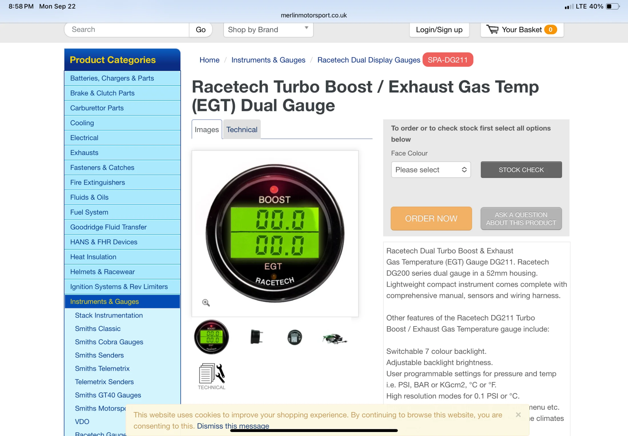

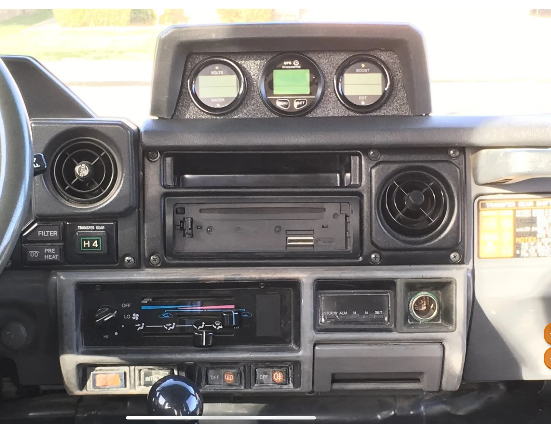

Beauty is in the eye of the beholder, but I’m partial to SPA from Merlin Motorsport out of England. SPA may have just rebranded to “RaceTech” though. Although, I’m a Yank, I prefer to read temps in Celsius and Boost in PSI. All boils down to preference, I suppose. I also prefer green backlighting.
Nice work, that looks clean, I did consider placing my gauges in the same spot but wasn’t sure if I’d regret hacking away at the oem part haha
Perhaps in the future, we’ll see haha

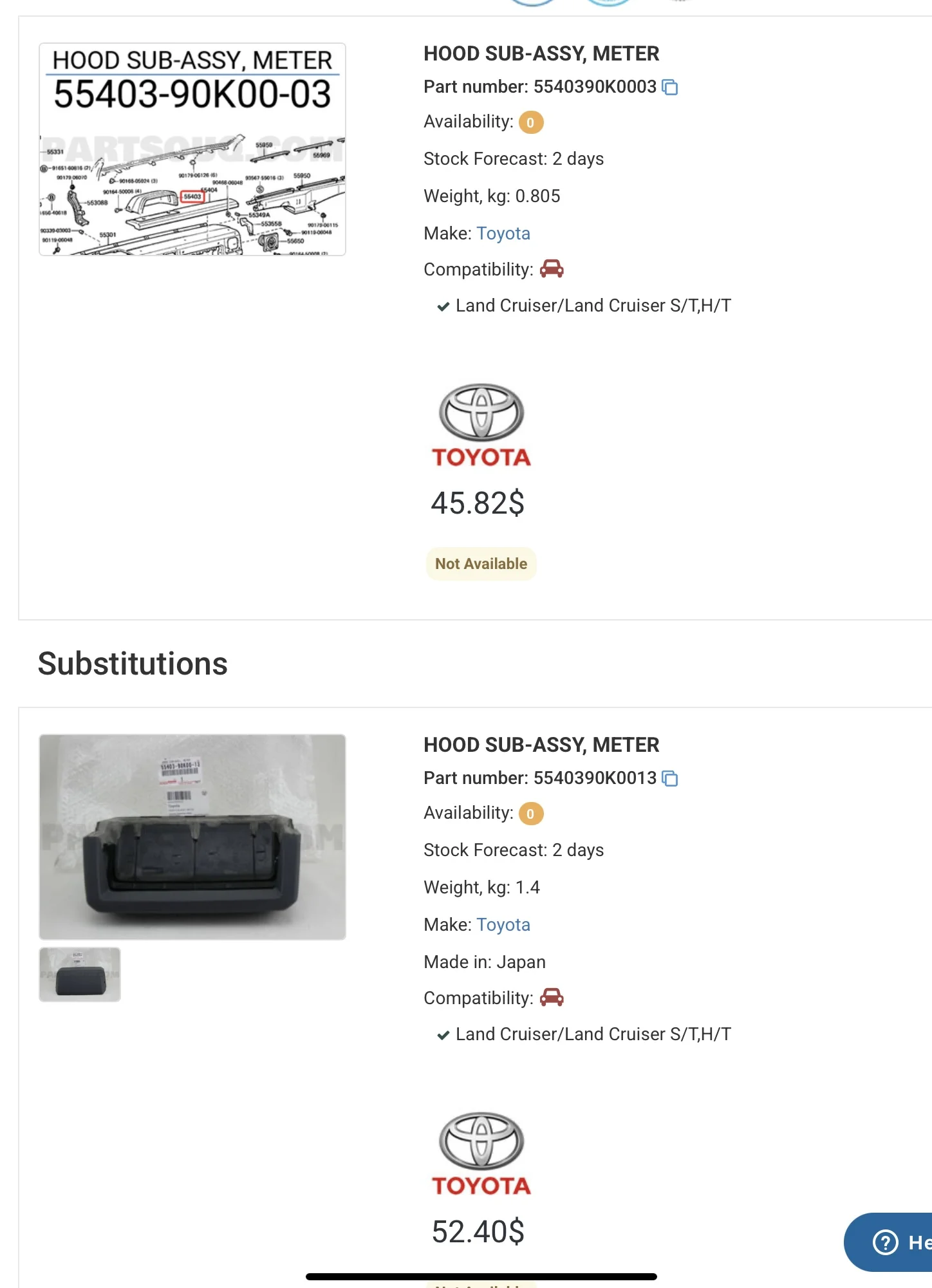

@Reedys , you really don’t have to hack anything apart. Altimeter & Inclometer pull out & apart easy enough. These are the expensive items that you pack away as a curio for future generations. If you don’t want to do that, you can buy the OEM housing / casing separately, if you prefer that route. All the wires for gauges to probes pull through existing stock holes / openings on the dash. Nothing to hack apart at all. Hun fun!

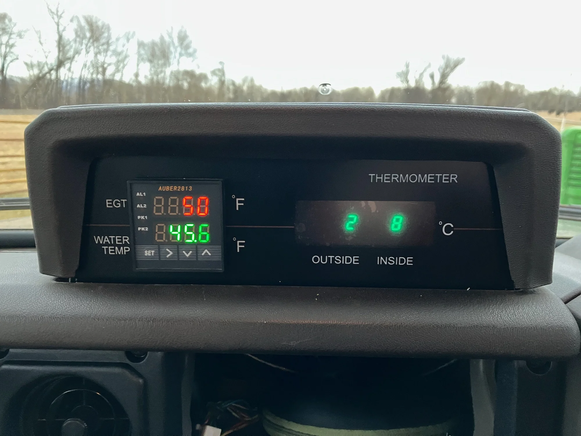

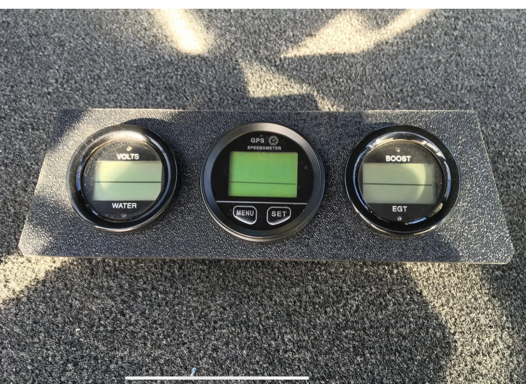

A couple examples of ones I've done. On the first one I removed the altimeter/thermometer unit completely and made an aluminum bracket to go in its place, totally reversible.
The second I retained the thermometer but removed the altimeter and cut a hole in the plastic inner housing to fit my digital Auber gauge, then made a new face plate from plexiglass and printed a sticker that mimicked the original design. At some point I'd like to redo the sticker to have a clear substrate so the thermometer window isn't cloudy, but it works ok for now.

Very cool, both look great man, well done.

@MushyPeez , Toyota actually calls the case / Housing a “Hood Sub-Assy, Meter” , who knew.
55403-90K00-03 for Gray
