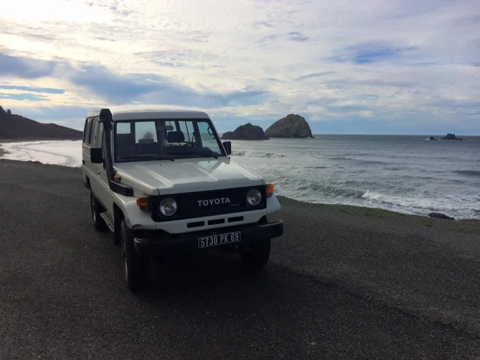

I recently purchased a 1990 BJ75 Troopy from gilmorneau. You may recall his "Tale of Two Troopies" post. He found himself in a position where he had bought two Troopies so I helped him with his "problem." ( I now have that problem as well but that will be in another post at a later date.)
The truck came from France and was a one owner in the same family. Father and son. gilmorneau picked it up in New Jersey and drove it CA where I bought it from him. The truck has a few dings and dents and a couple of spots of rust. The inside rear of the truck is somewhat ruff but has less than 100k miles.

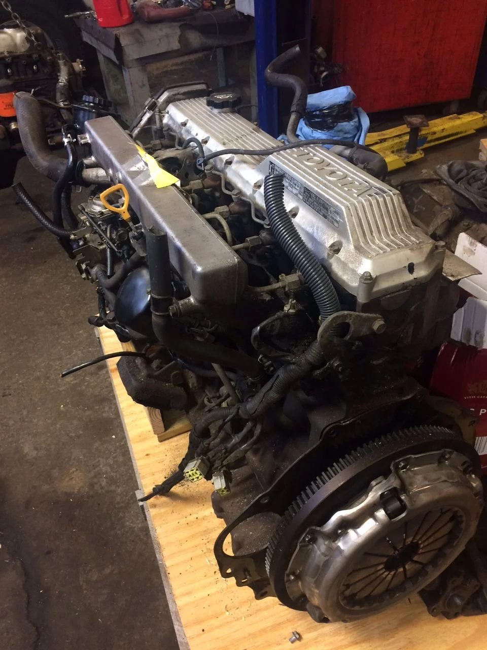

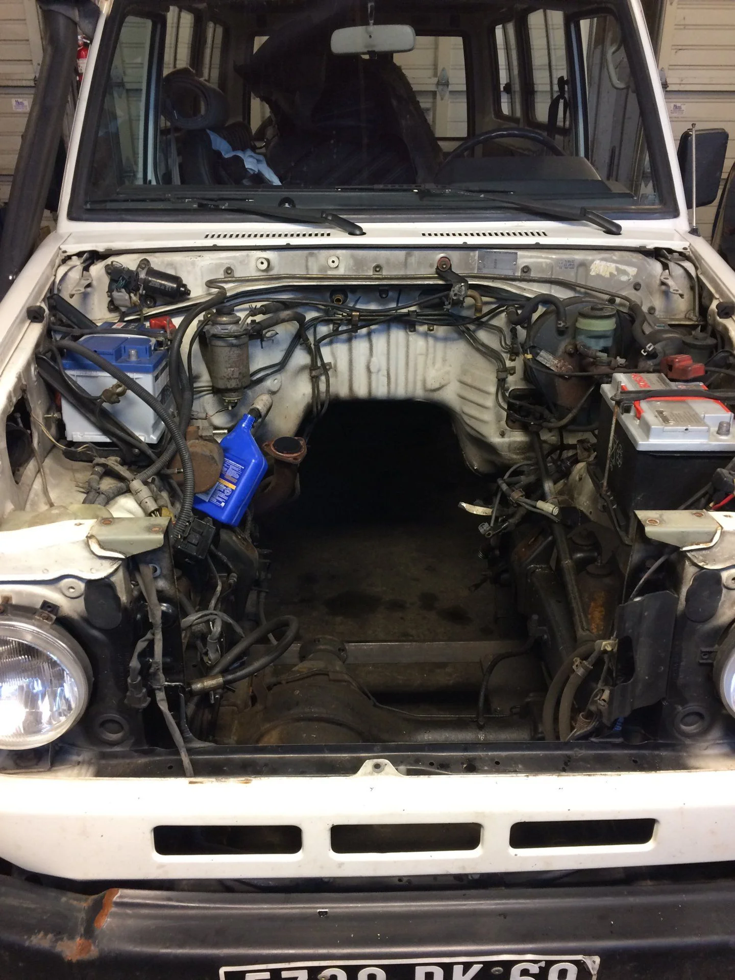

The plan now is to build out the Troopy. Currently it is sitting at Willamette Blvd Auto in Portland awaiting the engine transplant. The 3Bii is out and for sale (sold) in the Classifieds. We are currently waiting on a turbo rebuild for the 1hdt. With suggestion from mud members the engine has a new water pump, timing belt, tensioner, injectors rebuilt. BEB replaced. Cold start removed.

Looking forward to it. I haven't seen the fuel filter mounted there before. The 6 cyl engine and gearbox goes in easier by removing that valiant? panel above/behind the bumper.
Looks like a fun project and an interesting stall mate behind your truck! Glade to see more troopies in Oregon.
Dunno about the valance removal but I do know that it will be a tight fit.

Nice! you will love the 1HD. Mine just received a 1HDFT with aftermarket turbo and intercooler. Its got a ton of power. I do have the stock turbo still, not sure if it is interchangeable between 1HD-T and 1HD-FT

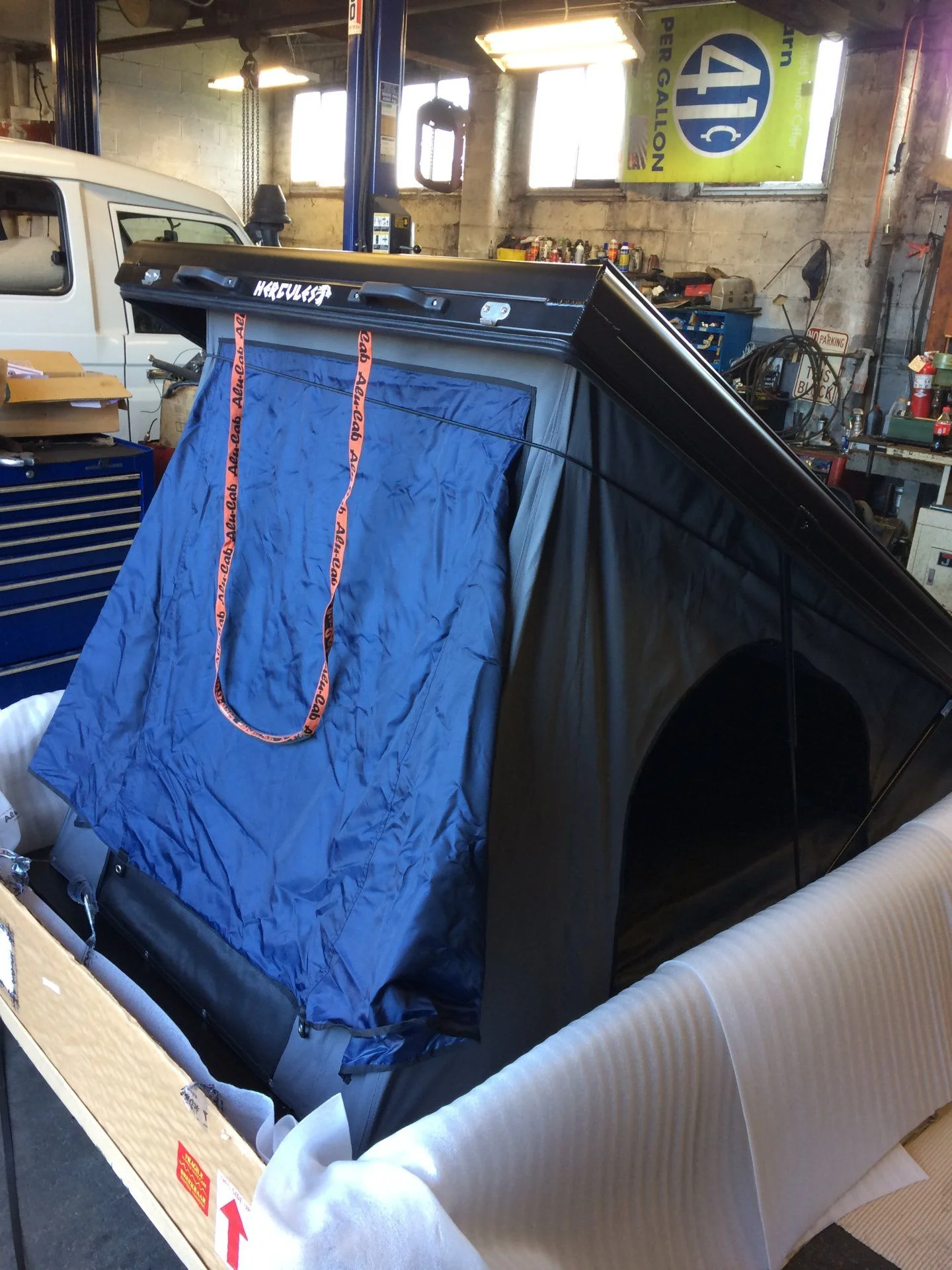

Like any good reality TV host, you have to provide suspense to your audience. The contents of this box will be revealed over the weekend. A cold Hamm's beer for the first correct guess.
If good things come in a small box this one will be a huge disappointment. Either that or off the chart.....
My guess it does this - :flipoff2:

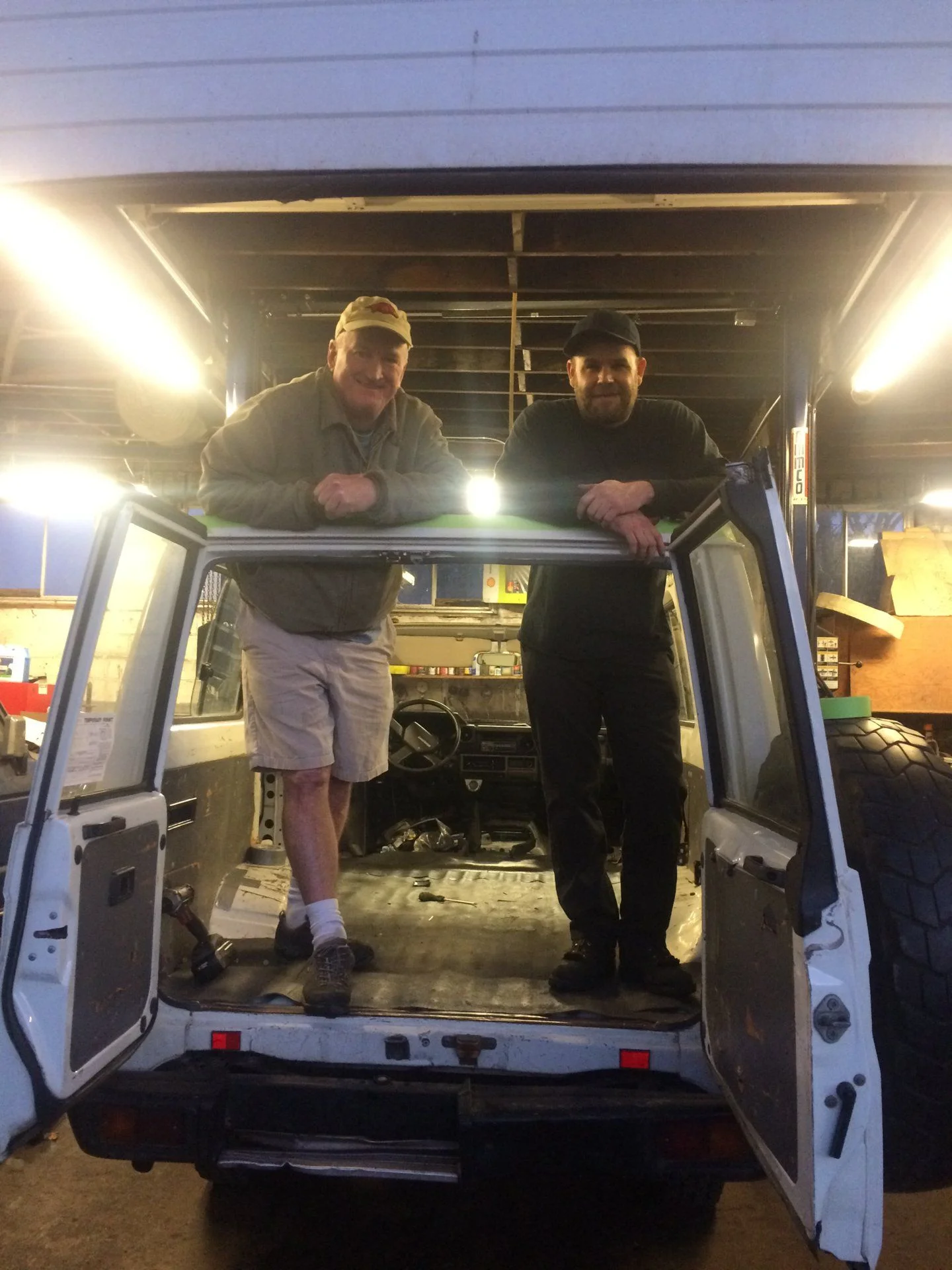

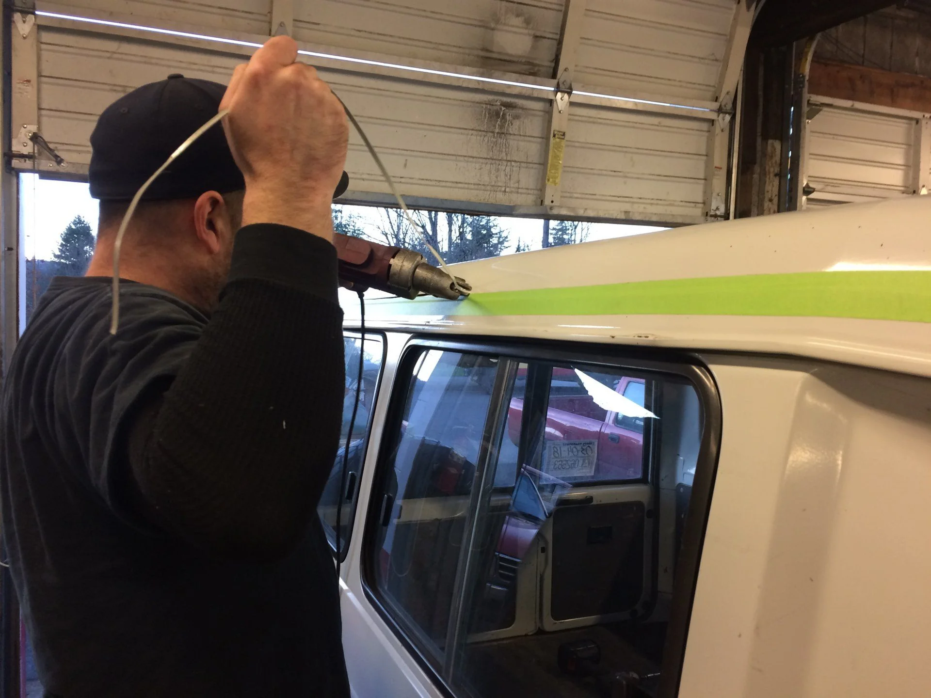

Just another day at the office cutting off the top of the troopy for the Alu Cab Hercules pop top.
