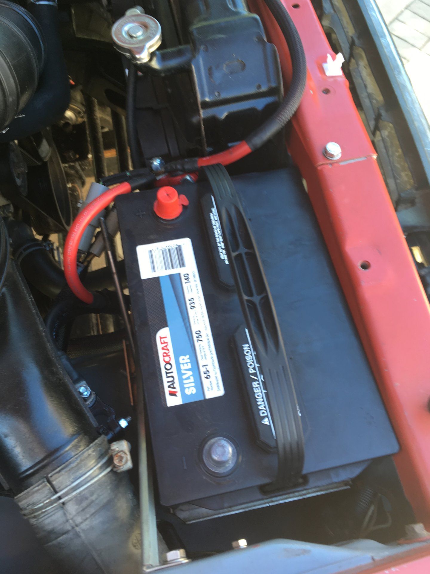

I had to put a new battery in too. 2.5 year old Yellow Optima died. Done with them. Went with a Group 65 from Advance with a coupon, nothing special, it was $100 and has a 2-year warranty. I'm going to get one of their 850CCA Gold version that has a 3-year warranty as my main battery and move this one over to the aux. side. Group 65 is really as big as you can fit in these stainless battery trays. I had to trim a bit off the hold down too.

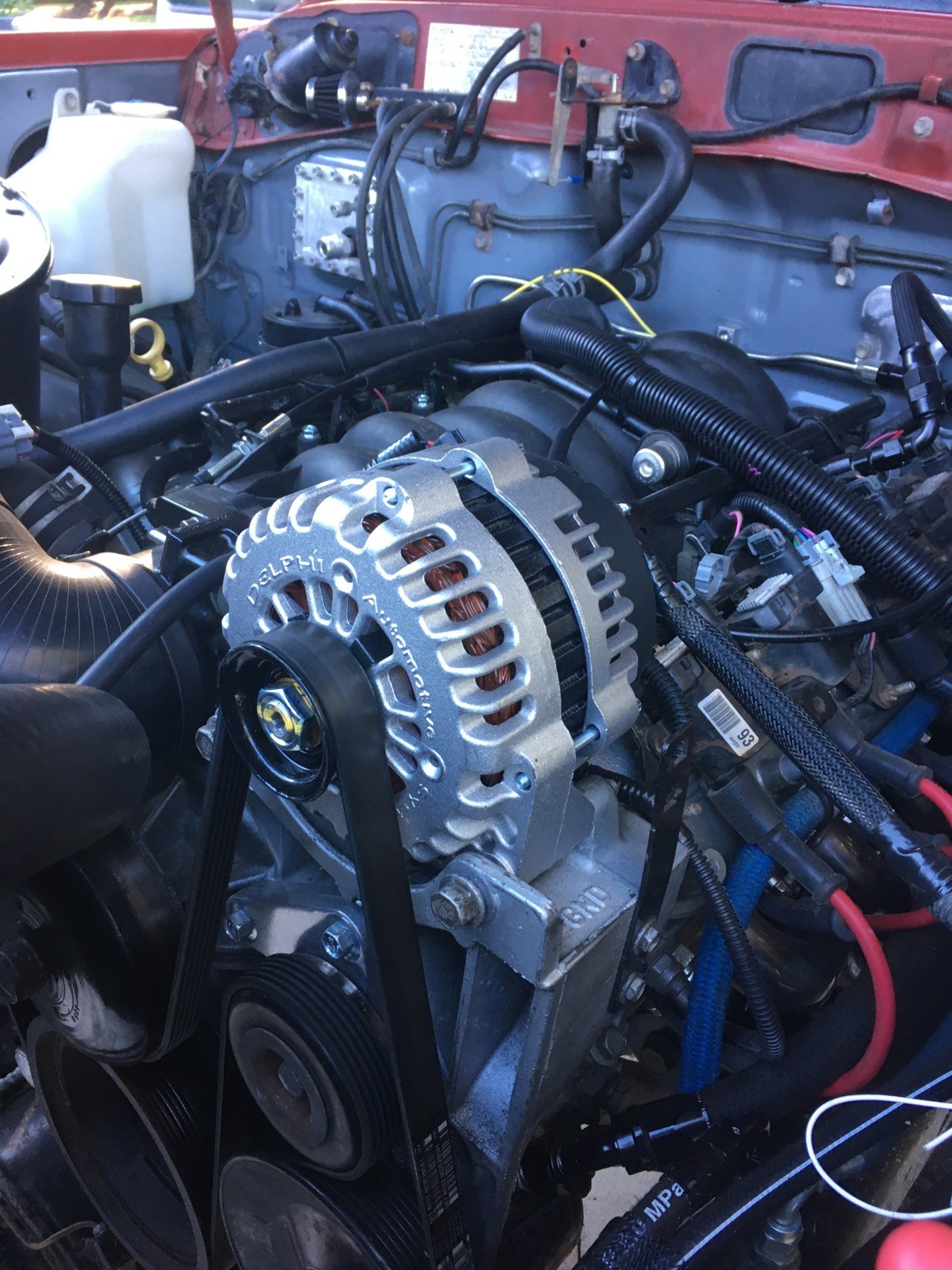

Before I found out the battery was bad I thought I had a bad alternator, turns out the one I had was fine but oh well. It was from a junkyard so who knows how old it was. Less then 2 minutes to swap the new one on.

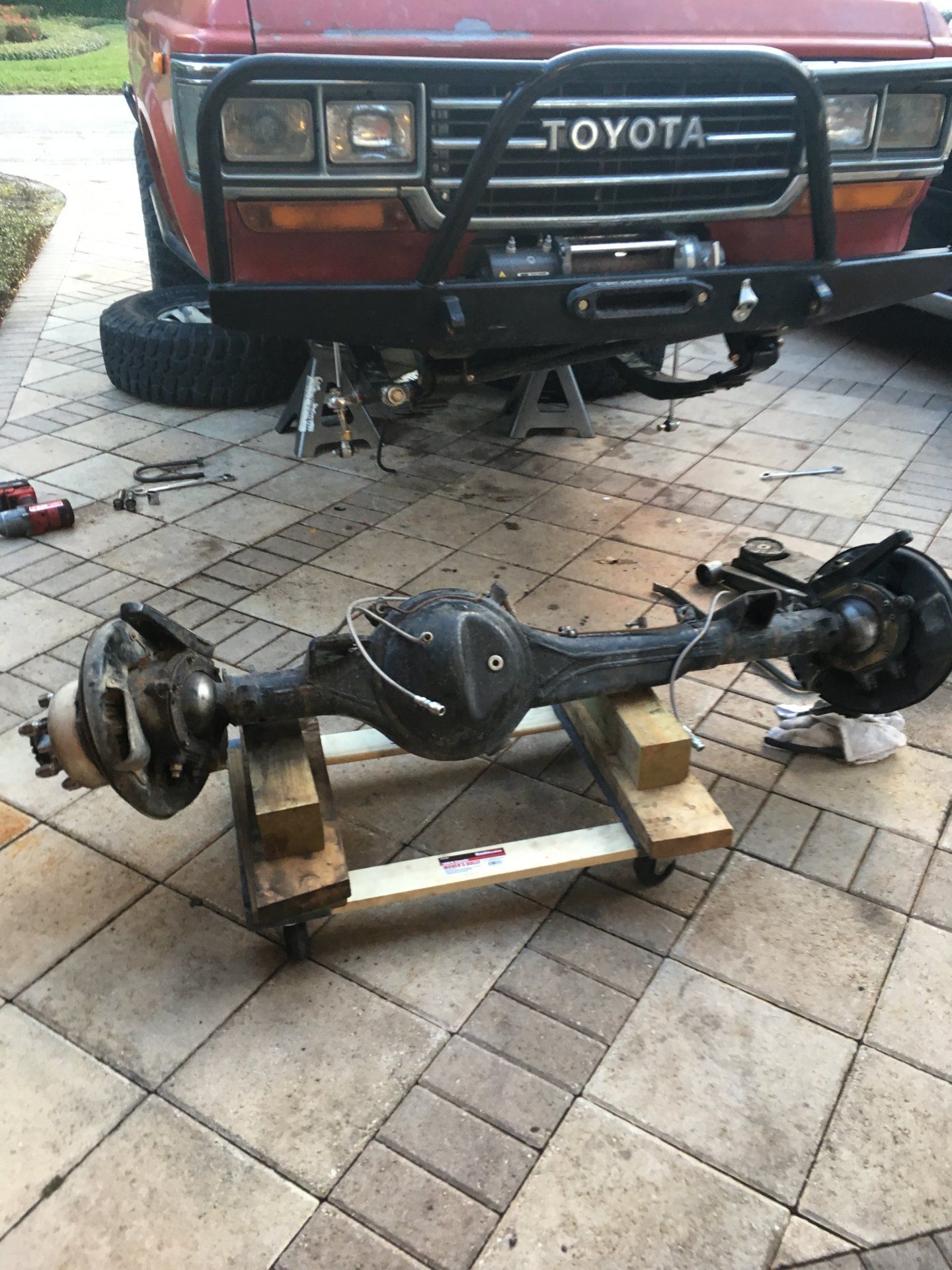

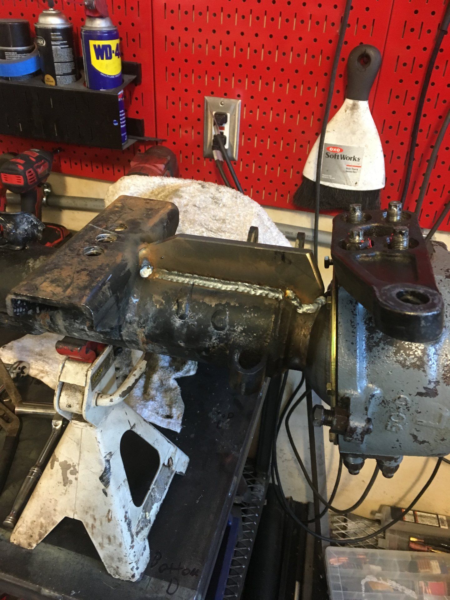

Pulled the front axle Sunday evening to tear it down for a rebuild, getting the RCV’s installed, knuckle gussets, some armor, and modifying the hubs for my ARP 7/16” bolts. I was wanted to remake the two hard brake lines on the axles since they are already rusted (got kinda scammed on what I thought was NICOP line). I love how easy it is to pull the front axle with SOA and heim joint steering. 30 minutes. No stupid tie rod taper to deal with.
I was planning on having it all back together this evening but didn’t get as much time to work on it this weekend as I would have liked.

I forgot to mention, I made the knuckle gussets myself, the ones on top are 3/8” plate and the bottom ones are cut down 1.75” tube, not as strong as the 3/8 on top but there’s no ground clearance issue.

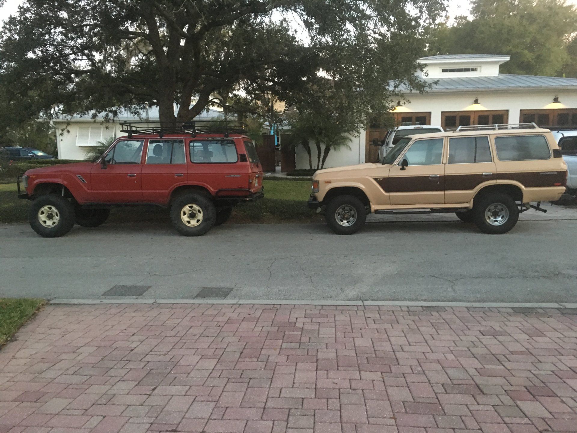

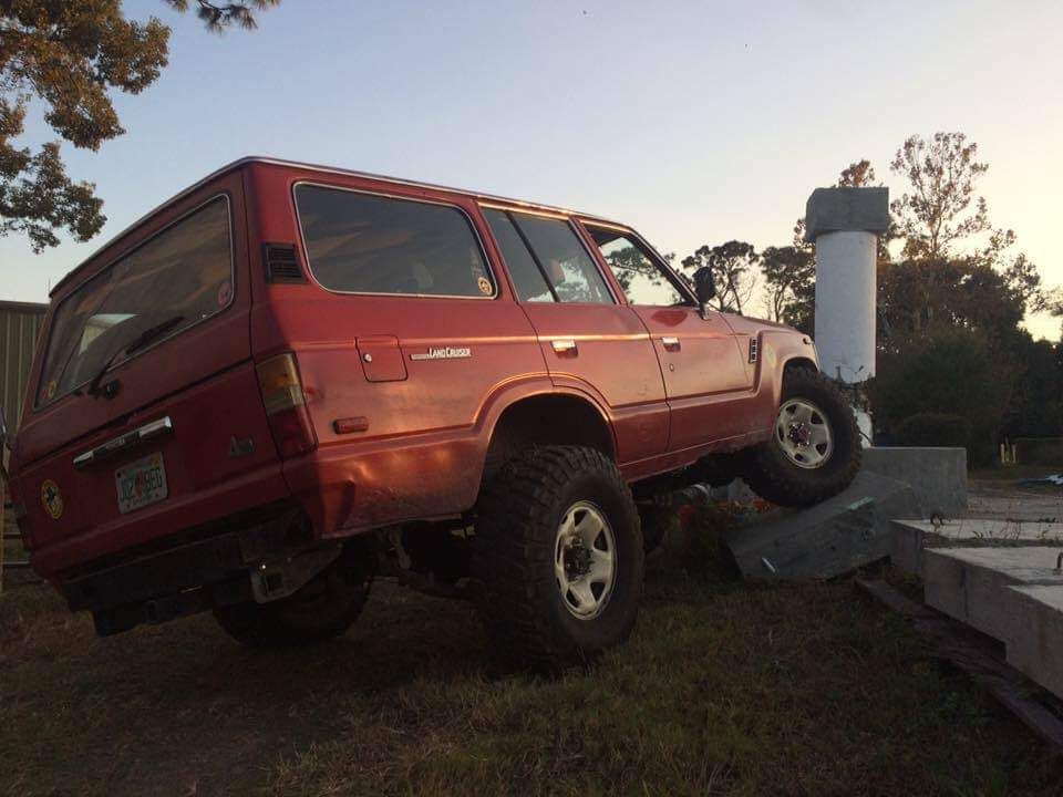

Here’s a good comparison shot of ride height difference between mine and a typical 60. The other one is running a brand new OME kit and I think 30” (pretty much stock size) tires. Also keep in mind mine is sitting about 3/4” taller front and rear then it was originally built at.
And some flex shots of course.

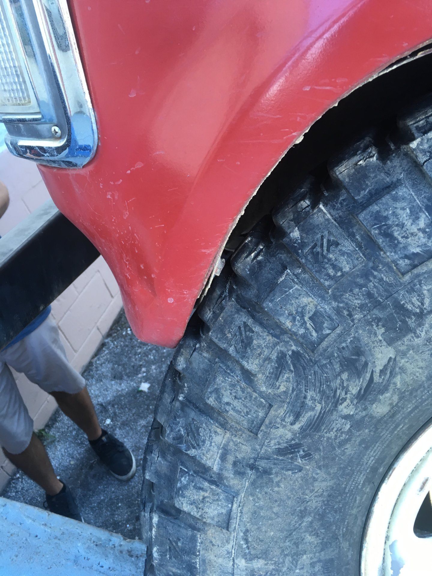

The rear does not rub at all. Here is full bump up front, actually a touch here then full bump as the spring is going into almost inverted danger zone, need longer front bump stops.
I’m sure this will rub a bit under steering but I am really happy so far.
Wheels are 16x7.5 with 5.5” BS with 2” spacers up front.
I am considering 17’s and 37’s with a wider rim for more positive scrub radius but I will probably just leave it alone for awhile.
And droop of course.
Wheel travel is about 6” up and 10-12” down.
Compare to before, same axles, wheels and tires.

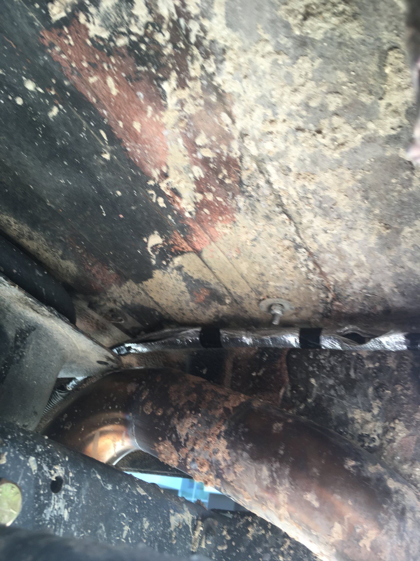

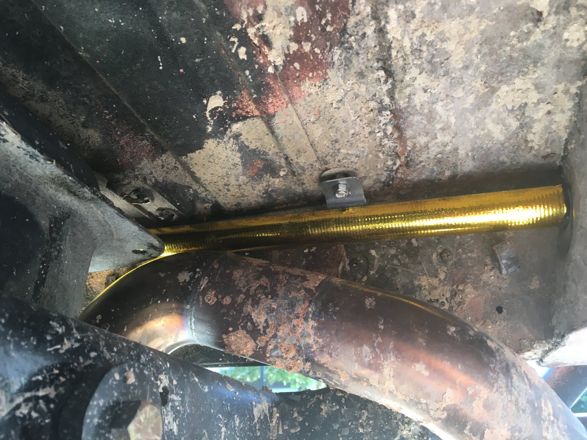

I made a nice heatshield and triple insulated that wiring so as not to have another issue.

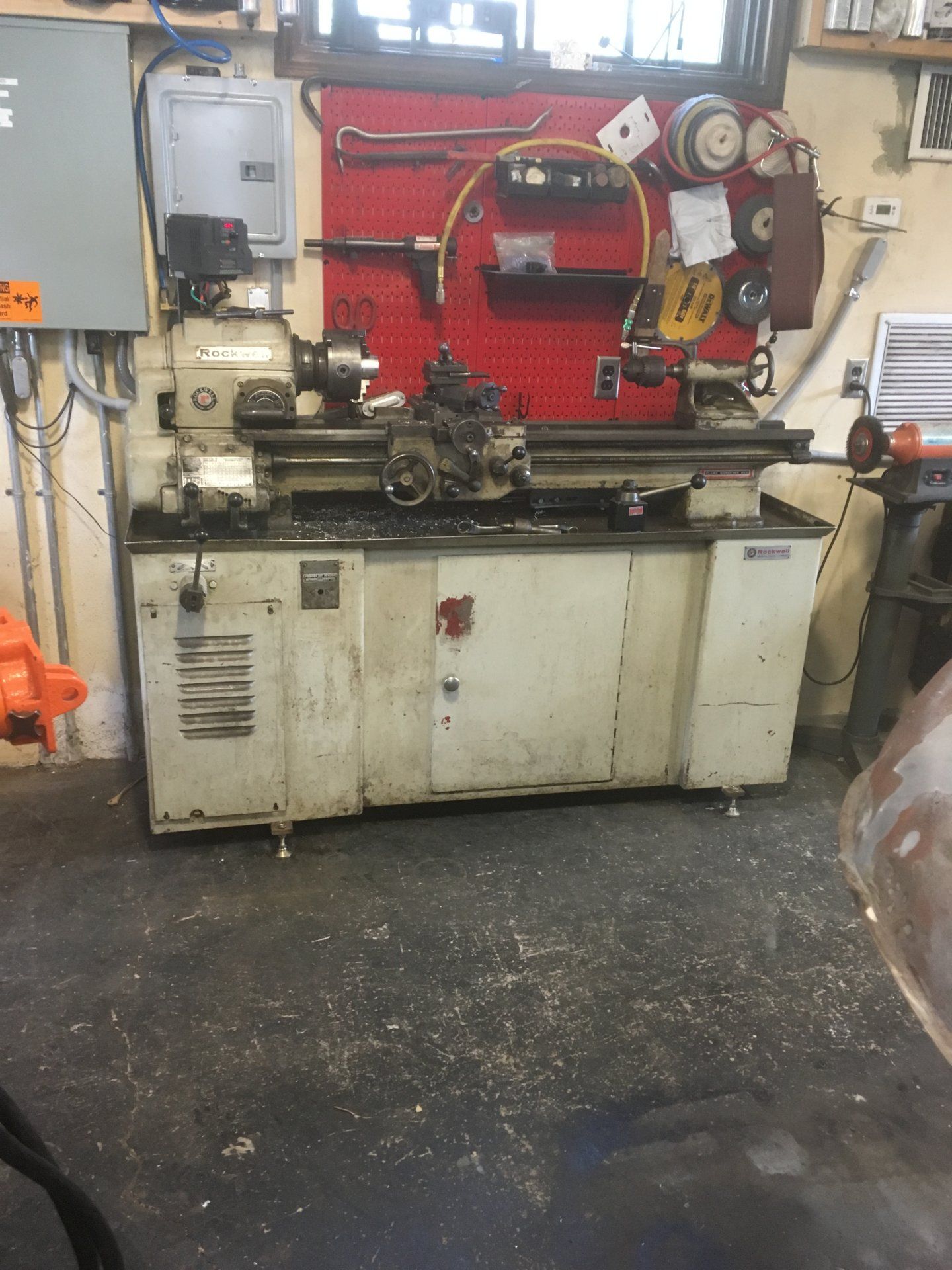

Some other fun stuff. Here’s the lathe I bought from @GLTHFJ60. It’s a 1967 Delta Rockwell 25-100. Made in the USA. It compliments my 1965 Bridgeport nicely. It has a broken compound slide and I want to install a DRO on it so there’s some work to do on it but it will be nice for when I need to do small stuff quick.
I built this quick gantry out of wood to get it out of the bed of the Super Duty myself using a chainfall from Harbor Freight.

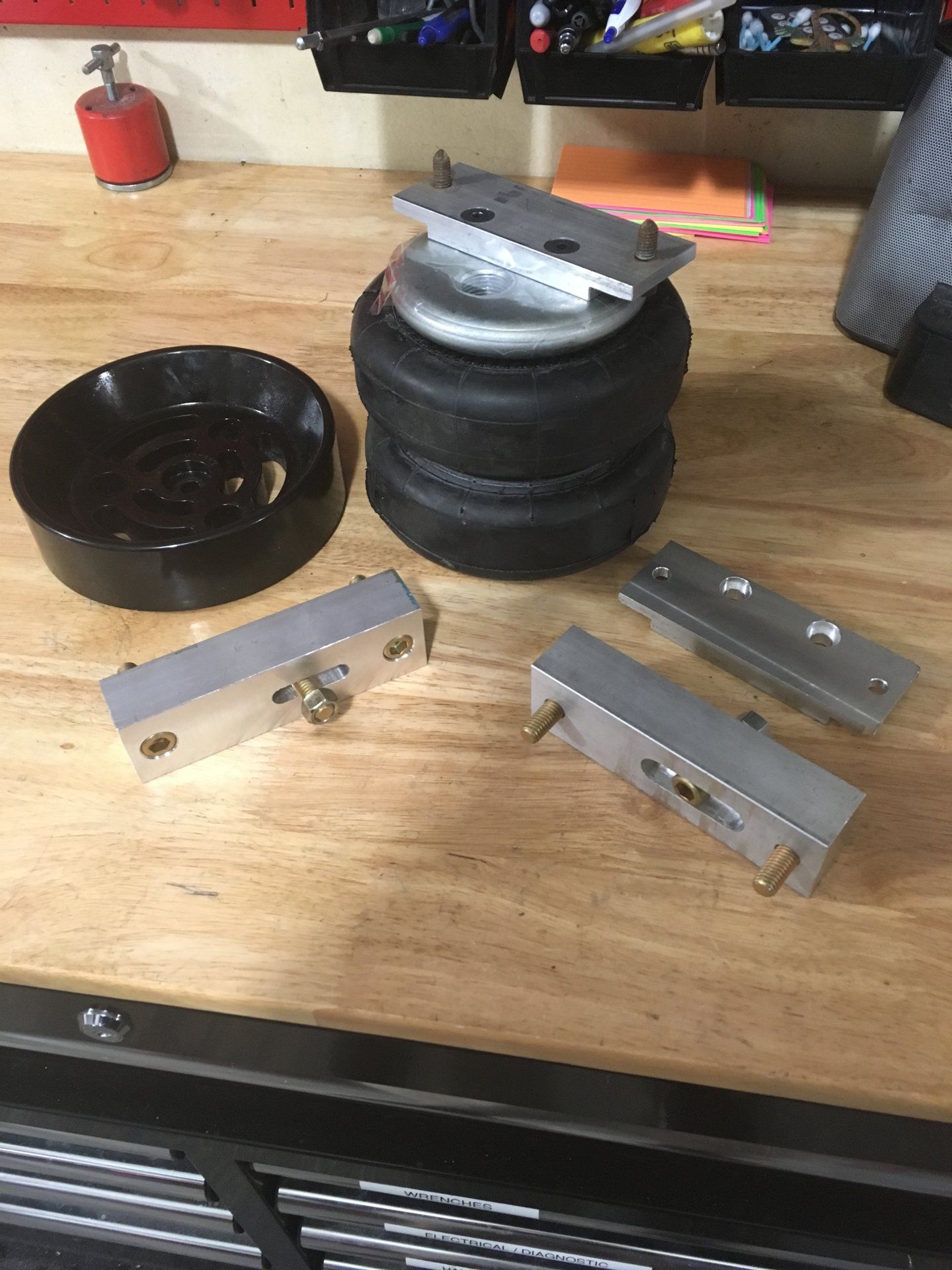

Here’s the brackets I made for my rear airbags. I bought a pair of the Daystar airbag cradles so I don’t tear the bags apart with how much travel I have.
This project will get finished after the front axle, driveshaft and 4wd shifter get finished.
