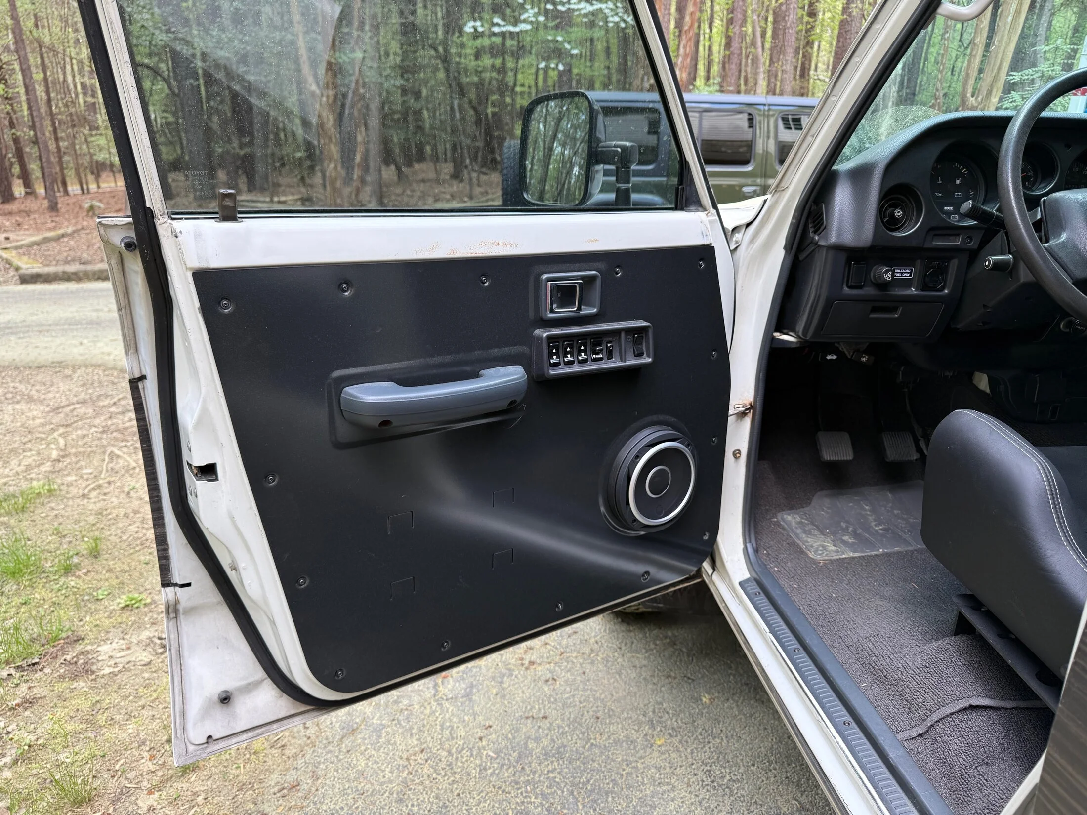

I would have been done with these panels and speakers, but I ran into A LOT of s***ty wiring. I had multiple trailer wire harnesses, multiple rats nest of stuff not there anymore and several items hard-wired instead of having actual terminal connectors. So, there was a lot of cutting, splicing, and pinning. It took a lot of time, but I think it will be worth it in the end.
Cargo Panels:
Front Seats (again):
Front Door Panels:

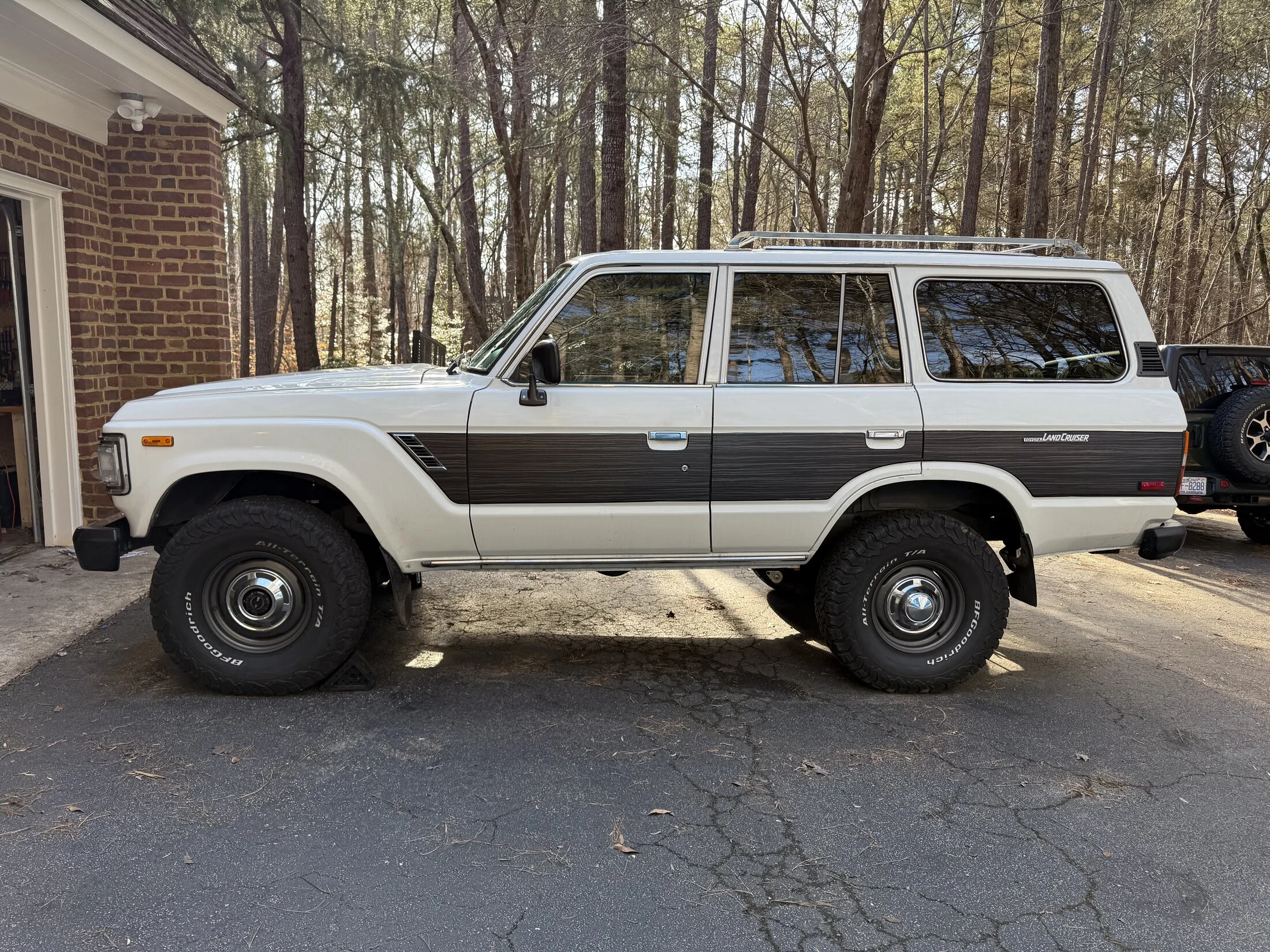

That being said I was able to get my windows tinted. I know people like the fish bowl look, but I prefer some actual tint. Did 25 in the rear, 35 in the front, and clear on the windshield. Definitely happy with the results.
