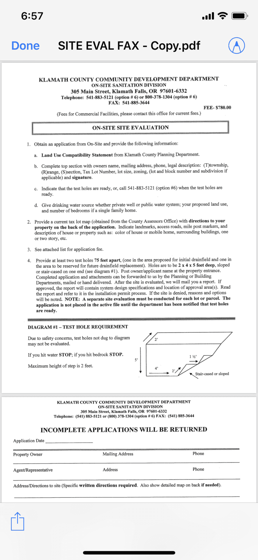

I’ve been talking to the county this week. The county doesn’t allow any building until a septic system is approved and installed. The septic evaluation and permit isn’t cheap, possibly $2400. I hope to offset this cost by installing it myself. I need to dig test holes for the evaluation so the county can see what kind of system they will allow. A good friend of mine Rob is the manager for HD Fowler in Redmond, Oregon and said I could get his employee discount. This should help keep my cost down as well as having the trackhoe and work that I love. I’d like to get started on fencing the property as soon as possible too. After the septic is installed then building can start and electrical service can be installed. It’s going to be awesome. All aspects of work that I really enjoy. This should be a lot of fun and a great place to get away from it all.

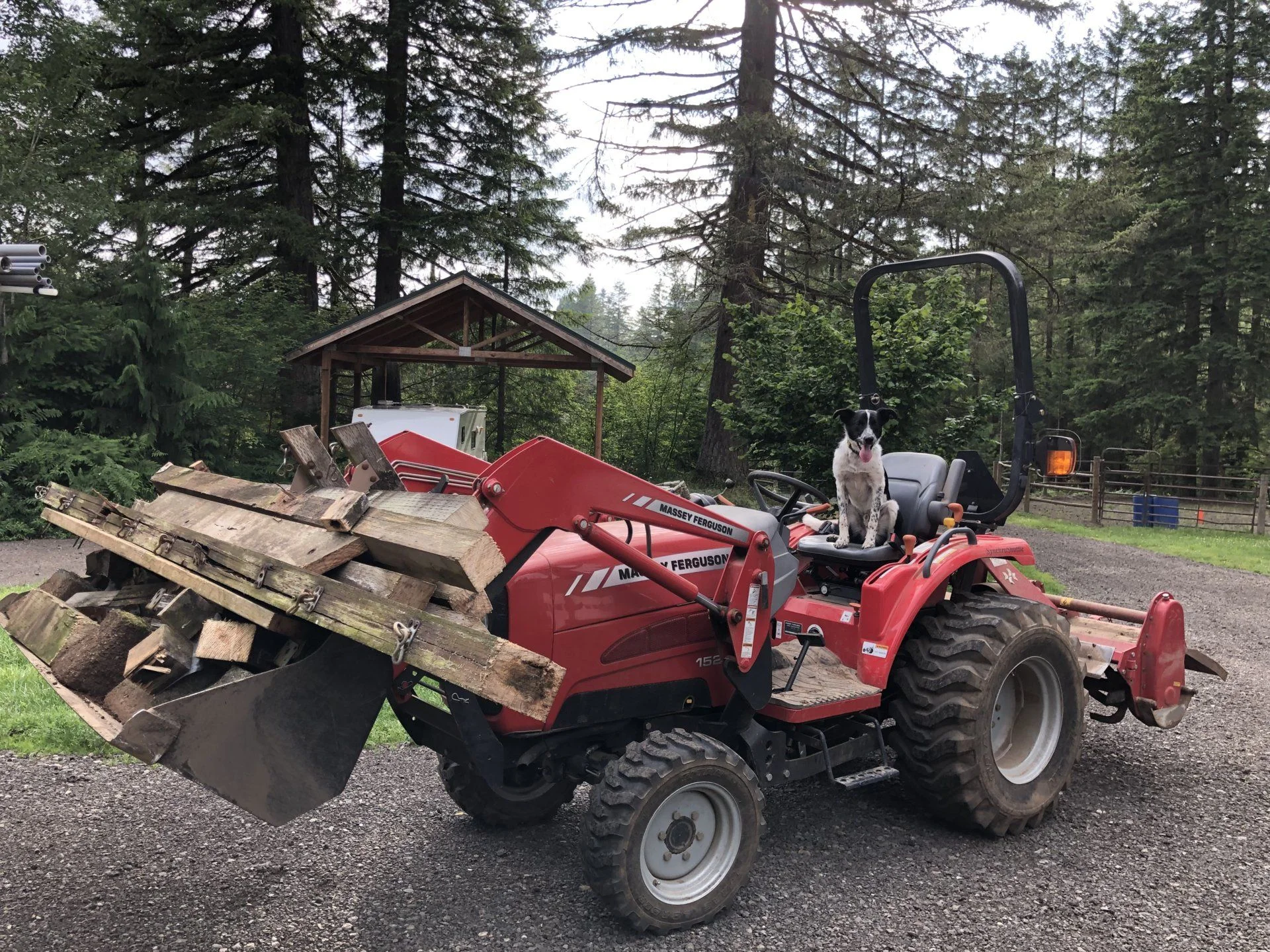

I’ve got a well armed supply of equipment available to get the job done.
Massey Ferguson tractor
Stihl concrete saw
Kubota Mini excavator
Stihl chainsaw
12,000 pound pump hoist

The test holes are to see if your soil is permeable enough for a conventional leach-field septic system, but before you go down that road, check your county's regulation on how far apart the septic system has to be from the water well. You may not have enough room with a 1-acre lot. You can always put in an aerobic system as a last resort, and you shouldn't have to test the soil for one of those.
I know all about the test holes. Have family friends who do septic for a living.

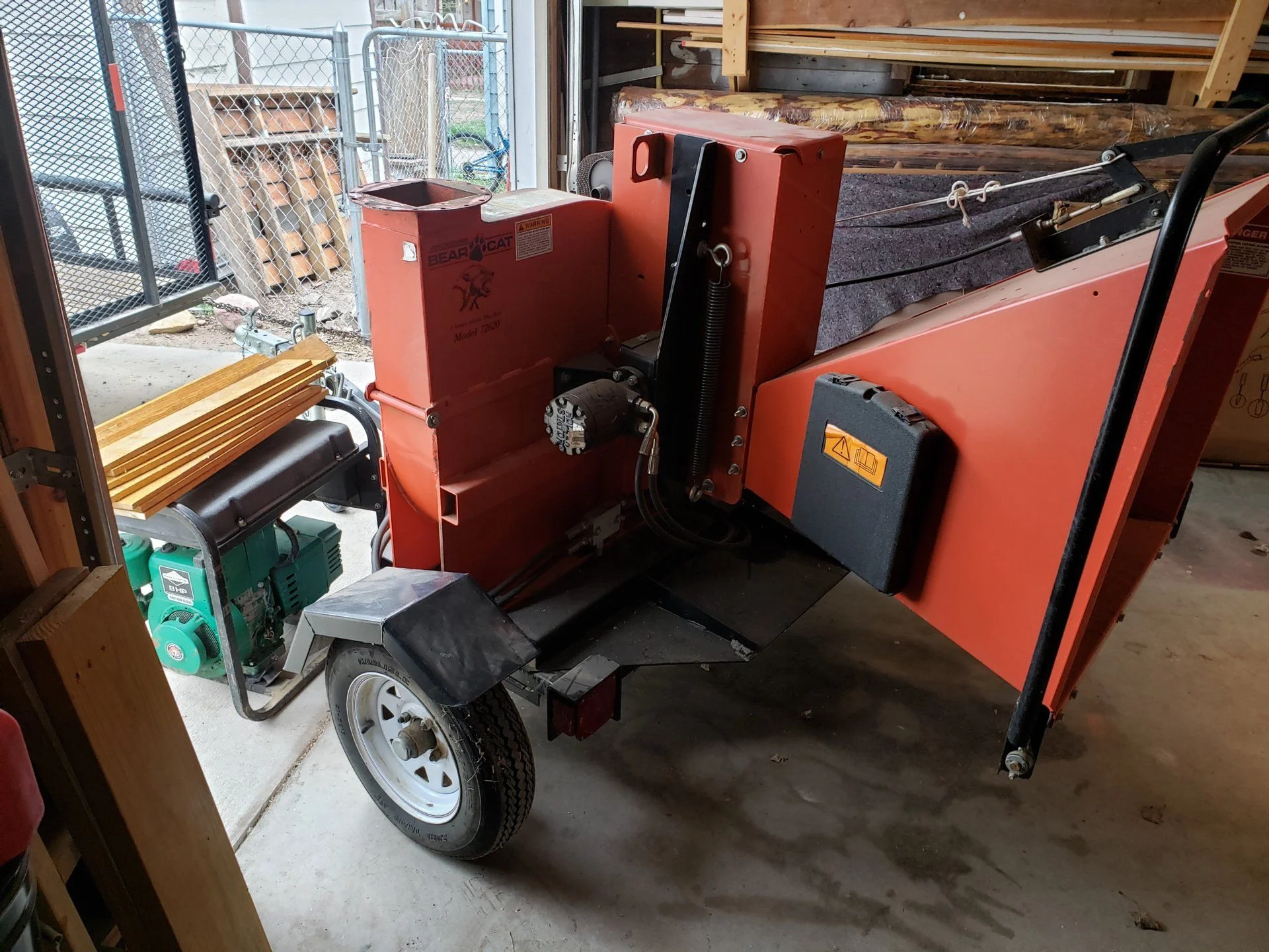

The similarities are amazing. I too have a massey ferguson TLB and a mini ex, but mine is a CAT. Have all the Stihls and other stuff, if you were closer, I would let you use my Towable wood Chipper. You got this...

I have a BearCat PTO wood chipper for my tractor 🤣

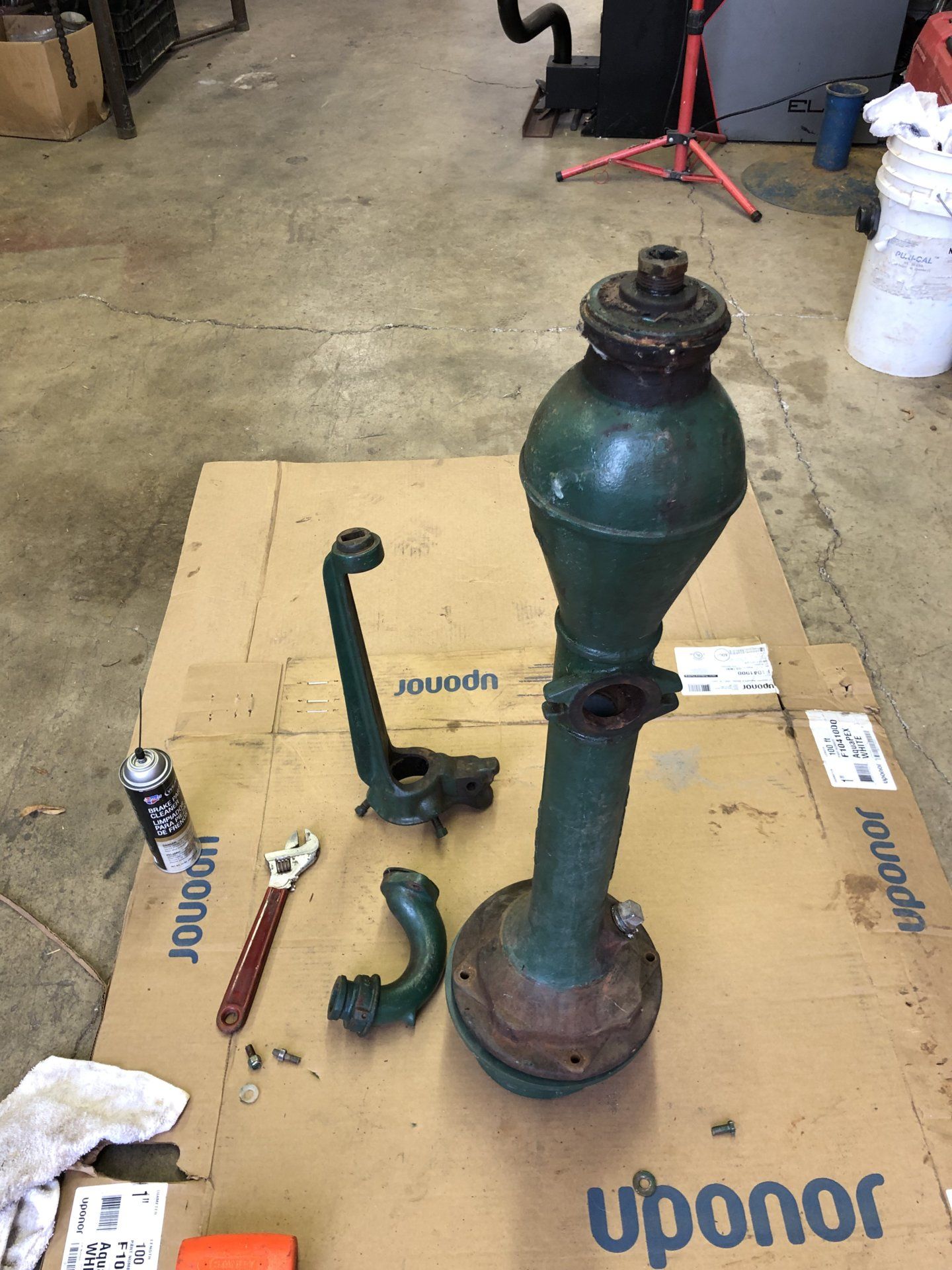

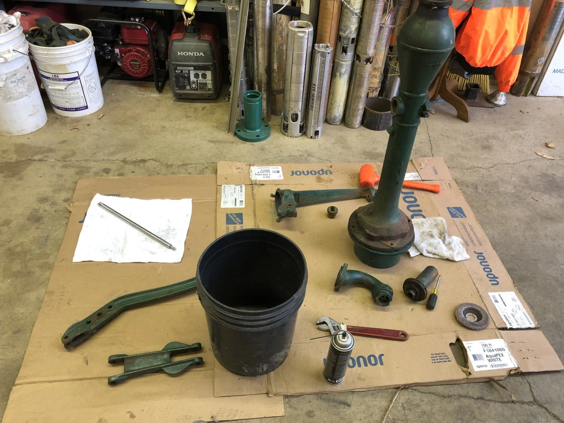

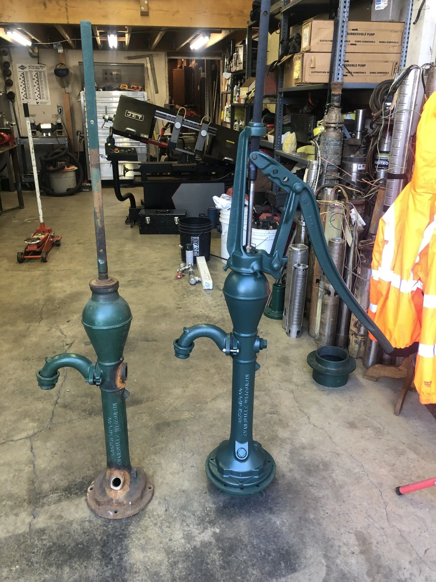

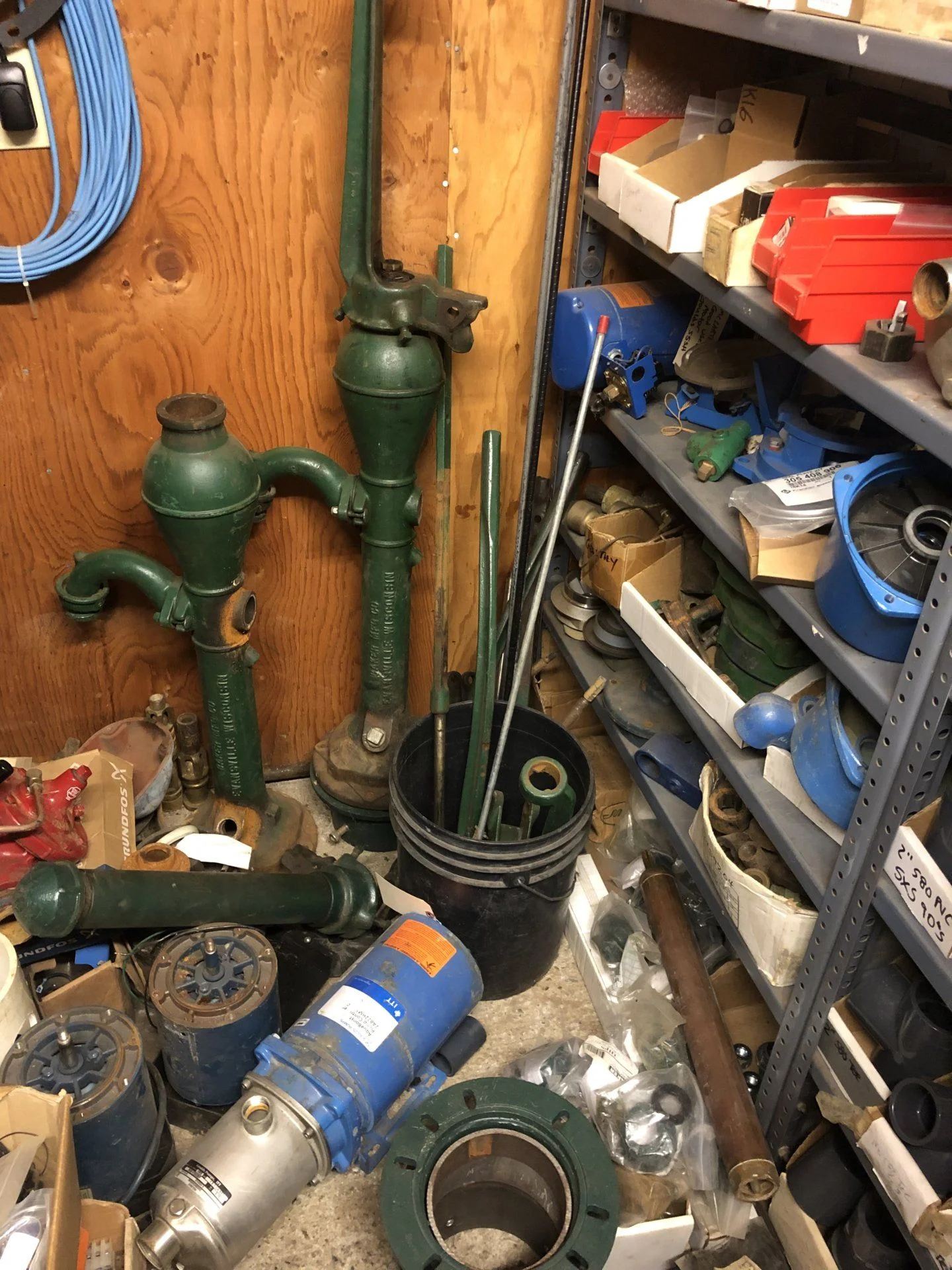

Our family runs a water well business in Oregon. I’ve worked for countless Forest Service campgrounds. Most here in Oregon have manual handpumps which became a fascination growing up. When I got my own house with a well I decided to see if I could put a handpump cylinder down the same well as my submersible pump. I got both setup now on my well. Since then I have been installing them also for residential customers. There’s not a lot of room in a 6” diameter hole and some wells it simply won’t work.
When I do get a old handpump if it’s in decent condition I put it in the bone yard.
Everything was good on this pumpstand. Just needed some cleaning up and some parts.
Gathering all the parts for a complete pump
Used a wire brush on my drill to make quick work cleaning off the old rus
Rebuilt and complete pumpstand.
Headed down to the CL property Friday to install with a submersible in the well.
