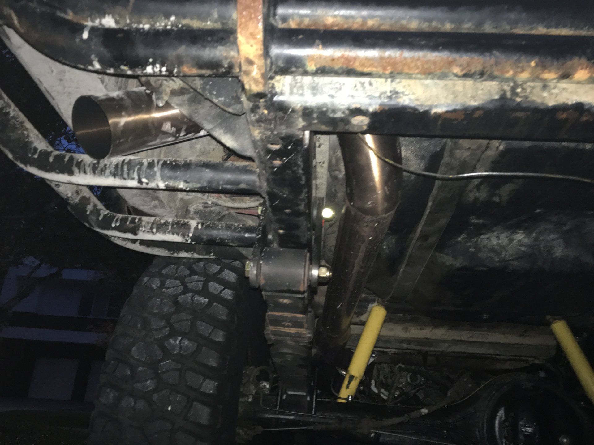

Added another few feet of exhaust, and a cheap hi-flow cat. I had it dumping right behind the rear axle under the truck for clearance but a ton of fumes were coming into the cab like that. It was kind of a puzzle figuring out how to get it out the back without it going under the frame (crunch!) but luckily there’s just enough room to put a 3” tube between the tank and rear sill over the frame.
Then I was dumb and fit and welded the whole thing at midnight and in a thunderstorm so I rushed and didn’t see that the entire taillight harness was resting on the exhaust, so at 6am on the roadtrip the next morning everything went black :doh: completely melted through, and I guess there’s some shared grounds from the dash.
