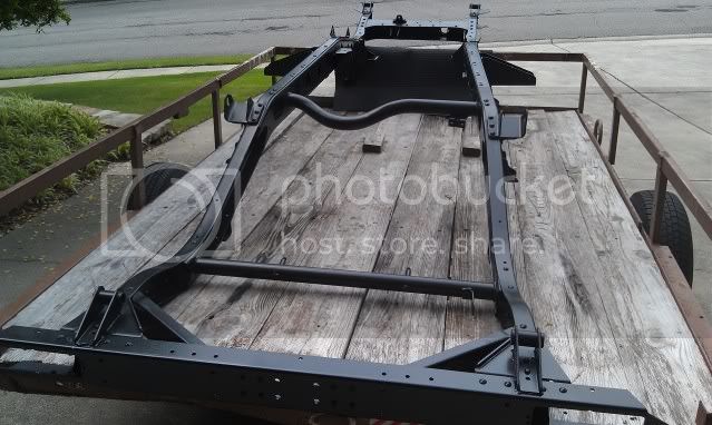

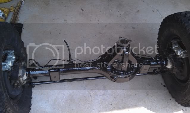

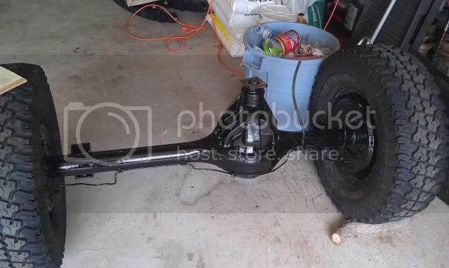

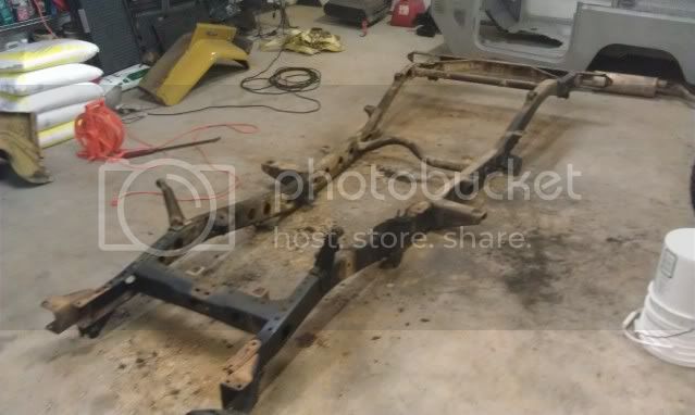

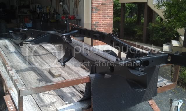

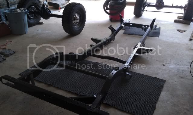

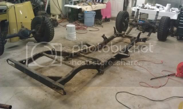

frame is going to the blaster this week. Tub is getting a NOS toyota driver rear quarter and some minor rust repairs in the floor as soon as a competent body shop guy is nailed down. Front axle housing was rebuilt with fj40 disc brake knuckles, reman toyota calipers, toyota pads, rotors, pins, springs and hoses. finished out with a marlin rebuild kit with the eco inner axle seals and koyo bearings.

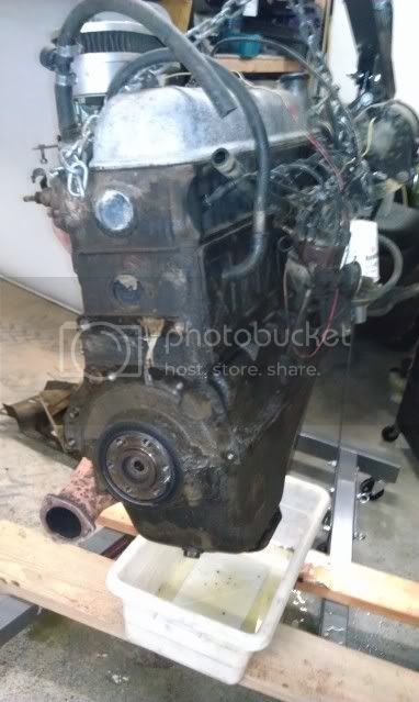

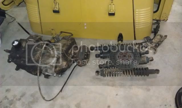

Roma and I have been busy since I returned. We have stripped off all lights, knobs, roof, body parts to get down to see what the "trouble" areas looked like. The roof had a leaky sun roof in it that will be subject of another post when we get to that point in build.

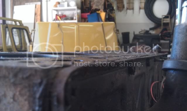

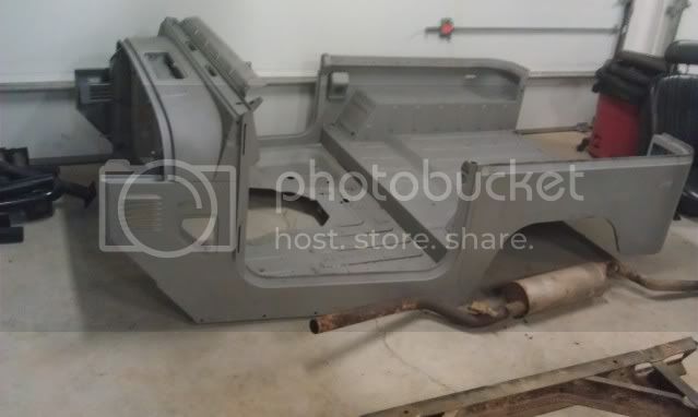

I took the main body into a sandblaster (see attached picture from Roma ). There was some rust spots in driver floor pan and left rear quarter seal that will take some body work. Overall work is progressing very good at this point.

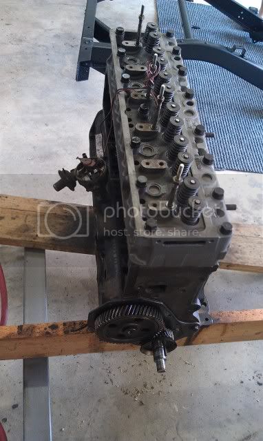

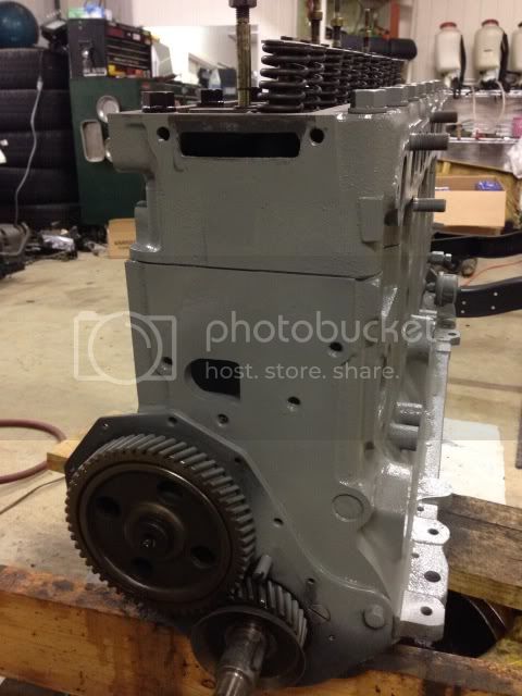

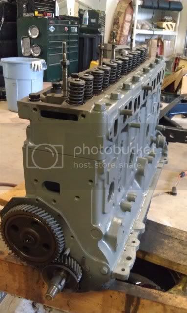

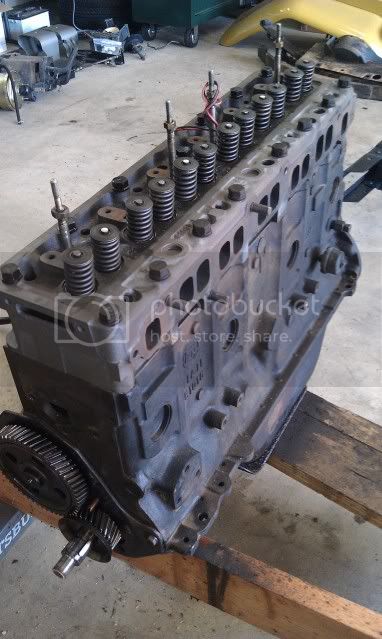

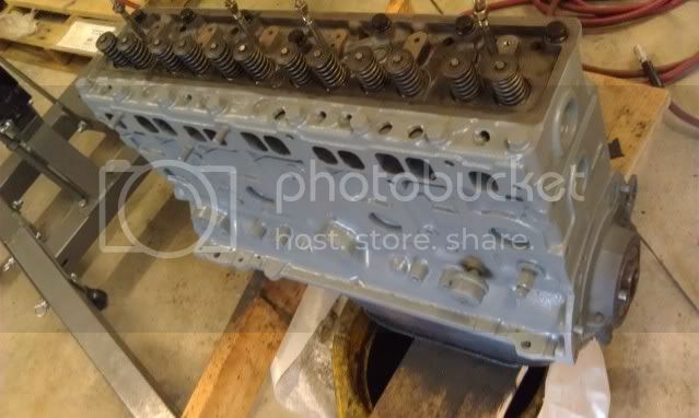

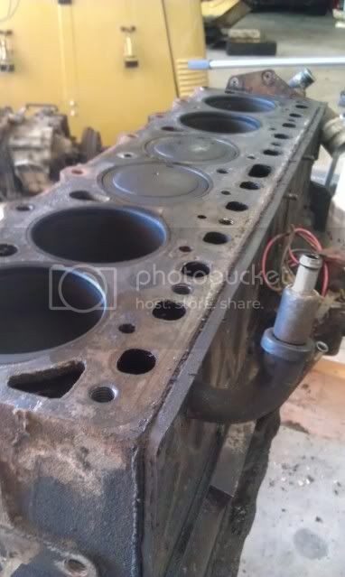

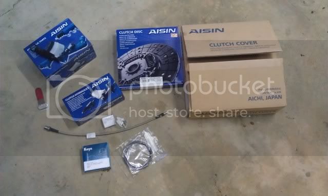

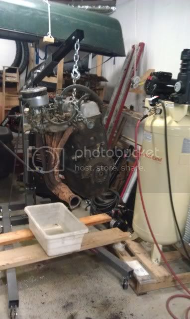

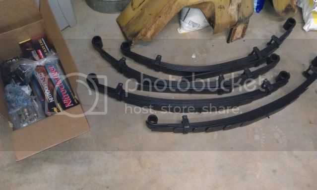

Got a pallet from man-a-fre as well. 2.5" OME deluxe kit and a aisin clutch kit including New hydraulics and line. Engine will get a new rear main seal, oil pan gasket, side cover gasket, timing cover gasket, front crank seal, water pump, t-stat and gasket, and will go ahead and do a cylinder head job as a preventative measure. Head will be decked, magnafluxed and new valve seals and valve job.

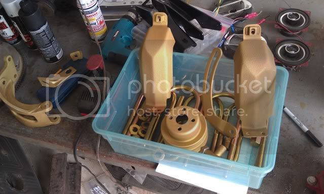

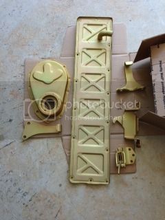

Misc box of items back from zinc plating

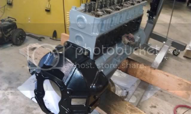

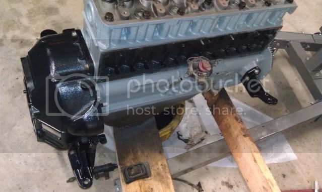

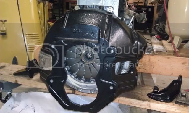

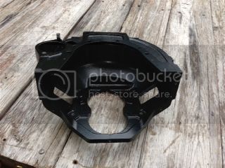

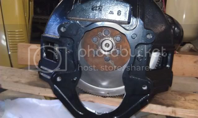

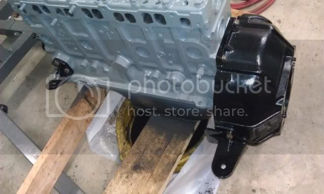

Powder coated bell housing and engine and trans mounts.

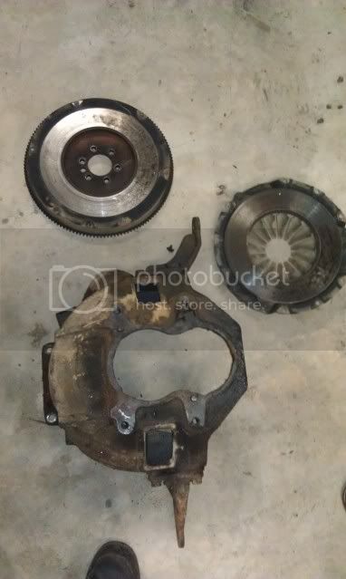

Resurfaced flywheel and new clutch

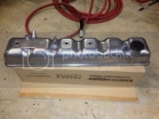

Zinc plated engine hooks timing cover pushrod cover and spare tire latch and hook.

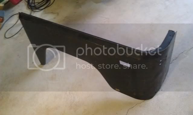

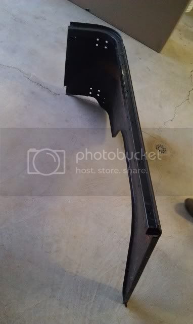

New quarter came in today. I was pleasantly surprised to find out it comes with the whole top channel. Taking that into consideration 250 shipped was a steal!
Where did you guys source this?! Looking good, you blokes don't waste time.
I found the quarter panel here in the classifieds i could not believe it had not sold sooner it had been bumped to the top for months! The pictures from the seller didnt show that it was complete with the top rail so i was pleasantly surprised when i opened the box. Yep moving in a hurry I cant touch mine until this one is done. Mine is patiently awaiting a turbocharger and front and rear axle rebuilds before my next roadtrip in july/august.
