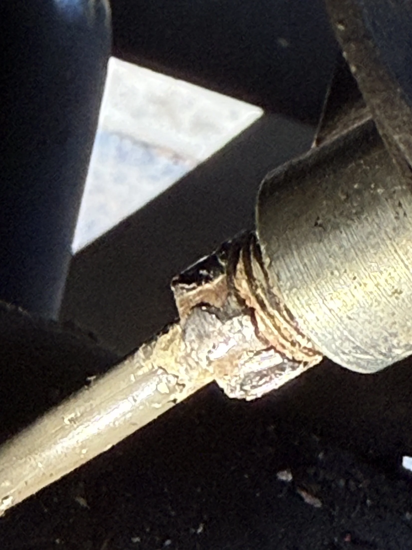

Question: During the process of changing out the soft lines, I learned about "Flare Nut Wrenches". Maybe a little too late. While trying to disconnect one of the hard lines from the soft lines, I kind of rounded off the nut with a regular box wrench. Now that I have the flare nut wrench, it just isn't grabbing. Am I going to have to just use vice grips? Any other ideas?
Nice write up! Keep it going. With regards to the rounded nut, you may have to post a picture. I was able to hold the wrench in place and then use a file to fix the nut.
Good luck!
Good luck!
Will post up something tomorrow. Never thought about trying to fix the nut.
I mean this in the kindest way possible but how do you have 1237 posts here and are just learning about flare nut wrenches?
Take a deep breath, learn and plan.
There is no real “fixing” the nut. There is getting it to the point of getting it off to replace it without doing more harm.

I felt like an idiot asking my wife to go to AuroZone to pick up a flare nut wrench, but sometimes you gotta learn things the hard way. :D In all these years and old ass trucks, I've never needed a flare nit wrench. LOL

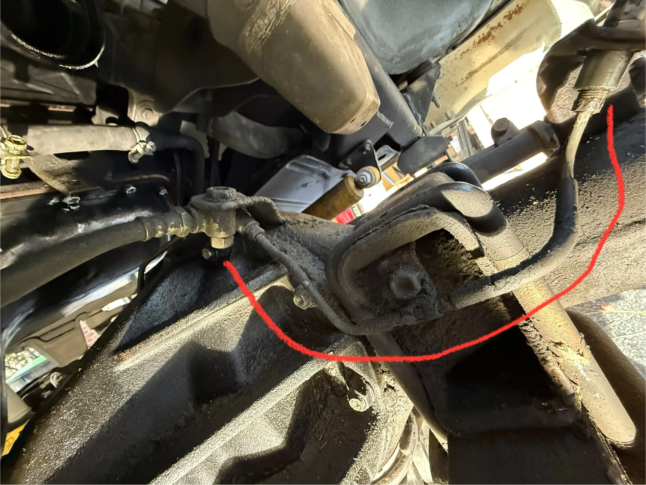

Here’s the nut after some work today. Give grips just seem to rip it apart. I feel like the best voice is to leave the old setup and find a new section of hardline and cut the old out.
Here’s the nut:
Here’s the hose I would need to find.
Finally broke free. Wrapped in some electrical tape so the vise-grips could grab on. It's ugly, but off. May just replace when I do knuckles, but we shall see.

There are companies that make custom hard lines. For example we have one company local that makes brake lines, power steering, etc. for the big trucks.
